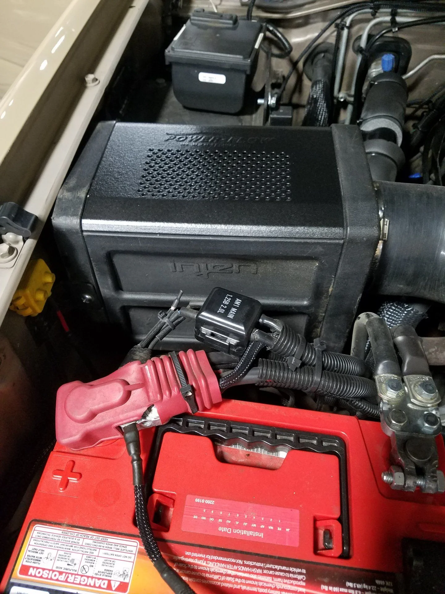

Here are the 4500 HID bulbs in projectors at night. My 4runner has 5500k color bulbs which I don't have a video of and I think the 4500 is a nicer color in helping my eyes see deer and other objects on the side of the road, they seem to bring out more colors in objects at night. Not a huge difference but it is noticeable to me. I need to adjust the lights a little higher. Their is a lot of wind noise because I don't have the rear door all together yet and quite a bit of wind comes in.

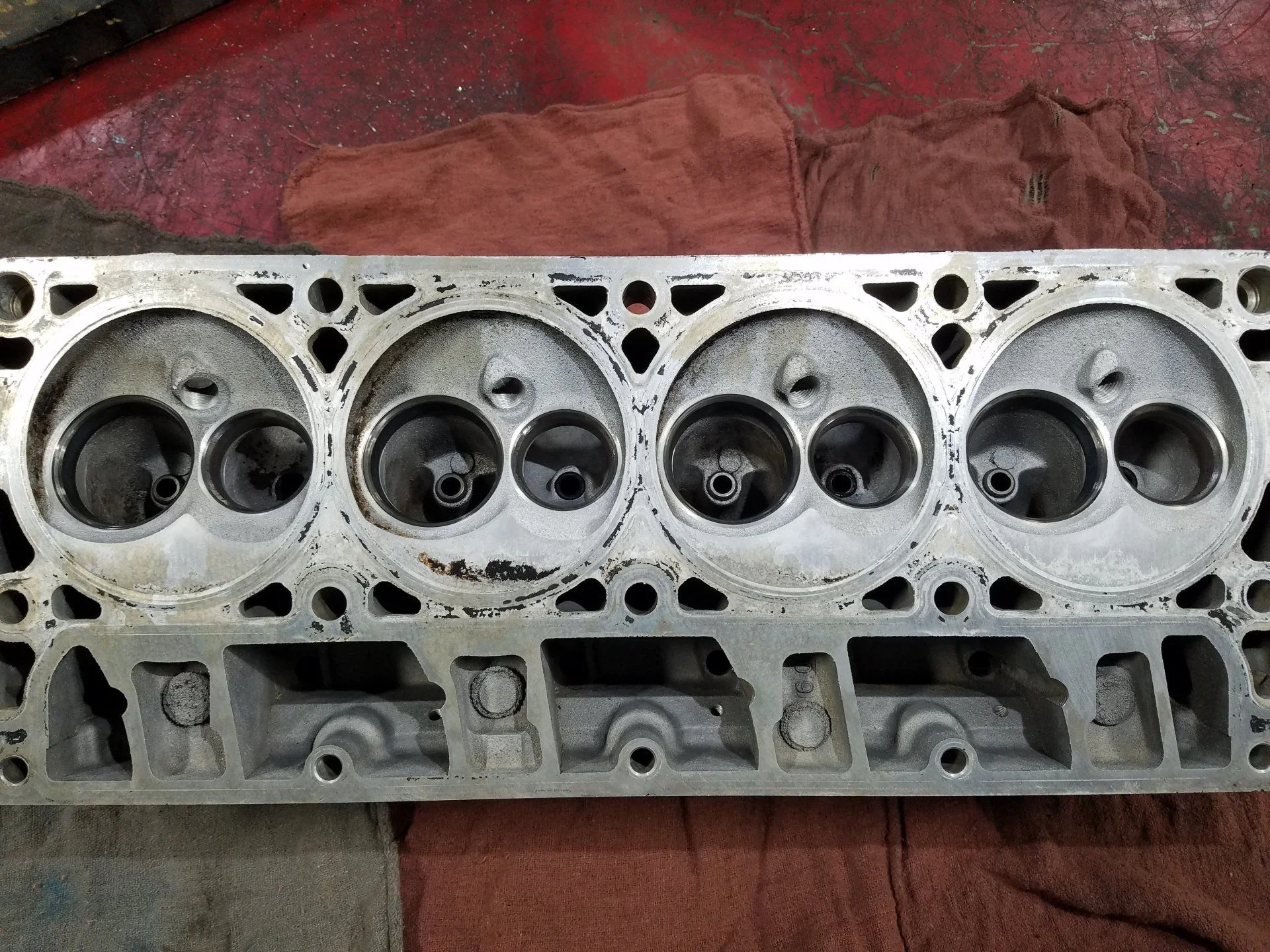

Making a little more progress on the porting...

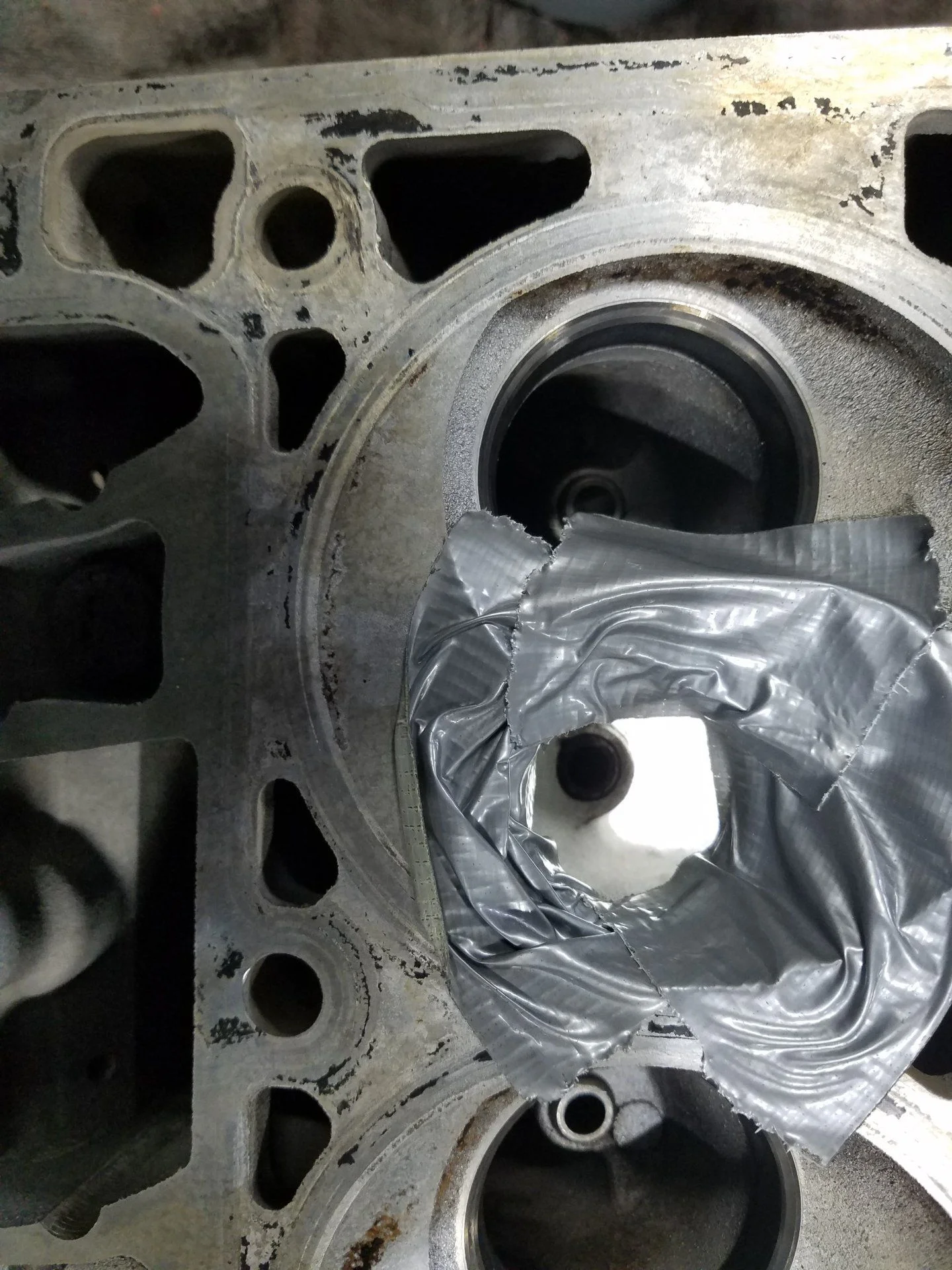

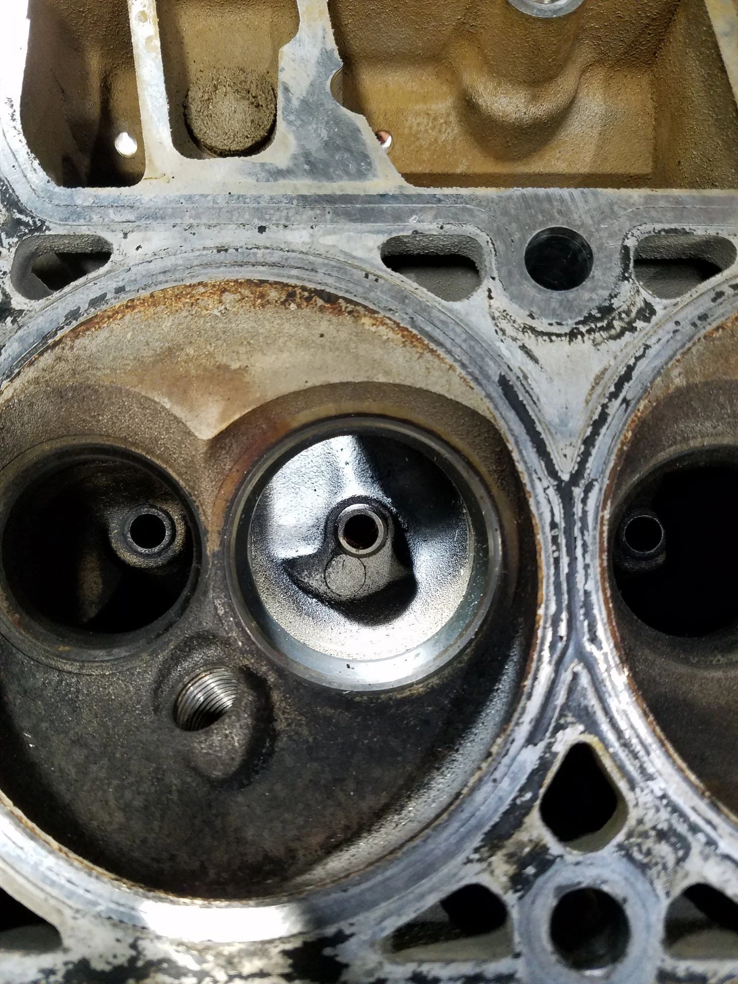

One cylinder head is pretty much done with its port work. I didnt clean the first one very well before starting which made it a more dirty process. I cleaned the second head more thoroughly. I also purchased a higher quality die grinder, I've been meaning too for some time anyway. It's making the whole process quicker. I put duct tape around the valve seat to give mild protection of hitting the seat when I'm worried about hitting it.

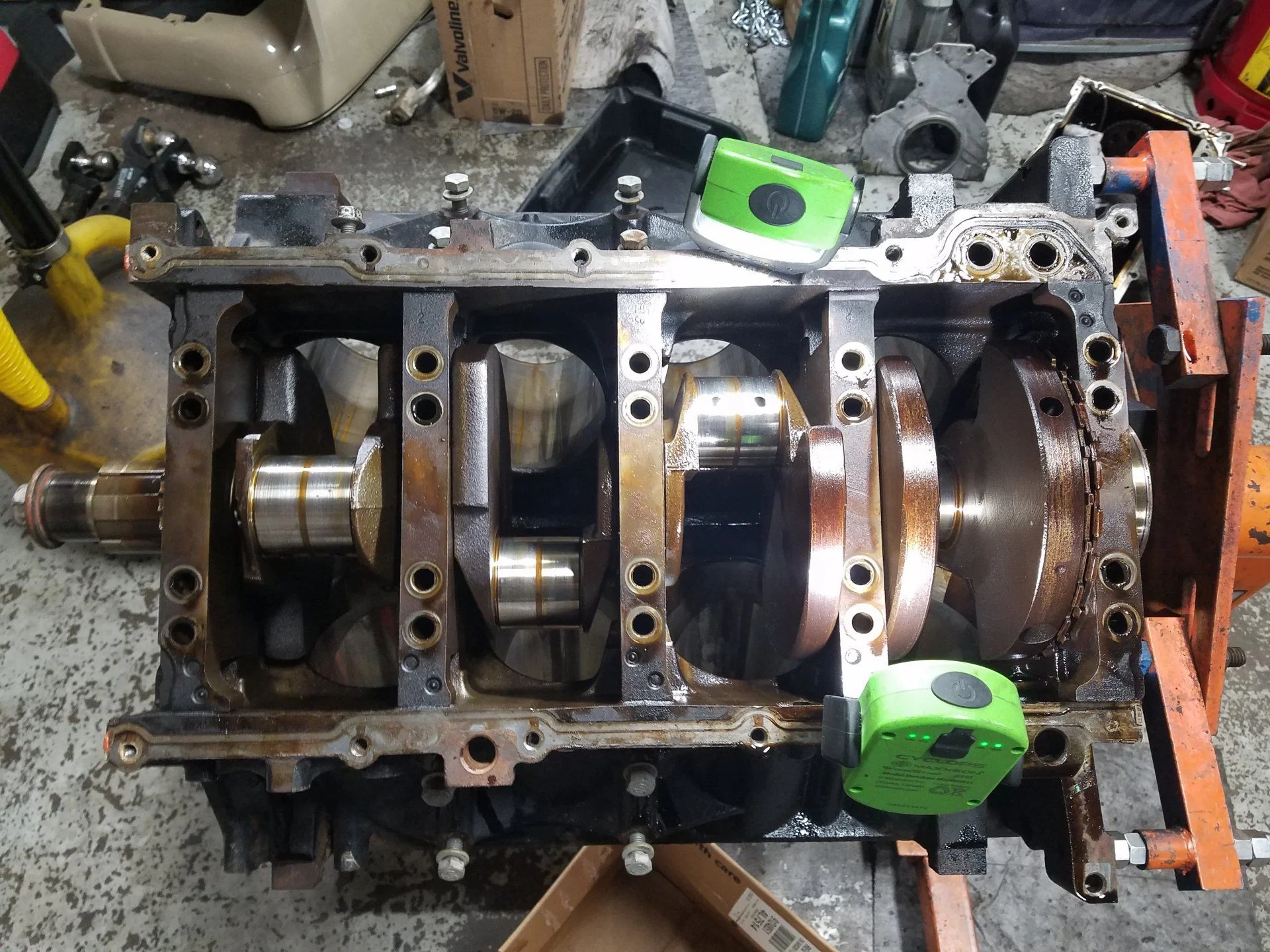

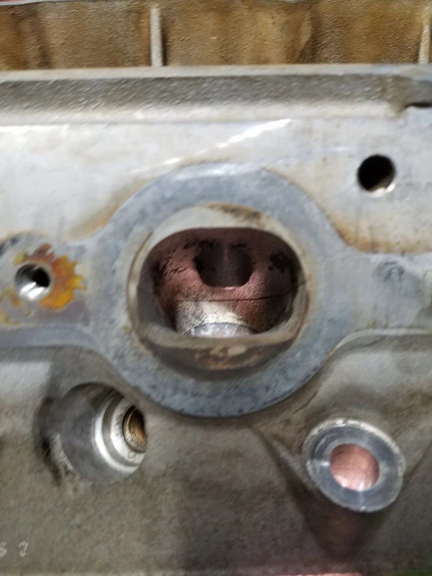

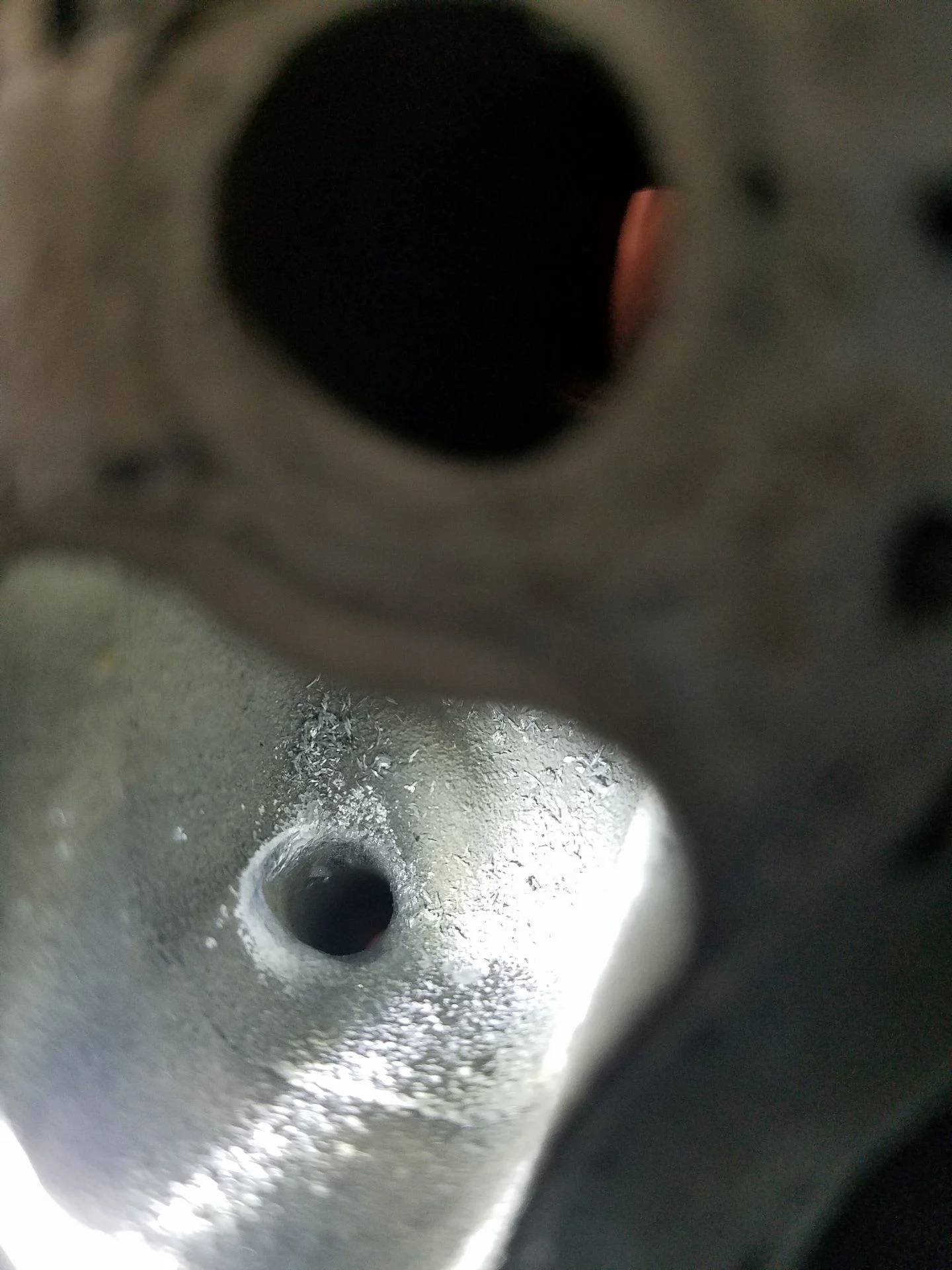

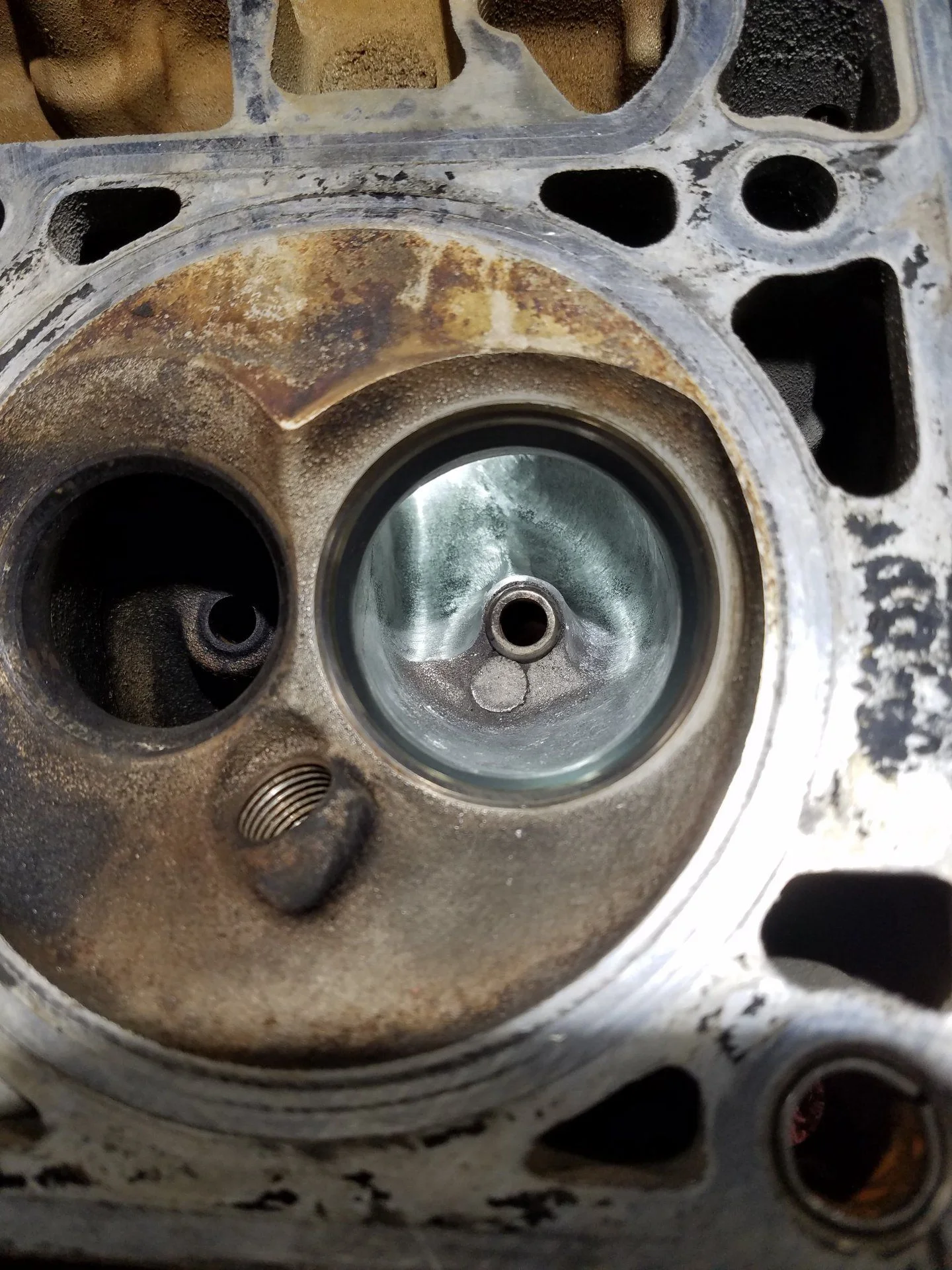

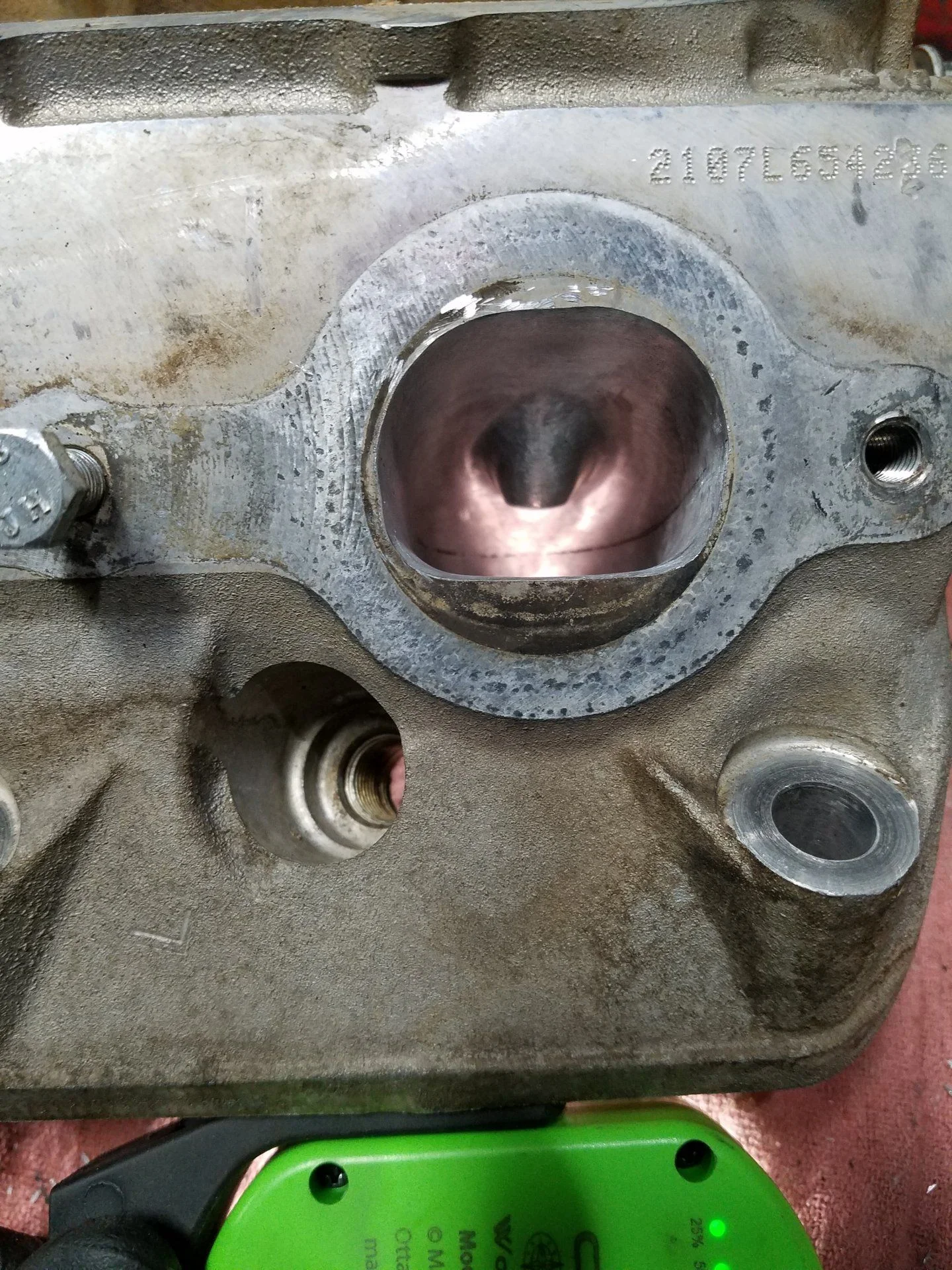

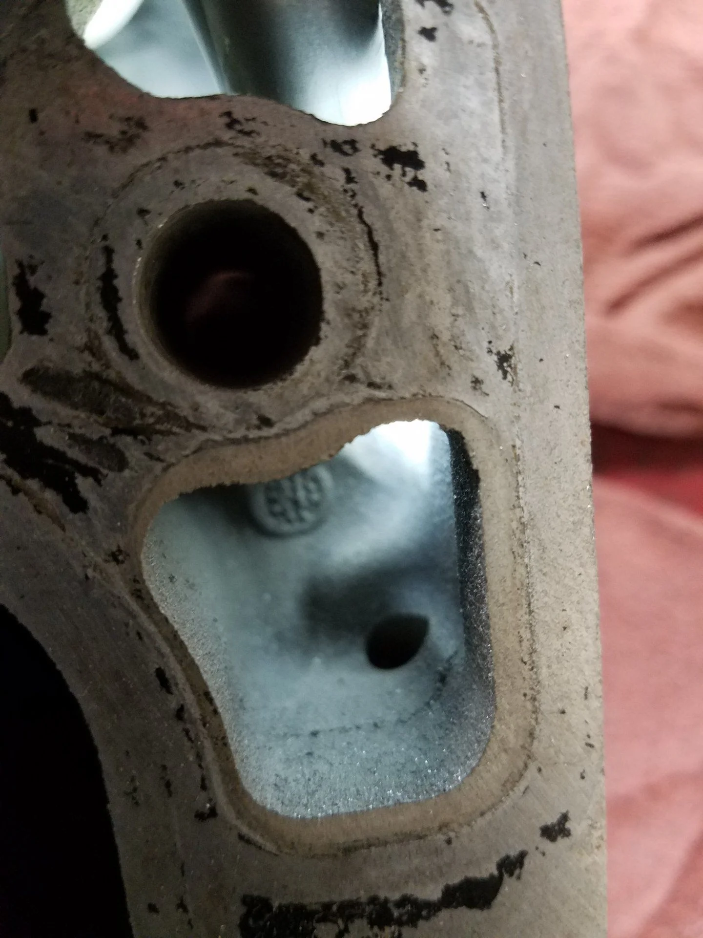

Still working on head porting. While I was at it I smoothed the edges in the coolant passage where it transitions to the steam ports hoping it will help air bubbles to flow out better. Only took like 5 minutes since I was already porting stuff. Here are pics of the underside of the steam ports b4 and after. I'm going to open up the rear steam ports and tee them to the front. Also stripped the block. Cylinders still have crosshatching but cam bearings are in need of replacement. Here you can see 4 of the 6 main cap bolts of each cap. The other 2 of the six are in the sides of the block of an LS motor.

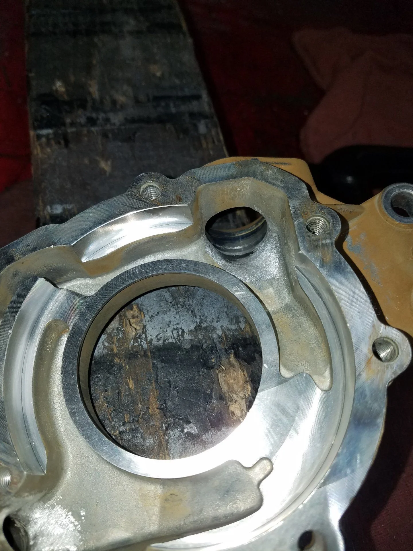

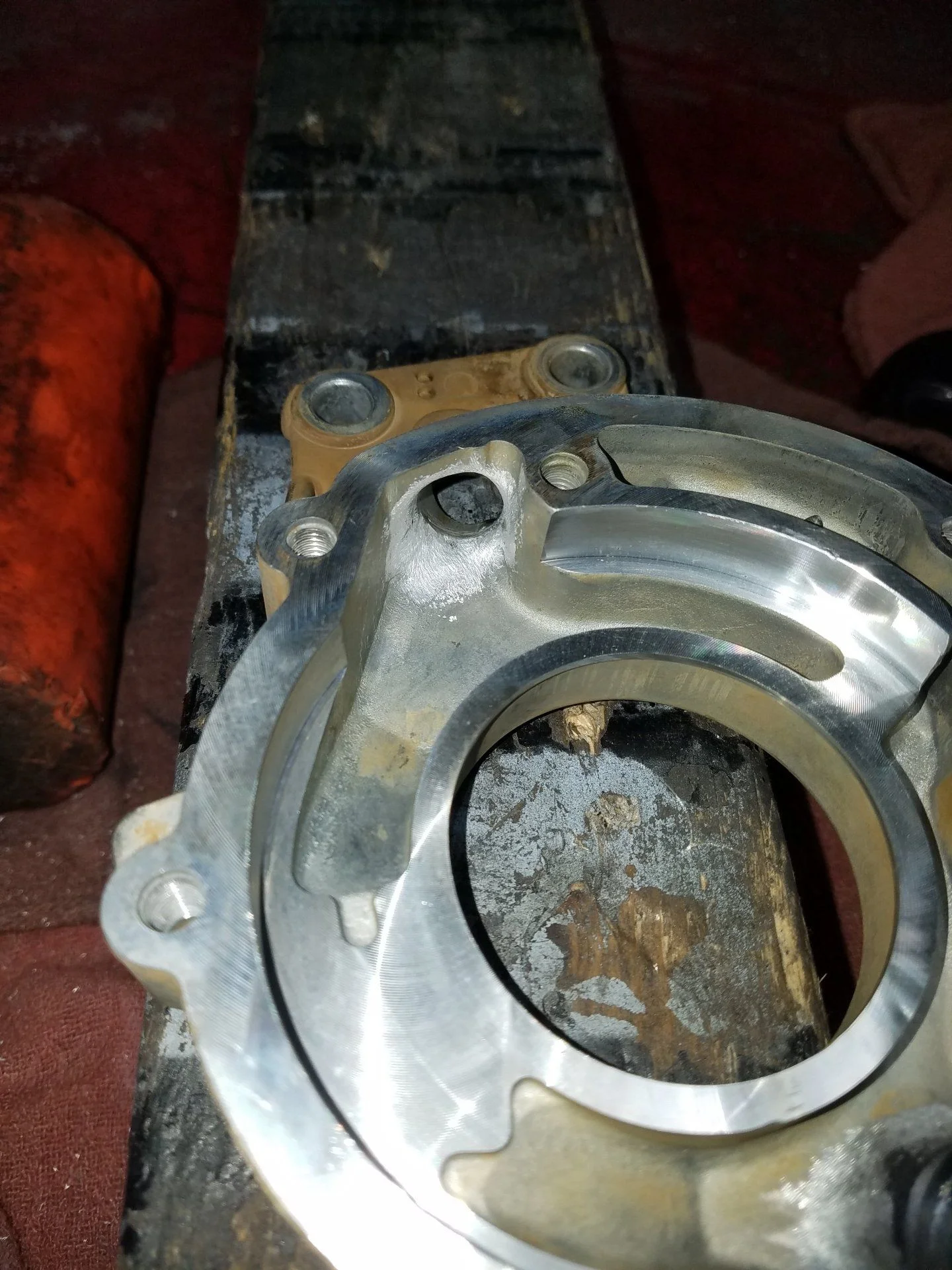

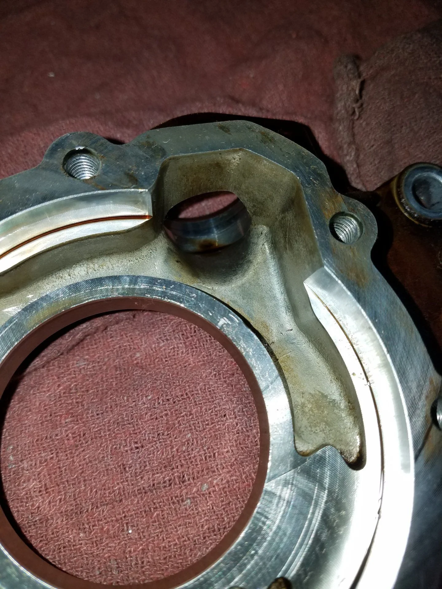

Since I was porting stuff, figured I may as well port the oil pump too. The outlet has lots of room for improvement so I worked it significantly, the inlet I ground a bit too but probably wont make much difference. I also ported the truck intake but realistically not much I could find worth doing and will probably not help.

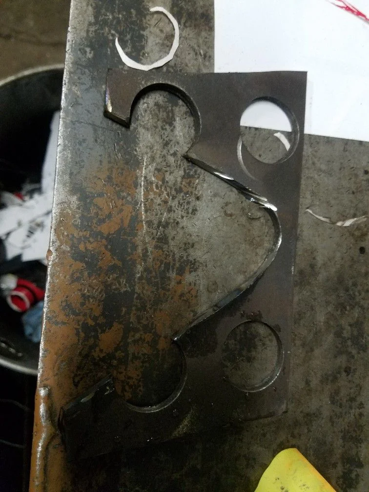

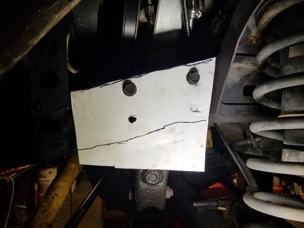

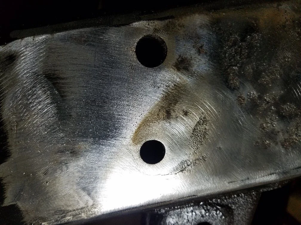

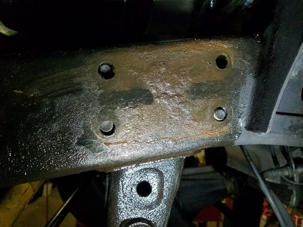

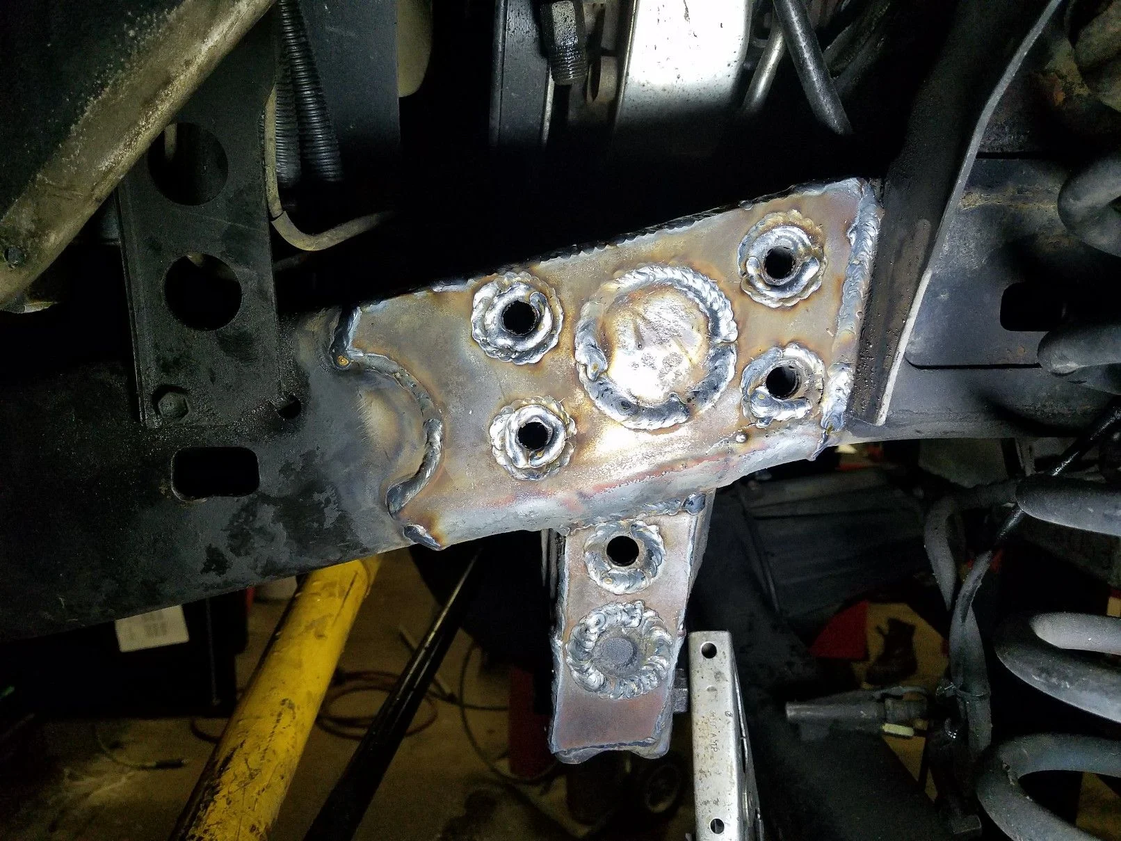

I noticed a very small crack near my steering box. Strange since this cruiser has never had big tires. So I decided I better fix b4 it gets worse.
I drilled both ends of the crack, ground it out some, then ran a weld over it.
This is the plate for the back side. I had difficulty getting the stinger in to burn this to the frame.
Here is the plate welded in. I'm not super thrilled with how it turned out but it should hold up I think. I would do it a little differently if I had to do it again. I also scheduled a dyno run to get a baseline before the new engine. Want to see how much I gain.
Round bottom on block sleeves and combustion chamber edges.
Still working on head porting. While I was at it I smoothed the edges in the coolant passage where it transitions to the steam ports hoping it will help air bubbles to flow out better. Only took like 5 minutes since I was already porting stuff. Here are pics of the underside of the steam ports b4 and after. I'm going to open up the rear steam ports and tee them to the front. Also stripped the block. Cylinders still have crosshatching but cam bearings are in need of replacement. Here you can see 4 of the 6 main cap bolts of each cap. The other 2 of the six are in the sides of the block of an LS motor.View attachment 2496676View attachment 2496677View attachment 2496678
