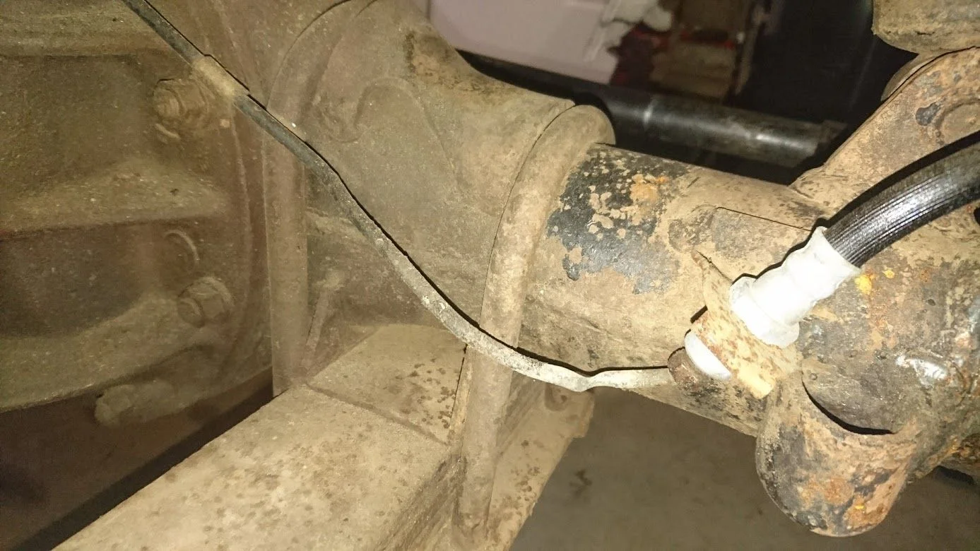

I'm gonna guess that happened when it was strapped to a trailer at some point. @ontherxs had a similar problem, IIRC. Caused him a good bit of grief before he figured it out. Anyone else remember that?
What year did the fitting sizes change?
Any leaks or cracks Joe? I would probably opt to replace it crushed that bad or its just a matter of time.
Yah, i recall that episode. It was acting like a check valve i believe and allowing fluid past the crush but then not releasing the pressure. It does look like tow truck or trailer strap damage. Cant recall the year change but i bet @Trollhole might.
I have "fixed" smashed brake lines like that with vice grips. Find a section of straight brake line and set the vice grip to lightly touch the brake line. Then, position the vice grip over the smashed line and clamp the widened section back down to size. By pre-setting the vice grip, you are less likely to oversmash it. This will get you back on the road until you source a replacement line.
This smashed line is on the wheel that dumped fluid. @roadstr6 I will try your method -- many thanks for that suggestion! Guess I need to get a line made locally, although I may try to make my own since I have the tools.
