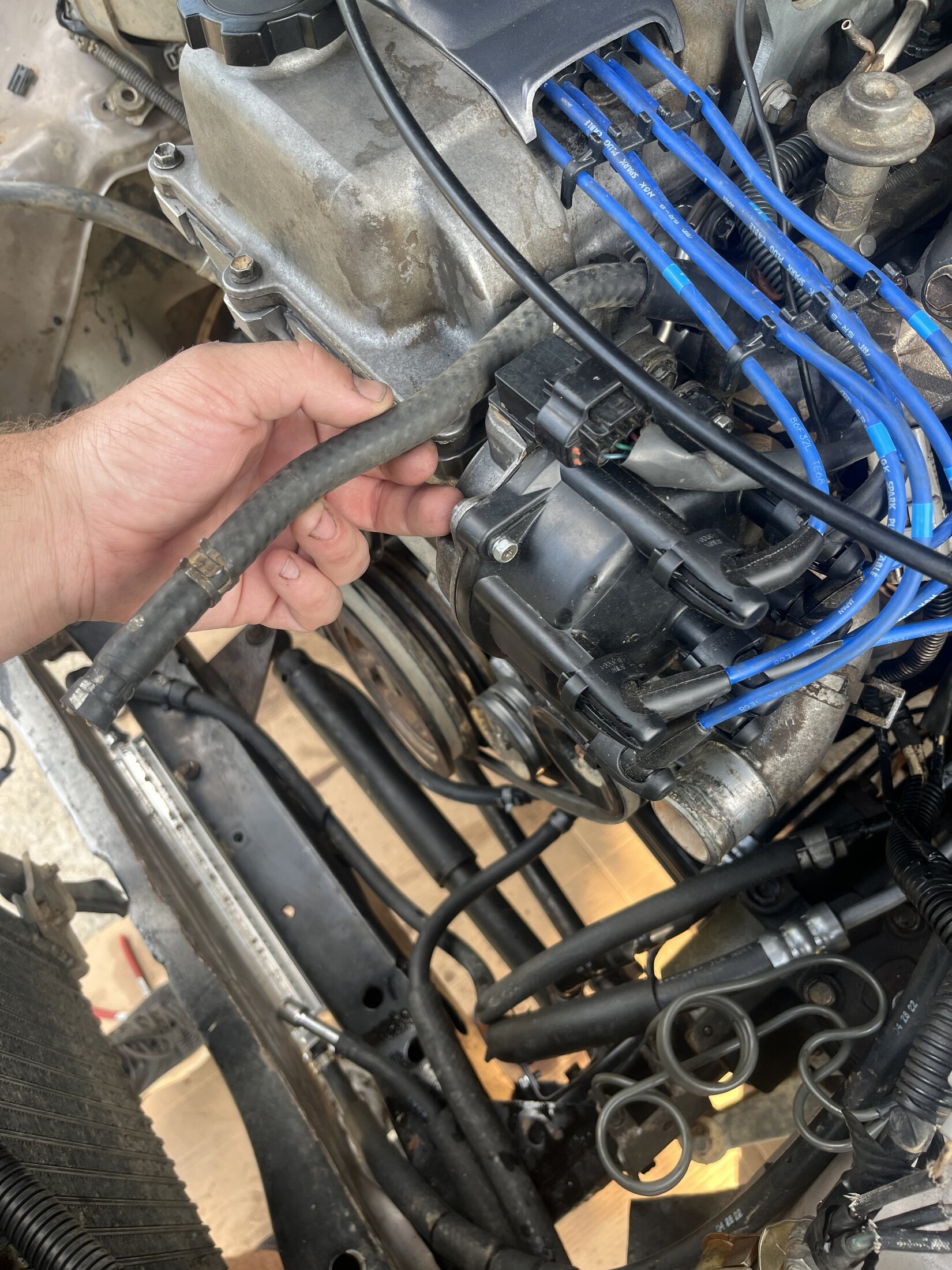

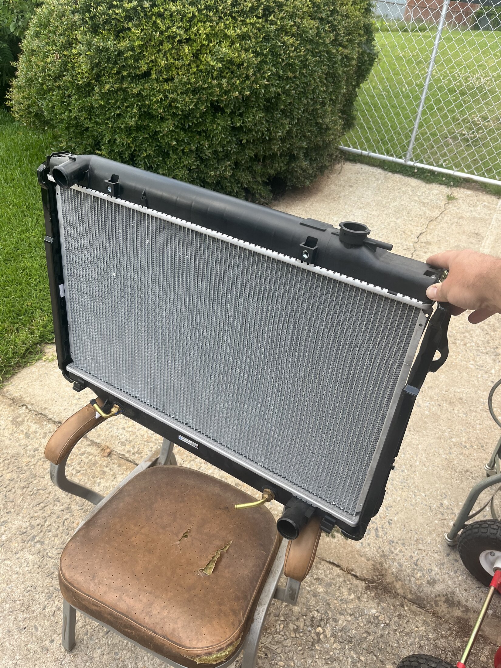

So the nipple for my new radiator is broken off, shipping issue.
I had put JB weld over it and was going to cap the small line that runs to it but am having second thoughts.
I thought it was a throttle body coolant line until I looked closer.
Anyone know its purpose? Helps flow somehow having another passage?
You could drill and tap the broken fitting and thread in a brass barbed fitting
That was my plan, but I ended up just JB welding the hole. And plugging the hose with a bolt.
My determination is that the hose is just a vent to help with bleeding air out. It's the top of the system. Remains to be seen how she works.

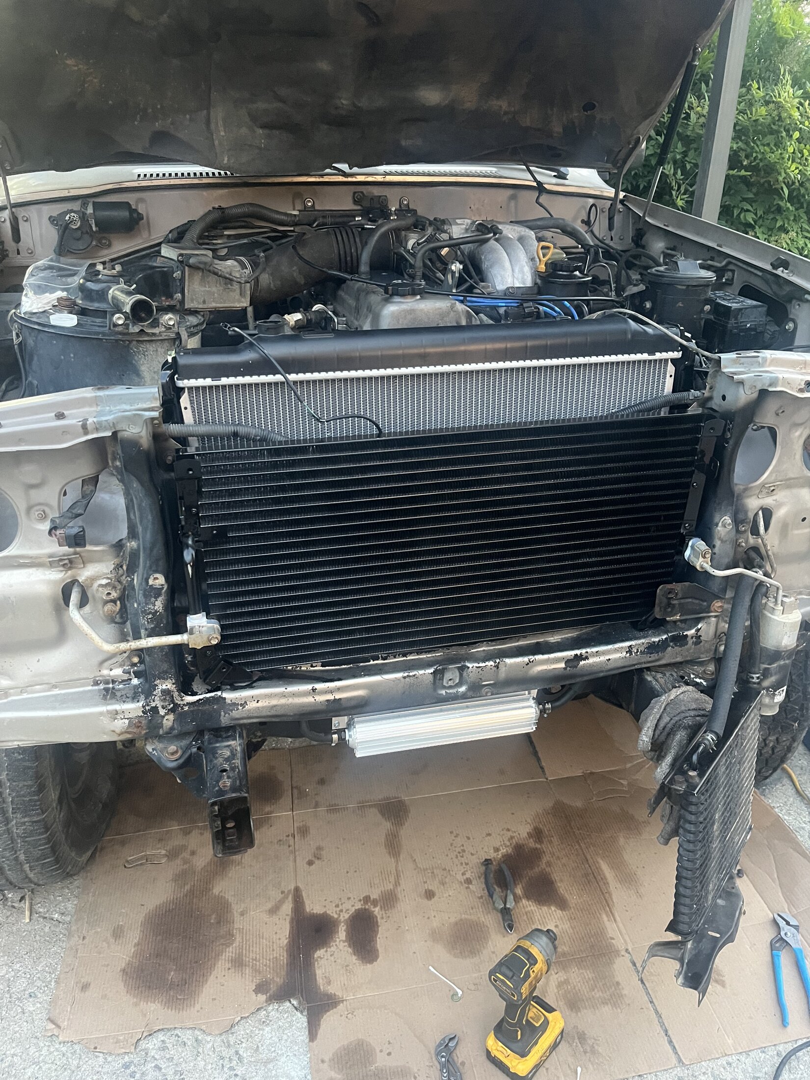

So now she has a new radiator, new condenser, and a derale PS heat sink cooler

Got the front end put back together and bumper on at about 11:30 last night.

That nipple is for the throttle body warm up circuit. You do not need it, but I doubt JBWeld will hold the pressure from the radiator. The epoxy might hold, but I have no confidence that it would stick and stay there. I have two perfectly good, almost new radiators with the same failure, in boxes on my shelf. That's why I only use metal radiators. Those plastic tanks are worthless.

I'm a little confused how that hose is part of the throttle body warm up circuit since it goes to the water neck. But that's good to know I didn't need it.
I used the 2 part JB weld epoxy and she's holding good so far. Held up all weekend at Windrock.

You are correct; I was confusing the thermostat housing connection with that one. IMO, it's still something that's not necessary. I've never had a problem filling the radiator and having to burp it. The water neck is higher than the outlet on the head; I think it's self clearing.
Good to know the JB Weld held. I'm interested in what the long term life is. I need to do something with the very nearly new Toyota radiators taking up room on my shelf. If Toyota had designed the tanks to be removable, you could easily back up the fitting with a nut and seal it. Chalk up another victory for value engineering over common sense.

Yeah I have a ton of friends who have ordered radiators online and had them show up damaged the same way. Packaging is not up to snuff for the violence of mass market shipping.
My buddy got one with the nipple for the overflow tank hose broken off and he was able to drill it out and thread a brass nipple in and it's held for a couple years now.
