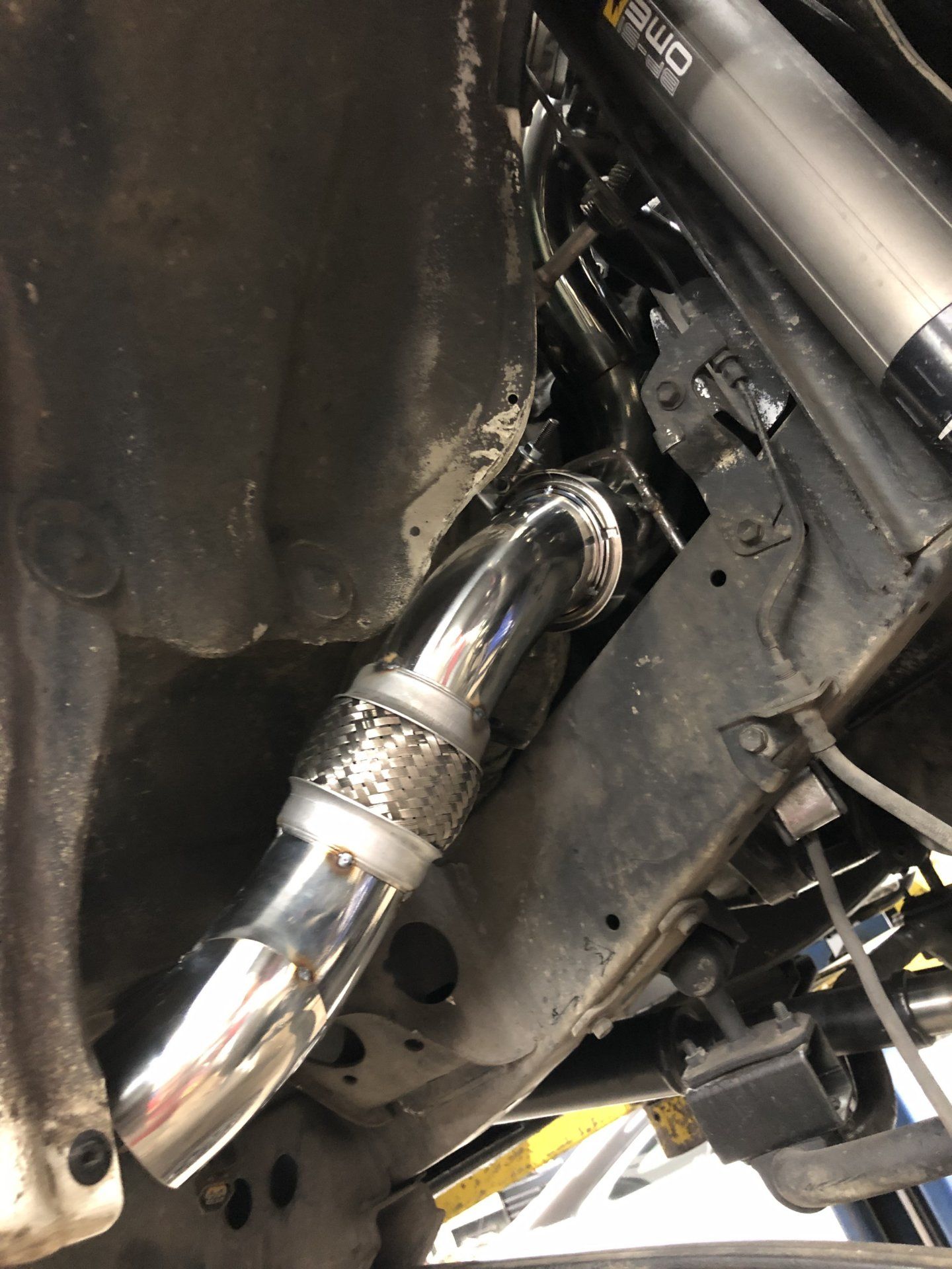

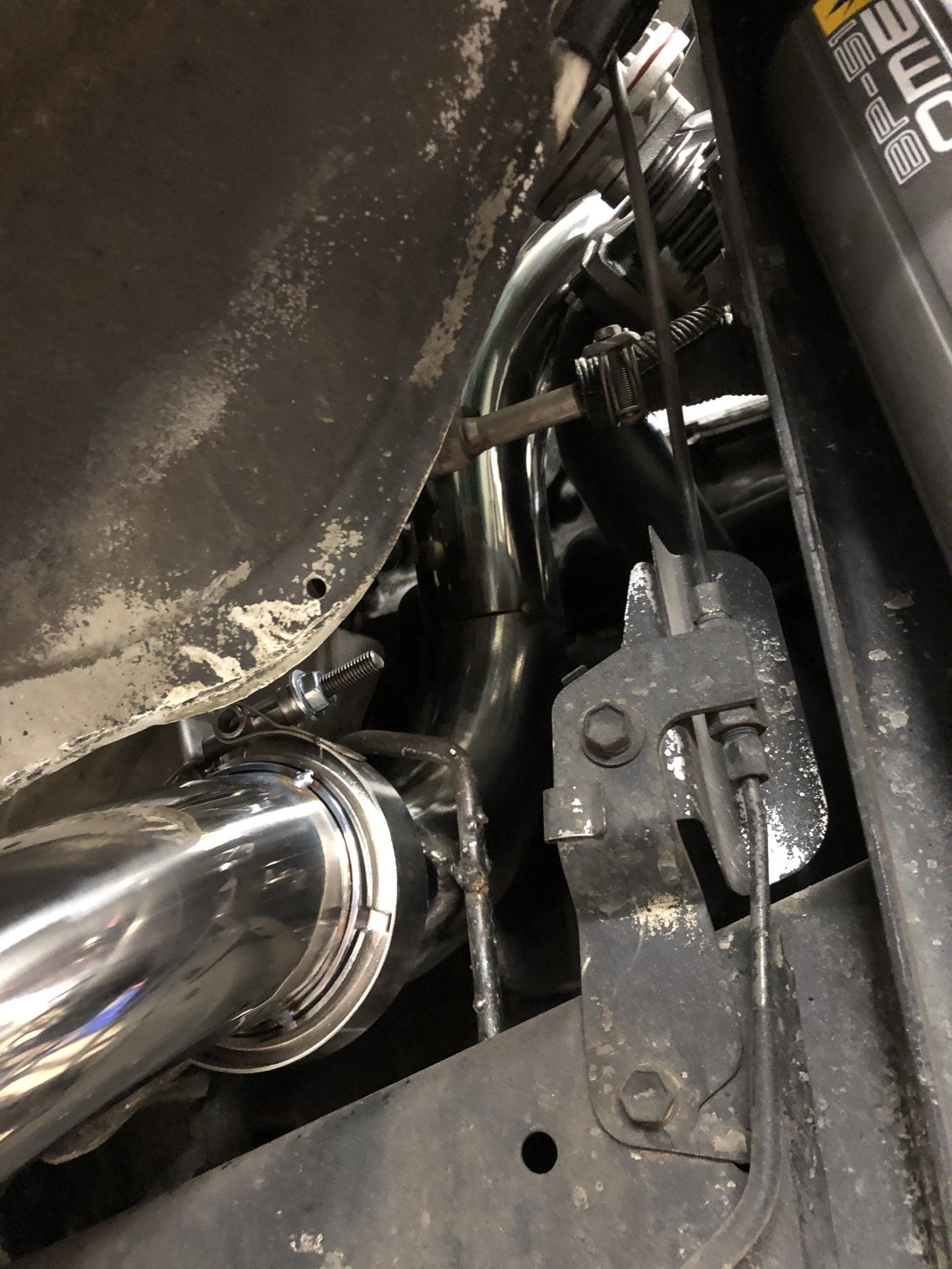

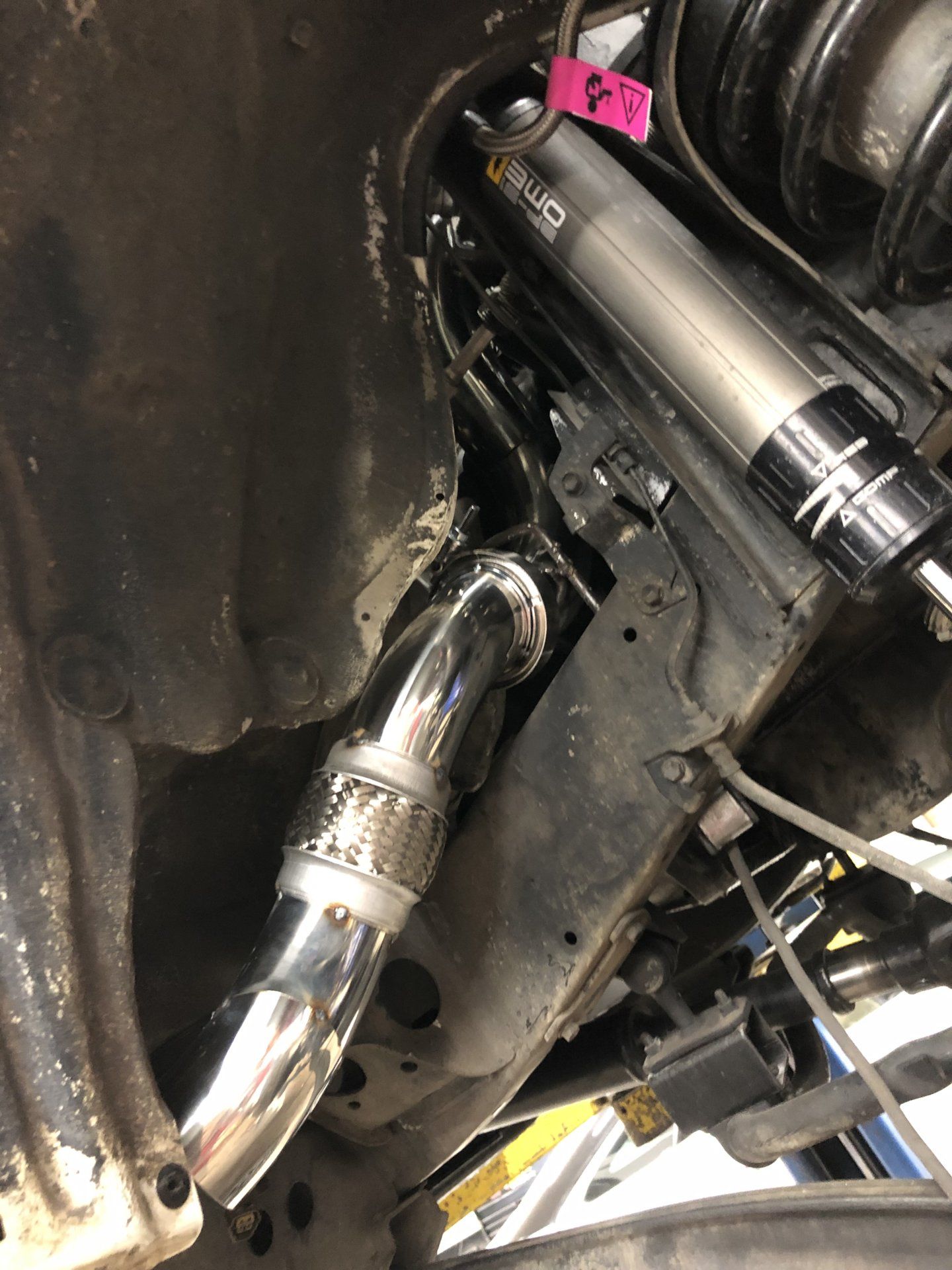

A few updates exhaust is done. I decided to go with a mandrel to the muffler then bent stainless. I also used a Borla Exhaust. After the extra bands, muffler etc price went up to 750. I thought it was still very fair. The work is very good. I decided to send out the DP and second pipe to get ceramic coated.
