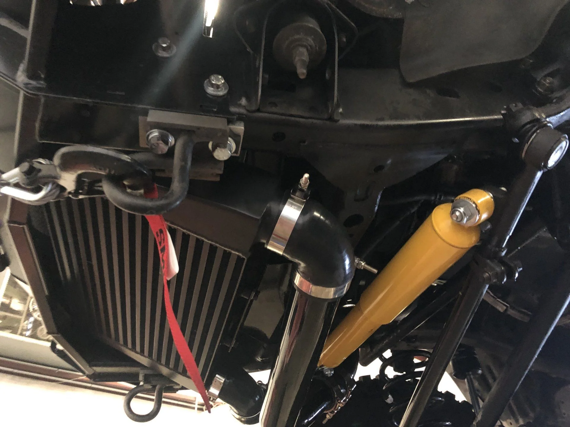

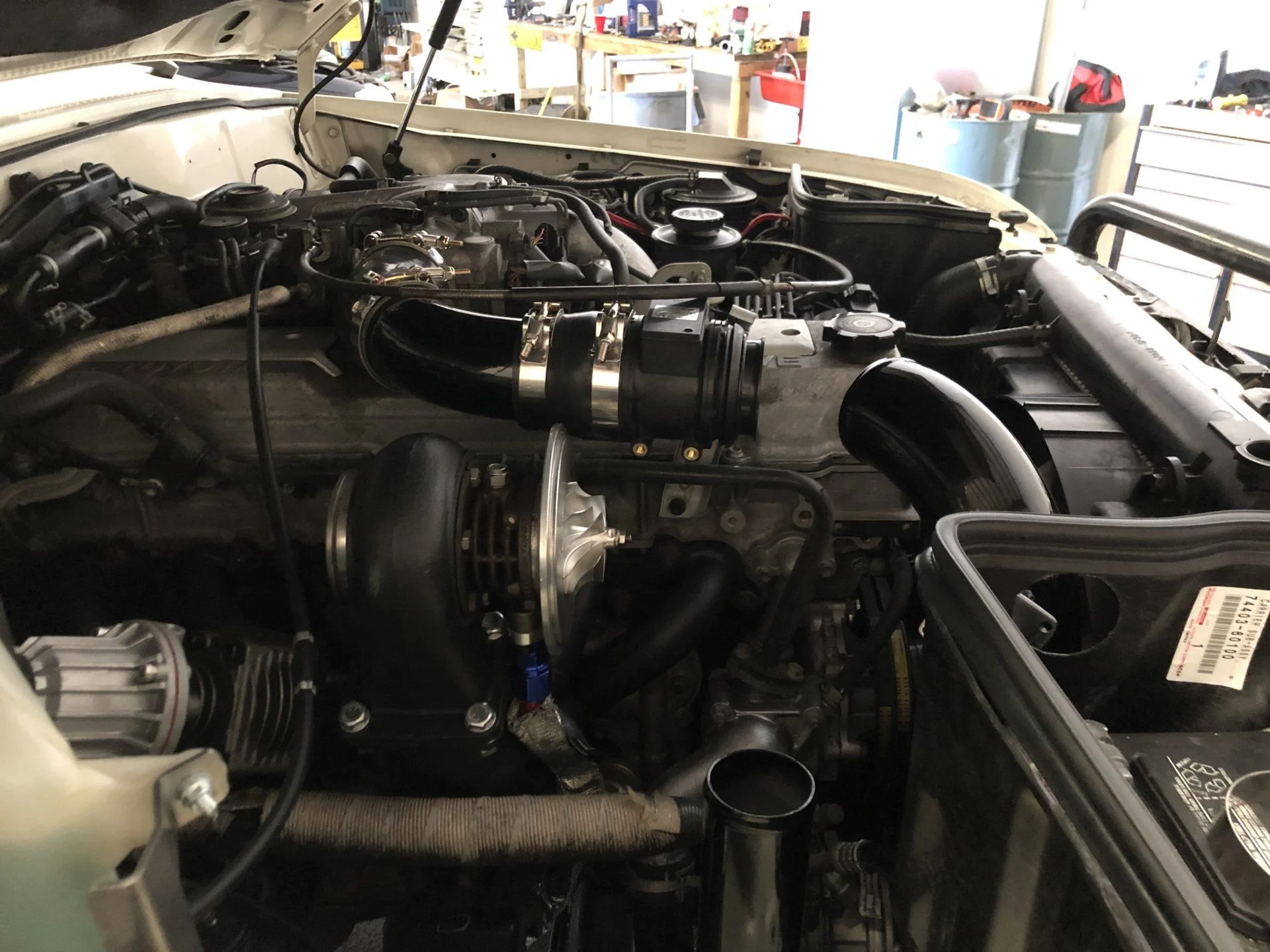

Plan is to run on stock ECU 7-10 PSI safely.
Preinstall:
1. Tranny fluid change with transgo shift kit $378.25 installed
2. Step colder plugs ?
3. Walbro 450 FP $104.89
4. Ordered Innovate SCG-1 boost gauge and controller with wideband $310.86
5. Bought Precision 5858 DBB from friend with little use for $600.00
6. Bought correct T4 4bolt exhaust housing $180.00
7. Bought 3.5LB spring for wastegate.

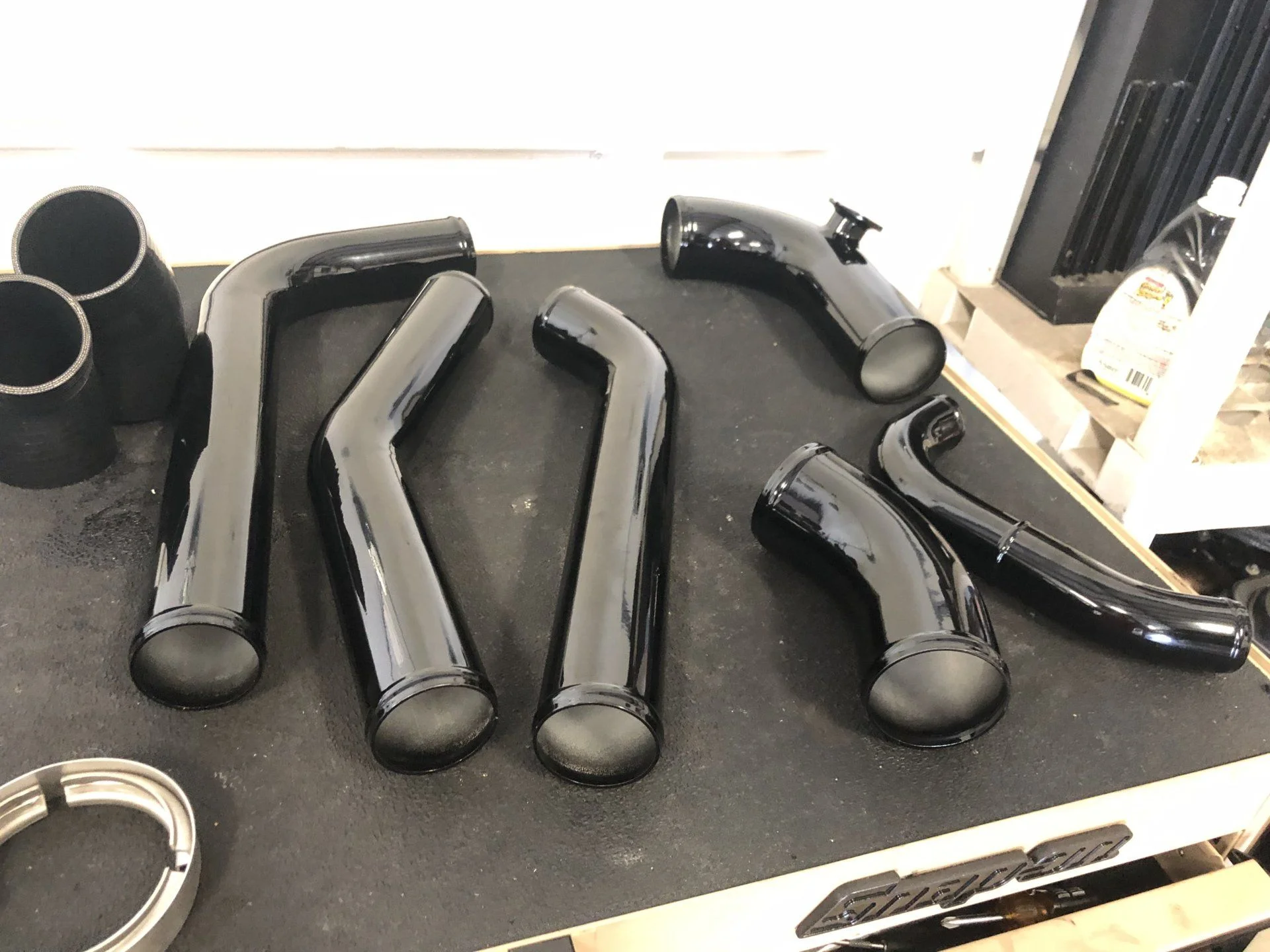

7. Had all cold side pipes powder coated black, intercooler cerakoted black, and hot side parts ceramic coated black. $500
8. Paying a friend with a shop do install $500.00
Kit: CXracing hot side kit minus downpipe, CXracing cold side kit for ARB bumper.
1. Ordered CXracing kits with discount minus Turbo and DP for $1433.00
2. Custom 3" turbo back stainless exhaust with high flow cat and quite muffler. quoted $350

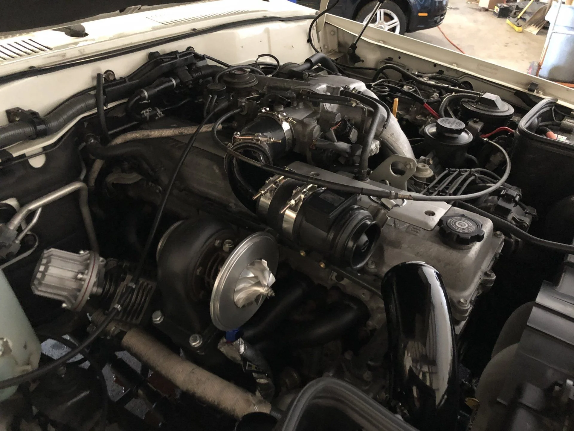

Status: Need 2 silicone hoses to make the kit fit better with my turbo. Then install SCG-1. Then take it to the exhaust shop for the custom exhaust. Exhaust shop will fab pipe from turbo to OEM air cleaner.

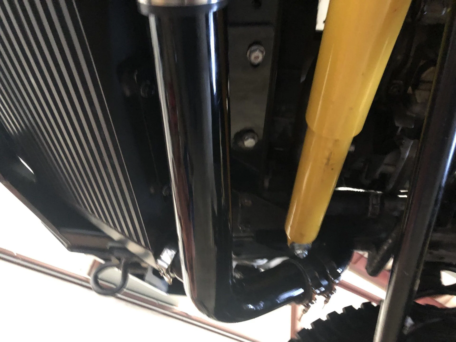

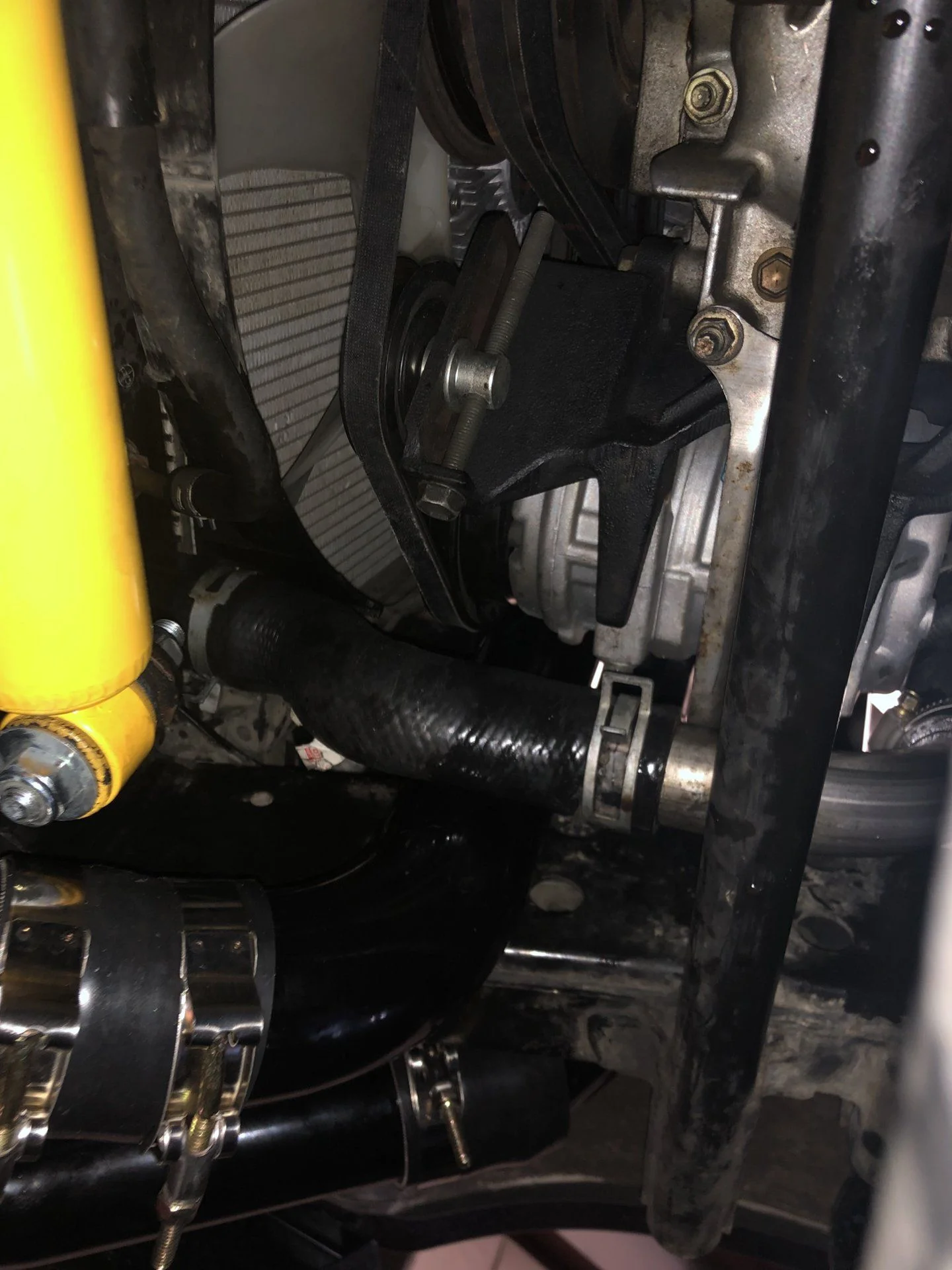

CXRAcing kit does fit rather nice and looks great black. The lower coolant line they send is useless along with the 90 degree silicone. Original hose and pipe works great to hold the intercooler piping away from the compressor.
A FEW PICS attached

Good to see another turbo attempt! I would watch that size turbo and going lean before closed loop.
With any used turbo, you might want to check balance and turbo shaft end play before your first start.

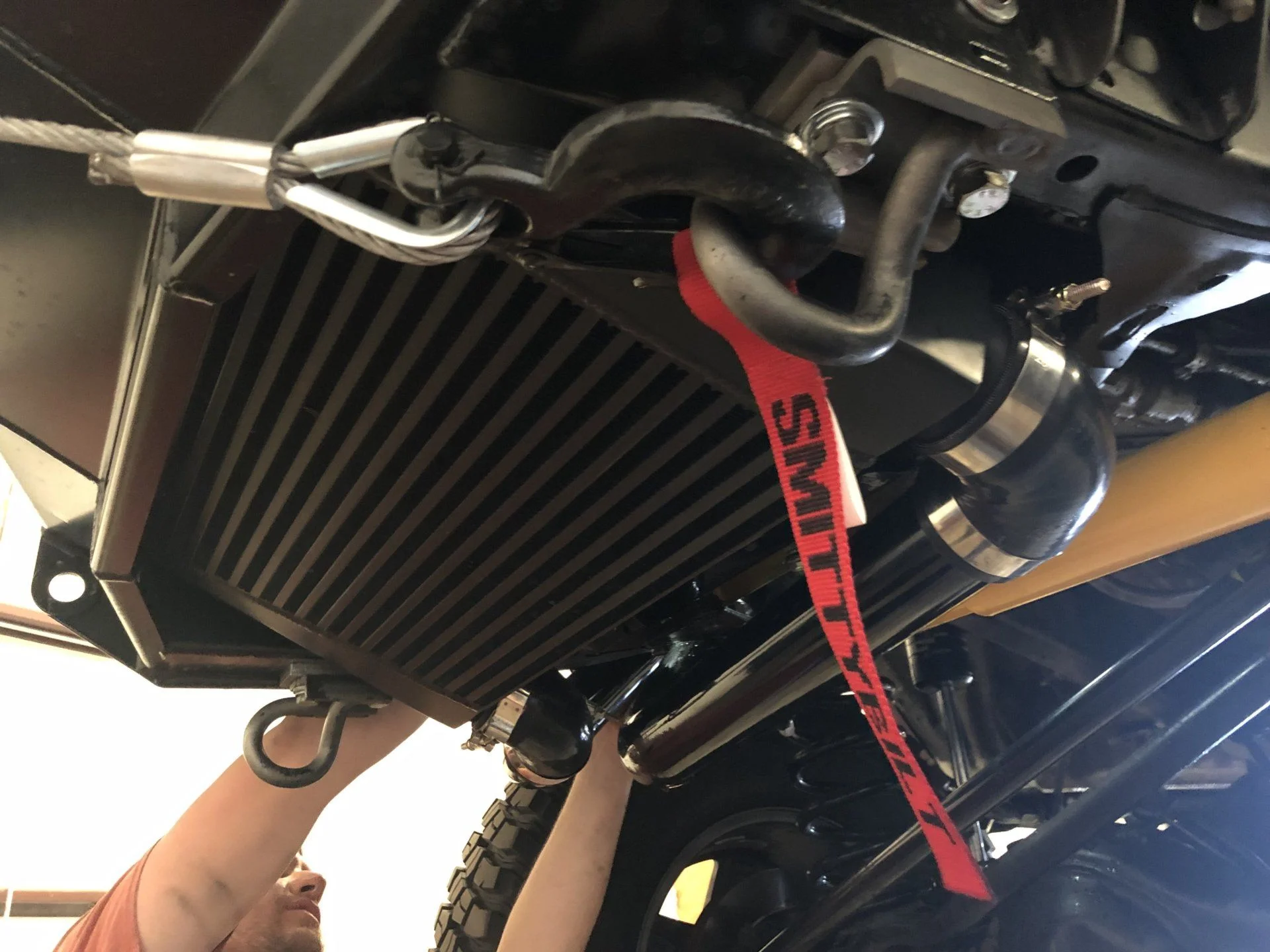

Also if you plan on doing any actual offroading I would have a custom pipe made-up to replace the intercooler when/if it gets punctured so you could just pull the intercooler put the pipe in place and carry on.
Not sure if you have some connections but some of those prices do not look like what most people would pay.
$300 for trans service and transgo shift kit install is a great deal.
$350 for a custom stainless steel turbo back exhaust is another crazy cheap deal. Usually a stainless exhaust with cat and mufflers is 4x that.

I love the manifold look and fit. I have had lots of turbo cars and chinese turbos are not going on my car. Truth be told 10 psi on a chinese turbo should hold up well. Theres nothing a like DBB Precision for spool and longevity.

Good job replacing the paperweight (err... turbo). Never liked the CX intercooler position, but if you're not poking any holes in your truck, it's about the best you can do I guess. I'd think about louvers and a fan to direct more air through it. @Cruzilla just did something like this with his A/W intercooler (puller fan on top):
Not sure 10psi with the stock computer/fuel setup will yield safe afr's (mine was spot on at 6psi), but only one way to find out I guess!

Problem of having IC low isn’t just damage, pavement and desert floor are really hot so the IC might not Uriel much cooling.
