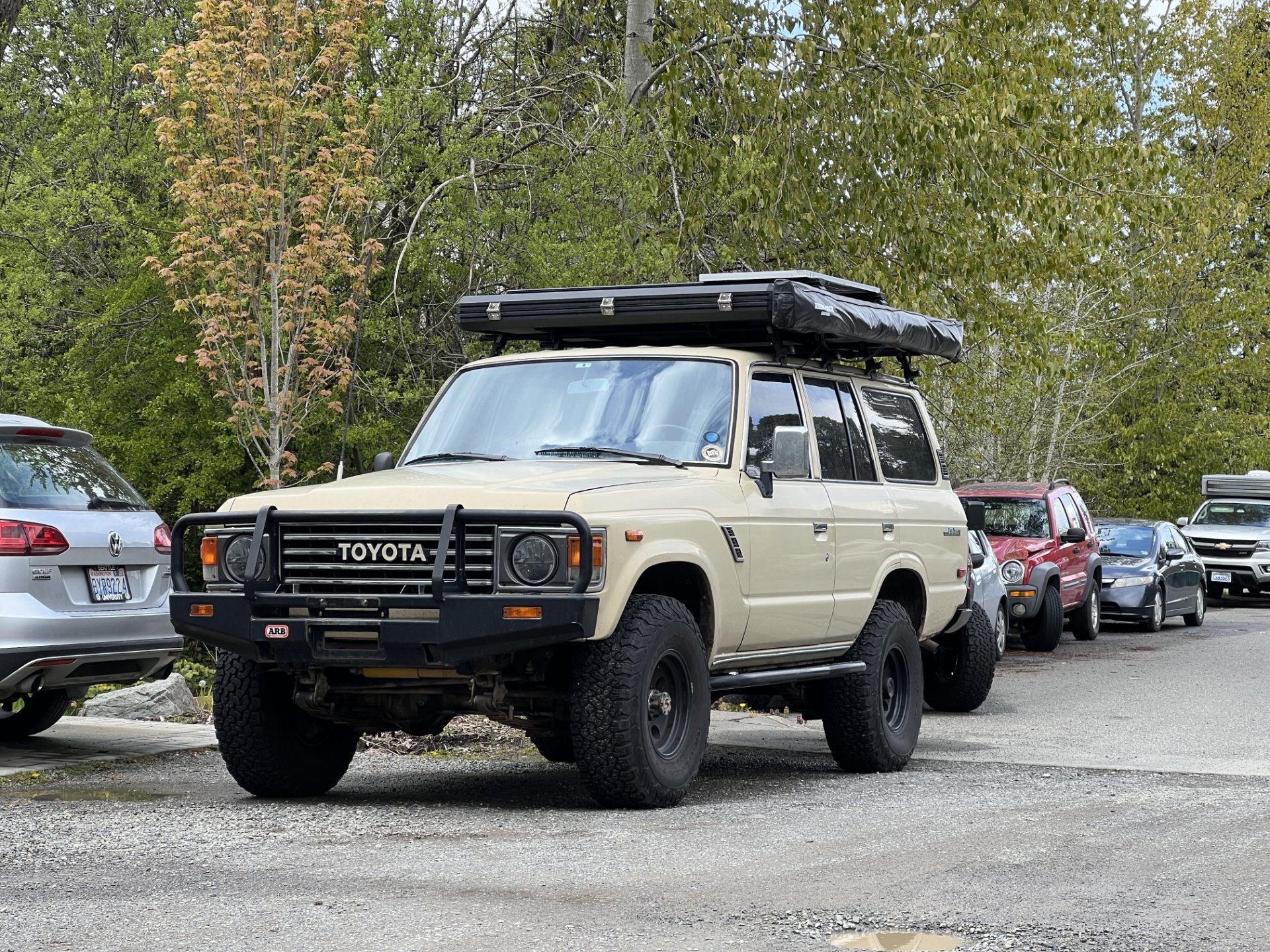

Hello everyone, I am quite proud to say that I am the new owner of Treebeard. I am planning on periodically updating this thread and leaning on the knowledge this forum has to offer. I feel quite fortunate that Nate has entrusted his project to me. We all know the difficulty of letting a project vehicle go, so thank you Nate, and best of luck with your future adventures.
This will be my first FJ60 or first Toyota for that matter. After stumbling across listings for 60s on Bring a Trailer, I fell in love. I impulsively sold my 2019 GTI and went shopping for an FJ60. The thorough documentation and apparent level of care found in this thread sold me on Treebeard. This vehicle will double as my adventure-mobile and daily driver. I realize daily driving a carbureted 300k+ mile vehicle in suburban Washington is not one of my wisest ideas.
