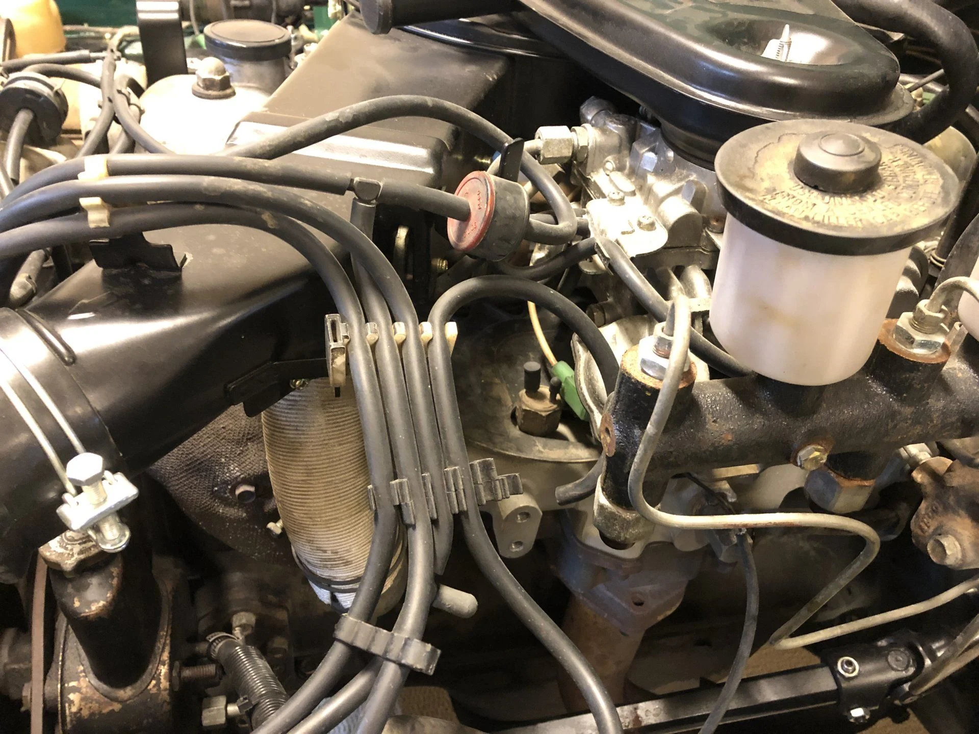

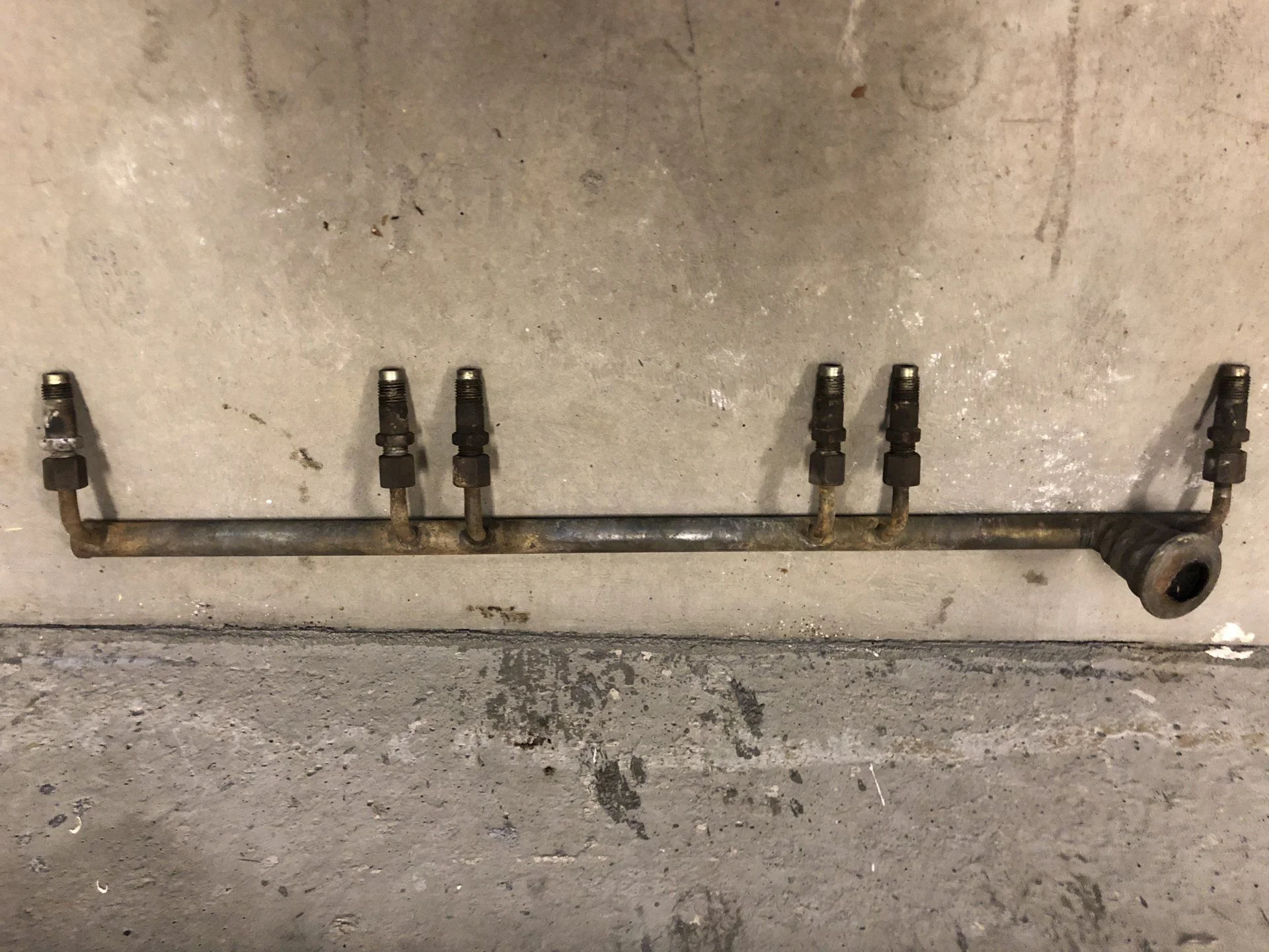

I decided to start where the PO left off by finishing the de-smogging. I looked it over and it appeared they did a pretty terrible job. The air rail was still hooked up but broken off and each of the 6 connections were only finger tight (I suppose it could have been worse). A myriad of vacuum hoses had been plugged or were left dangling and the EGR pipe connecting to the exhaust manifold was lose. The smog pump was long gone, thankfully replaced with a Sagnaw power steering pump.
I removed the air rail and plugged the holes with some pipe plugs I found at the local hardware store.
I removed the EGR system and welded the EGR tube closed.
I followed the directions for the vacuum routing procedures found here on MUD to make sense of the remaining lines. (Thank you everyone who posted information here, it was very helpful!)
I then drove it and it ran the same but somehow 10lbs of non functioning smog equipment made me feel like it drove slightly better. It certainly opened up the engine compartment so I could see and work much easier!

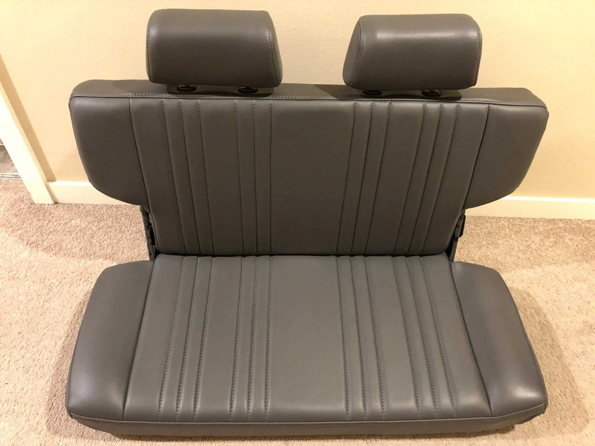

- Bestop Fold and Tumble seat - removed and sold. (original jump seats were included with the vehicle)

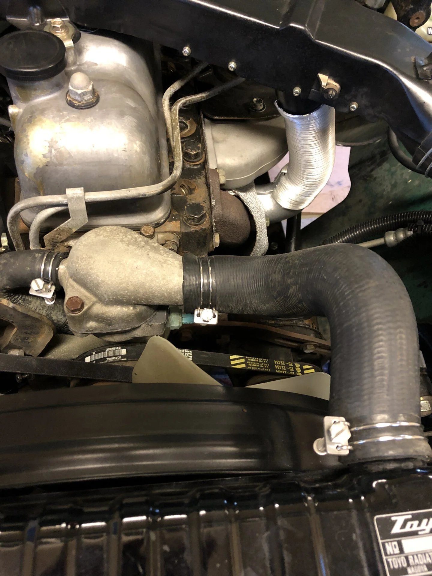

The hose from the valve cover to the air cleaner assembly (new looking) was bent in such a way that it was completely kinked and not possibly doing it's job of sucking out the vaporized oil. It can barely be seen in the top right of the picture. (pre de-smogging)
I ordered a new one along with a new PCV valve, hose and grommet. Installed all of these and it seemed like each time I looked at it, something else had to be replaced. I guess this is part of the fun.

As I mentioned before, the jump seats were included and I prefer the look of those over the fold and tumble seat that was installed, so I removed the seat covers, foam, strap and rubber bumpers. Then I sent the seat frames off to be sand blasted and powder coated along with the trans/xfer case skid plate. I'll be picking those items up later today. Pics to come soon.

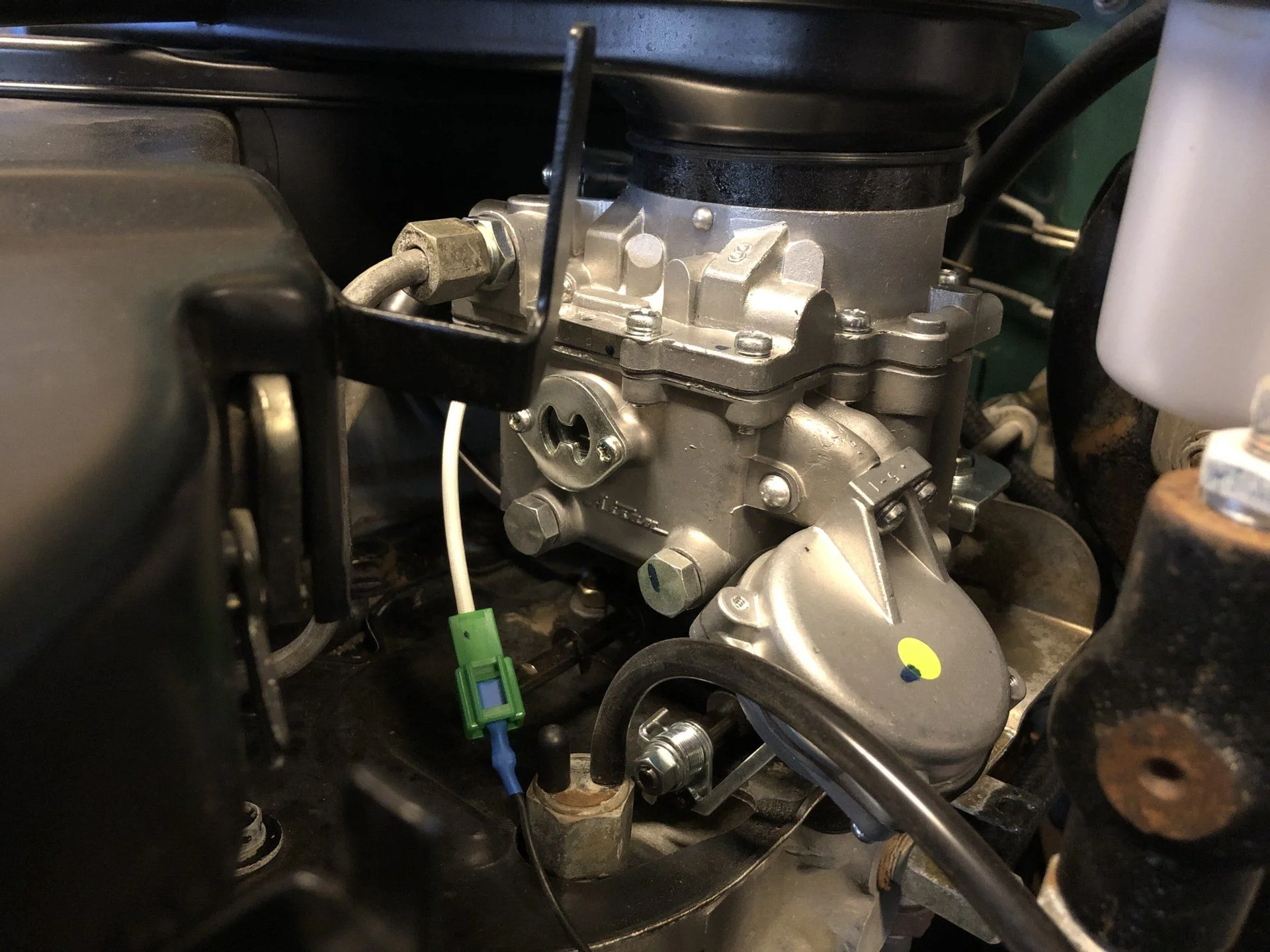

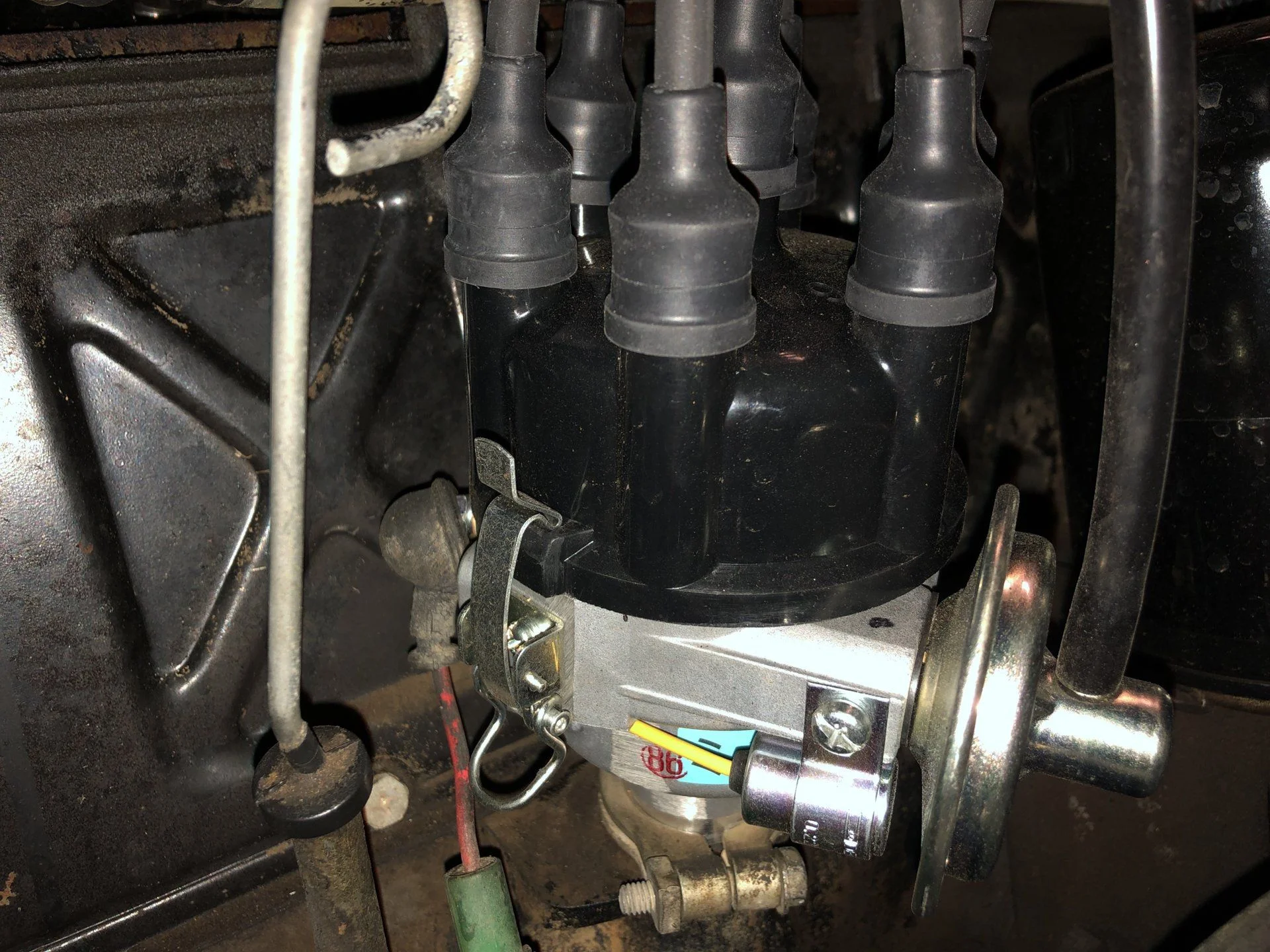

After spending some time driving this thing and looking at the various vendors recommended here on this site, I reached out to Roger from CityRacer and ordered a couple of key items.
- An OEM distributor for a de-smogged 2F
- An OEM de-smogged carb
These two items were considerably more expensive than all of the other parts I'd ordered but well worth it!
I first replaced the distributor and as I took out the old one, I noticed the vac advance or retard was screwed stationary. That could be why it pinged like a mofo on my test drives. I test drove it with the new distributor and it ran MUCH smoother! It idled better and seemed to have a touch more power. When I timed it I gave it a touch of advance and backed it off a bit until it quit pinging. What a difference that made! I have the old distributor if anyone wants to buy it... PM me.
I then set about the carb replacement. Super easy, unbolt, disconnect the fuel input and return line. Plug the return line. Install new choke cable ferrule and put a little spacer on the top so the air cleaner assembly fits. It started right up and I set the idle, took it for a spin and WOW! It runs so incredibly smooth and has an enormous amount of power increase, especially when the secondaries open up. Looking back after having this thing for about a month and doing various part replacements, this is without a doubt the best change I've made. I have the old one if anyone wants to buy it. I bet it would be a great candidate for a rebuild.... PM me.

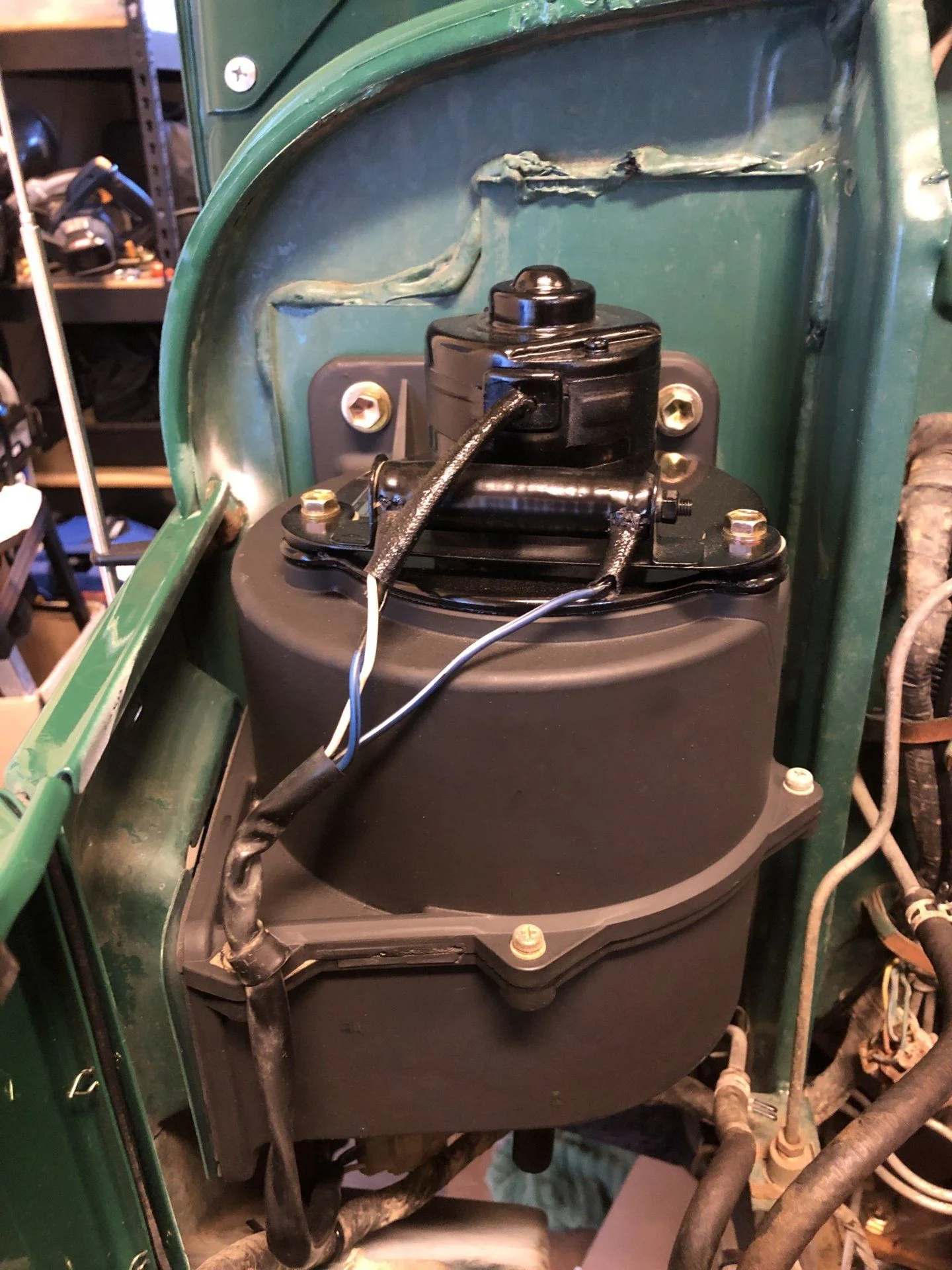

Along the lines of doing things that don't really matter... I removed the blower motor box, cleaned it up, painted it, installed new foam and put a sticker on it. I know it's not the right sticker but it looks nice. HA! The fan had TONS of 40 year old dust inside it, so cleaning that out was a bit of a chore but it sure does blow harder now and much quieter! Again, something the wife will appreciate, meaning we get to drive it more often.

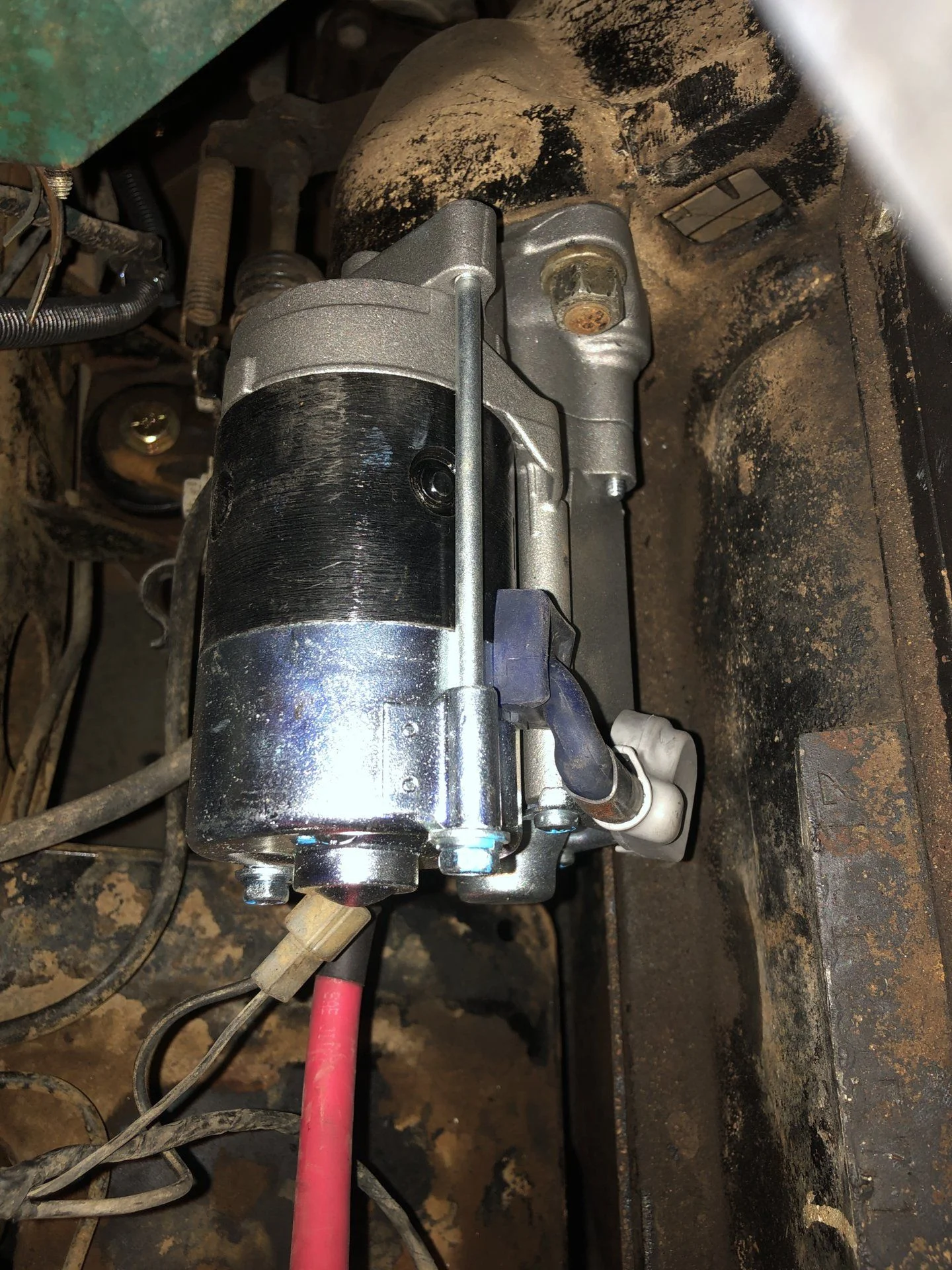

2- The starter needs to crank quite a bit to start this beast when it's warm. It's almost like it has vapor lock except I seriously doubt it does because the ambient temp was in the 50's. I previously had ordered a gear reduction starter from Cruiser Corps for about $150 and after spending 10 minutes installing it, problem solved. This is probably the 2nd best thing I've done so far. Now it starts after just bumping the key and I have another shiny part on this turd.
3- When we'd stop at stop lights the heater blower motor would slow down quite a bit. I noticed that on my initial drive home from Portland as well and suspected the alternator was showing it's age. So I ordered one on RockAuto for $50 (part number REM 14540) it took about 10 minutes to install it and as soon as I started the engine I could tell a difference. The blower motor blew so hard it spewed dust all over the cabin and the amp gauge didn't sag down as far at idle. I think it was only a matter of time before the old alternator completely failed... this new (rebuilt) one is so much more powerful!!
