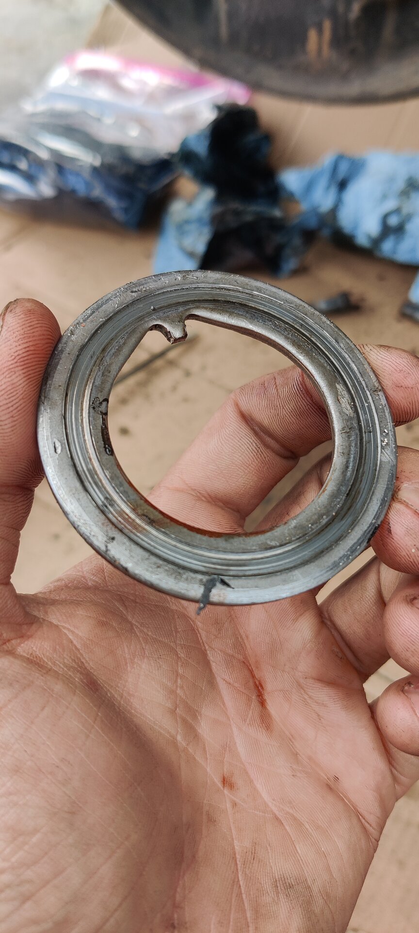

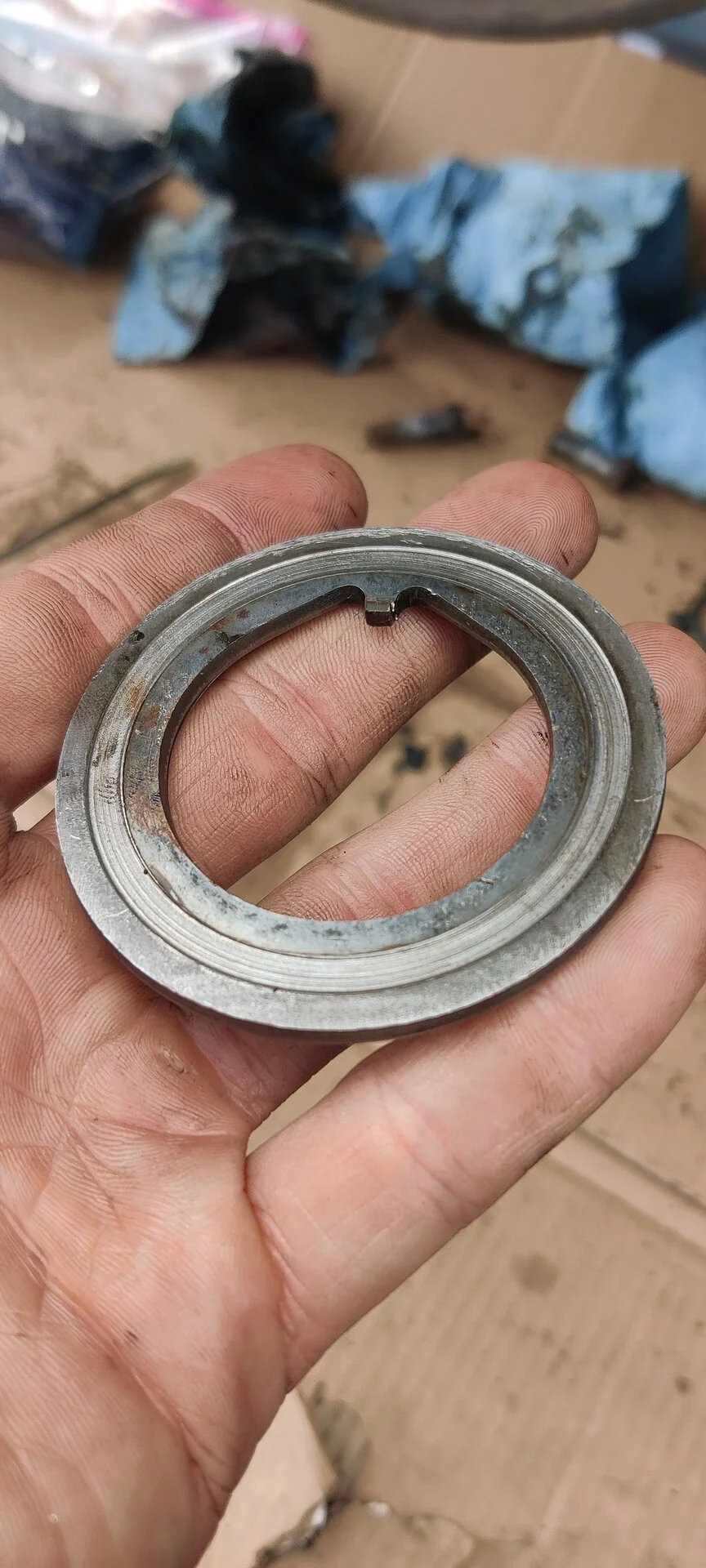

Question for y'all. Currently working on replacing wheel bearings, knuckle seals, and all the wonderful things that goes with that undertaking.
The thrust washer(?) Appears to have a fairly deep groove worn into it on both sides from the wheel bearing. Unfortunately the rebuild kit I bought from CruiserTech does not come with a replacement.
Will this be problematic to reassemble with the same washer? I know this would be less than ideal, but I've got to have this thing back on the road by Monday!

Check local dealership parts counters. Those aren’t so rare and there’s a chance you might find a couple.
@Berry , in a pinch i'd think that if you were to lap that on say 100 grit sandpaper on top of a pane of glass it could be run till you got replacements. just something to lose the ridges on the edges of those grooves. the pane glass is for flatness. or, have you got a buddy who runs a machine shop that could mill them flat? just my 2 cents :meh:
Or flip it over so the smooth side is against the wheel bearing .. wheel bearings must have been loose and spinning against the washer.
i read his post as both sides of one washer. you'd still want to lap that ridge off would you not? or am i thinking incorrectly
Yeah I'd do something with the messed up side and put the other side assuming it's flat. All this is all still in a pinch personally would be looking for a replacement.

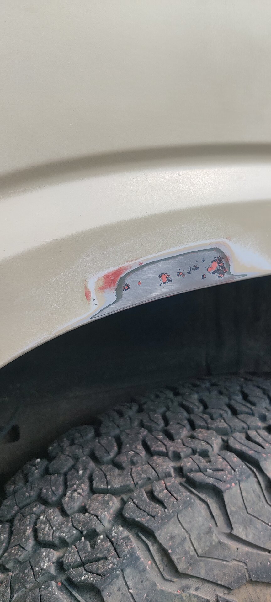

I’ve been slowly delving into treating the active rust on the truck. Exposing, sanding, applying Ospho (awesome stuff), priming, and painting can only get me so far. I will likely have to take the truck to a professional to address the frame.

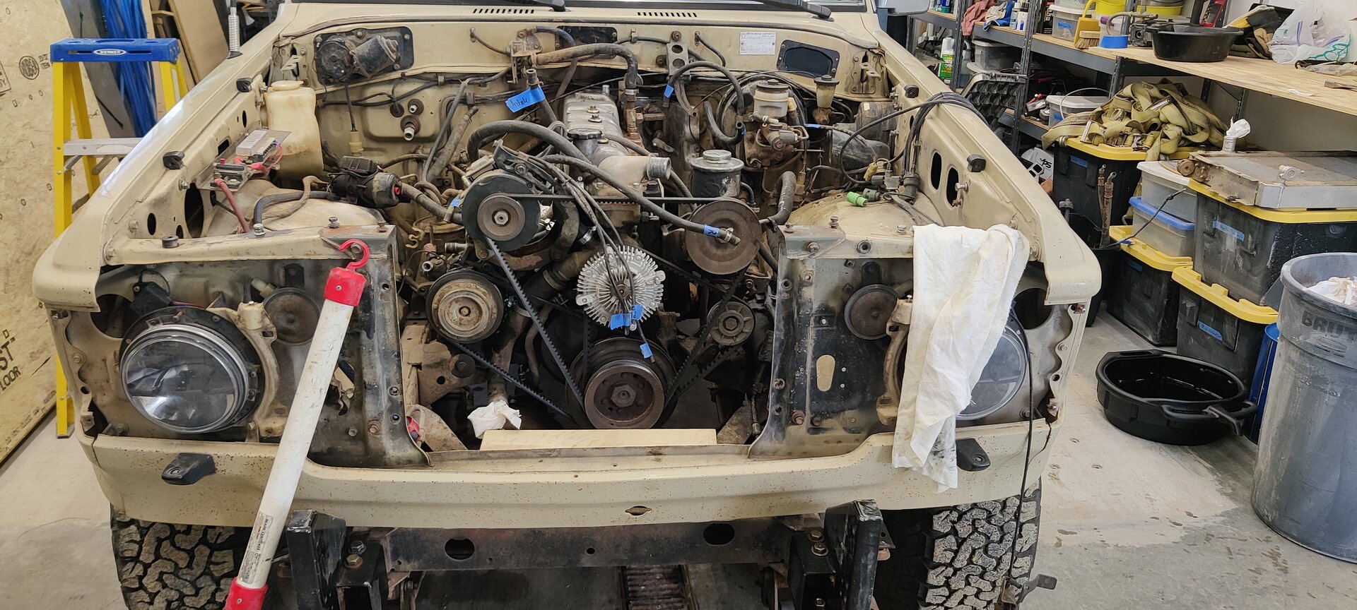

Long time no update.
My Cruiser now has a shop! I've done very little since my last update here, but now the fun part starts.
The engine, trans and transfer case are coming out within the next few days.
The 2F has developed a habit of producing white, coolant smelling smoke while idling after cold starts. Compression test results are as follows
1- 140
2- 130
3- 140
4- 140
5- 155
6- 160
Planning on a fresh head gasket, lap the valves, and perhapse rings.
The transmission is likely going to a professional for a rebuild. The transfer case also needs to be rebuilt as it leaks EVERYWHERE. Hopefully I'll be able to tackle that job personally.

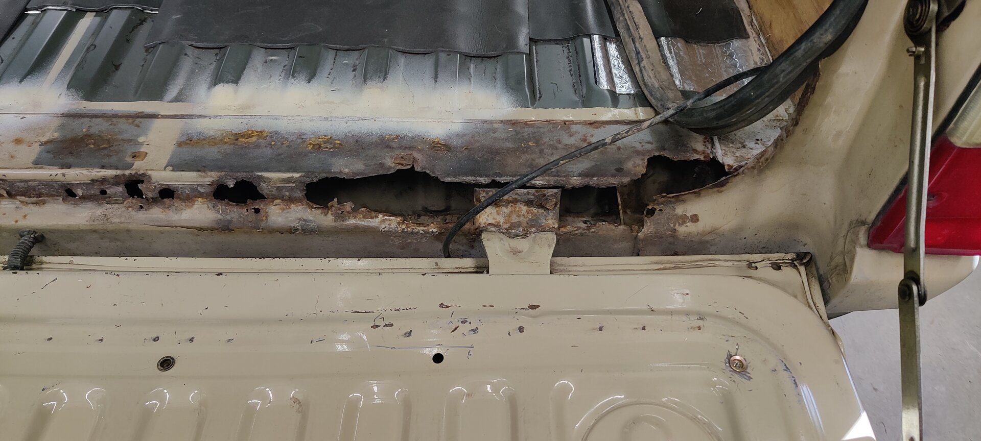

Additionally, rust abatement is a large priority with this job. The radiatior support has corrosion, the frame needs to be cleaned, painted, and sealed. The largest rust location is the rear trunk sill.
Luckily, I have a rust-free sill to replace it with (thanks Nate) and a buddy who works in auto body to advise.
A few questions,
- Is removing the accessory drive before the engine beneficial?
- Should the drivetrain be removed together or separate?
- Are there other maintenance tasks I should consider along the way?
Let me know what you think!

My thoughts on the following:
Removing the accessories makes it easier to get the engine out without the accessories hitting the radiator mount. the accessories are probably the widest part of the engine
I think separate is easier. Makes the hoist easier to move around without the transmission and transfer case bumping into the front axle or hitting the front valance. Its only four bolts to separate the transmission from the engine. It can also be hard to remove the front drive shaft with the engine in place. I did engine first, driveshafts next, transmission/transfercase last
I have the engine and transfer case and driveshafts all out of my truck now. I am putting in new brake hoses (and master cylinder/booster), new clutch slave cylinder, new heater hoses and fuel hoses--basically as much new rubber as possible since its easy to access at this point. I'll probably do new brake wheel cylinders and shoes and pads before I start driving the truck again. If you want new carpet and seat covers, now is good time since its easier to remove the carpet to get the transmission and transfer case out. Also, check your climate control parts like heater core and ac evaporator. These trucks need a lot of work at their age, so whatever time, patience, and funds allow you to do, I would say go for it, then you wont have to worry about it for the rest of your life.
