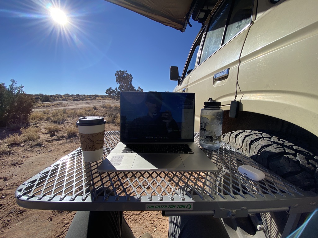

The WeBoost has proven itself. I was able to work from campsites for most of the week and I'm looking forward to doing more of it in slightly warmer weather.

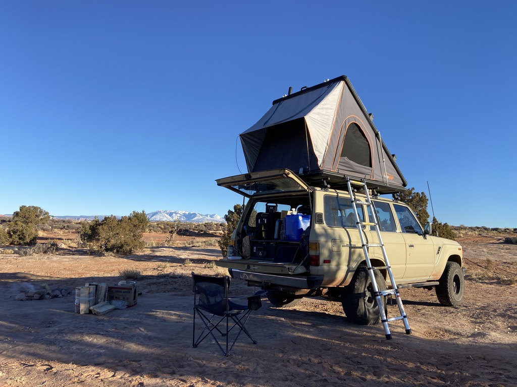

I'm also loving the Roofnest Falcon XL. Setup and breakdown is super easy and the mattress is comfy. I'm thinking about ways to get it mounted a bit lower. A full platform rack could do the trick but it's hard to justify the cost when it's really just a mounting solution for the giant tent.
I haven't gotten to properly test the awning yet. I set it up on rocky BLM land just long enough to break the hinges in a gust of wind. It was stupid, I should have anchored the legs somehow. Thankfully the hinges are designed to break to protect the rest of the awning and I had spares so it's good to go again.

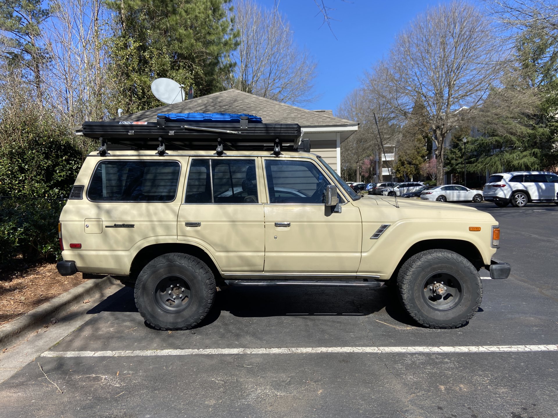

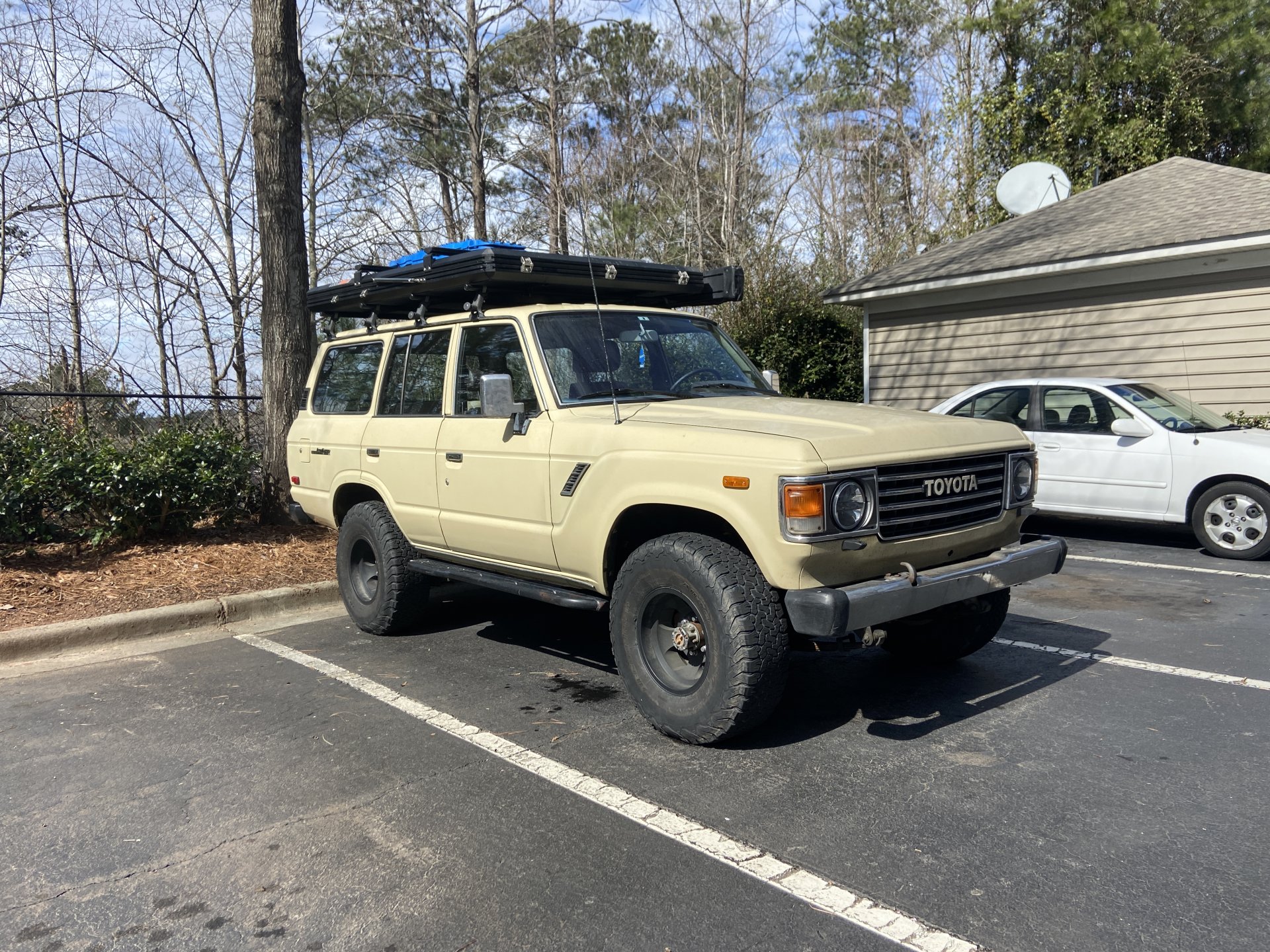

I finally got the windows tinted! I agonized over how dark I should go and ultimately settled on 3M Color Stable 35% VLT. Honestly... it does look a little dark for my tastes from a purely aesthetic perspective. The heat reduction is already noticeable and visibility from the inside is great so ultimately I think it's worth it.

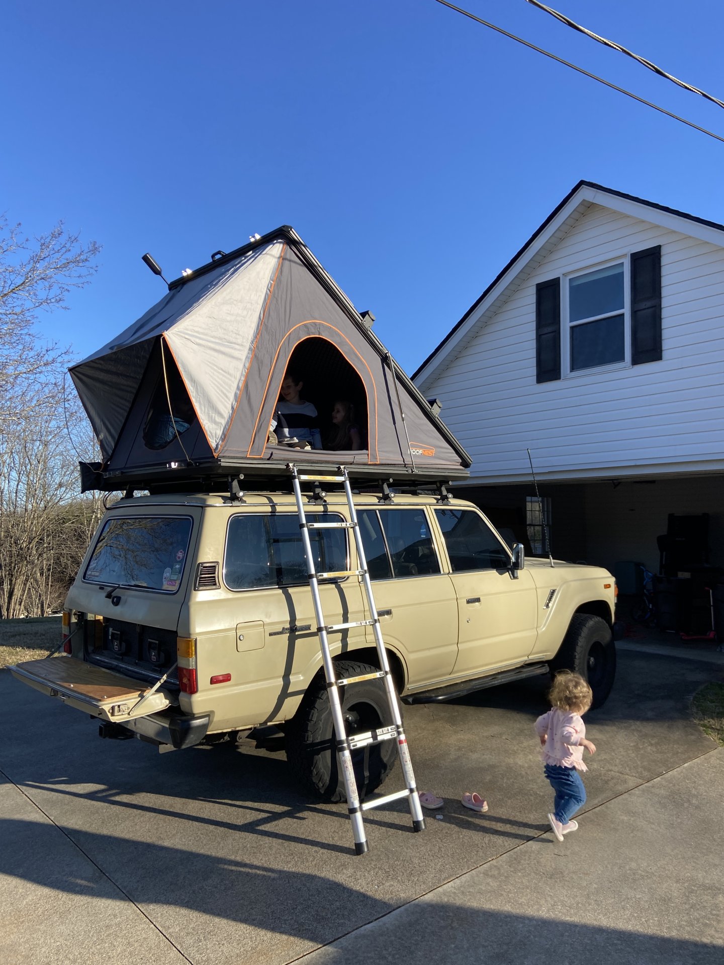

Yesterday I introduced my nephew and nieces to the tent. They loved it and took a lot of convincing to come down.

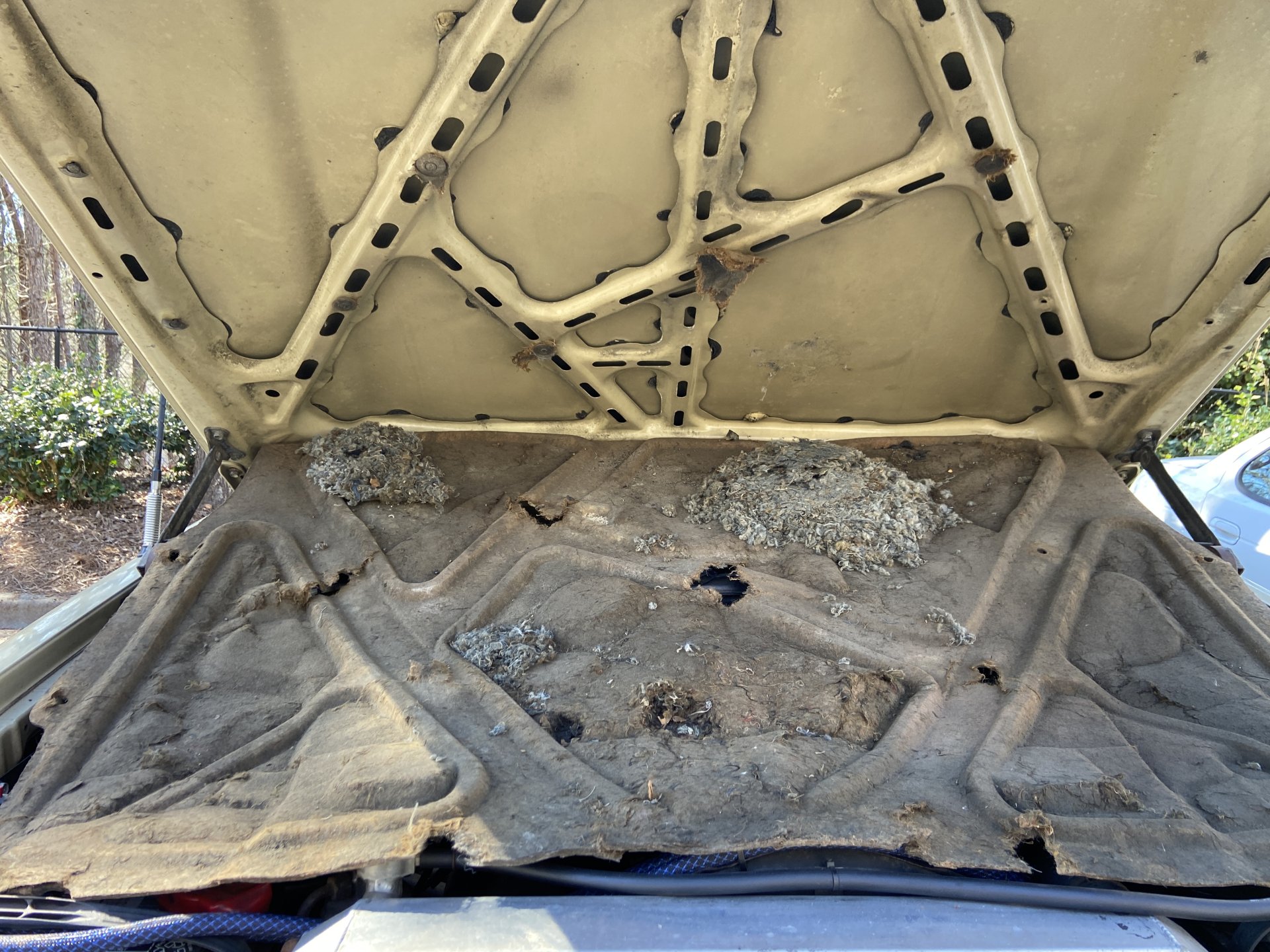

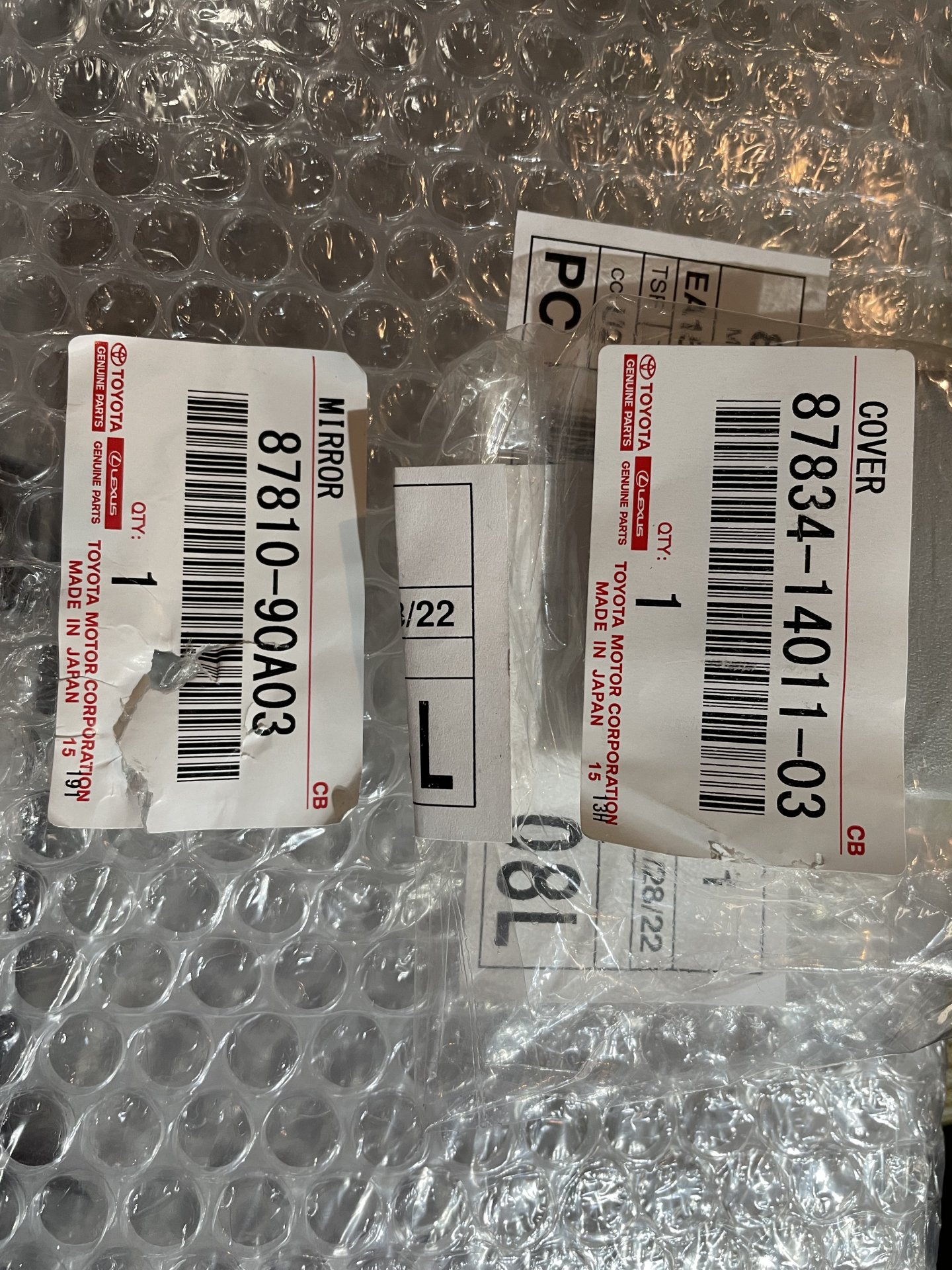

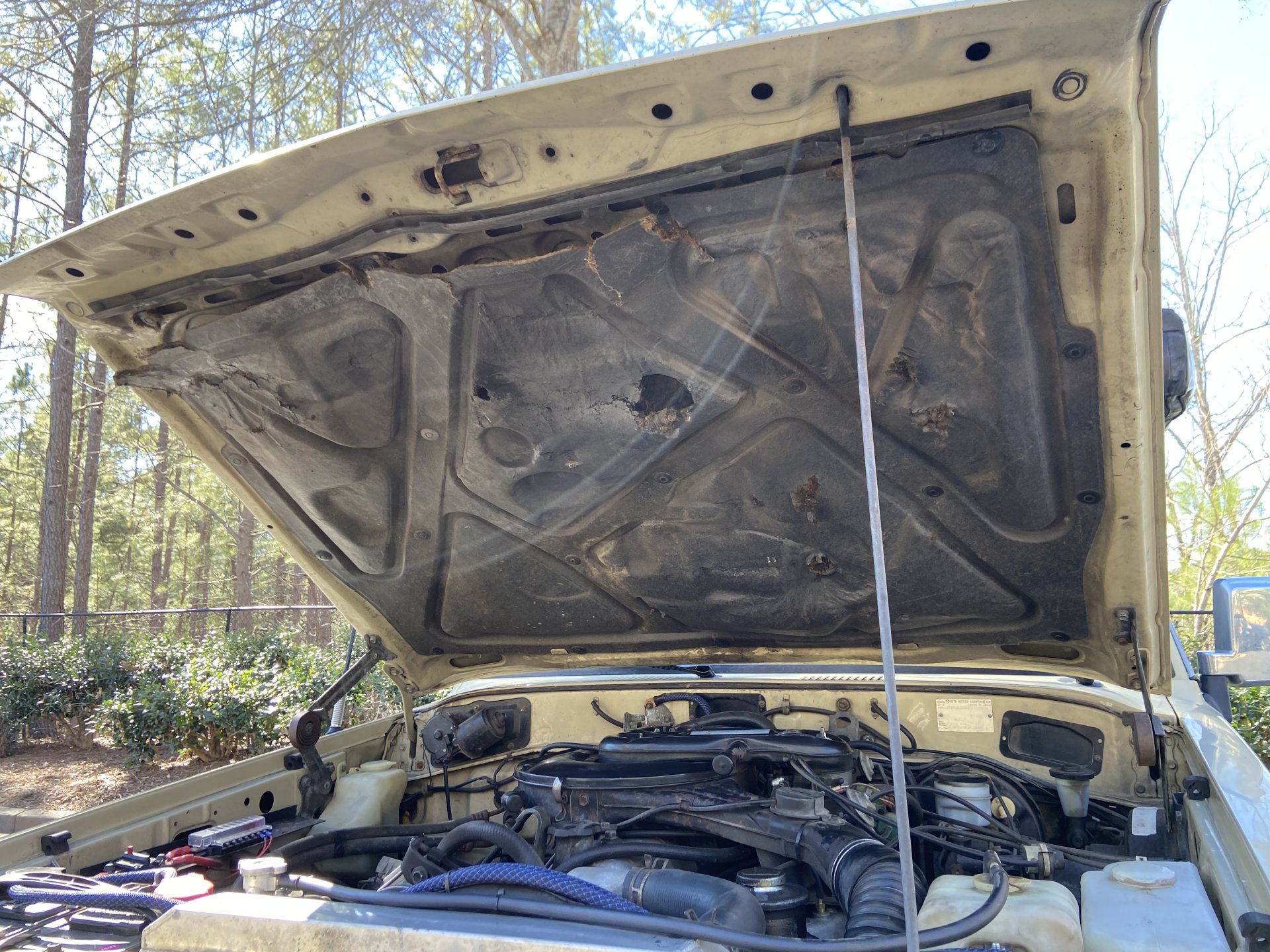

Today I spent a while outside with a bottle of simple green and some shop rags. Got lots of dirt out of the tailgate area and the engine bay. I also ripped out the hood insulator and cleaned up under there. It was lovely. I ordered a new hood insulator, clips, and a new OEM rear view mirror from Toyota. I don’t need anything fancy, just a mirror that isn’t turning into dust from 40 years of UV blasting.
Did you get the insulation clips from Toyota?
Yep! I also like the idea of adding some butyl under the insulation. Gotta see if I can order just a small amount.
I'd give you some.
My structural supports have broke loose of the sheet metal. I need to glue them back. I didn't have fresh clips so I put it off.
I'd give you some.
Ah shoot, mine are loose too. Time to research that project… if I don’t install the insulator before I hit the road again I may take you up on that offer, thanks!
If I recall correctly, @Cruiser Cult did a quick 'how to' on the hoodliner replacement and gluing the ribs. It was one of their Saturday tech tips. It was @NookShneer doing the work on Fitz.
Mine were detached as well so I asked Kelly glue them when the Bean was being worked on. I think he used a 2 part epoxy seam sealer?

Well that's cool, didn't know rear view mirrors were still available. Thought we had to rely on 4Runner or fj80 mirrors for replacements.
Just put a new one in mine....
70 series side mirrors are another nice option from a visibility standpoint.
And I forgot to mention, if you add a small piece of vacuum line to the nub on the rear view mirror mounting arm to lightly wedge it against the windshield it acts like the OEM rubber damper that is NLA from Toyota.
