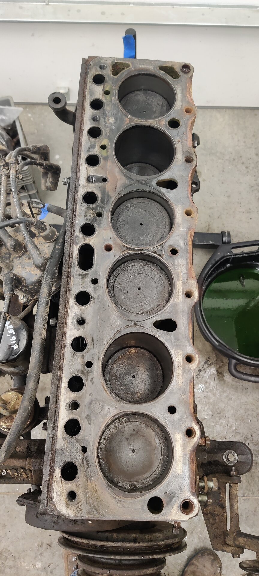

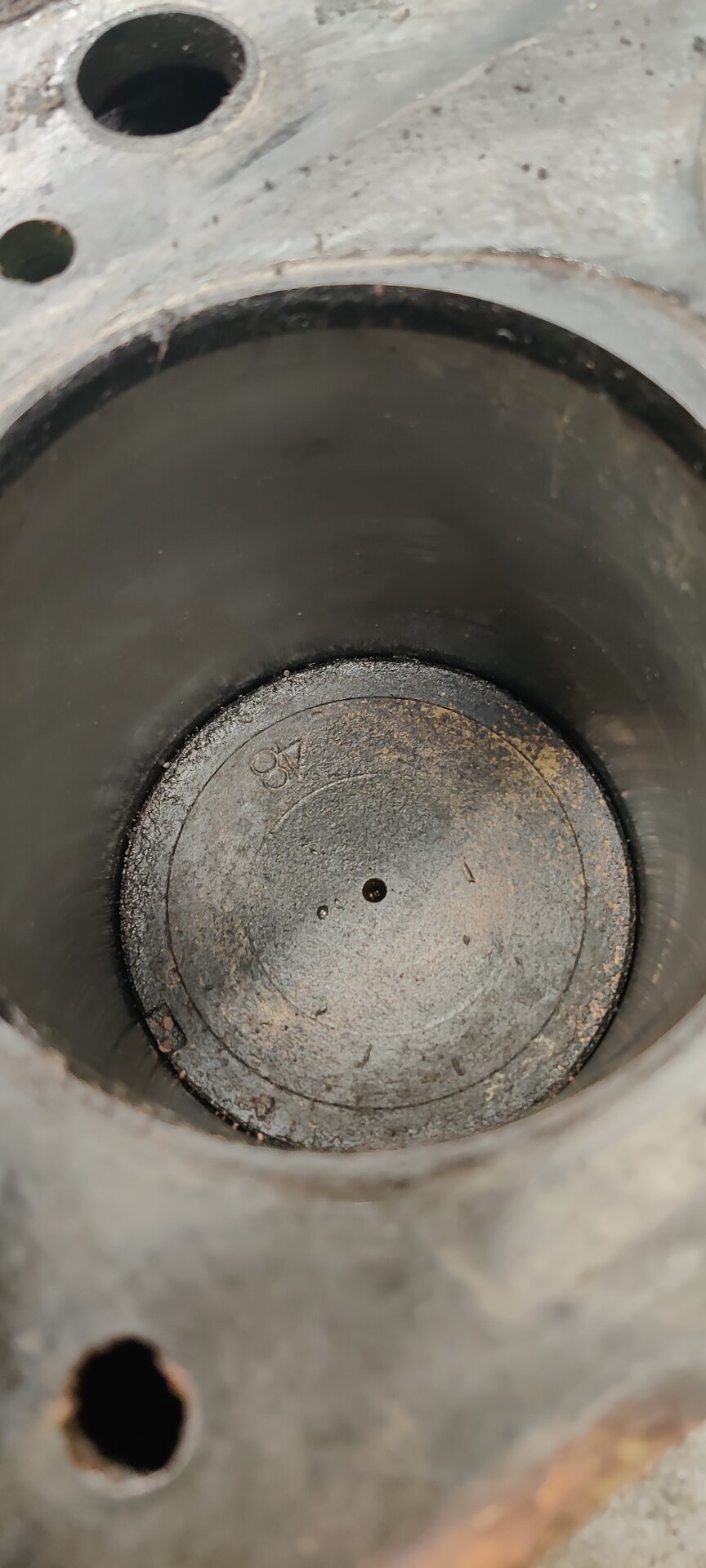

Once the head is stripped and clean it's off to the machine shop. The cylinder bores are shiny and bright, no scratches or putting. Was not expecting any issues, but there have been few surprises.
Should rings be a priority? See above for my compression figures.

I wouldn’t touch the rings. Compression numbers over 120 are pretty solid on these old 2F’s. Slap a Toyota head gasket on it and get the head checked out rebuilt if needed and call it good.

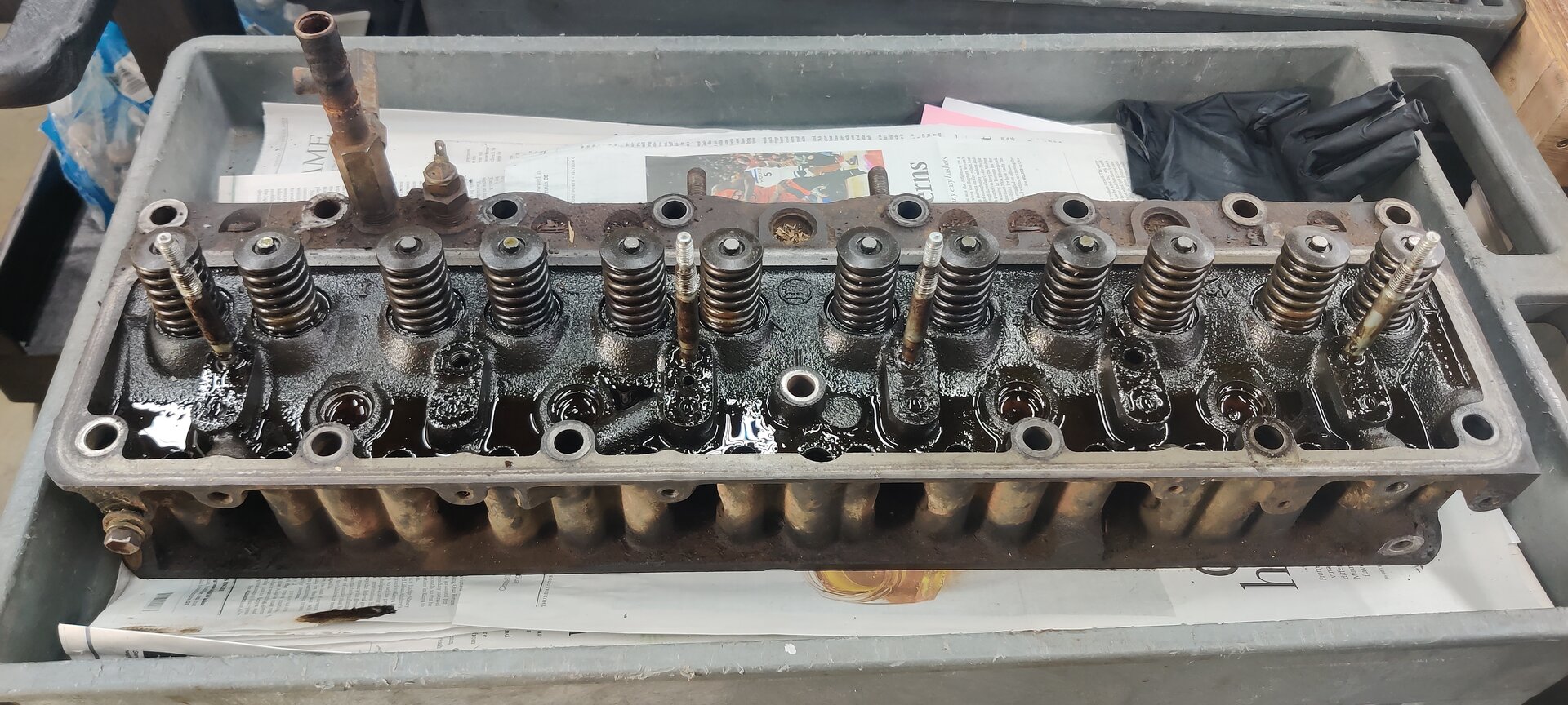

Got the call from my machinist, and the 5th cylinder has a substantial crack. This would probably explain how coolant was winding up in the exhaust with an intact head gasket. If anyone has a lead on a 61040 head, I'll happily buy either built or a core.

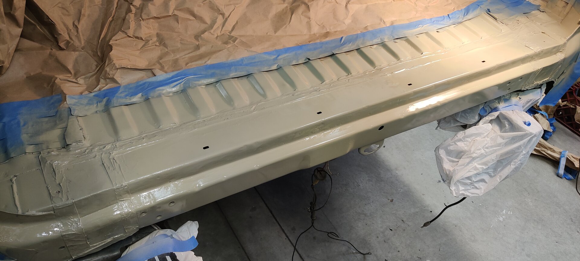

My trunk sill has been cut out and grafted with fresh metal. Seam sealer, primer and paint all went on yesterday. For a first attempt at body work, I'm fairly pleased with the result.

@Berry I’ll probably have a 61040 head for sale in a couple months. I’m about to send a spare 2F off to the machine shop and I’m gonna try to get installed ASAP when it’s back. I’d have the current head magnafluxed first. Not sure if you can wait that long though.
I appreciate the offer, but ideally I'd like to have this thing thrown back together by early April. Thank you though!
I've found a welder who claims he may be able to save my head. To be determined. Does anyone have a source for valves and such other than SOR?

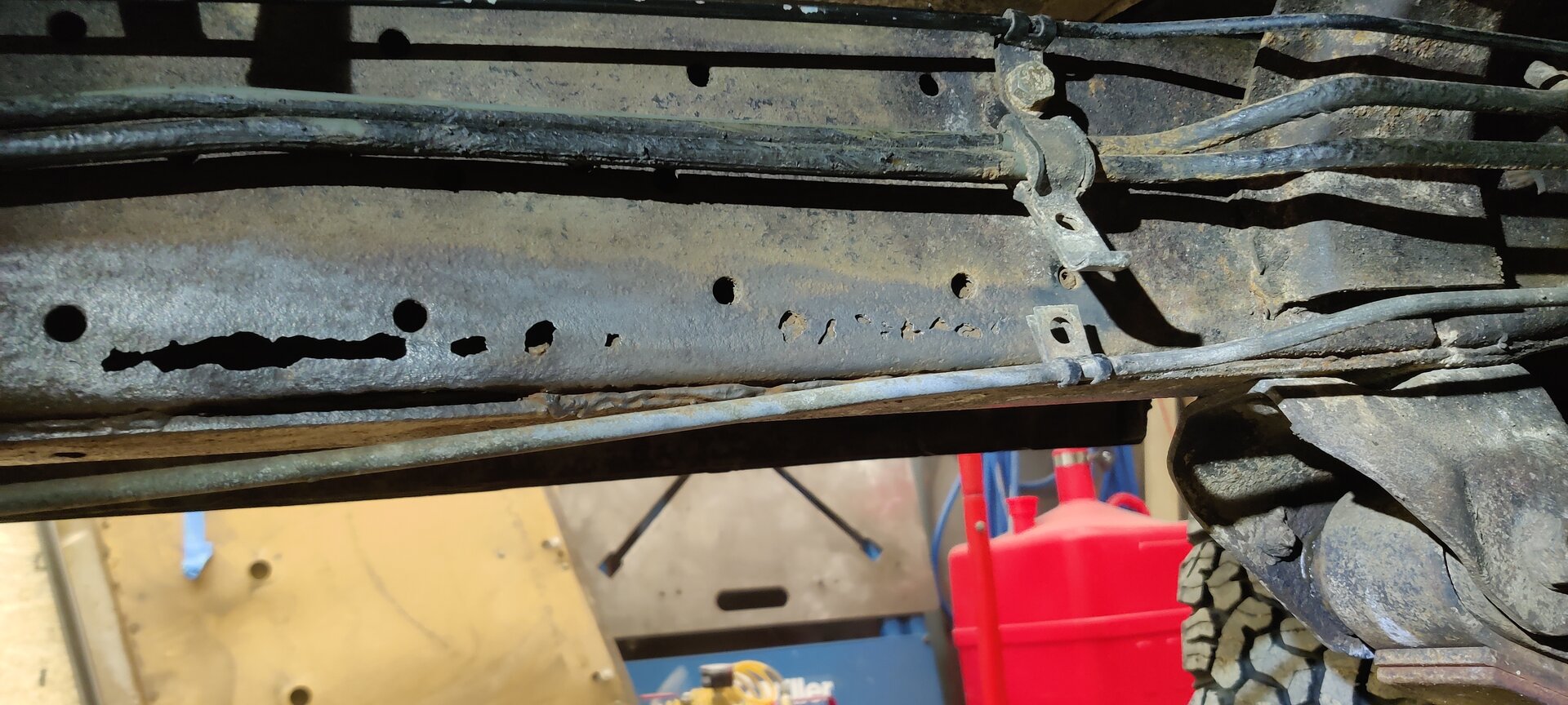

To be brutally honest, this truck either needs a new frame or immediate preservation of what is left. At the moment, I'm opting to wring the most life I can out of the current frame. A few inner wheel wells, cab corners, and cab seams are also beginning to rust through. As far as the cab is concerned, I'll chase out whatever I can with a wire wheel and touch up the paint. It won't look perfect but hopefully the cab will survive.
As far as the frame, how aggressive should I chase rust? Do I wire wheel everything I can see? Or do I scrub, rust convert, and paint as it sits? Any input would be helpful. More pictures momentarily.
Good news! My head has been welded, cut down, flame sprayed, new seats pressed, and even passed a pressure test!

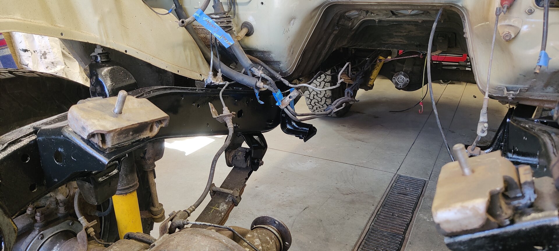

Wrapped up the frame weld/grind/coat portion of this refresh earlier this week.
- New Trail Tailor C-Channels
- Patched a thin section beneath the rear passenger door
- Frame entirely wire wheeled and ground bare
- POR-15
Trail Tailor C-Channels have perfect fitment. Trimmed up two bolt holes, fit like a dream. Covered as much of the frame as possible with a heavy layer of POR. Set nicely without running (too much). Thankful to be done with the frame. Will coat the underside of the body within the next few days. My goal is to have Treebeard back on the road by May. As soon as valve springs arrive, my head can get reassembled with brand new springs, valves, seats, seals, and head gasket.

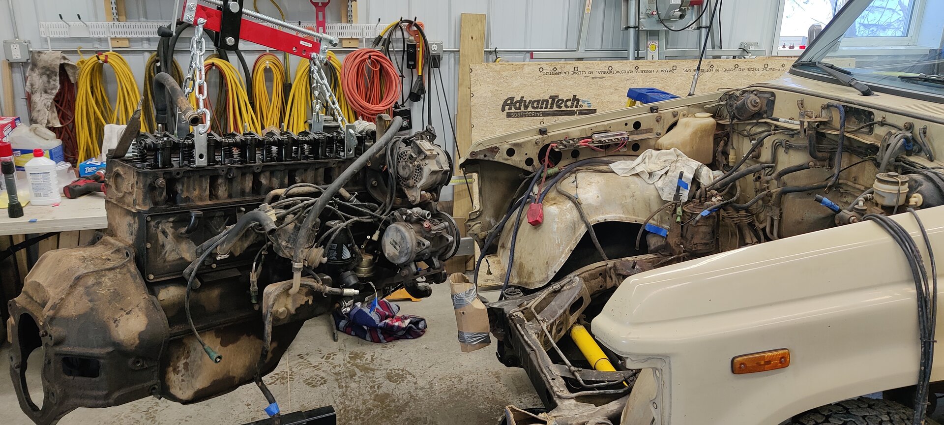

Installed the engine/new trans/rebuilt transfer case with a few buddies today, the gantry crane was huge here. I can't imagine the PITA of doing this with an engine hoist.
I'll post pictures later, but the old clutch was SHOT. Same with the throw-out bearing and every oil seal in sight. Resurfaced the flywheel, Cruiser Outfitters clutch and bearing, 'new' H42D, and rebuilt t-case with another Cruiser kit all installed.
