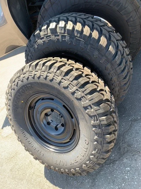

Some 285 75 r16 ordered

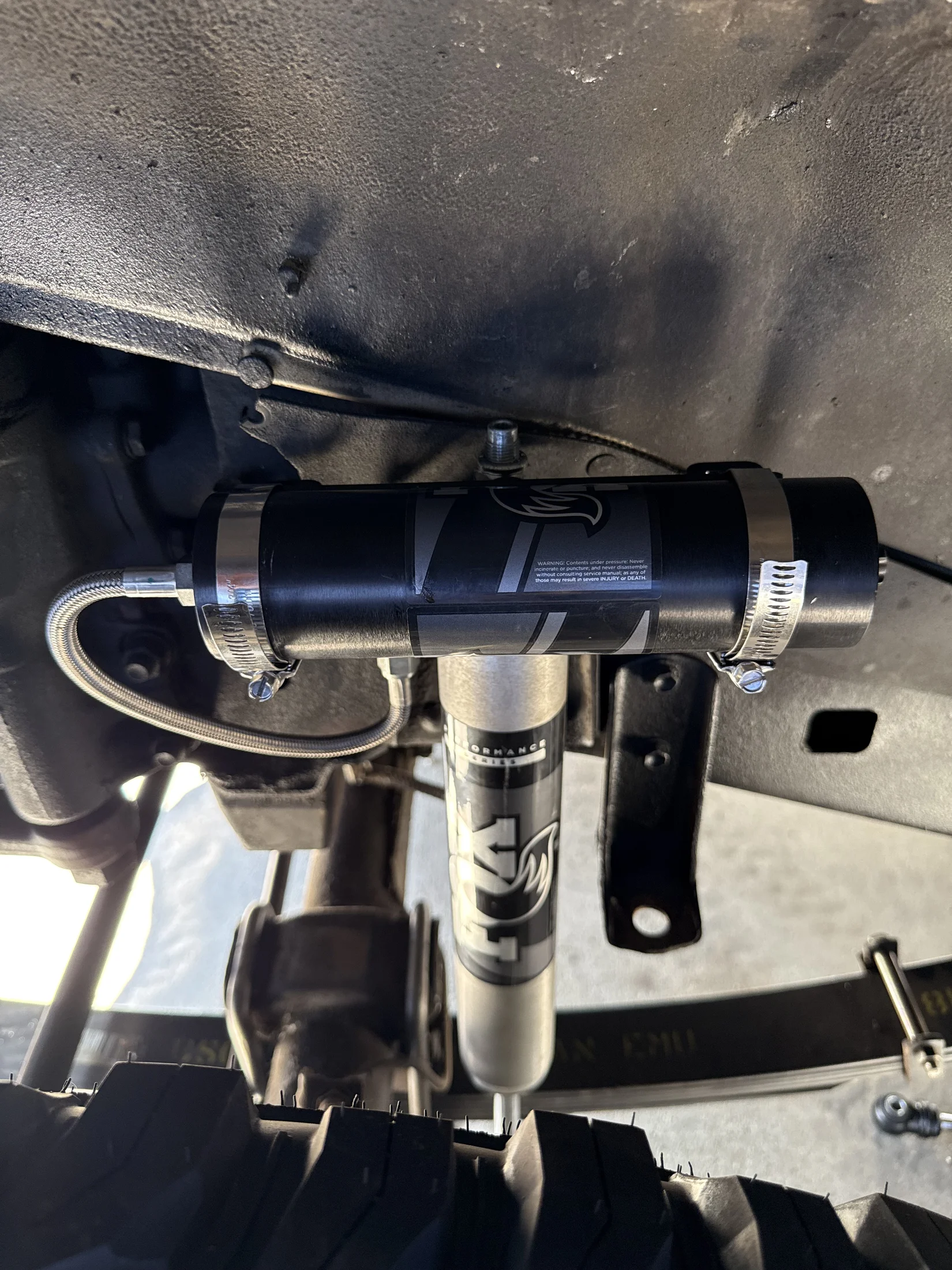

found some nice 2.5 Fox shocks with resi and adjusters for the front now on the hunt for some deals for rear shocks and front leafs.

Question has anyone ran a Fox or king 2.5 with adjustable resi or just a straight 2.5 size shock. ? Would love to make it ride smooth and it would just be a little bit more of an upgrade from a 2.0 smooth body.
Found some nice new Fox 2.5s for 800$ so wanna make I different.

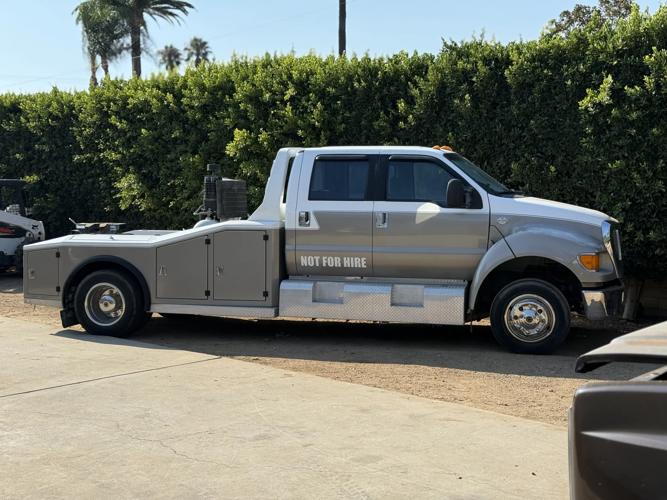

Picked up a new haul rig too a month ago check this sweet cowboy Cadillac out. FORD F650 cat 3126B with Allison 2500 trans 4:11 gears full king ranch package. Been chasing this over the last 2 yrs and finally scored it. Some fresh alcoas and 265/55r19.5 next for the 🇺🇸 MAGAHLR 🇺🇸
Picked up a new haul rig too a month ago check this sweet cowboy Cadillac out. FORD F650 cat 3126B with Allison 2500 trans 4:11 gears full king ranch package. Been chasing this over the last 2 yrs and finally scored it. Some fresh alcoas and 265/55r19.5 next for the 🇺🇸 MAGAHLR 🇺🇸View attachment 3976279
Man, you find them... Love seeing it all 🤙
found a nice set of Fox super duty shocks that are going to work nicely with the lift springs for the front.
Fox 2.0 remote reservoir (985-26-162)
