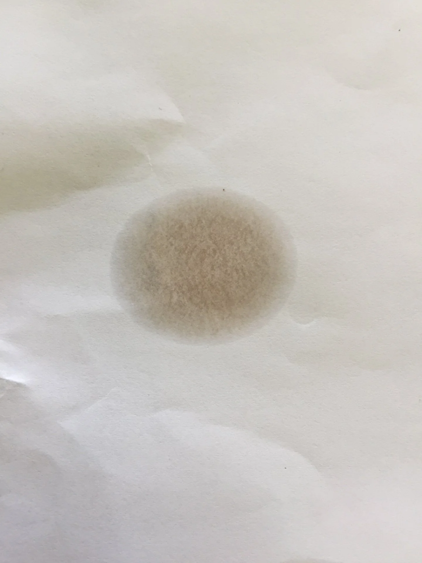

What does this tell you?
Looks old to me. Should be pink (good) or reddish (ok). Brown typically means it's time to change.

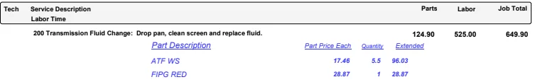

Hoping to take mine in for a transmission fluid exchange...this is a very well known shop in ATL and surprised by the quote... Am I justified in being surprised or is $500+ the going rate for labor?

Regardless I wouldn’t pay that much for a trans exchange on my 200, that seems really high. The 200 takes what like 14qts @ ~$12/qt = $170 for fluid + $30 for the FIPG. So if you were to do it yourself it’d be around $200 plus the pain of scraping off the old FIPG to clean up the mating surfaces. The screen is easy to clean. Also, if you are wanting a full fluid exchange I don’t know why they only quoted you for 5.5qts...
Why are you having them pull the transmission pan?
BTW: starting in 2003 (IIRC) the pan began use of gasket, not FIPG. Pulling and resealing a pan with FIPG (98-02) is much more labor intensive, than just a gasket.
When I first bought my 2005, I took it to an independent Toyota shop here in ATL to have fluid exchanged. That was using the BG Machine. I think the price was around $230 $329.95 for that service. Agree that anything over $300 is excessive.
EDIT: I went back and looked up the price I was charged for the BG Transfluid Exchange on my LC it was $329 back in late 2015.
Now that I do my own work, the DIY method of disconnecting at trans cooler is simple and cost effective. On A750 transmissions calling for WS, If you dont have a line on Toyota WS for under $7.50 a quart, the AISIN WS is suitable alternate and around $5.80 a quart on rock auto. If you buy two 12 bottle cases you’ll have extra left over for quick refresh drain & fill down the road.
Handy and will do a diff and oil changes etc but wanted to not mess with such an important part of the vehicle. I asked for a fluid change and this was the quote sent over. What should the ask be? This quote was from a very reputable to IH8MUD shop so unsure if I asked for the wrong thing or if the price is just expensive. Thank you all for the assistance and kindness when posting on a 100 forum for my 200!
It would be helpful if you disclosed a little info on your rig. Year, miles, previous and intended use (DD, offload, tow, etc).
You need to speak with the shop. But that is not a full 12 qt flush. It is a pan drop and clean (on a 200 series). Which is not a bad idea, just not usually necessary. They only have 5.5 qts in estimate. That is a "long drain" & fill or pan drop. Note: "long drain" letting transmission drain overnight will yield more. In just a quick drain of ~5 min., we get about 2.5 qts in from the 100 series.
I feel any shop that takes the time, space and capital carry cost to stock the fluid/parts for customer, needs to mark-up the prices. But $17.46 is a hefty mark-up. See market prices for: M1 MV ATF, which can be used 98-2002. Toyota IV ATF in 2003. Toyota WS ATF for 04 an u.
FIPG was used up to 2002 IIRC. After that it's a gaskets for pan to body of transmission. To my knowledge Toyota does not recommend use of FIPG on a pan gasket. Could be this shops likes to for some reason, IDK. But they do not show gasket.
I just helped a local with his 2005, do his transmission full 12 qts flush. I estimated 2 hours. It took closer to 5 hr. 5 hrs seems excessive right and it was. Well we needed too:

So again; speak with the shop!
