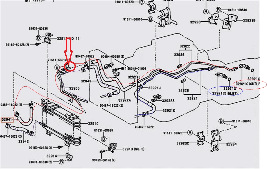

I've read all the transmission threads I could find to change my fluid on an 2006 LX. I am still confused as to which hose to unplug, and where I should put the hose extension to drain the fluid. People refer to outlet/inlet but its not clear what diagram they may be referencing aka if its outlet from tranny or tranny cooler. On this attached picture do I remove the top hose(red line) from the transmission cooler and attach a drain hose from the transmission cooler(where I removed the hose) to my dirty drain bucket?

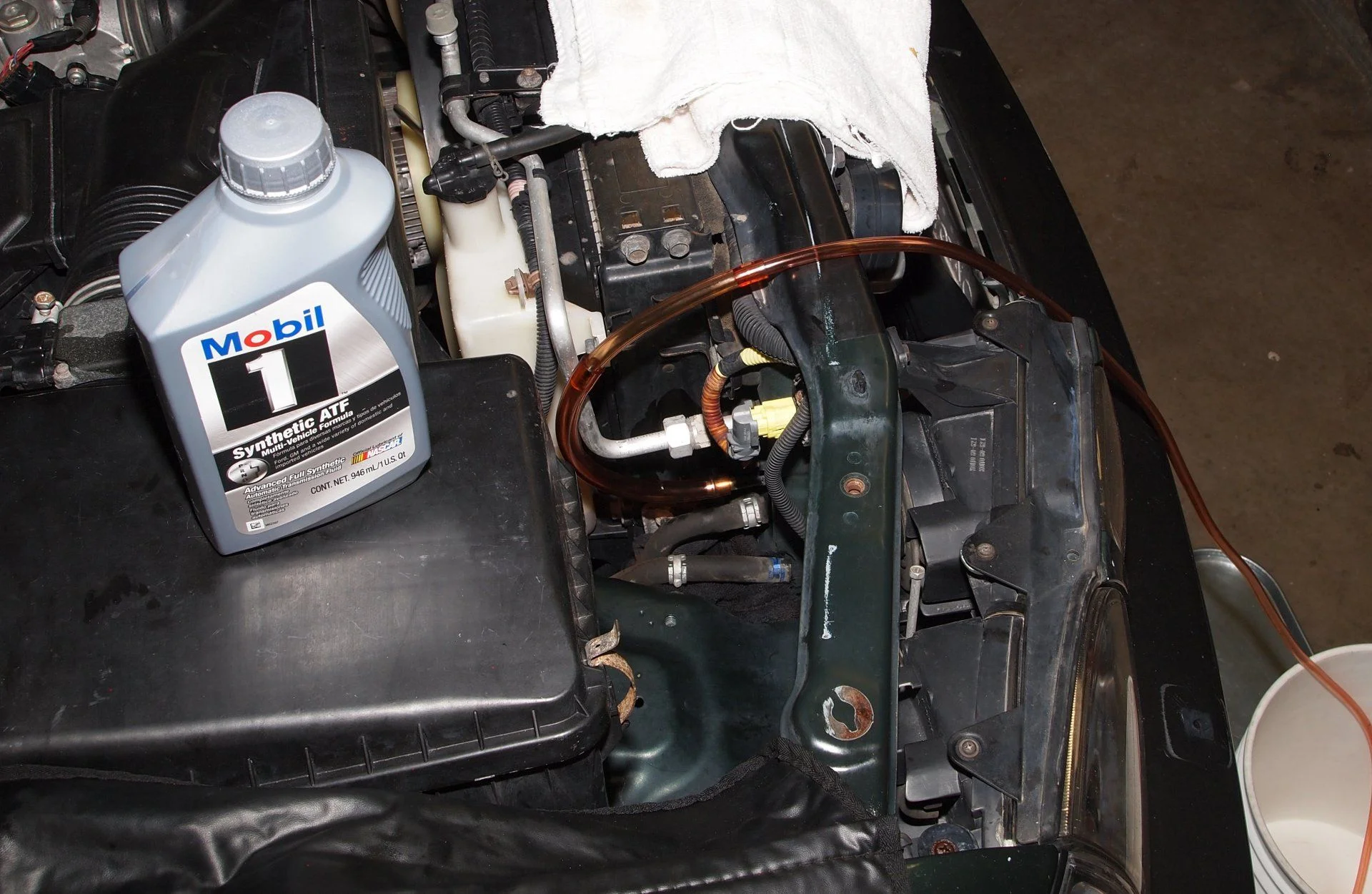

If it helps any, i removed the grill on my 2006 (3 phillips head screws) and afterwards easily was able to use pliers on a hose clamp to slide it back. Hose nipple (as you are looking at area behind the grill) is on the lower left pointed towards driver side.
Not sure where it is in your diagram but i flushed 14 quarts of atf ws two quarts at a time using that hose. Did that just a few days ago.

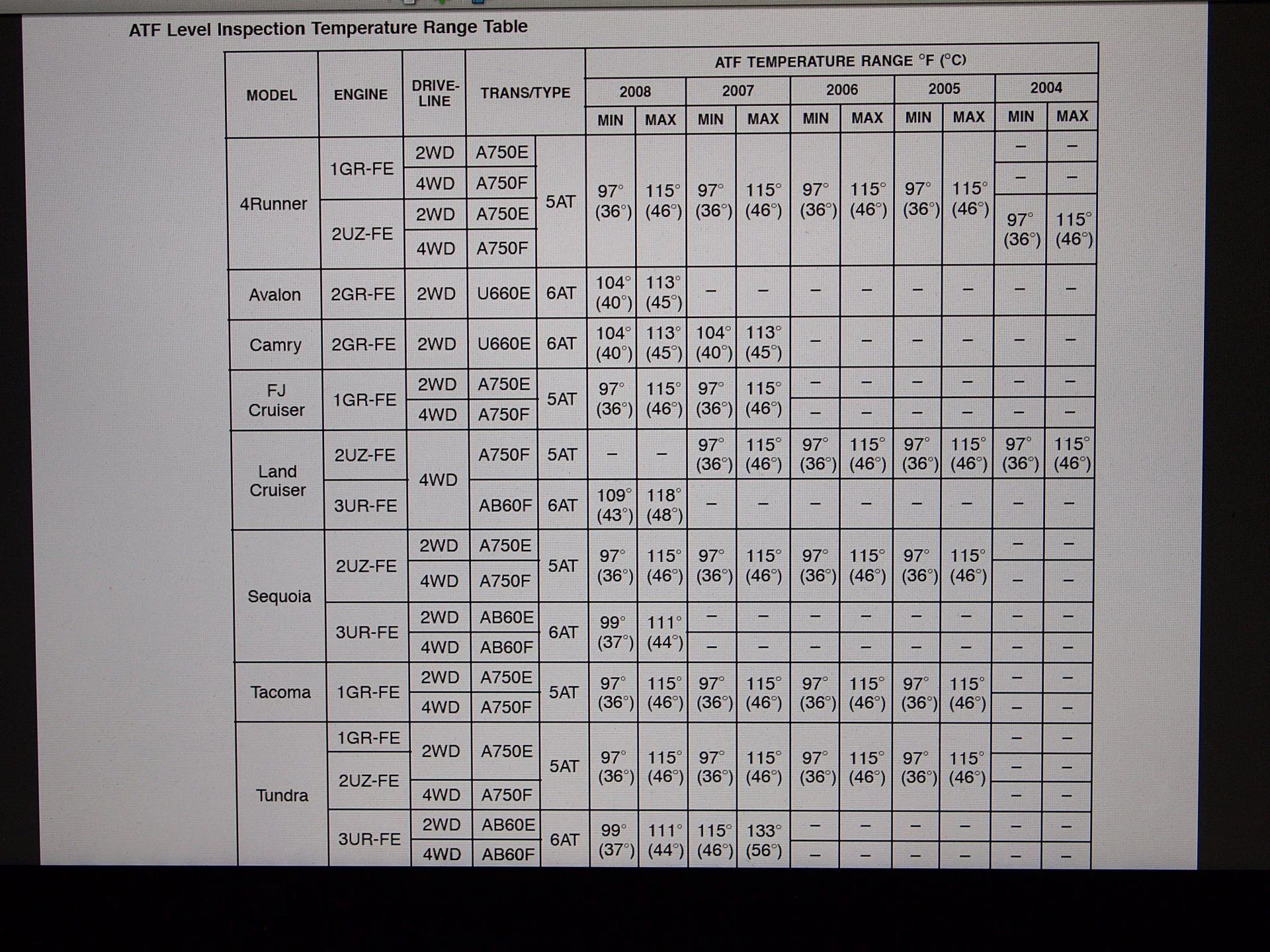

TBS. Set level with trans at between 97 - 115f. I set at 97F
First I've never done a Tran flush, but i believe the confusion stems from the diagram.
First the red ( hot) & blue (cool) are reversed in the picture. i think steming from the confusion for "inlet/outlet" as indicated on the diagram. I believe it is refering to the trans cooler inlet/outlet not the transmission's.
Second the dotted line don't match up when you follow it to Tran cooler.
2001LC says to pull the hose which he points to above, but if you follow that hose to the tran cooler it appears to lead to the upper hose at the Tran cooler.
But it's not it actually leads to the lower hose at the cooler.
So when Ducknl says he removes the lower hose he's also right.
So either pull the lower hose at the Tran cooler or the one 2001lc points to because they are the same hose (trans cooler outlet) IOW the cool line heading back to the transmission
I hope I got that right.
Pulling the return hose pictured and attaching a drain hose to catch bucket, at hard line next to radiator and near airbox. Is last point before fluid returns to transmission. It's first point after the transmission oil cooler radiator, easily accessed by just opening the hood. You can follow this hose to hard line and disconnect just under alternator. But that spot is not as accessible, messy and requires remove skid plate. In either case you'll no you've the correct line, when you idle the engine.
Some videos in youtube, show disconnect line going into radiator (DS engine coolant radiator). That not optimal point to drain from. As it does not flush radiators, and is messy. But, if you didn't have a drain hose to hook-up and run to a catch can. It's an easy point to run/drop its hose, directly to a catch can under the vehicle. It requires removing the skid plate for easy access.
Thank you both. The picture was worth a thousand words. I saw that hard lose location when I was surveying the situation. This makes sense as it will help to drain the cooler as well. Trace bottom line hose from Tran cooler on its way back to transmission to the hard line location in the picture.

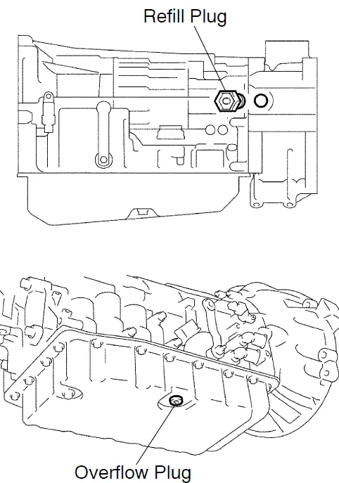

I can't find thr fill bolt at all its 24mm head right? Stamped ws? Do I also need to remove front skid? Is this bolt it-that's been removed? It was missing when I started the job.
This is for the A750F (5 speed), versions without dipstick:

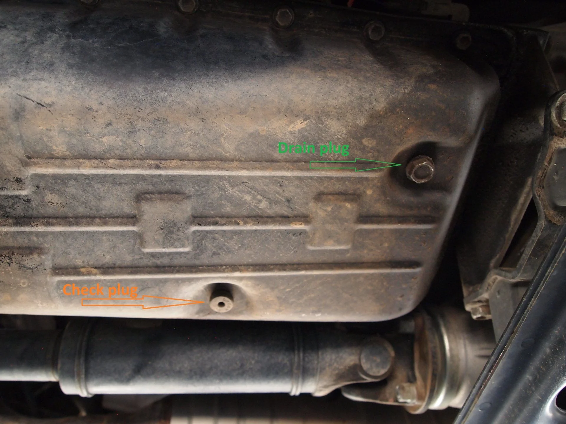

Thank you both. Eventually I found it and drained the transmission-after significant delays.

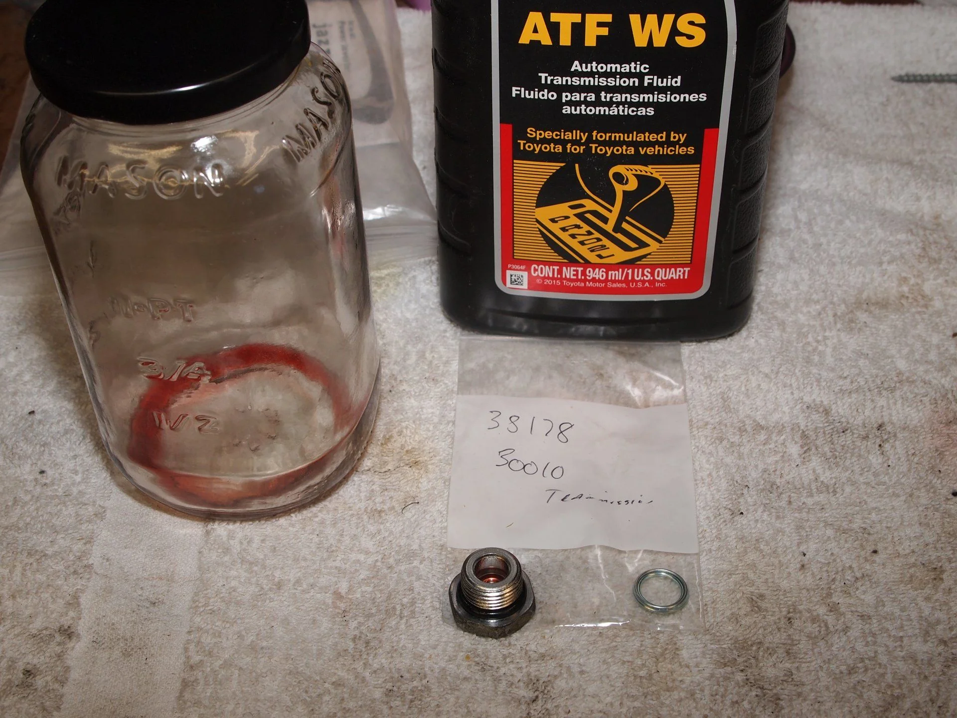

I could not find the fill plug anywhere when I started and couldn't find a diagram for the life of me. I removed a smaller than 24 mm screw from the side of the transmission and tried to fill there with no luck. I know everyone said its really hard to fill and I agree. Fluid just came back out and did not take so I knew this wasn't right. I put the screw back back in. I was crawling my way back under the car and stumbled upon a 24 mm plug easily accessible. How did I miss it? Well I removed the transfer case fill plug by accident(changed that fluid last week or so) and proceeded to pump atf into it which was flowing out. After realizing my mistake I immediately drained transfer case and fluid looked just like new, not mixed with pink/red. The atf was flowing back out the fill plug like when you fill transfer case with gear oil.

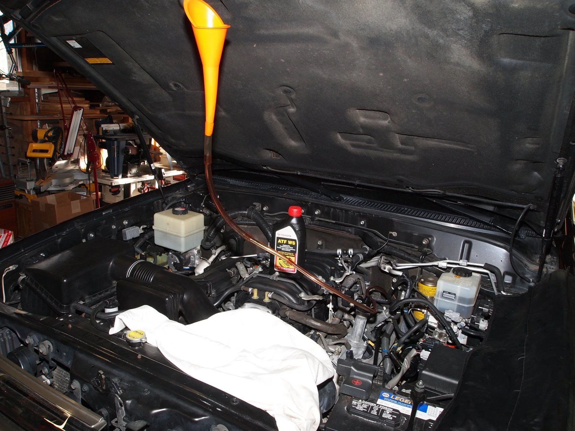

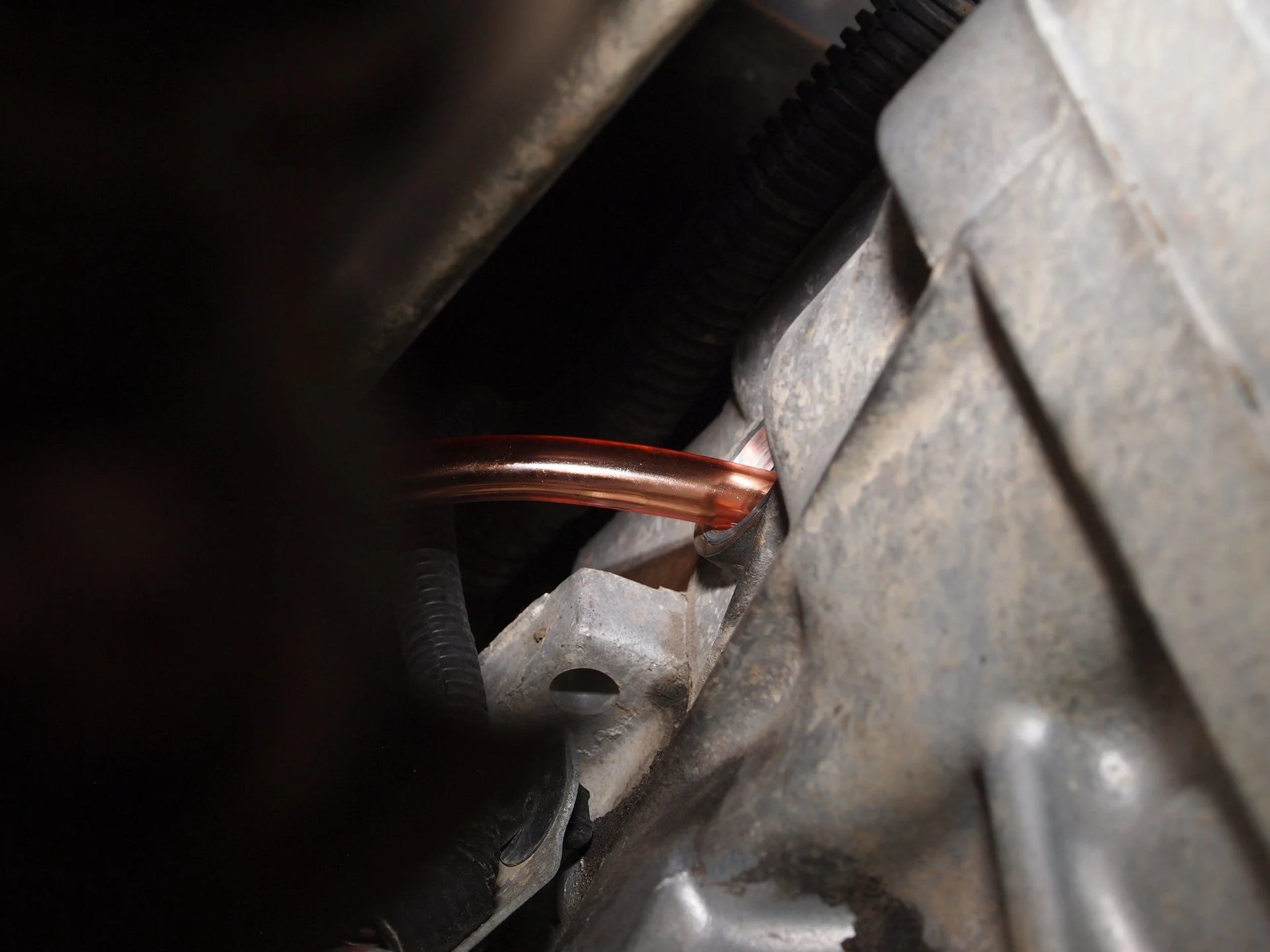

Eventually I found the fill plug from a youtube video. It is easiest to see if you are further back towards the middle of the truck looking forward and up. It's next to impossible to see from the front of vehicle looking back. After draining the pan first(before even locating the fill plug, woops lesson learned) I removed the shift linkage to get easier access to fill plug and filled with 2 quarts(all that came out, slightly warmed up after drive) I d/c the outlet from the trans cooler aka lower line coming out of trans cooler to my drain bucket. Starting the car and drained away 3x to get 6 quarts out. The fluid was dark brown at first, didn't smell bad and got progressively more red quickly. By 6-8 quarts it was looking basically new, but I kept going since I had her opened up.
Now I wanted to move through the gears with foot on brake to get it all out as best I could. My dad was assisting and went P to R and fluid spewed out of the transmission. I thought I did not put the fill plug back in. But no, I had placed the "smaller than 24mm screw" I took out first in the wrong hole. There are 2 vacant screw holes, one on each side of tranny and I put it in the wrong one. It spewed hard all over cat etc. and clean up was fun. I figured out my mistake(number 2 of the day) and refilled, ran through gears with no spillage. Yay, small victories are nice.
I plugged in my Icarsoft to start monitoring a/t temperature. I am not certain, but I think it only shows engine coolant temp because engine coolant and a/t temp were the exact same(is this correct?) I was under impression they would have different thermostats and did not trust that Icarsoft was correct so I tried to jump the 4 and 13 pin at dtc but failed at that too. Engine on tried to jump, shift between D and N 1.5 sec for 6 times and could not get D light to come on.
The shift from D to N didn't feel like normal, a bit clunky so I added more fluid and was also checking "check" plug. A few drops came out of check plug earlier when engine was cooler but as I started and checked again it was mostly dry so I kept adding fluid. I did a road test after a few more small fills of 0.3-0.5 qt approximately and the truck shifts excellent, aka the exact same as before. As a precaution I shifted on the dirt to 4L and ran the truck in 4L and back to 4H-came home and drained more transfer case fluid which was not pink/red at all so I was happy about that.

Last question, I thought I saw proper temp is 36-46 to test the temperature. Did it used to be higher aka 46-56? What temperature does the truck "think" is correct? I thought I read the revised the fsm or a/t check temp so I am not sure if the car is "thinking" correctly. I know I was not today!

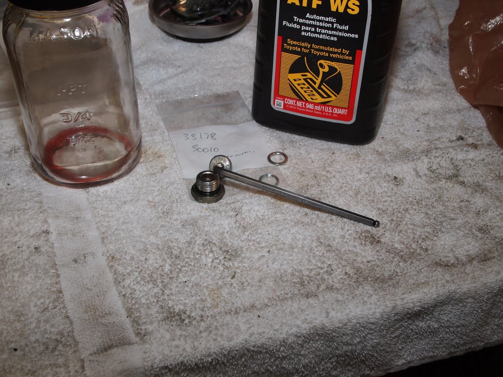

See post #152 above. You'll see I posted the TSB with new ATF topping temps 97- 115f. We do not use the jump procedure any longer. We read temp in tech stream 97-115 F. If you can't access tech stream. Shoot transmission pan with IR temp gun. Shoot for 100 to 105F.
Procedure is to shift through all gears once at temp. Once at temp, while idling with shifter in "N", remove check plug. If overfilled, ATF fluid will run out. If underfilled it will not run out. You want it slightly overfilled and let run out until it just drips. DONE.
I run a hose from under hood to fill plug. I don't remove linkage.
You can reuse O-ring on fill plug, torque to 29dt-lbf. But replace crush washer on drain and check plug each, torqued each to 15ft-lbf.
