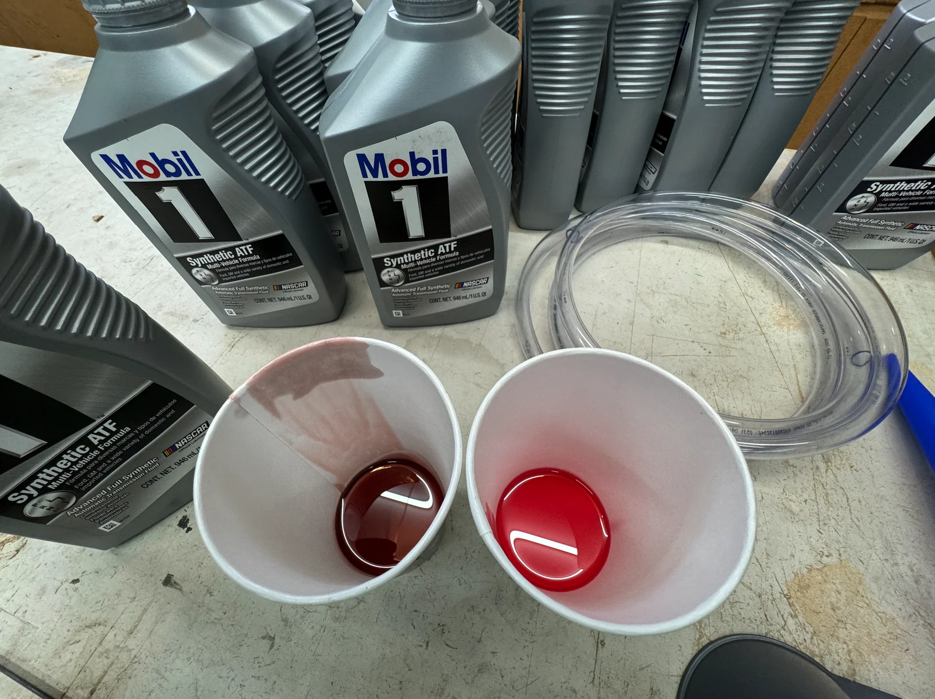

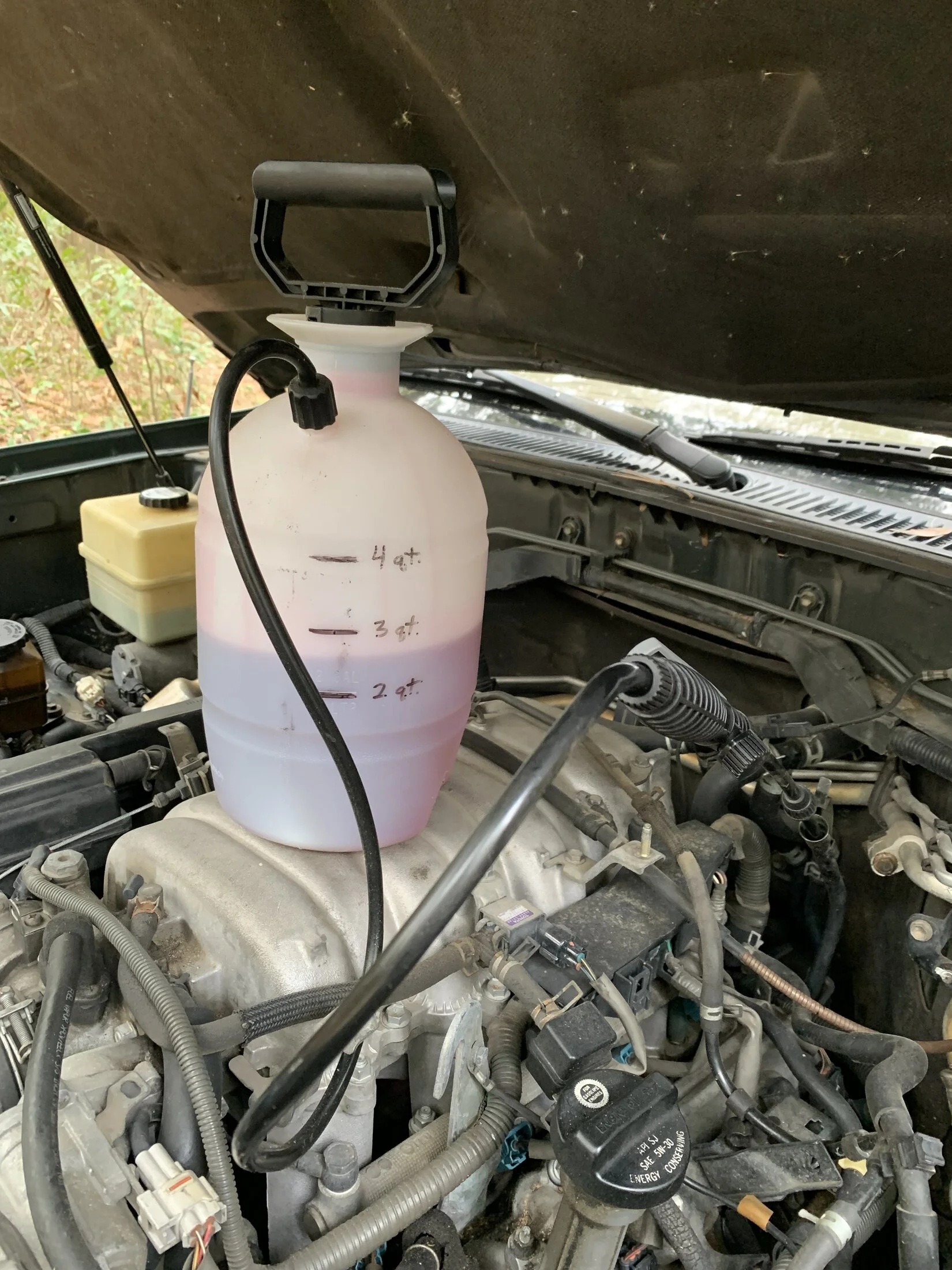

I did the flush procedure a couple weeks back from this post by @2001LC on my 2001 (with dipstick). Pretty straightforward. Some observations:
  • the system can pump out fluid way faster than it can be refilled due to the tiny dipstick tube. starting/stopping the vehicle to get the right amount flushed is the tricky part.
  • the clear 1/2" ID tube was too big for my truck and leaked a lot
  • pre-marked catch bucket was super helpful to keep fill = drained. i used an old chlorine tab bucket to catch the old oil.
  • i had 16 quarts on hand and it was not enough. the fluid was not fully clear after flushing all of it, but that's how it goes
  • not noticeably different when driving, but good peace of mind!
