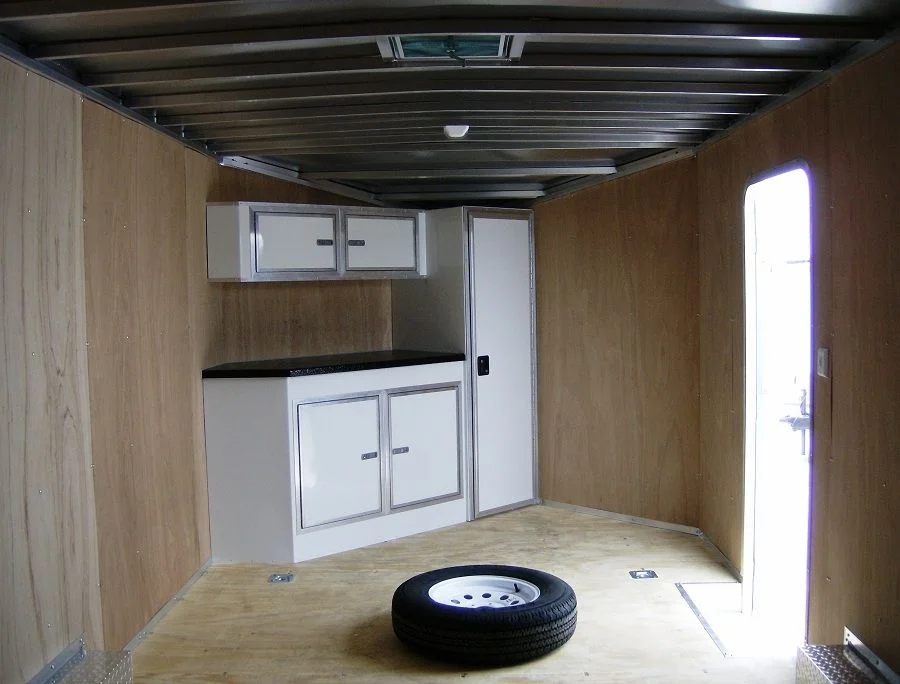

That's what's in my head for now. The cabinets won't be as fancy as what you have in the pic Rice, mostly because it's not tall enough to stand so a countertop doesnt really make sense. Picture basically everything from the right of the door to the right of the fridge will be enclosed with doors to access.

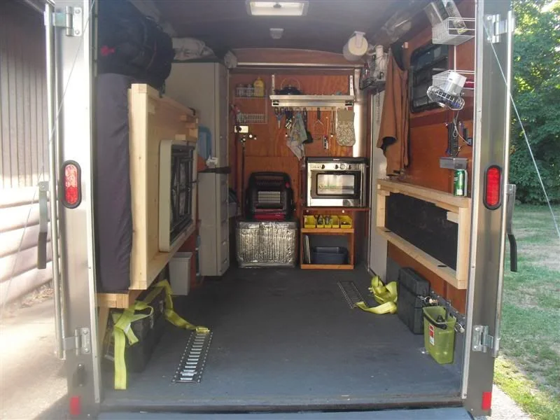

I'm all for hinged bedding, caputured tables, and stackable storage. Love the kitchen up front too.
