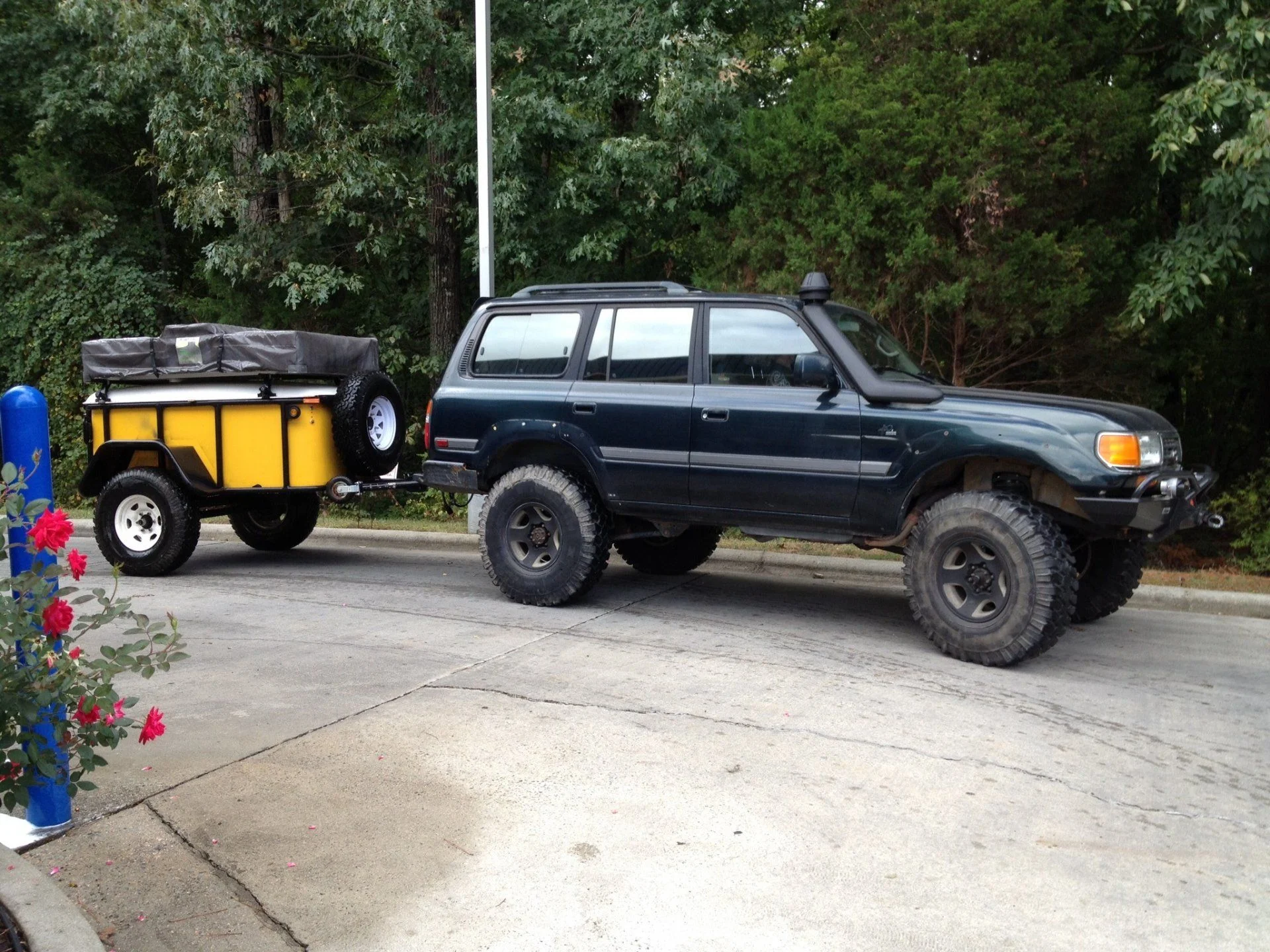

Here's a very fuzzy picture of when Mike and I did this on his utility trailer:

Any clue how much lift he ended up with after the SOA?
No, we didn't measure. Lift height for your trailer should be the thickness of the axle tube (with spring perches) plus the thickness of the spring pack. If I had to guess for mike's trailer it was somewhere around 5".

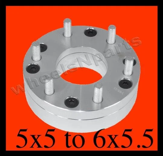

They do make adapters that will allow you to keep your axle/hub and swap to a Toyota bolt pattern. If you want extra width that is something to consider. For about the same $$$ you can also pull off the 5 lug hubs on the axle and replace with 6 lug.
Adapter/spacer
All you have to be sure of is the spindle and hub combo match (usually they are matched according to load rating of the axle)

spacers - I'm not going to bother switching to Toyota, the wheels would be too small to use as a spare on any of the cruisers anyway - so I don't see a lot of benefit. I'll likely just put wider/taller tires.
