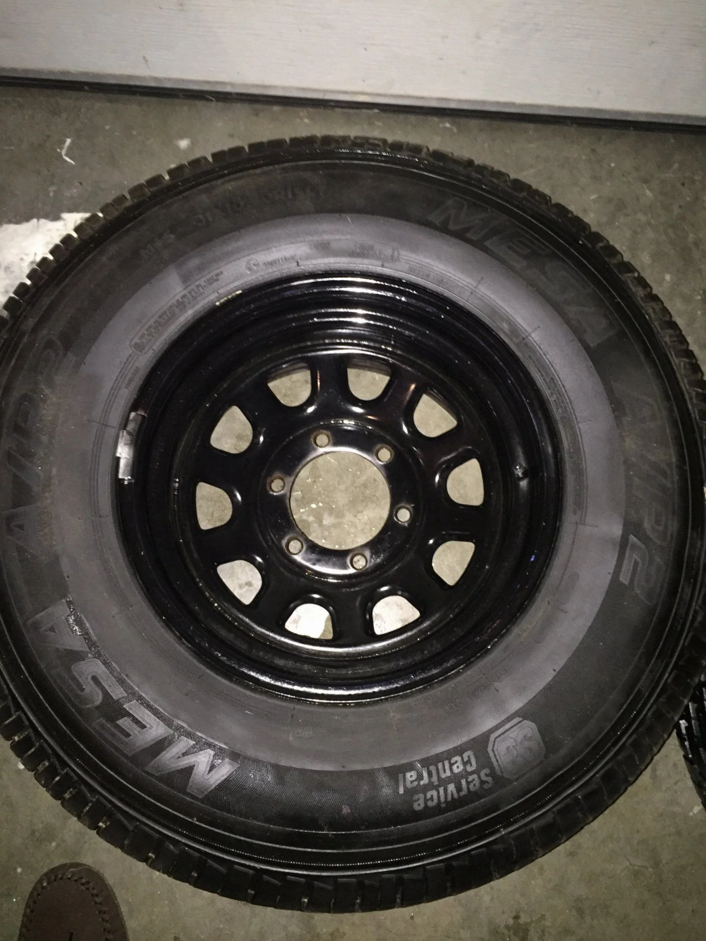

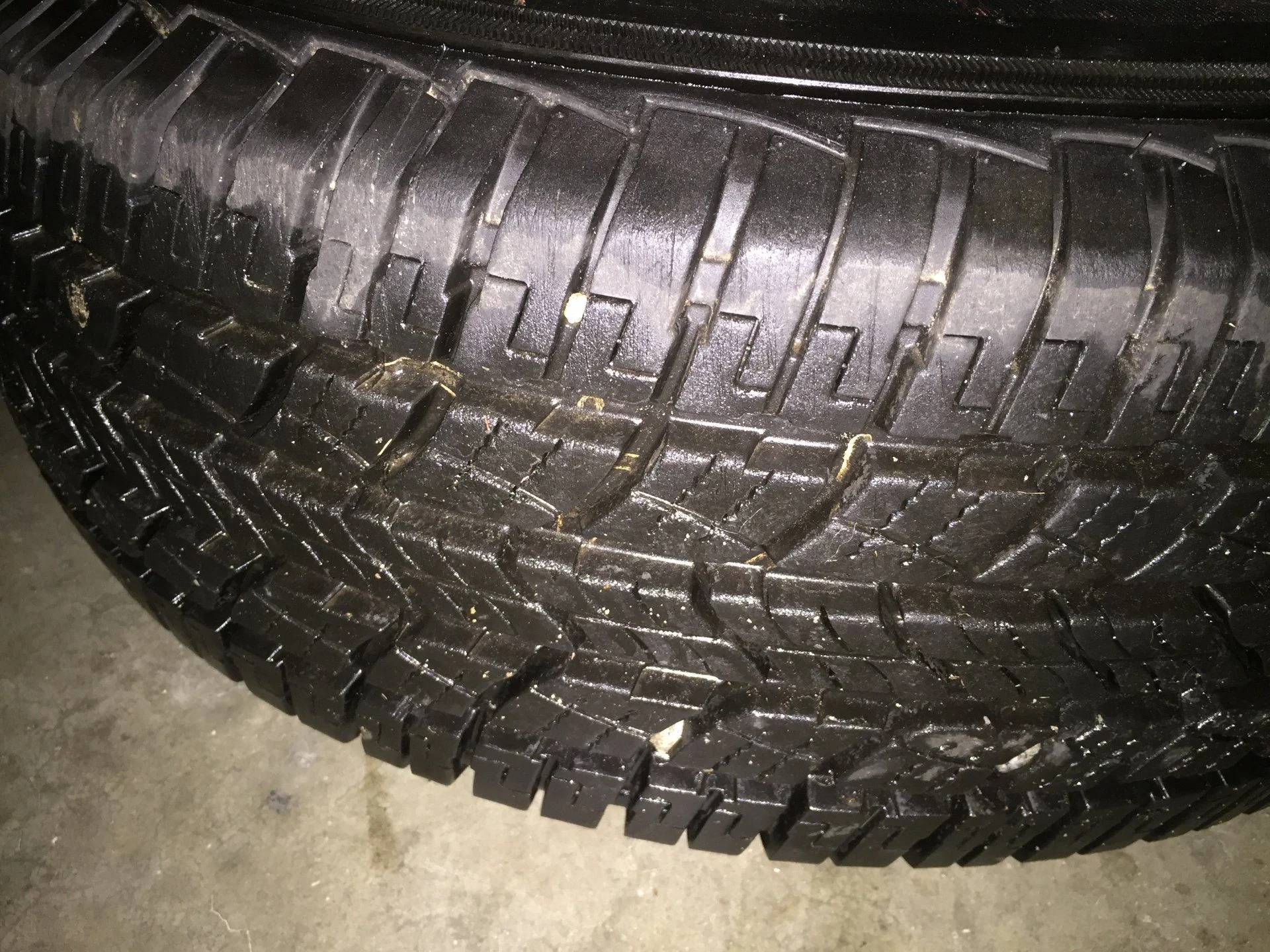

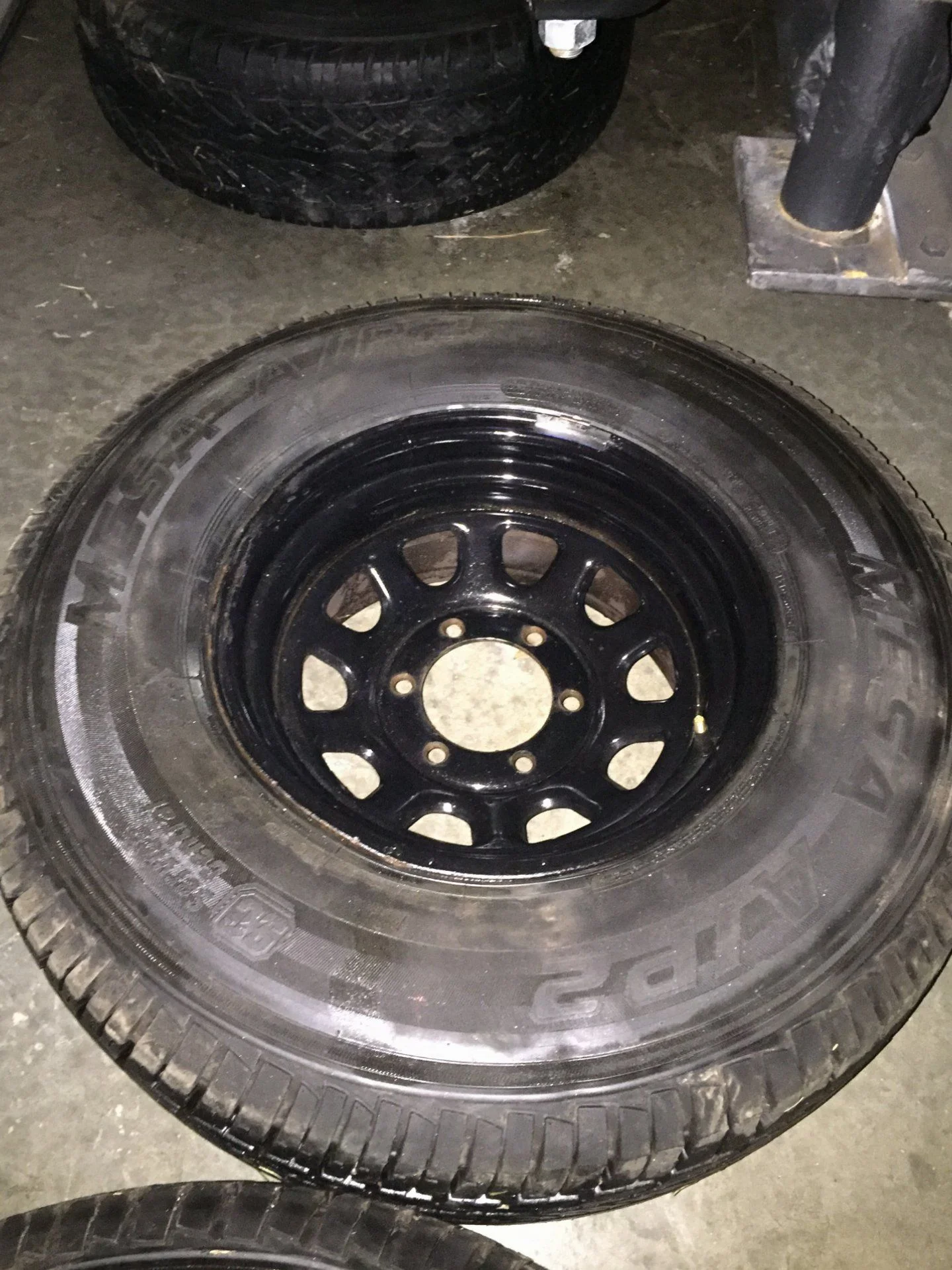

Got the wheels and tires. 2 with good tread. They're 'mesa atp' which is a generic tire made by cooper. They were dirty but cleaned up nice.

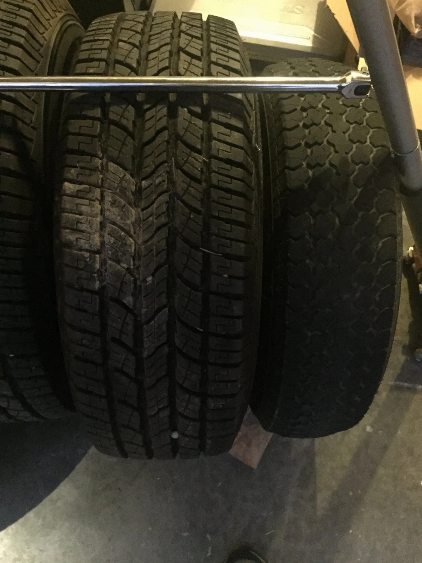

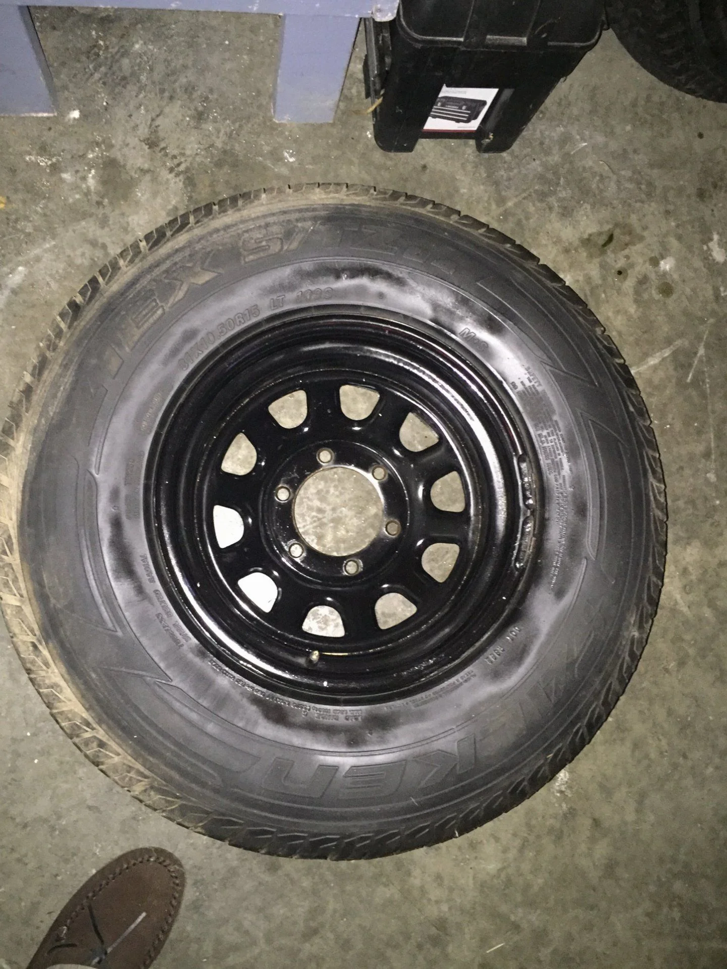

Also got 2 suitable spares. 1 I'm keeping and the other may be available for a reasonable price if anyone needs a 31" spare. As pictured it's a falken

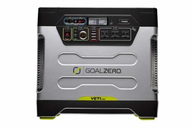

I realize this isn't a powered generator but I keep two of these at home for "emergencies". The Yeti 1250 has 1250 watts of power, 12v outlet, 110v outlets plus USB ports. Can be charged from a 110 v outlet or solar panels. At 100 pounds it isn't light but I would bet it would keep a camping trailer going for a weekend. I have used a portable induction burner plugged into it to cook an entire meal.

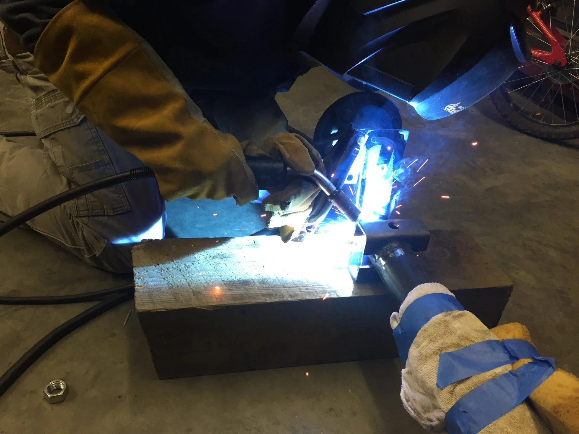

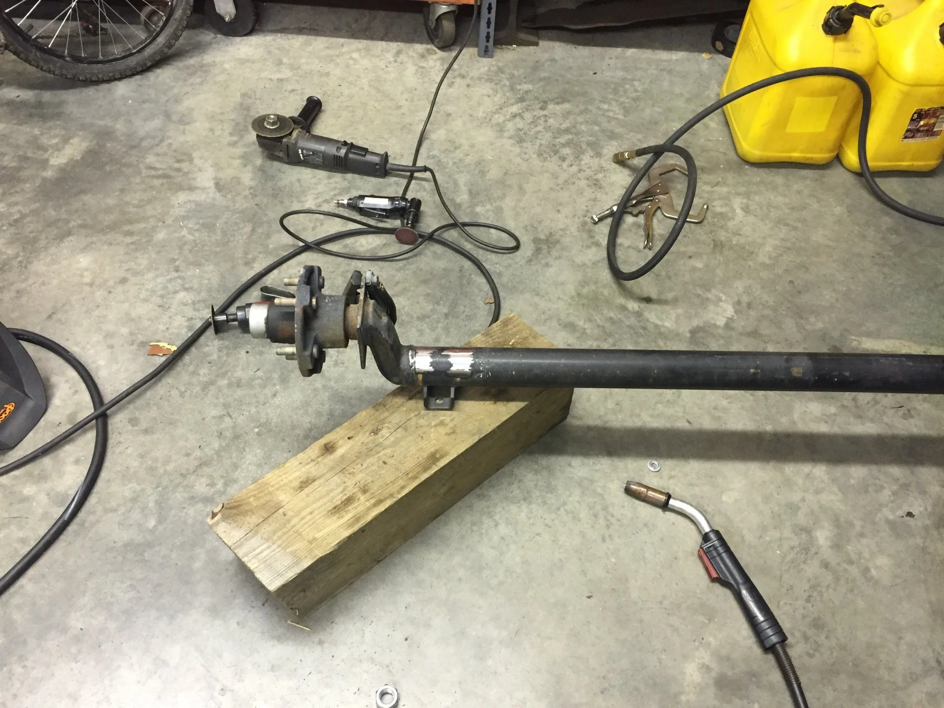

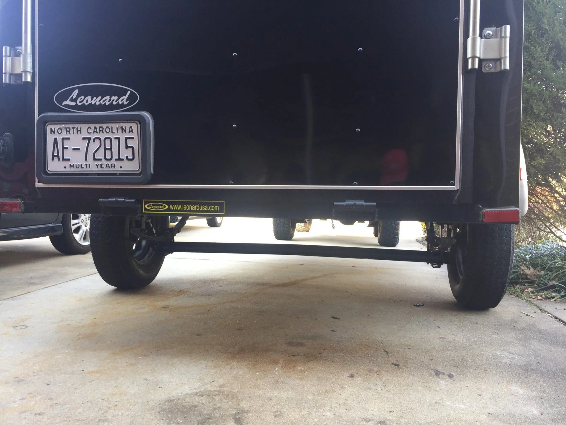

So I got the suspension flipped thanks to some welding help from Rice. Thanks man! With a drop spindle axle a traditional axle 'flip' would have been hilarious, but bad. So Rice burned on a couple of new plates. Got the axle installed this morning and realize that the wheel spacers I got were wrong. I got 6x4.5 to 6x5.5. Should have gotten 5x4.5 to 6x5.5. Unfortunately there's no local source that I know of so the old trailer wheels went back on in the meantime.

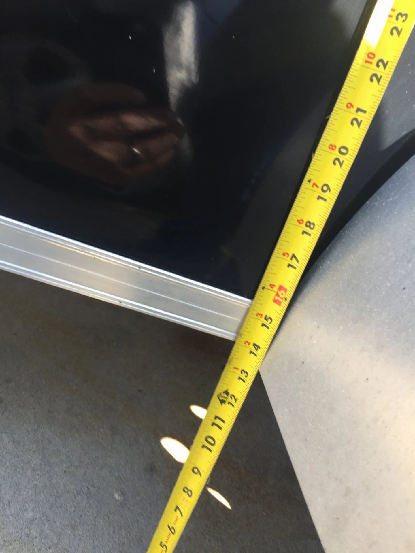

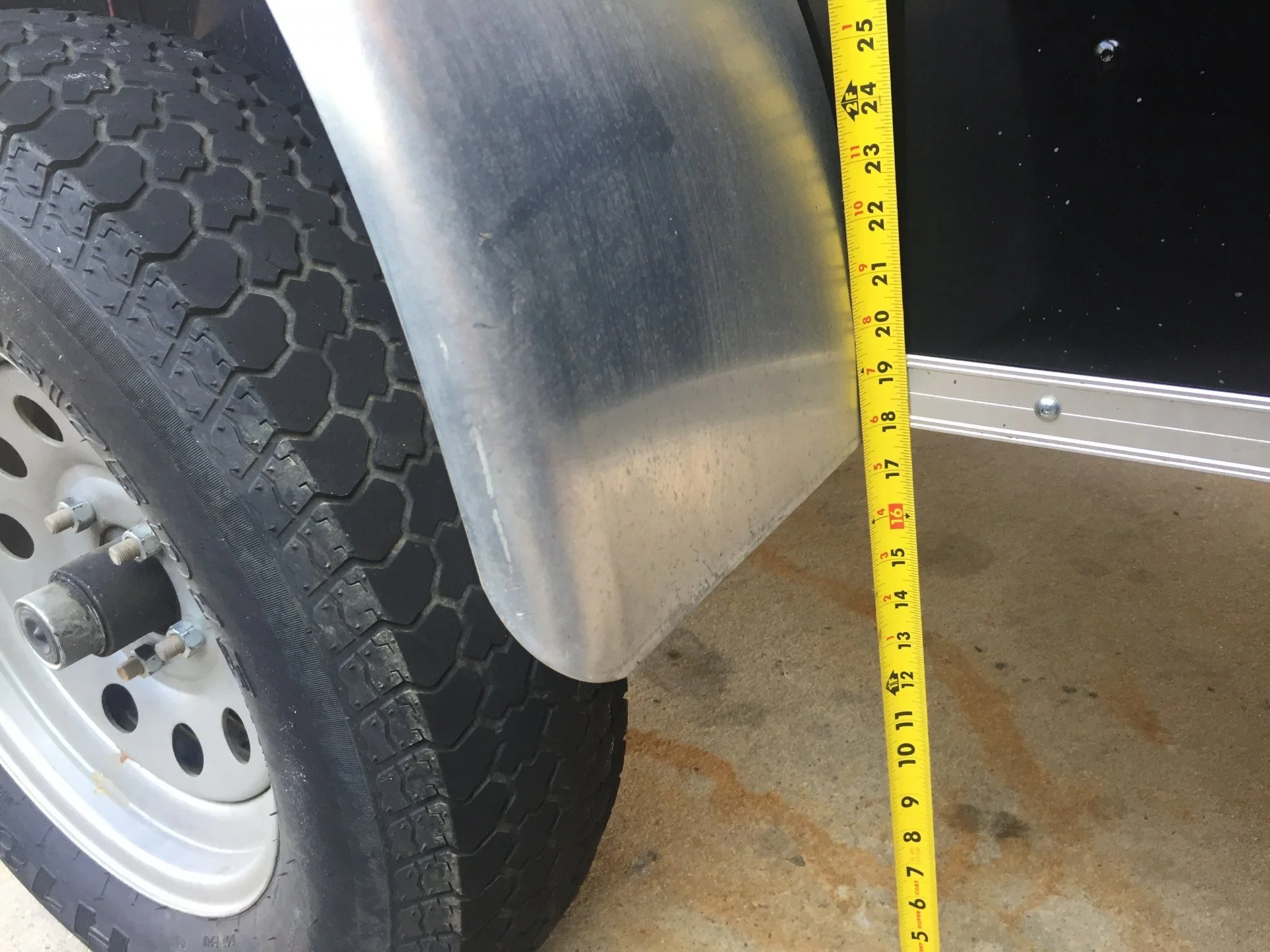

Before and after height wise.
Before:
And after. ONLY The suspension flip. No tire:
So approximately 6" of lift. Which is much more than I expected. Add the tire and it's another 1.75" ish.
What's nice is it's fully level when I tow it with the 40. So... still gonna need 8" or so of drop with Biscuit.
Now after I fill it with 1000 lbs of gear it may sag a bit.
Took it to the DEpot to buy some supplies and it rode really smooth very little bumping. The drop spindle axle looks ridiculous though. For $90 I may spring for the straight axle equivalent and gain the 5 or so inches of ground clearance.

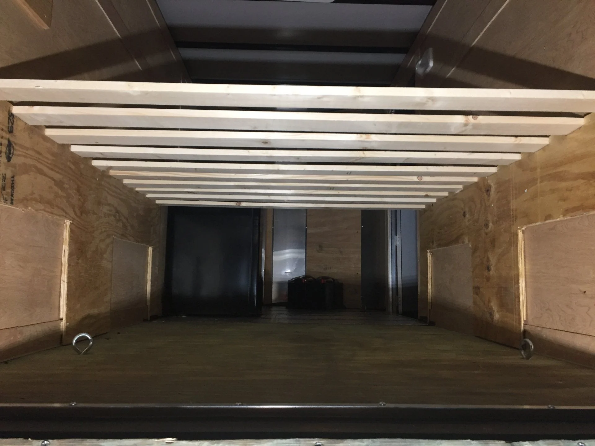

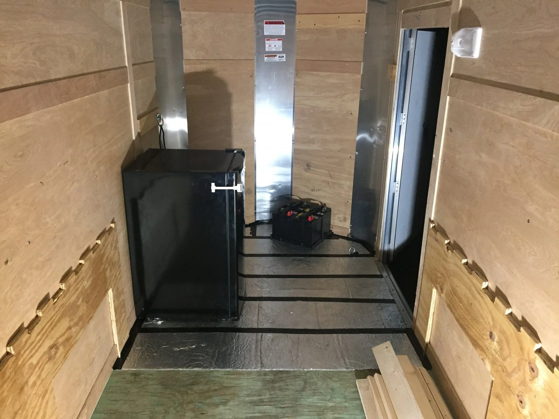

Some small progress. Got the sleeping platform finished and installed, added some floor insulation up front and installed the battery tray and bolted in the fridge.
It's gonna be cosy :)
Oh and thanks Steve for the router - it's insanely difficult to use. The bit kept wandering and the height adjustment kept changing. Granted ive literally never used one before so I'm sure I'd do better next time.

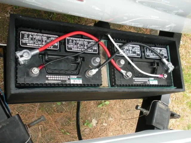

Have you considered putting the batts on the tongue?
Either using a small box just for the batts:
Or a bigger box that can hold additional hardware.
Right now the tongue won't fit a thing because of the spare tire and jack locations. Im looking at how I can change them to allow the propane tank to fit on there. I had considered putting the batteries, but it's a very small tongue. I'm planing on enclosing and venting the battery compartment to the outside just in case.
Gotcha. Maybe even a straight across wall at the front to make a nice "pantry" for Batts, inverter, misc hardware, and camping supplies.
