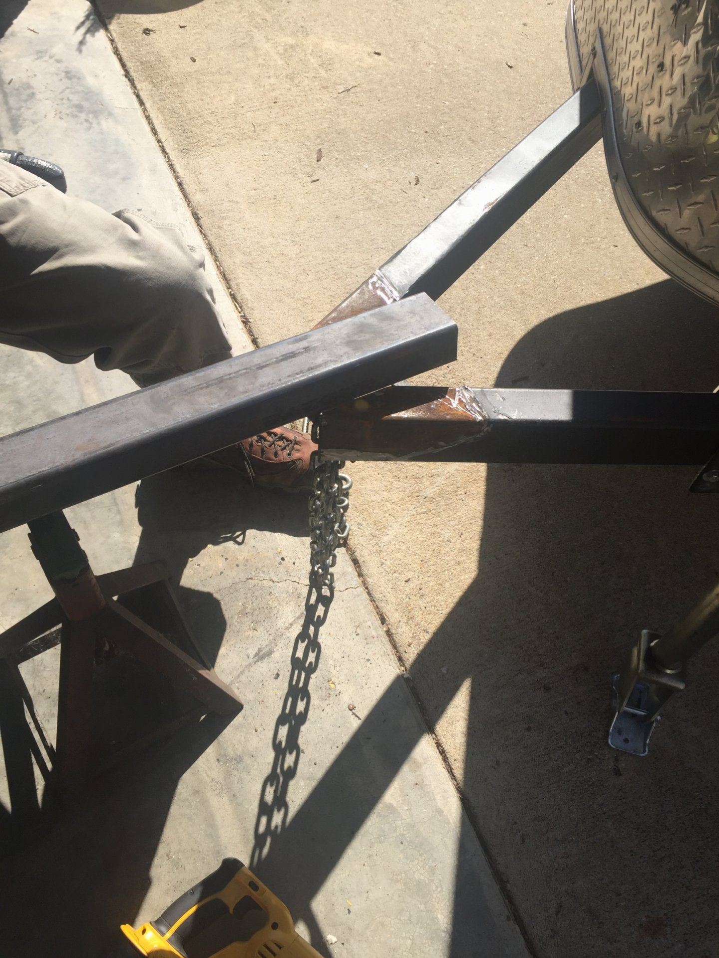

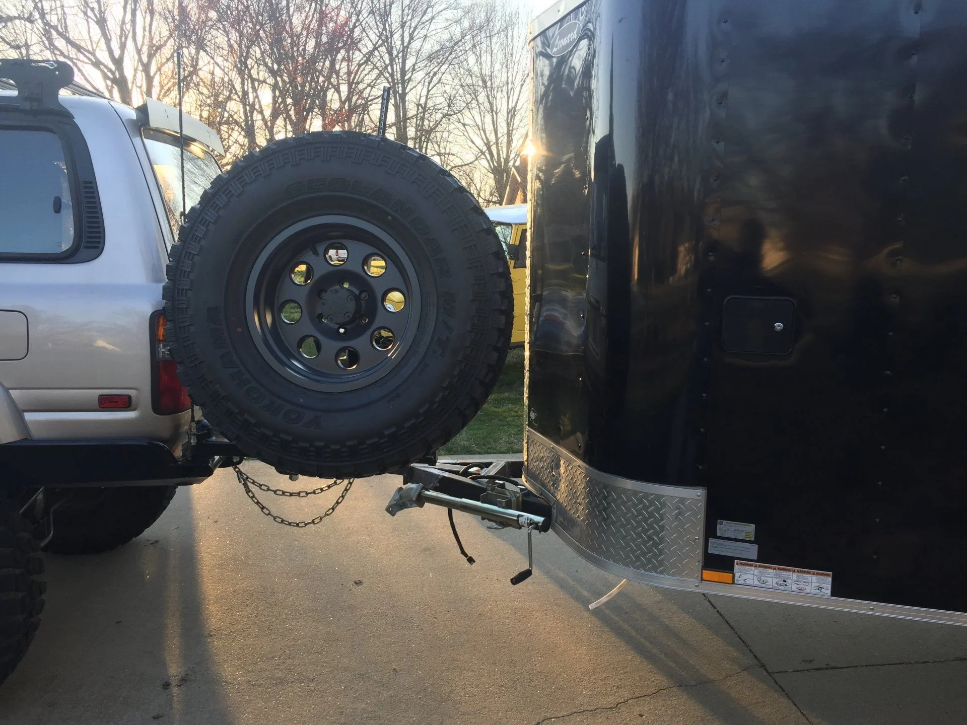

Rice designed and fabricated a longer trailer hitch out of some steel that I got from Jason.
RIce and I would like to go on record and say that the length was specifically designed to allow the spare tire to swing out. :)
Yeah, swinging out that won't happen once there is a propane tank in the way. :D

I think it will actually. That angle is deceiving.

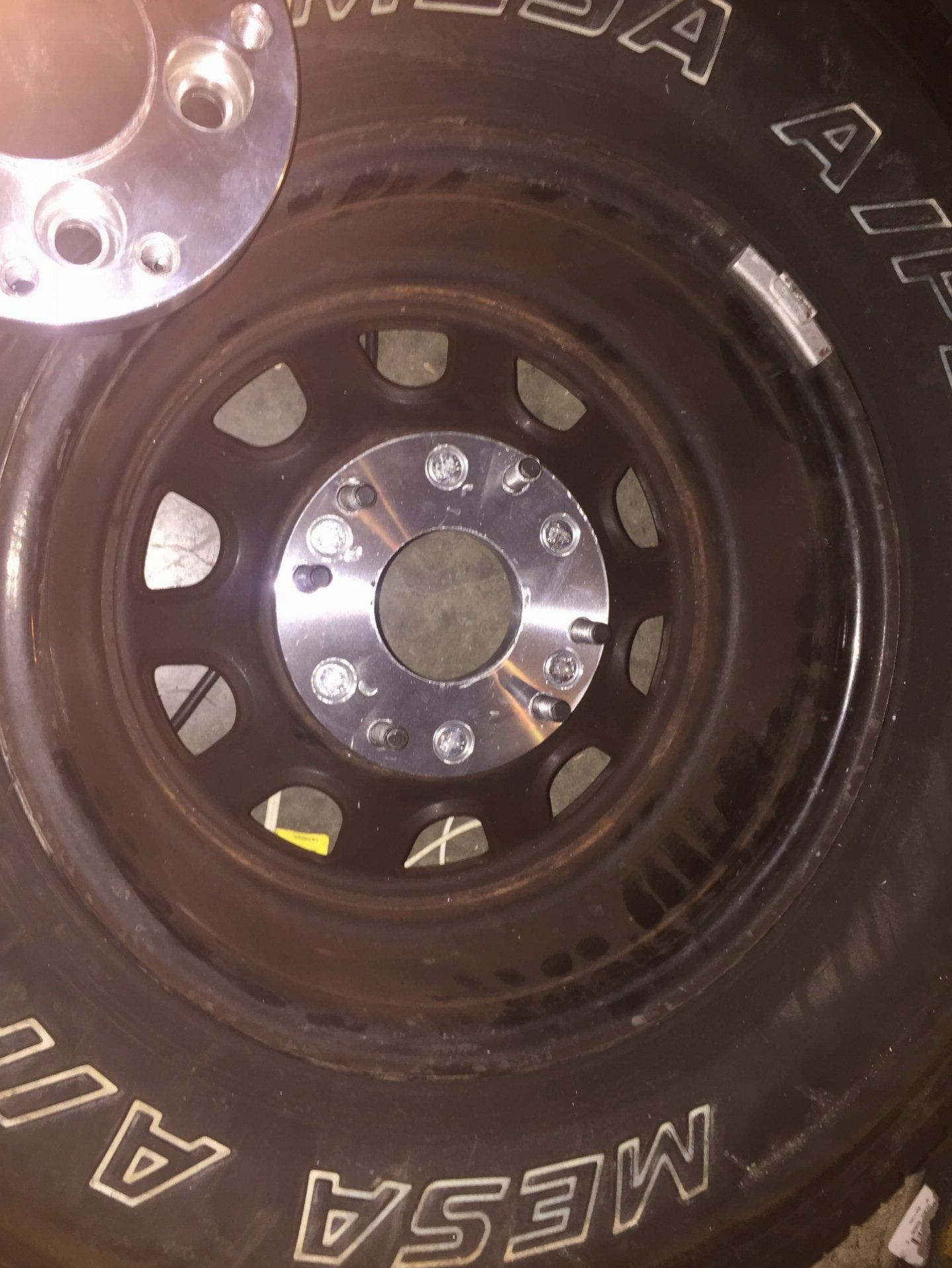

So later on that day. As in, on the way home... one of my wheel spacers decided to fail. Still tight to the hub and still tight to the wheel, the two pieces separated. Which meant a tire rolling down the street at about 35 mph straight past me. Thankfully someone followed it and brought it back to me on their trunk lid (it was about a quarter mile down the road). The trailer scraped for about 20 yards before I came to a stop. Another thankfully: fender doesn't look like it's completely toast and the part of the trailer that scraped on the road was the now redundant spring perch from when the axle hadn't been flipped yet. So all in all it could have been way worse.
I'd love to figure out how the hell all of these bolts decided to give up. Something put a nice gash in the tire too. All this happened less than 5 mins from my house so I decoupled and ran home and grabbed one of the 5 lug wheels and a jack.
Still firmly attached to the wheel.

View attachment 1415127 View attachment 1415128 View attachment 1415129 View attachment 1415130

So what failed? The threads for bolts holding spacer half together?
Looking at pic looks like spacer bolts (that join halves) are still there intact and new 6 bolt pattern wheel studs all sheered? Was the other half of spacer still bolted to axle hub and tight?
Yep - both ends tight. The connection between the two halfs was allen (hex) head fine thread bolts. Quite sturdy. I man tightened them with a 6-8" allen wrench - so plenty tight.
I don't think any of us could have produced enough torque for that fastener from a 6-8" long tool handle. The amount of torque should have been close to the lug nut torque.
Did the spacer have steel inserts for the threads or did the allen bolts thread right into the aluminum?
