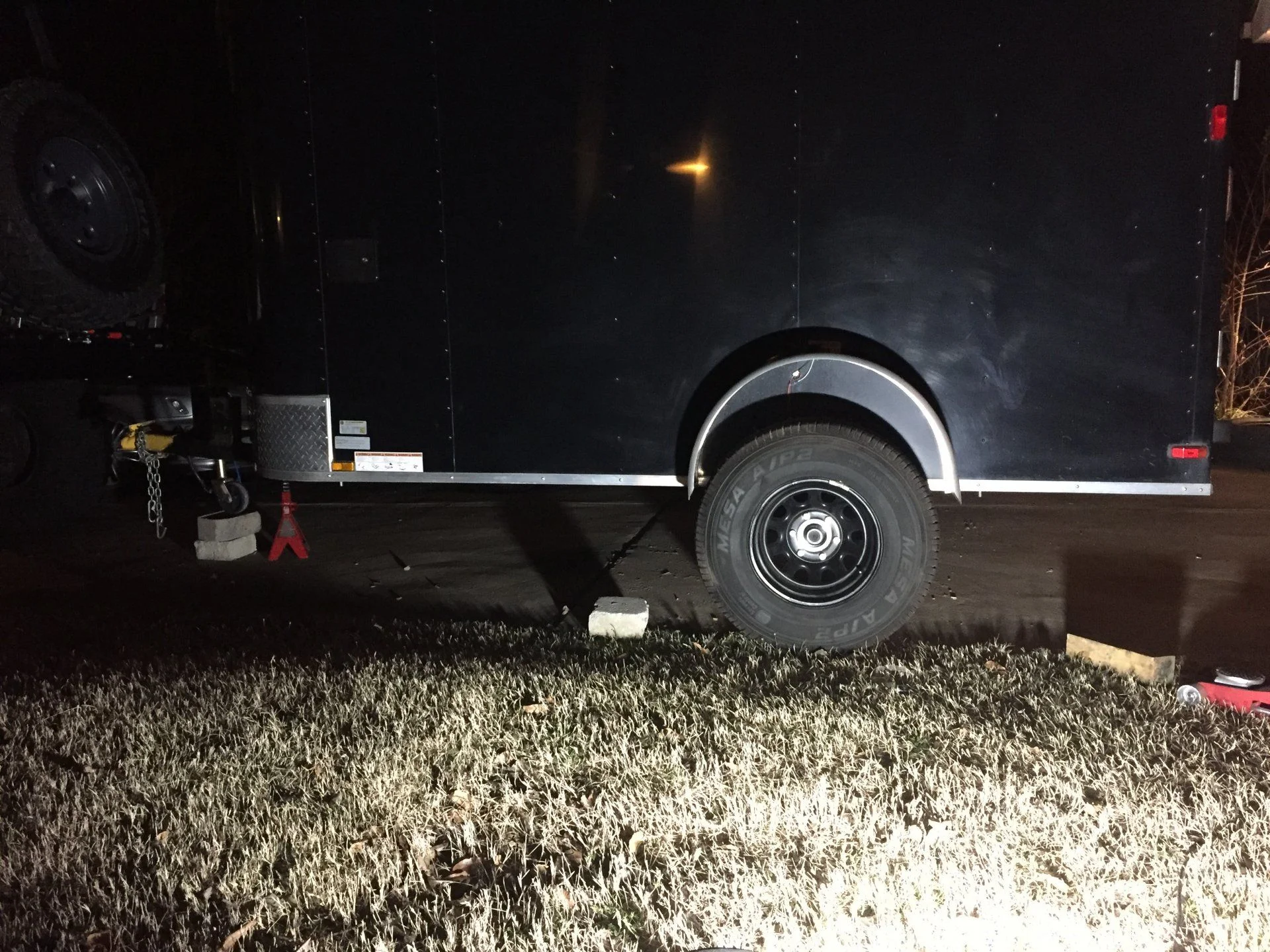

The: 'I had 30 mins to spare so I did something' update.
Spacers. And wheels.
Complicated spacers due to the 5 to 6 hub conversion.
I'll have to go back and look, but the final ride height mostly 'unloaded' is 19". Glad I didn't do 33's they would have rubbed the fenders.
