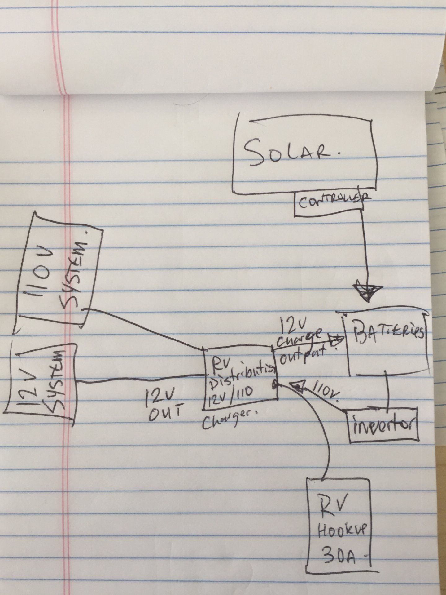

Help me out here. Concerned about the loop that is the 110v DC to AC invertor. Basically it's going to send power into the unit that generates 110 and 12v ouputs, but also send a signal back to the battery to charge it? Mind blown.... Batteries power invertor, which powers battery charger.....

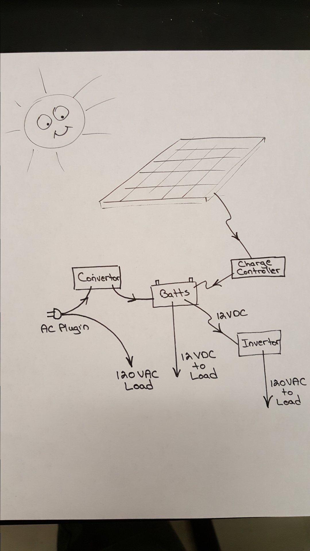

All the invertor will ever do is draw energy off the battery. It is the job of the controller to regulate voltage from the solar panels (and thus flow of charge) to the battery. The exception is when you are plugged in and can charge the battery using RV hookup (via the convertor).

Thing is, that 'convertor' on the left is a dual voltage. It controls all 12 volt and 110v circuits. So that "12vdc to load" and "120 load" will come out of the convertor rather than direct from the 120 socket, or output direct from the battery. I get the "shore power" functionality - that's no problem, it's just the non shore power, when I'm running the DC to AC inverter, I need to feed that power back into the "convertor". and the concern is that by feeding 110 into it, I'm now feeding 13.6dc back to charge the battery :)
Here's what it is:
WFCO 8700 Series 12 Amp RV Power Center Converter - S119-554718
