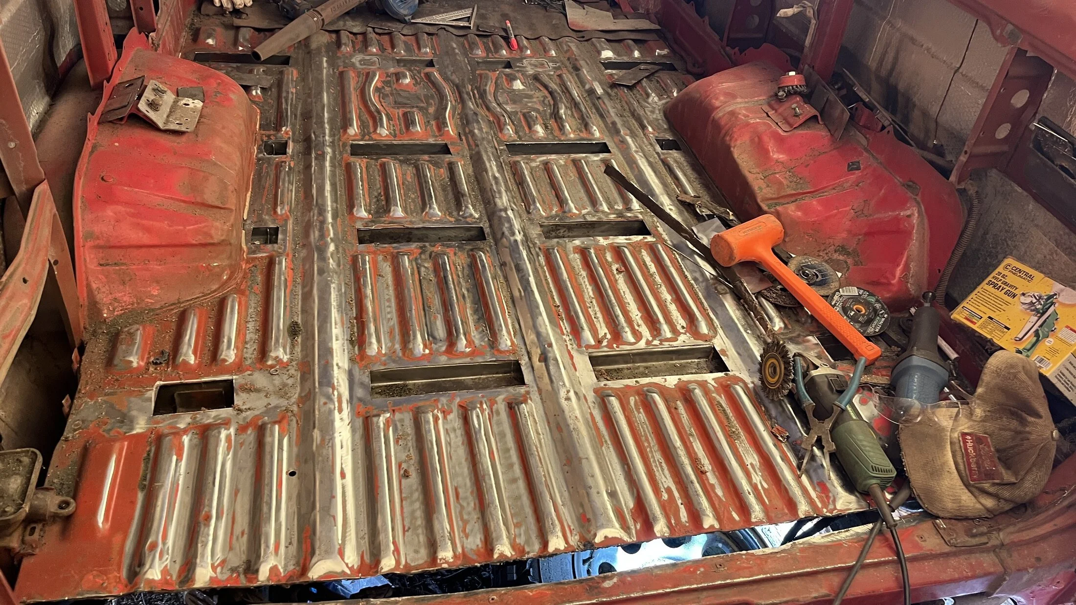

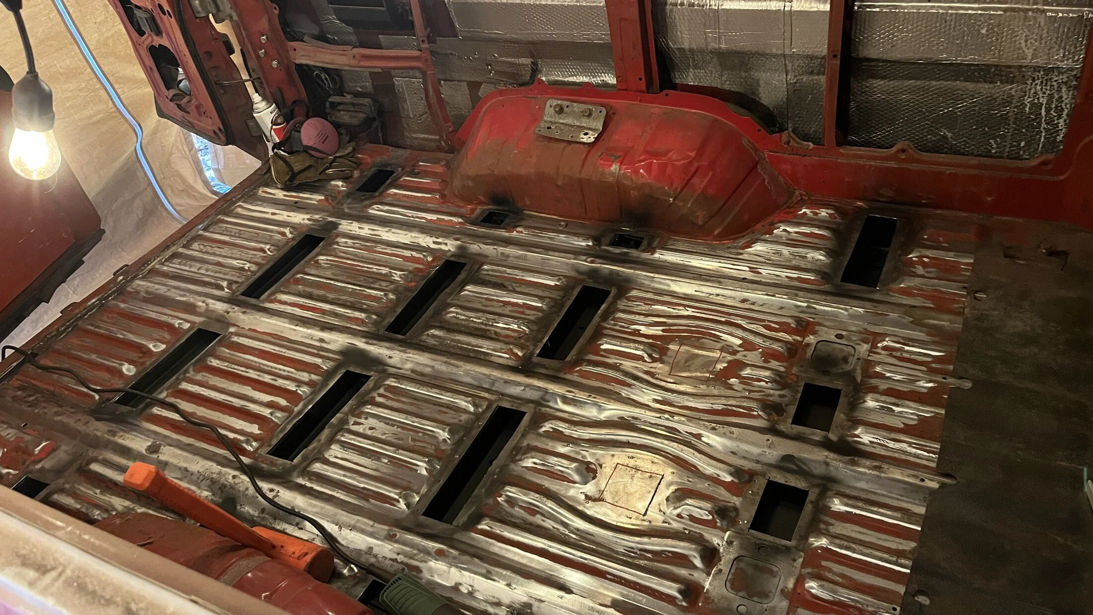

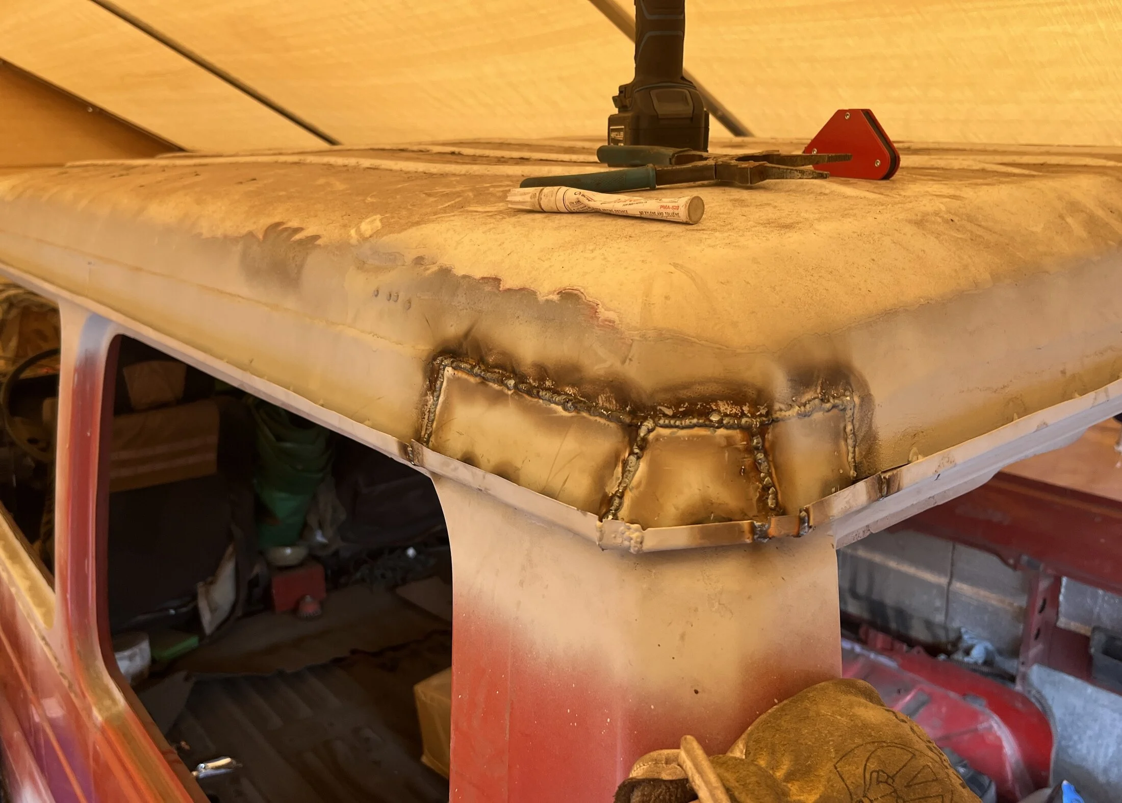

Alright progress! Following in the exact footsteps of @SNLC from the Troopy Hodgepodge thread, I had seen that they had cut into the floor to access the cross-members that support it underneath. I am SO GLAD I did. Nothing was horribly rotten or rusted through by any means, but another couple years down the line and it would've been a totally different story. Glad I got to this when I did.
Wire wheeled what I could, followed by sandblasting everything else, then rust converted, and finally covered it all with a rust encapsulator paint.
Ground down the backsides of the pieces I had cut out which had minimal rust on them, but still didn't want any chance for anything to grow, and slathered some weldthru primer on them.
To anyone who hasn't done this kind of tedious sheet metal welding before, I truly wish you never have to. At first glance, I figured this would take 4-6 hours tops... NOPE more like a day and a half (14 -16) hours. Every part of the cleaning process takes quite a significant amount of time, alongside the cutting and welding parts aswell.
View attachment 3861835View attachment 3861836

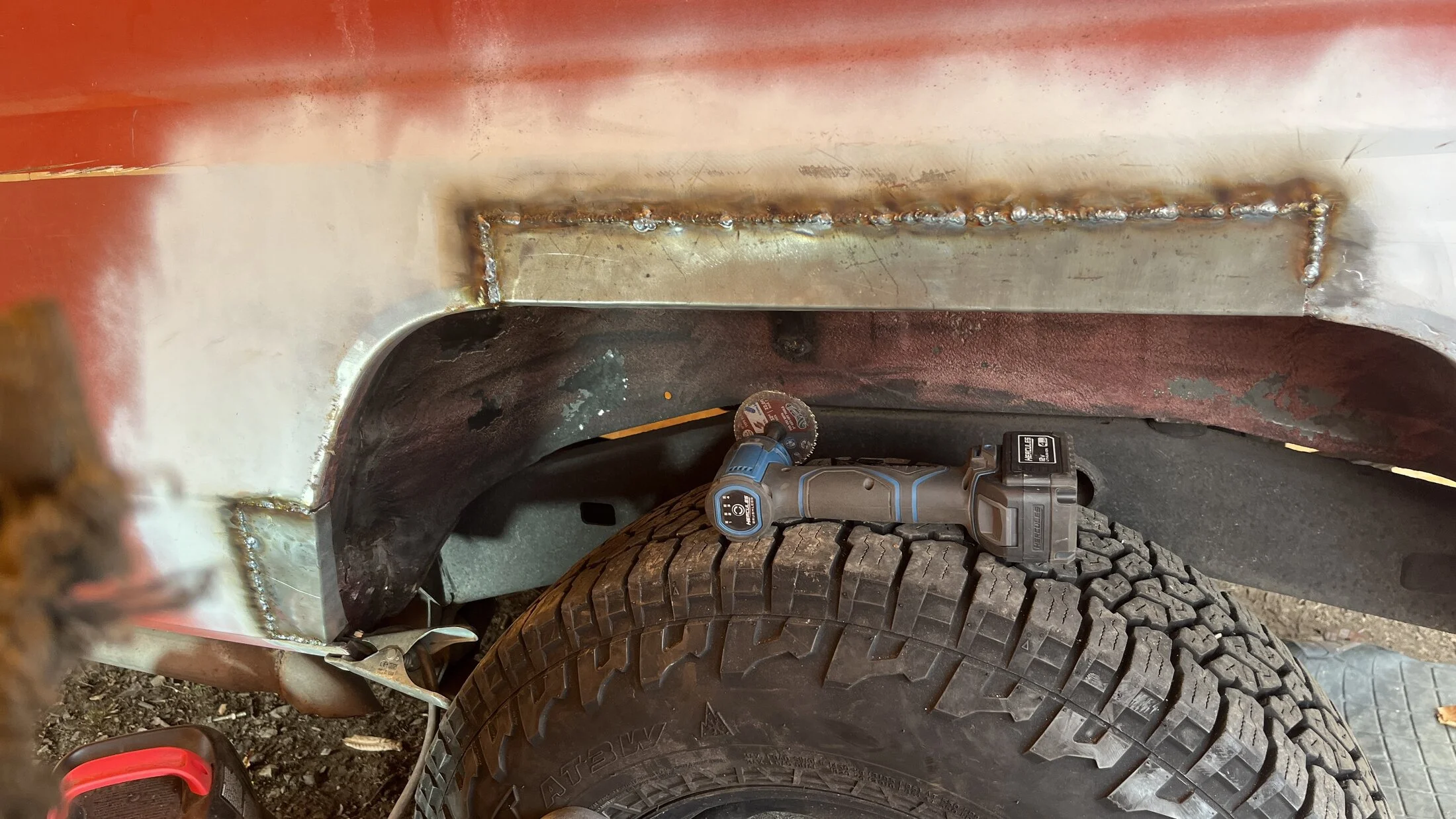

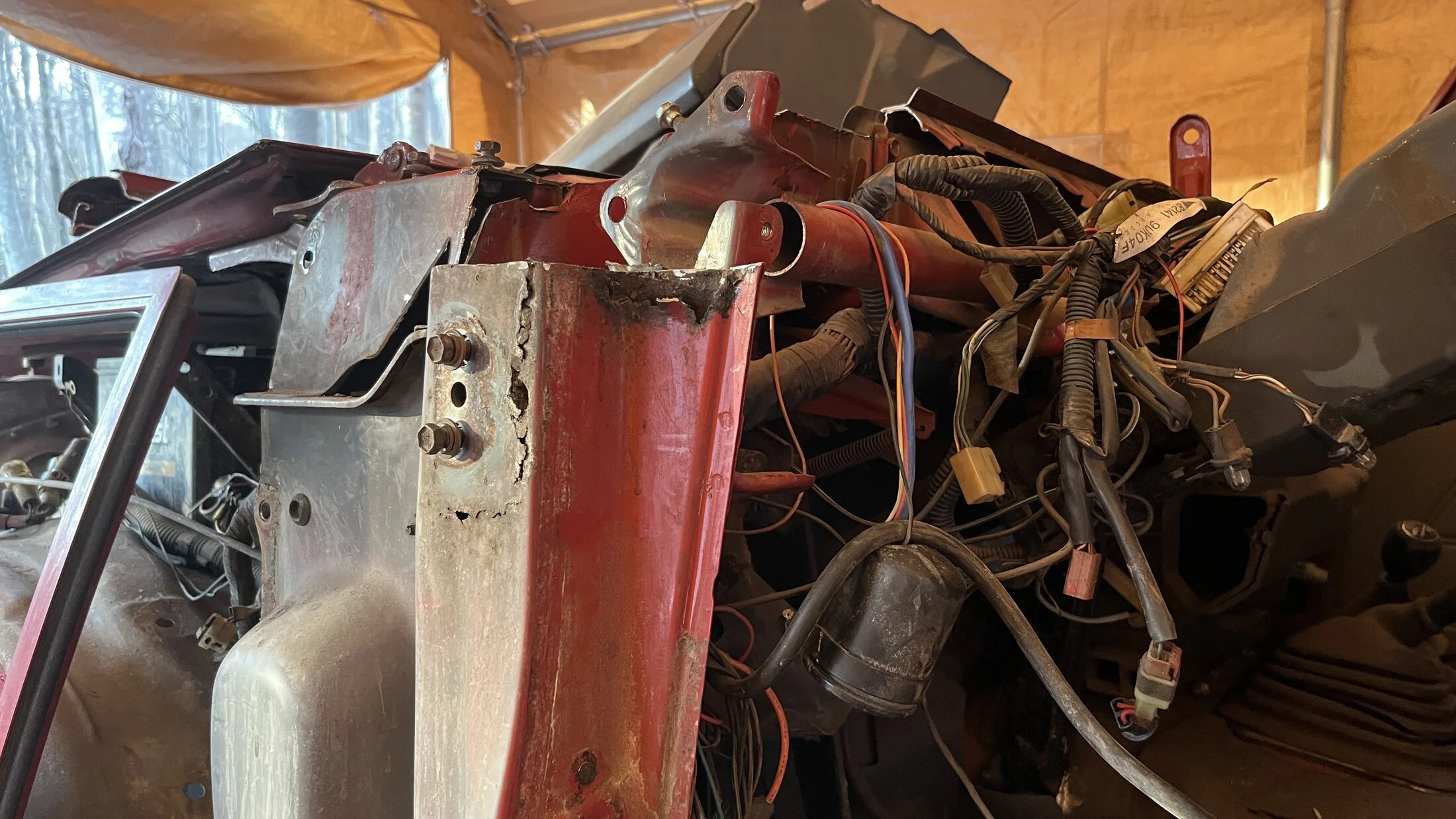

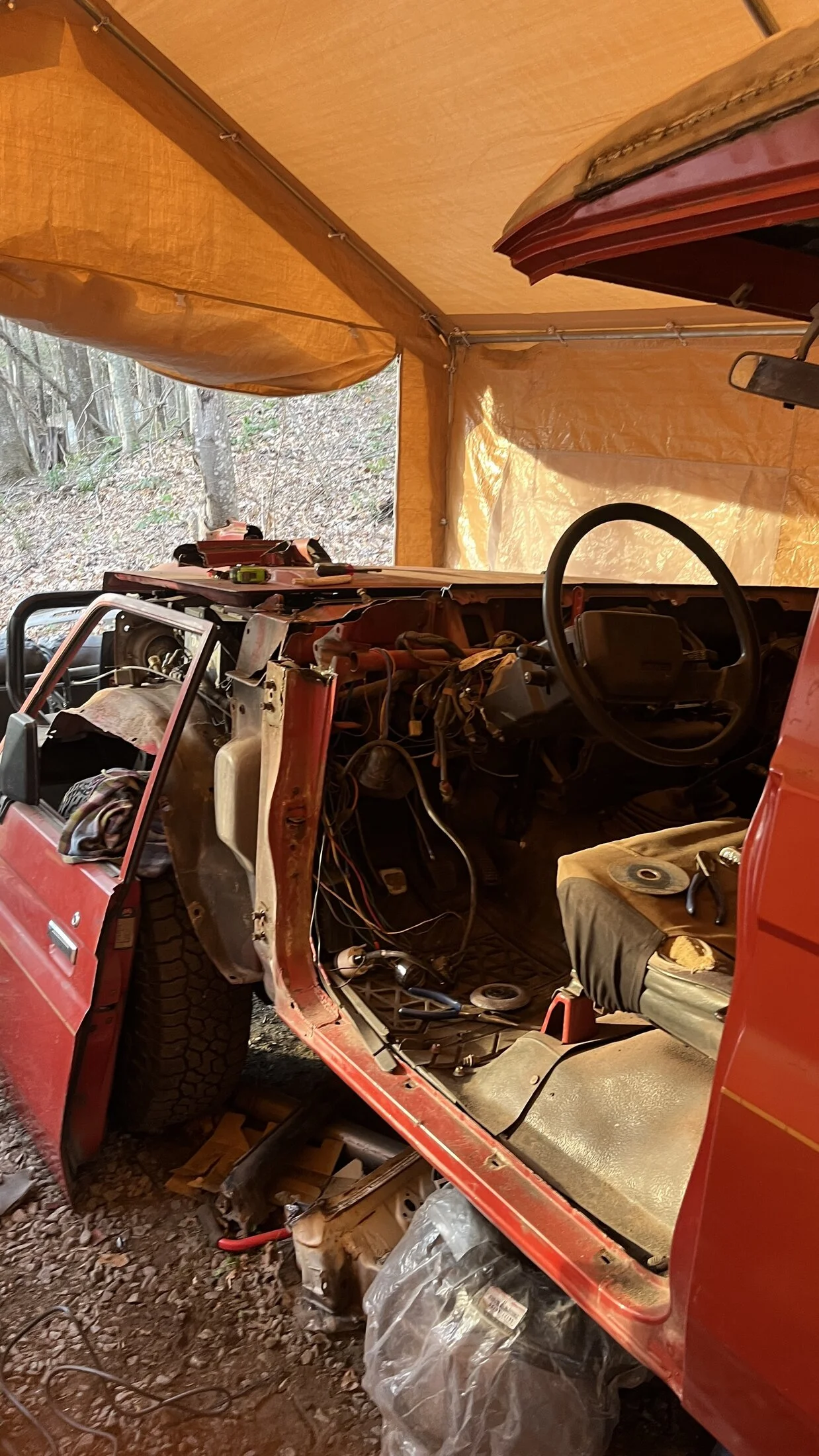

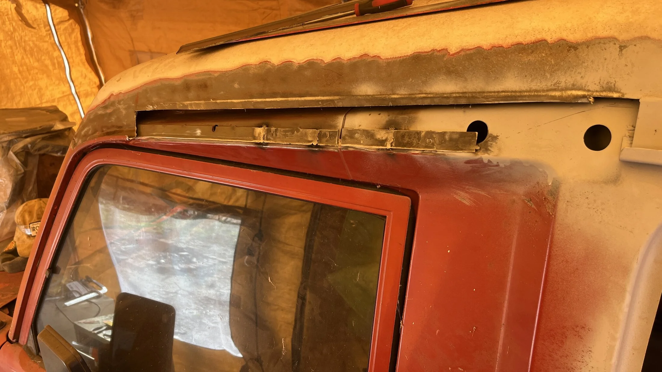

Finished most all of my welding on the passenger side and the floor, got the Red Rocket turned around and have started rust repair on the driver side! Lots of rot hiding away in all fun sorts of places.
and the somewhat finished product, still have a lot left to do just on this fenderwell alone

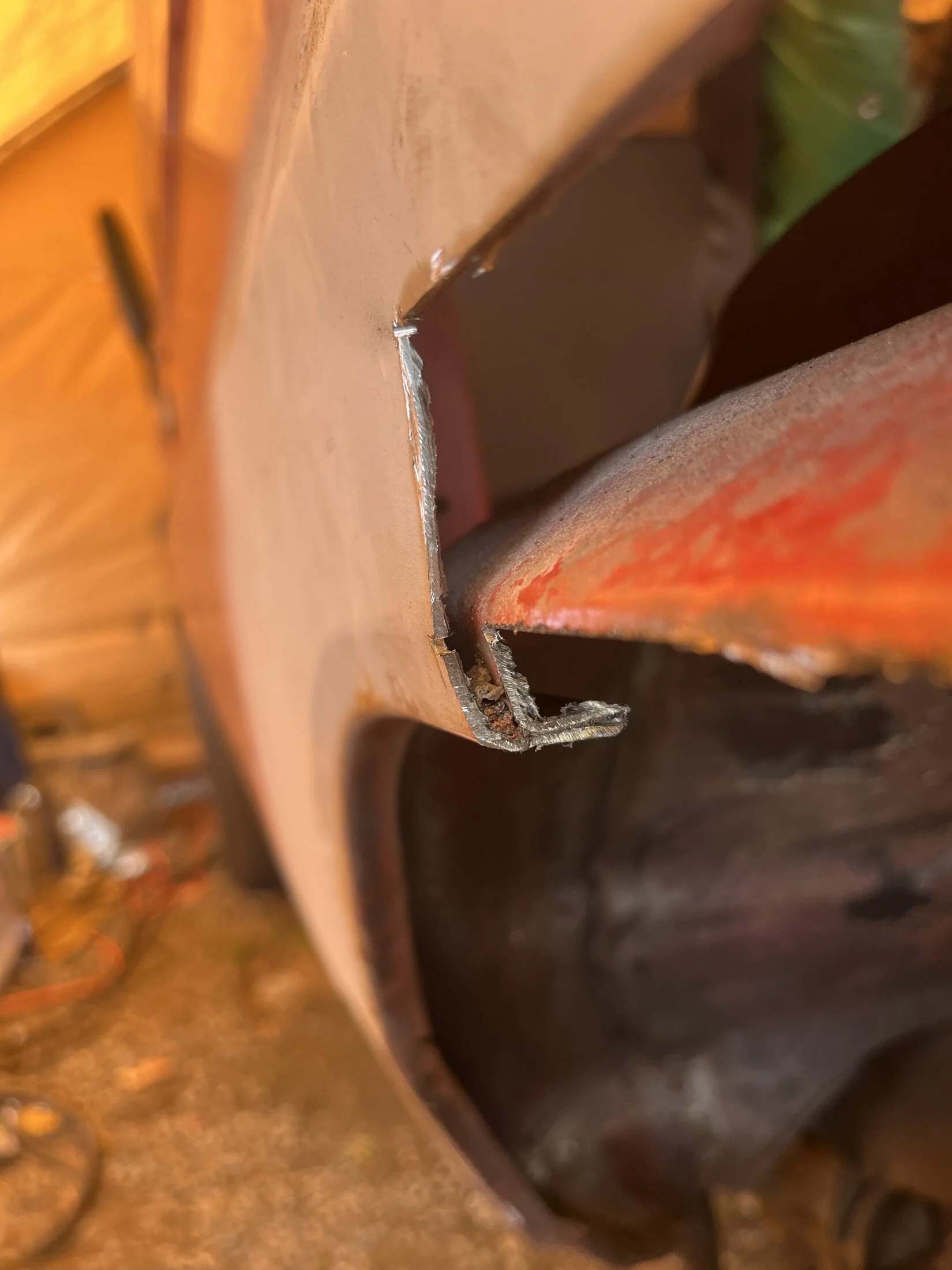

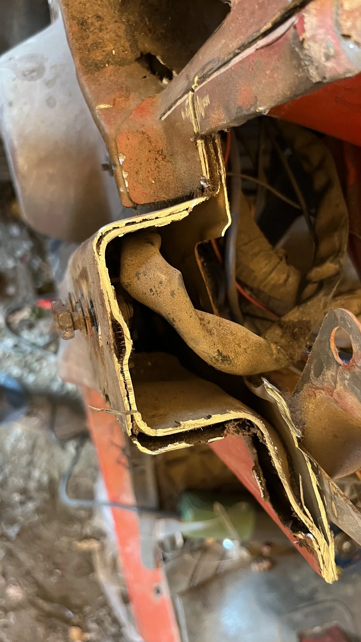

Just to give everyone with a 70 an idea on why these rot out, this is how it is designed... Honestly, it seems like planned obsolescence from Toyota. I'm sure there's a great reason for 2 pieces of sheet metal being sandwiched together, such as added strength and all, but seriously it's not surprising that these are prone to rot out. If you own a 70 or similar series Land Cruiser and have easy access on the inside, I would highly recommend spraying fluid film or some sort of rust prevention down into that channel from the inside.

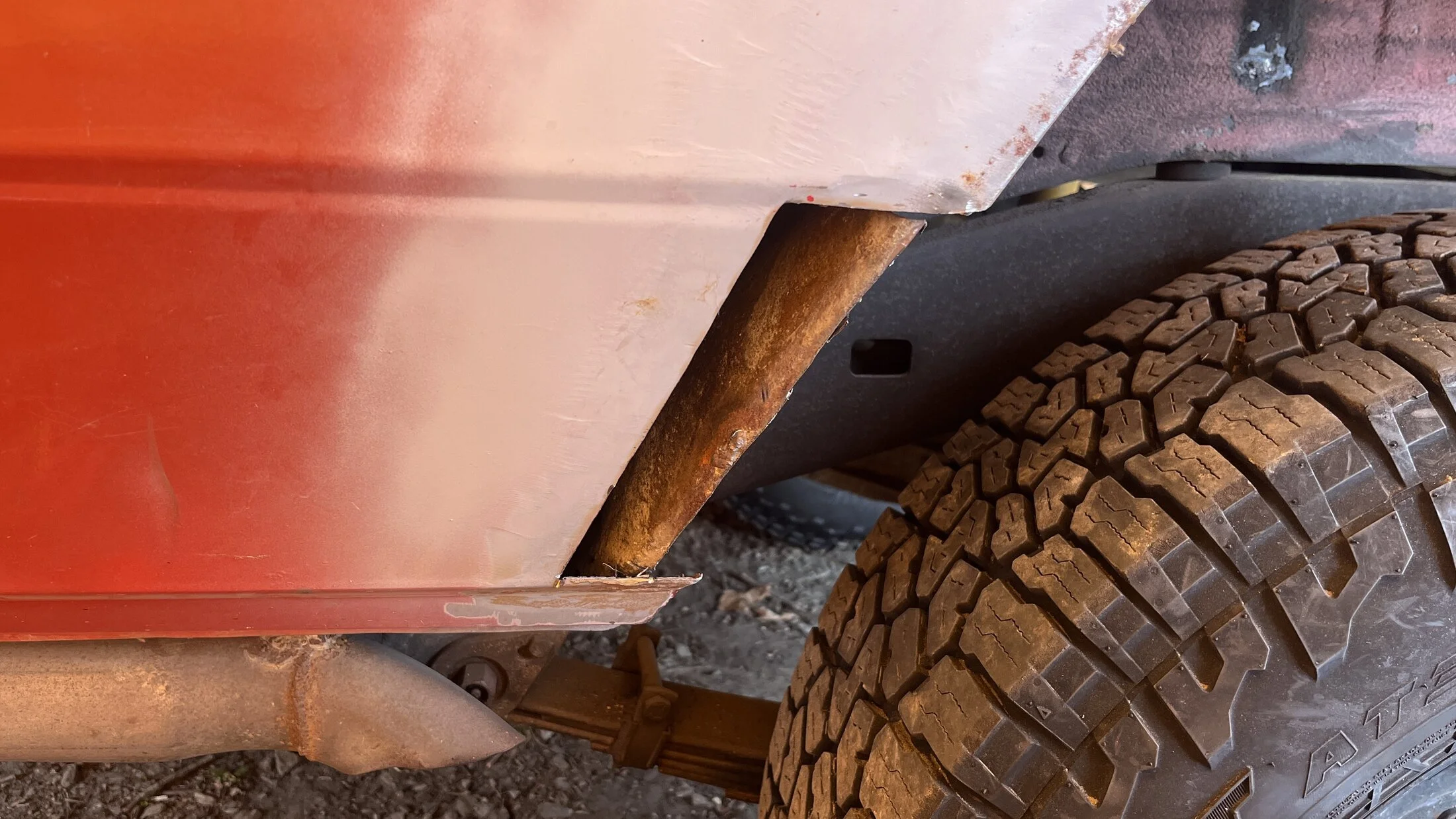

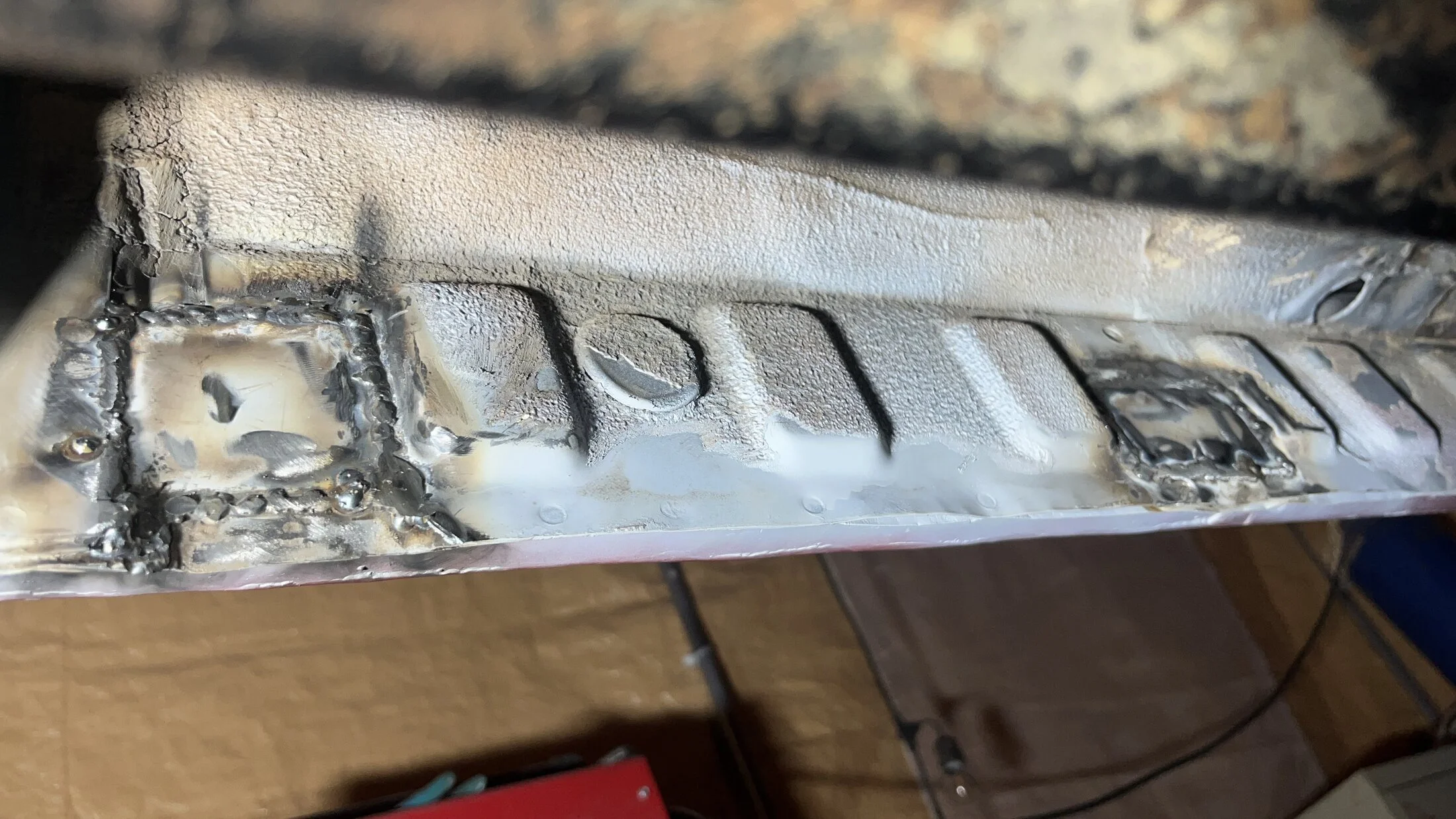

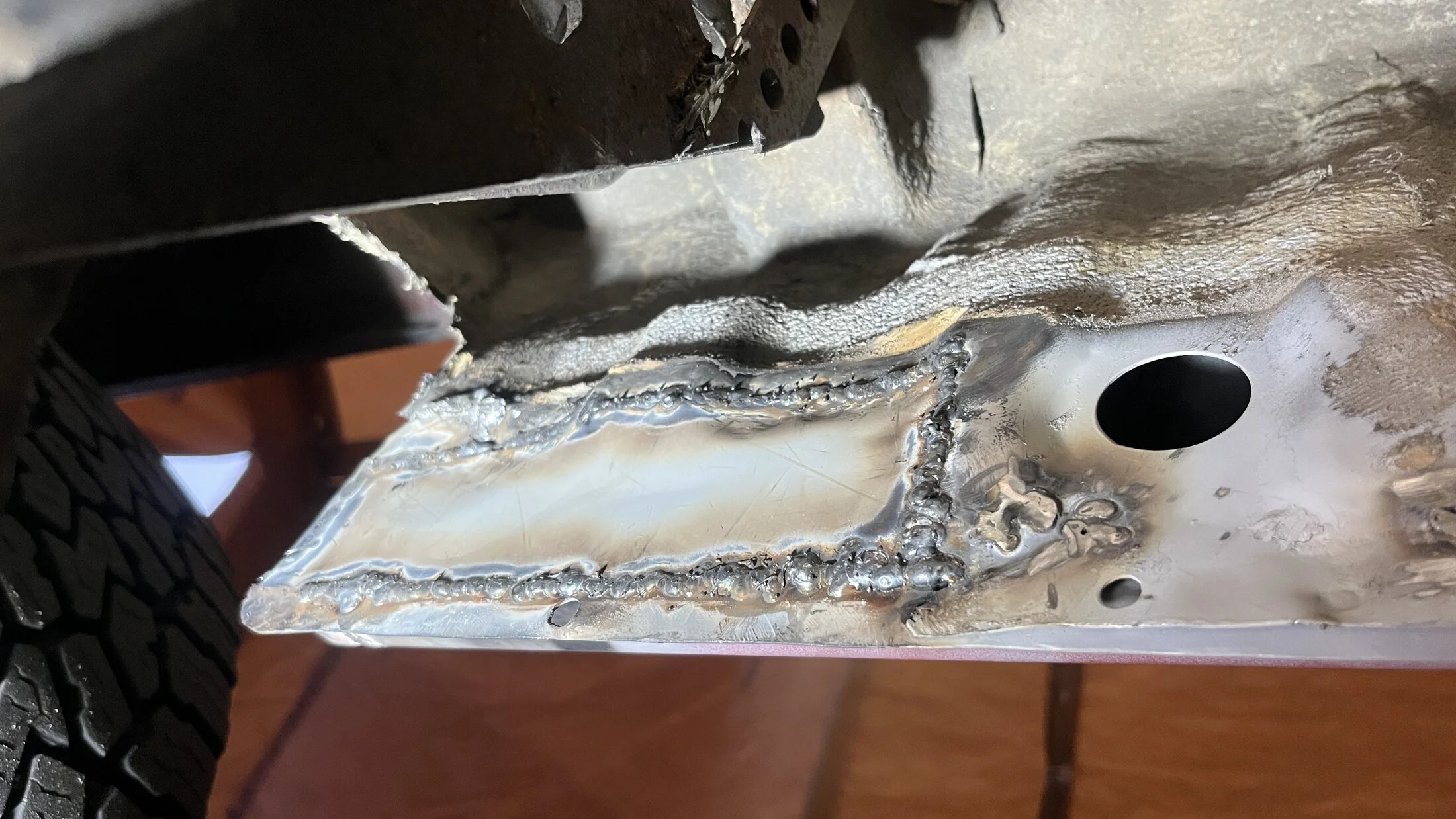

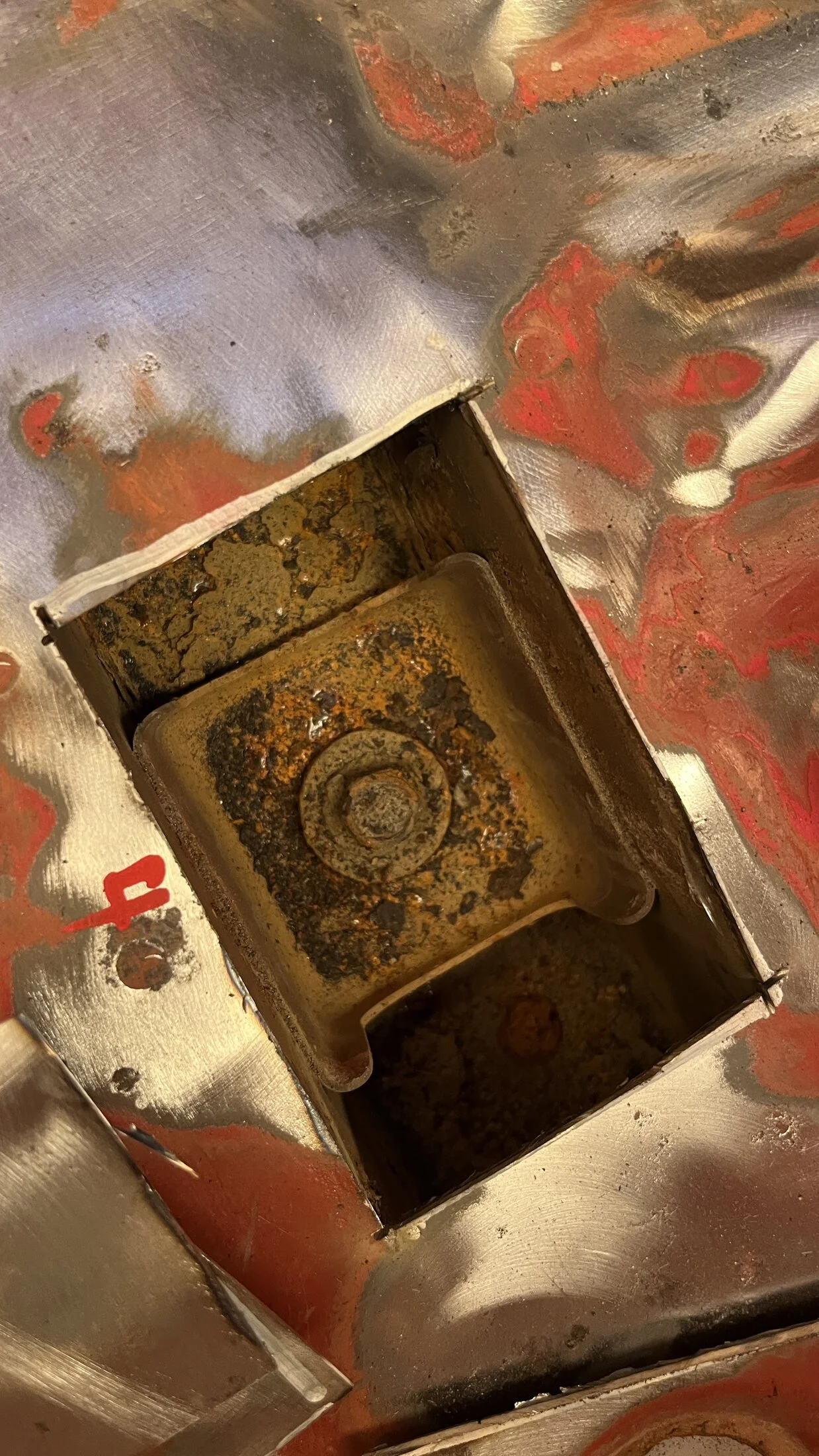

More progress as promised! Picking up right where I left off on the last post, I had discovered a nasty, crusty, rusty mess hidden inside my wheel well/rear rockers. Well I cut out all the cancer, made new bits and pieces, and glued them in. That sandblaster has been a lifesaver for neutralizing rust where a wire wheel cannot reach. The inside was rust converted, painted, and will be cavity waxed when the final paint job is hardened.
This rusty plot of metal on the inner side of the rocker was tack welded in only the corners, slathered in a bunch of silicone to cover it up, then undercoated, to fully conceal it.
And here is my repair, unlike the frenchmen who were in here before me, I have actually fixed the rust problem. Cut out all of the rot, and put some new skin back in place!
And some smaller patches on the inner side of the rockers where there were a bunch of rusty holes through the metal in these spots.
It might not look like much, and surely isn't as interesting or pretty as when I was taking the troopy on adventures. But this is what yall are stuck looking at for the next month or so haha. This all took me roughly 6 hours today. Like I said, it might not look like much, but its so painstakingly time consuming.

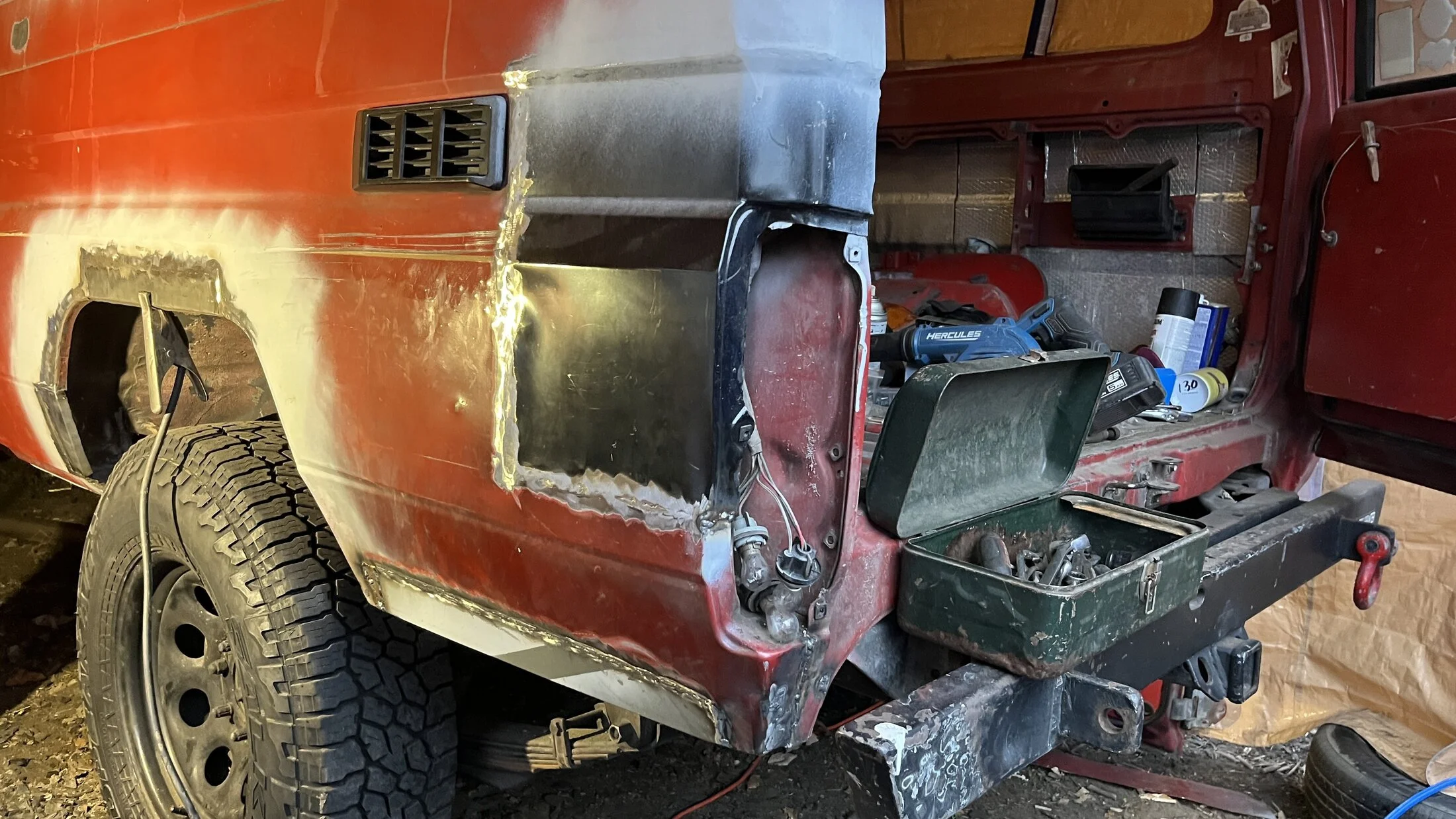

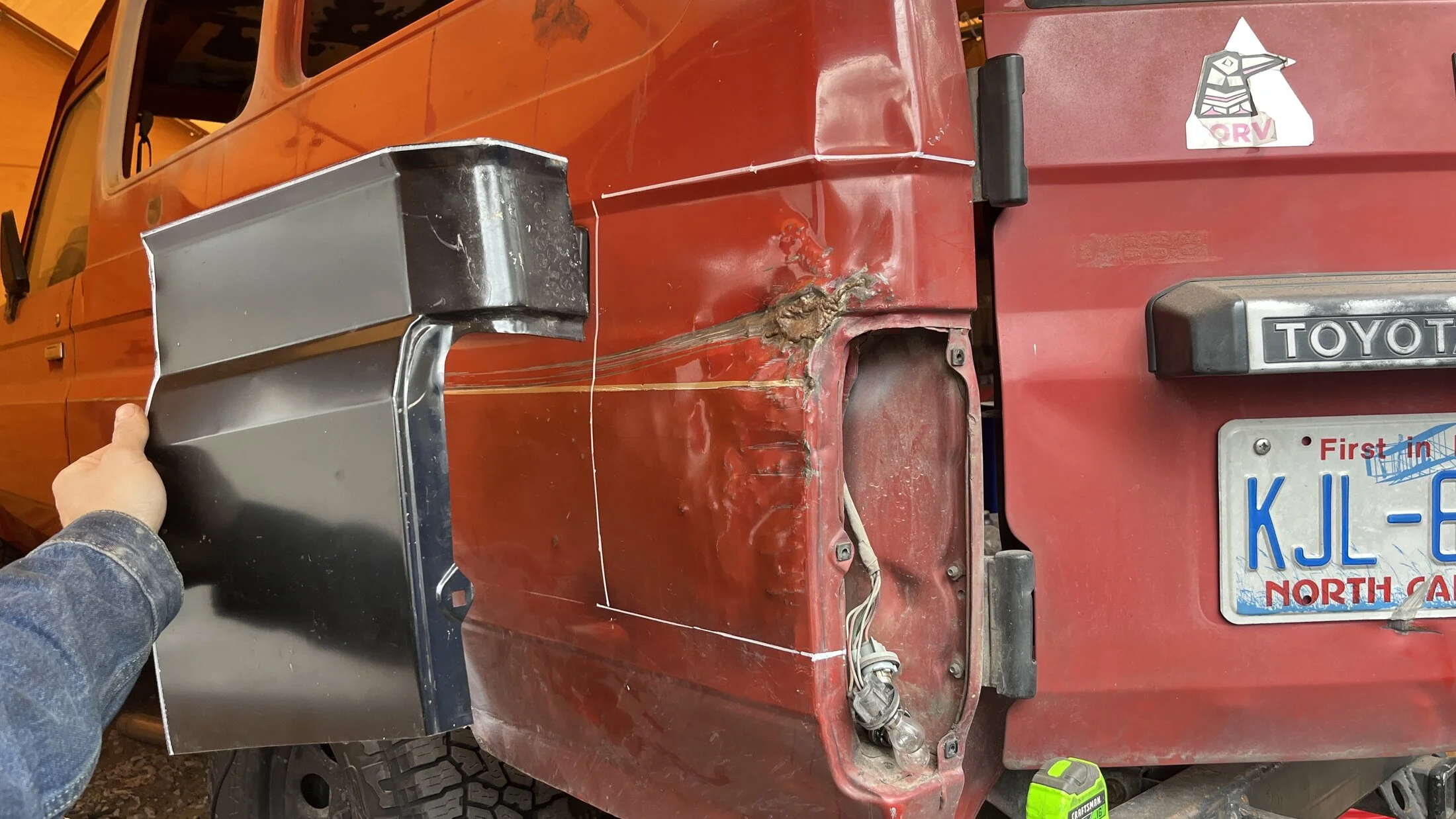

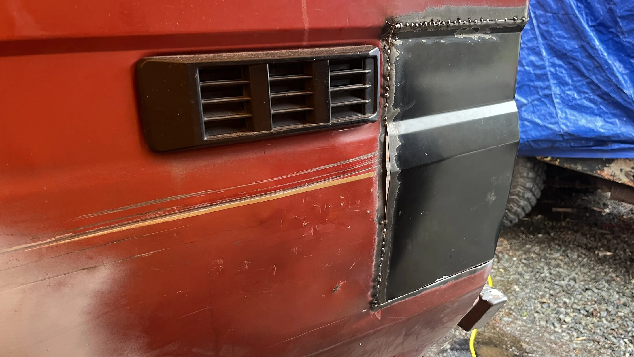

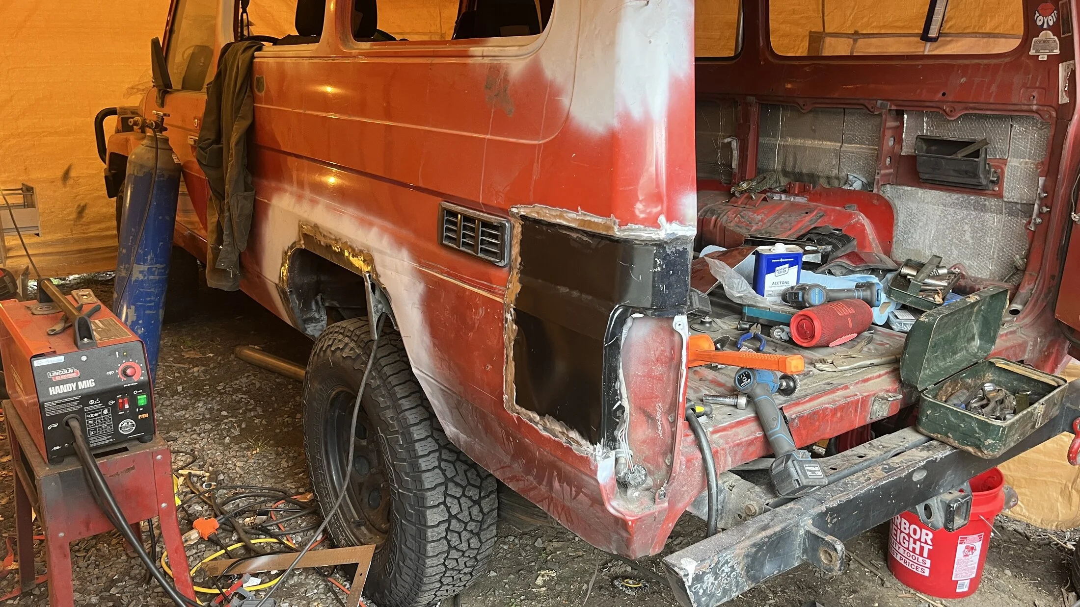

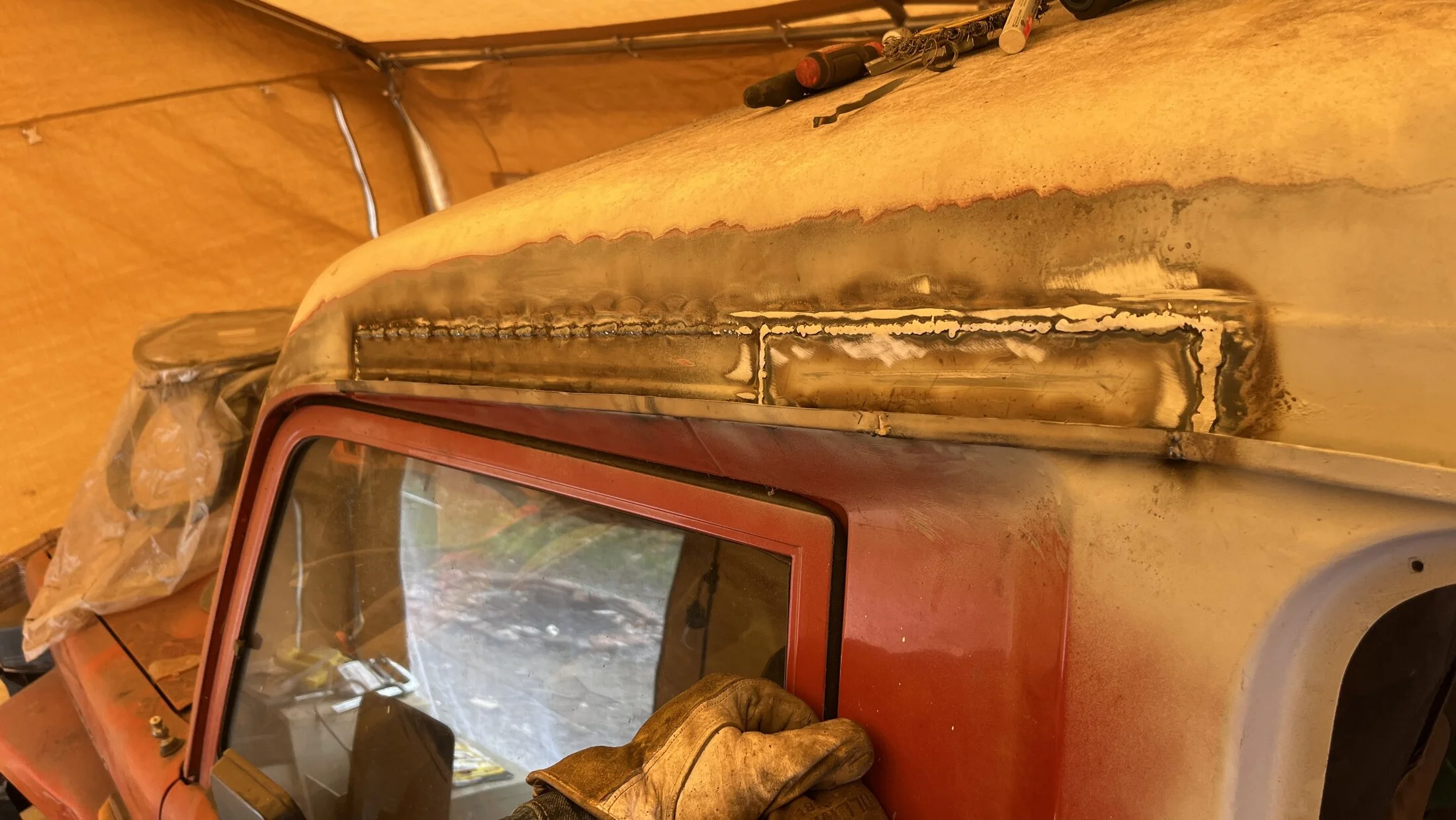

I don't work on Mondays so I got right to work on the troopy today. Finished the rest of the rockers and got right to work on the rear quarter.
Got it tacked in place
Due to the massive indent followed by me banging the dent out with an axe, things didn't totally line up. Had to do a lot of little metal massaging here and there but I got it all lined up after a while.
And here's the finished result!! Much better, it's still not perfect by any means because the whole quarter panel was crunched in from the wheel well to the taillight. But where most of the nasty crunched-up metal was, is now gone!

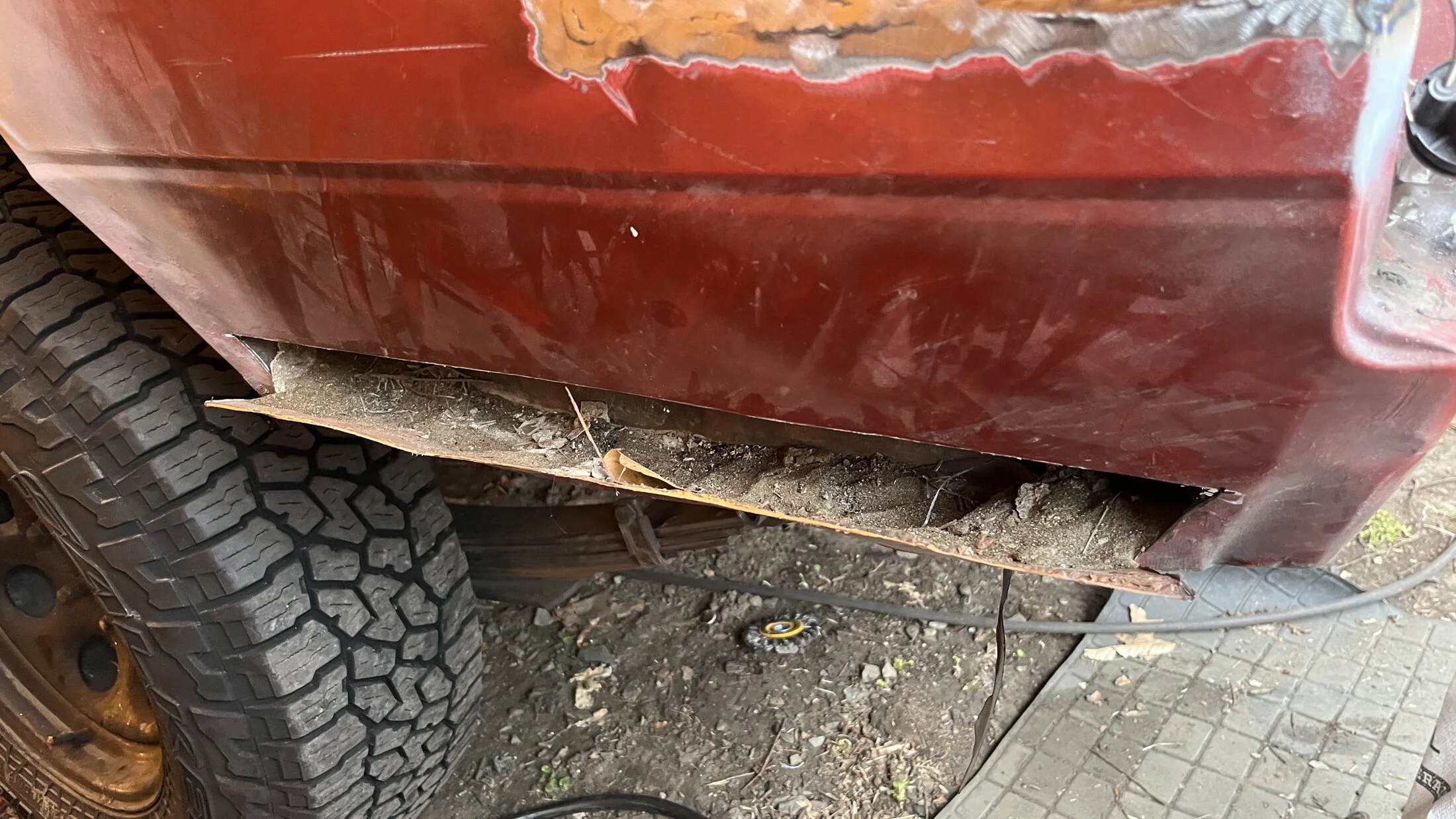

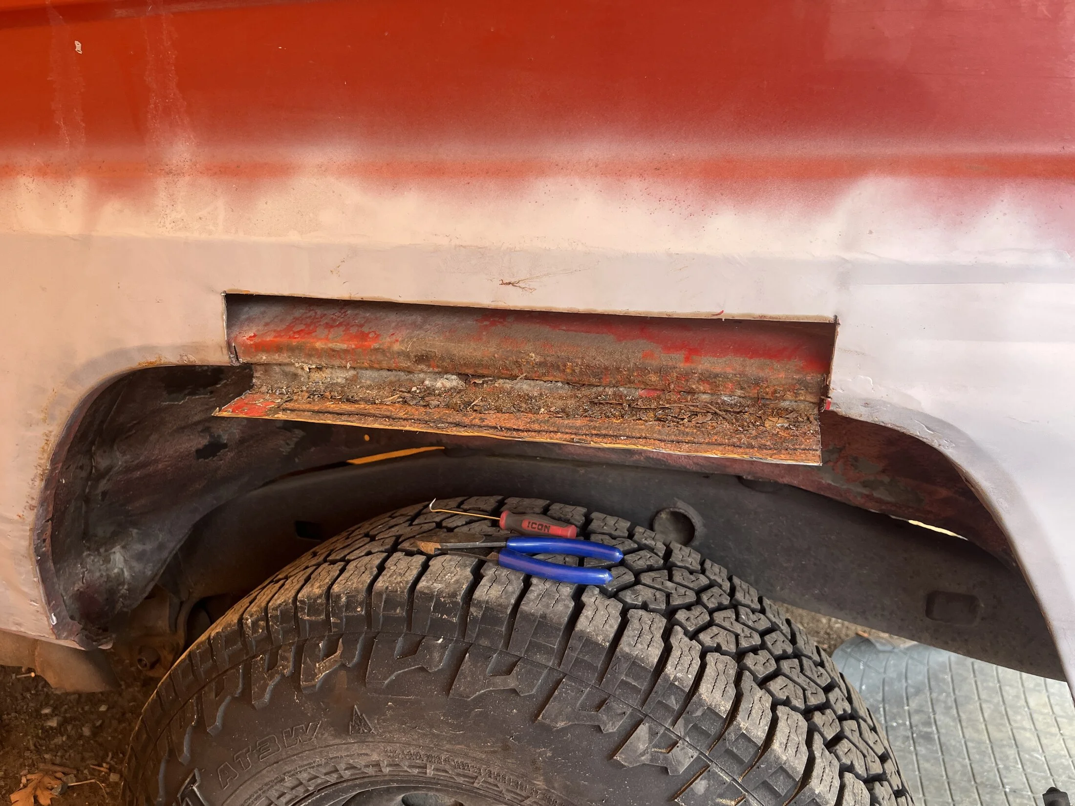

Near the end of the day I cut into the bottom of the panel just to see what I was dealing with.
oh man....exploratory surgury
I would highly recommend securing that gas bottle from tipping over. If it falls and the valve hits something on the way down the bottle could turn into a missile.
Noted, thanks for the heads up. Hard to tell in the pics but I dug a hole in the ground to stabilize it some, not by any means safe or a good way to secure it. Will have to weld together some jig to hold it upright. Seriously thanks for your concern.
I find it kinda odd that I didn't even blink twice while cutting massive external chunks out of this thing. It's so much of a POS that I'm not even scared or phased by cutting into my body anymore haha. I remember at first a year or so ago how nervous I was, a horrible feeling cutting into a car you love. Now it's just an everyday occurrence for me.
What size wire are you using ? .028 is way easier than the standard .O35 wire when doing sheet metal 😎

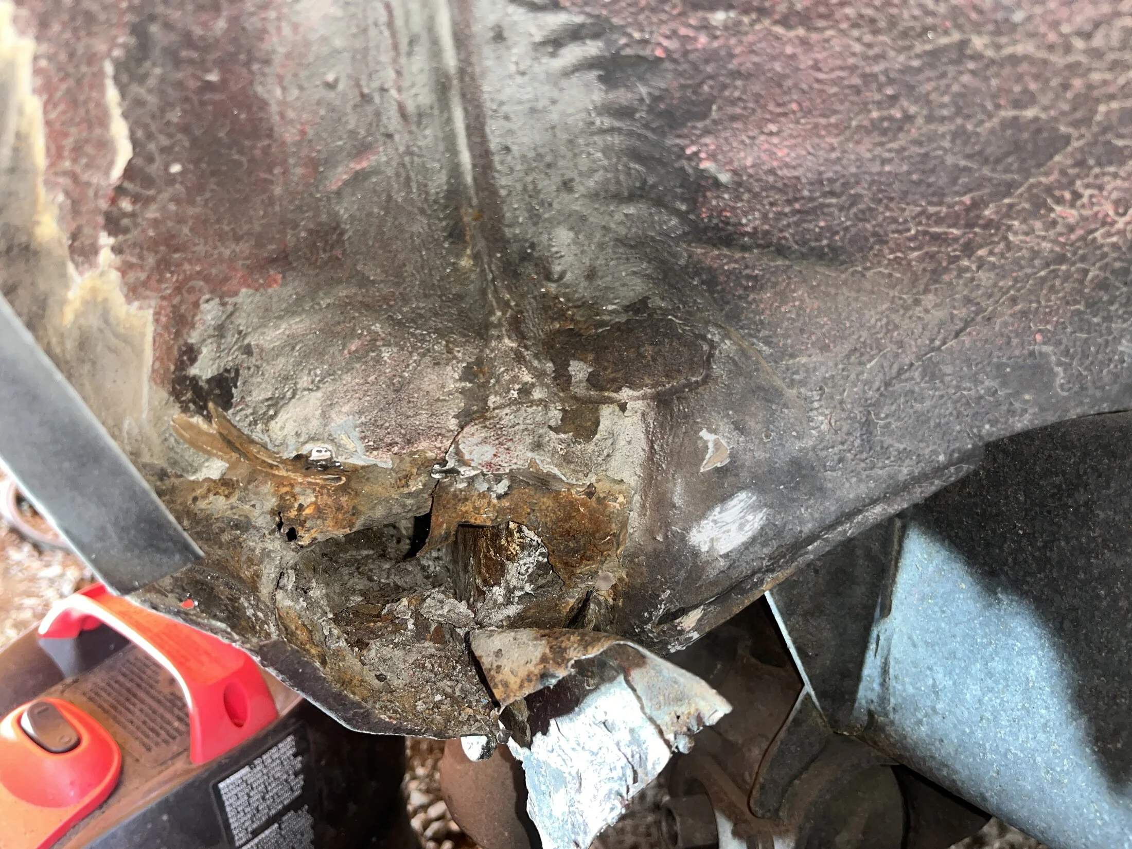

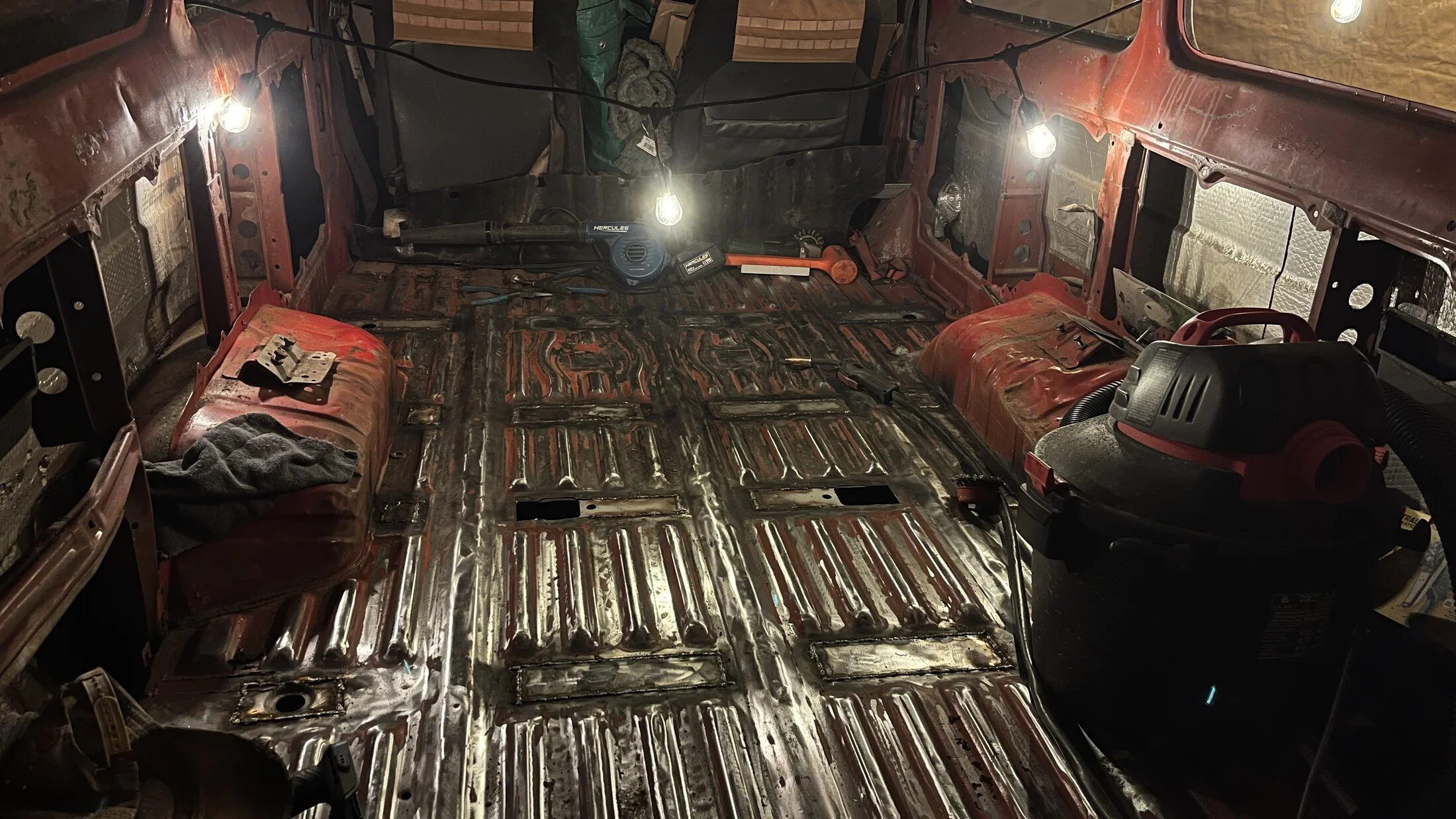

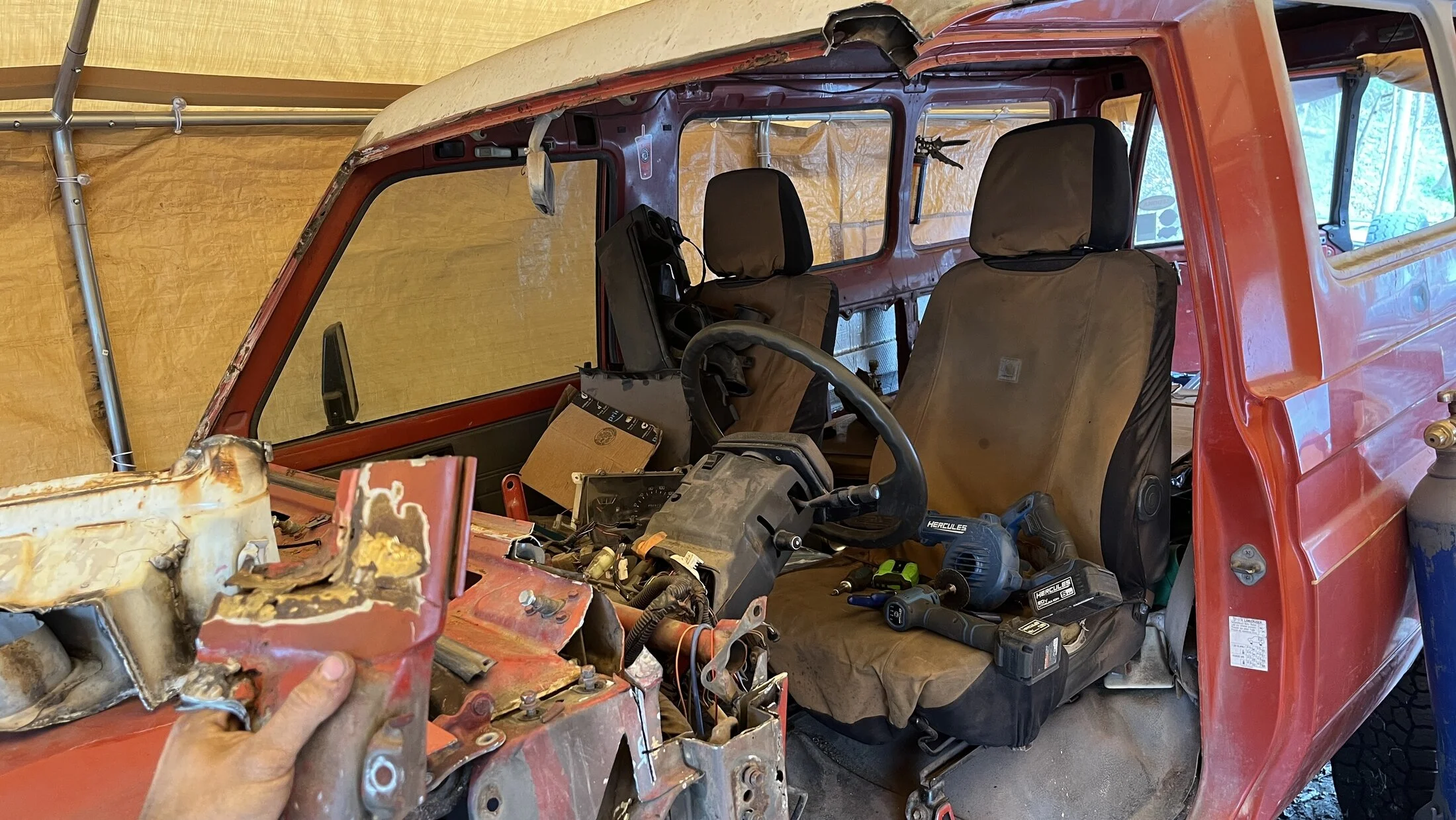

Wow, 2 weeks went by fast! Not nearly as much progress as I would have liked to make but I ended up in the ER from a cheese curd... yes a cheese curd... hitting me in the eye at an incredible speed and lacerating my cornea. Took my vision out for a bit but I'm mostly healed! Back to work.
Left off with cutting into the lower section of my rear quarter, lots of rot in there. atleast 10 hours of work put into all the little crevasses inside of there along with remaking the inner and outer panels for it.
I had a few little spots I didnt wrap up on before I lost all steam on the project last summer, dived into them and was pleasantly surprised to find, really no rust at all, peeled back the spot welds where most of the rust on these starts, cleaned up the few specs of rust and just put them back into place.
Finished welding up the back corner that was just left open for the past year. Looks bad in the photos but it'll clean up nice... nice enough especially considering a pop top will be covering up all of it
and finally a public service announcement to anyone reading this. Please dear god, never undercoat your vehicle. This may sound dramatic but trying to get through the 1/8 - 1/4in of rubberized undercoating where I can see it starting to peel apart from rust forming underneath it, is easily the most unenjoyable thing I have had to do to this vehicle yet. Me and my dad pulled and put the engine into this cruiser 20 something times in 90-100 degree weather under a tin roof shack, yet trying to grind away at this undercoating is so much worse. All it will do is trap moisture in-between itself and the precious metal on your Land Cruiser causing it to rapidly rot. The kind frenchmen I'm assuming did this before it was shipped off to make it look decent.

Welp, this happened
WHY ARE THERE 2-4 LAYERS? JUST MAKE 1 THICK PIECE OF METAL!!! I have been screaming at the middle-aged, elderly or dead Japanese engineers who designed the 70 series way back when.

I had to remove the undercoat (like bedliner oem) to fix the rust. It been the worst job ever. Used a needle gun...
Didnt even think of using a needle gun, I'll give that a try maybe it'll work better!
