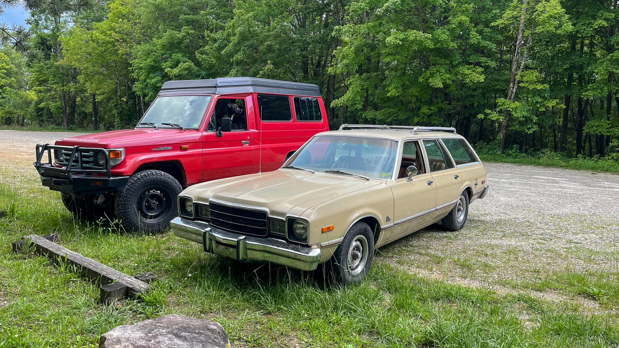

Got that crusty 60 running decent enough to limp it up to Boone, horrible intake gasket leak was not fun to deal with but it drove the 300 or so miles, abliet very slowly.
Then I got home and immediately got a message from a guy who I met in a parking lot 2 years ago, I gave him my number jokingly if he ever wanted to sell (i don't remember any of this). He said he urgently needed to sell his 1977 Plymouth Volare wagon as he was moving to St. Louis the next day. I showed up fully intending not to purchase the car, really I didn't even remember meeting him or what car he was talking about, I was just curious.
Well I take it on a test drive, check it all out, and he keeps asking "well?!? Do you think you're gonna buy it?" and I keep brushing him off because I didn't have a casual $5,000 to drop on this car, AND I had nowhere to put it. At the time my driveway already had 5 cars in it. He keeps asking, and I tell him I have no interest in buying another car at the moment and already have way too many projects going on... So I offer $1000 to shut him up. Well he bit on my lowball and now I own a Plymouth Volare!

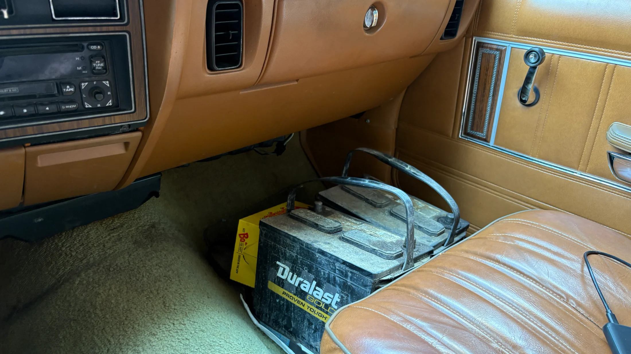

3.7 liter Slant 6 and some sort of Chrysler Autotragic Transmission, 58,000 original miles, not too much rust at all. I've been driving it daily for the past month and it's been relatively drama-free

Check out the mint interior in this wagon

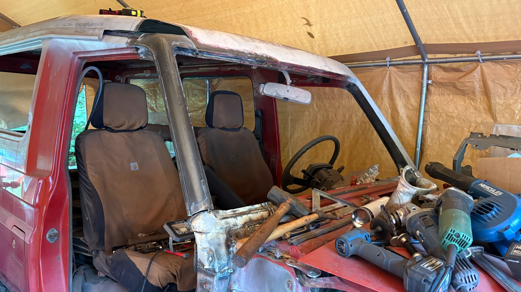

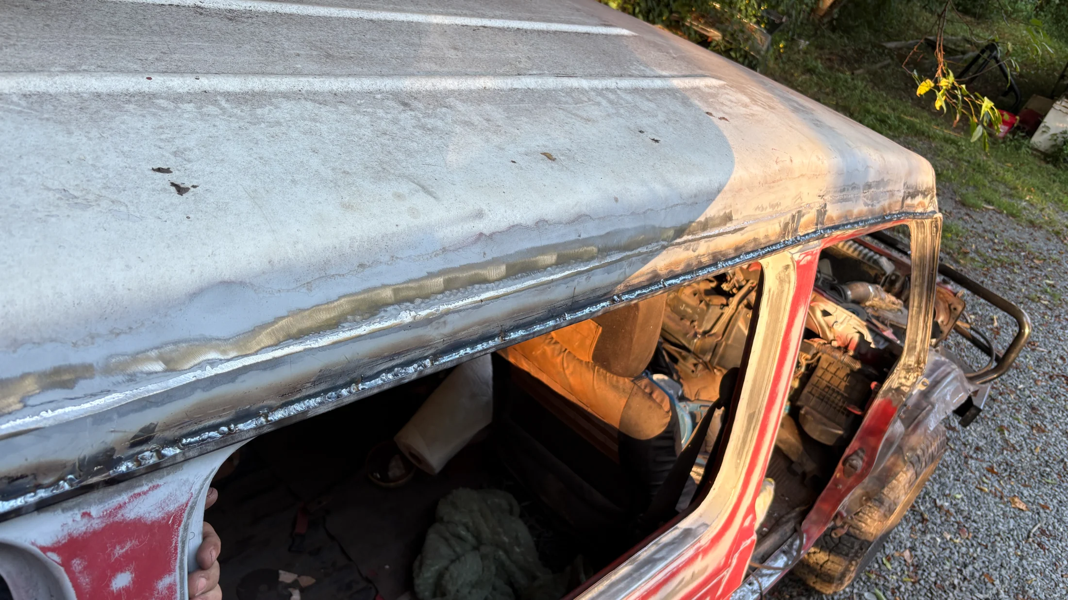

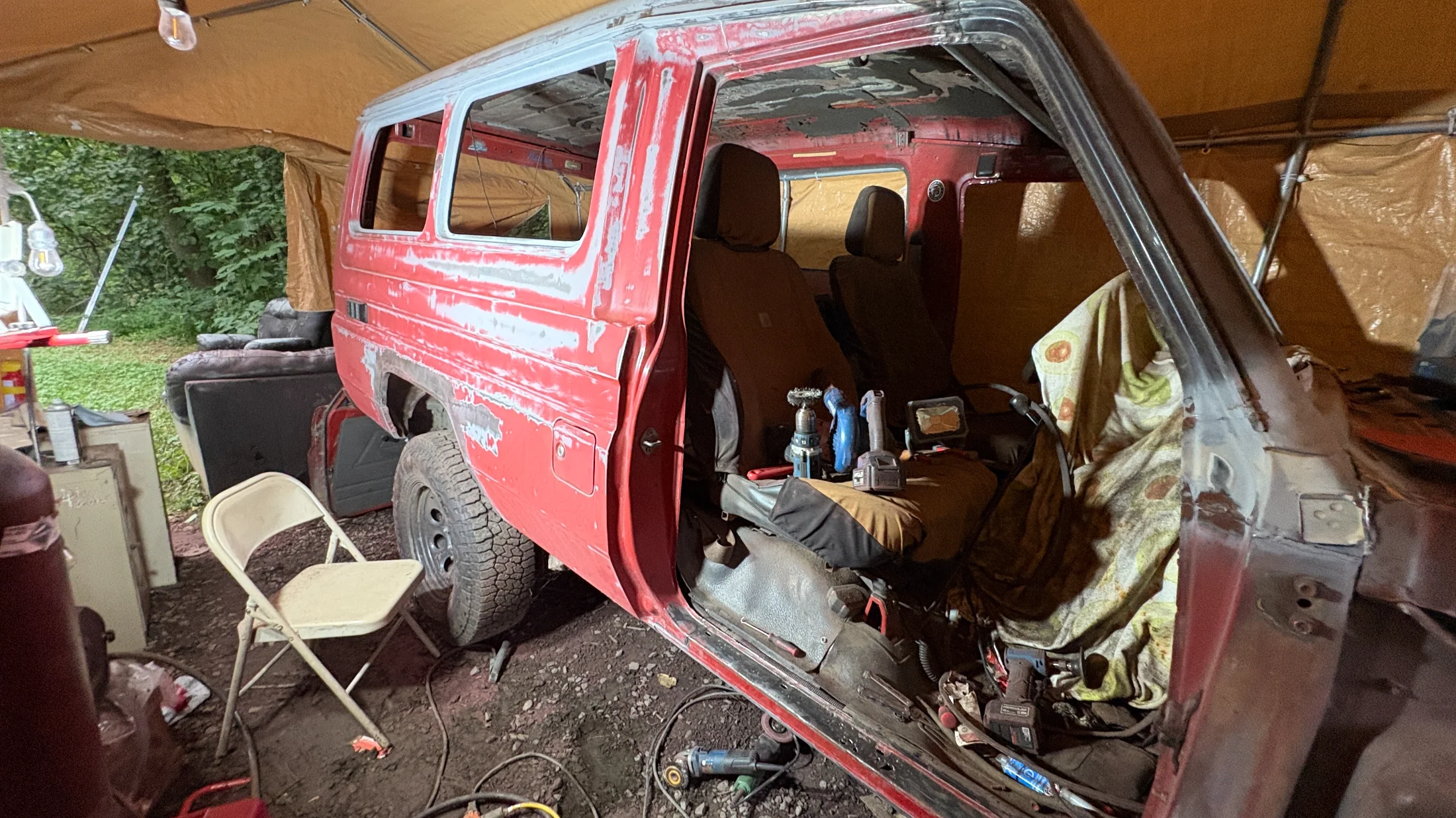

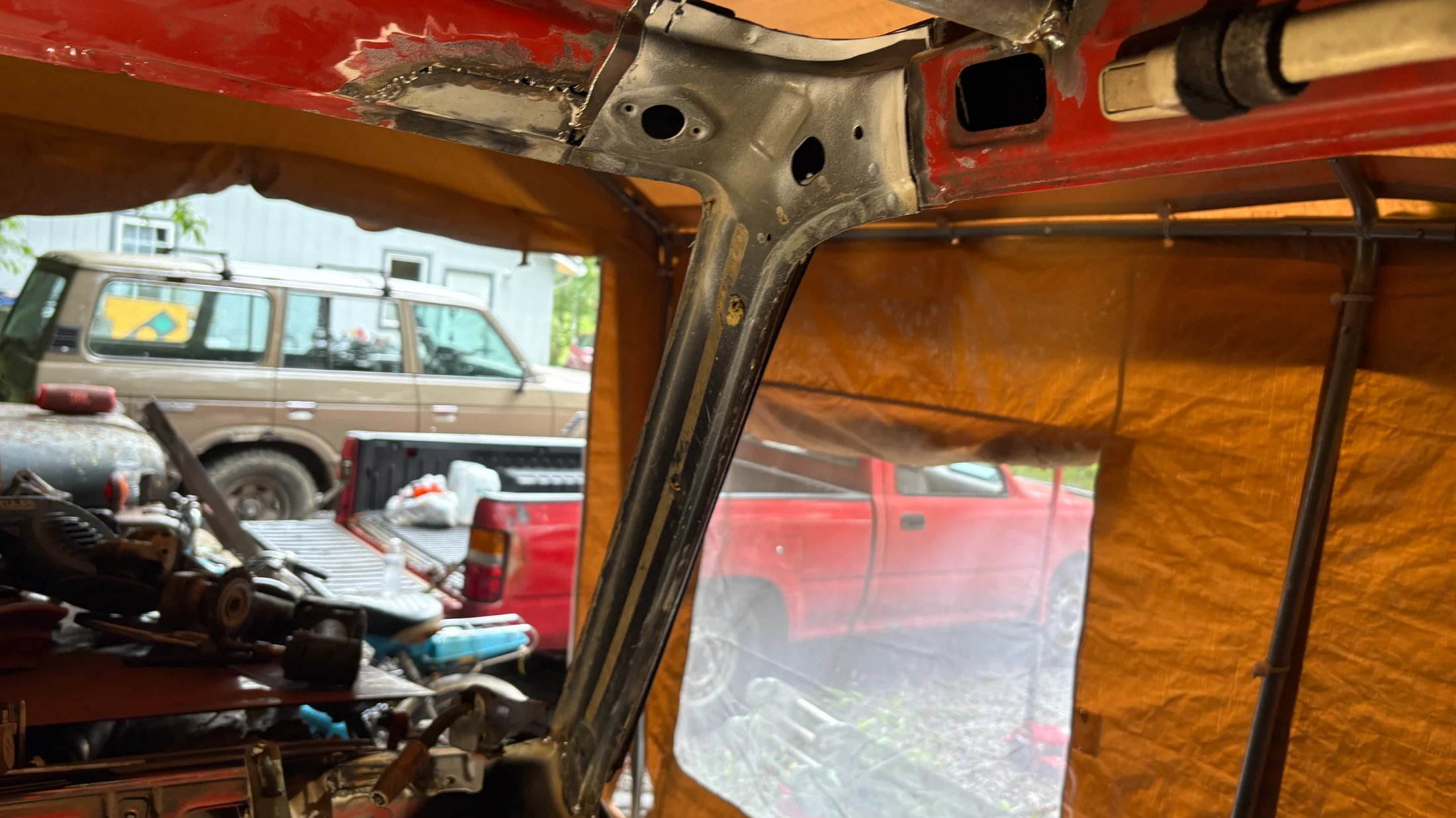

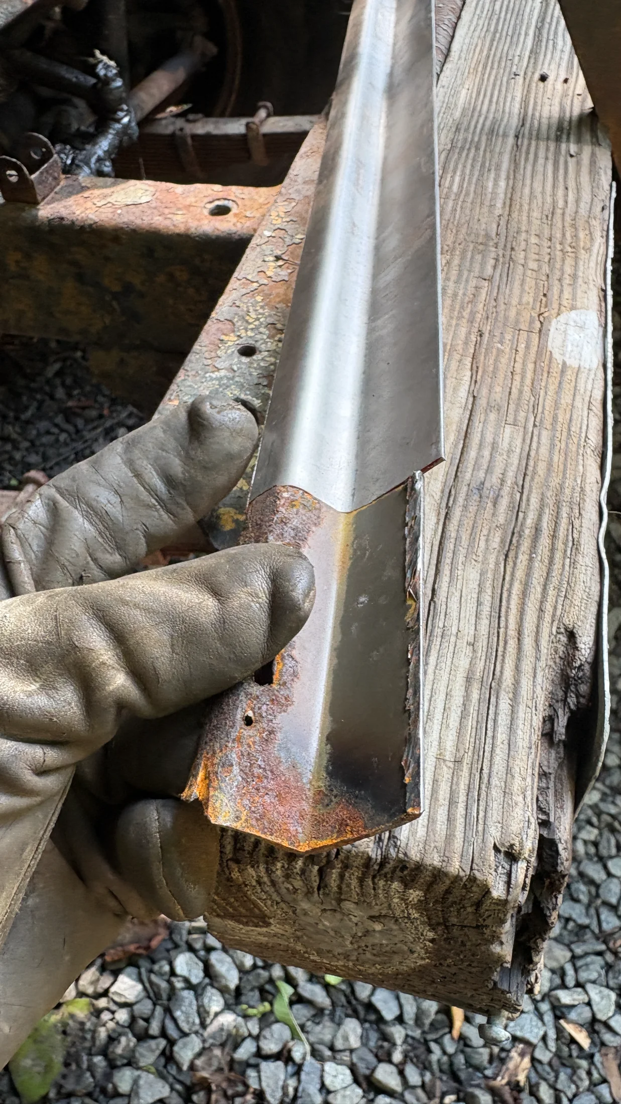

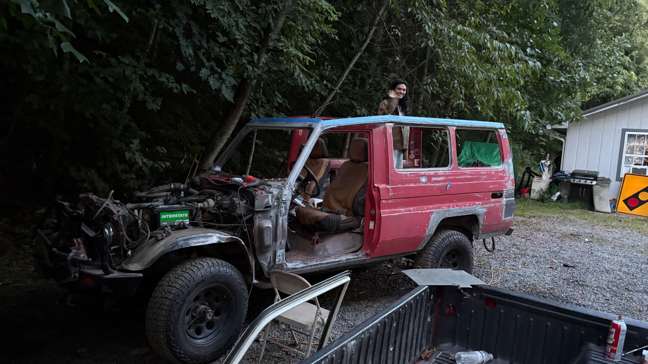

ALRIGHT! MORE PROGRESS.

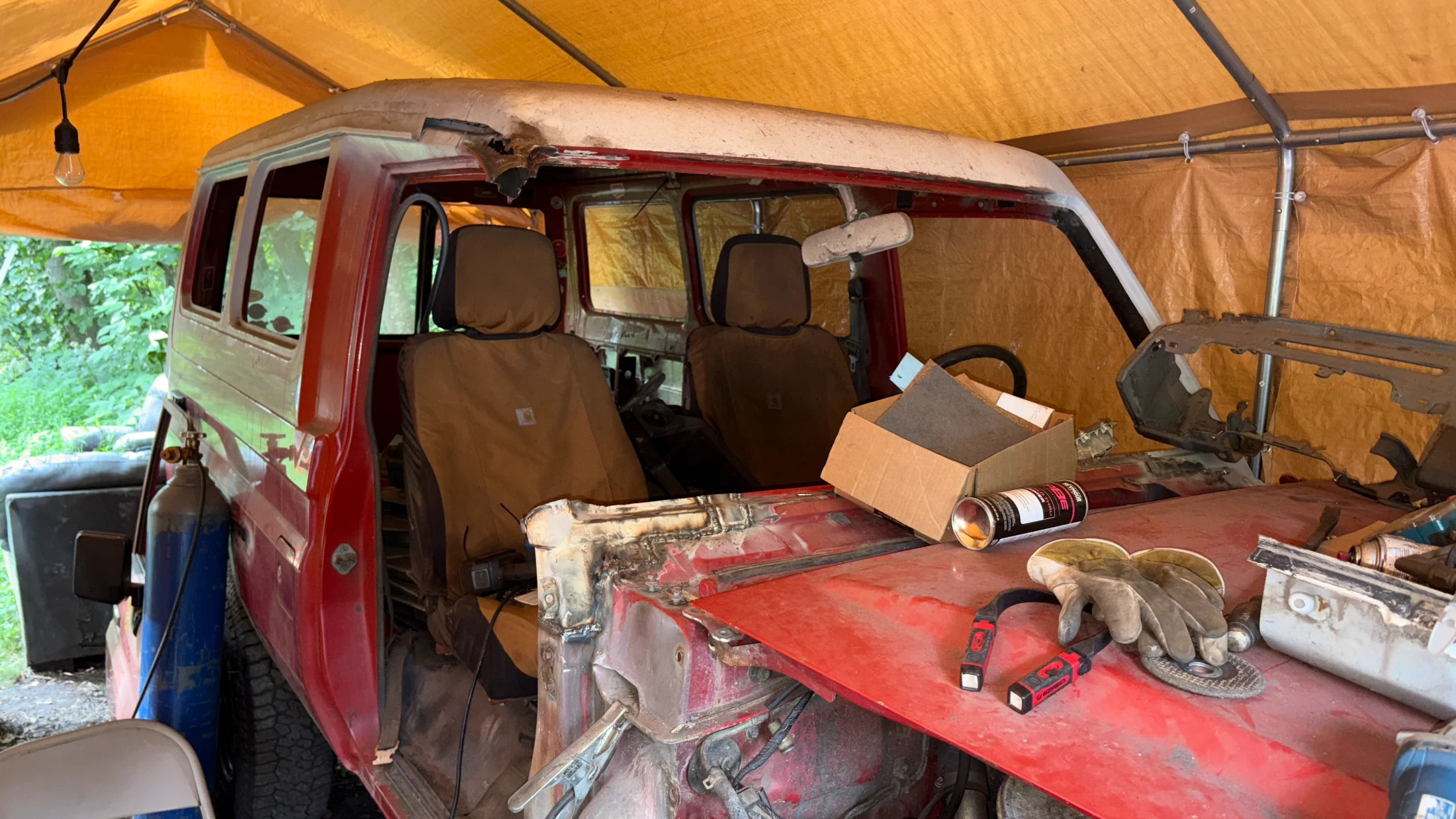

Cut out the crusty A-pillar and firewall, welded in new firewall section (excuse the gas bottle leaning against the troopy I made a little baseplate thing for it to keep it stablish)
Test fitting

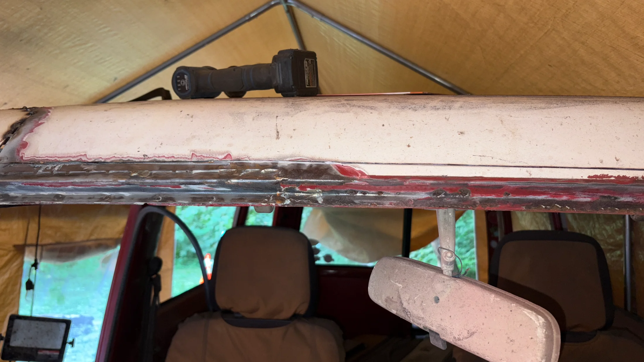

Got that all welded in and then started on the upper part of the rotten out windshield.
Used our 85 year old WW2 metal brake to make a new panel to weld in.
Checking the fitment and angle of the new 44-inch piece
anddddd got it all welded together. THAT'S IT! like 97% of the welding I need to do on it, there are little spots that pop up here and there while I'm sanding the paint down but THATS ALL THE BIG STUFF

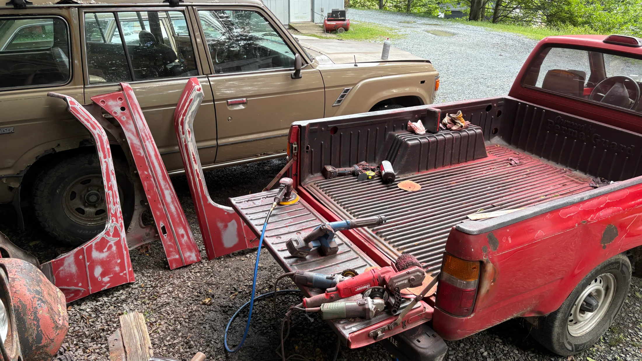

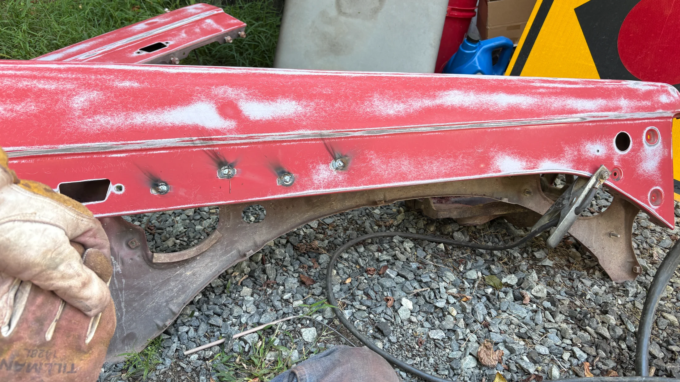

And so now it has begun. I've started sanding every panel down with 80 grit so this real fancy epoxy primer I got will adhere correctly. I know absolutely nothing about paint or bodywork. Just going off of google and youtube, so if anyone has any advice, please offer it!
Looking back at all of this before I post it, it really doesn't show just how much work all of this was and is. Those videos make it seem so easy 😂
Test fitting

My only recommendation with body work: wear a respirator!
Your older lungs will thank you!
Watch your fingers around that press brake. If you're holding a piece of metal in place while the jaws squeeze down and you squeeze it too fast The metal can bend and trap a finger not between the jaws but between the folding metal and the face of the jaw....... I worked in sheet metal fabrication for a while before the Army. We had a Navy vet on my shift that only had one arm. He was using his one good arm one night and his "robot claw" prosthetic bending 7 gauge. He squashed his only thumb. Started turning green a couple days later. He was a lot more upset than the other people that had cut a finger off at that place....... Be careful and don't be that guy.
It's great to see the parts from the other side of the globe going in.
Get wax and grease removers, the normal solvent kind and the water soluble style too.
Spend extra on them to get the good stuff. Get a zillion shop towels.
Use a tack cloth.
Epoxy primer is awesome.
Sand it and wipe down before final color goes on.
I keep wax and grease remover in one of these: spray on, wipe off.
My biggest advice for painting is lots of blocking and priming until the surface looks good. I did several coats of epoxy with blocking then 3 coats of high build urethane with some blocking on the samurai before I did the color. try not to drip sweat in the paint like I did on the hood! also like @jblueridge said wax and grease remover is your friend.

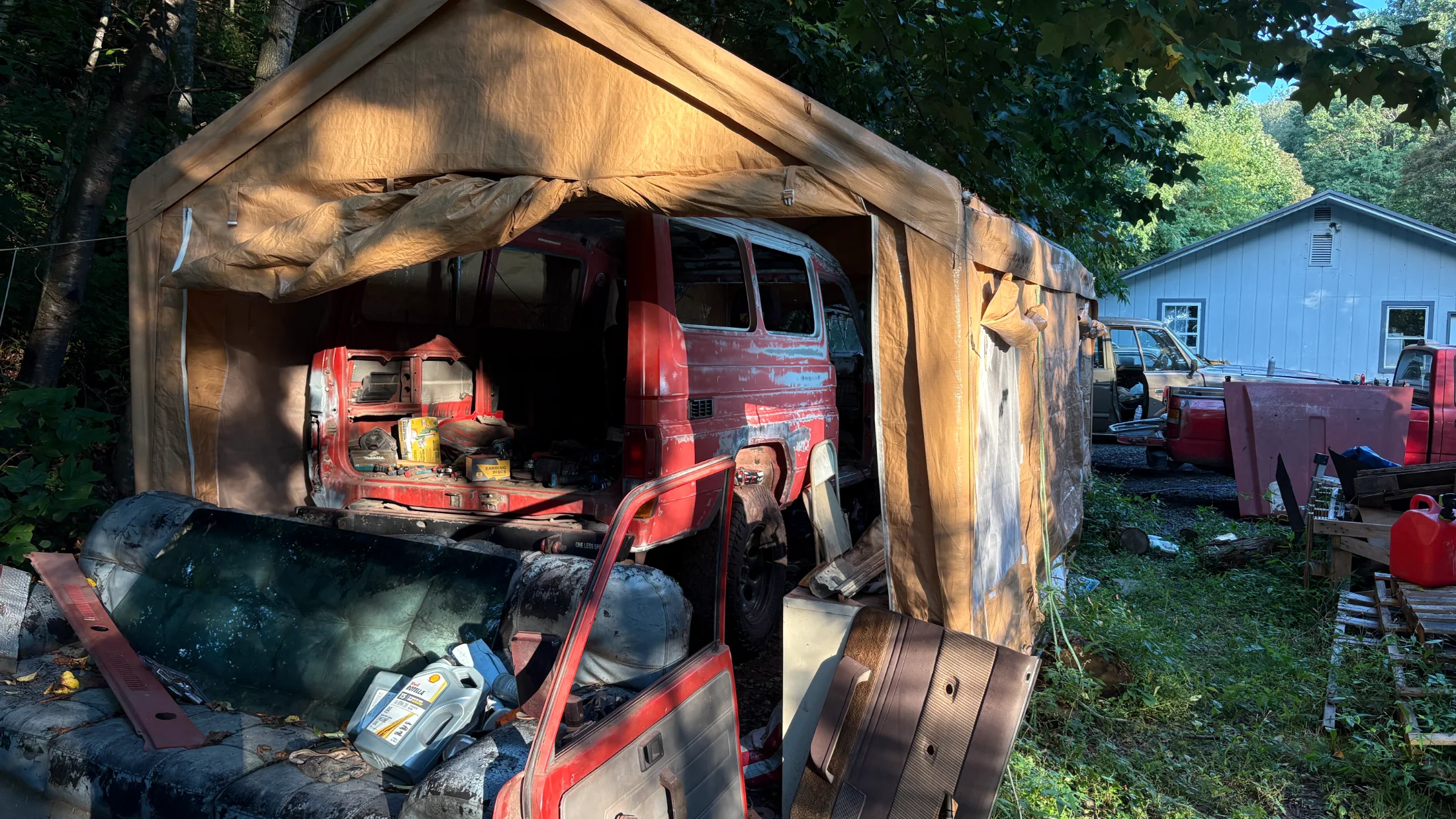

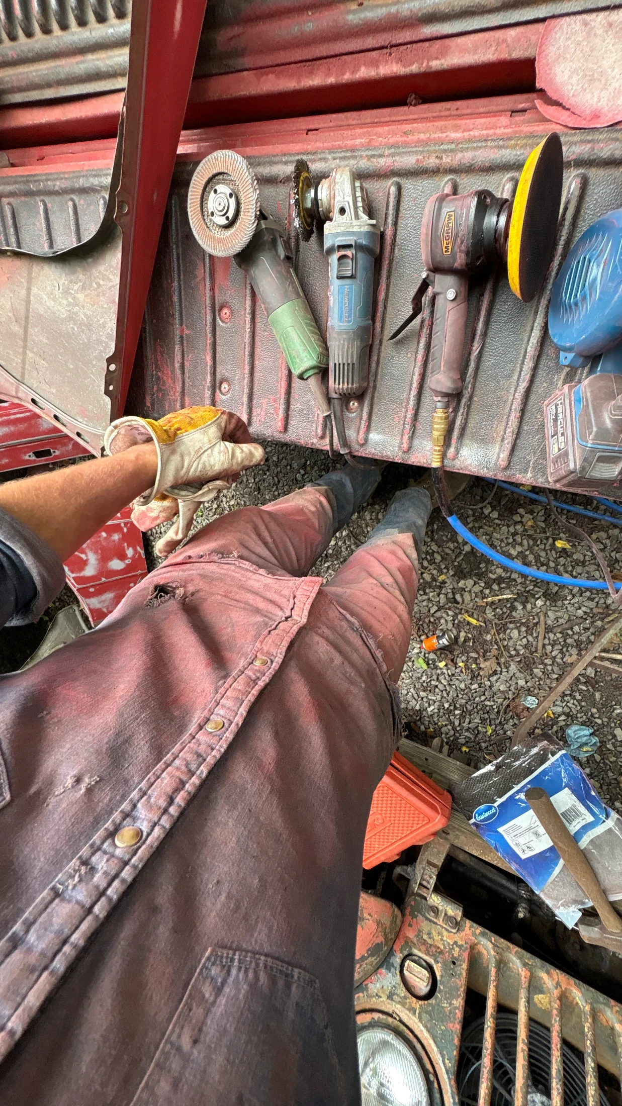

Alright well, my air compressor decided to eat its belt, which I inspected prior and it looked totally fine. Halted my progress immediately, so I tried to make this negative thing into some sort of positive bit. Organized a bunch of crap, cleaned up my working area, got the troopy running again, fully welded the roof up cause I had nothing else to do.

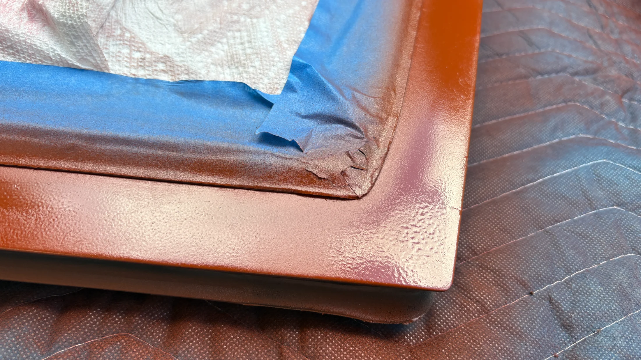

A potential major paint issue:
Something I wasn't aware of was that I can't paint/apply this this epoxy primer if the temperature drops below 65 degrees, that is the bare minimum. Not a degree less. The leaves here are already changing and the temps are dropping down to 50 degrees or so. I've thought a lot about my options and settled on buying one of those diesel heaters that people heat their rooftop tents with, and I'll see if I can insulate the temu carport enough to keep the temperature in there high enough. Has to be at or above 65f for 24 hours, we'll see how that goes.

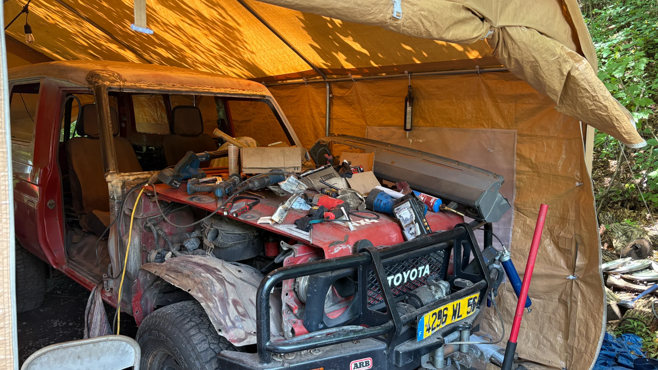

Well my lack of luck continued, when I went to start the troopy I had nothing... no power. Tried to jump it and the batteries wouldn't take anything, took them to get tested and both of them are totally dead no saving them. Only 2 years old and I've started it every other month since I got them. Well that'll be a decent chunk of $$$ whenever I get this thing back on the road
My lineup of crap
The Willy's has been turned into an interior parts storage
The fully finished roof welding which I had talked about
I cant wait to get this thing painted and put back together, there is so much crap everywhere. I often wonder what my landlord would think if they ever found out about what I've been doing back here 😂 lucky enough for me she has never been to the house in the past 5 years and the roommates aren't snitches.

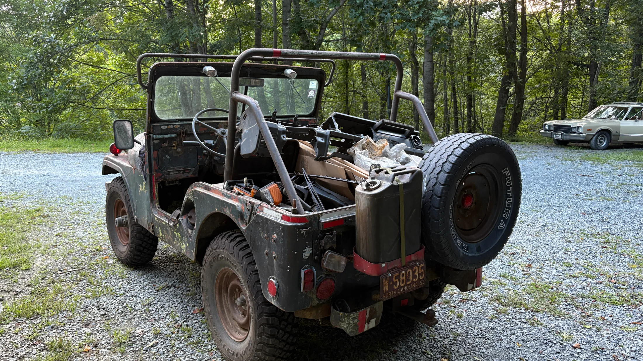

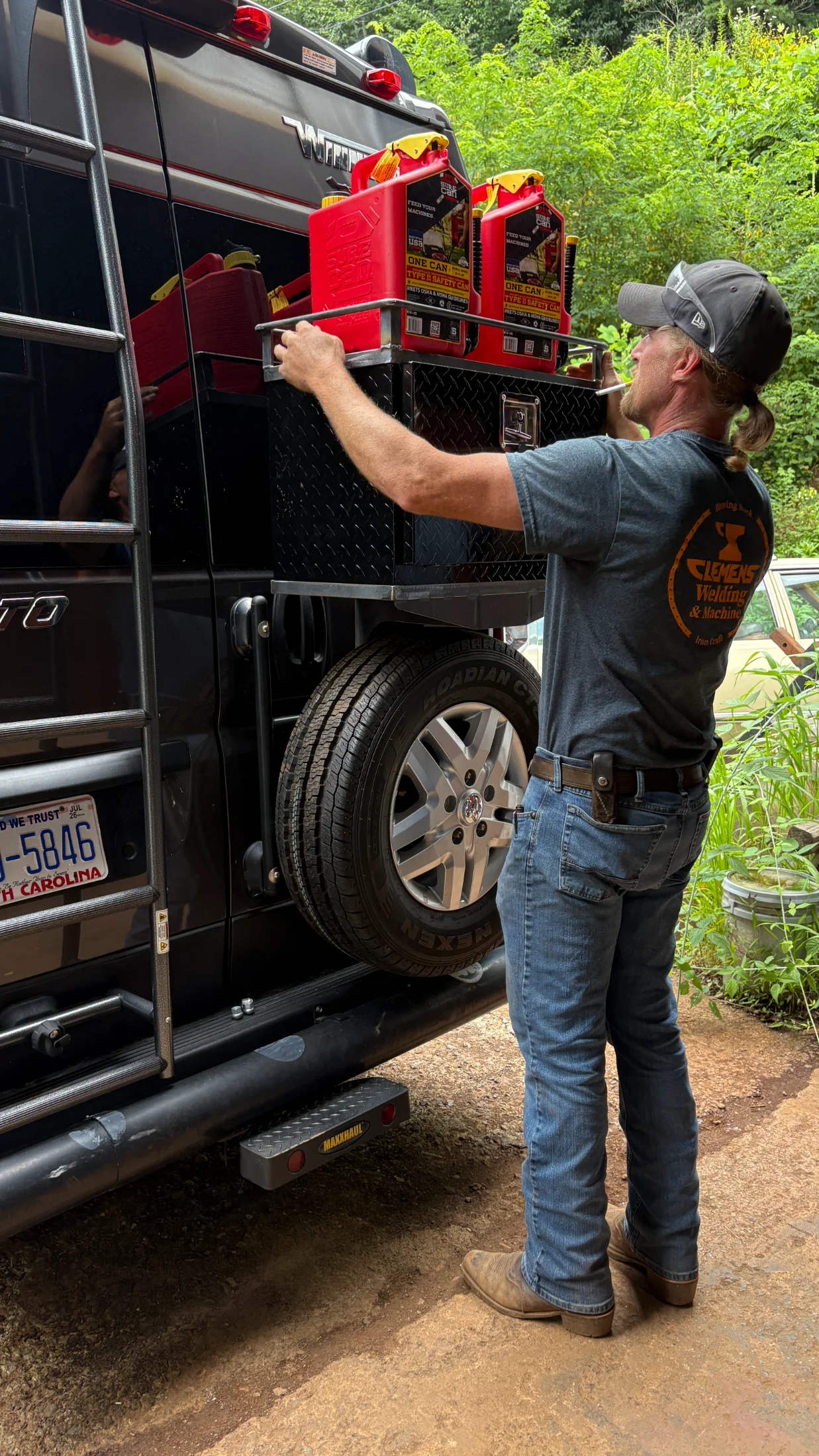

A few non troopy related pics:
spare tire/fuel/toolbox carrier I built a work a bit ago
My lineup of crap

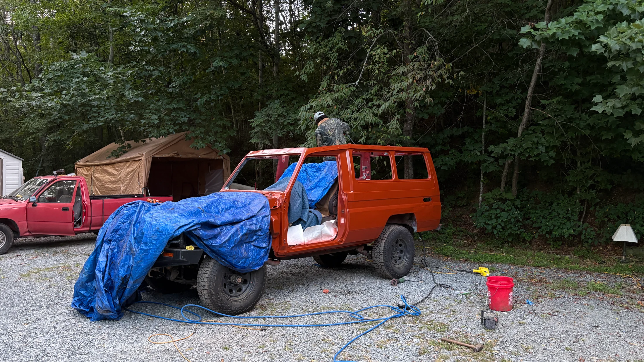

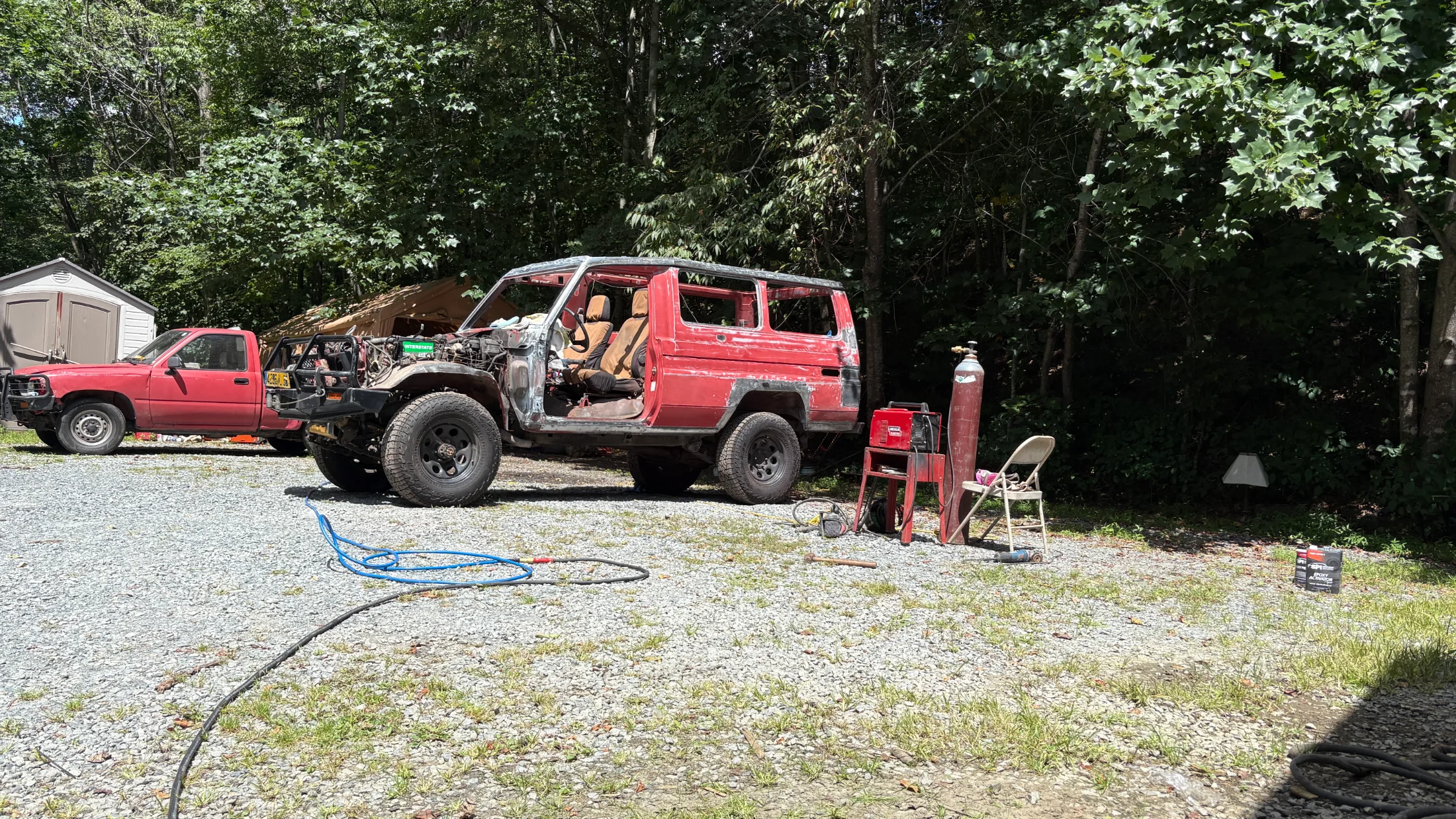

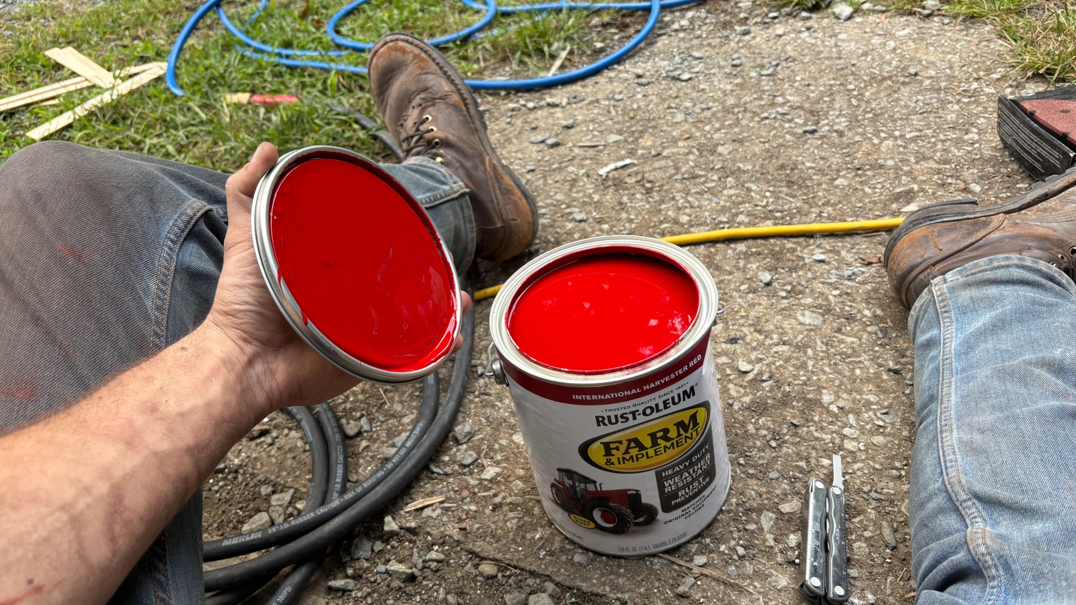

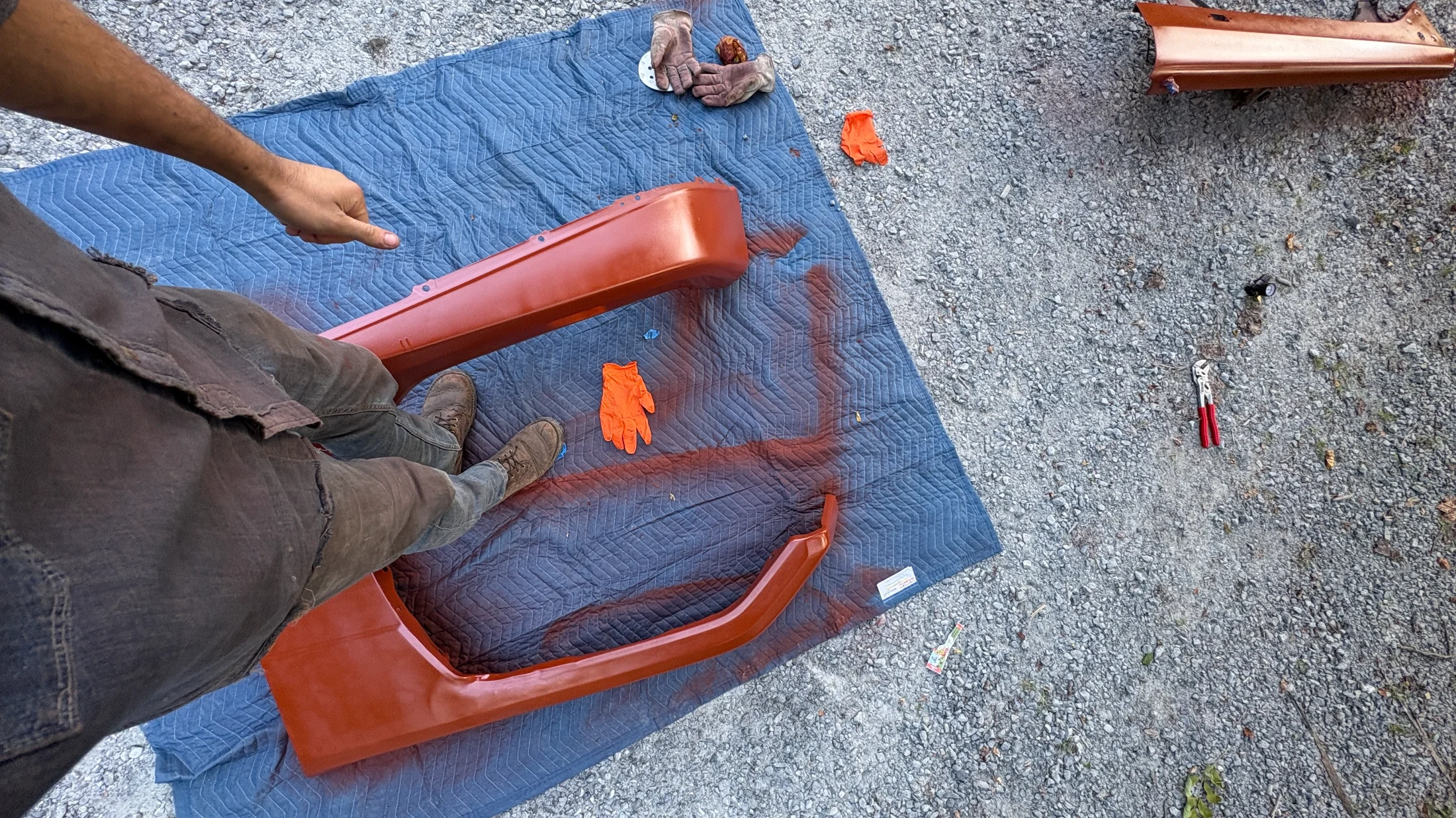

Alright, MORE PROGRESS!
Figured I might aswell go ahead and cut the top off before I paint it so then everything can be properly primed and painted.
Then on Friday the temps checked out (during the daytime) and the forecast was clear for the next couple of days. So I did something I rarely ever do... get a helping hand. My buddy Joey was more than happy to put some manual labor in sanding and sandblasting everything.
Got it primed with Red Oxide epoxy primer.
Don't let the pretty pictures fool you... I have never painted anything ever before and really still dont know what I'm doing. In combonation with a $15 Harbor Freight spray gun... it really isnt anything decent. Then again its just primer, but I hope it has and will adhere well. My Vevor diesel heater kept the temu carport at 66 degrees overnight while the outside temp was 52!
I got new doors for the troopy (dorito side windows) that came off a newer 70 series shoutout to @cruiserinsanity for finding them, grabbing them, and then passing them off to me. They have the "Land Cruiser" emblem mounted on the doors and not the fenders. Figured I'd rather plug weld these holes on the fenders than the nice fancy new 70 doors with all the internal window mechanisms.
Some more primer pics, I still dont really know how to get the gun to spray well, no matter what I do with the settings it just doesn't like to flow out that well unless I have it REALLY close to the metal.
And a quick question for anyone who is more informed. If my primer has this kinda paint defect, should I sand it down and repaint it? I'm assuming it'll make the paint look like sh!t
I spent $300 on some real nice fancy primer (probably a mistake and a waste since I'm learning with it as I go) but I figured thats where it really matters. I just hate rust, so much. Deeply. and figured the primer is really where it counts with keeping it away. So I shelled out a whole $50 for 2 gallons (yes $25 a gallon) for some International Red tractor paint. Gonna mix it some with mineral spirits and add a hardener to make it more like automotive paint. I'm hoping it won't be TOOOO red but at that price point, I dont really care.
And my final question for the masses, should I just sand this old cool middle eastern 4x4 logo off of the troopy and replace it with a new one? I have dimensions and location recorded and a while back I believe @gilmorneau said he could get me in touch with someone to remake them. Or should I go through the trouble of masking it off bit by bit to preserve the old one, I kinda like the cracked patina but also worry that it wont match the brand new paint look at all. Any thoughts?

I prepped and prepped and prepped, made sure there were no oils or anything. Yet still had fisheyes and orange peel. I just am extremely inexpericed with painting and really dont have a love for it or bodywork at all. Just one of those things I gotta do cause theres no way I'm paying someone else to😂
Awesome work! My only bitch about rustoleum red or orange is that it is not uv stable. It fades and goes chalky. Very noticeable at night by torchlight after 6 months or so. Places where the sun does not shine it is fine. Goes on easy though, very forgiving. But fairly cheap and cheerful, I always have some of it about ready for a patch up.
Don't forget to treat the back sides of all that welded metal, too. Rust can start inside your truck and work its way out. Freshly welded metal is particularly prone to that if left untreated.
BTW, red paint on red primer might be tough to see well when you're laying it down. Maybe try a light coat of gray or something in between so you can better see where your red top coat is going? Just a thought.
And, yes, if you get me good photos and accurate measurements, I can repro the "Dakar" decal for you if you want.
