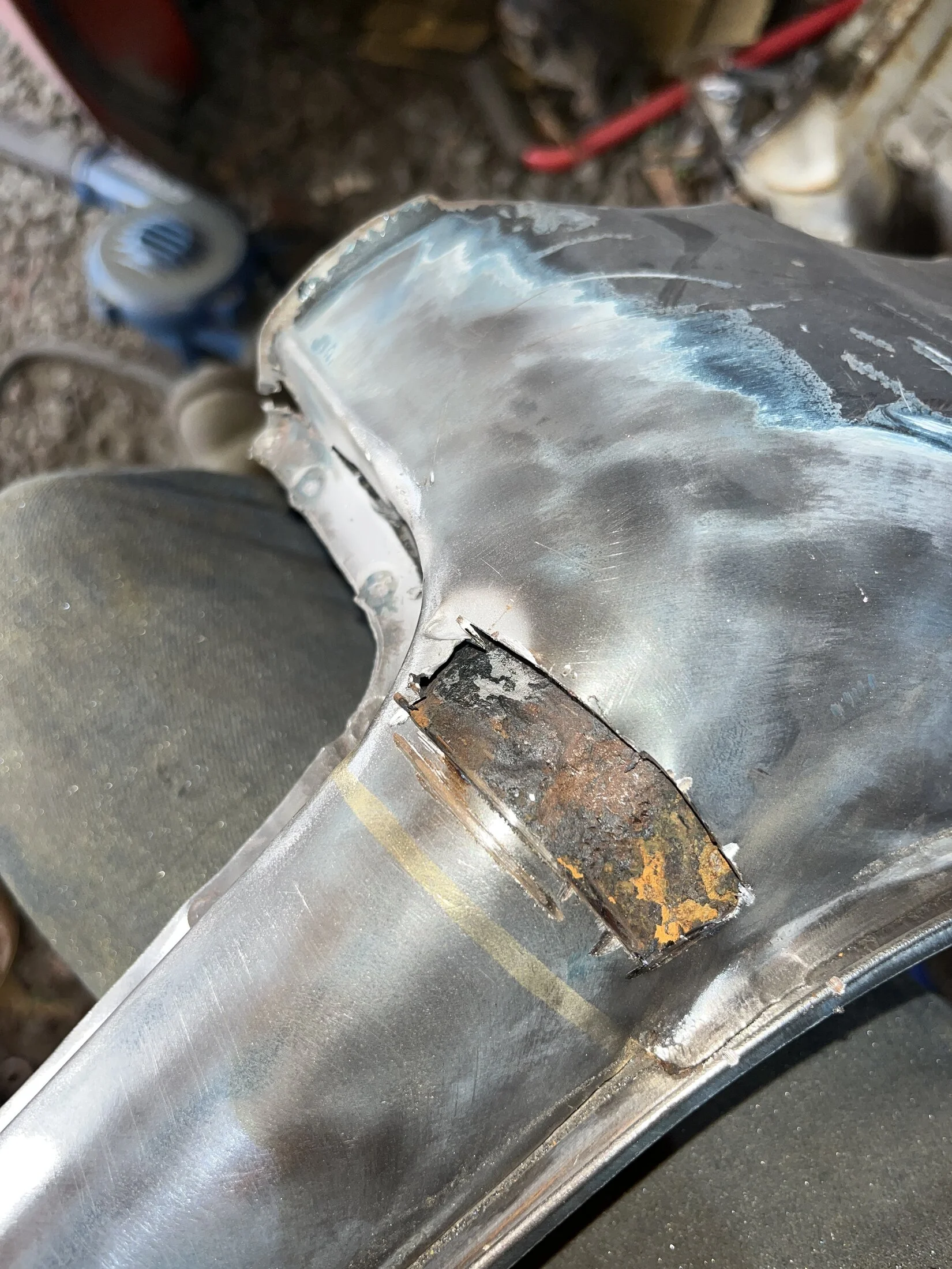

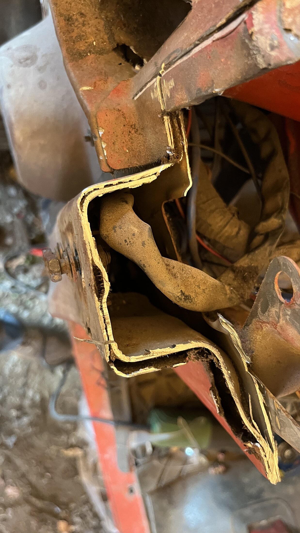

WHY ARE THERE 2-4 LAYERS? JUST MAKE 1 THICK PIECE OF METAL!!! I have been screaming at the middle-aged, elderly or dead Japanese engineers who designed the 70 series way back when.
HA! My buddy was throwing some cheese curds around and toss one at his POS beater truck, ricocheted off of the truck and right into my wide open eye, cutting my cornea. It sounds absolutely ridiculous, because it is. Cheese curd induced ER visit.
Didnt even think of using a needle gun, I'll give that a try maybe it'll work better!

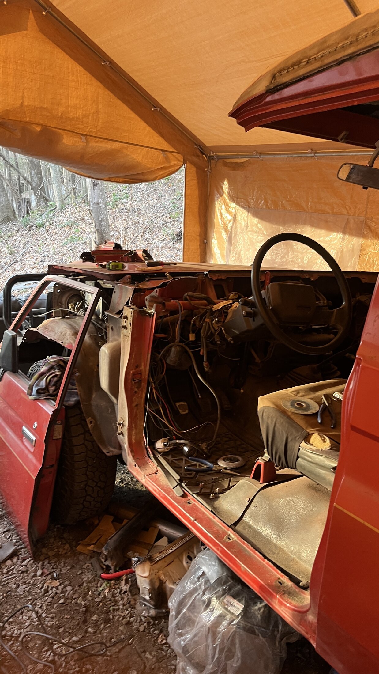

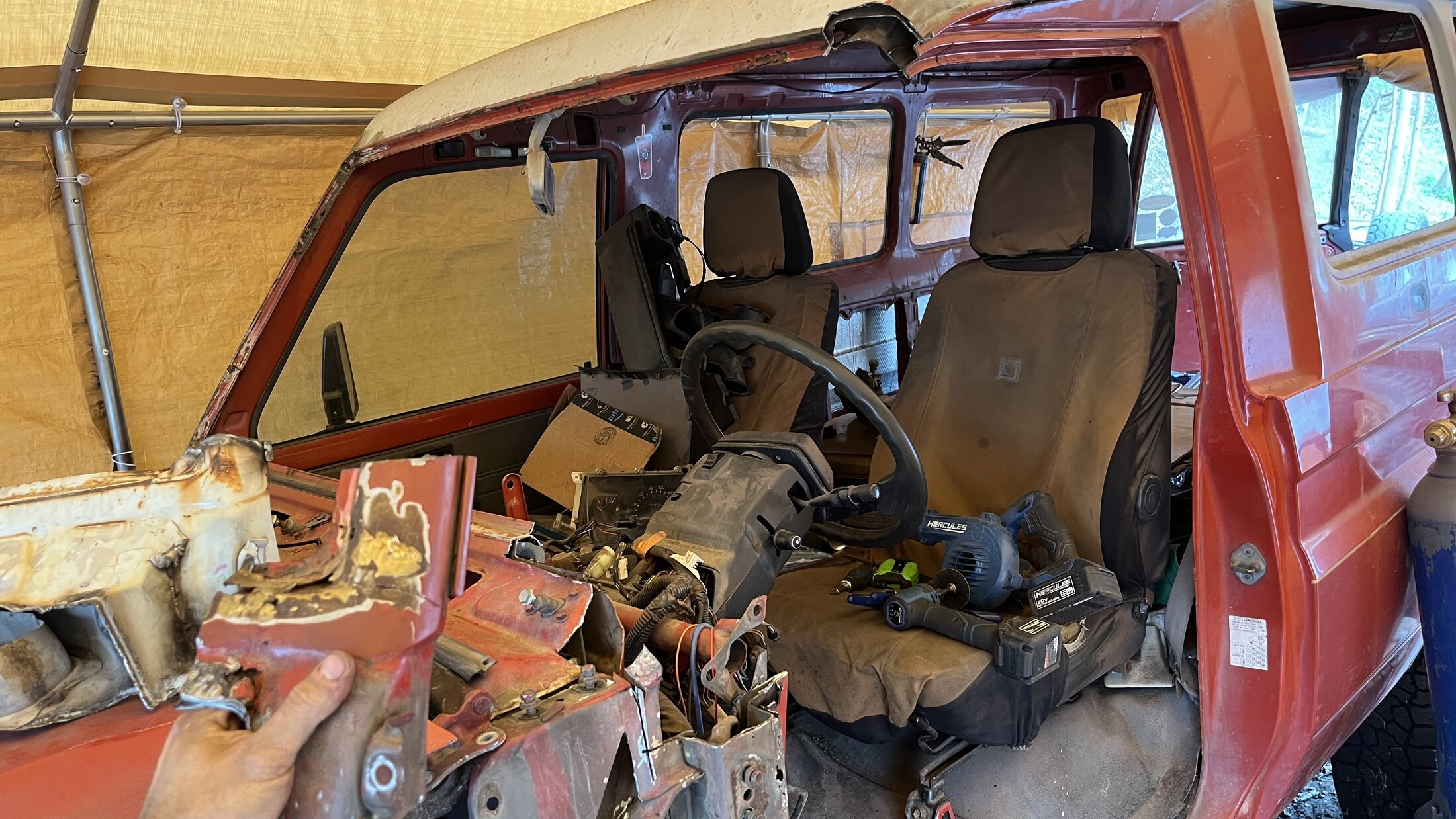

What a serious challenge to fit/weld back together! You might try putting the door back on and using clamps to hold it in proper place to fit the door as well prior to tacking in position all around. I hope someone out there can help you with a technique to position and tack your new. Frame together/in proper fitment. Good Luck!

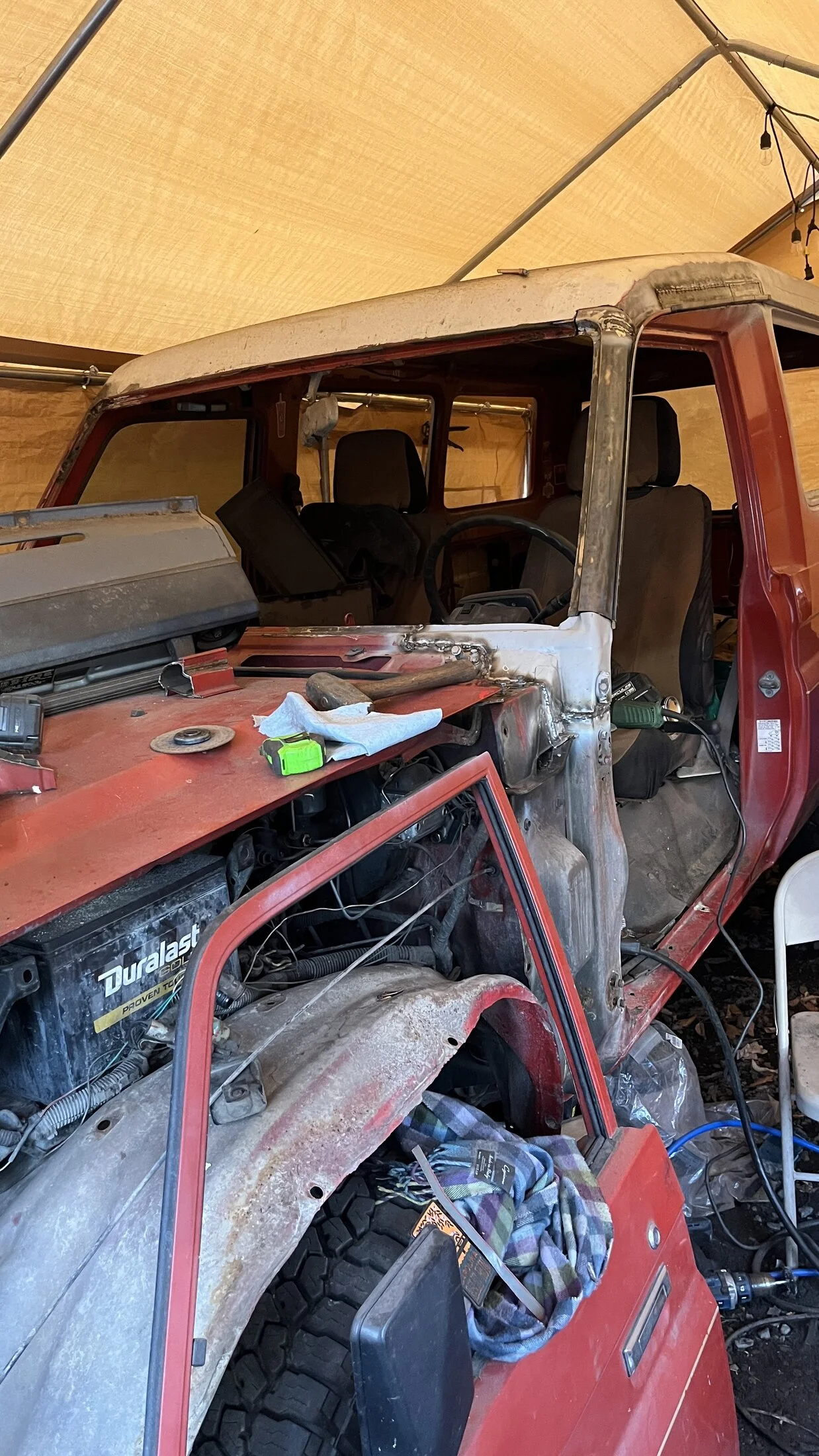

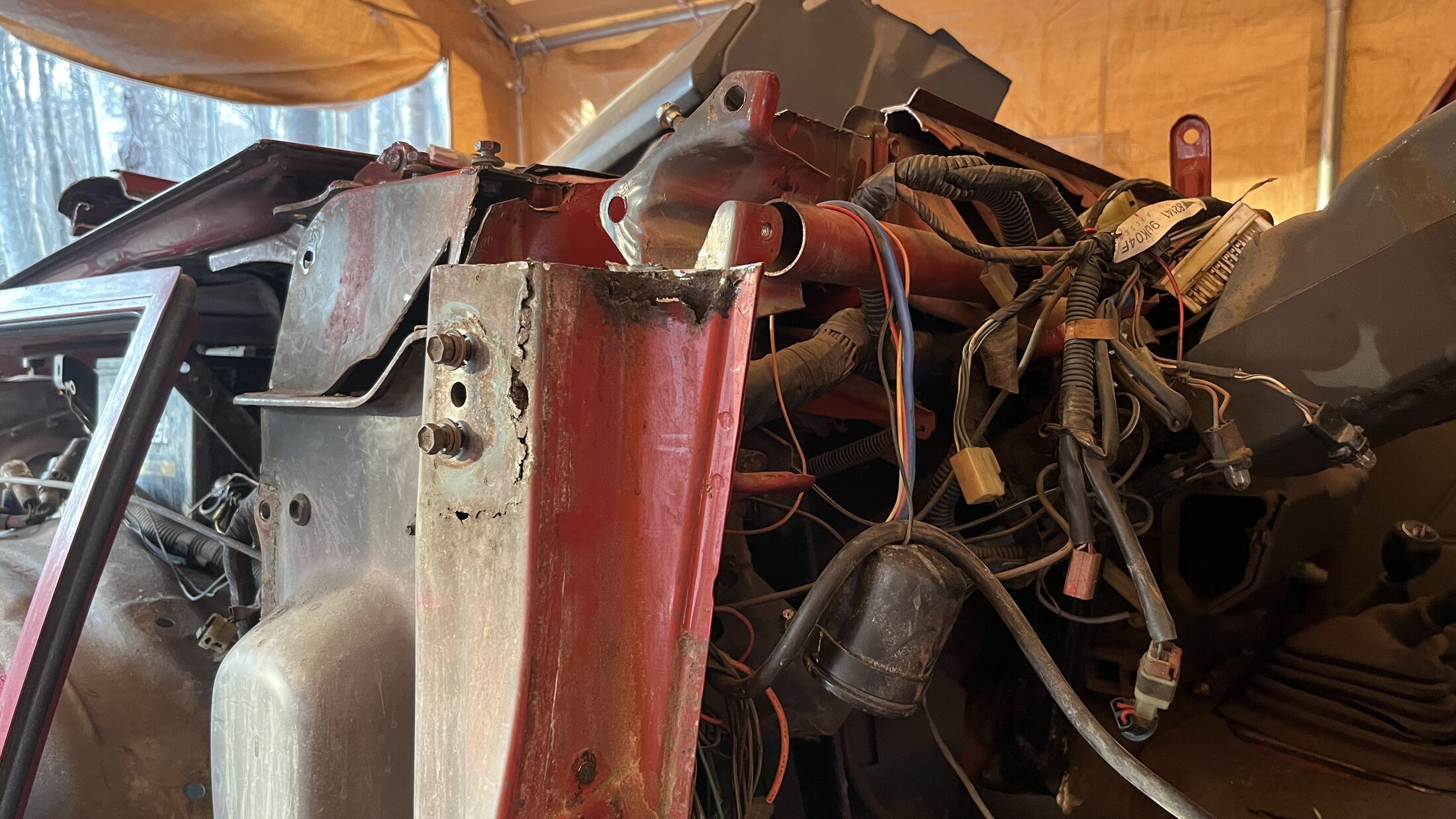

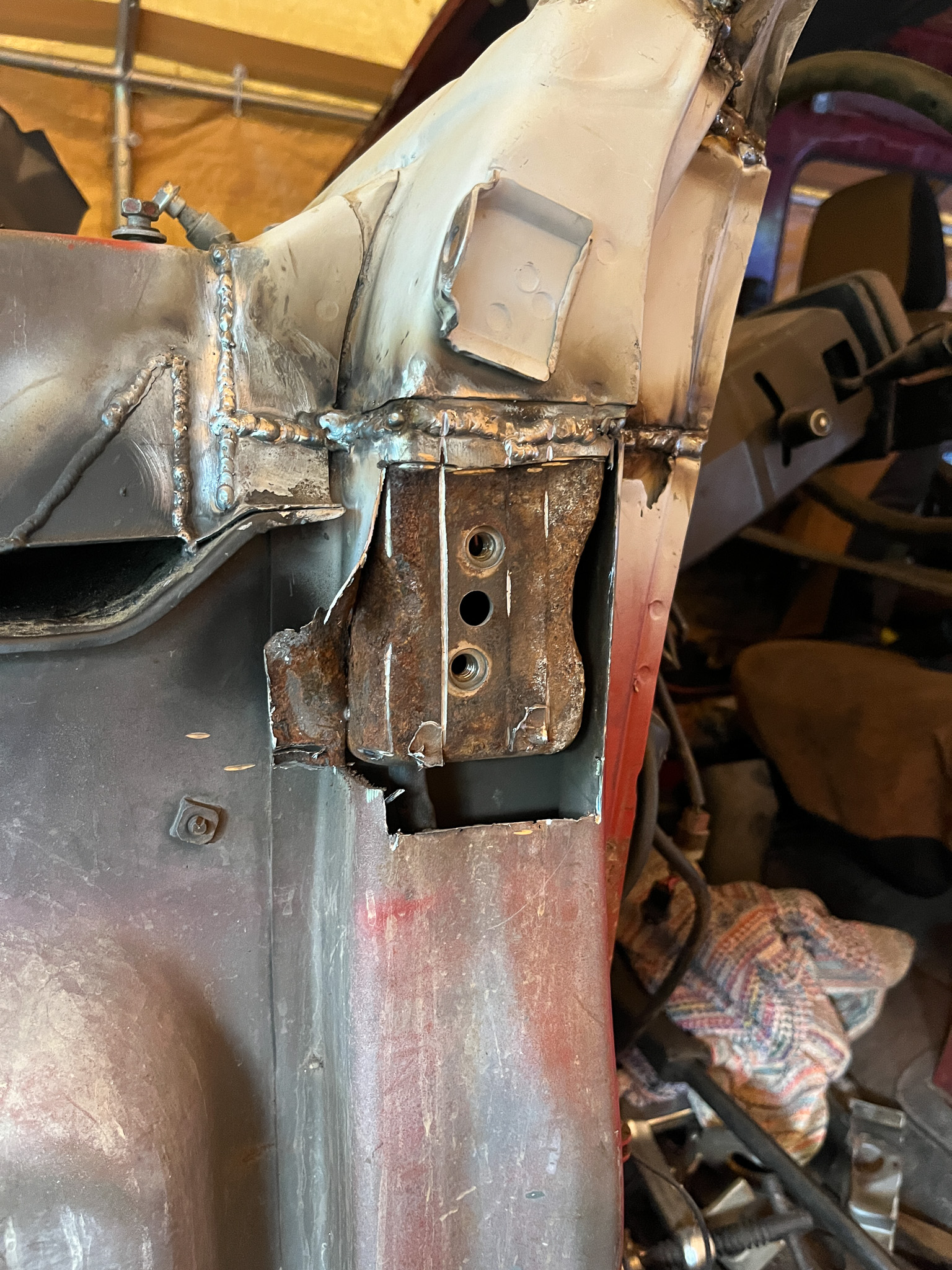

Well my "rust free" A pillars were indeed, not rust free 😂 they were infact about rotted thru on the inside layer, so I cleaned all of the rust away, sandblasted it and then gooped a ton of weld all over everything replacing any of that paper thin rusty metal that was left, with weld.

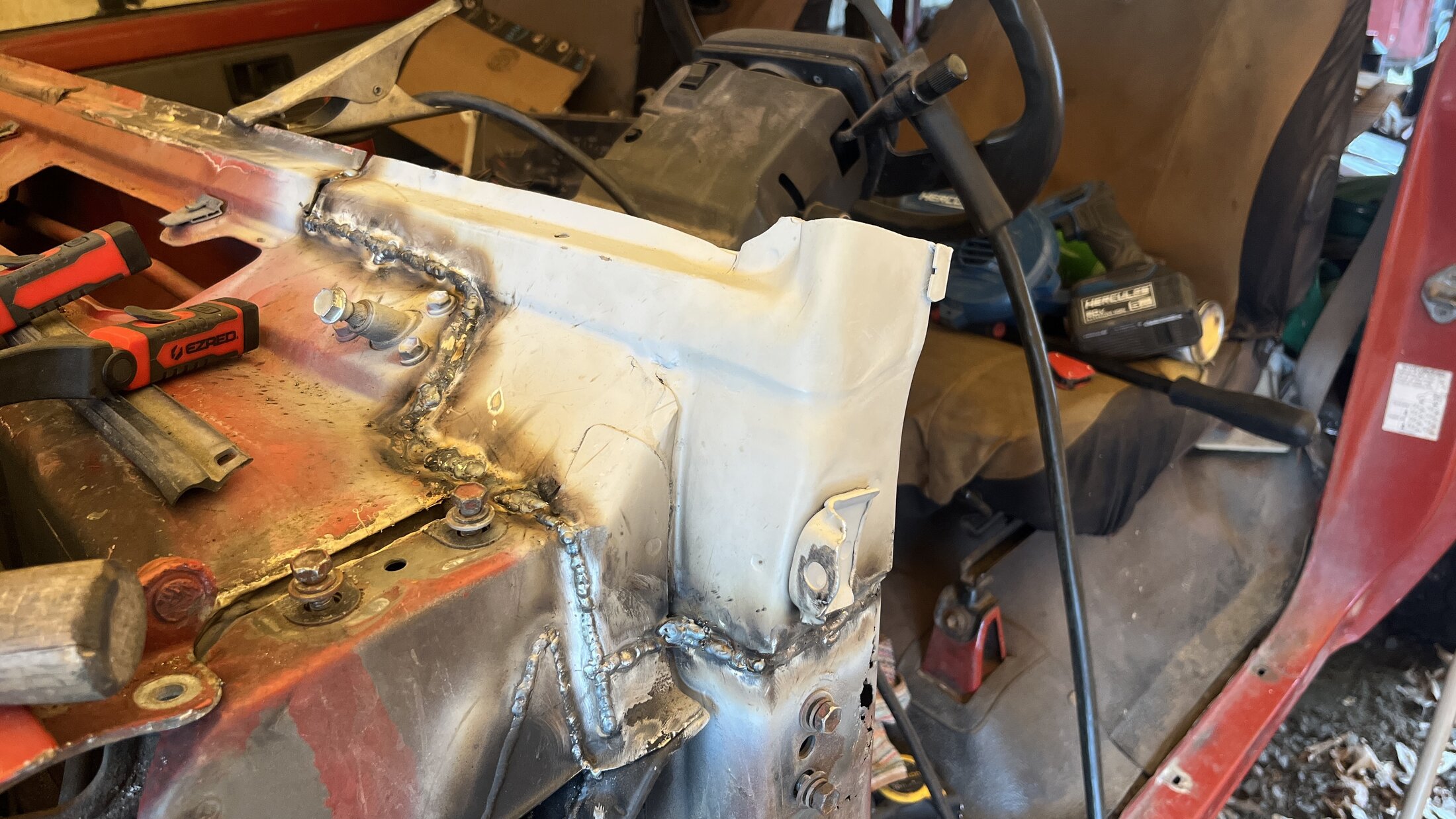

Here is my new chunk of firewall pretty much fully welded into place
and after hours of meticulous grinding bit by bit, the A pillar fits! Kinda...
Yea... I have been way in over my head with this vehicle more times than I can count now, but this is by far the MOST I have ever been. I mean good lord, I take a step back and just look at the state of this thing... what have I even done. Can't go back now, can't sell it, probably couldn't even give it away for free cause its such a POS. So here I am, stuck haha.
Great idea on putting the door back on, thanks a lot for that tip. Will definitely help as I'm trying to get as many other bits of the car in place to match where I should permanently weld the A pillars back into place.
Well my "rust free" A pillars were indeed, not rust free 😂 they were infact about rotted thru on the inside layer, so I cleaned all of the rust away, sandblasted it and then gooped a ton of weld all over everything replacing any of that paper thin rusty mental that was left, with weld.
Great work. With projects of this sort, maintaining tunnel vision helps. All I see is the A pillar portion, nothing else. After that its the … section. You have it in you, based on what you have dealt with. Rig has been a great companion for you on metal toughness and resiliency. Chin up, ya doing awesome!!! So what if it ain’t perfect, doing your best is where its at!
Quick suggestion before you weld that window pillar back in place. Install your door and get it all fitting nice and lined up then weld some braces to keep the door support section secured in position with the door closed and body/door gaps looking decent. brace it front to back and side to side. It will make four life much easier when you do final fit up. When you remove some of the structure things get really flexy and its easy to weld metal back in with things out of alignment.

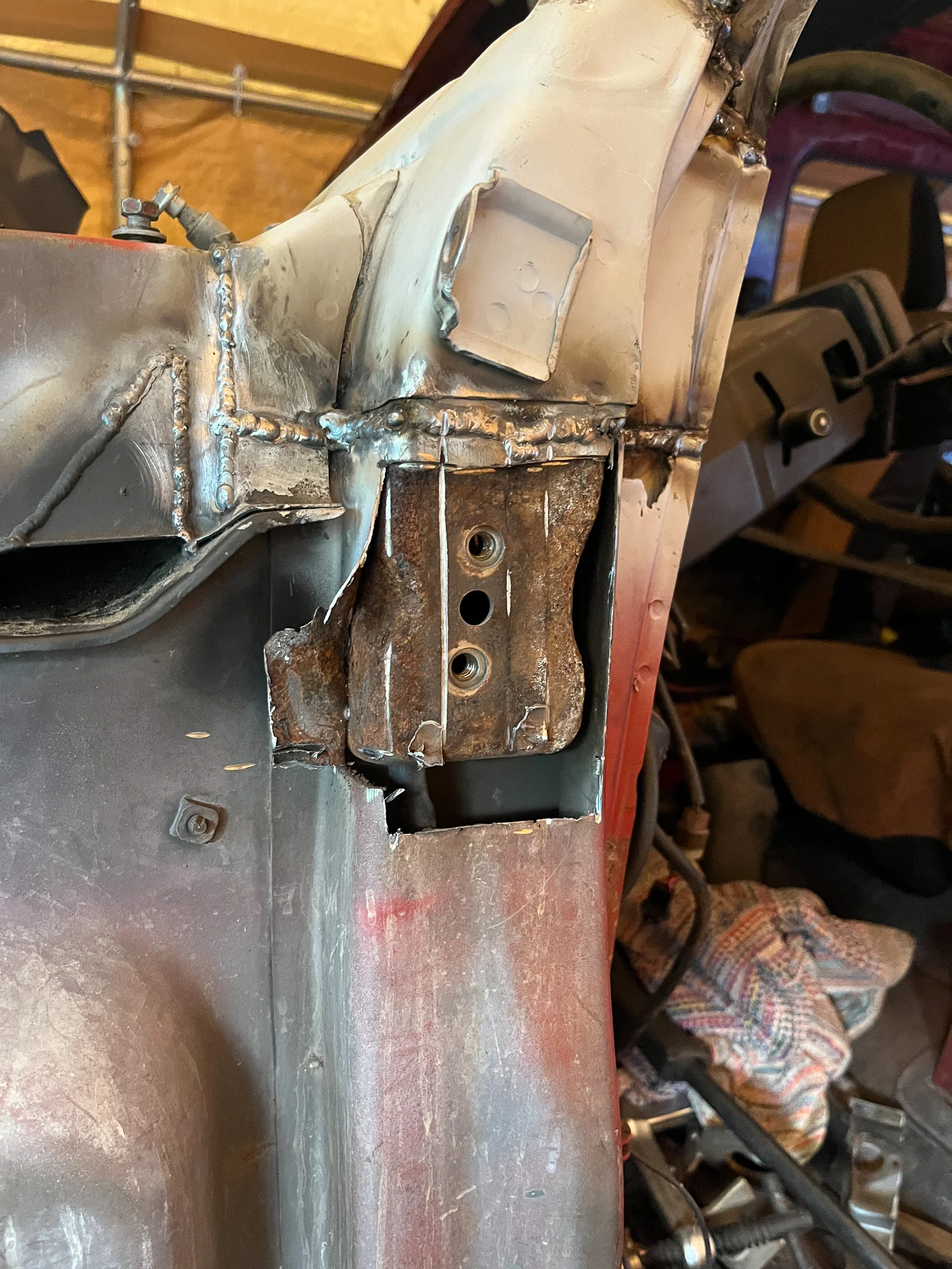

Below the A pillars, where the doors mount to were rotted out due to there being 3-4 layers of sheet metal all crammed up next to each other. I fixed it but don't have any photos at the moment

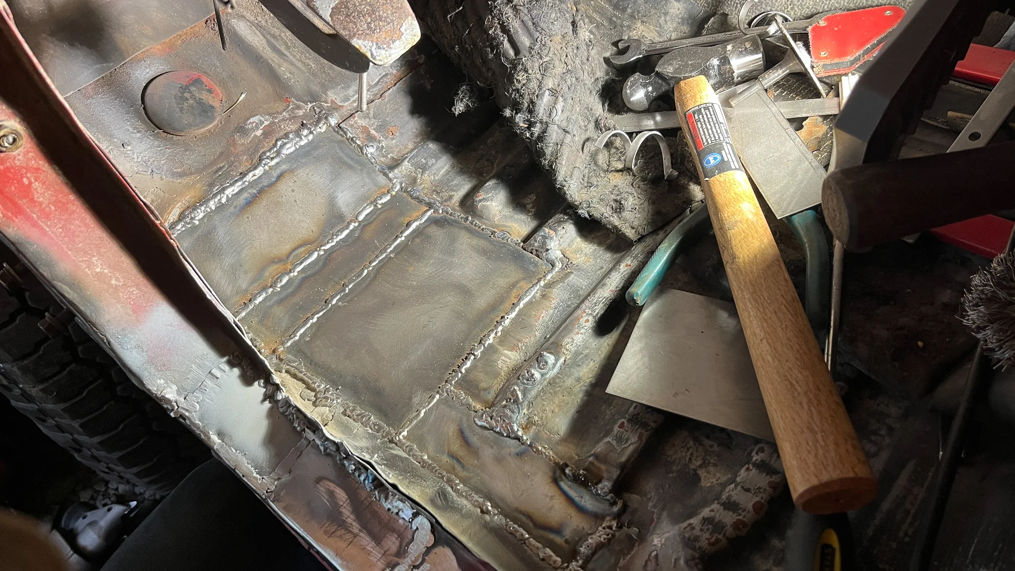

And my floorboards were rotted out, replaced with 16-gauge steel that'll do just fine.
