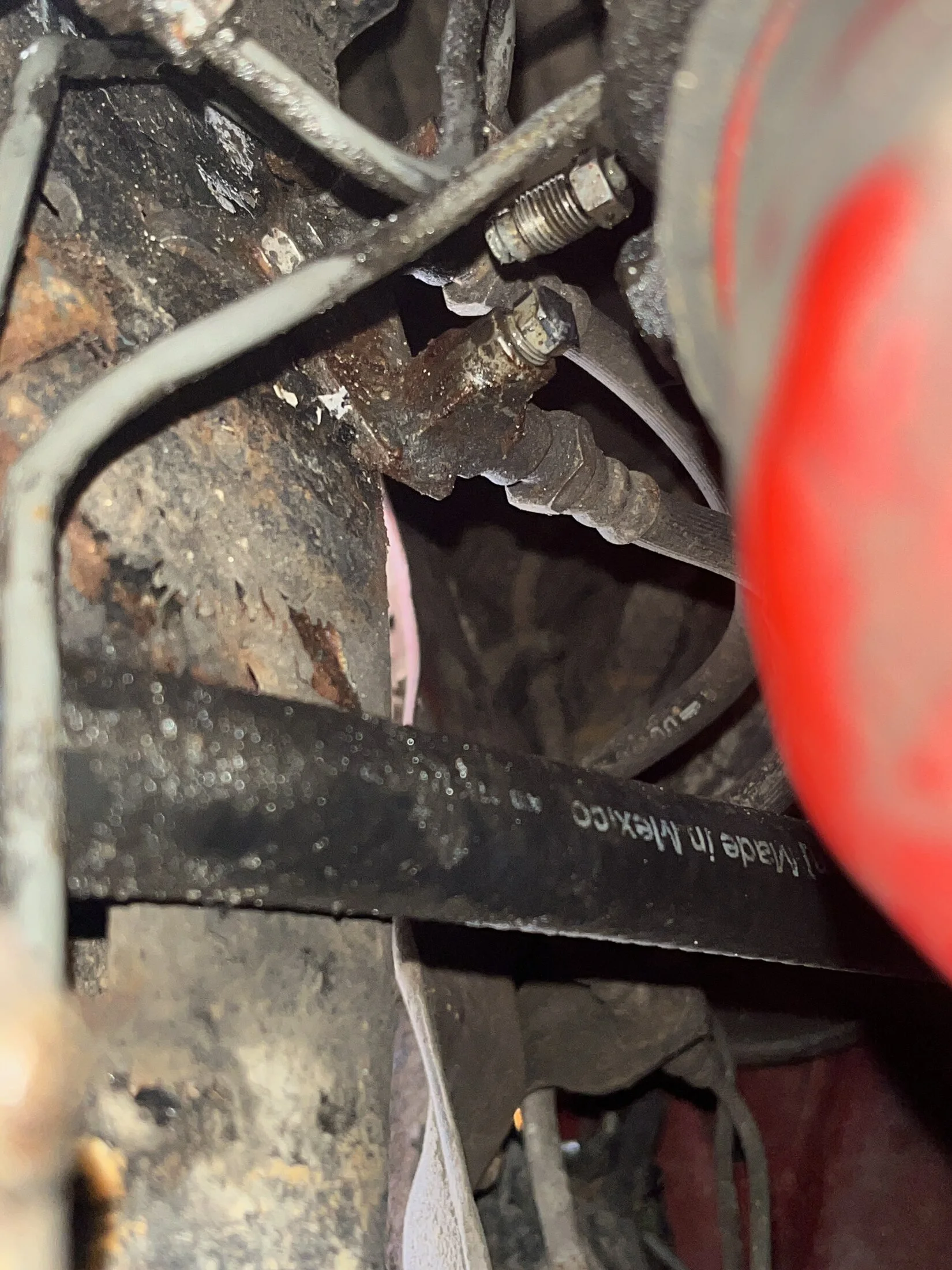

I did make it home last night but pretty dang late so I just fell asleep with no update. My brakes fully went out about 1/3 of the way into the trip. The SOFT clutch hose wore through the HARD brake line, I previously had rags and zipties (real professional I know) between the two, preventing them from rubbing. I failed to check if those were still in place during my pre flight checklist with the Red Rocket and paid the price for being negligent. I cut the line and tried to plug the pressure with the vicegrip at the end of it but it would still piss out a pinhole stream of fluid, so I pulled out the mig welder I had in the Red Rocket and welded it up, then vice gripped it shut. Even then... my brakes wouldn't build pressure even though it wasn't leaking from the cut line anymore... there are 2 lines going to the rear, I'm pretty sure the LSPV had something to do with the weird lack of pressure being built so I took the brake fitting that was on the line and welded it into a nut to hold pressure for the other line going to the rear. That worked!

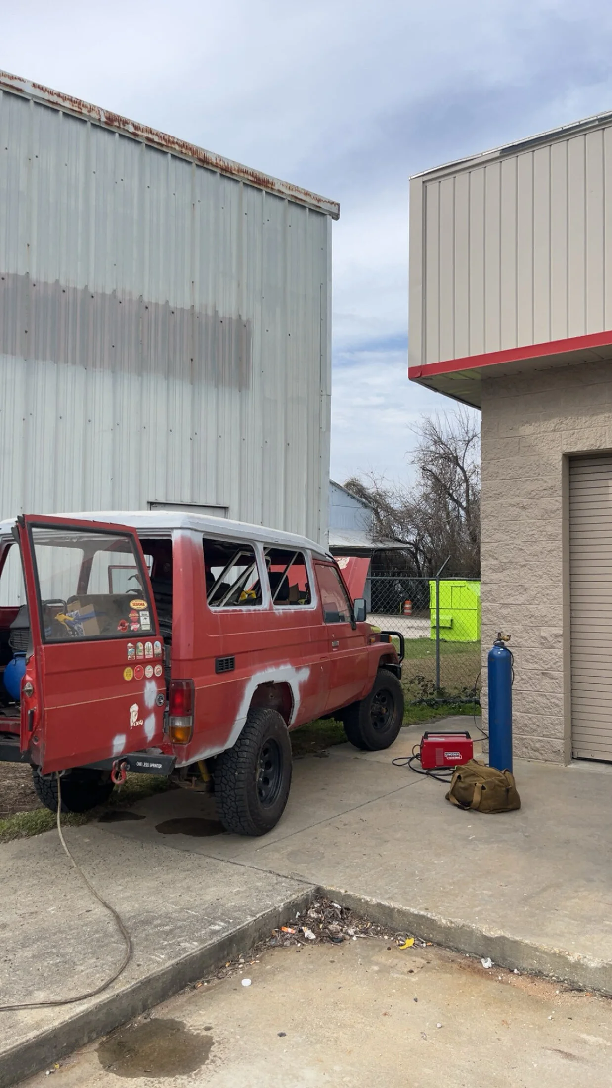

kinda hard to tell what you're looking at but there's my welded up plug!

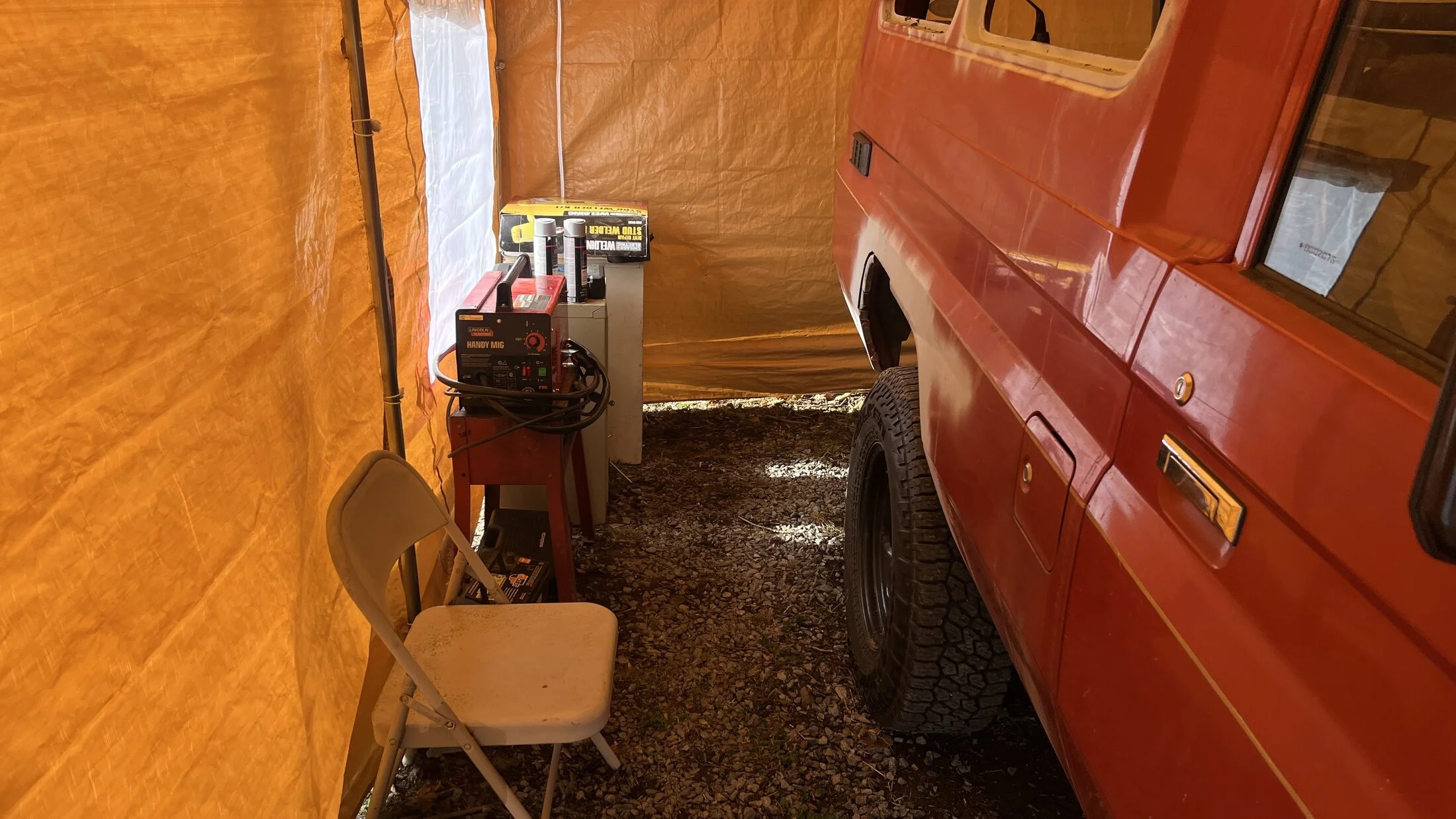

Y'all like my welding setup?? Shoutout to Orileys Autoparts for letting me steal some power from them. I broke down in the middle of the ghetto, so throughout the entire time (like 1-2 hours) I was trying to fix my brakes I kept having some sketchy fellows approach and ask what I'm doing, eye me up real good, check out all of my stuff, and then go on their way. I'm pretty sure they didn't wanna mess with the disgusting white dude in the hood who was welding his car with no windows back together in a random parking lot 😂
I was back on the road with front brakes, all was well for another 140 miles or so, then I lost all of my brakes again... NOW WHAT????
Well I limped it on the side of the road to a gas station and started to diagnose. It would build barely any pressure and then leak away. Tried to bleed it on my own but it just wouldn't build any pressure. Paid a homeless dude $10 to pump the brakes for me while I tried to bleed them and still to no avail. There was a very loud whooshing noise coming right from the master cylinder that wasn't there before. I'm assuming it gave up the ghost (lucky me). Called a tow truck and made it back to Boone around 11:30pm, it broke down only about 35 miles away from my house so I'll count this as a partial success! The troopy is infact, in Boone, under my temu carport, waiting to be cut apart even more now.
I got more working room than I had thought in here!
So yea, the no windshield thing for 300 miles seems like an absolute walk in the park compared to the brake nightmare I had to deal with.

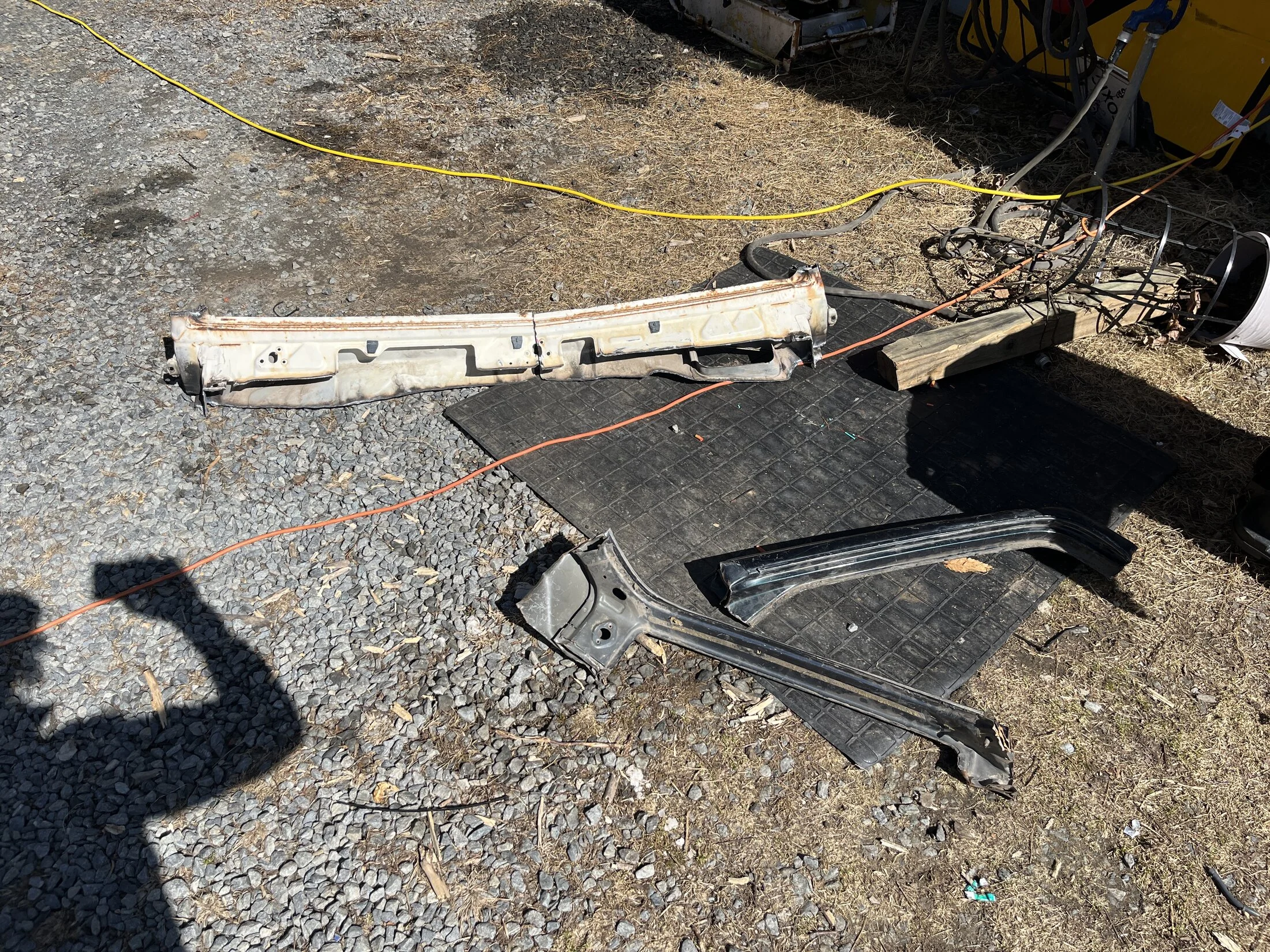

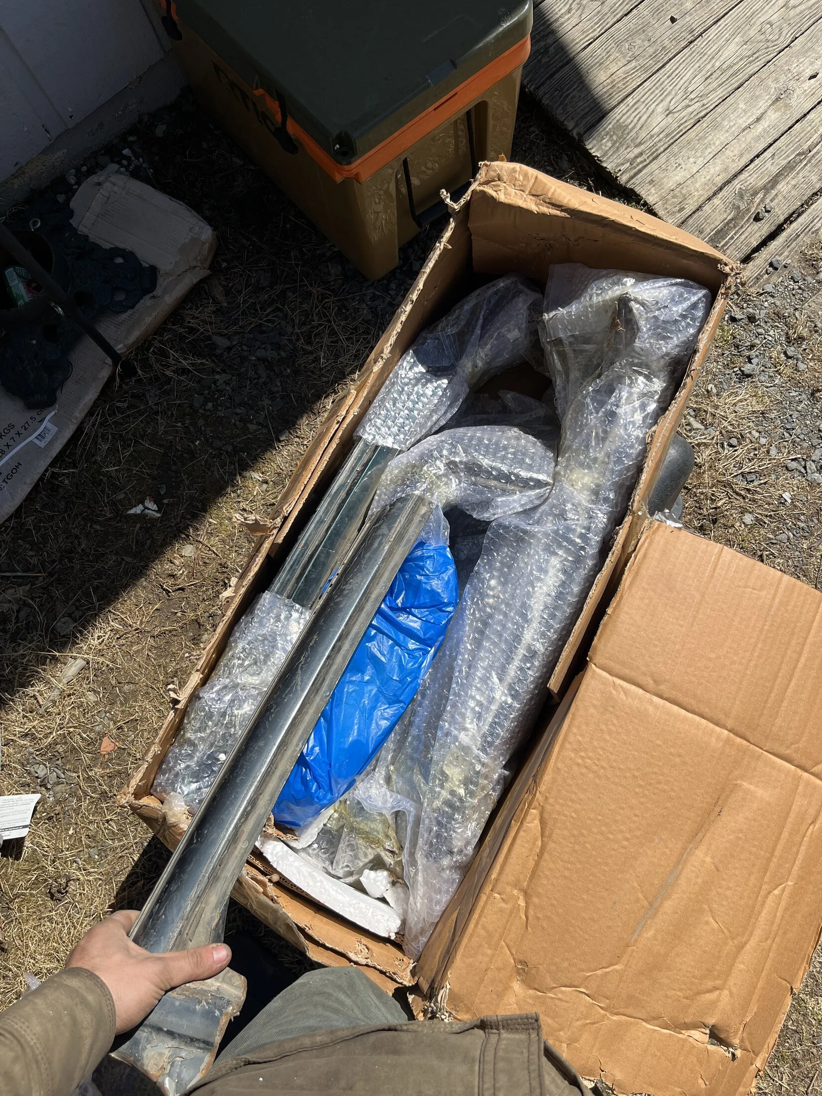

My parts have arrived from Pakistan! a-pillars and the firewall/cowling area are now in my hands. It'll be a while before I go to install these and start cutting apart the front end of the troopy, I'm gonna try and get the rest of the body totally ironed out and finished before I tackle the windshield frame area. Mostly I'll just be redoing work that I'm not happy with looking back at it now, the welder I was using was broken without me knowing, leading to some pretty horrible welds and some pretty great ones, it was totally hit or miss. I'll remake some rocker panels, wheel wells, areas for the rear floor, etc etc.

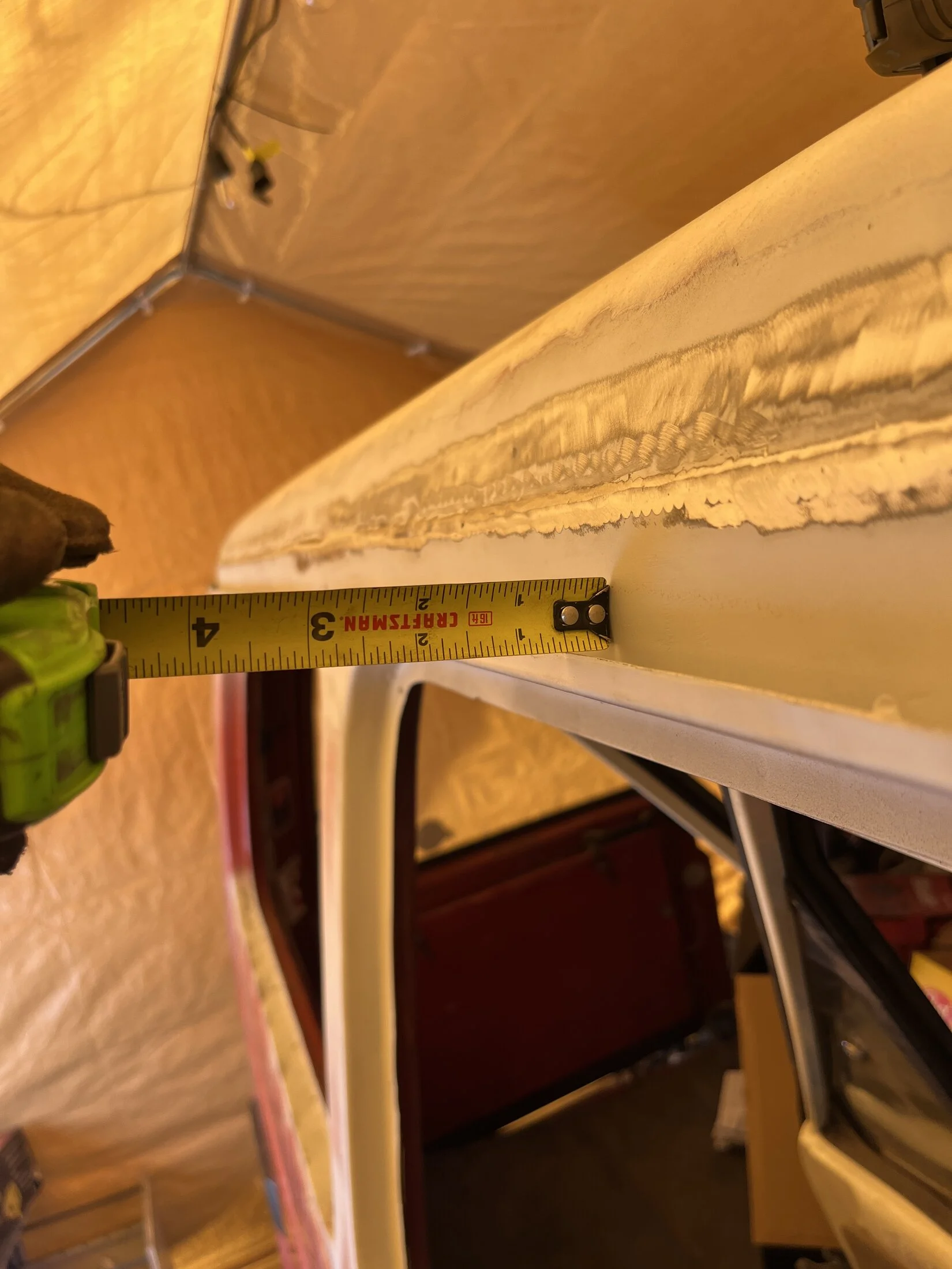

would anyone with a 70 series be willing to grab a quick measurement of how far their factory driprails measure out to? My handmade ones come out to 1/2 an inch just trying to see if I'm somewhat close to original

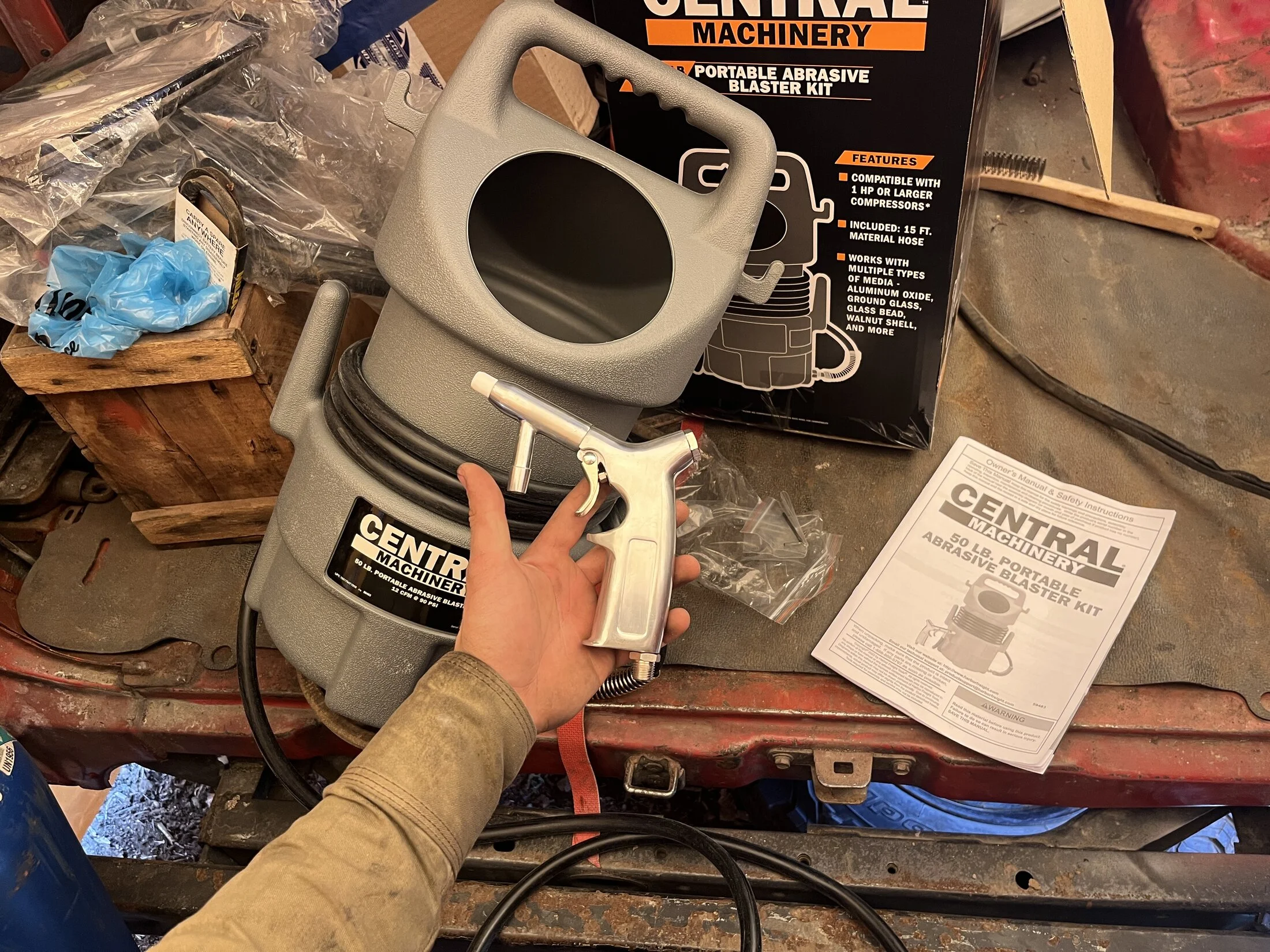

If you have any kind of an air compressor go out and buy one of those cheap spot sandblasters at harbour freight. They are slow and messy but do a good job of getting rid of rust in areas you are going to weld an also will uncover what lays beneath all the bondo ( including where the layers are spot welded together).
Thanks again for the recommendation, I figured I couldn't go wrong for only $35.

I use Black Diamond coal slag abrasive from Tractor Supply in my blaster.
When it flies all over the yard, the black blends in pretty well with soil and gravel.
Get the fine grain.

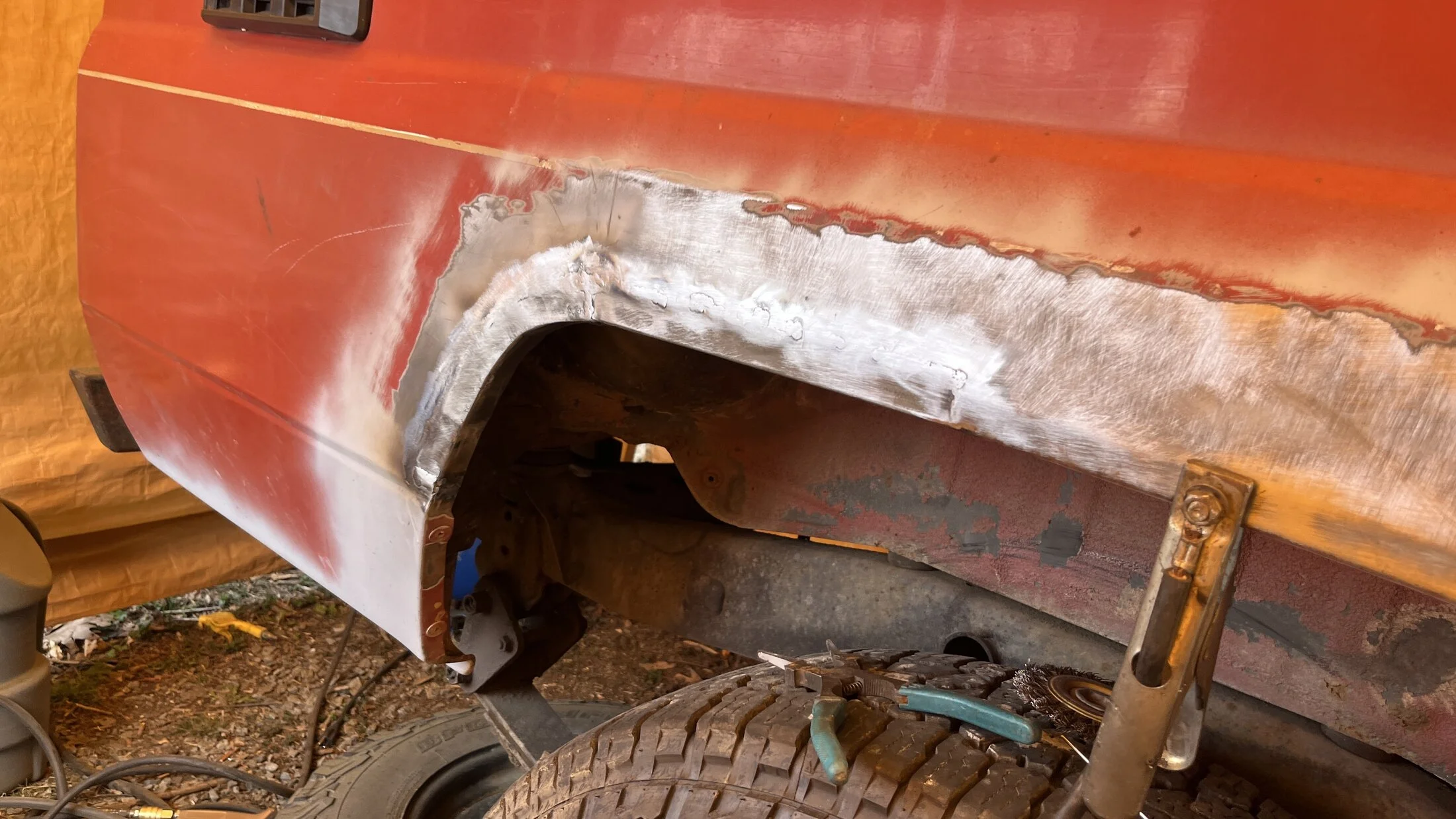

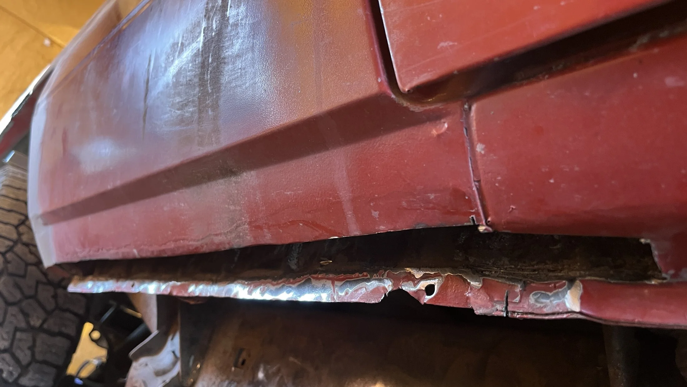

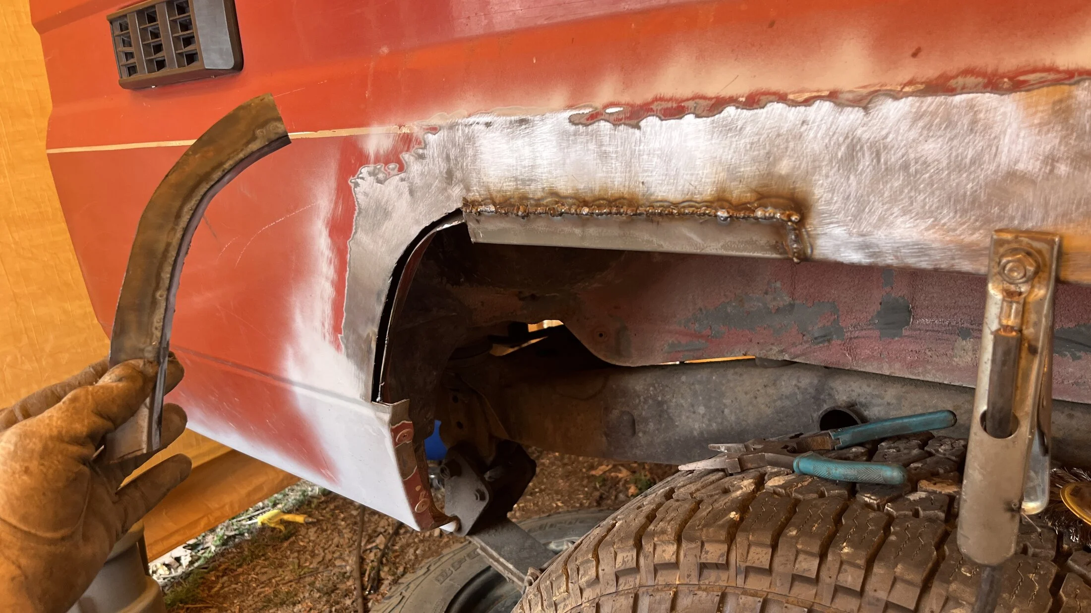

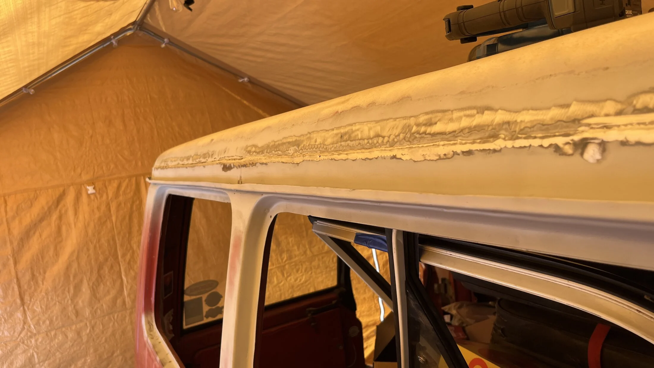

Diving in deep. Waiting for rust converter, cavity wax, and some fancy rust encapsulator paint to arrive in the mail before I go too crazy. Lots of cutting stuff out and making panels so when that stuff does show up, I can just get right to painting and then welding.
Went ahead and welded this since I can access everything from the inside.
Bottom of the rocker was all rotted, have the part cut out ready to weld in whenever I get the inside sealed

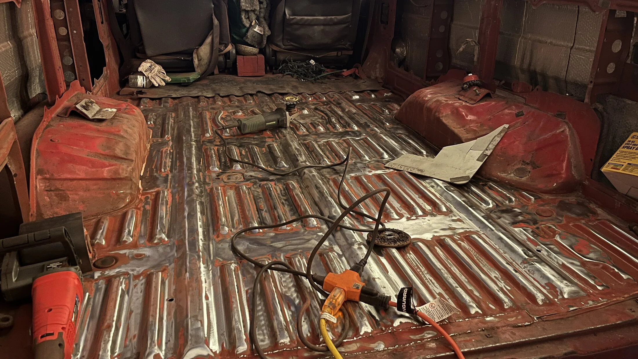

and cleaned the floor up well to find any and all rust. Will be cutting into the floor to the crossmemebrs that you cant see or access to clean them out, convert, and paint them, then I'll weld them back, drill a small hole in and fill it with cavity wax.
Get the fine grain.
I bought some 2 days ago, not the fine grain... learned my lesson. Went back and got the fine grain stuff, works great! Thanks for the recommendation
View attachment 3860158View attachment 3860157

Glad you're moving forward again. ....On the sandblasting only thing I've ever used is sand. Which if you're short on cash you can go to a local playground and get a small bucket from the sandbox. Biggest problem with a dirt cheap sandblast setup is the sand getting damp from moisture in the air and clogging. Dump your air tank very often if you don't have a good water seperator. ...I'm actually curious how much better blast media is for simple rust removal. gray closed cell foam 3/8-1/2" "fatique mat is a very good and not expensive sound deadening material for your floor. They sell it at lowes or home depot in the carpet area. It is used for mats on concrete floors in work areas so workers that stand all day have some relief from standing on a concrete floor. You can use the "vinyl upholstery spray paint" to color it to the desired color..............before you weld your windshield frame together you might try bolting it in the LC in pieces and then tacking it in proper pos., before welding it complete so it doesn't warp/shrink/deform enough to become difficult to bolt in........I had a similar LC brake loss experience when I was 20 at Clemson in my FJ40. You are a much more competent mechanic/fabricator than I was at that time. .....My 72' FJ 40 was from Folly beach and flooded with salt water during hurricane Hugo. My wheel cylinders kept getting frozen with rust so I had to clean them which required removing the rubber boots and cleaning them. rubber boots fell apart(brittle), Which then caused them to freeze up more often. One was so frozen I drilled a hole through the wheel cylinder in order to drive out the piston with a steel bolt and hammer. I then put the bolt in the drilled out hole with RTV to seal the cylinder again.........some weeks later I drove up into the mountains exploring some 2 hours from Clemson when it blew and my brakes went out completely........I drove it home turning the 2 hour trip into 5 utilizing low range downshifting and the Emergency brake..........YOU welding it up behind the parts store is above and beyond your years. Outstanding effort.!
Good luck-R.
Be very, very careful using sand (I wouldn't recommend it at all). Sandblasting with actual sand creates extremely fine silica dust, which stays suspended in the air for a long time and is quite a health hazard if inhaled. Regardless, make sure you use a respirator while media blasting, and you'll probably find that a face shield and safety glasses are really nice to have too.
Wow I can’t believe you’re actually suggesting taking sand from children.
It’s dirt/sand cheep.
This is the Land Cruiser community we don’t do that 🤷‍♂️
Waiting for rust converter, cavity wax, and some fancy rust encapsulator paint to arrive in the mail before I go too crazy. [...】I can just get right to painting and then welding.
Be very careful i.p. with the cavity wax.
Wax and welding is literally an explosive mixture. 🔥 (Nobody knows better than you what that looks and feels like)
Remember that wax will melt and flow by induced heat from welding. It might suddenly show up in unexpected places.
Have a water hose and foam (!) fire extinguisher at hand at all times (don't use a powder extinguisher. Powder totals vehicles)
Also wax is very problematic when it comes to painting the rig.
Needless to say that creeping liquids like FluidFilm are even worse.
I strongly recommend to apply any wax / oil only after you are done with the bodywork.
