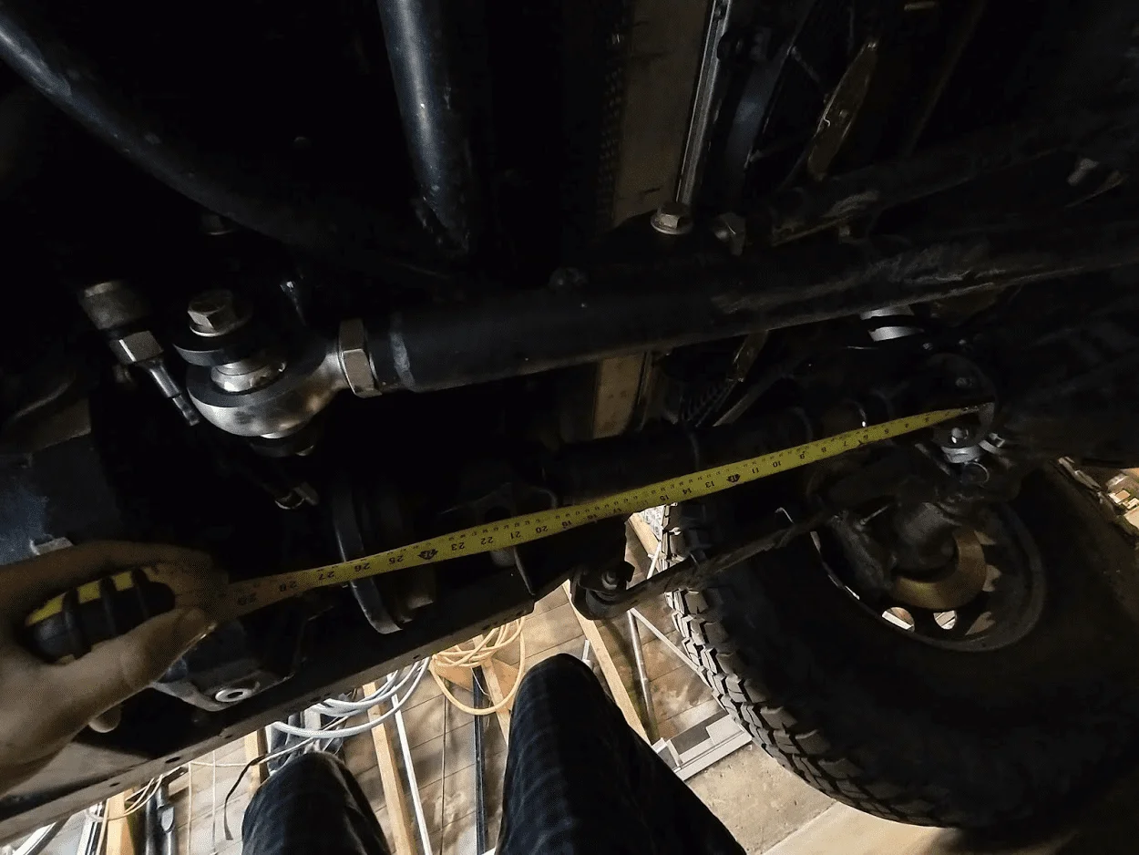

Its a hair over 24" from flange to flange. I imagine its about 25" from center to center.

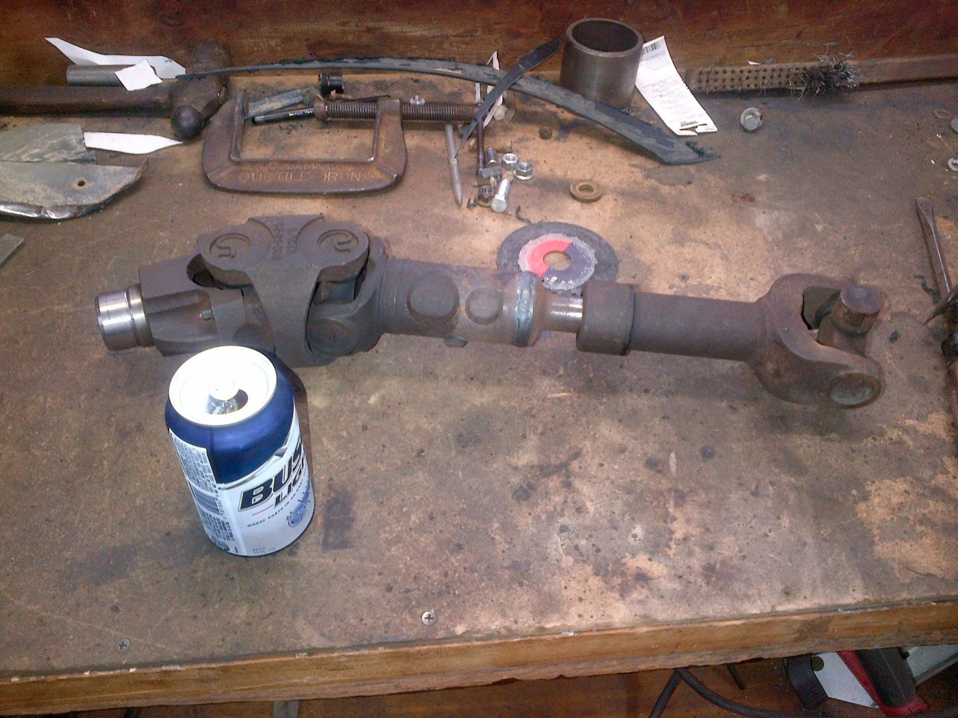

When you are working on your driveshaft be sure to take in consideration the suspension at full droop in the rear to make sure the yokes dont' bind. My nephew has been running this shaft for several yrs with no problems. Obviously its not in a 40.

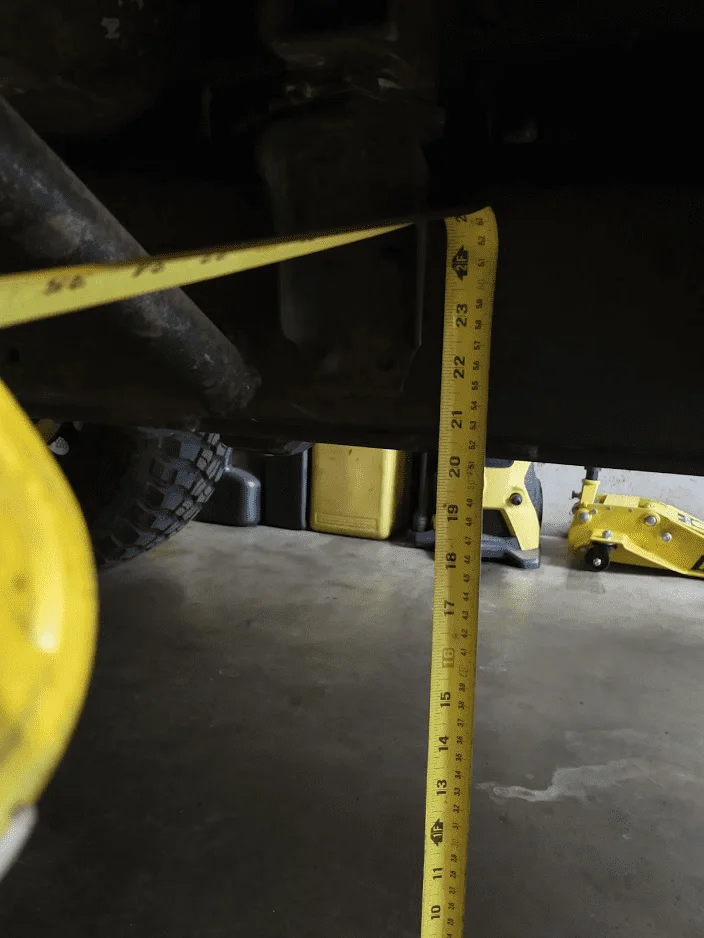

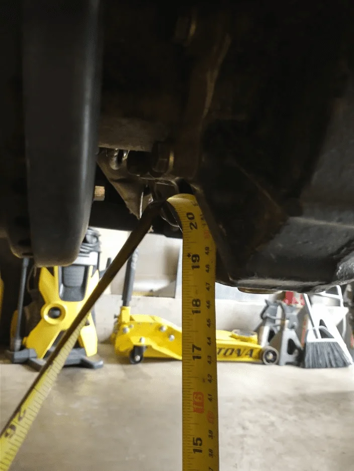

The frame is about 20" off the ground and the transfer lowest part around 18.5:
This is with 39" tires.
View attachment 2580679View attachment 2580680

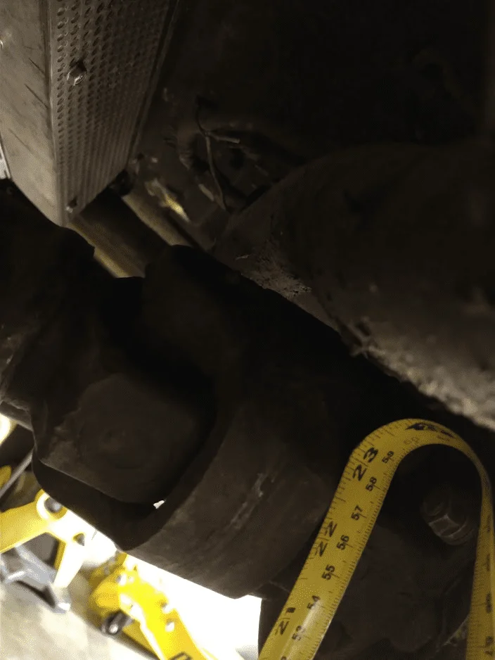

The split case hangs down really low. I'm not sure why. I'm right at 23" for frame, and I'm thinking it will probably settle out about another 1" once everything is in. How flat are your springs right now? Mine still have some arch, and I'm thinking that I'm going to change out to 6" shackles to gain some more droop on the rear.
When you are working on your driveshaft be sure to take in consideration the suspension at full droop in the rear to make sure the yokes dont' bind. My nephew has been running this shaft for several yrs with no problems. Obviously its not in a 40. View attachment 2580665
That's good to know. Having the driveshaft that short does scare me, but I've heard of a lot of people running them with no problems.

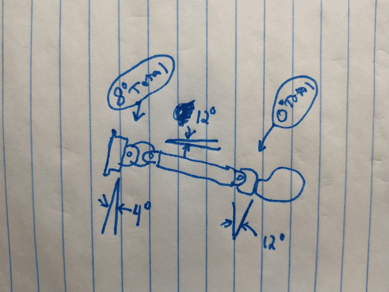

The fact that it's short is itself not an issue. The problem is that usually our tcase outputs are very high in relation to the rear pinion, meaning the driveshaft u-joints (DC or not) can't handle the angle.
My rear driveshaft is just shy of 32" long and I'm right at the limit of a 1350 DC joint angle capability. Granted, I have a centered rear output tcase, so my output is higher, but it's something you need to really figure out before you burn mounts in.

What's vertical separation between your tcase output and pinion as it sits now? what about at full rear suspension droop/compression? That's what you should figure out.
DC joints can't work reliably at anything more than say 25*, and bind hard at 30*. 30* isn't "super steep" imo.

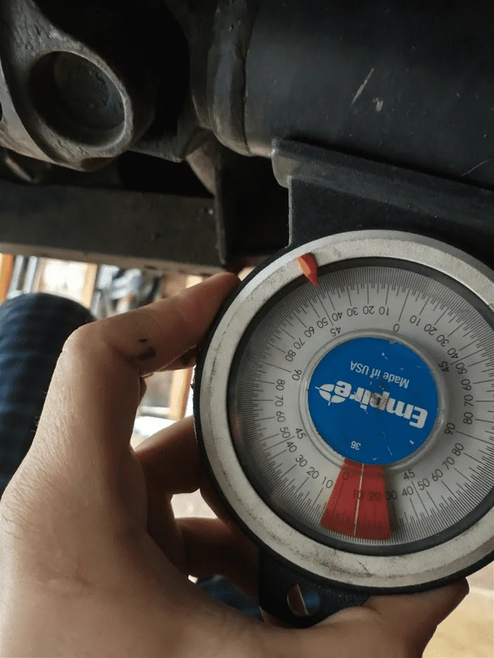

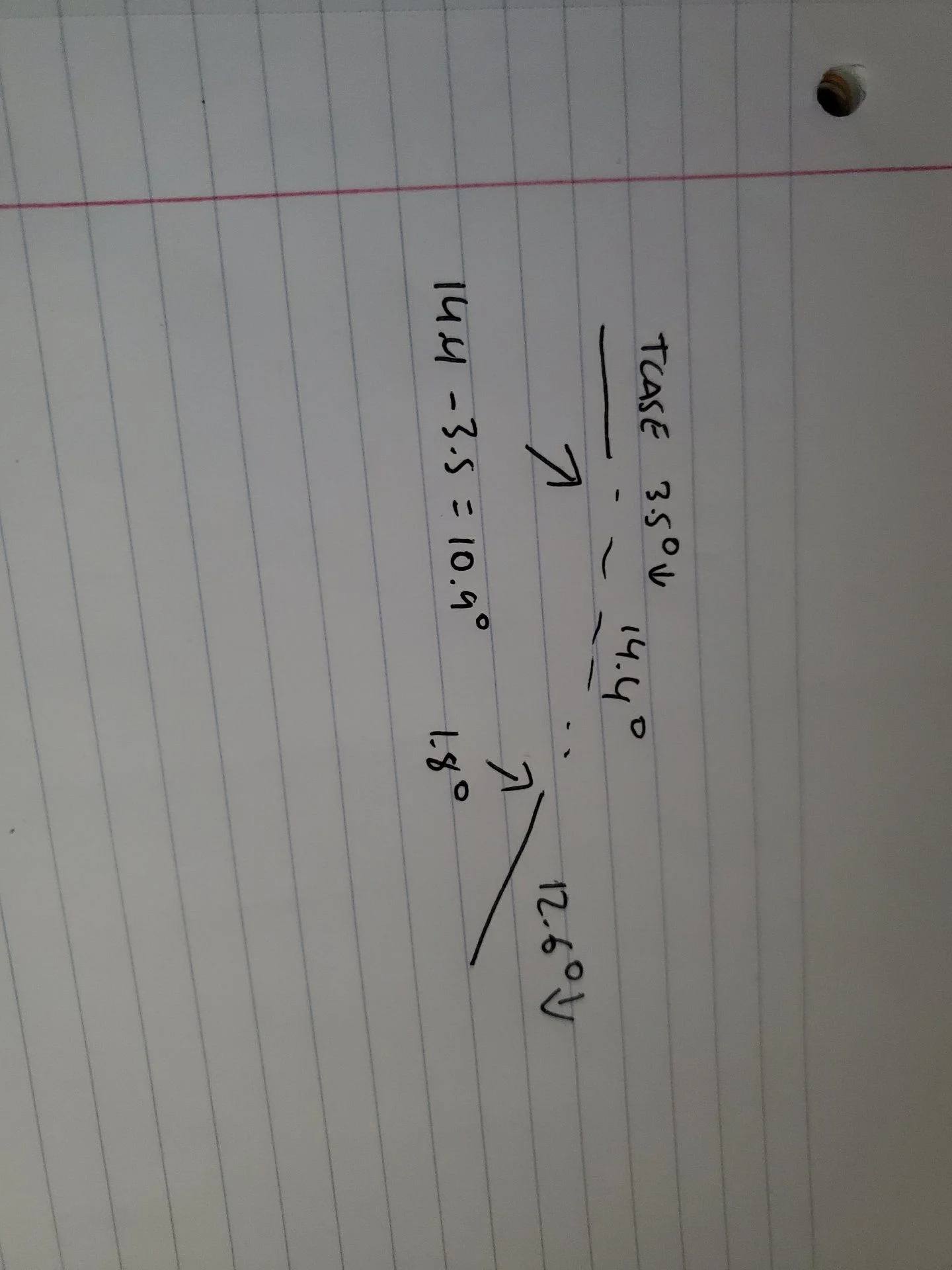

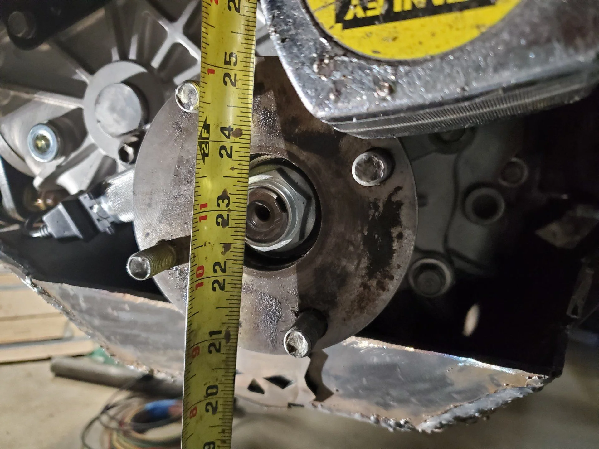

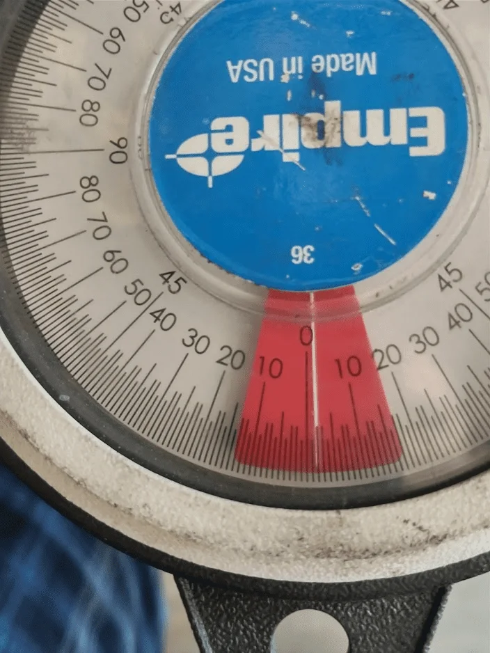

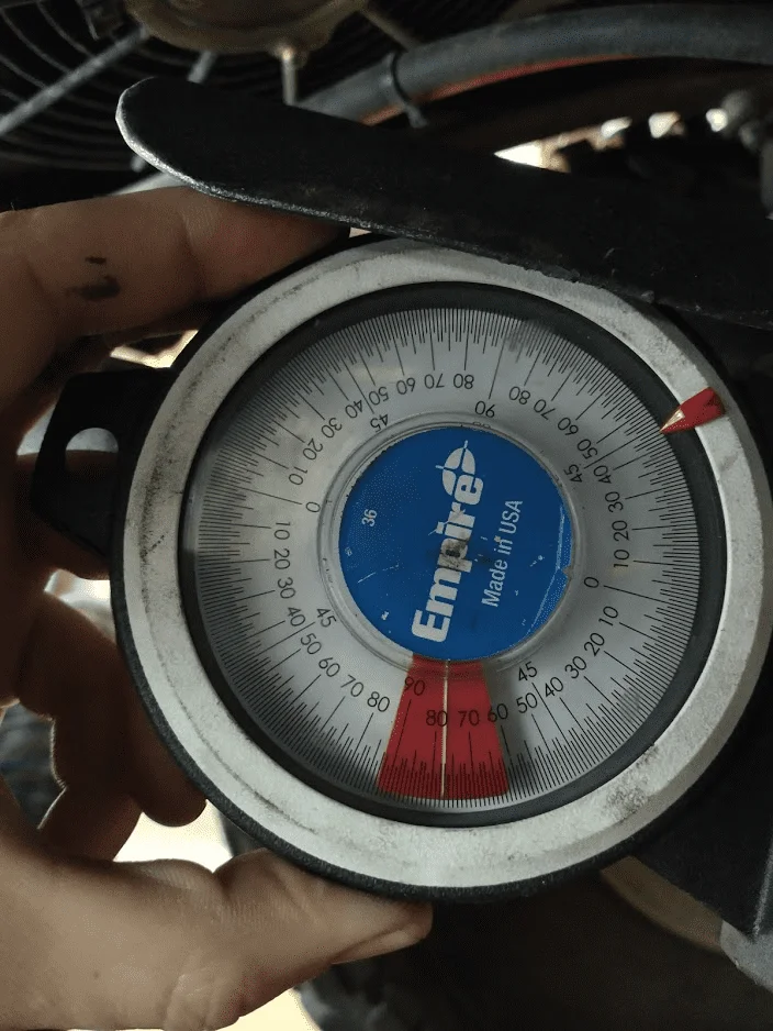

I've read a lot of stuff on the driveline angles to make sure I made everything work. Here are my measurements. The driveshaft is right about 17" center to center.
Tcase Output:
Pinion:
Rough angle (14.5°) :
My pinion is a bit off to get my 0° at cruise, but I have it pretty close I think.
I haven't been able to really flex this thing out much, so I cant really give numbers at full droop/compression.

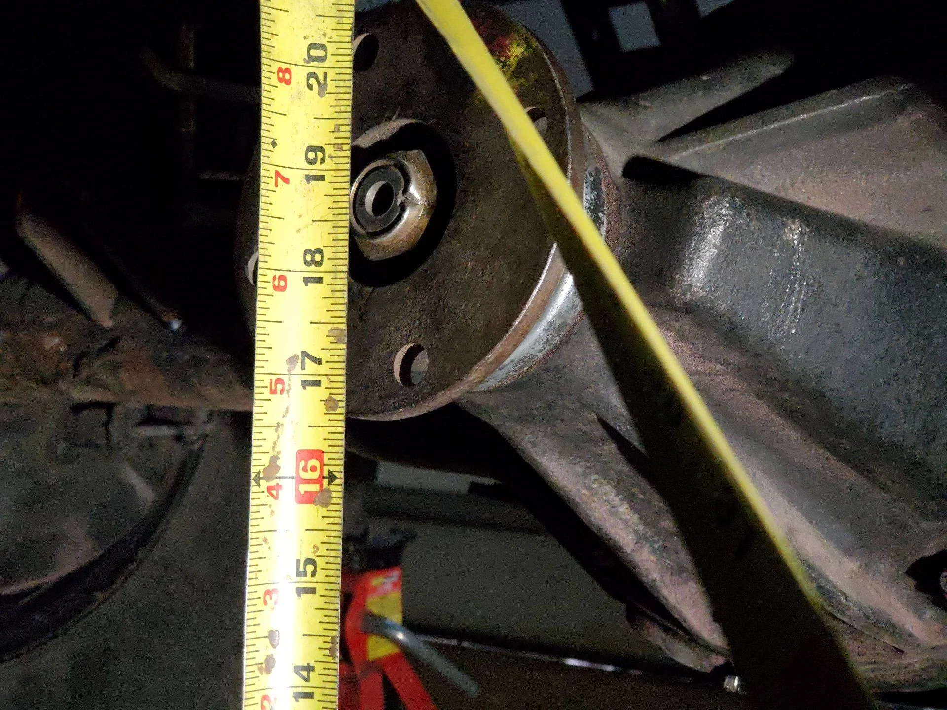

My rear drive flange is ~22 3/4" off the ground.

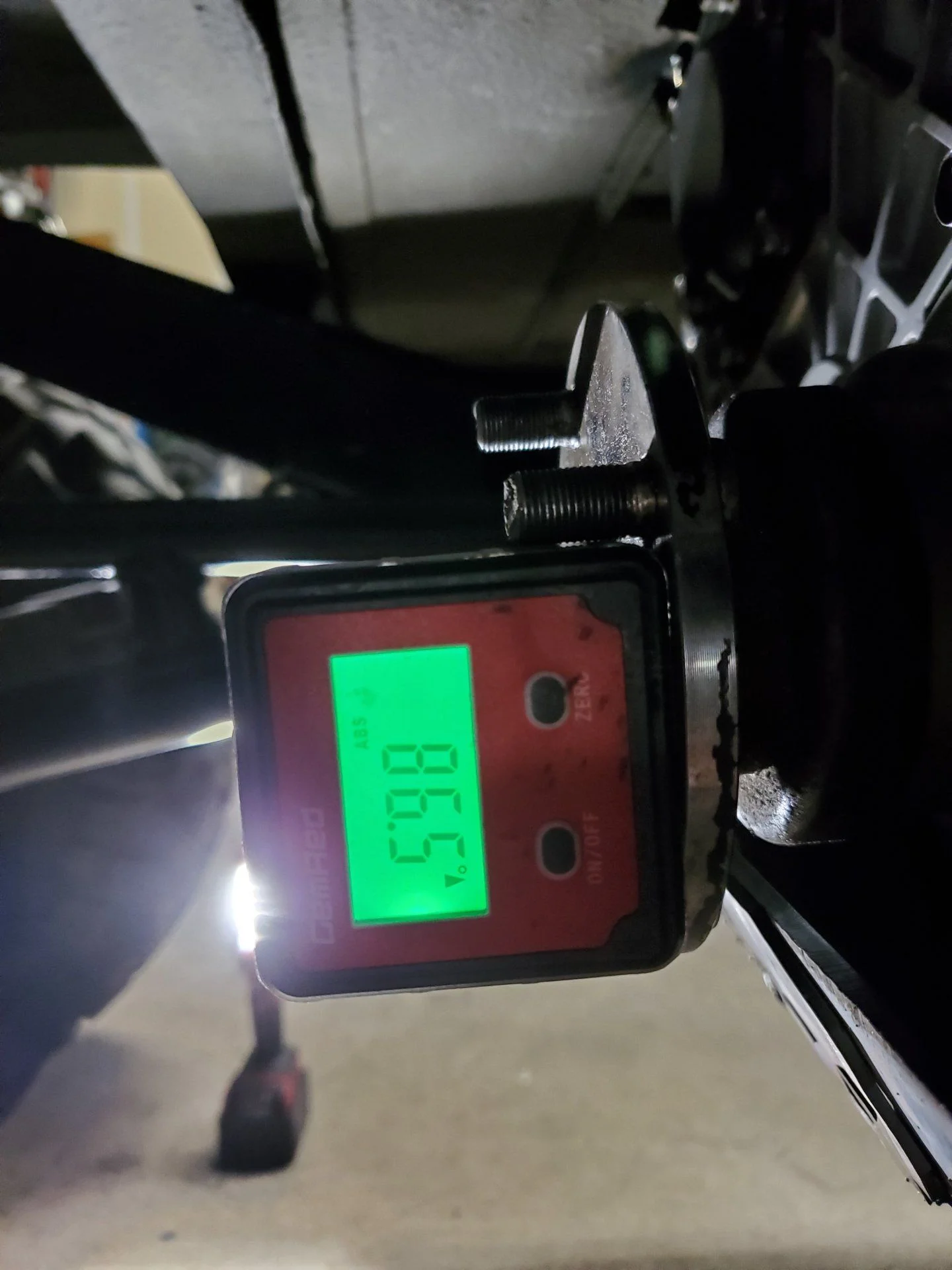

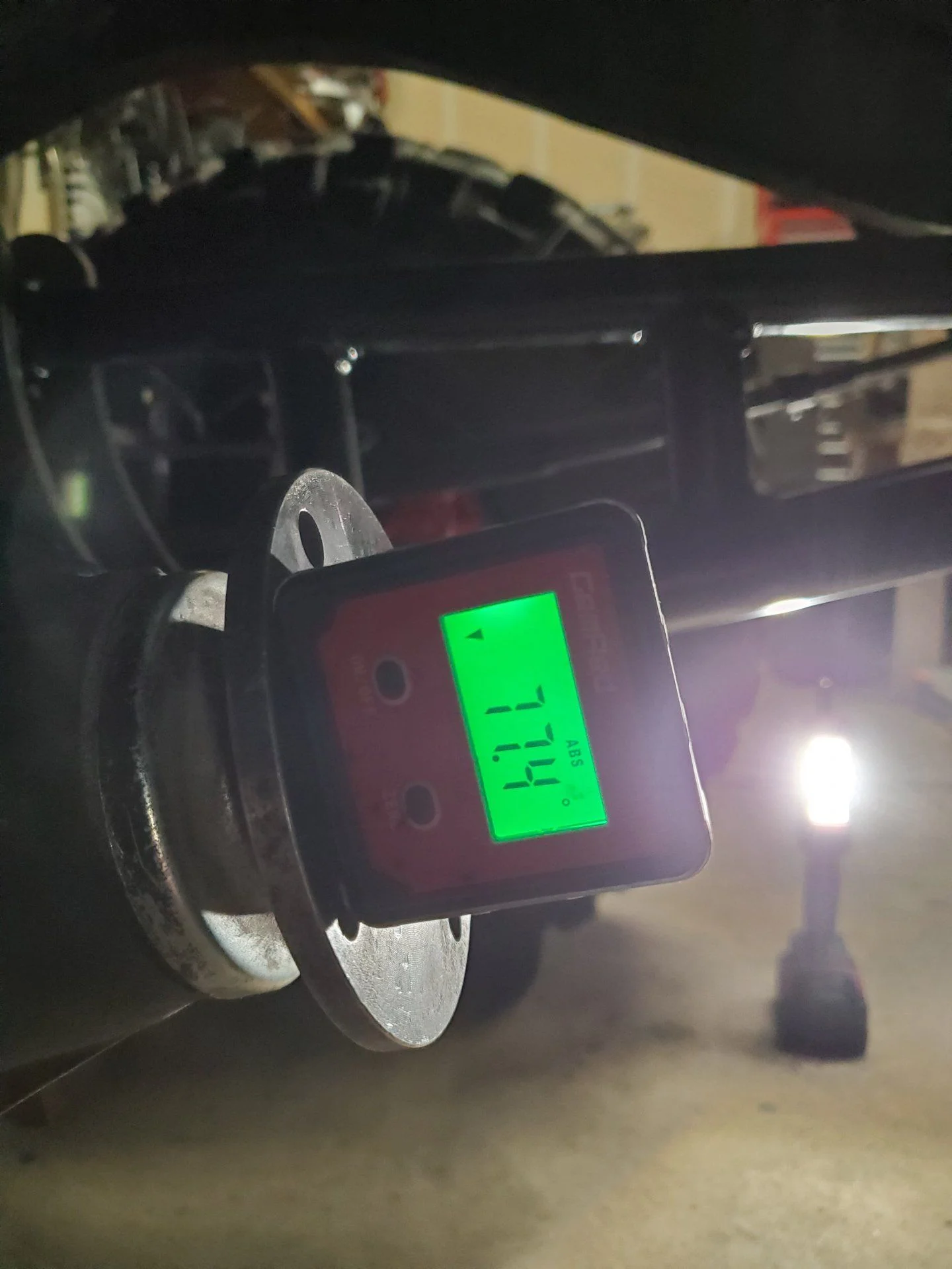

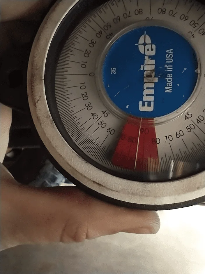

Here's my rear prop shaft setup:
Rear end:
Rear shaft:
Rear drive flange:
I set this up with the top off. There is usually 1-2* in less the rear.
Here's the angle of the truck:
SO about 2* butt side up.
Hope that helps,
Mike
