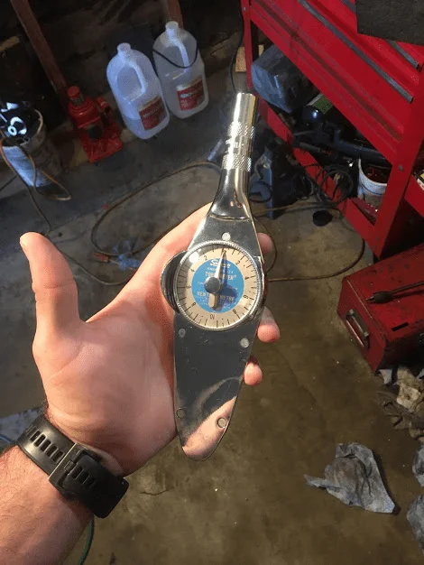

During the fuel calibration for the new cluster I noticed a dead spot in my fuel sender around half a tank. I ordered a new sending unit, and hope to get the fuel gauge working when it arrives.
1964982

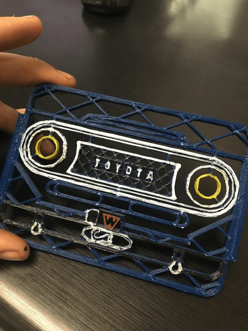

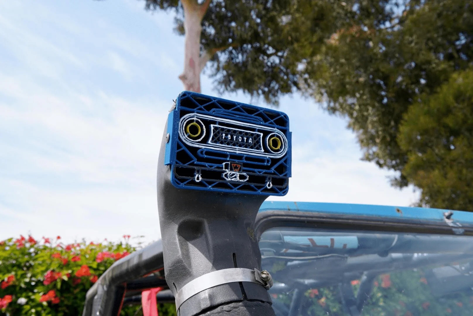

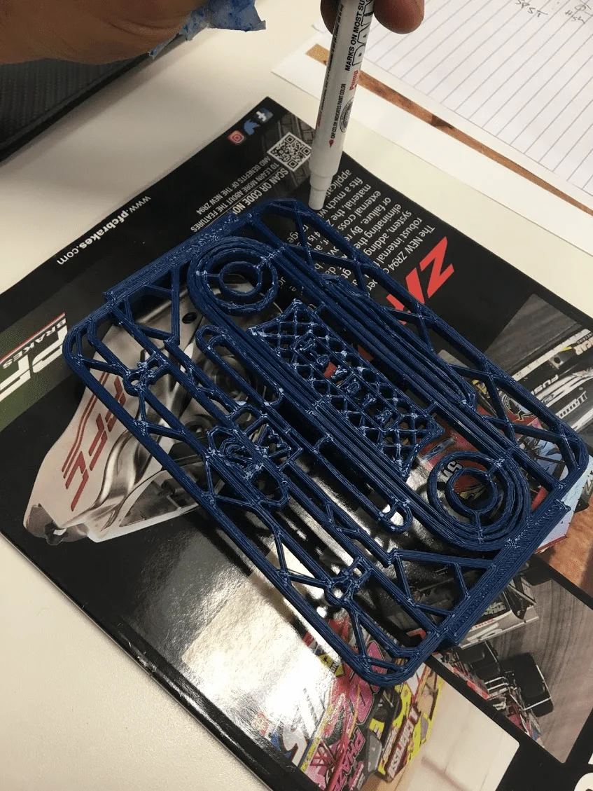

My buddy is always trying to incorporate his 3D printer in my truck here's what he came up with:
1967585
I stole some paint markers for it from work:
1967586
It's not my normal kinda style, but my buddies quadriplegic and anything he figures a way to make for me is pretty special:

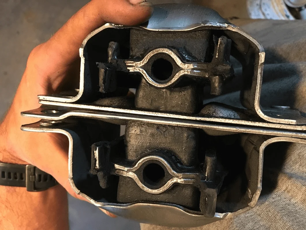

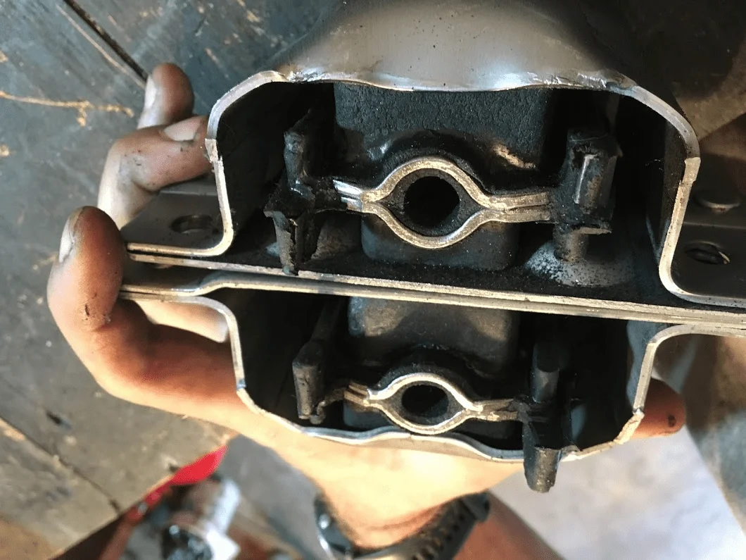

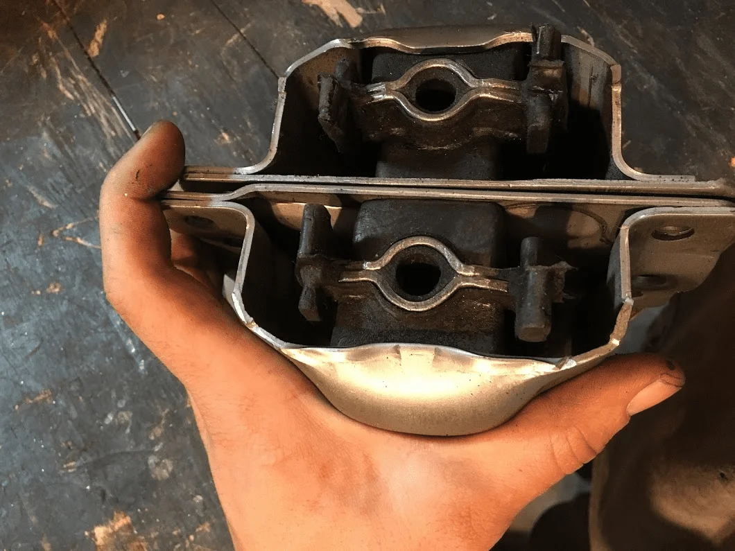

Before I made an adjustment I figured I would look into the engine mounts readily available one last time. I had a pretty hard time finding a straight answer on the web about the differences between the small block and big block engine mounts (besides the obvious bolt pattern differences) so I went ahead and ordered both to compare:
1977344
1977345
1977346
Contrary to what you can read online you can see there is a pretty obvious difference in the construction of the rubber portion of the mount (top mount small block, bottom big block). The big block mount has significant increases in cross sectional area in the bottom or compression portion of the mount. I cannot see the tension side changes as they are hidden behind the chassis of the mount. Hopefully this will help someone down the road.
Needless to say I will be using the Big Block Chevy mount moving forward.
There is ~1/4"-1/2" difference in the working/install height of the engine mounts with the big block being taller. Many of these changes could be due to the increase in weight of the larger engine.
I will be lowering the engine mounts 3/4" and raising the transmission mount 1 3/4" when I get a chance, which will in turn point the front transfer case output flange 3.5 degrees closer to the transfer case. This should make everything really nice taking advantage of the new transmission to engine angle of my new adapter.

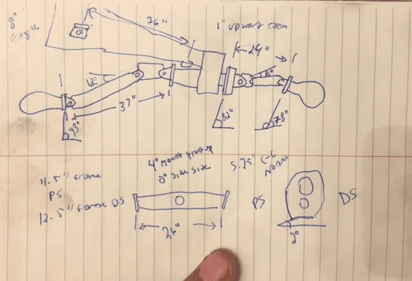

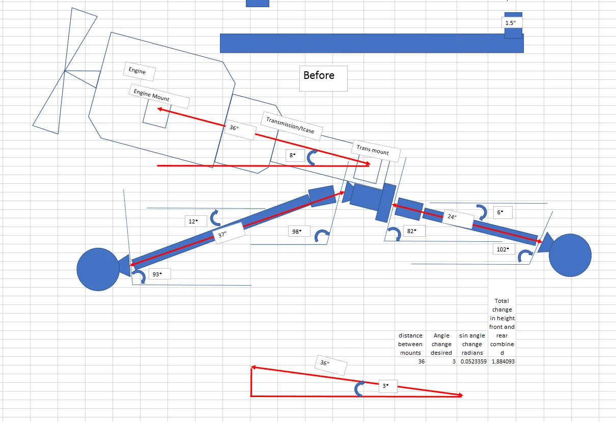

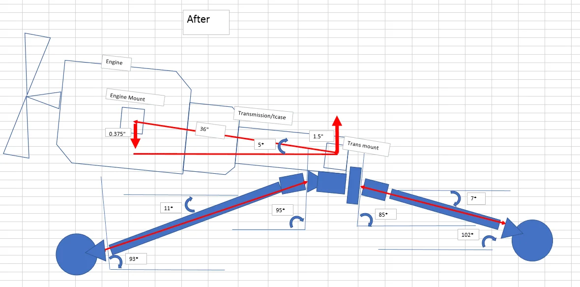

Maybe I’m just being anal about it! I read in the spec that I’m about 2 degrees too steep in the front and the opposite in the rear.
I don't see anything extreme in the vid posted above, driveline angles look good.
Maybe I'm just being anal!
My engine is between 7-8* leaning back so I've been looking to make it ~5* which I think is going to be the happiest place for it.
Here are my crude drawings (sorry made this while I was on my back under the truck):
1978616
And then here are the current angles:
1977950
After my proposed changes:
1978084
There's some wiggle room there, so well see how much I can move it before things start to get close. I'll be sure to post my measurements after the changes.

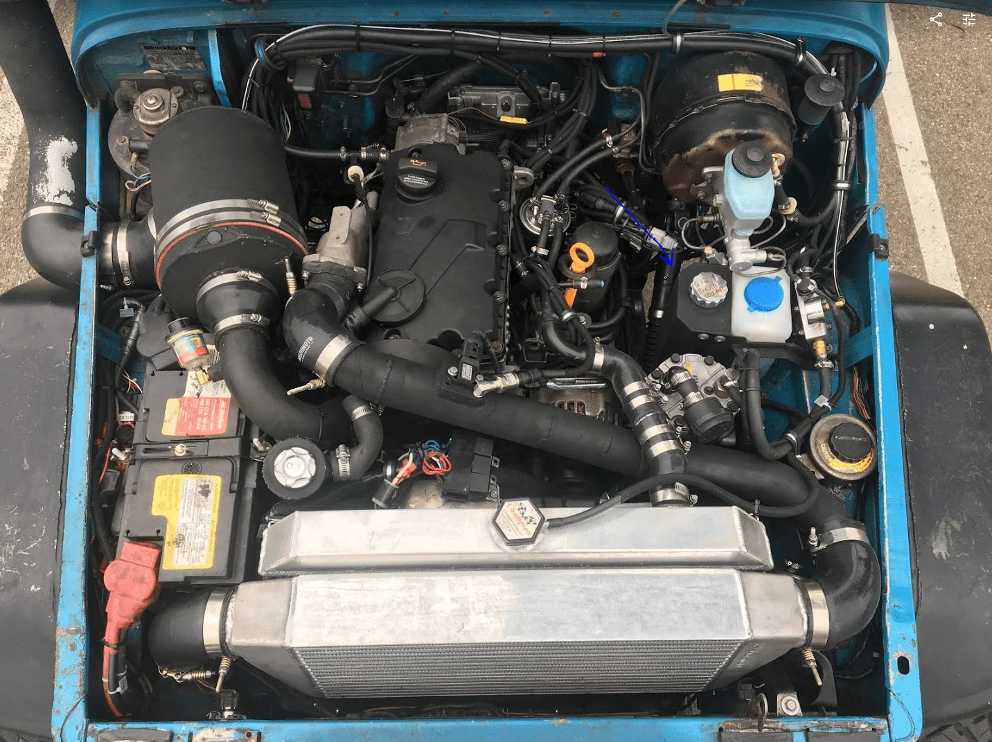

I made a few last min changes before the trip towing the trailer last week:

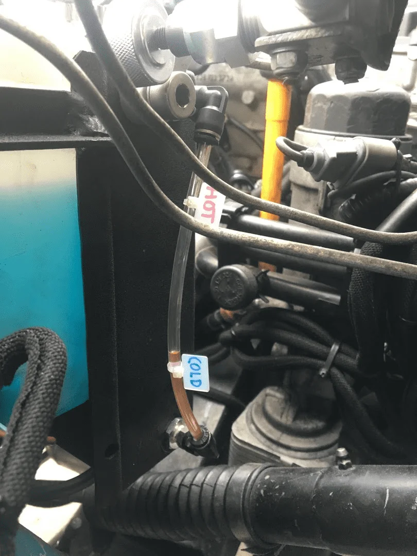

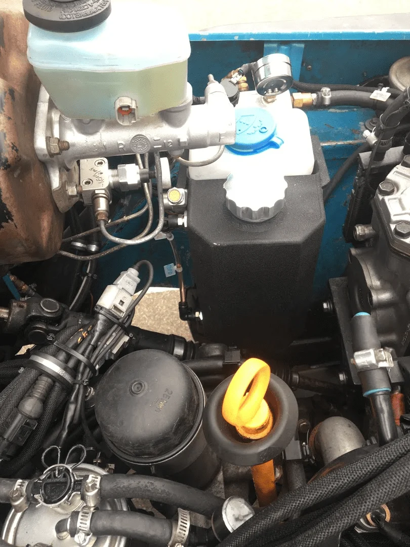

The Coolant Overflow bottle I had made before was approximately 1L in size, which proved to be just a tad too small. When the engine was getting toasty up a steep grade out in the High desert it would just be small enough to push fluid through the breather. Once the engine would cool after a hard days work it would show just barely an inch of fluid above the floor of the overflow bottle. Too close for comfort. I should have know as my truck holds over 3 gallons of engine coolant and there must be appropriate expansion room.
Here I built one twice the size ~2.0 L (blue arrow is hard to see), along with a new cold side charge pipe with increased clearance all around:
1977962
The sight tube is easily seen from the driver side looking into the engine compartment, along with all the other fluids in the engine compartment:
1977963
1977964
Now it goes from~1/3 to ~2/3 which gives it a bit of extra room in the event of a higher than normal coolant temperature spike.

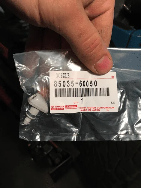

Finished inststalling and wiring the washer fluid system:

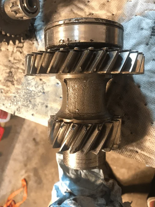

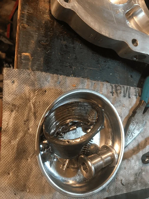

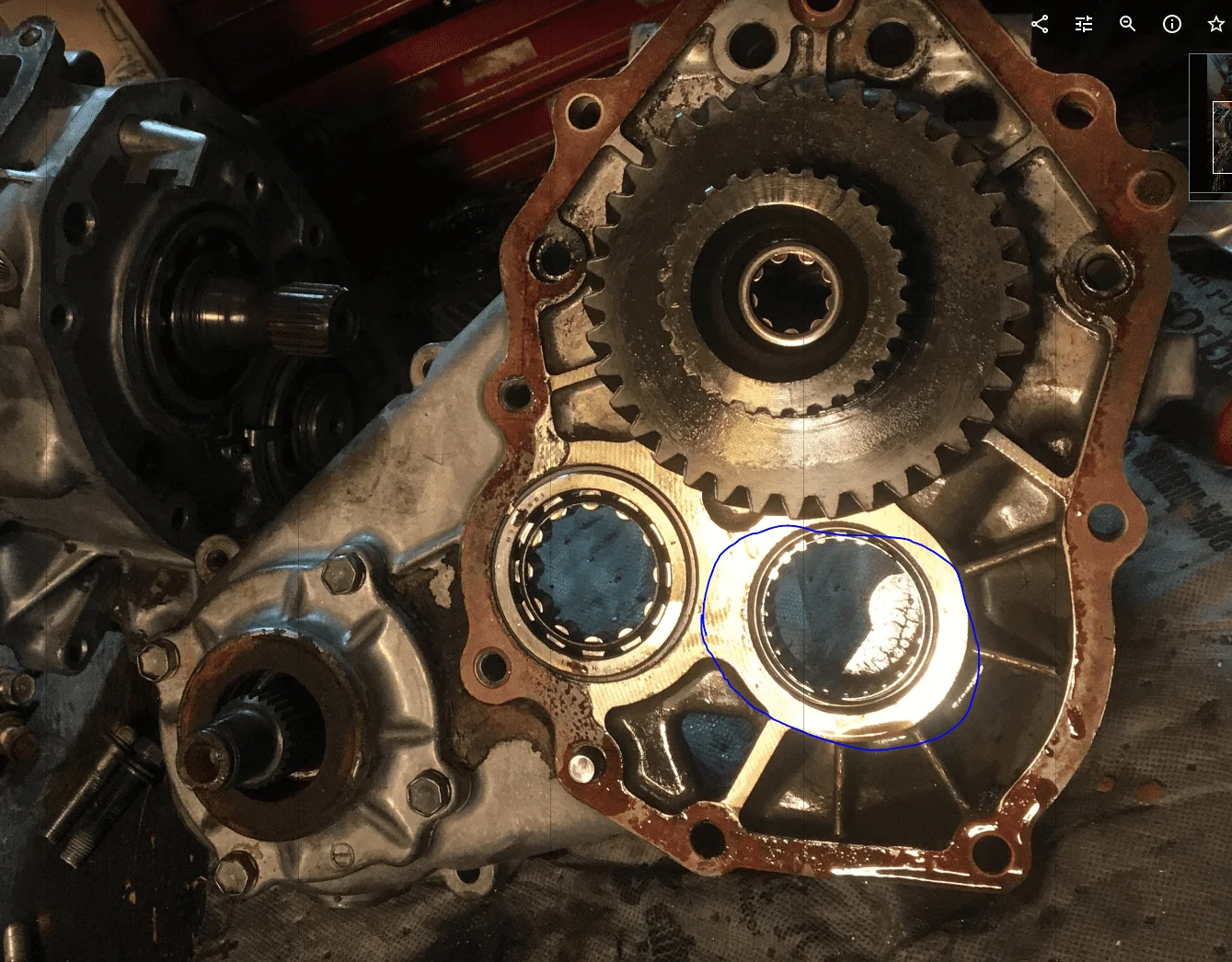

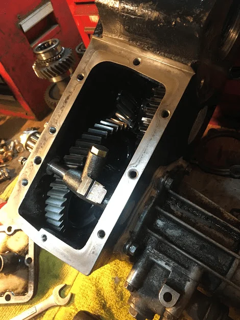

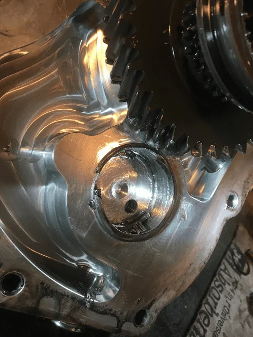

I got the truck home after a few days and parked it in the garage. The following weekend I tore into it and here's the carnage:

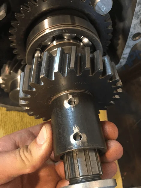

Unfortunately as expected it took the counter shaft with it:
My hypothesis was correct.

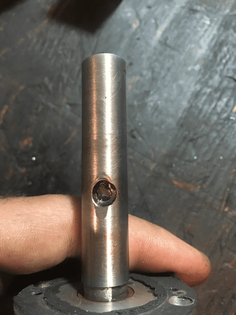

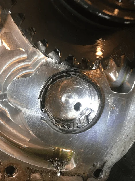

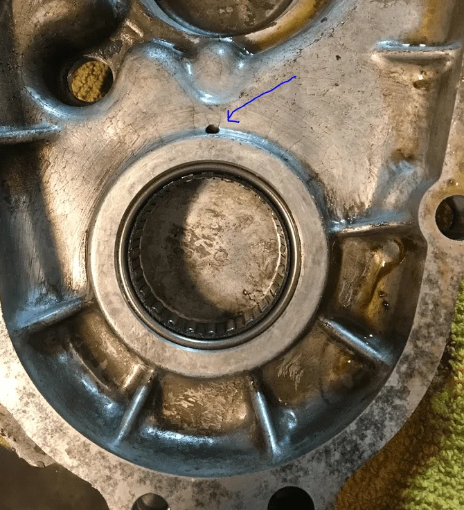

Now I have a confession to make; when I put this thing together after the last bearing failure I could not find a way to pull this bearing out cleanly so I cleaned it up and gave it a quick look over and assumed it was OK to reuse. All the rest of the bearings were good to go.
Now besides that prior oversight I had several contentions about this portion for the adapter plate. The first is that the bearing is sunk into a blind hole. Here is the original application of the bearing used by the kit:

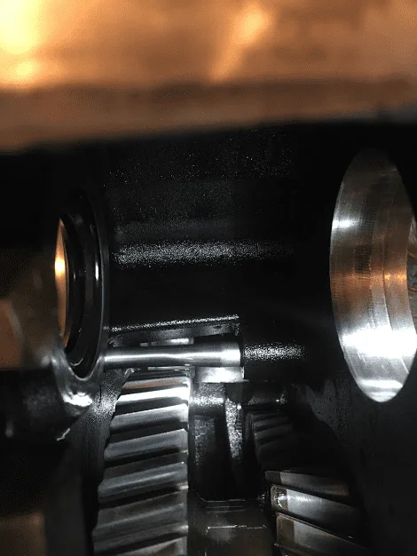

As you can see it is a though hole. this allows the bearing to have a lot more oil flow and run much cooler. I should have done something about this in the first place, but Oh well.
Now there are other ways to lubricate this type of bearing in a blind hole. For instance here's another application that sees an even higher shaft speed:
Notice the oil feed hole and the recess behind the shaft the bearing will ride on to allow an oil volume.
Once again with the bearing removed:
Oil hole and recess shown with arrows.
OK so now we know why it overheated and finally so time to make it better.

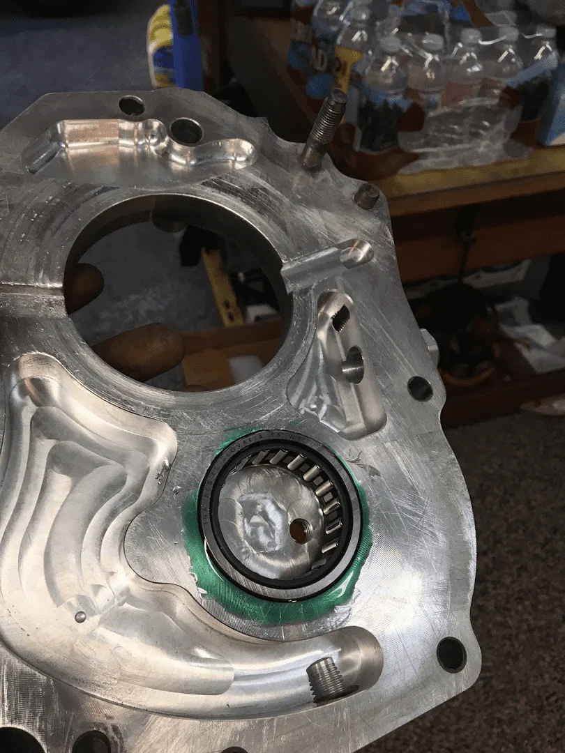

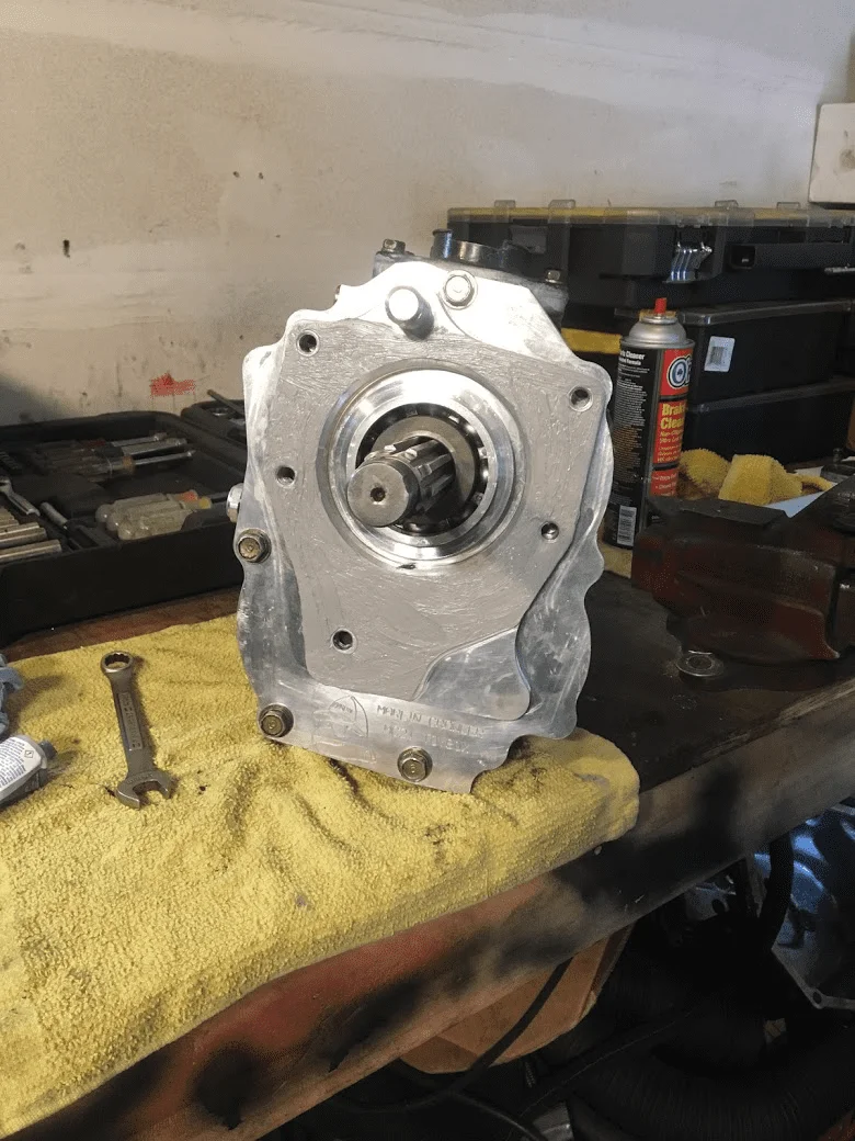

Ok so this brings us to the modifications:

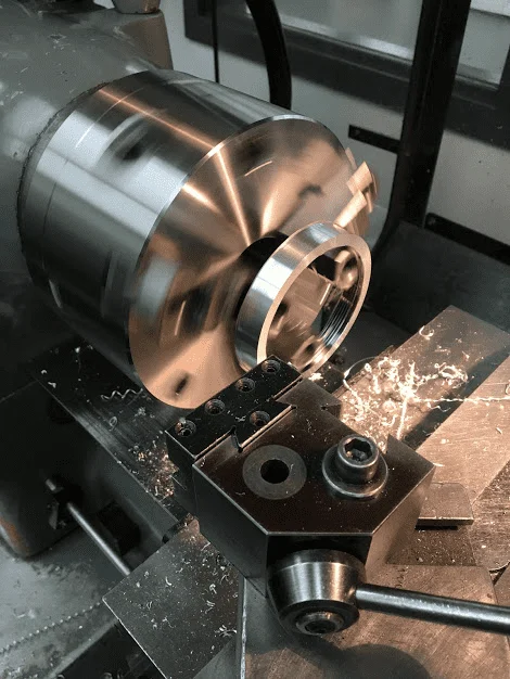

I sized up a larger rolling bearing with a safety factor several times higher than the original in both axial loading and shaft speed and did some machine work to accommodate it:
In addition to the machine work I added some oiling features. Here you can see the recess and two oil feed holes:
And finally the bearing pressed in with some retaining compound:
And ready to assemble this time with all new gears and bearings:
Oh yea!

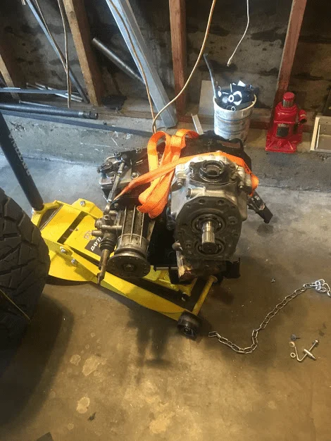

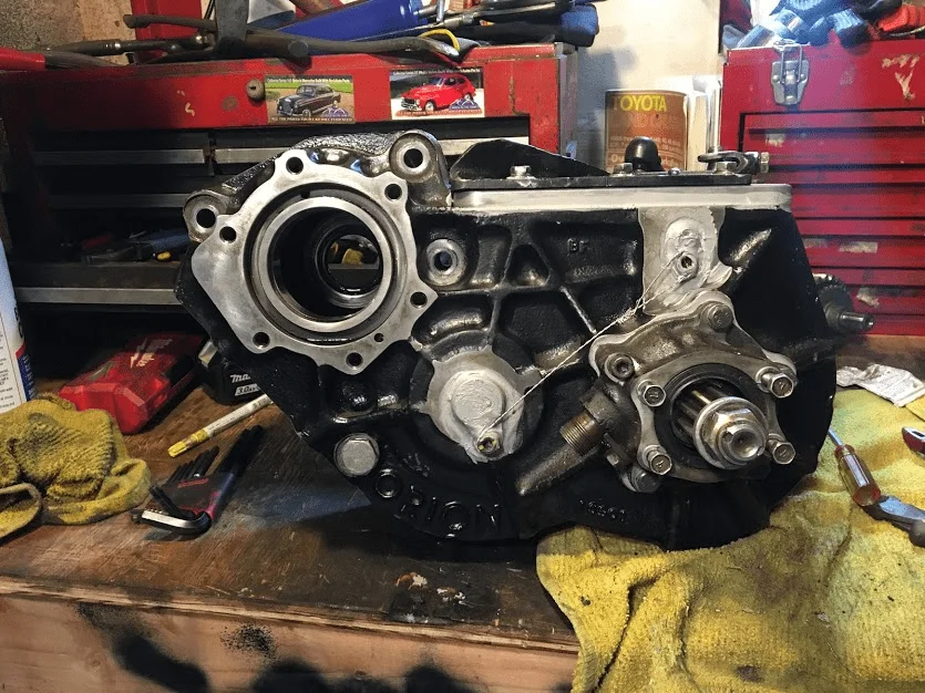

Now on to some additional mods while I had the transfer cases apart:
Checked the preload on some bearings:

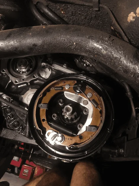

Split and resealed/inspected the Orion. The gear wheels are substantially larger than those in the mini truck boxes:
Resealed:

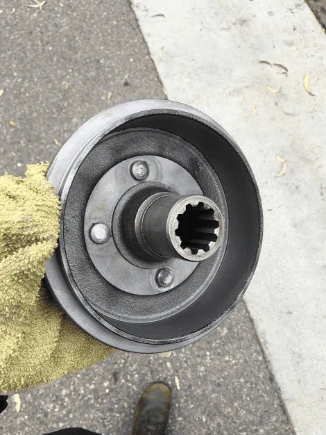

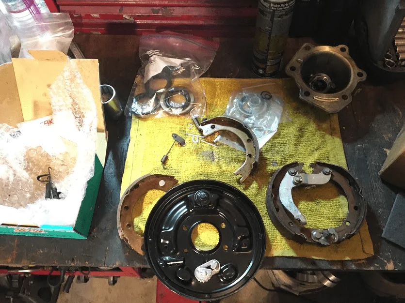

Re surfaced the parking brake drum:
The assembly came out of the parts washer like new!
I learned it's a lot easier to maneuver the assembly with no parking drum. it clears the rear cross member much easier making the alignment a piece of cake!
Put the brake together:
Hope I got this right from memory:
Don't want these to loosen up:

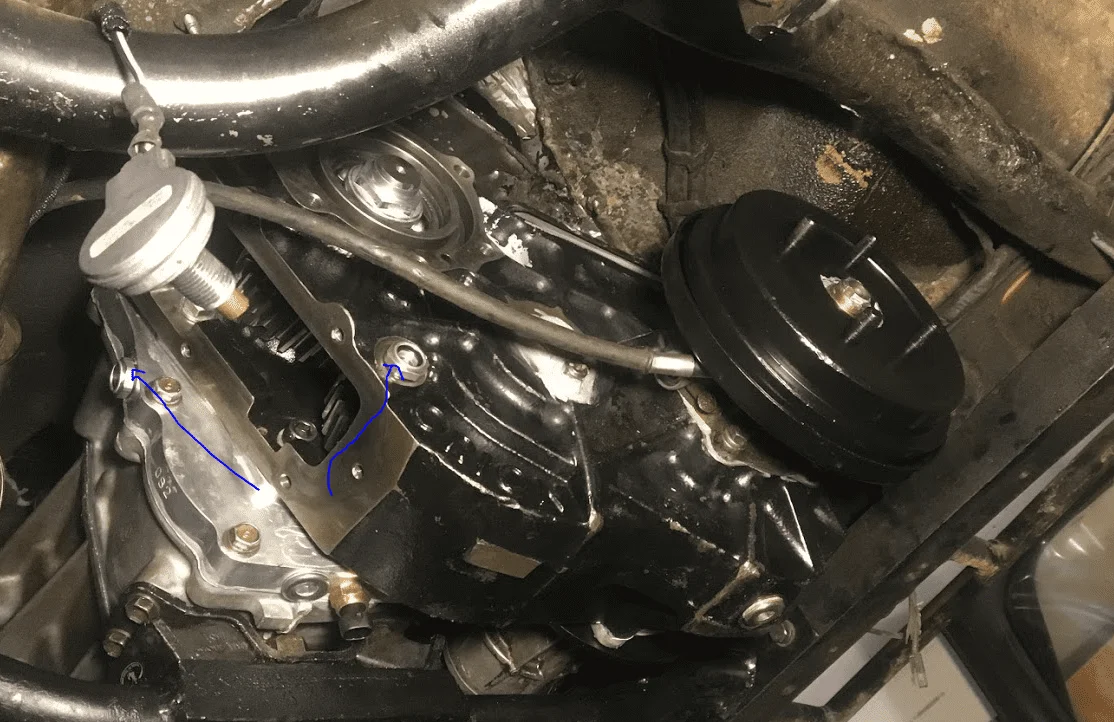

Added sight glasses to the transmission transfer case and reduction box to monitor the fluid level and quality:

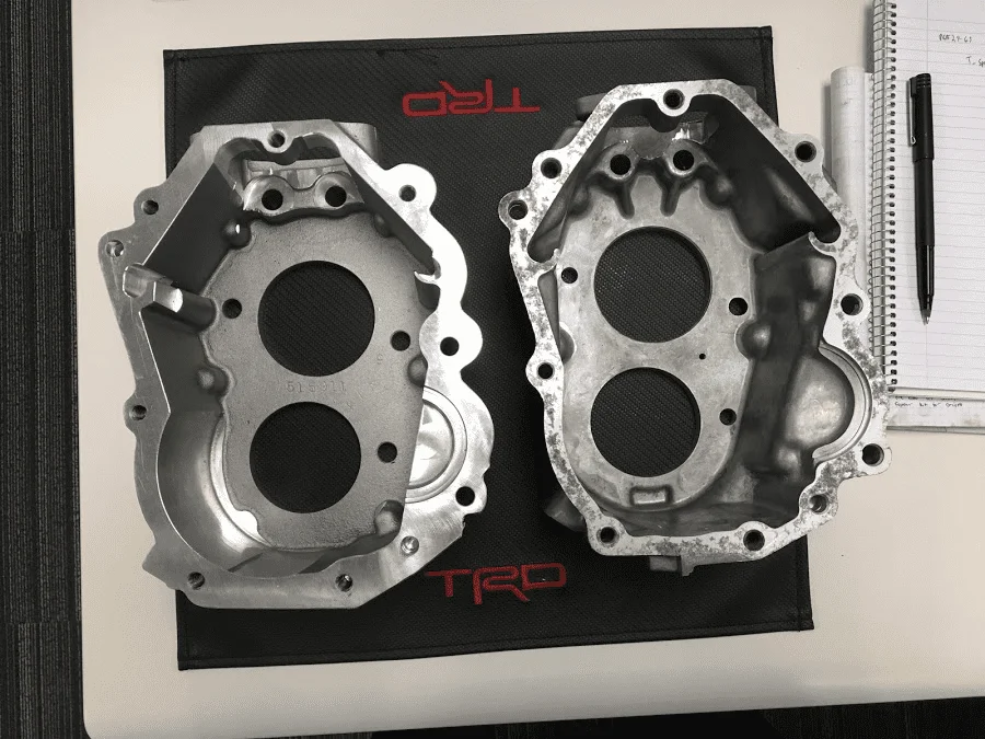

I was also planning to run the Advaced Adapters heavy duty housing for the reduction box but the casting quality was so poor I had to send it back:
If you're interested in more details on that I can share more.

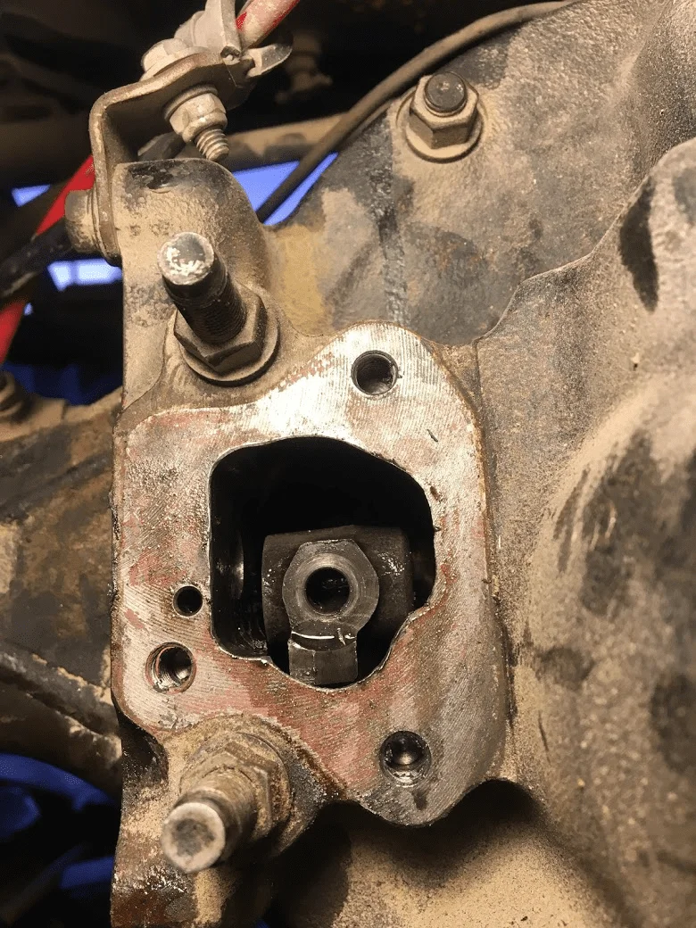

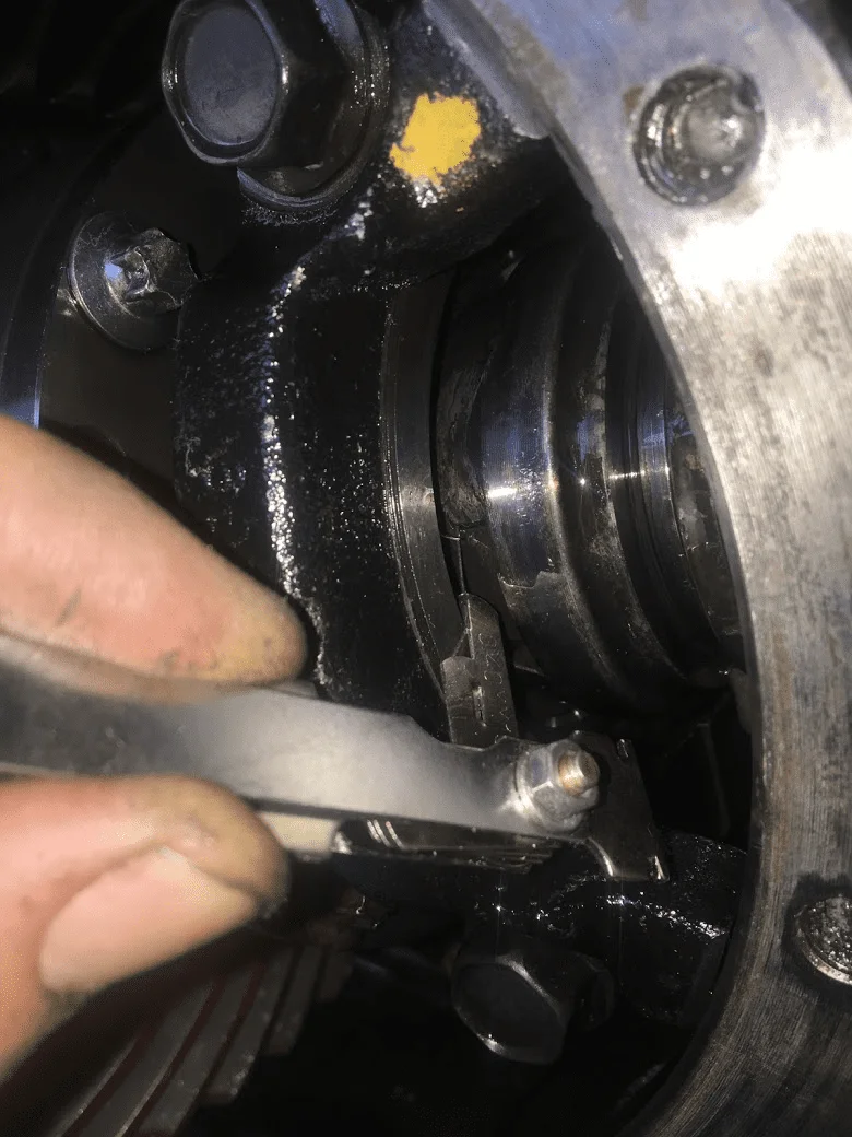

I was headed up the first waterfall when I realized my rear locker wasn't working. I thought about turning back, but with the front ARB the truck just kept on going without a hitch. When I got home I tore into the truck to see what happened:

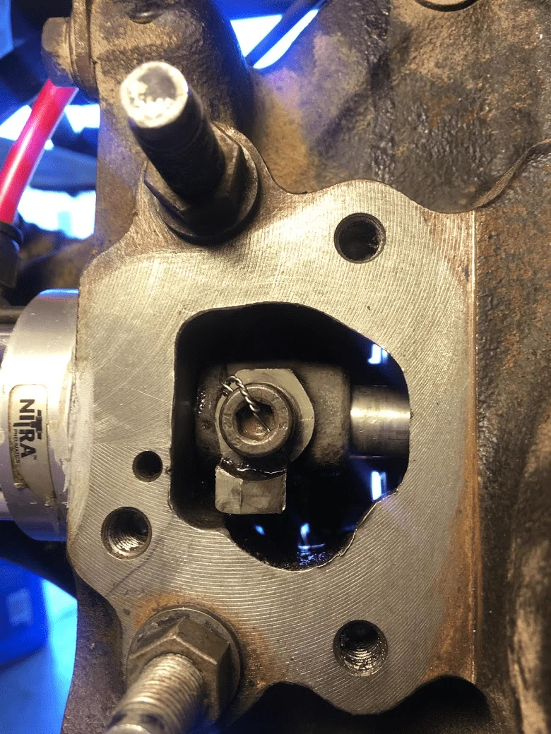

Pulled the cover with the indicator detent:

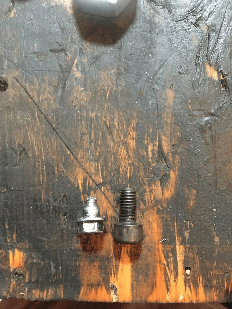

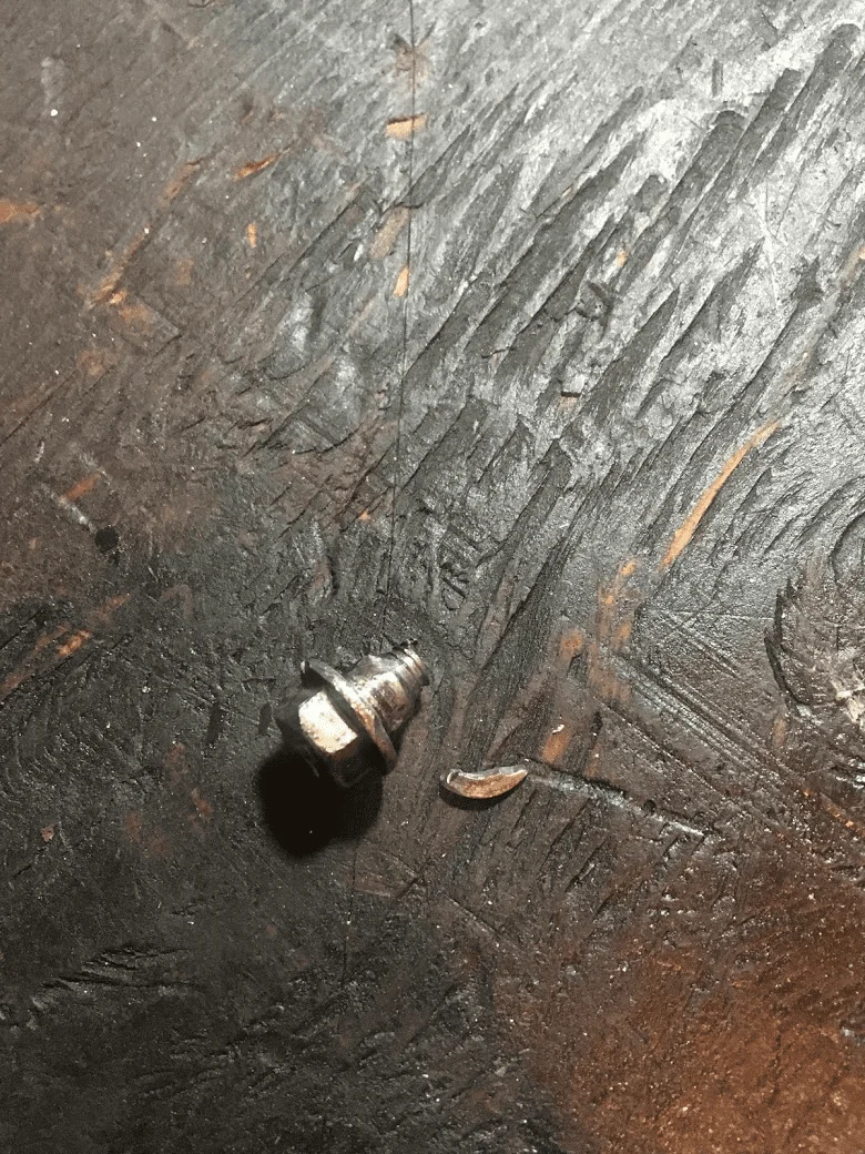

Looks like it sheared the fastener between the engagement fork and the pneumatic actuator:
Easy fix but where did it go?

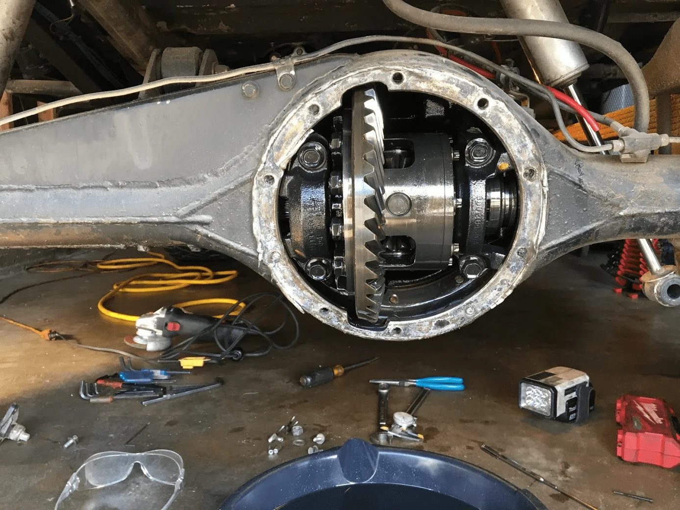

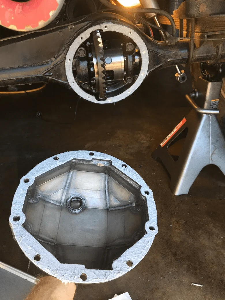

So I searched everywhere and couldn't find the head of the bolt. It must have found its way down into the diff housing...
Poped the cover off:
I got really lucky:
Found it and as far as i could tell all the remnants. I looked over the ring and pinion and didn't see any witness marks, so ill just assume its all good :)

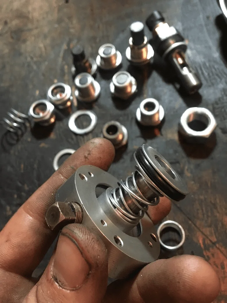

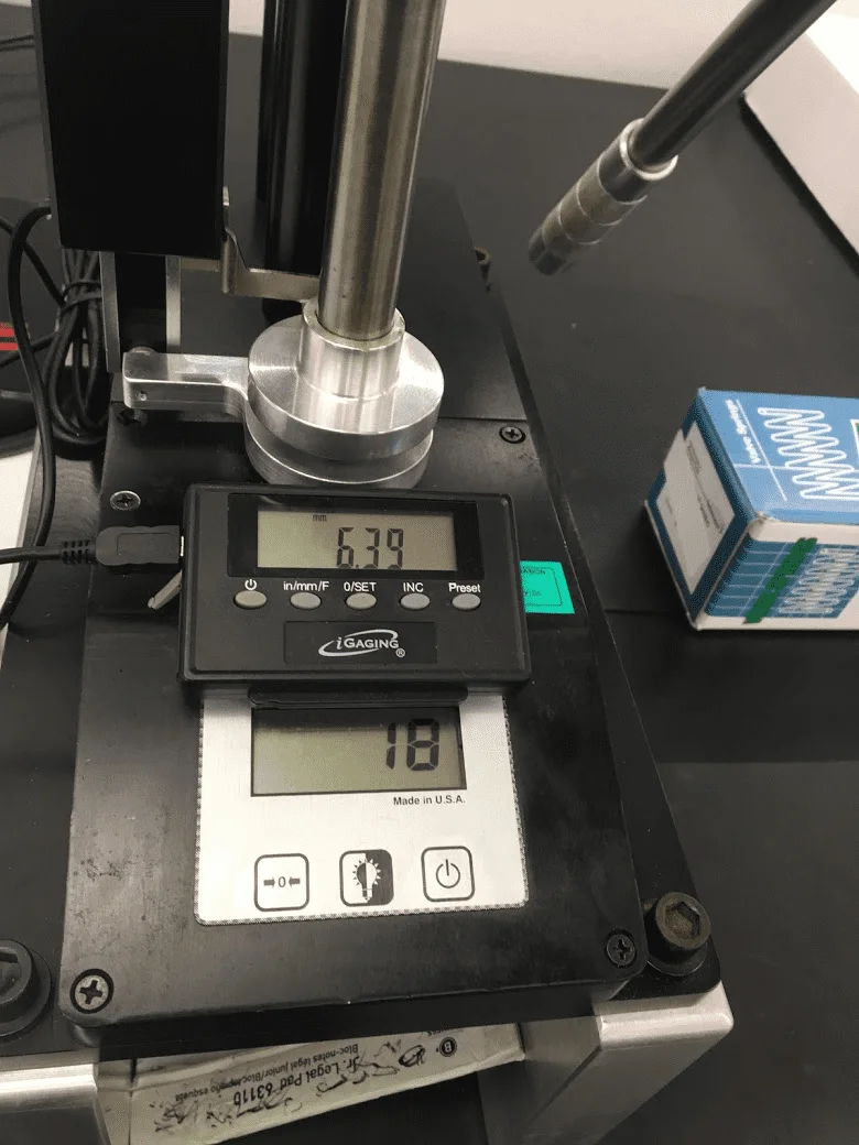

As for the rear locker setup, I always hated how long it would take for the locker to disengage. It would take forever to disengage but would lock instantly.
Here's my solution.
Sized up a few springs:
Ended up with a triple spring setup (sorry only a picture of the two springs I forgot to take on with the final third outer spring is installed):
Low the actuator begins to move at 30 PSI and has full lock at 35. Before it was less than 10 psi.

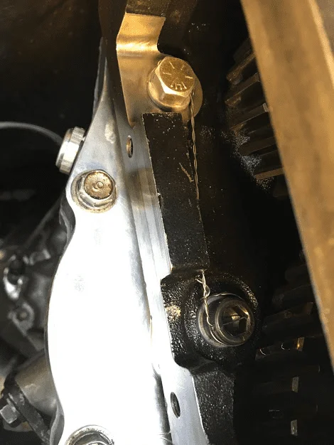

I set the gap so there's no undue stress on the fork when locke

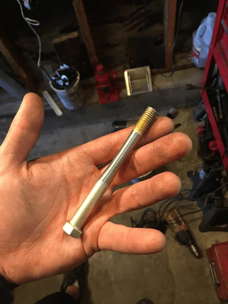

As for the bolt I was able to fit a M8 grade 12.9 bolt in place of the M6. Should be quite a bit stronger:
Safety wire to retain it in case of another failure:

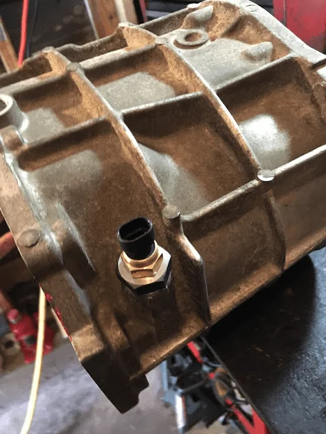

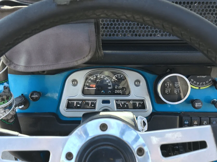

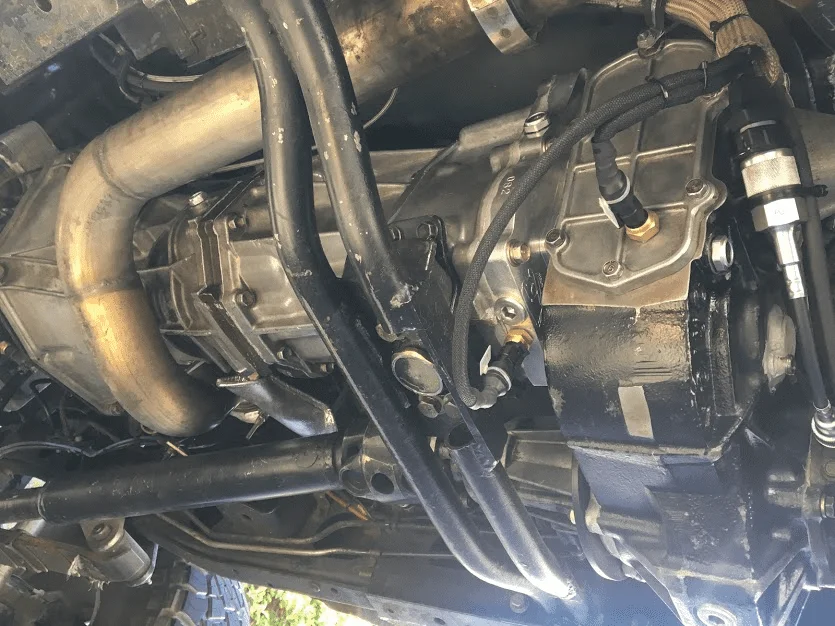

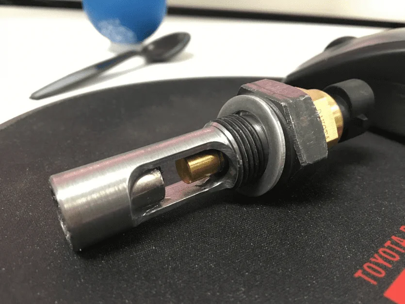

So I machined a few parts to accept temperature senders:
I didn't want to remove the transmission to drill and tap the case for the temperature sender, and I wanted to add a magnetic drain plug so this was my solution. I chucked up a 10.9 bolt and made this. The magnet is pressed in with retaining compound from behind into a lip at the end, and then staked so it wont move. The sender is a thermoresistor and will not be effected by the magnetism.
All three senders installed (See the spark plug boot for thermal protection on the transmission sender) along with a new Hall effect speed sender so now my speedometer can read down at lower vehicle speeds:
If you look closely you can see the 18mm sight glasses in the trans/transfer/crawlbox as well.
Chucked up and made a bezel:
And skipping all the wiring and circuitry here's the additional gauge added to the dash:
It communicates with the DD dash via CANbus signal, so I can put whatever I want in the additional gauge which is nice. Also I didn't have to drill any holes in the dash, just ran the wires through the Brake/Seatbelt warning bezel. These warnings are now plumbed into the cluster as well.
