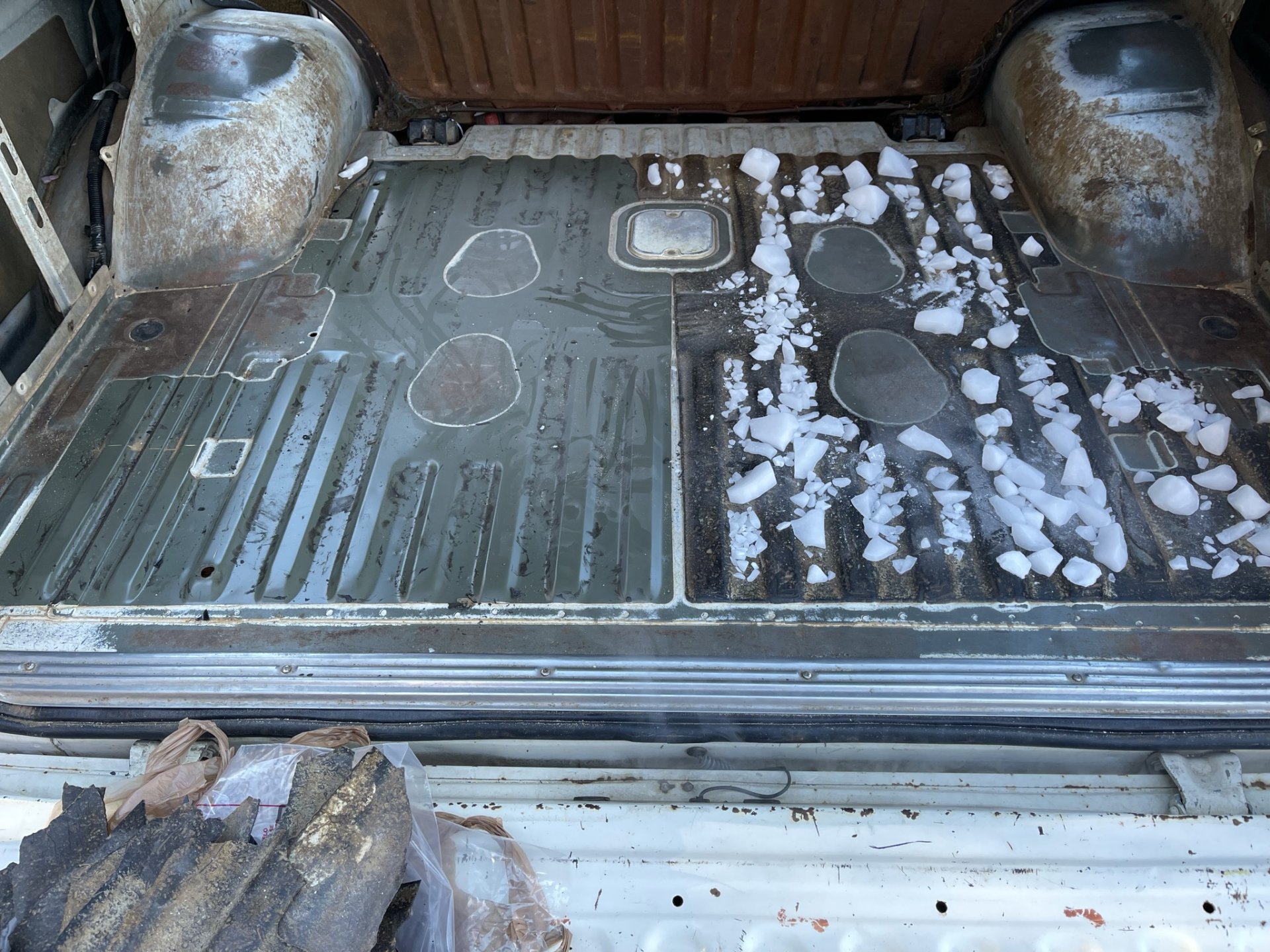

For anyone doing this later, the smaller you can make the dry ice pieces, the better. Let them sit for about 15 minutes and then start hitting it with a mallet. Next steps are to order some sound deadening material to cover this back up once I get it back and then the carpet kit from another user on the forum. I was quoted $12k for a doors/trim off respray in the factory 033 Toyota white and that comes with a lifetime guarantee on the paint. For now the paint and body are solid so I think I'll work on getting the interior how I want it and addressing any mechanical issues that come up along the way. My passenger side reverse light is out for some reason so I've got that short I've got to chase down but nothing else that's pressing. I've got a pretty good roadmap of what I want to do and how to do it, just a matter of getting it all done.

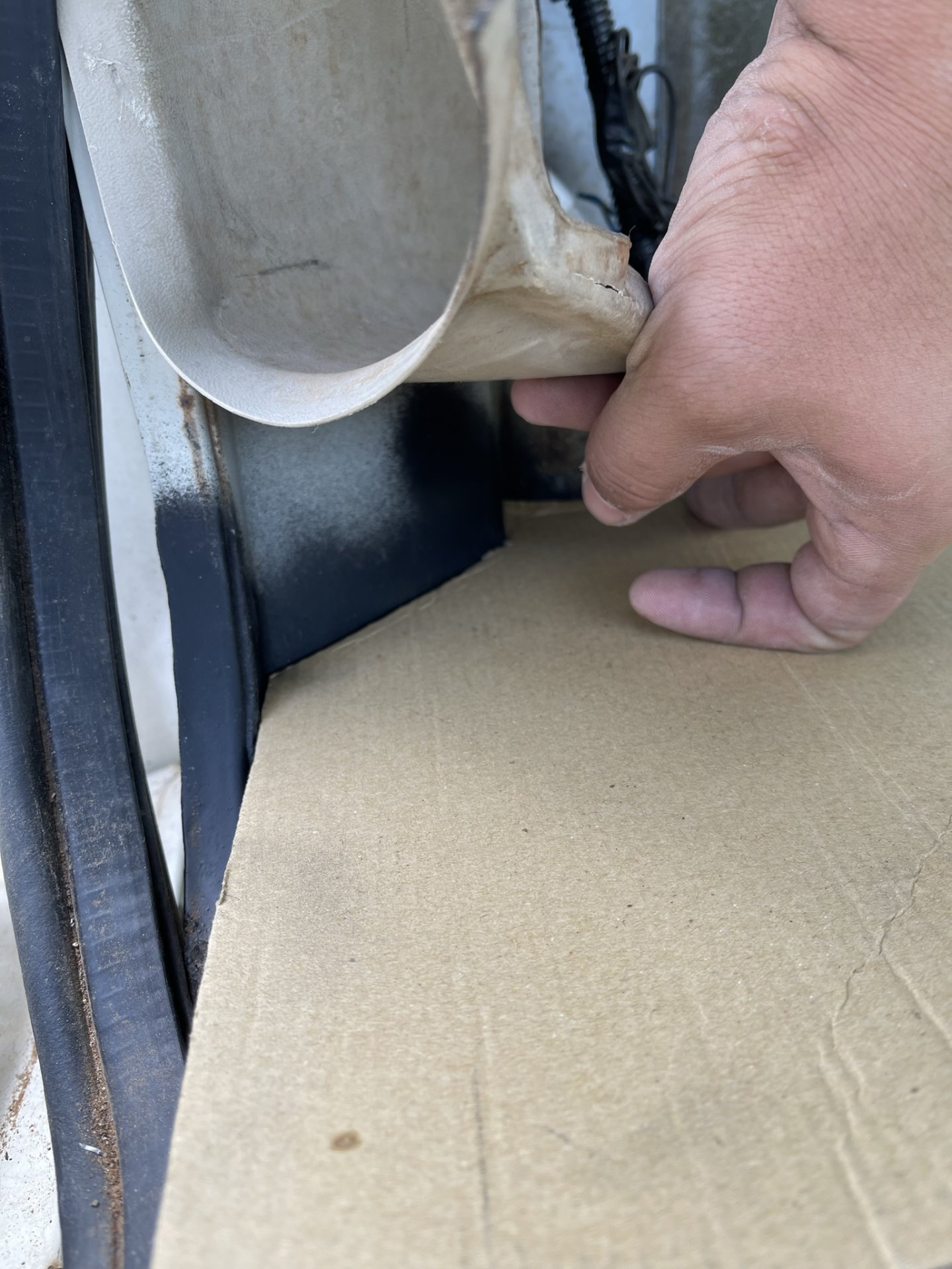

Tracked down an high pitched whine to my transmission. It sounds like the throw-out bearing is resting on the clutch springs. For the past couple weeks I've heard a creaking when I push the clutch pedal in and thought nothing of it since I didn't notice any performance changes. Hoping it is just an new slave cylinder that will fix it so I've got one ordered that should be here in a few days.

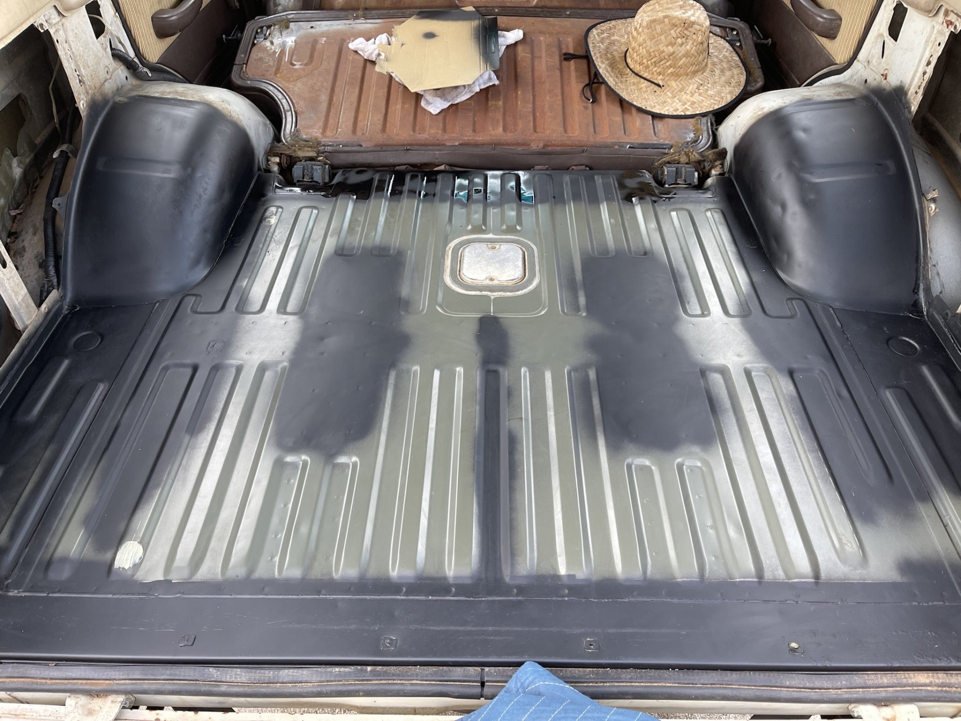

Goo-gone and rust converter spray prep in the rear. Some of it was surface rust, the rest of it was caked on dirt that came off with a ton of elbow grease.
Basic CAD work to make sure my patches fit nice and snug.
Made use of the mid 60's/70 degree weather we've had. Got the trunk floor done in a couple of hours and I still need to do the rear quarter walls to consider this part done. If anyone knows a way to get the stock sound deadening off the quarters I'd love to hear it. Some of it is still on there nicely, other patches are barely holding on and its kind of a pain to scrape it off in tiny chunks.
Going to vacuum out the sides and cover what I can in rust reformer just to be safe. Once that's done I'll have to put mat down there too.

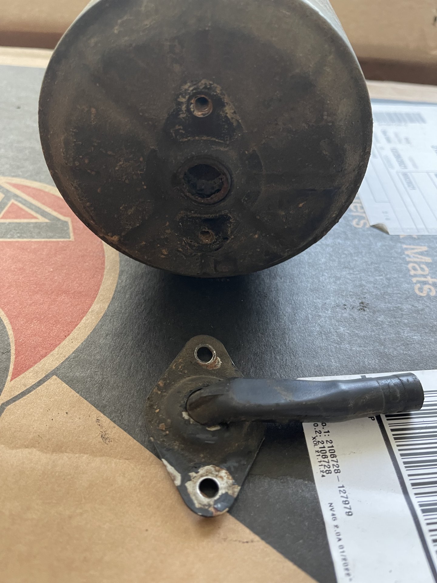

Charcoal Canister Replacement
Toyota has discontinued our charcoal canisters and the most widely used replacement piece is the ACDelco 215-153. You can find one here. Signs that your isn't working properly are pressurized gas tanks with air rushing out when the gas cap is removed, rough idle on startup, needing to feather the throttle on startup (cold weather is the exception) and running rich.
This piece is responsible for a few things. It serves as a vent for the fuel bowl in your carburetor, it regulates pressure in your gas tank, and it prevents condensation build-up in your tank. If enough condensation builds up in your tank your fuel will contain trace amounts of water. Over time you can foul your injectors and spark plugs if this does not get fixed. This is mostly a collection of information and photos I've found on the forum, most of which can be found here, with some added details. Their photos are better than mine and I don't see the point in adding duplicates.
To remove the OEM cannister you'll need:
  • 8mm socket
  • 10mm socket
  • 12mm socket
  • Extensions are nice to have but not necessary. I used a 1/4in ratchet and about 12" of extensions due to space constraints.
This is what you'll see on the passenger side of your engine. Red box is what is being removed. The blue circle is one of two 10mm bolts that need to be removed to loosen the mounting bracket for the OEM cannister, the other is directly below it. The green circle shows the location of one out of four 12mm bolts that I needed to remove to take the mounting brackets out of the vehicle. The replacement cannister is larger than our OEM units and I couldn't make it work with the brackets in place. There is also a 10mm bolt that holds some lines to the cannister mounting bracket that will need to be removed. You can remount those lines to the uprights that held the cannister mounting bracket in place.
The last item holding your cannister in the vehicle are two 8mm bolts on the bottom that vent the tank to the atmosphere. It was easier for me to unbolt this fitting because the line connecting to the atmospheric vent was as hard as a rock. It's easiest to unbolt this from the under the truck using a couple extensions.

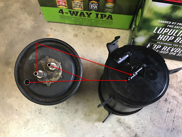

This is how the old lines will connect to the new charcoal canister. You'll need to combine the outside lines through a tee connector.
And this is how it should look when you're done.
I want to add information in the mounting and line setup. You can make 5/16" fuel line work for all of the connections but you will have to be careful with the VCV. The elbow that joins the valve to the original canister that is most likely too fragile to re-use so keep that in mind. A better size line for the VCV would be 3/8" but a 5/16" can be massaged onto it if you've got strong fingers. I bought five feet (more than enough for mistakes) of 5/16" fuel line and a 3-way brass tee connector rated for fuel as well as some zip ties for mounting. Hose clamps are not necessary here because none of these are high pressure lines.
I used zip ties to keep the cannister snug to the original bracket uprights and if I go back to make it cleaner I'll update this.

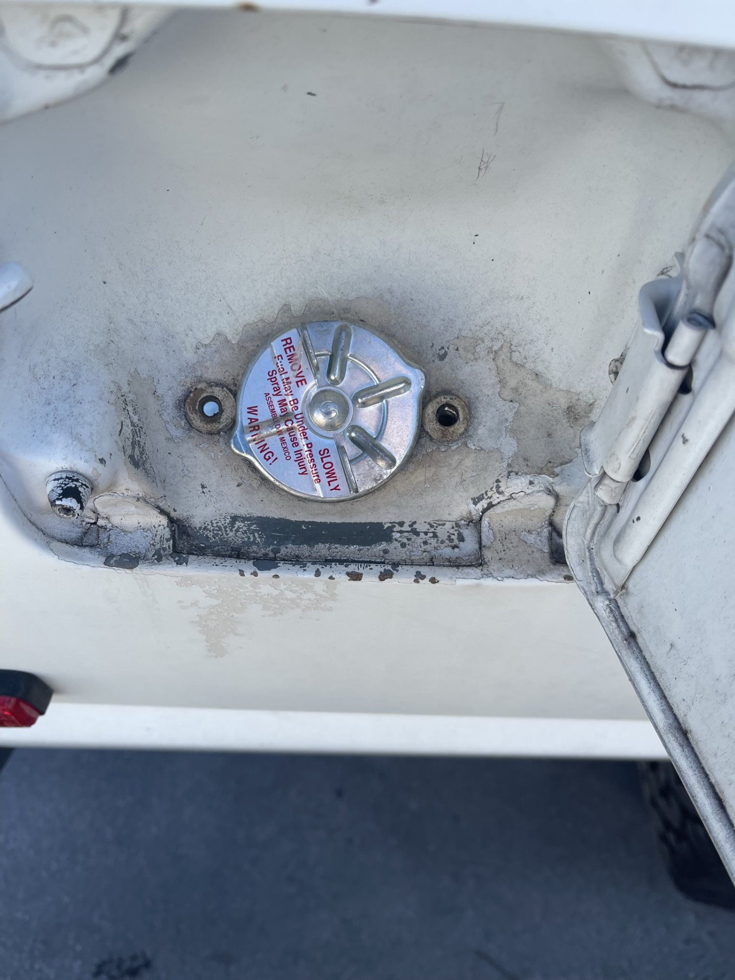

Fuel filler neck grommet OEM part number. The four plugs you'll need are 90950-01826 and they just pop right in.

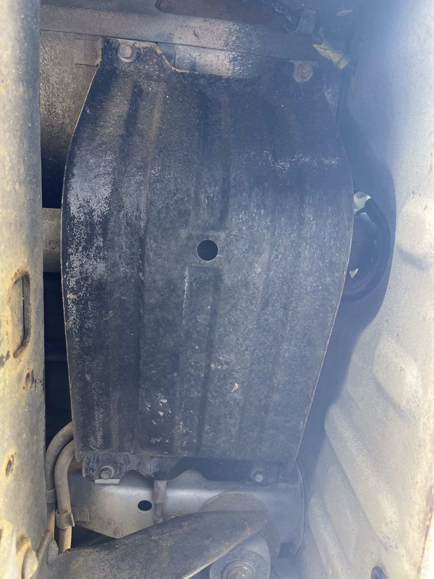

The view you're greeted by when you get under your trunk on the passenger side. You can see how decrepit my fuel filler neck grommet is. There are four 10mm bolts, one on each corner. The rear two only have to be loosened as the skid plate can slide in and out.
This is the rubber hose that joins the fuel filler neck to your gas tank. A clamp on each side holds it in place and you can either use a Phillips or the 10mm socket. Before removing this make sure the OEM piece is good enough to reuse or have a new part standing by.
I removed both Phillips round bolts holding the fuel filler neck to the fuel door area as well as the single 10mm bolt holding the neck to the rear quarter support (No photo here because of the 5 picture limit). I wanted to do this to give me some wiggle room to help get the factory rubber connection hose off.
To remove the stock hose after the brackets were loosened, I pulled towards the passenger side, forcing the rubber hose higher onto the fuel neck. The hose should come off the gas tank side fairly easily and then you can get it off of the fuel filler neck.
Reattach the 10mm bolt holding the neck to the rear quarter support as well as the two Phillips round bolts in the gas cap compartment. This is important so you can make sure the neck is sitting where it's supposed to when you install the new grommet. The replacement grommet will look like it won't fit until you get in on and the side with the small lip faces upwards. Work the lip onto the body, it'll fit but might take awhile to get seated.
To reinstall the connecting hose do the removal in reverse. Check that the hose doesn't have any debris in it before you reinstall it because anything in the hose is going into your gas tank. Start with the filler neck side and then the tank side. To make it easier on myself I folded the hose slightly to help getting it onto the gas tank side. This is why it's important to check if your original hose is in decent shape. I used a flathead to get the last part of the hose over the gas tank fitting.
Reinstall the hose clamps and the skid plate and hope that you attached the hose correctly or you'll be leaking fuel at your next fill up.
Great write up, thanks! I need to do this mod more for the filler neck hose.....mine was patched with something red the PO used. Its an endless rabbit hole, but you should consider getting a real deal gas cap! Mine had a cheesy aftermarket locking cap, inside the locked door......fort knox style.....the PO never gave me the key. It was actually hard to get the thing off and not have the plastic pieces fall down into the tank.....at a gas station on empty.
OEM , Cap 77310-12100
To be honest I didn’t even think my cap wasn’t OEM. But now that I know that it’s not it bugs me a little.
