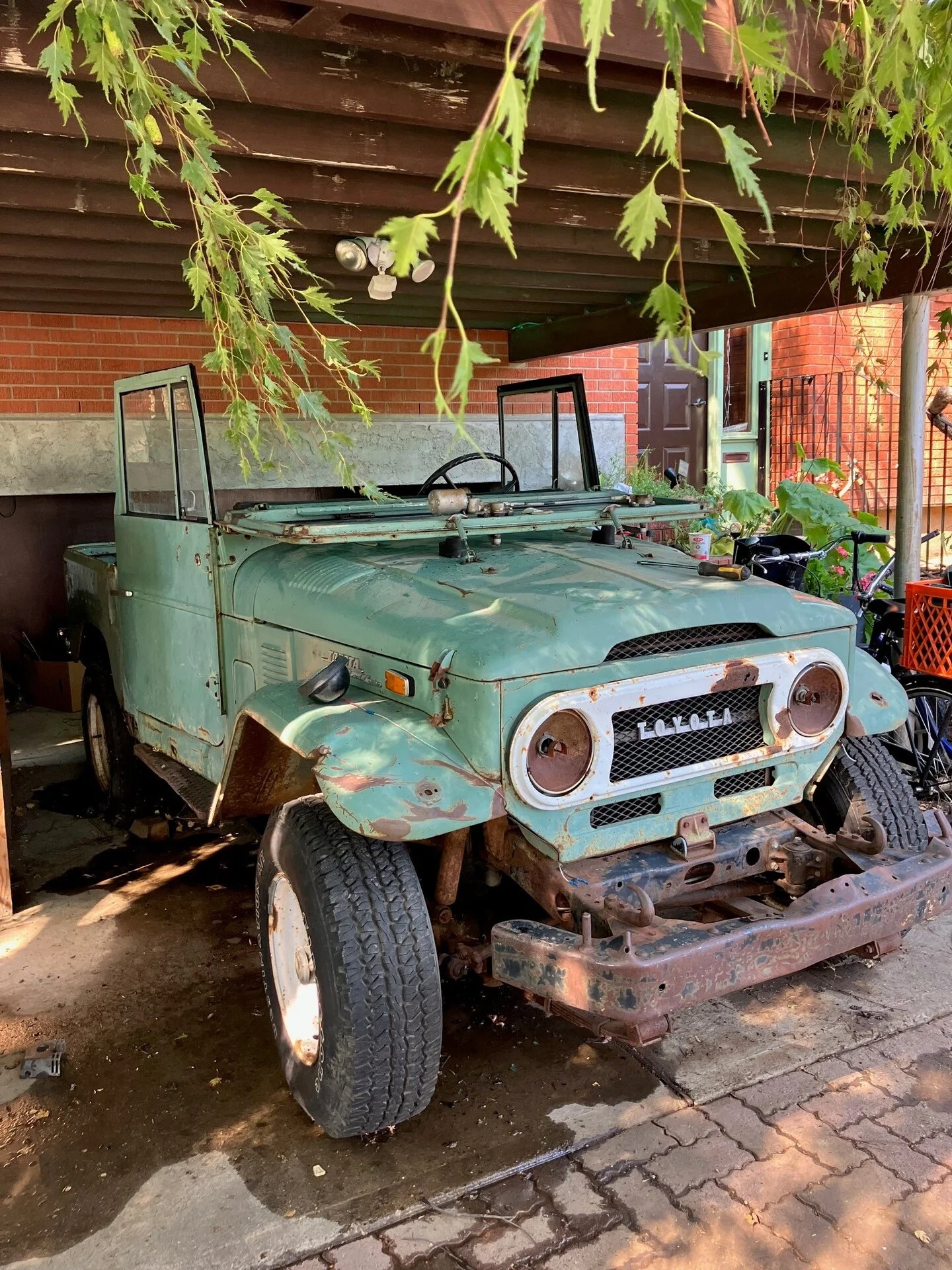

It's a '72 FJ40 with a build date of 11/71. Colour is Breathe Green. It was posted for sale in Calgary, Alberta, Canada, which is about 200km north of where I live. It was posted for sale by a gentleman who'd purchased it with the hope of restoring it. Unfortunately, he experienced some pretty serious health problems and was unable to complete the project. I sensed that he was quite attached to the truck despite not having been able to work on it, but luckily I was able to convince him that I was capable of doing the necessary work to bring it back around. He sent me a few more pics, and we agreed on a price of $3,000CDN (about $2,150 USD). Not having access to a truck or trailer capable of hauling the rig, I found a guy to haul it for me. He dropped in it in my driveway, and I couldn't help but tear into it right away.
Here's one of the pics that the seller sent to me before we closed the deal:
From the pics he sent, I knew that I'd be dealing with some weird mods - the most obvious being the shortened top. I could also see that most of the lights were missing, most of the glass was toast...and the rust. I knew I'd be in for lots of rust, though I have to say it ended up being much worse than expected. Based on the debris that I pulled from the bed and cab, it's pretty clear that this truck had been sitting for a while in a forested area. There were leaves and pine needles to a depth of 3" in some areas of the cab. The rear heater was completely buried in dirt, and in fact most of it had *become* dirt - that's how corroded it was.

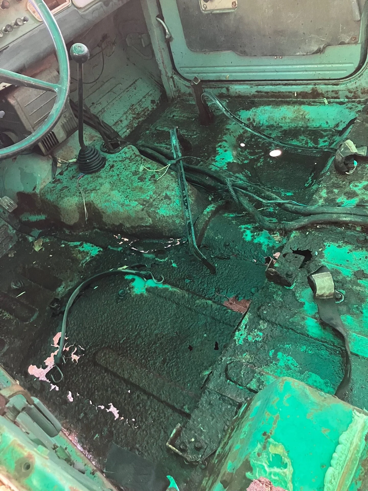

In order to shovel and hose out the interior, I removed the seat, tool box, and fuel tank. The seat is a non-Toyota bench seat that they mounted using square tubing welded to the floor pan and rear fender:
The bottom of the tool box had disintegrated completely, and the fuel tank was rusted and leaking along the seam. Anyway, after much cleaning and hosing, this is how things are looking. I'm going to need to build a complete driver's side floor pan, parts of the transmission tunnel, along with a lot of other sheet metal on the tub.

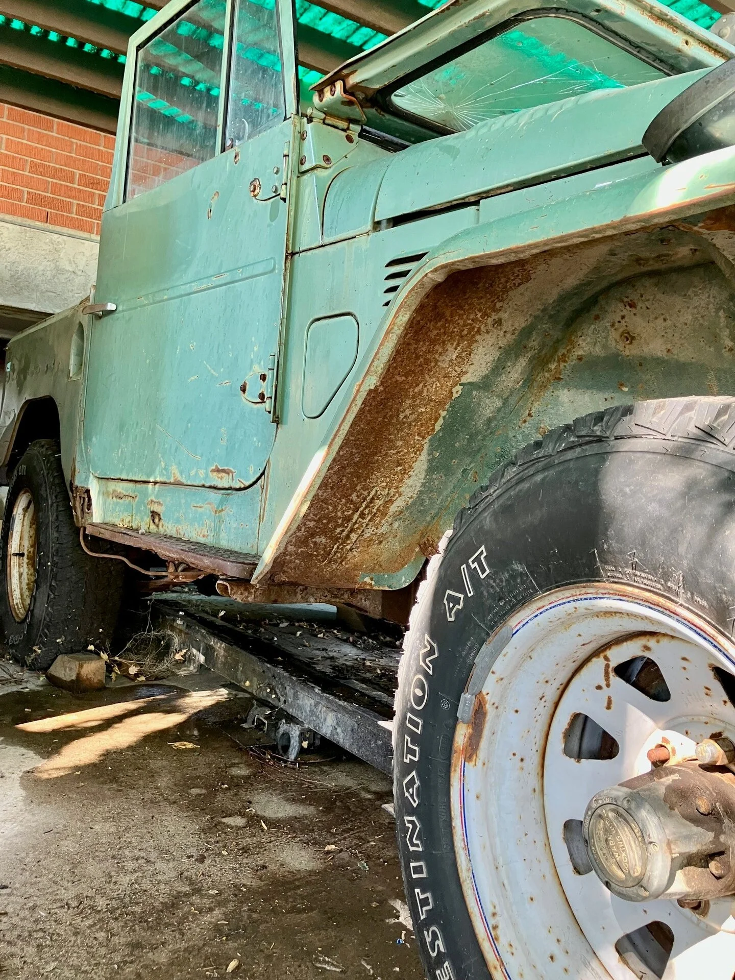

Even though the tub is pretty far gone, other parts of the truck are pretty decent. The doors are in good shape, and the front clip and fenders are banged up but relatively solid. The dash is actually in pretty good condition, though judging but the amount of house wiring I found in the truck, there's going to be a lot of electrical work needed. The brakes kind of work, but the clutch master is seized up.

Much of the tub is severely rotted, but from the firewall forward, things look pretty salvageable.

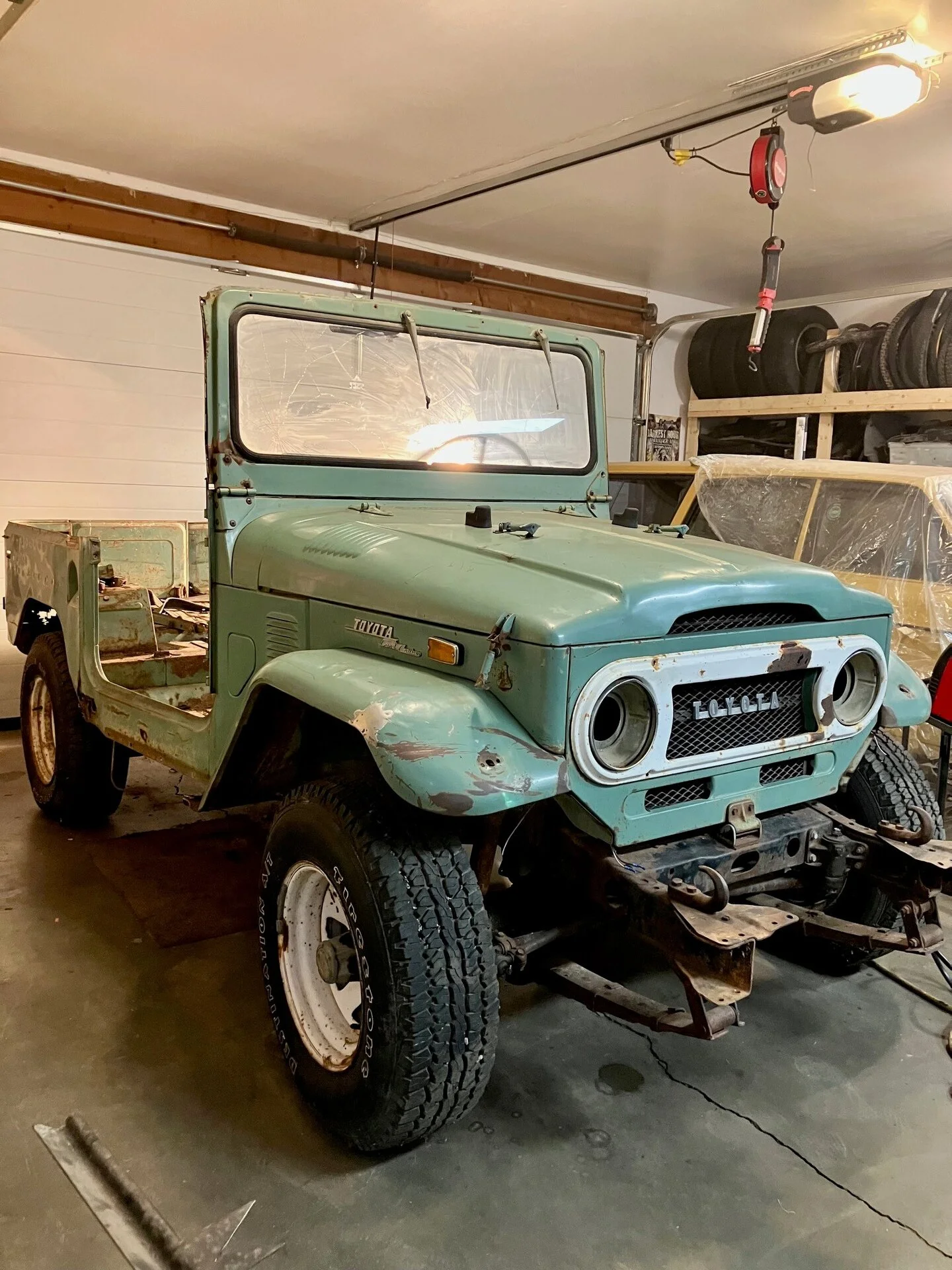

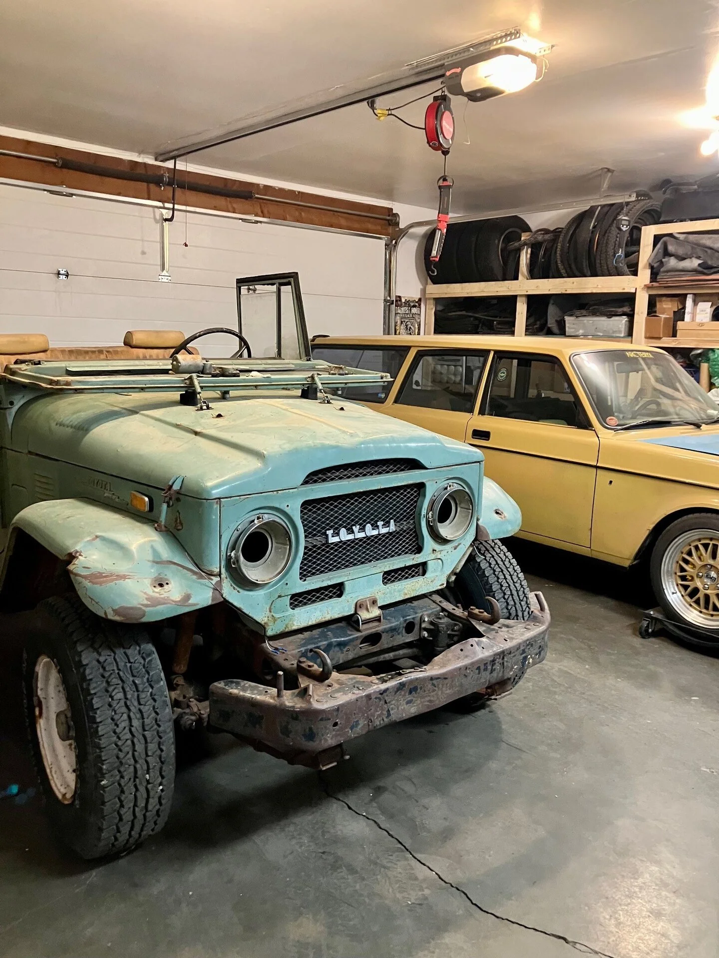

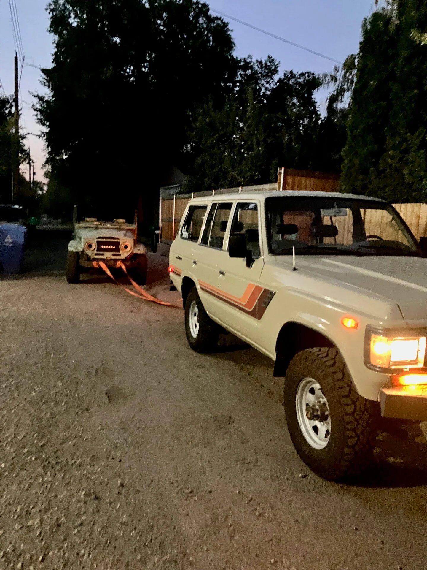

Got away with an illegal flat tow. The garage is only about 5 blocks from my house, managed to avoid any heat on route:
All set up in the garage:

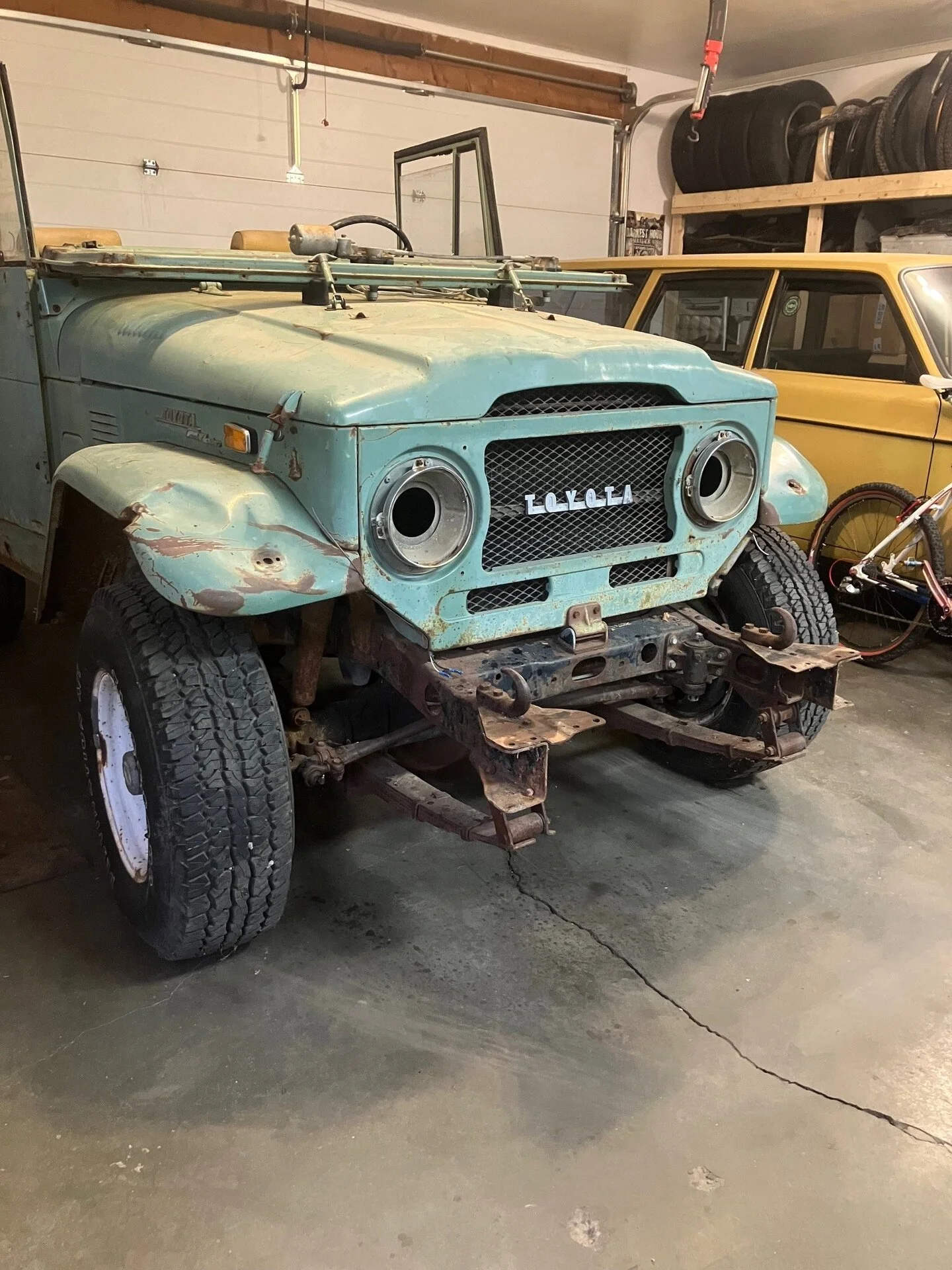

The first thing I did was remove that mangled front bumper. Looking much better already!

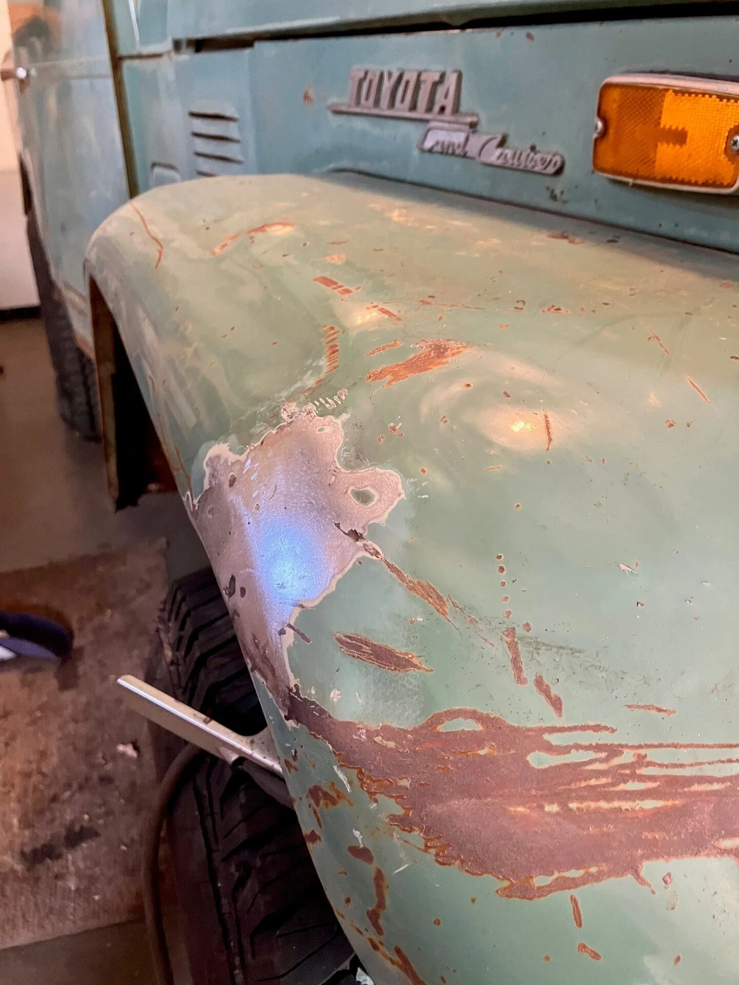

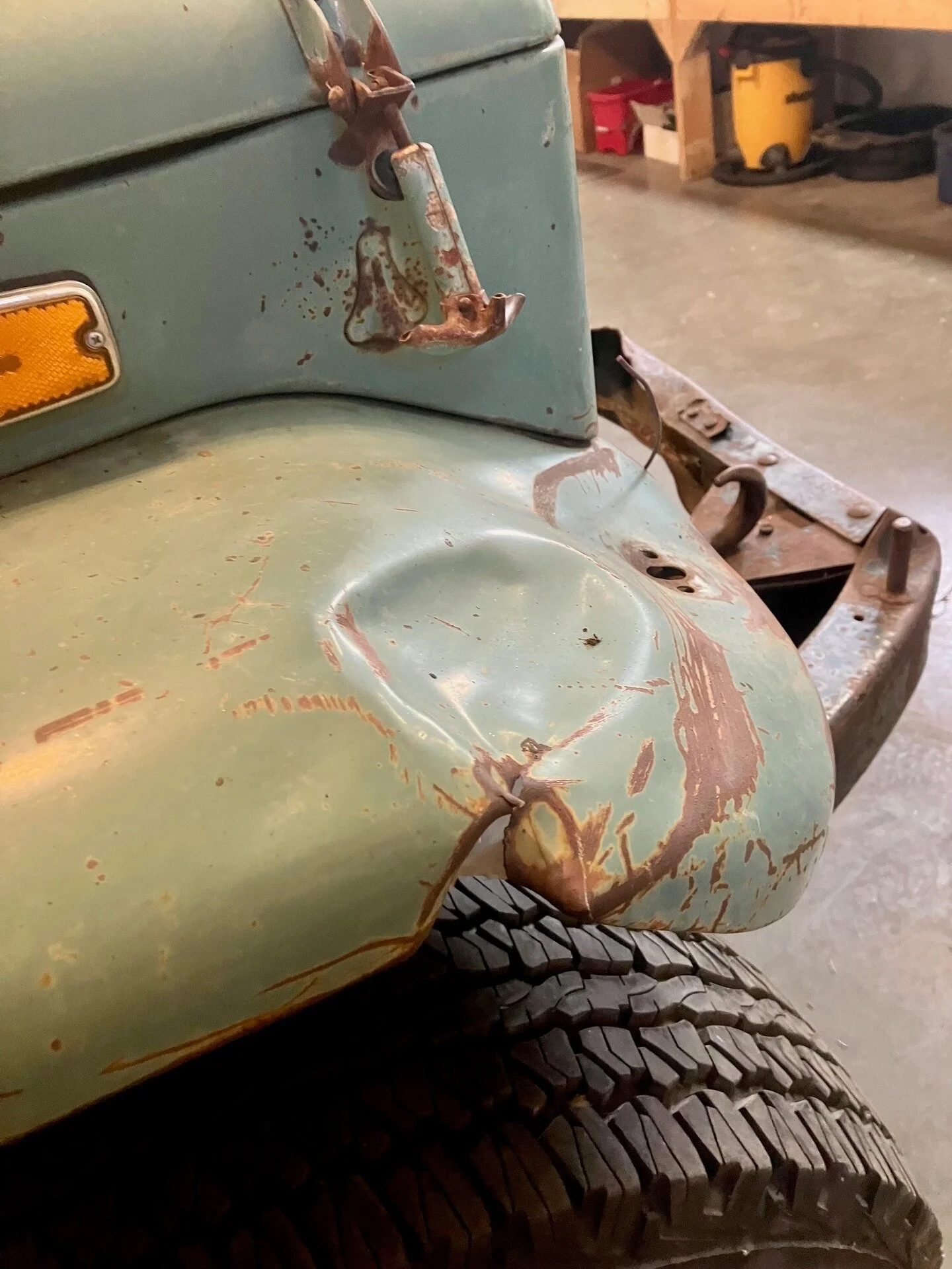

Then I set about trying to get the fenders straightened out a bit. The driver's side was pretty dented up and had one major crease to hammer out:
After a fair bit of hammer/dolly work, it's looking quite a bit better!
I'm hoping to preserve as much of the original paint as possible, as I love this colour and I think this truck has great patina. I'm going to be replacing a fair bit of sheet metal, though, so I guess I'll be watching some youtube videos on creating faux patina haha.
Next steps include removing the dents in the passenger side fender, and moving on the significant rust repair that this truck needs.

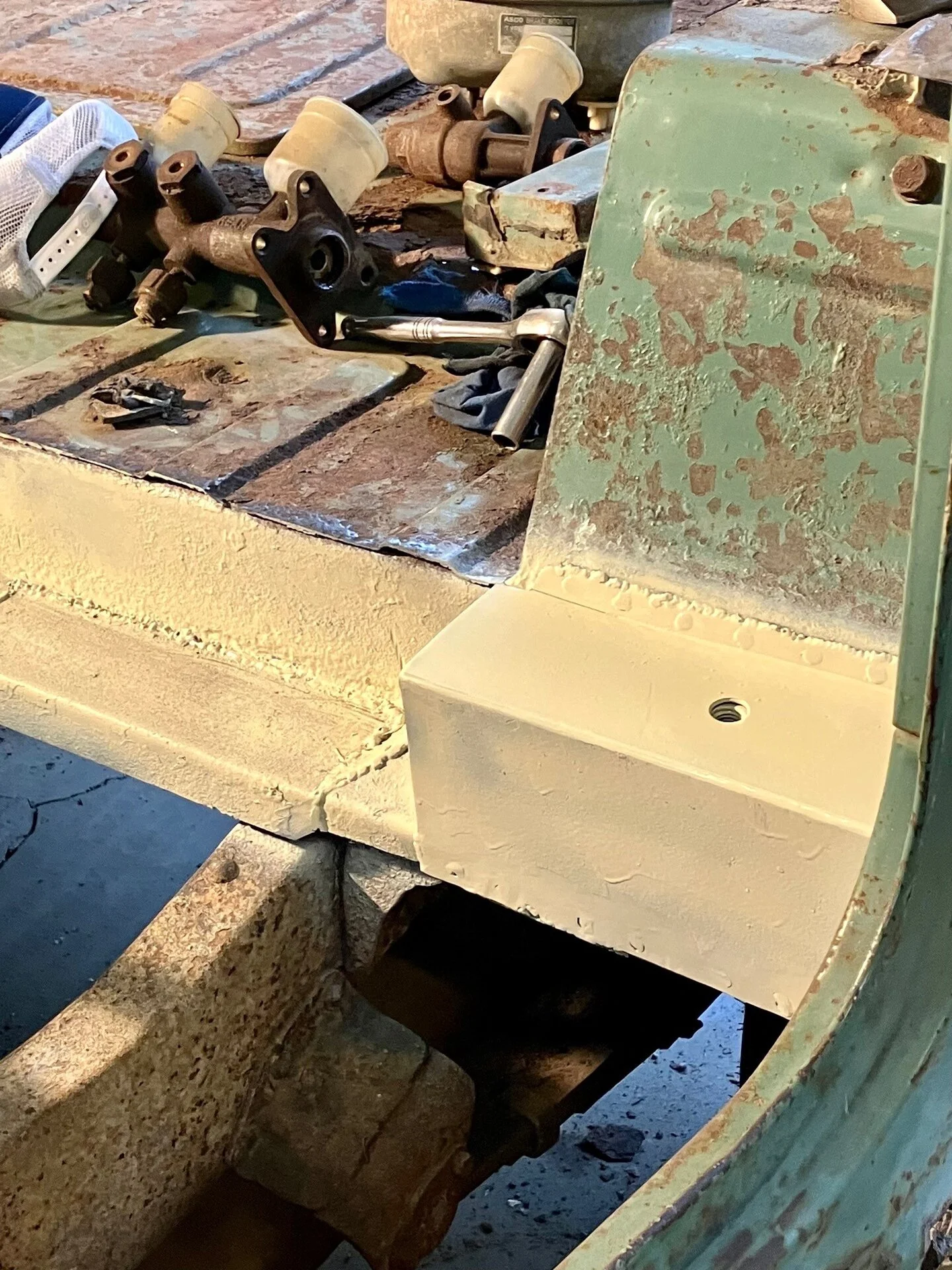

First thing was to bring the passenger side fender into a reasonable approximation of its original shape. It was pretty dented up and had a significant tear in the fender lip:
After a *lot* of hammering and some welding, it's looking much better:

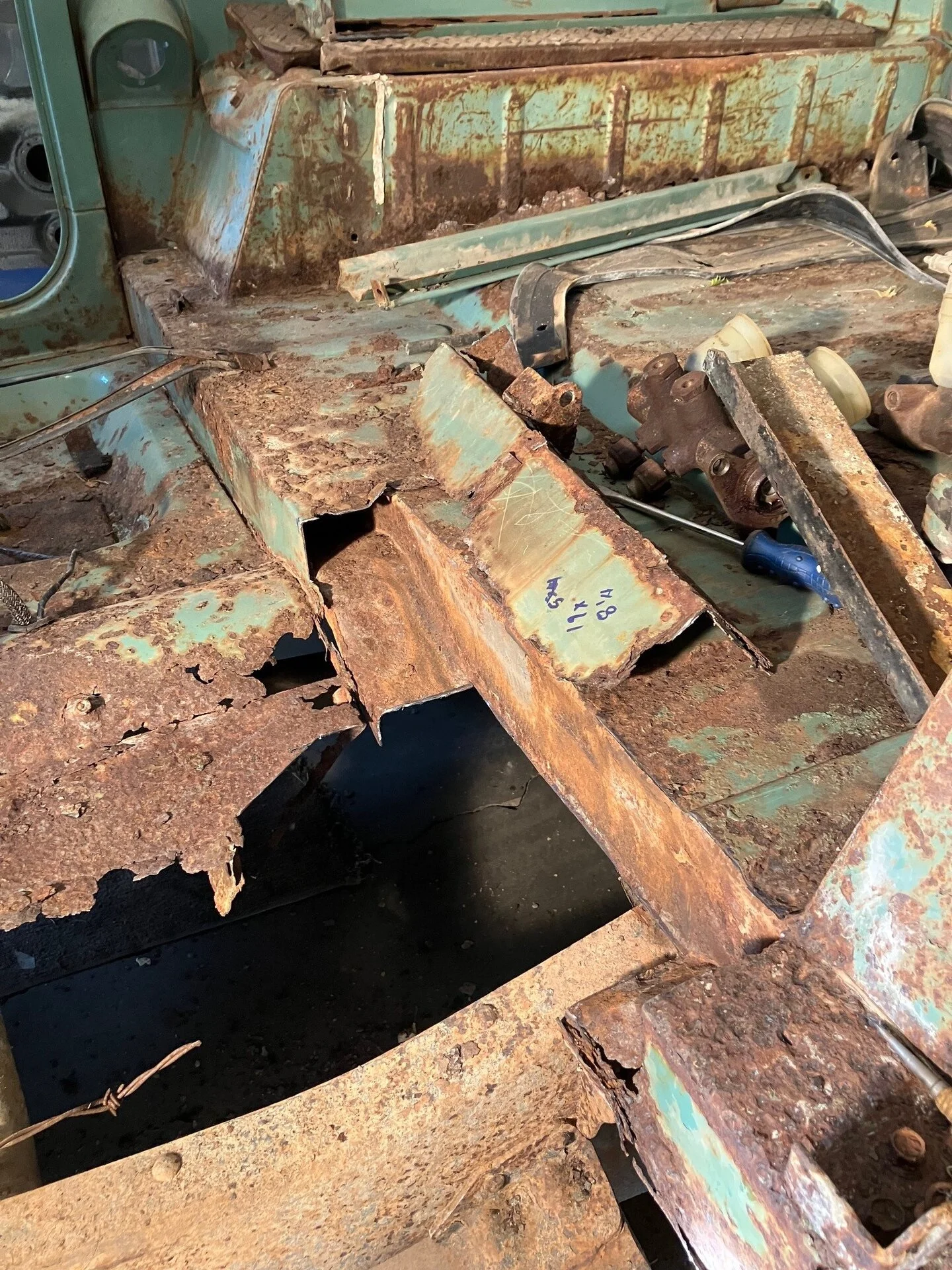

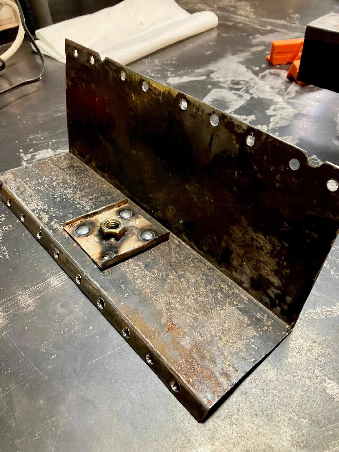

Then I moved on to some of the more serious rust repair. I removed what was left of the driver's floor pan, and then started working on the structural pieces that will need to be nice and solid to support an eventual replacement pan. Found a fair bit of rust in the box section behind the front seats, so had no choice but to start cutting:
Here's the first replacement panel I fabbed up: it's the piece that sits right in front of the rear wheel tub. It has to be super strong, as that's where the seat belt anchor is located. This is made from 16 gauge steel. I'm no engineer, but I think it'll do the trick:
And here's the piece welded in. Please forgive my crappy welds: rusty metal always makes it tricky to get a clean weld. Anyway, I reckon it will hold.

The front fenders came out great! Looking forward to the progress. Is that a Volvo?
Yes, that's my buddy's 240 wagon that he's been working on for years. I'm renting half of his garage, so the Volvo gets lots of cameos in my posts.

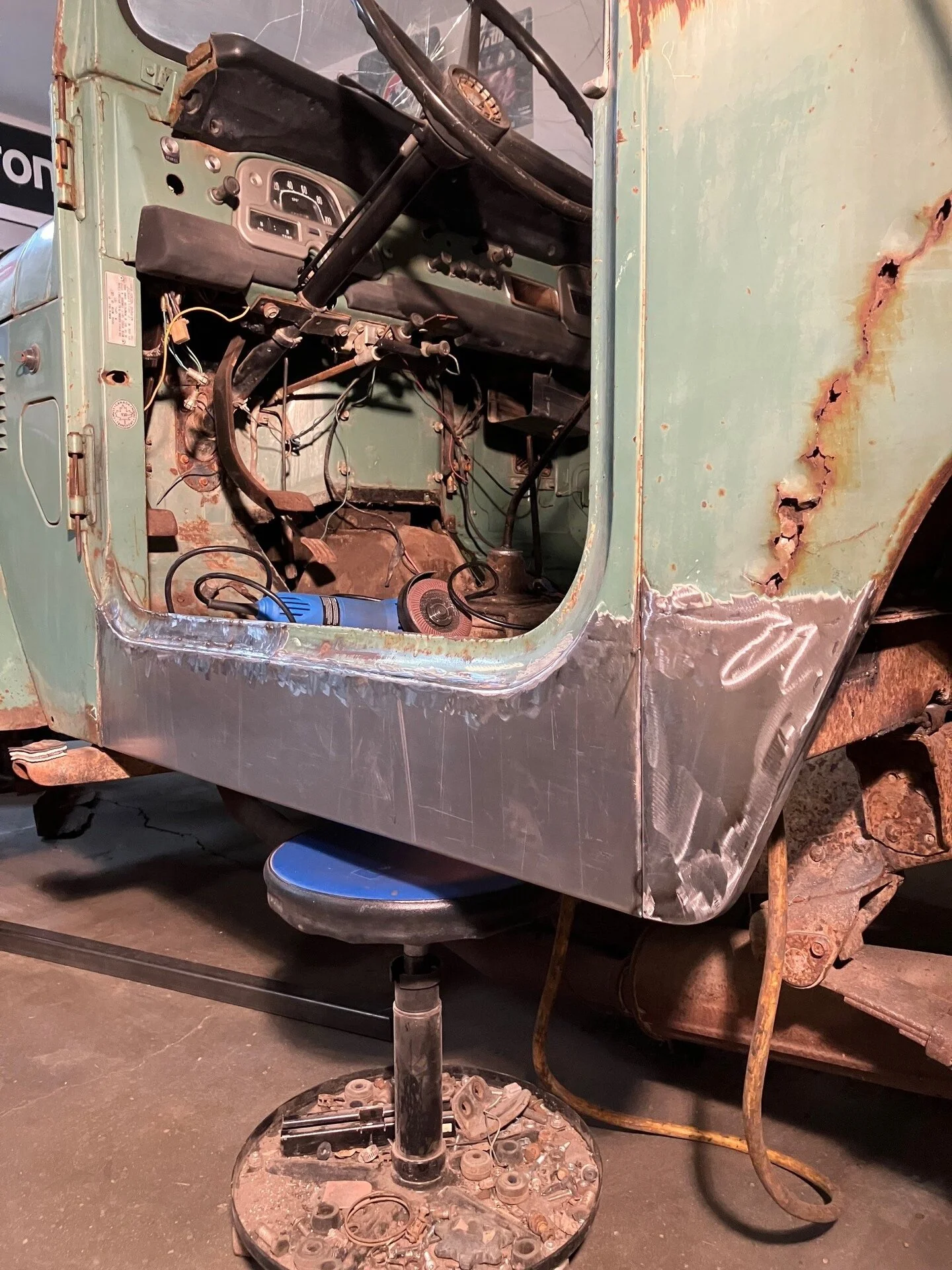

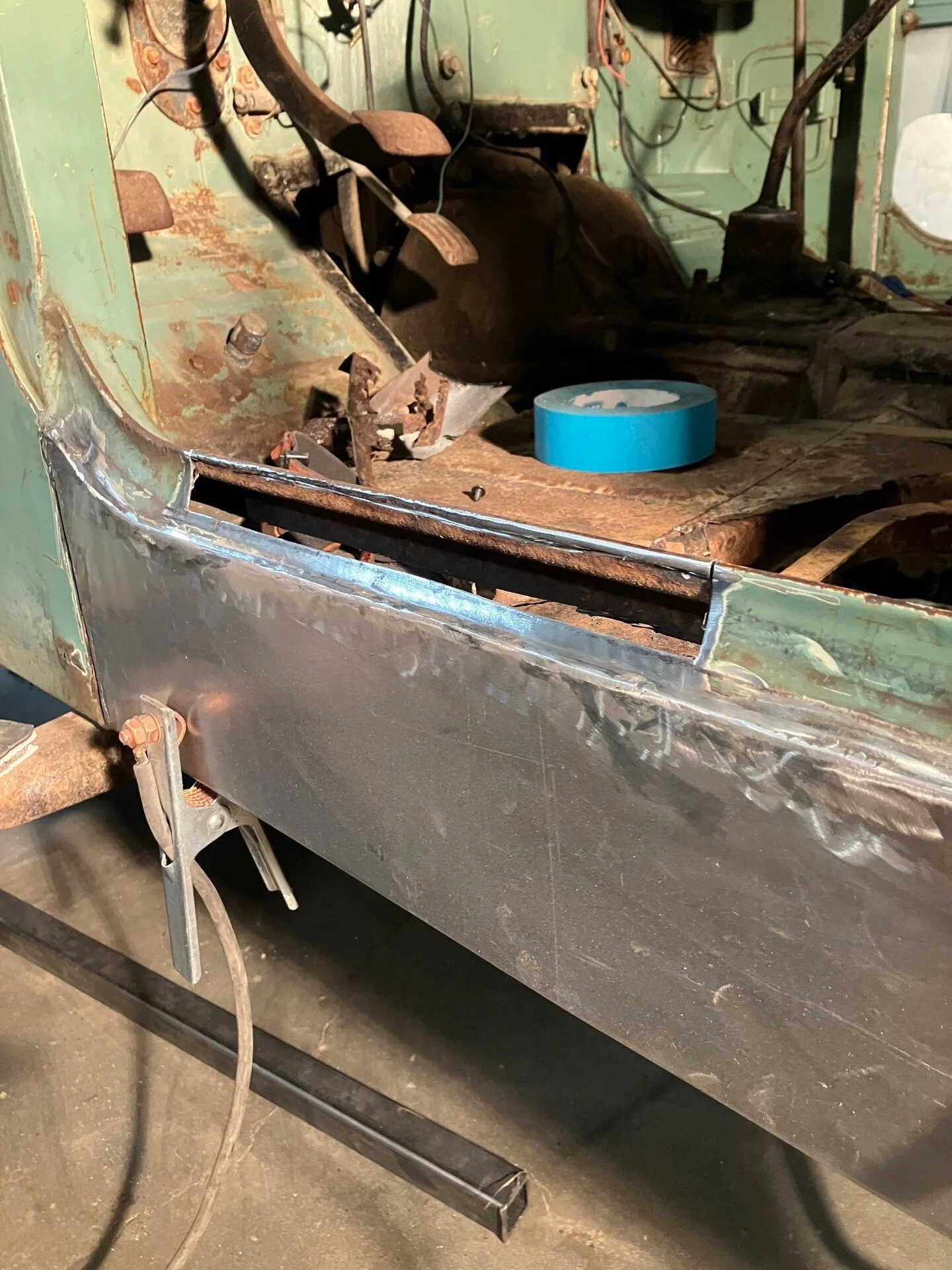

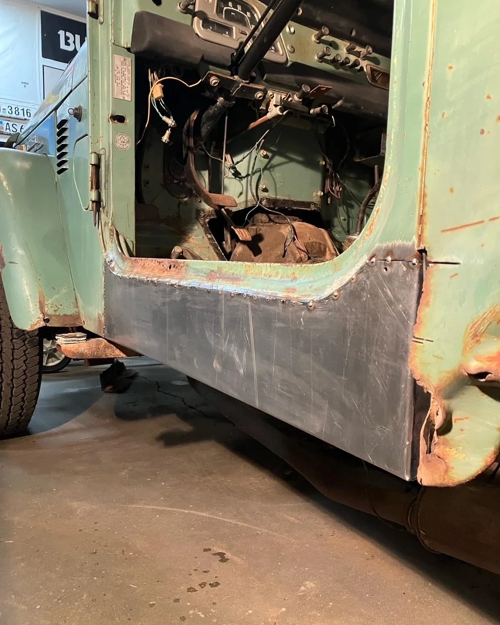

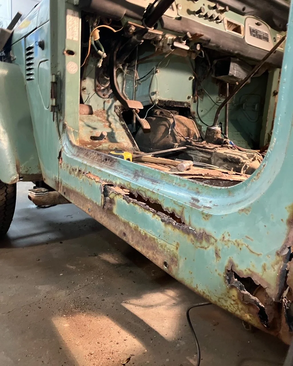

Productive night in the shop last night: got the driver's side rocker tacked in place and ready for welding. Since the floor pans on the 40 series are welded directly to the rocker, it's necessary for the rocker to be solid in order to properly measure and secure the replacement pan. The original rocker had all but disintegrated, and was bent and distorted by rust:
After some careful measuring, I cut out the corroded metal and test fit the replacement rocker panel that I'd made from 18 gauge sheet.
With the panel clamped in position, I used two sheet metal screws as registration points to ensure that I can return the panel to the exact same location every time I remove it (sheet metal screws are the poor man's Clecos).
Finally, I welded the panel in using the "cut n' butt" method I learned from the Fitzee's Fabrications youtube channel. This technique involves tacking the new metal over top of the old, and then systematically undercutting and re-welding the panel in short sections. Keeping the old metal underneath keeps the panel aligned during welding and helps ensure a consistent gap, without having to resort to clamps or magnets to hold things in place. Once the tack is complete, the old metal can easily be removed from the back side. To minimize panel distortion, I decided to weld right along the break where the door jamb begins. The panel is a lot stronger there, and less likely to move under the heat of the weld.
I ran out of time to get it fully welded in, but super happy with the results so far!
The next step is to rebuild the inner sill. That should put me within spitting distance of installing the new floor pan!

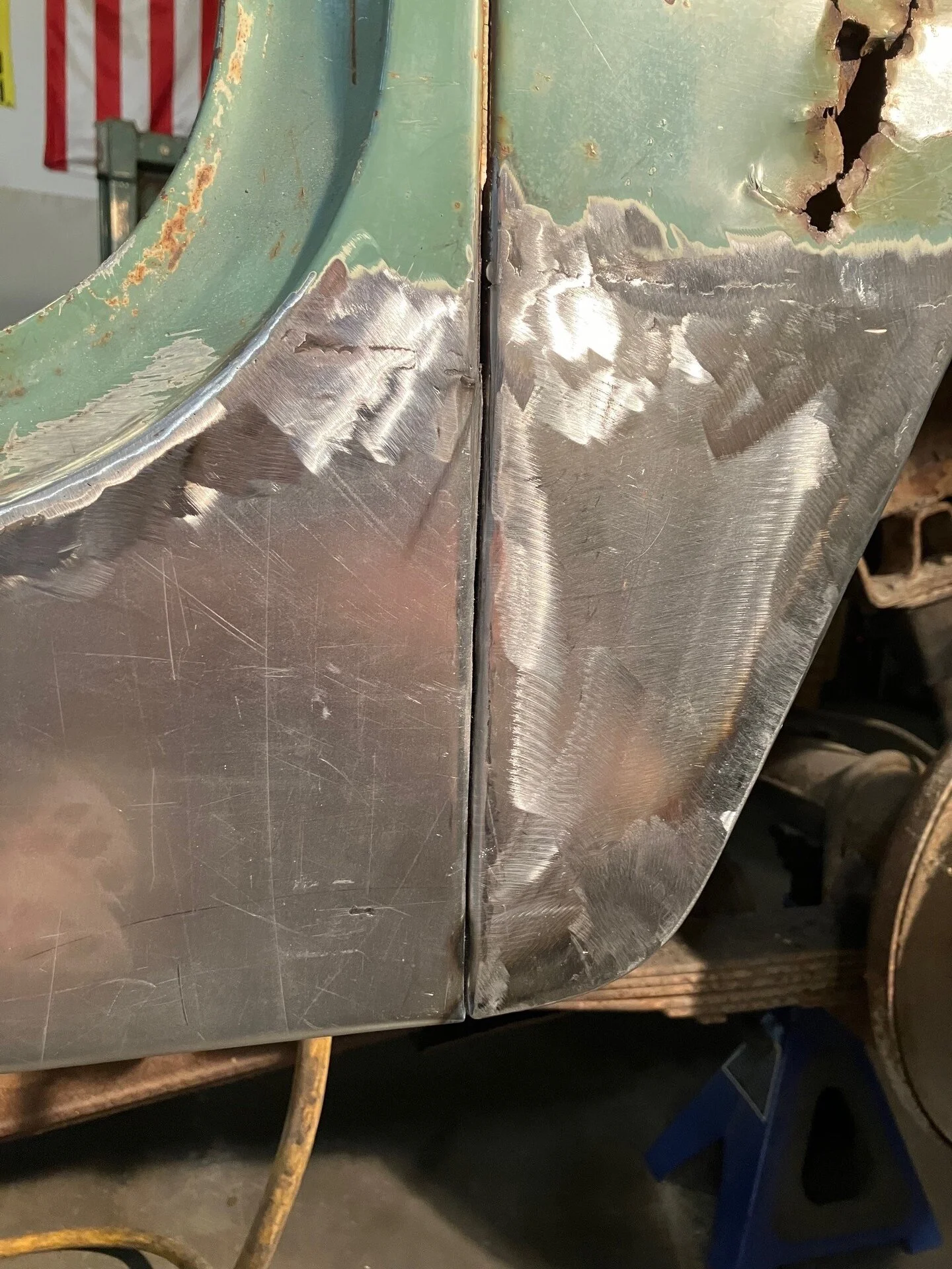

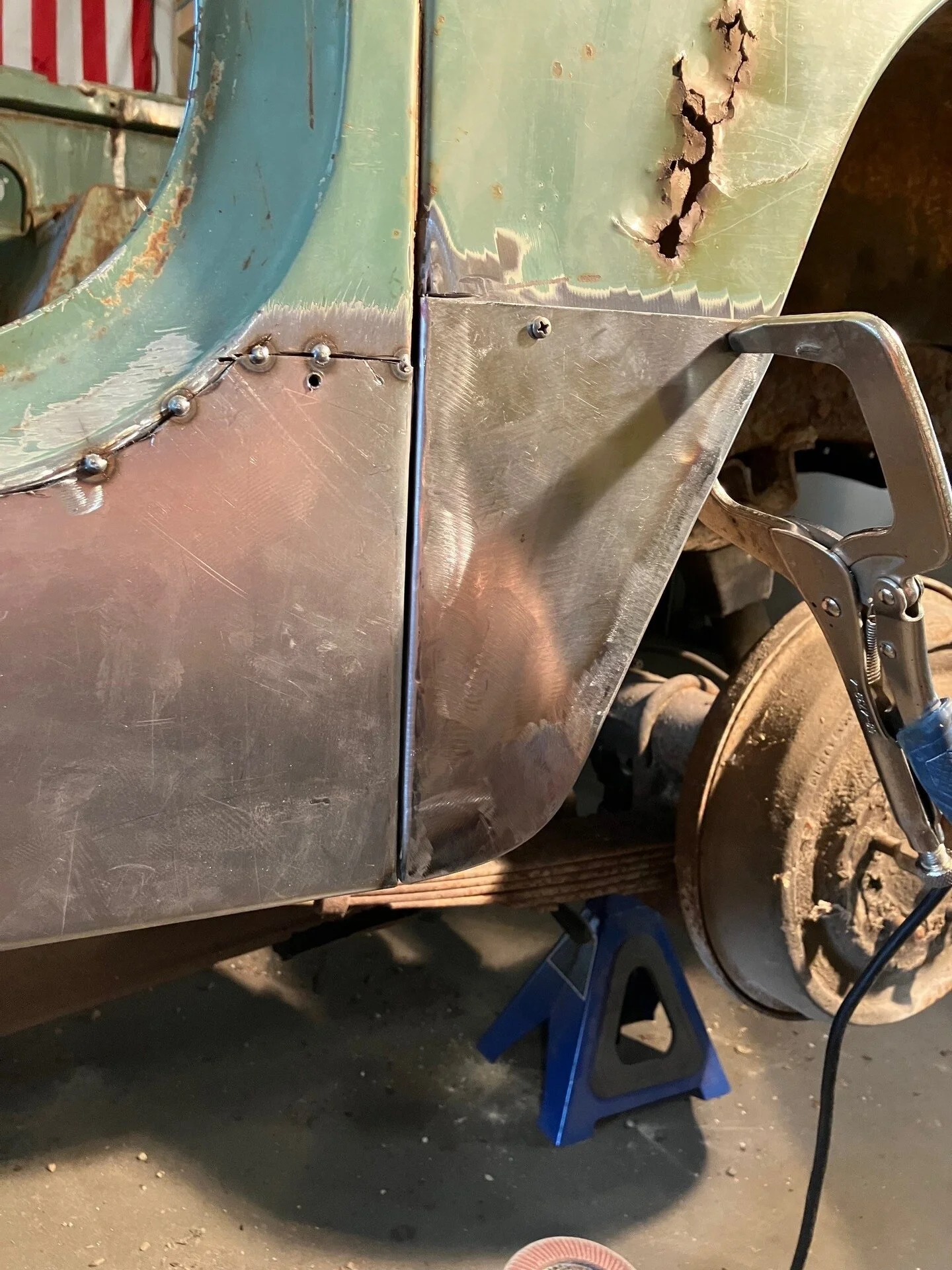

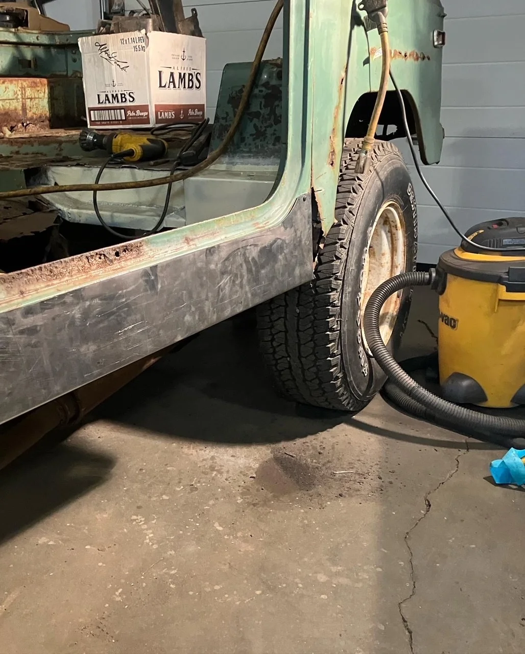

Welcome to another post-weekend photo dump! Got the rocker fully welded in over the weekend, and also fixed up the wheel arch.

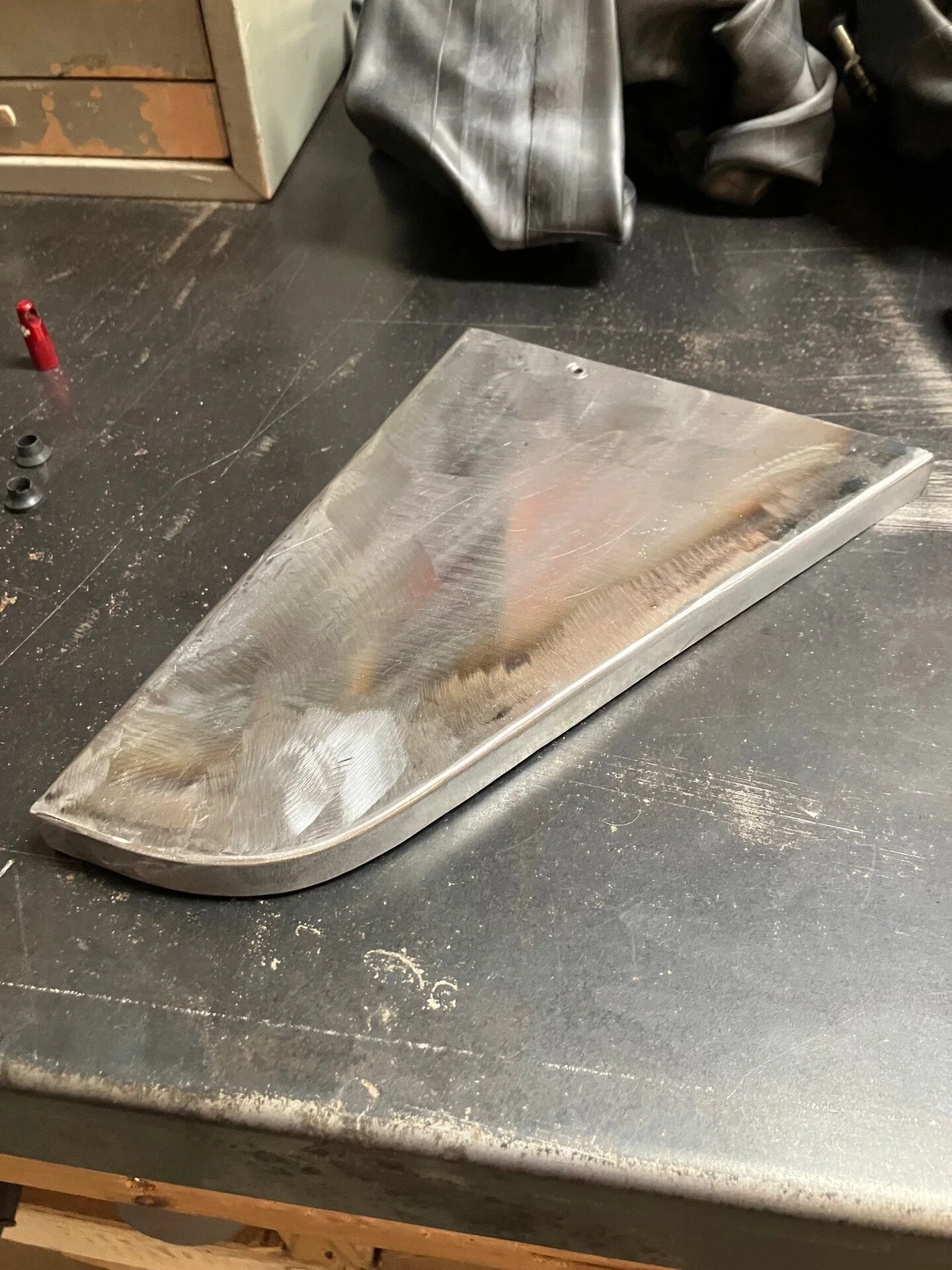

Started by making a replacement panel for the lower front wheel arch. I don't have proper sheet metal tools, so I simply weld the curved lip on instead of trying to fold it over. Makes for a nice straight panel.
Test fitting the panel, again using a sheet metal screw to locate it:
Welded in place:
Also decided to cut out the section of the door jamb that had rusted through:
Still a bit of grinding remains on the jamb, but otherwise this rocker is good to go!
