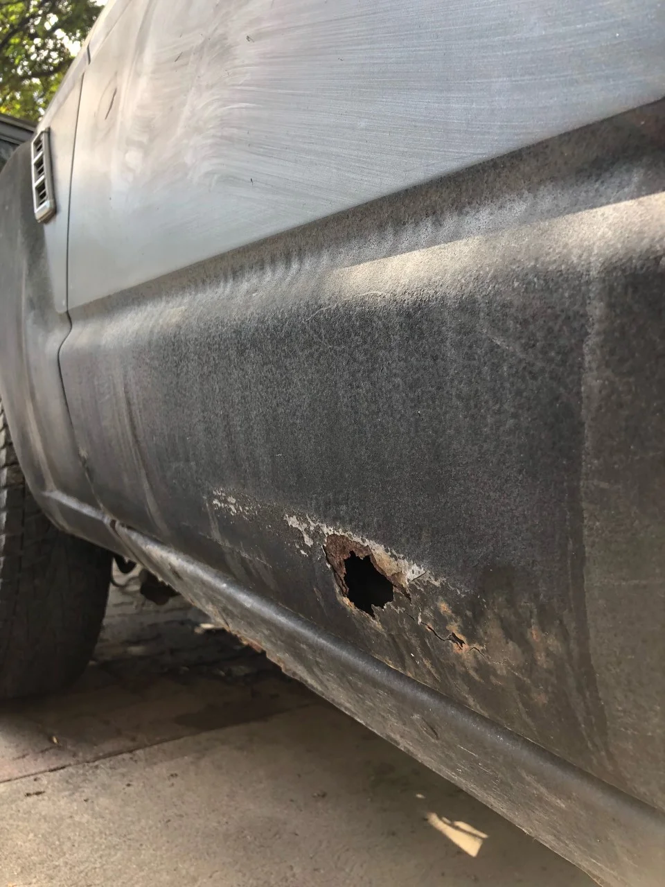

BAD: engine condition unknown, A440f condition unknown, no brakes, cracked windshield, signs of neglect, sketchy wiring, shoddy rust repair on front clip, everything covered in greasy dirt.

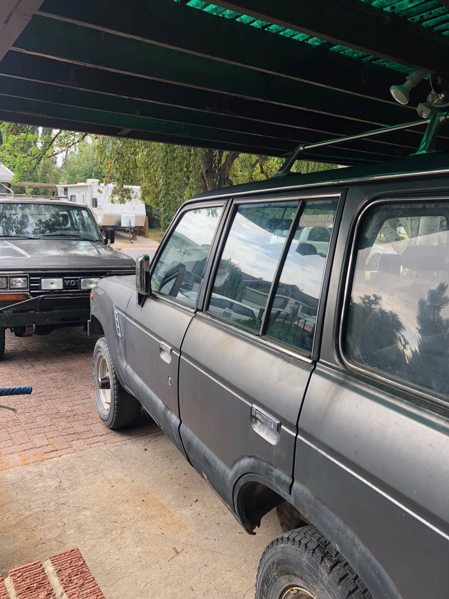

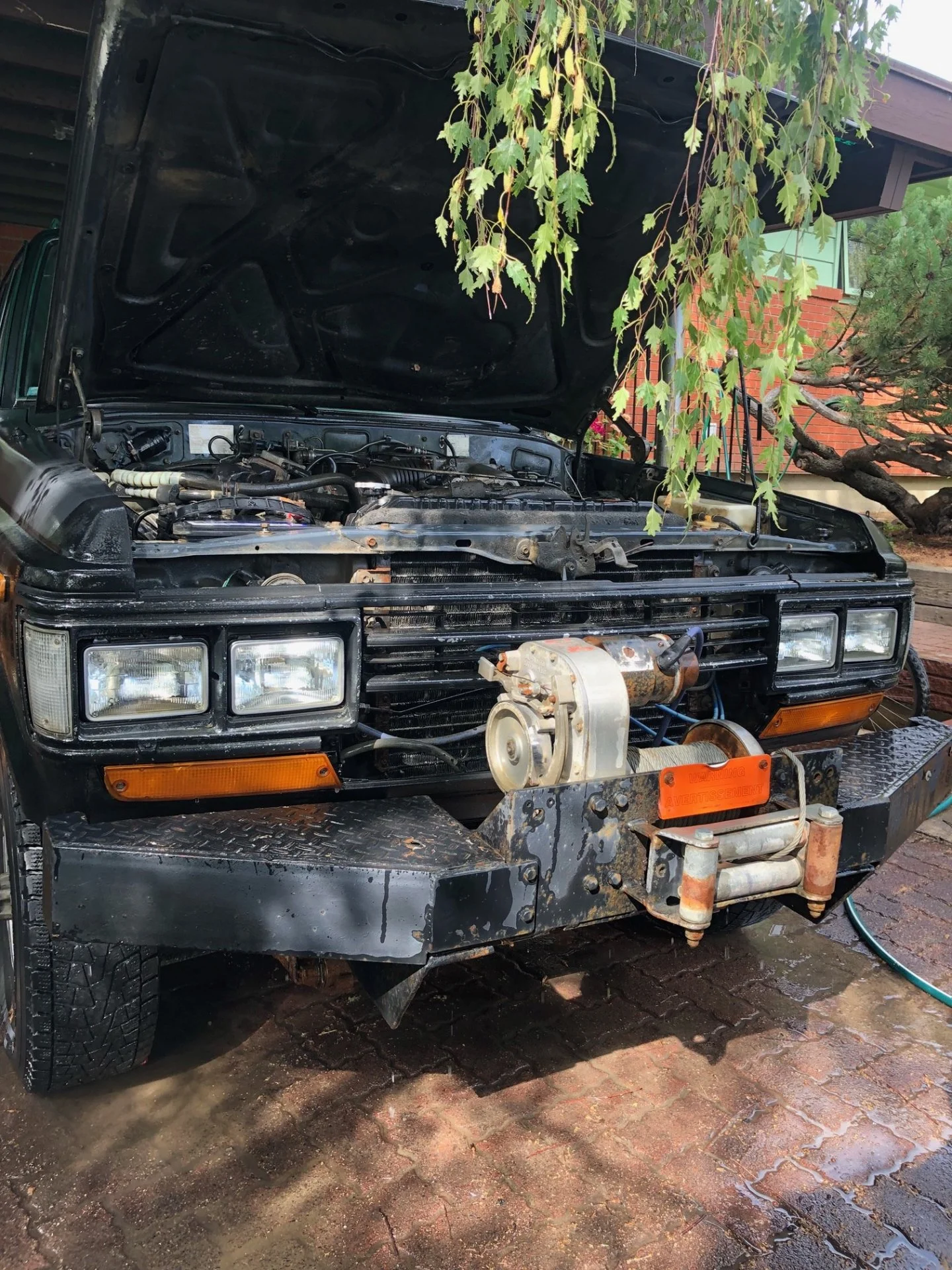

Here are some more pics of the 89. It has clearly seen some neglect. Everything is covered with this weird greasy dirt that does not want to come off without a ton of detergent and scrubbing.
The truck features an old Warn 5687 winch, which seems to work! Originally thought I might sell it but now leaning towards keeping it, even if I only end up using it for dragging deadfall out of the bush for firewood.

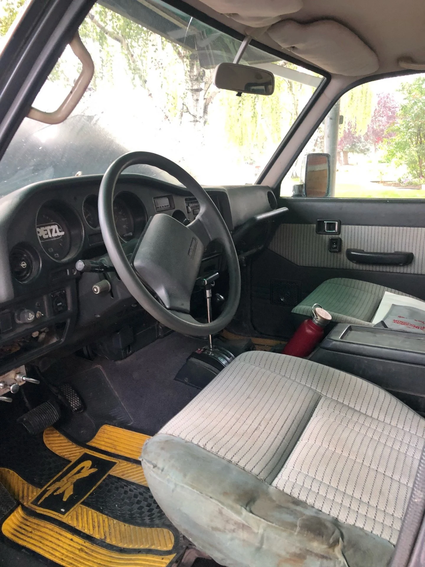

Interior is a little dusty, but appears to be complete and in decent shape. No slop in the shifter etc.

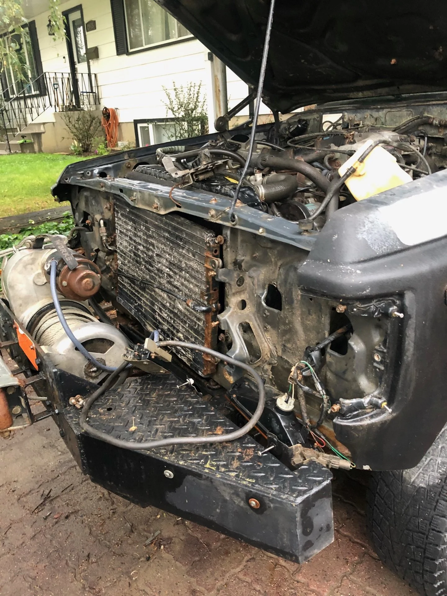

Taking everything apart for a good cleaning. My plan was to remove the rad support and fix a rust hole on the bottom, but I discovered that a some point, someone welded the rad support to the fenders, so that complicates things a lot. If I end up parting out the 88, I could swap over the rust-free fenders and rad support from that truck, and not have to bother with any welding.

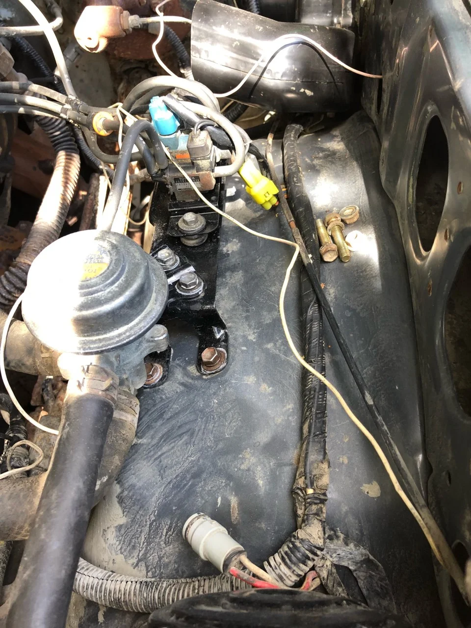

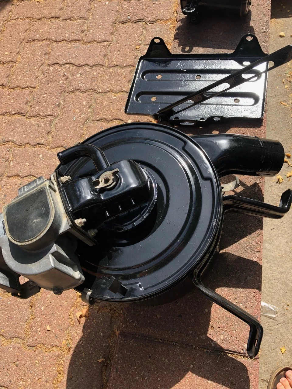

The engine bay is dirty and rusty. I've been working on removing various pieces to clean and paint them. Took the valve cover off last night so that I can check to make sure that the valves are close to spec before I try to fire it up. Removed a rusty old Fram oil filter and the empty A/C lines and condenser. Found a broken A/C line at the evaporator. I think I'll just delete the whole system.

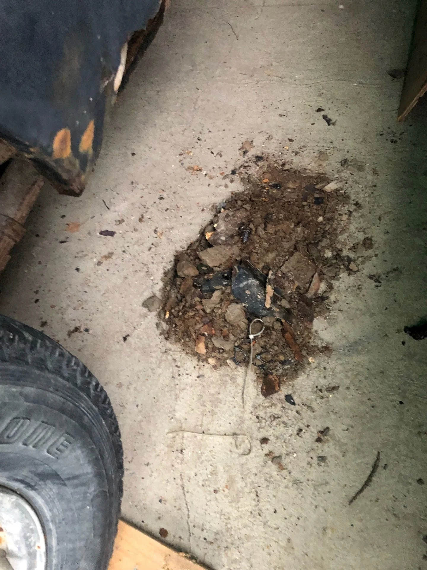

The rear quarters were both full of mud to a depth of about 3". Stuck a screwdriver through the sheet metal and it just dissolved. This pile is what was inside the driver's side quarter panel.
So anyway, that's where things sit. I'm slowly draining the bad gas from the 89, and burning it in my 88. Will reinstall air cleaner, throttle body, some fresh oil, etc. and see if I can get this thing to fire up. Then will do a compression test on both trucks to see how the numbers compare, and take it from there. Thanks for following along - well see how this particular cookie crumbles.

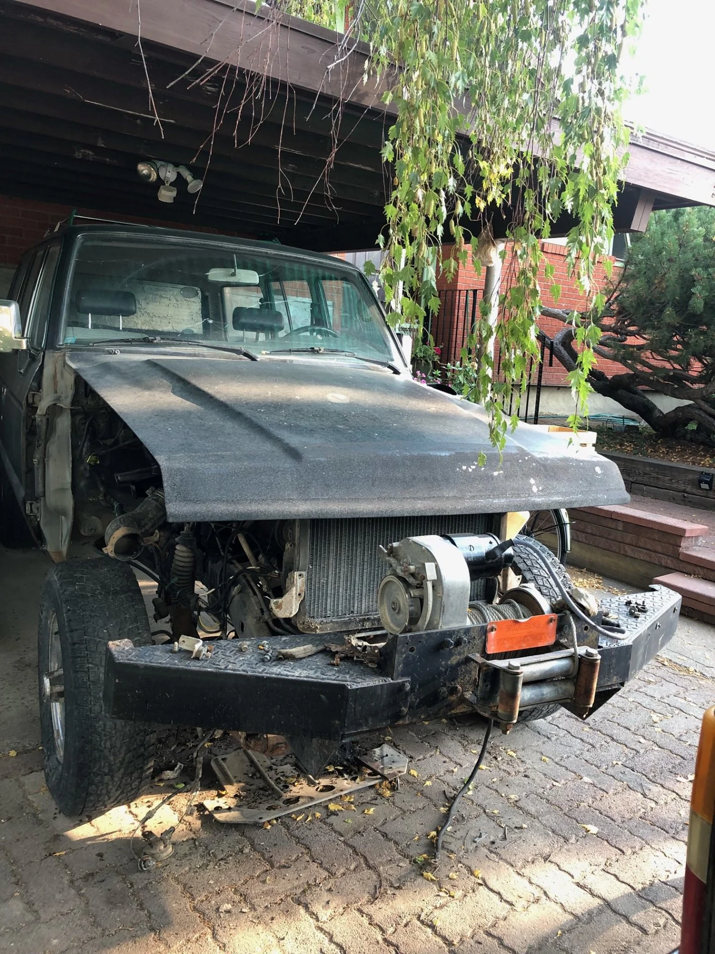

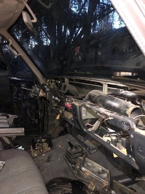

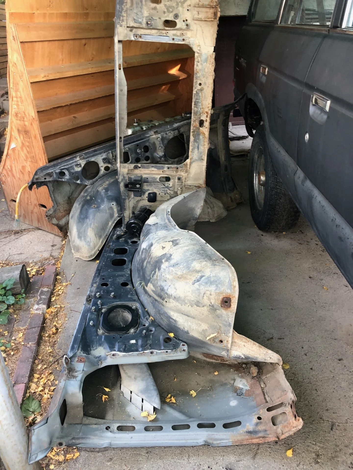

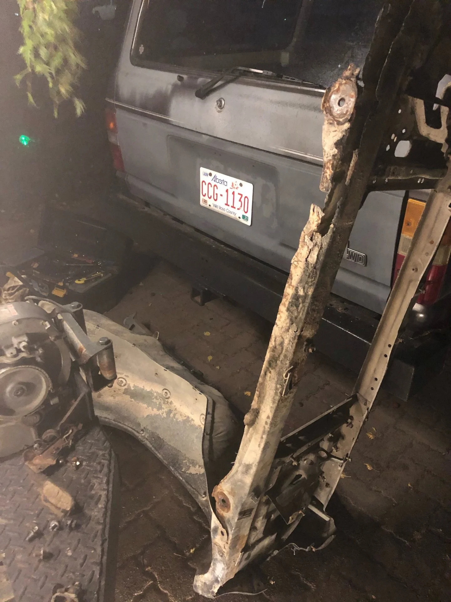

Yesterday I started dismantling the front end of the 89. As I think I mentioned above, someone must have done some bodywork on this thing, and in the process, decided it would be cool to weld the inner and outer fenders together, and then weld the fenders to the rad support. As a result, these fenders are basically junk (though if anyone wants me to cut out some pieces for you, send me a message!) Anyway, because of this, I had to remove the fender and rad support as one piece. :rolleyes:
Some pretty bad rust on the bottom of the rad support:
So here's how it sits! While the fenders are off, I'll continue cleaning things up, replacing hoses, etc. It's so much easier working on the engine with the fenders off! Will also start pulling the fenders off the 88 and painting them while they're off the truck. Also need to re-seal some of the joins behind the fenders.

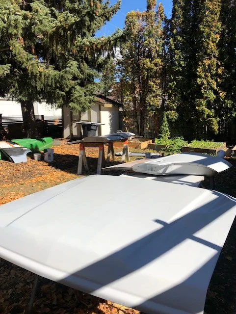

Operation Backyard Paintjob is underway!

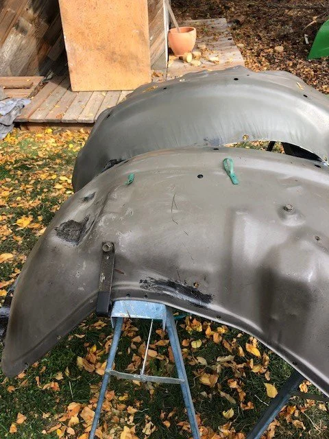

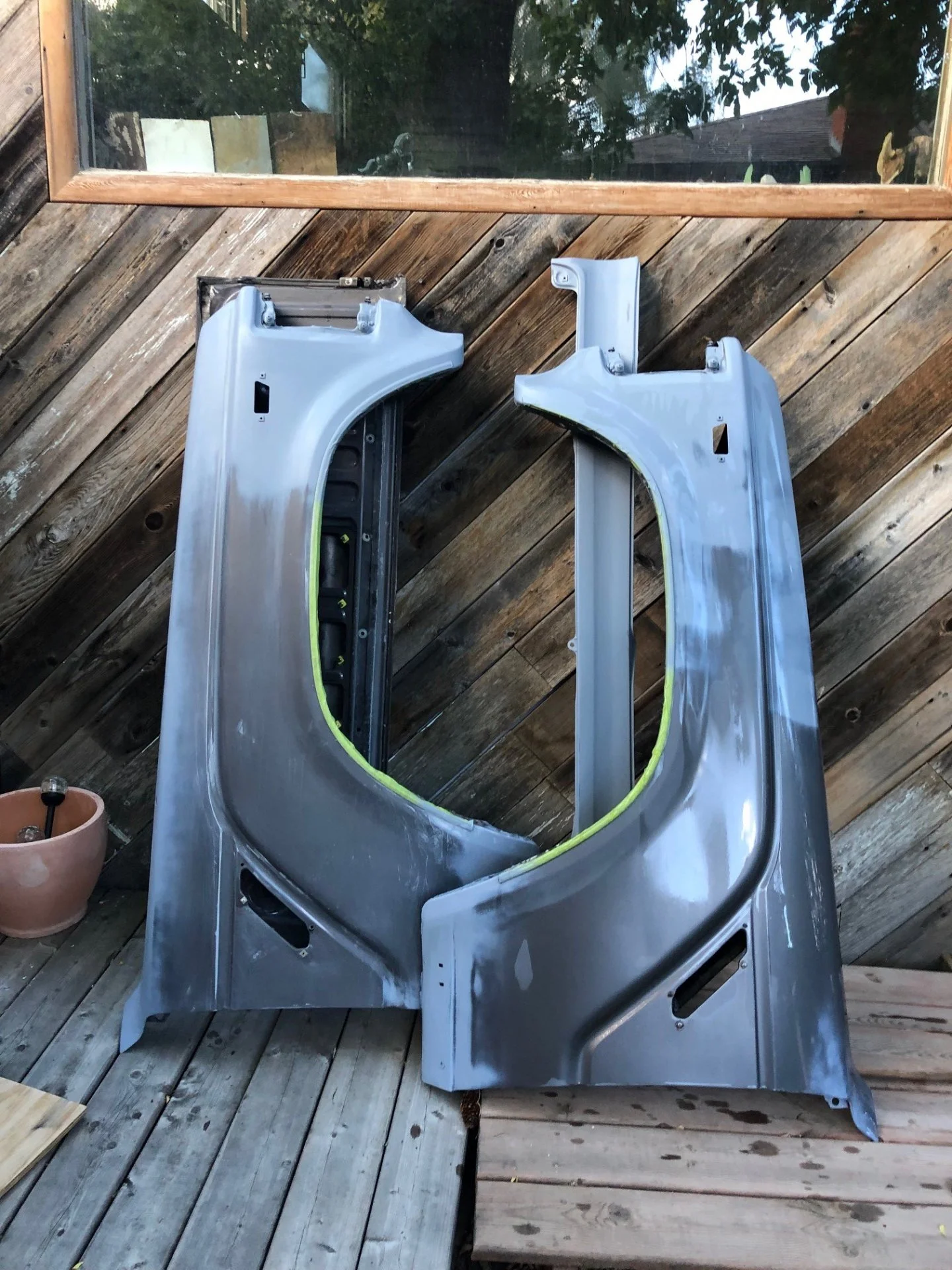

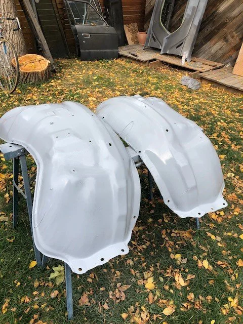

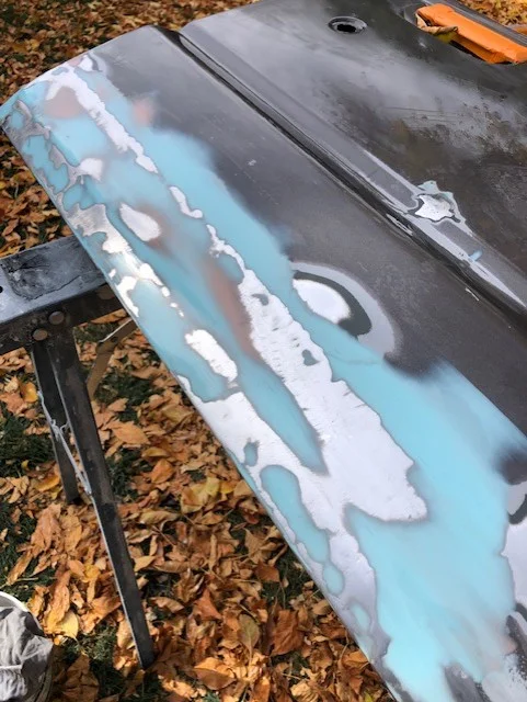

Inner/outer fenders are off the '88 and are being prepped for paint. So far, that's meant a lot of wet sanding with 320 grit, some high-build primer in the areas with rock chips, and more sanding with 600 grit. I'm not going for show car, but it's already looking better. Picked up a little HVLP paint gun that should work with my 5-gallon compressor. Fenders will get a seal coat and then a few coats of single stage Beige 4E9 before going back on the truck. Spots with surface rust all got some POR-15.
So smooth!
Still haven't been able to get the 89 to fire. I'm not getting any spark from the coil, despite swapping in a known good coil/igniter and main relay. I'm wondering if my jury-rigged ground for the igniter was not sufficient (I understand that the igniter needs to be properly grounded). I'll dig into it some more once the fenders are back on. I also ran a compression test. Numbers are all between 130 and 140, with the exception of #2, which was reading 120. I put a little oil in the cylinder, and it came up to 130. This engine hasn't run for a long time, so I'm hoping it's just a stuck ring or something. Maybe it'll loosen up after driving for a while. Something to keep an eye on, anyway.

Started some of the paint work by laying down a sealer. I used a urethane for these panels, but after doing a bit more research, I am abandoning that strategy. The stuff is just too toxic, and I don't trust my half-face respirator to keep me safe, even though I'm spraying outside. Moving forward, I'll be using an alkyd enamel with a hardener. It's looking good though! Before:
After:

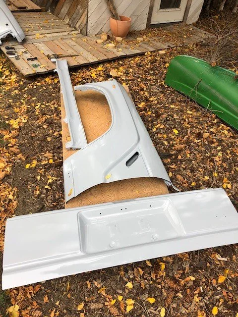

Shot a few other parts as well, including fenders and the rad support. All looking pretty sweet IMHO.

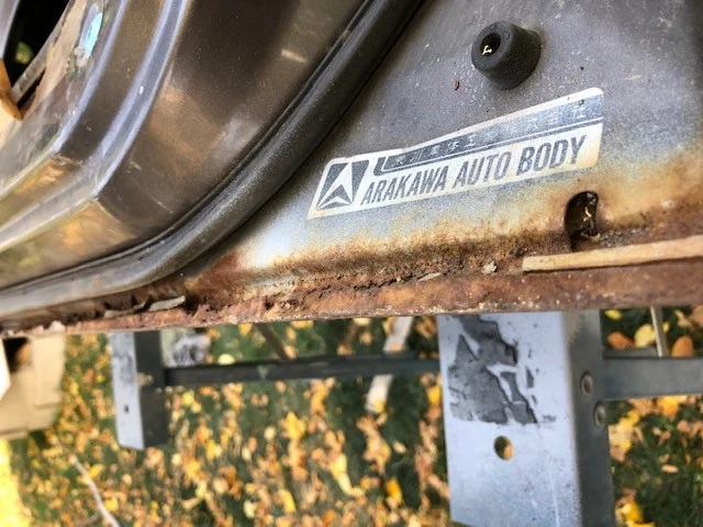

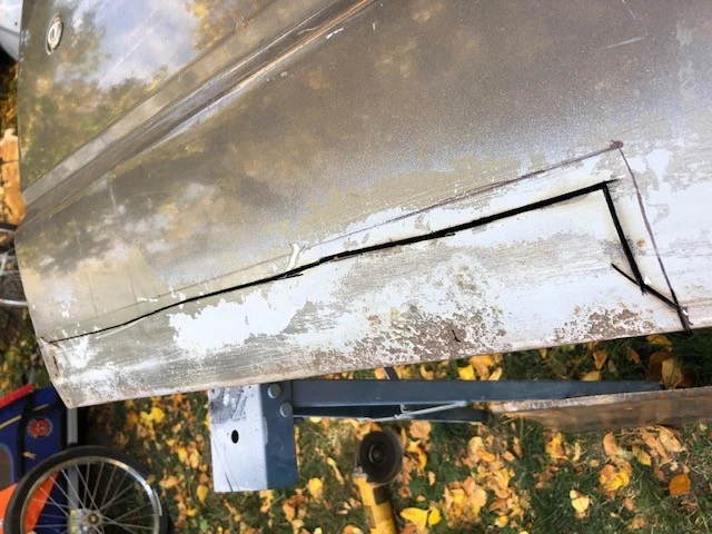

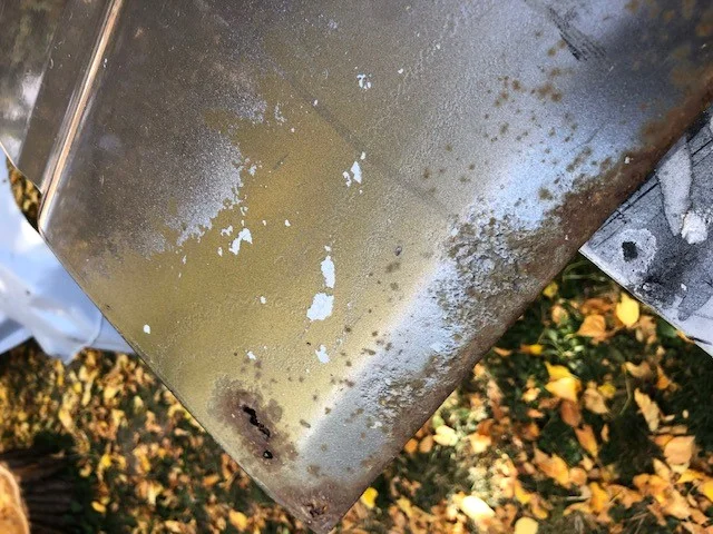

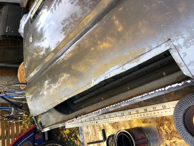

Went through the 7 doors I have at my disposal (the 89's driver's door was a write-off, though I was able to salvage the door card and internals. Let me know if you need a motor or regulator etc). Found three basically rust-free doors, but as it turns out, both front passenger doors were pretty rusty, so I chose the best one and got to work:
Cutting the rusty bit away:
Of course the inner lip was completely gone, so I tacked in a new lip and coated everything with POR-15:

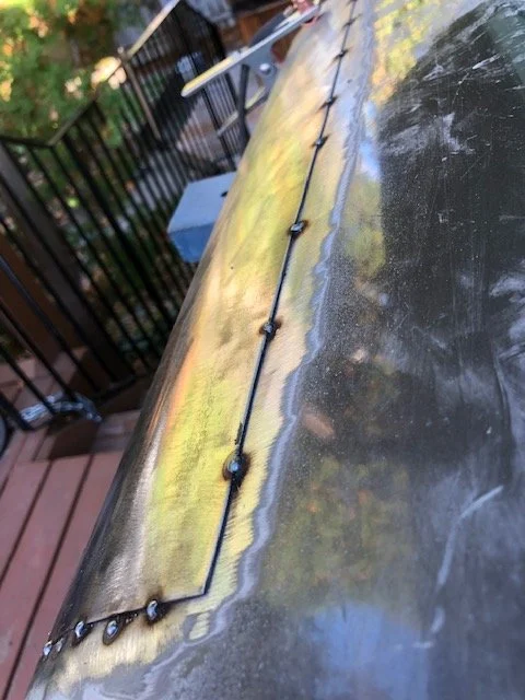

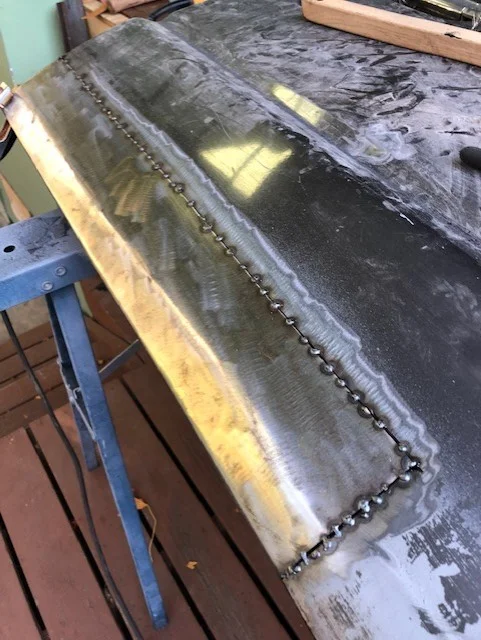

I've made the patch panel but haven't welded it in yet. That'll be tonight's job.
A little more progress to document.
Finished up the driver's side door bottom. Came out pretty good:

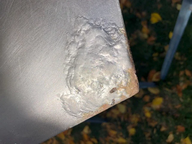

Fabbed up a little panel and tacked it in.
Little bit of filler and some high-build and it's almost not quite as good as new!

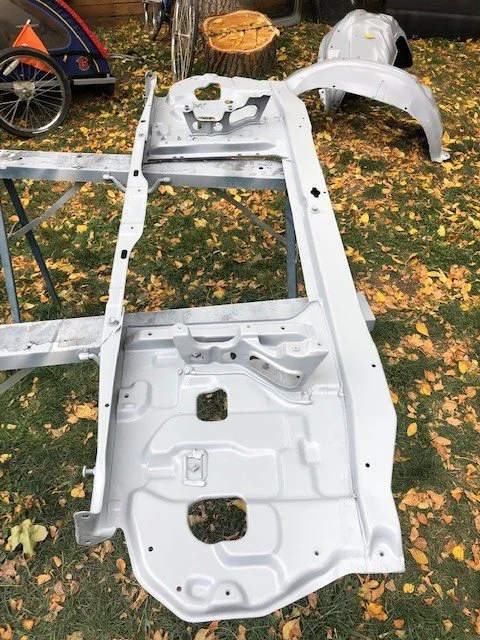

With that done, I was able to get all of the panels in primer. Not having a garage, I've had to turn my yard into a de facto body shop. It's not great, but you gotta work with what you have.
Next up: PAINT!
