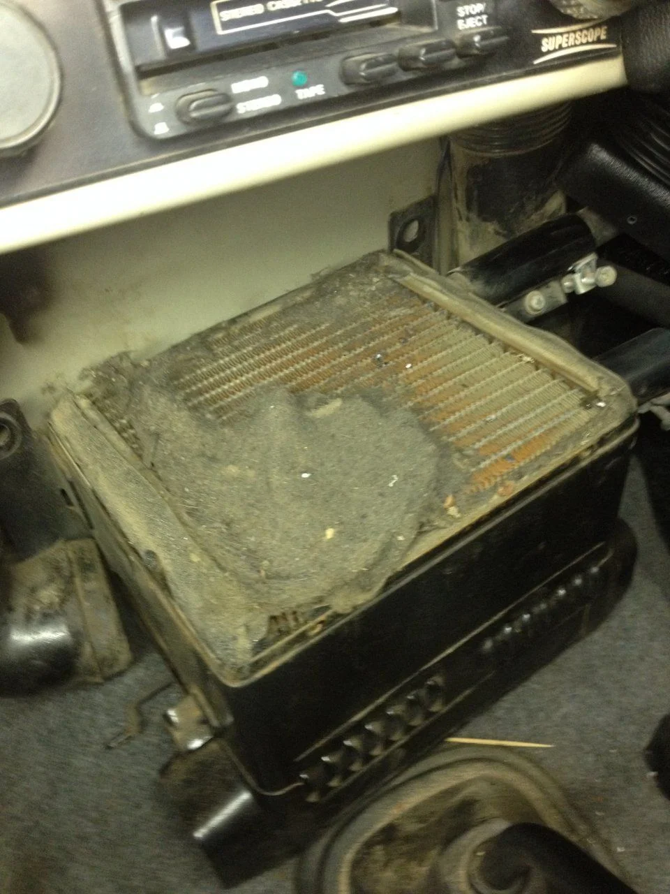

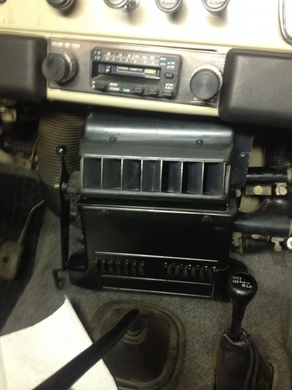

A few weeks ago, it really got cold here in GA. After looking at a few threads about heather boxes, I tried my hand at it. All the threads I read had removed the heater box and core. Well, I didn't want to drain my coolant to remove the core, so I set out to see if I could remove the heater box and leave the core.....OH my, am I glad I tried this. Yes, I was able to remove the heater box and leave the core hooked up. I cleaned the box, reapplied foam, took my air hose and blew out the heater core, and reinstalled.....Much nicer look and more heat! Well as much heat as the CCOT small hose that sits behind my rigs CCOT AC unit. Matter of fact, I'm going to address that small blower to heater box hose here soon. I've used my CAD to come up with the schematics on a new hose similar to the elusive L200 OEM piece.
Before photos:
After:
Were you able to disassemble the entire heater (top and bottom box) and leave the Core hooked up?
Before photos:
After:
