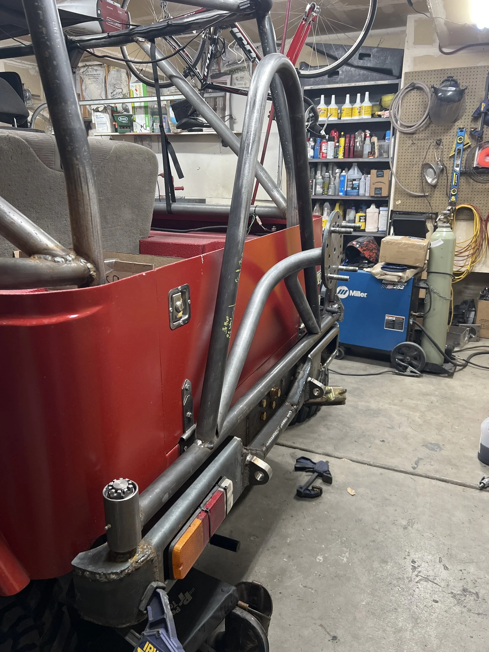

I’m glad to hear this as I’ve had a few different tire carrier spindles on this Cruiser and they both failed. I had a large bolt with some hokey box that I created around the last pivot point that worked for 25 years, but it looked terrible. This Ruffstuff spindle looks legit.
Where did you put your gas struts?
I had room under the swingout, so one bolts into the bumper and the other one 8” or so out on the arm. They also act as my stops, which is great on hills. These are cheapies I pulled off a car hood at the wrecking yard. The Idea was that they were an experiment and I’d replace them with new if I liked them. They still haven’t failed.

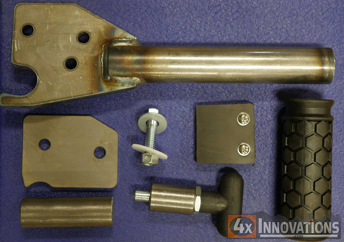

My carrier latch arrived from 4xInnovations and it is stout!
I can’t quite figure out where the square rubber pad goes. Let me know your thoughts. The second picture is from their website.
That’s a cool idea for a swing out latch. Not a big fan of the little red handle over center latches. Good job!
Thank you. I owe the credit to this amazing community as I found this latch on here. I purchased one of those flimsy red handle latches as I forgot about this one, then @DirtSniffer posted pictures of this mount and it reminded me to reconsider.
I am glad that I did. This is an amazing piece of work and sometimes it just makes sense to buy something that is engineered well, especially at $85.

I understand where that rubber pad goes now. I realized that the picture was taken from above the bumper looking down and that pad must go against a metal stop that I have to fabricate.
You’ve probably figured it out, but keeps from metal on metal, allow metal on rubber and a bit of tension on the latch mechanism.

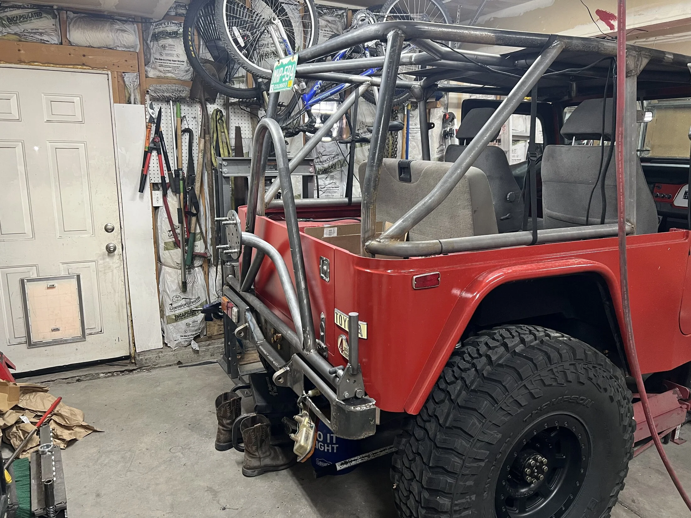

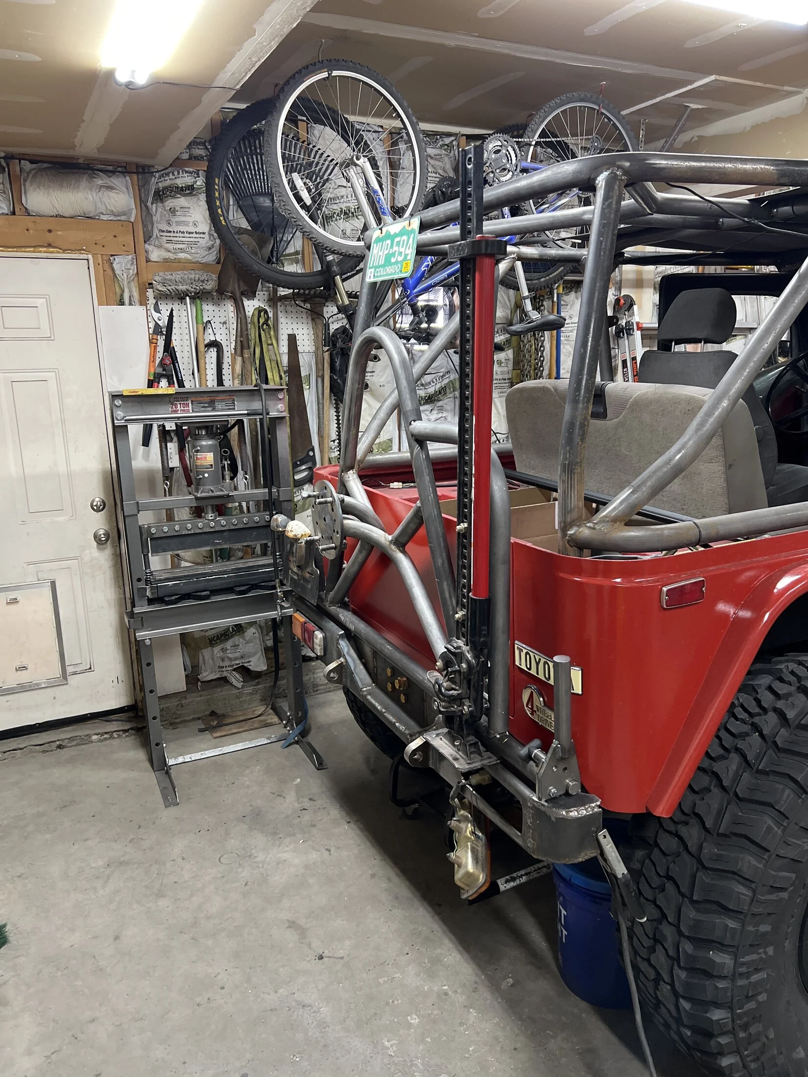

IMO the bottom bar is to small for a 40” tire
You going to have a lot of flex which leds to fatigue and breakage.
I built one very similar and it flexed like crazy with a 33” tire and none bead lock wheel.
I would gusset to the spindle kinda like you did on your cage . putting the tire on should be fun
That’s a good idea. I didn’t leave much room between the spindle and the license plate bracket but I bet that I can come up with something.
What wall thickness?
It’s .120 DOM.
It’s .120 DOM.
Sounds thin to this farm boy, but I wouldn’t be surprised if I’m well over 6k on my build.
Mount a tire up and shake the snot out of it, see what you think about it then add bounce, momentum, and age. #trustthescience
What size do you recommend? This is 1-3/4 tube.
I would use some rectangular tube preferably the same height as the spindle sleeve and wide enough to make it to the center point of the sleeve. 2x4" 3/16 wall ?
The tire is basically hanging off the back creating a twisting force to the bottom tube of the carrier, gussets well only help side to side movement.
This is 1.5x3 IIRC, and probably 1/4” on a 2” shaft, tapped on the bottom for a brace that runs diagonally to the frame, because the 1/4” wall bumper wasn’t strong enough IMO. Doesn’t wiggle.
Thanks for the input. At this point it seems to make the most sense to run with this and see what happens. I will see what I can do to splice another gusset between the spindle sleeve and the hoop, and somehow through the license plate bracket.
