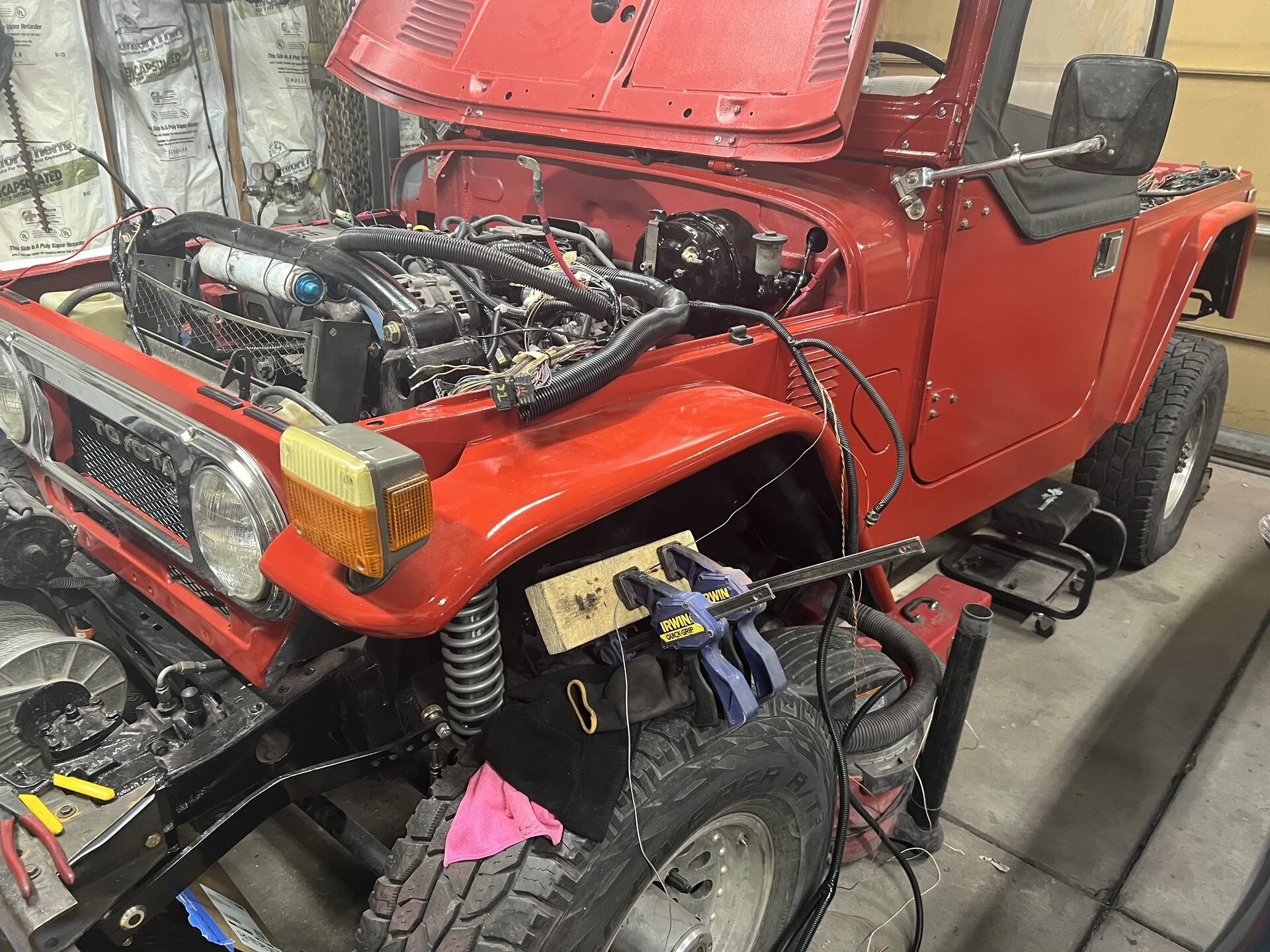

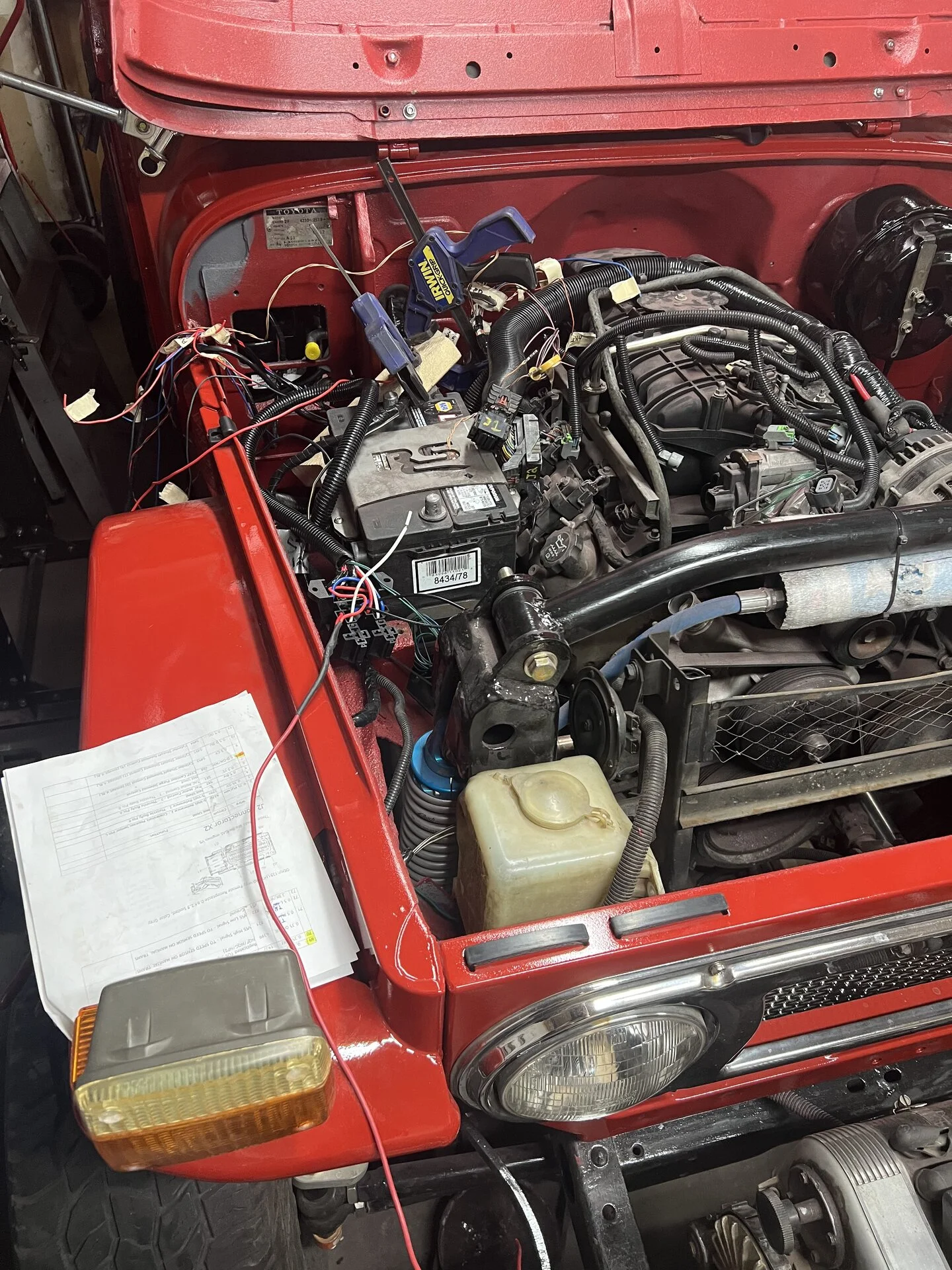

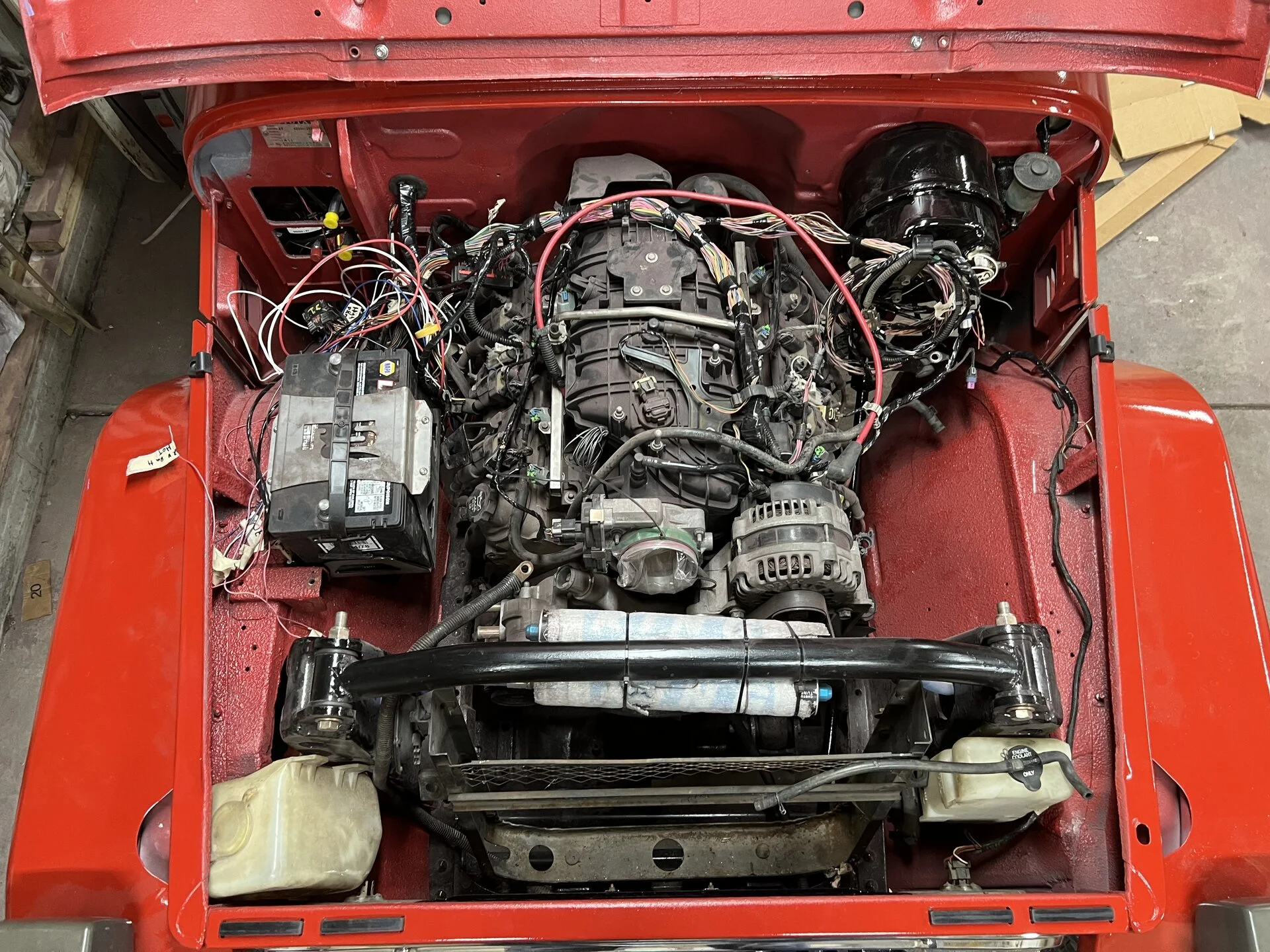

I was asking the questions now because I needed to make the decision about what to do with the harness. That decision has been made and the transmission wires have been deleted. Next I will mount the battery, extend some of the wiring and build a fuse block, then I can get back to wrapping up the wiring under the dash and to the rear. I’m really glad that you steered me towards reconfiguring my factory engine harness. It has been satisfying to figure out where everything goes.

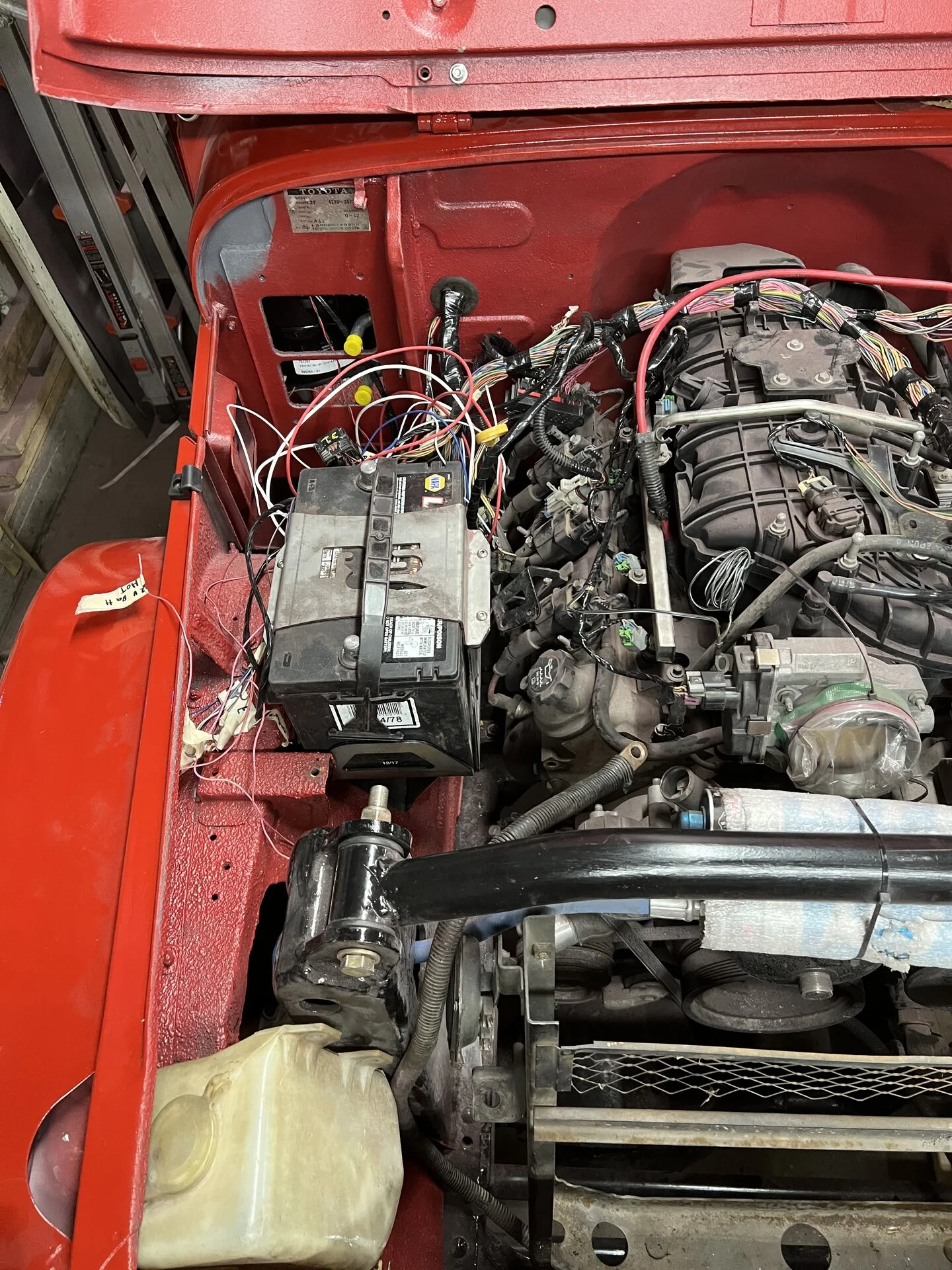

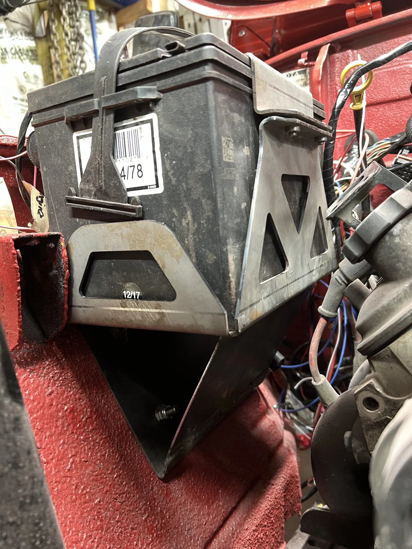

Done. Now I just need to tape those wires around the positive terminal and run them straight to the engine harness without any fuses and it should be good to go.
I got this battery tray from Ruffstuff three years ago and it was the first fab part that I acquired. I thought about remaking it since I have learned so much along the way and I could take pride in yet another part made out of a garage using an old broken table saw as a workbench. But then I realized that I have more pride in the fact that I didn’t waste my time and effort, and it works great! I did fab the fender bracket. 🙄

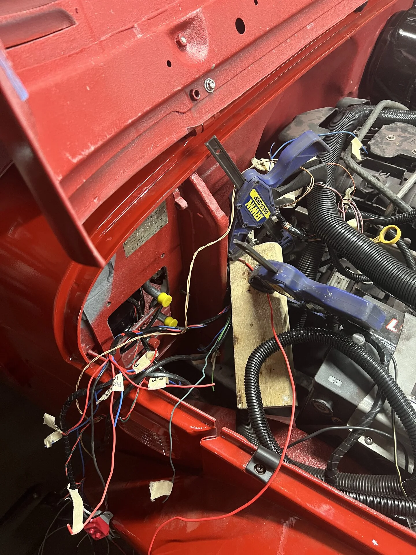

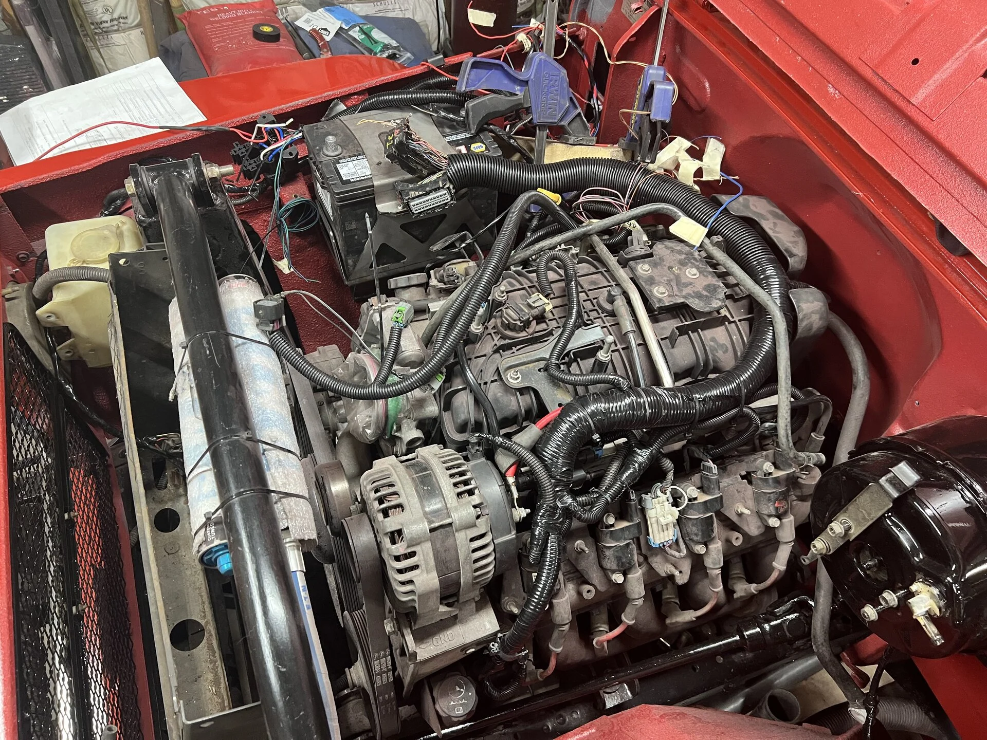

I’ve made a little more progress this weekend. The left side engine harness is in and I am working on connecting the right side to the factory harness. My computer is programmed and lost in the mail somewhere between Kansas and Colorado so hopefully it makes an appearance this week. Brendan was able to program two signals for the VSS input and I have the hardware for the signal wires in my connector and computer so I ran those wires today.

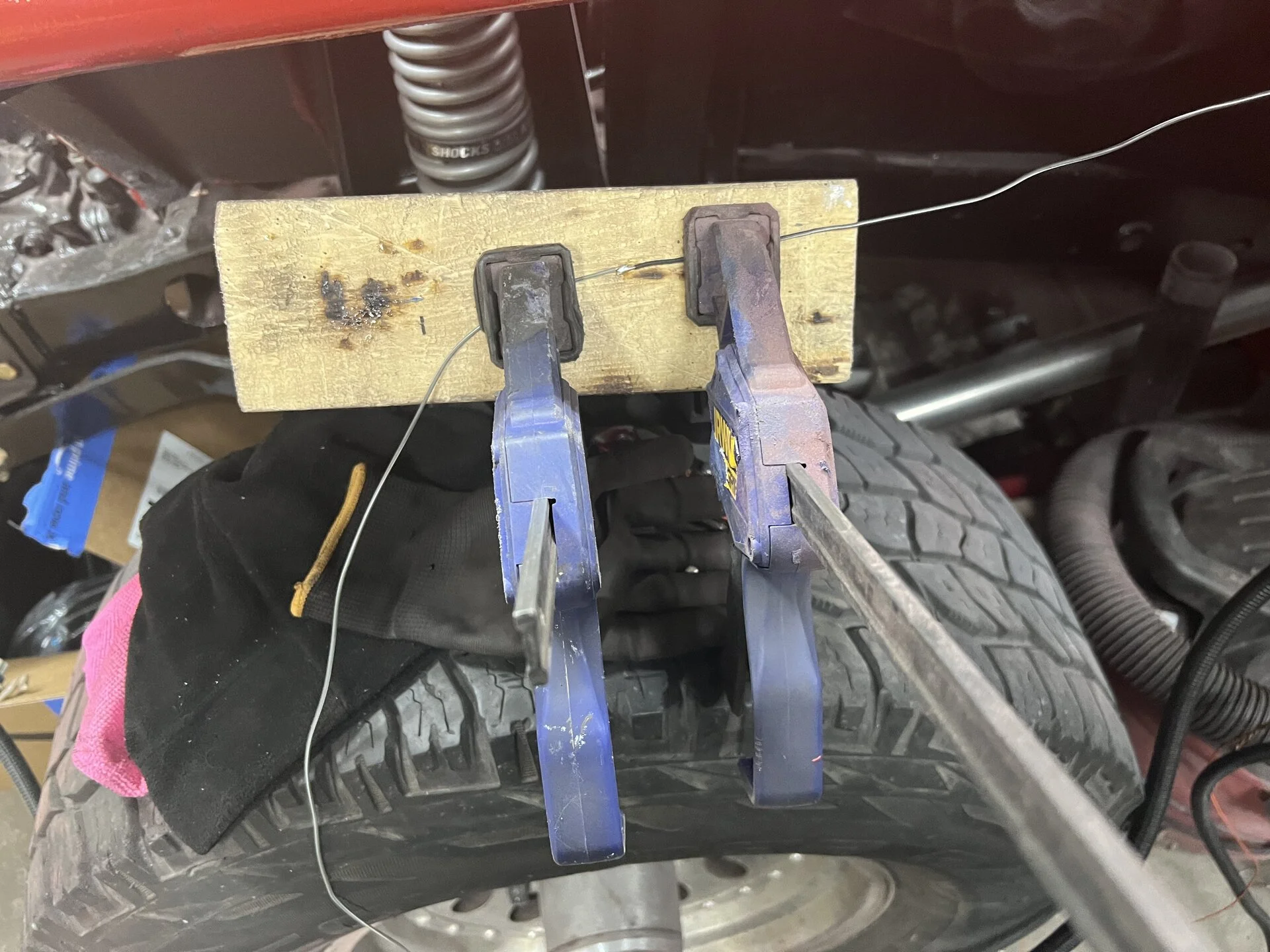

Love the wire holder, maybe a bit overbuilt but great idea
It works, but you inspired me to purchase a set of wire clamps as I have a bunch of soldering left.
