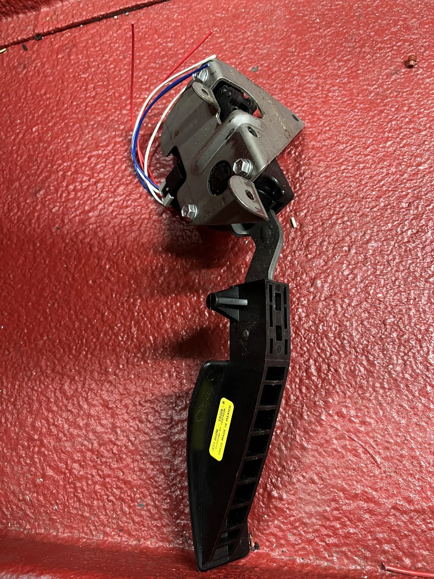

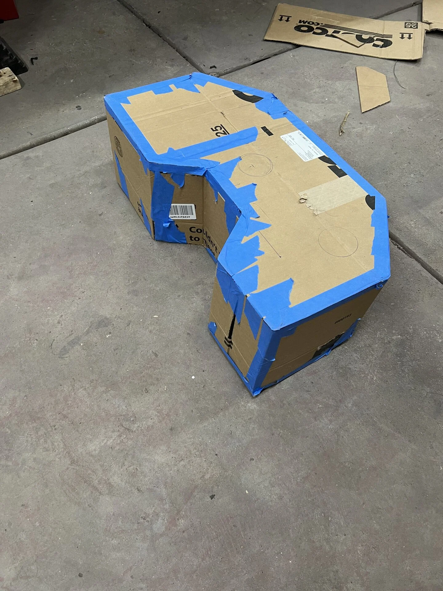

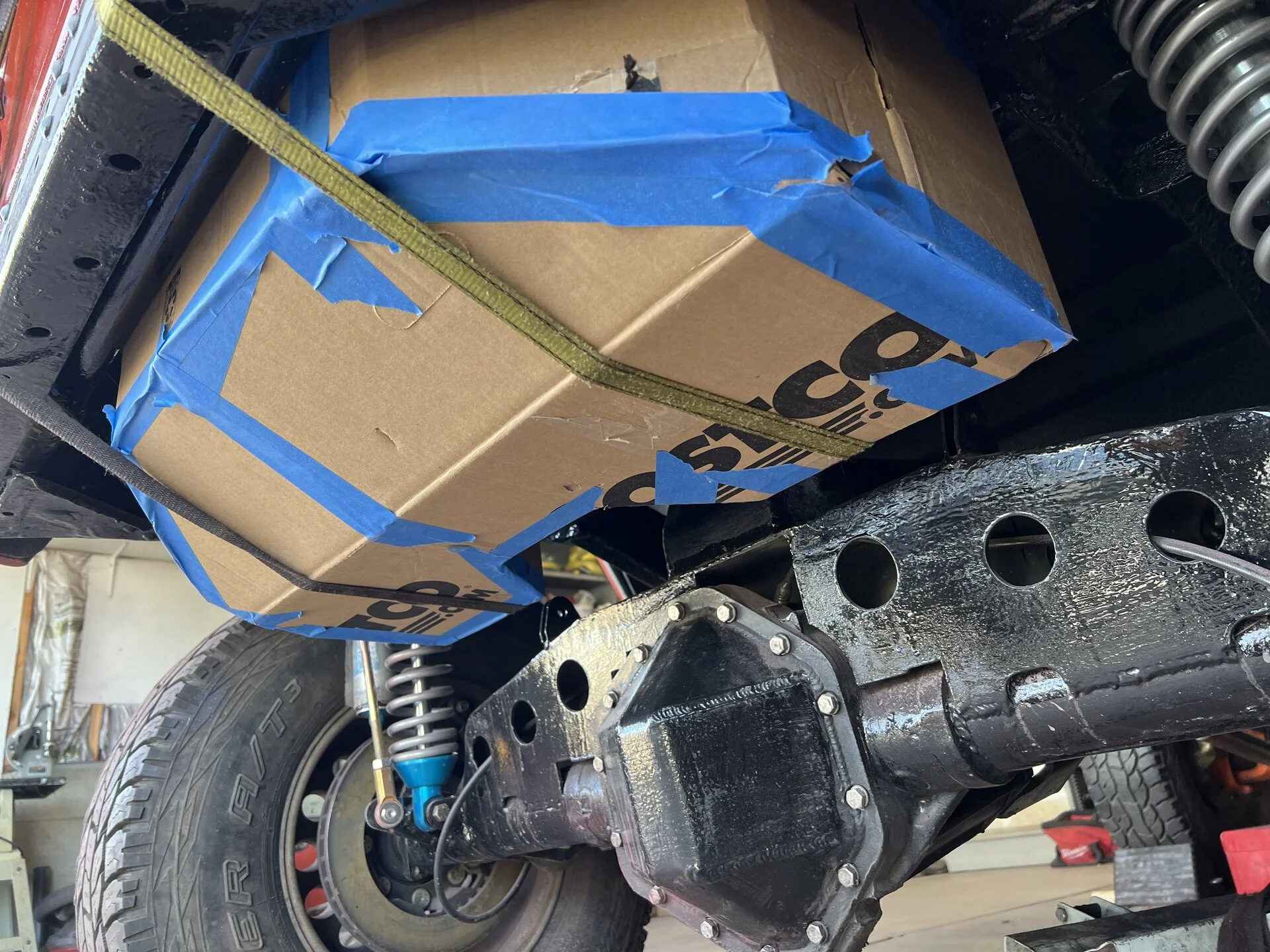

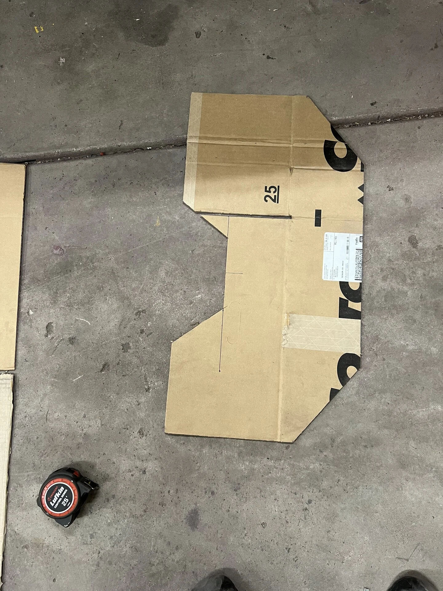

This used accelerator pedal from a 2008 corvette arrived. The bracket is steel so this should be a snap to modify and install. I think that two pins on the connector are swapped from the Escalade for some reason so I’ll have to pull up a Vette wiring diagram to sort that out. This might wait a few weeks as I may jump on the fuel tank mockup so that I can get measurements to RCI. It looks like it’s arts and crafts with cardboard this weekend.

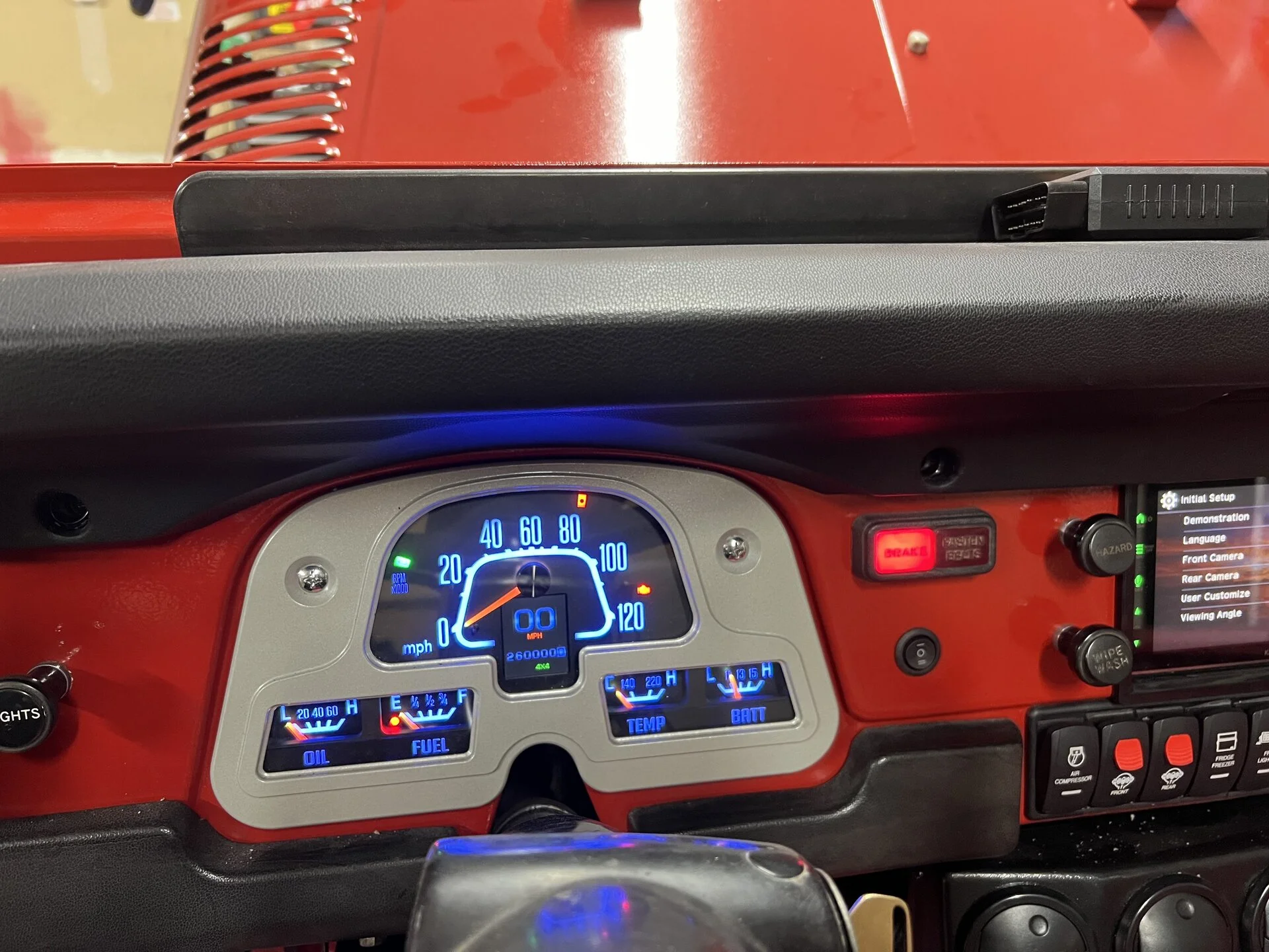

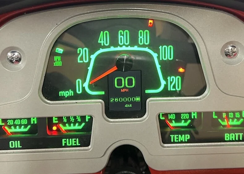

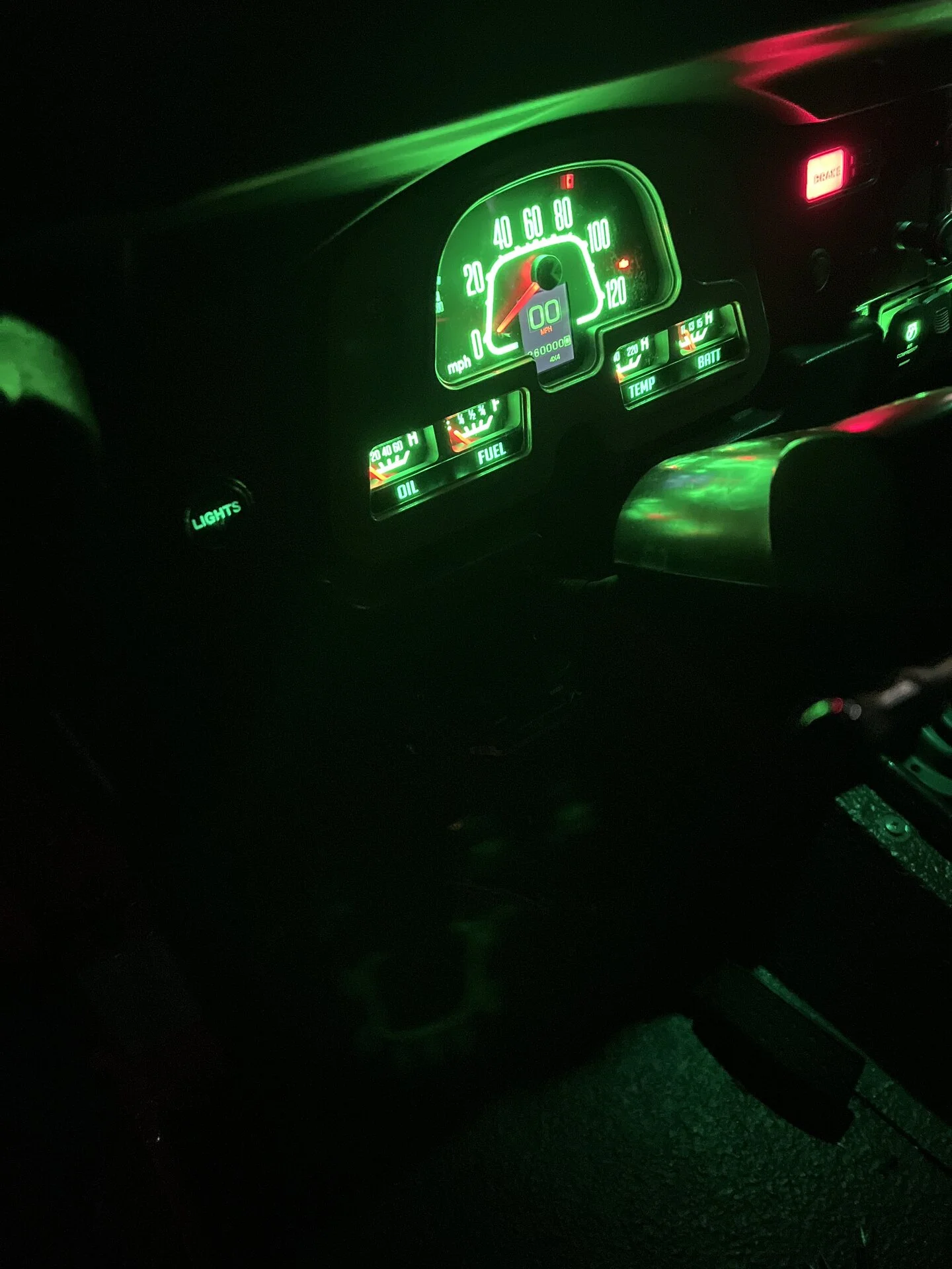

The 4x4 light decided to start working on its own. ✅
Maybe I should leave this thing alone more often. It seems to have some gremlins that it is working out. The brake light switch was turning on the parking lights before, and that is now fixed, too. I assumed that it was a ground problem, for which I did nothing about 😂
Here is a closeup. @Firemedic831, you need one of these ☺️
It’s been 30 years since this brake light has worked, and I never knew that the headlight switch was supposed to light up. I don’t think that I ever remember seeing this illuminated. It must have burned out on the ship ride from Japan.

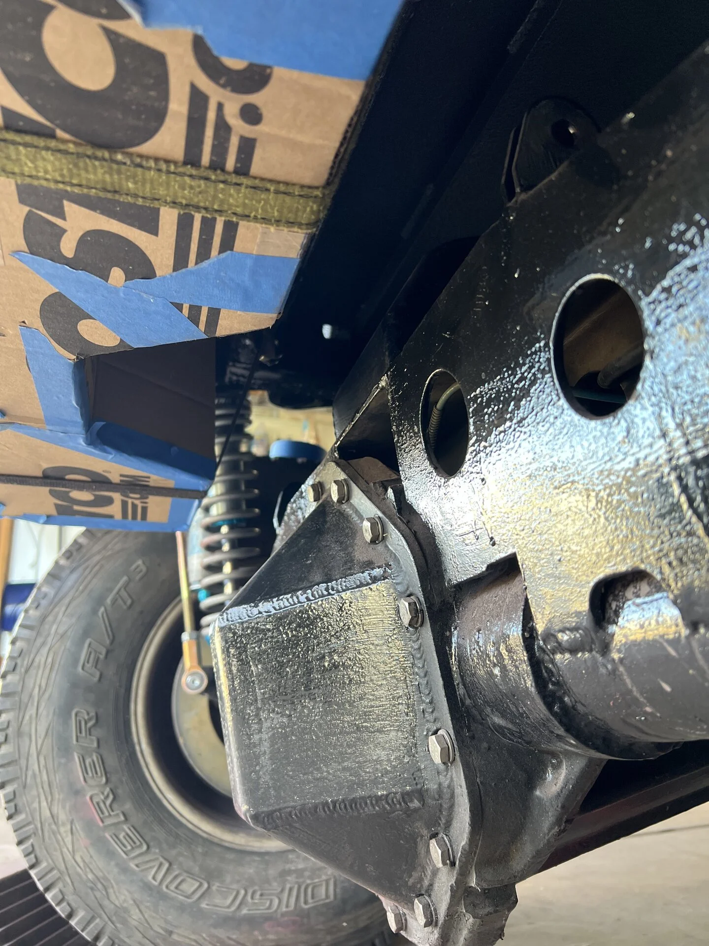

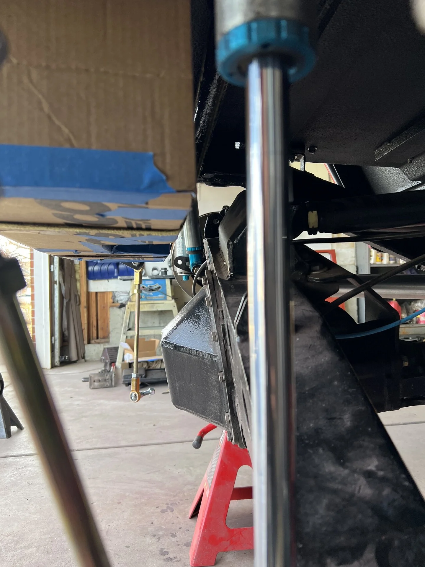

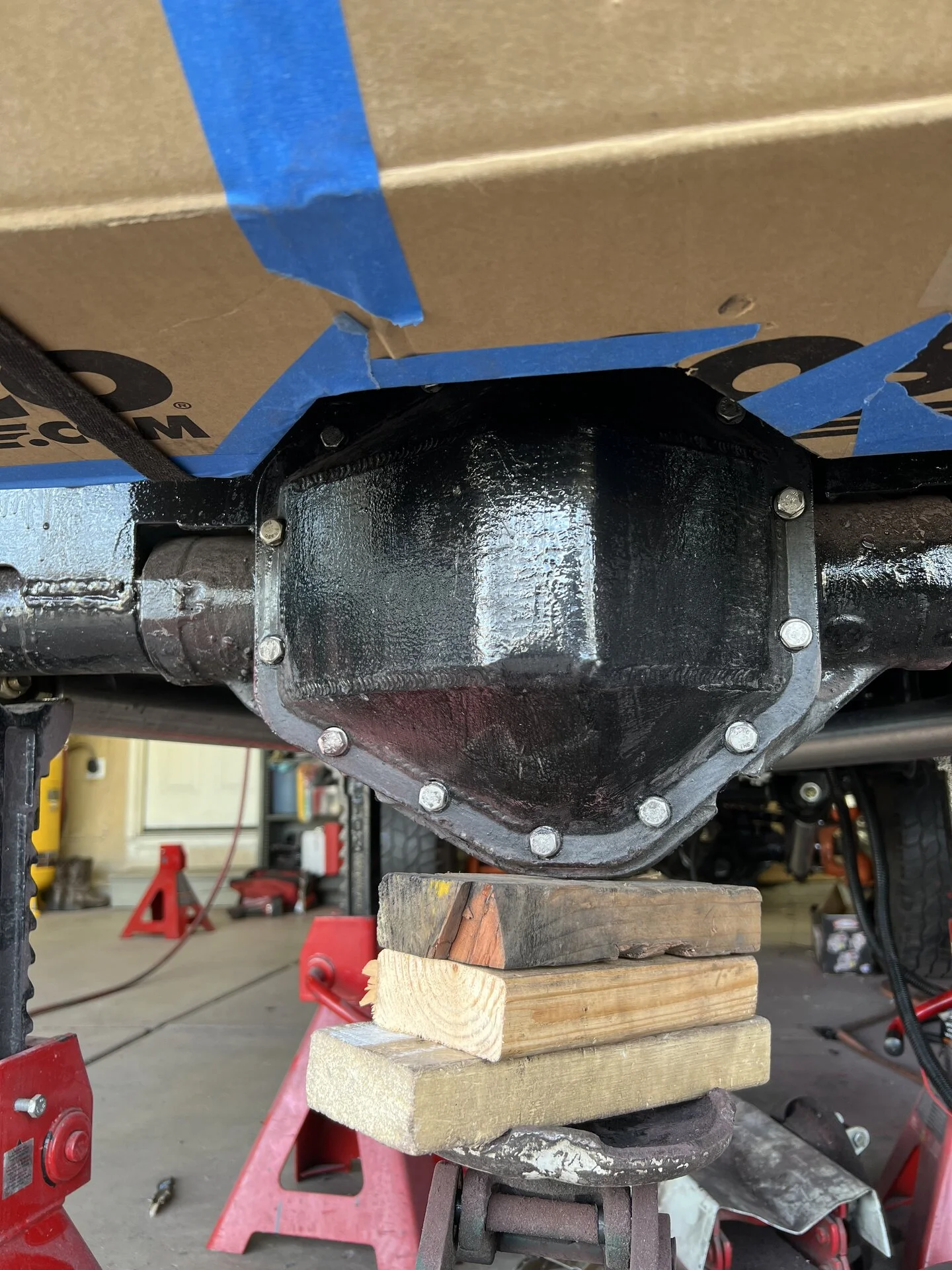

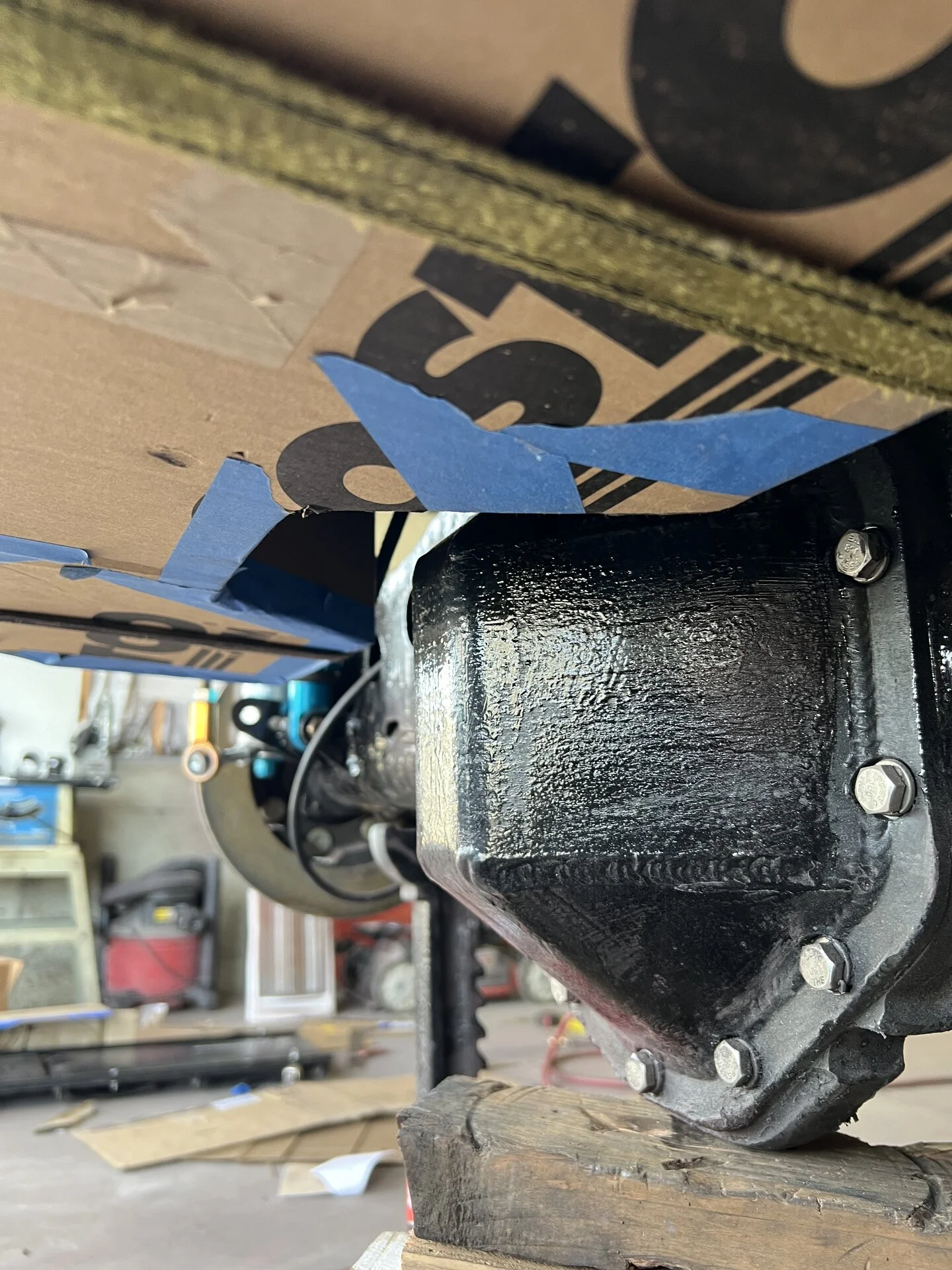

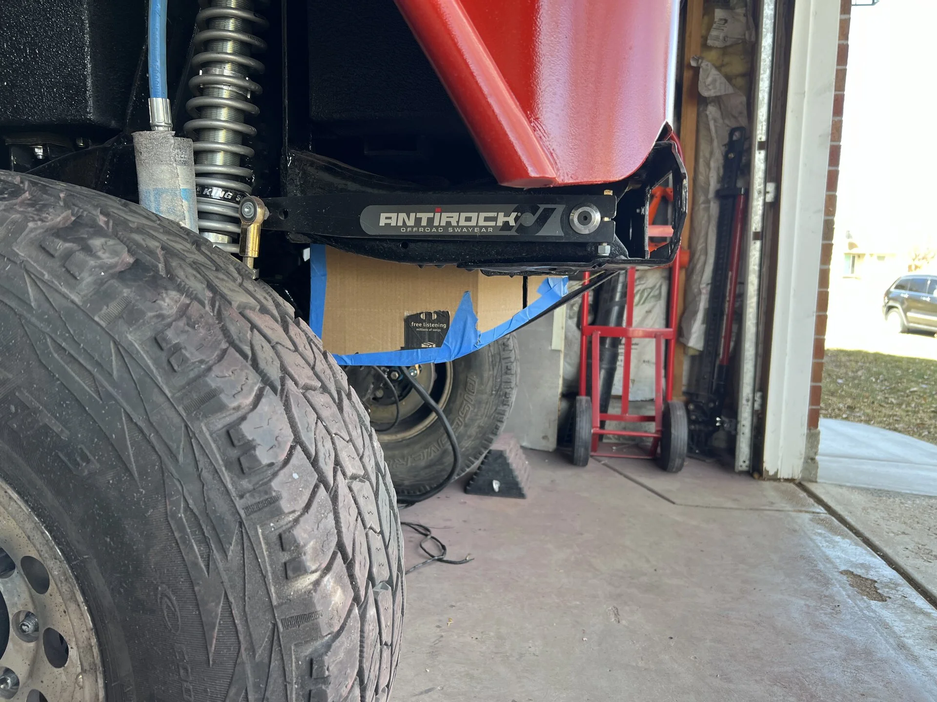

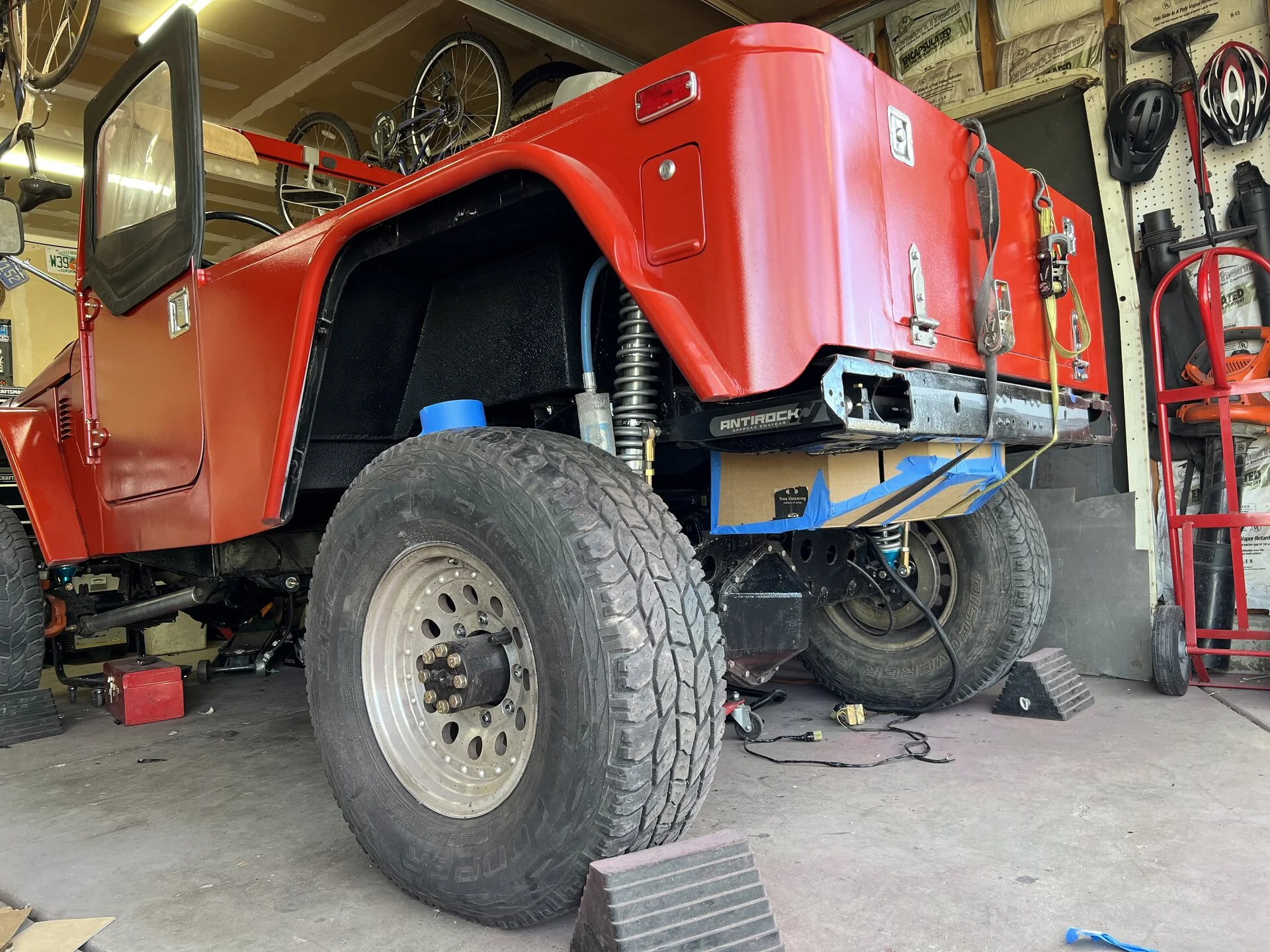

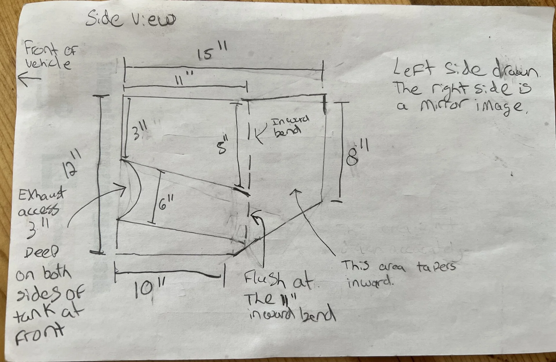

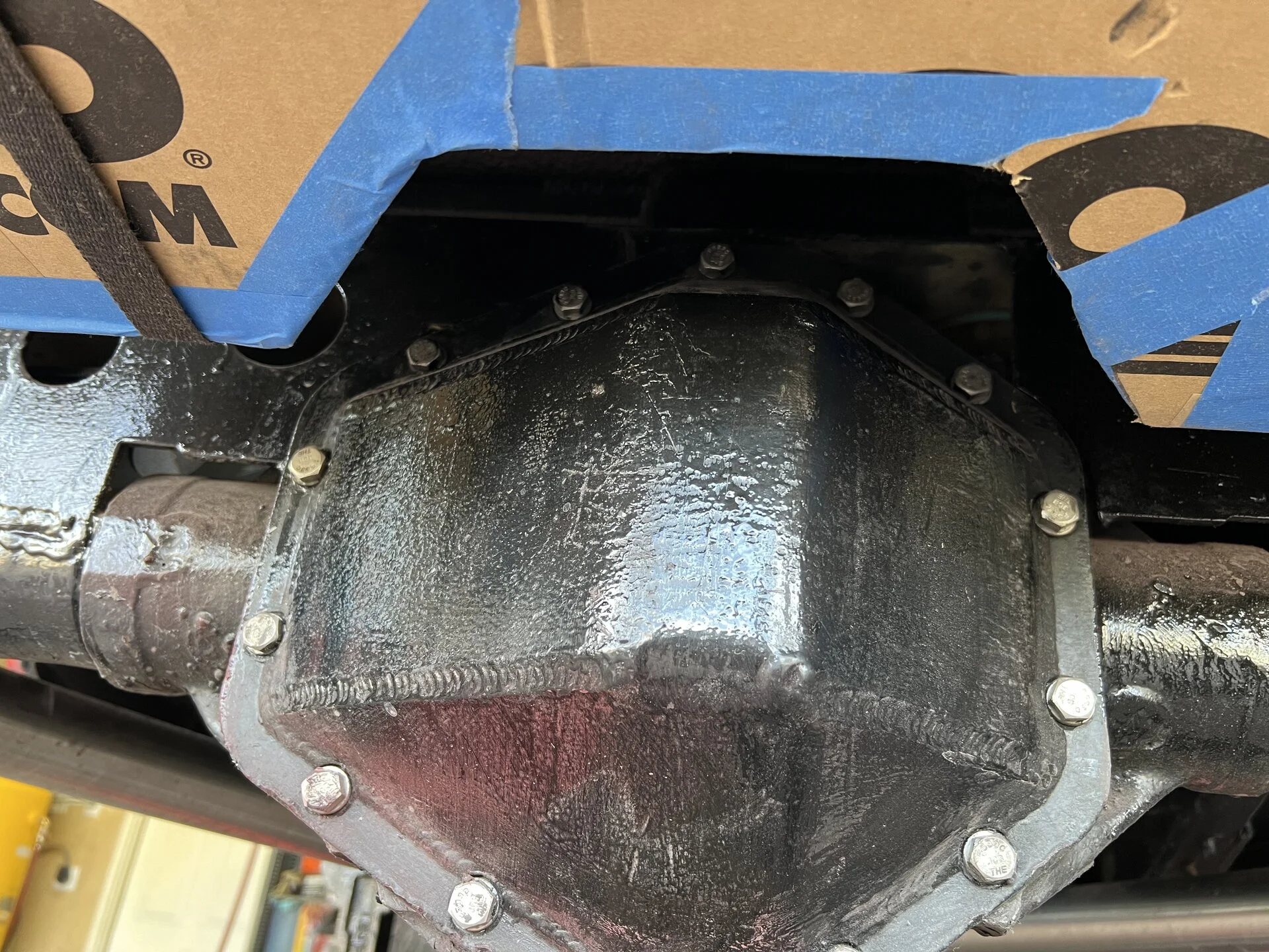

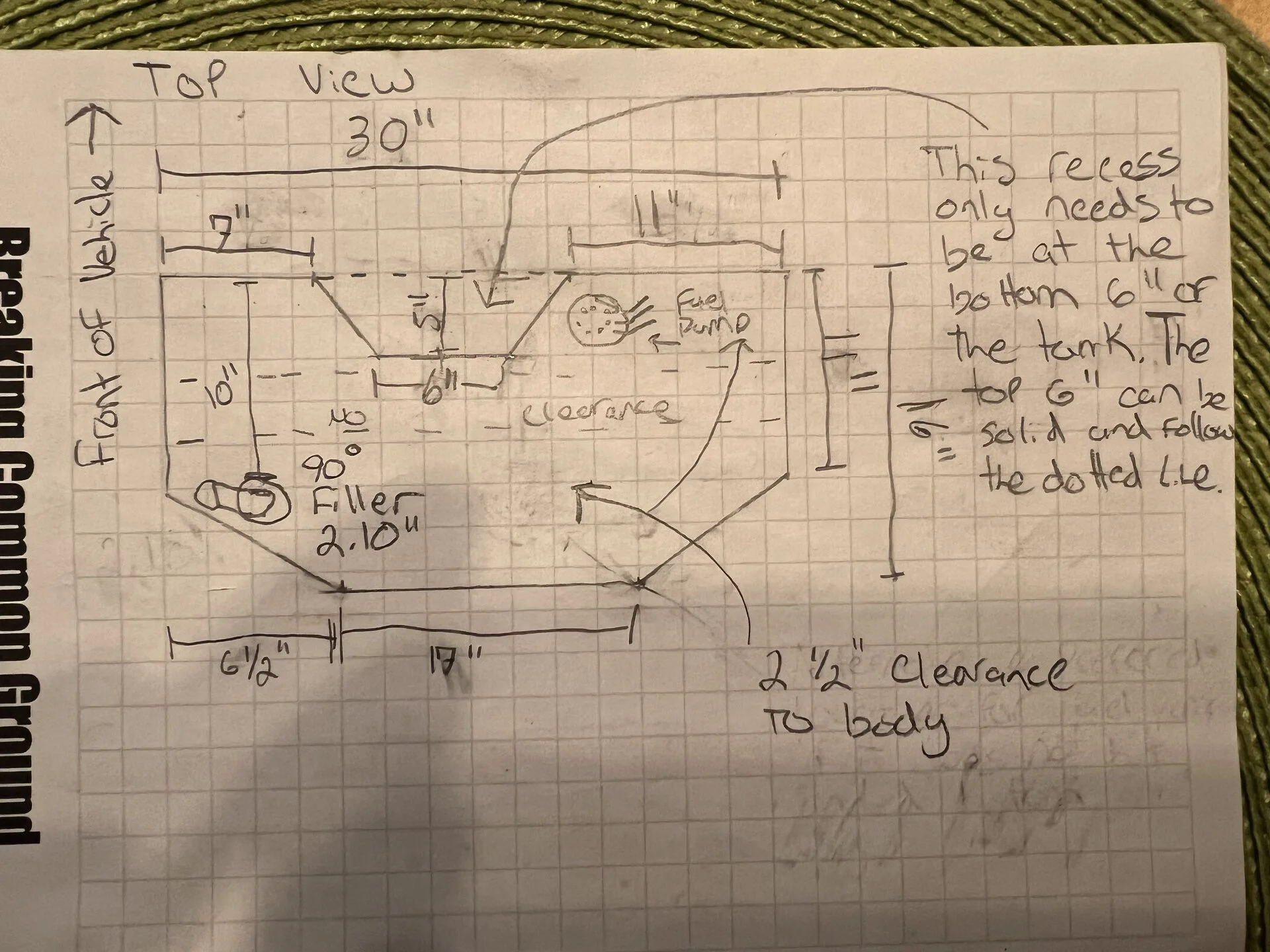

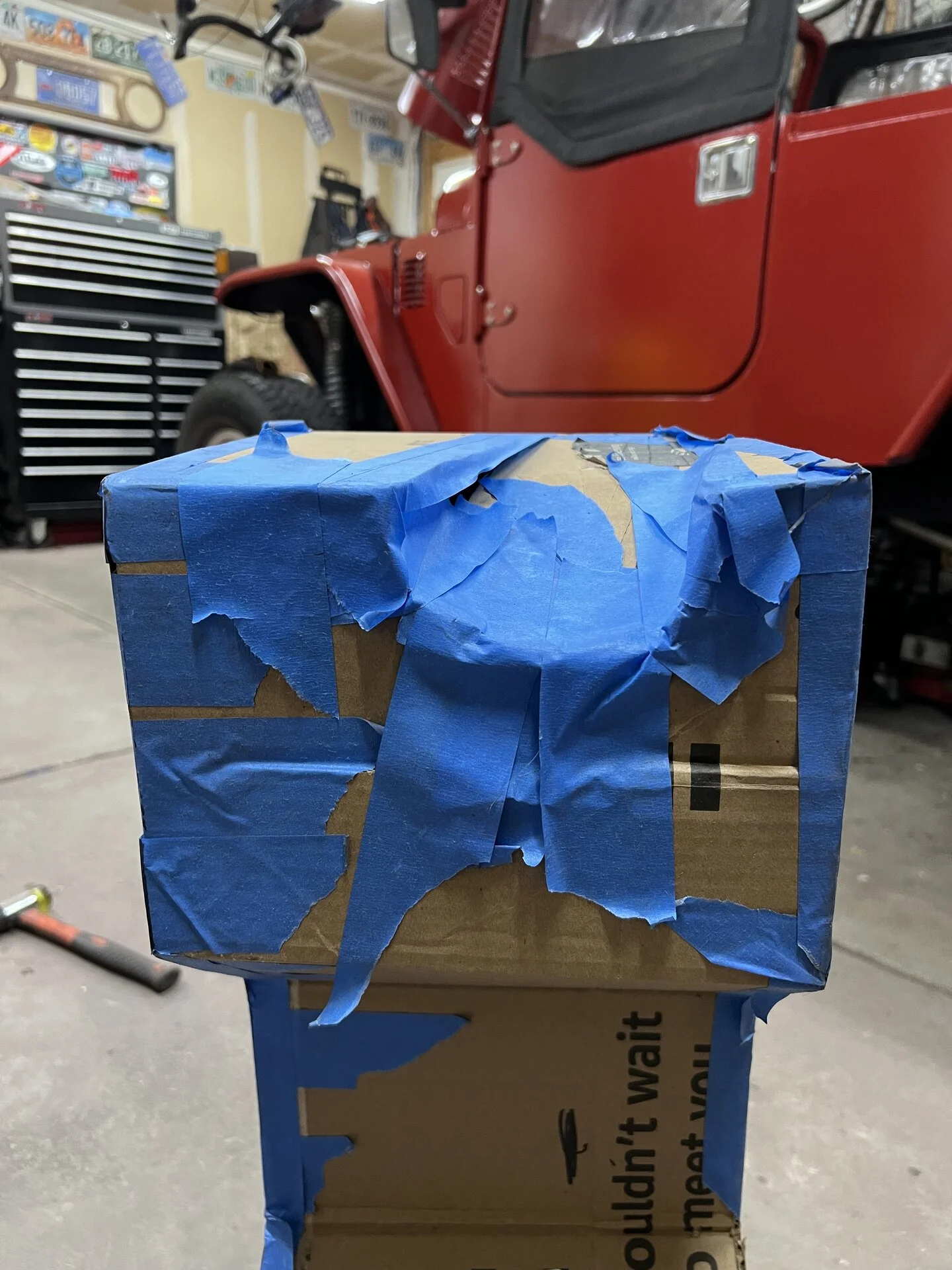

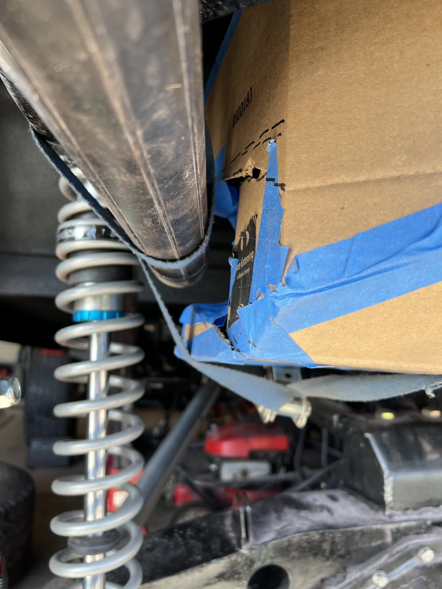

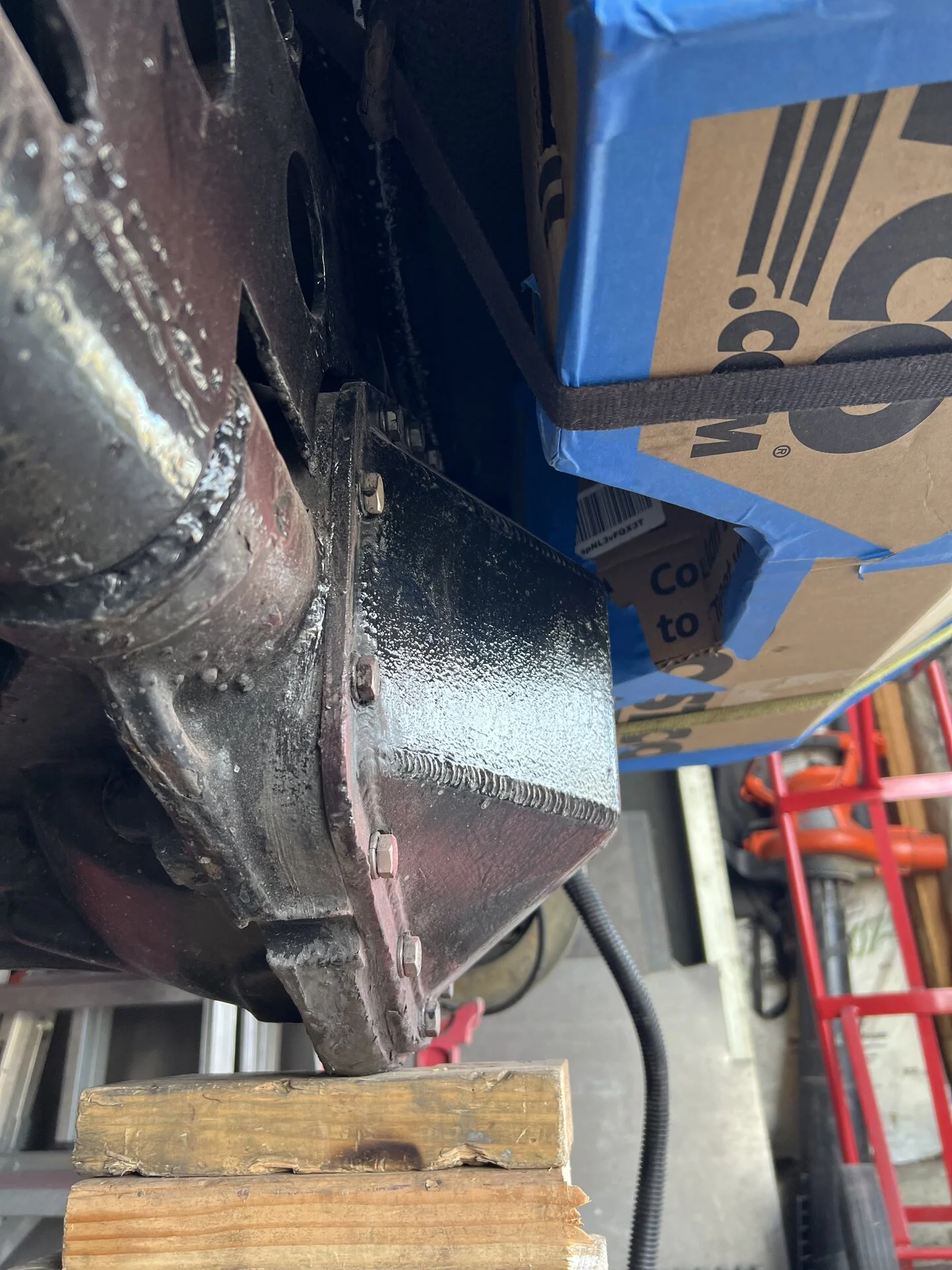

Yeah, I can worry about fuel mileage later. Here are what I think will be my final dimensions. I still need to figure out where I can fit my filler and fuel pump.

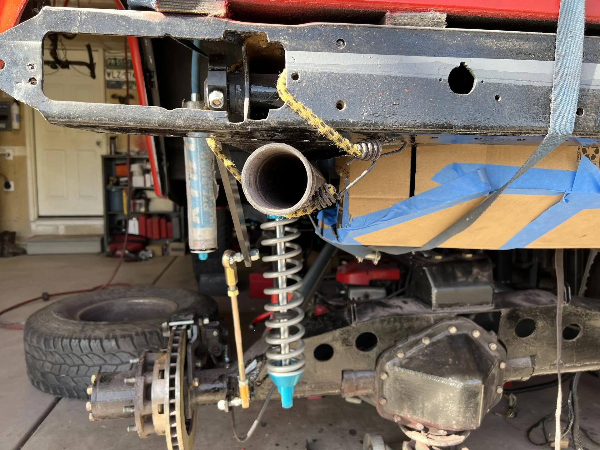

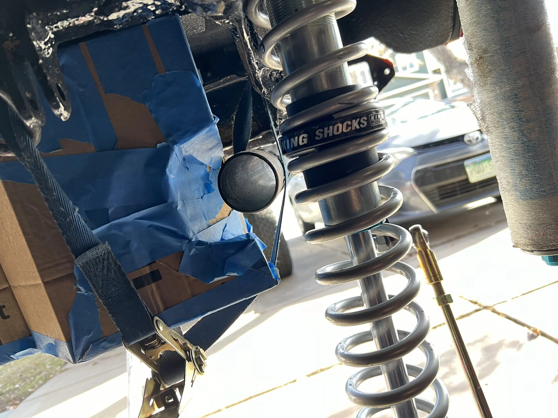

I updated my measurements above and I added recessed areas for the exhaust pipes. I’m not sure if they will do this or if I’ll have to add them in later but I need these to sneak the pipes in between the springs and the tank.
Id bet theyll make whatever you want, but the price tag just keeps going up the more you add. Gonna be sharp when its in for sure!!
