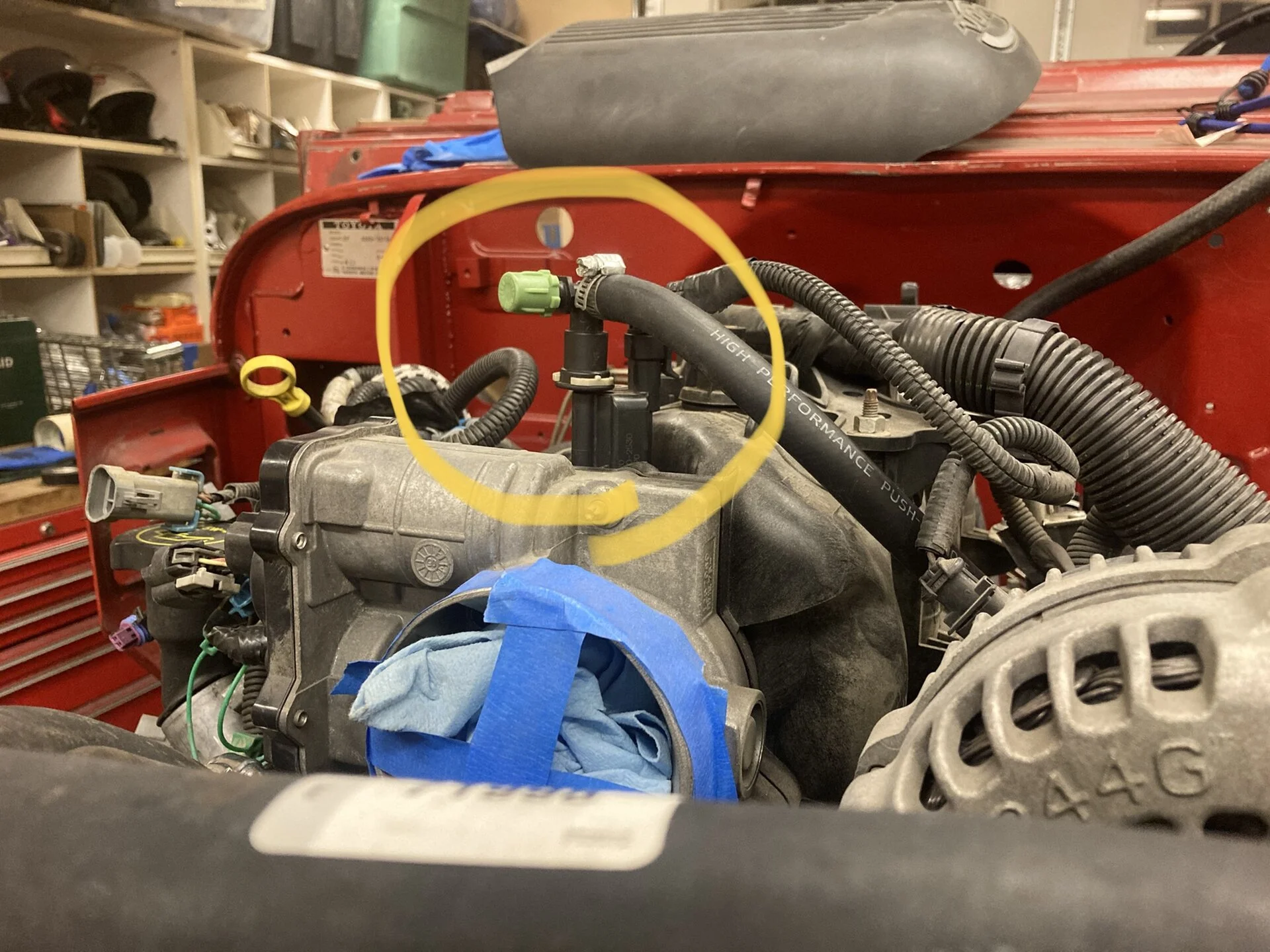

Hey all LS swap guys following Mike’s build what are you doing with the vapor purge hose. Deleting it or running a fuel line to a charcoal canister? Thanks.
I blocked mine off with a kit.
Mike, here a couple of pics for reference. I just completed all my fuel lines and fuel cell install. Now moving onto the PSI stand alone wiring harness. This have to pickup a chassis harness. I will give an update on this Monday. If I can delete it I will. But I need to check with PSI first. If I can’t delete I will run a fuel line to a charcoal canister to catch the vapors.

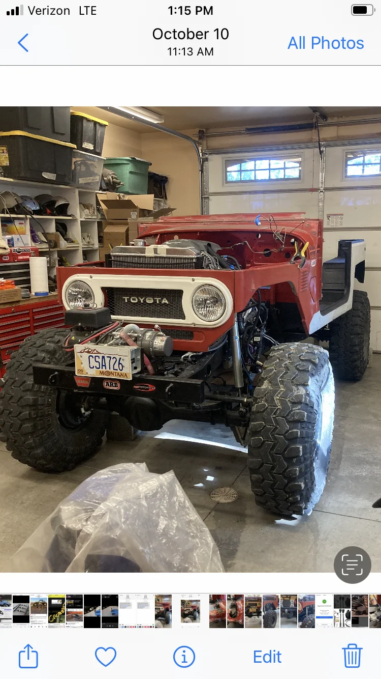

I was planning to use the Dakota Digital factory style gauges so I probably wouldn’t use the Holly display…tough that display will be nice for the initial start before my dash display is installed. Thanks for the info. Could you attach a picture of your engine bay when you get a chance?
Mike, My Wheelbase is 100". I will lengthen when I do the axle swap and 3 link the front. Comp cut the rear and try to pickup another 8 or so inches.
Your Cruiser is going to be amazing! I can’t wait to meet at a trail. Our Cruisers should look very similar when they are done.
