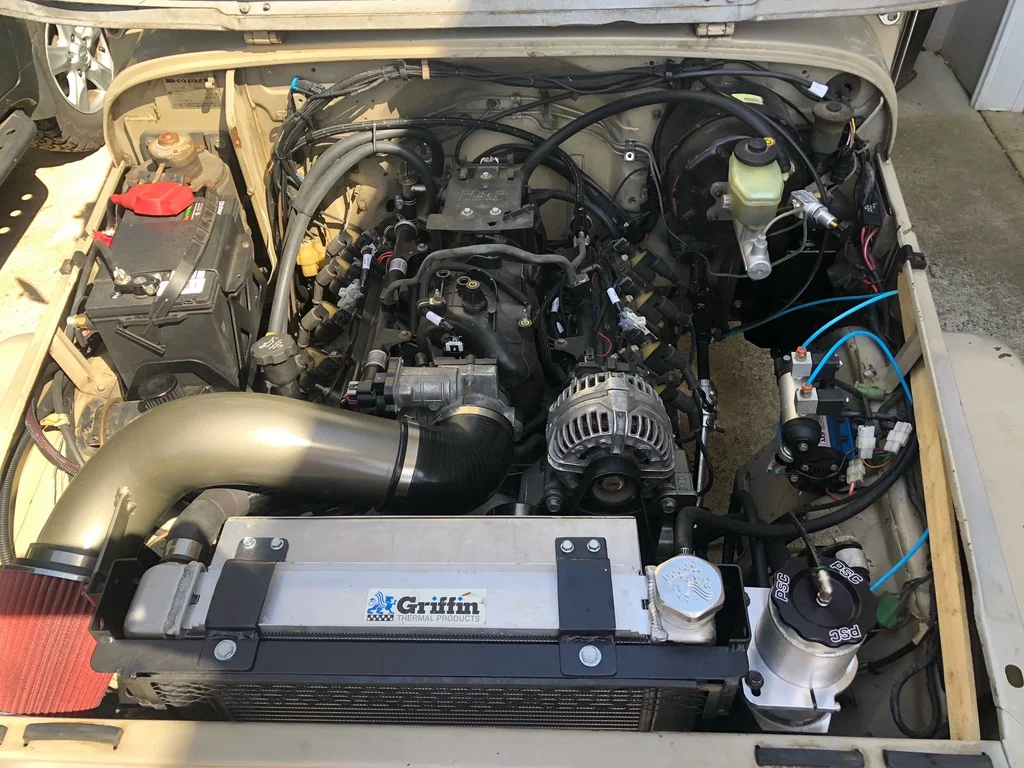

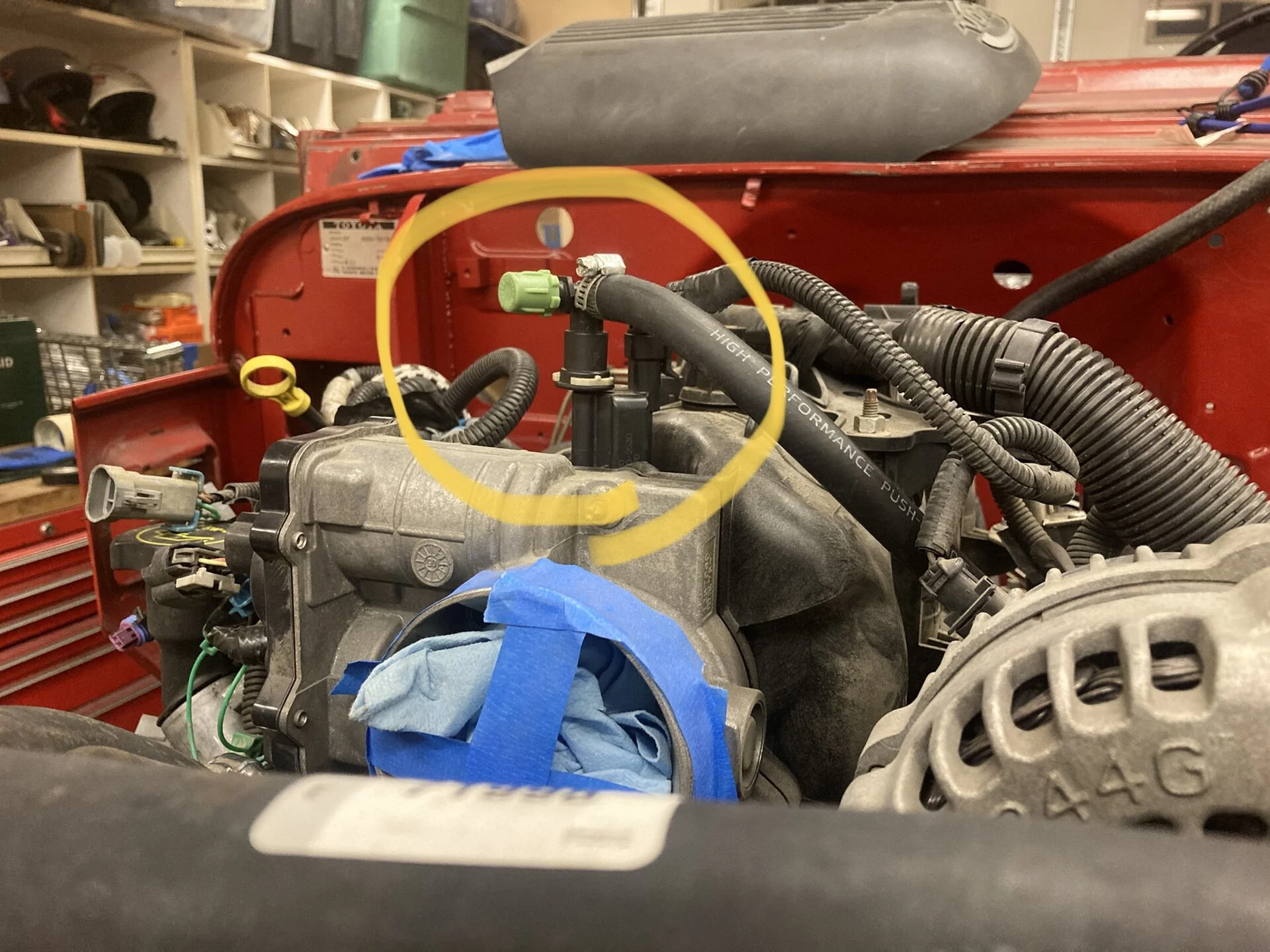

Mike, here a couple of pics for reference. I just completed all my fuel lines and fuel cell install. Now moving onto the PSI stand alone wiring harness. This have to pickup a chassis harness. I will give an update on this Monday. If I can delete it I will. But I need to check with PSI first. If I can’t delete I will run a fuel line to a charcoal canister to catch the vapors.

I spoke to my wiring harness guys at PSI. The EVAP has been deleted from my ecu. So I will delete it and block off.
This looks very clean! Nice work on the intake and brake master cylinder retrofit. How well does that radiator cool the engine in 100+ degree Fahrenheit weather? I was looking at the same brand.

Thanks. I'm running a brushless fan and drove it here in NC in stop and go traffic and she keeps it nice and cool under 210. Fan speed is controlled by the ECU and and is only spinning about 50% duty cycle at that temp, so plenty of "oomph" left should it be commanded. That's a brushless 14" fan and if I ever see it topping 215 or so I'll retune it to spin faster at a lower temp. I know the LS engines really like that 200-210 operating temp and I'm typically 195-205 with low fan demand. I'd say that rad is plenty for my 6.0L, which is pretty much stock.

If your engine placement is similar, I was able to modify the following hoses to work quite nicely:
Upper Rad Hose: Dayco Curved Radiator Hose 71848
Lower Rad Hose: Dayco Curved Radiator Hose 72191CQ
Also, FYI, I was able to use the stock rad support by cutting and stretching it a bit and then you can see the little brackets I fabbed to hold the "custom" shroud. That shroud was a universal kit I bought with the fan from Wizard Cooling.

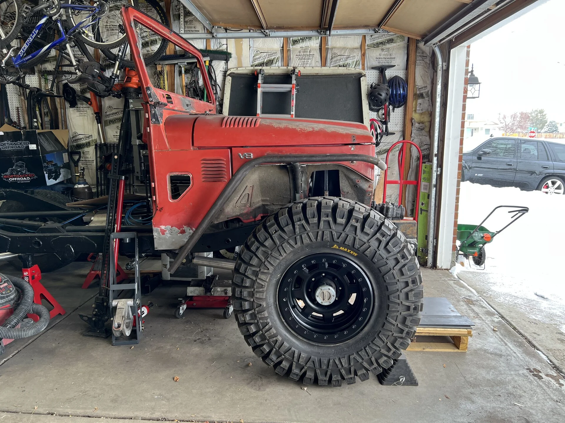

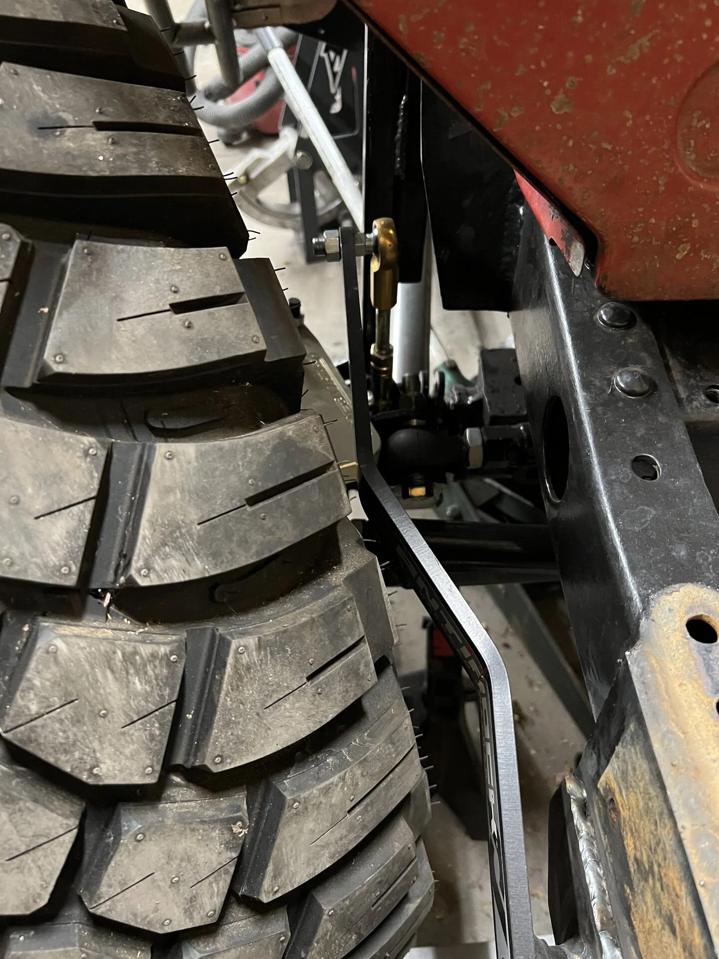

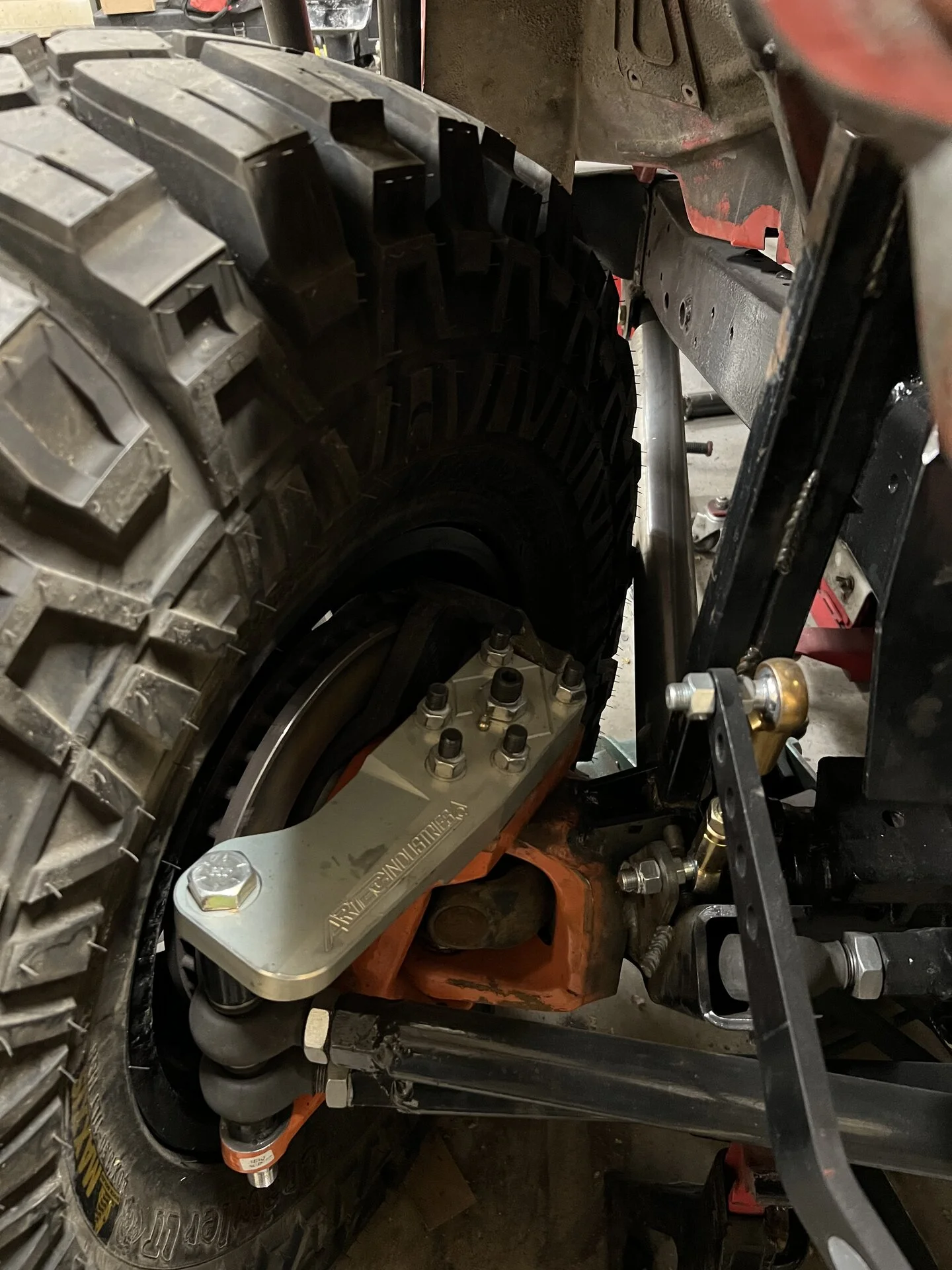

My test wheel finally arrived and it appears that everything will clear. Nothing needs to move in the front (although the tire gets very close to the bib and I am afraid to flex it because the rear isn’t stable) and I am one step closer to being ready to continue with redoing the rear coilover towers. I still need my coilovers and the junk tub.
The wheels are Sidetrack Offroad 17x9 beadlocks on 4.25 backspace and 63” WMS to WMS.
