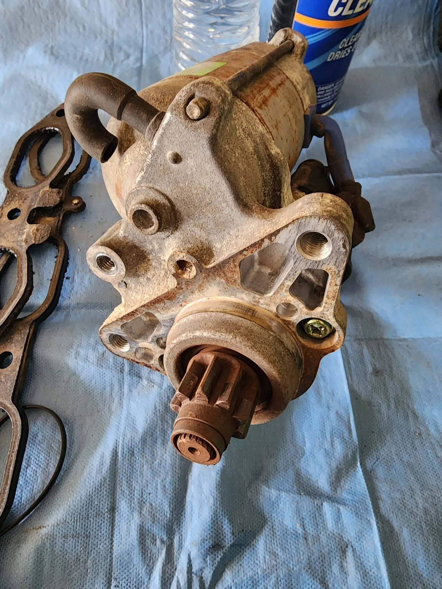

Starter was replaced at 236K miles with an unknown brand starter, but has been working fine. I'm not sure if I should replace the starter anyway. Guess I could see what brand it appears to be, or how nasty it looks under the manifold.

Yeah, that's exactly what happened to me. Reset the code and it comes back. I'm going to go with a Denso starter one from RockAuto. It's around the $130.00, $100.00 if I was to ship them back my old starter. The Toyota/ Denso starter is $239.00 from Toyotaparts.
I just can't justify spending that extra $$$ on the same part just for the Toyota stamp. Most Denso parts that I get have Toyota grinded off of them. Knowadays as well, getting stuff from the stealership isn't a guarantee anymore.

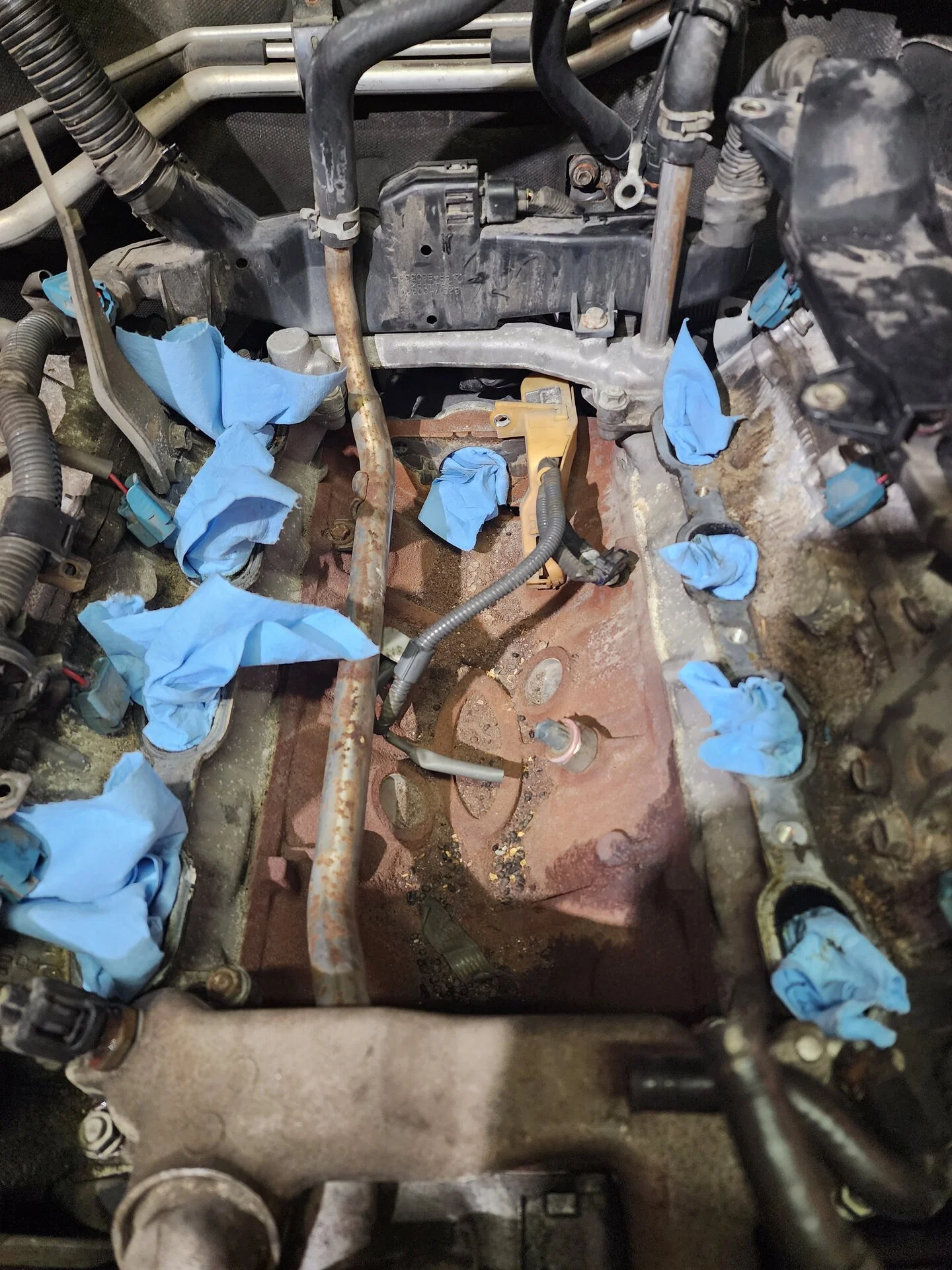

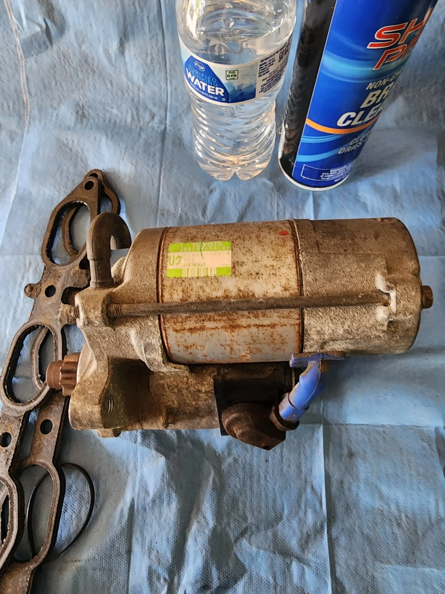

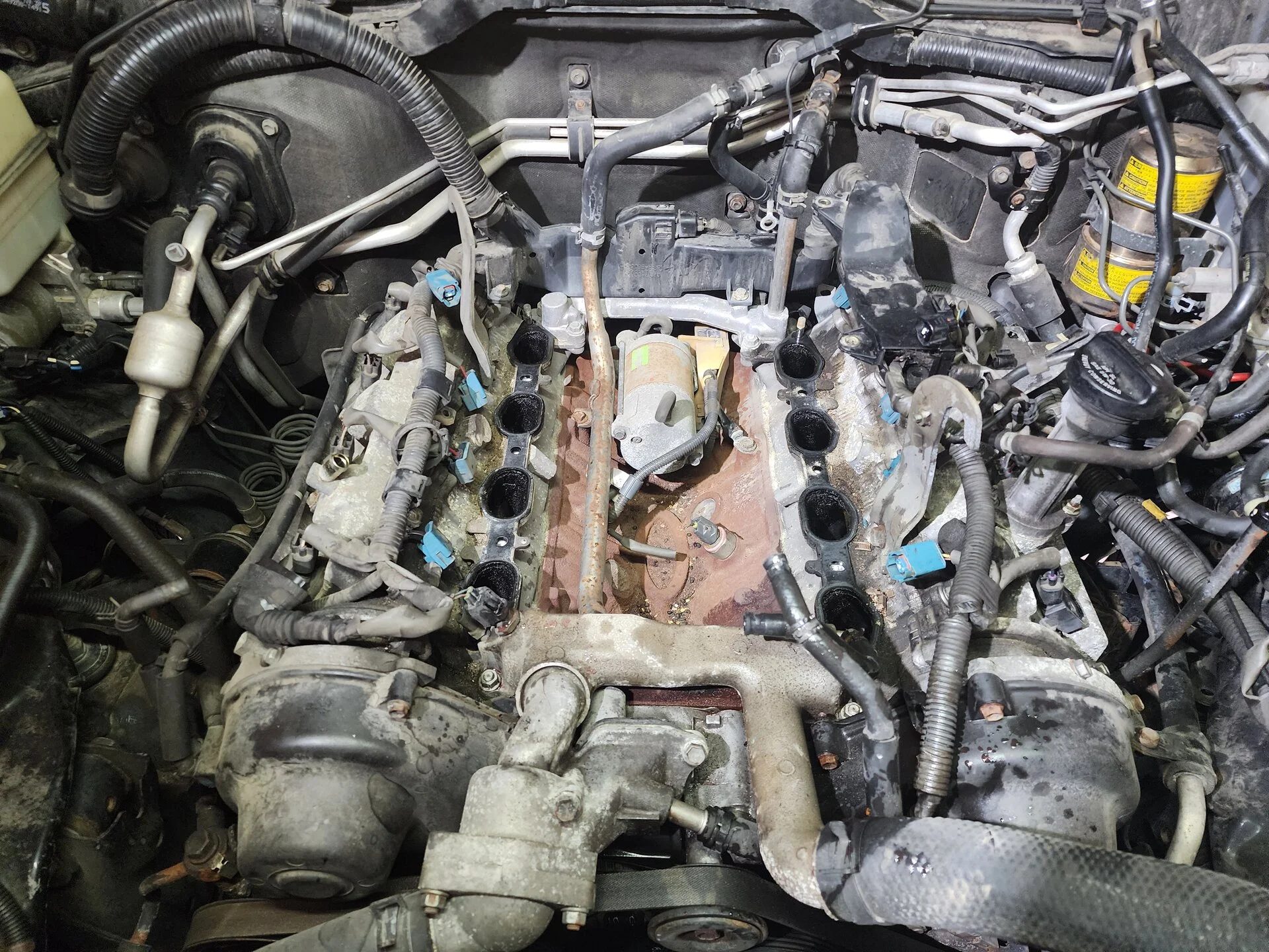

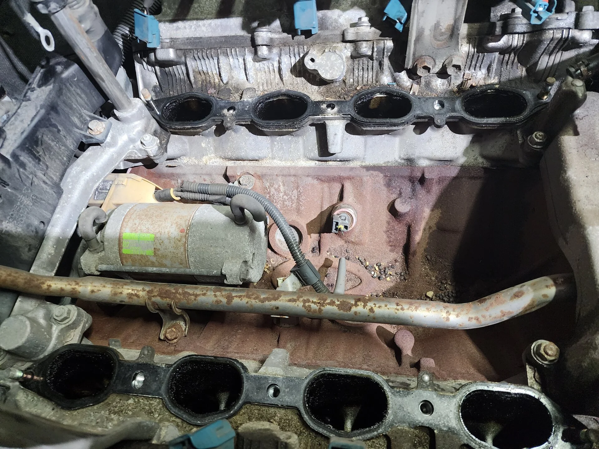

Decided to drop in with and update.
Yesterday morning I decided to get moving on getting this project taken care of, so I set the timer on my phone for 3hrs and I hoped into the engine bay and got on it.
To my suprise, the job wasn't that, I had everything removed, the intake manifold removed from the vehicle, and had the starter out before my timer when off. My advice, since you are going to be all up in the engine, remove the air box, that gives you alot more space to work in. Also, remove the bolts from the power steering pump, because you will need to move that around. Also wear knee pads
-The good:
Removing everything wasn't that bad,
just be prepared for some fuel & coolant leakage when removing some of the lines, and the fuel injector rails. There are also 4 bolts on the rear of the intake manifold holding the fuel line, and a ground wire up. Removing those is kind of a "by feel process" so just becareful. The intake manifold weighs around 20-25lbs.
-The bad:

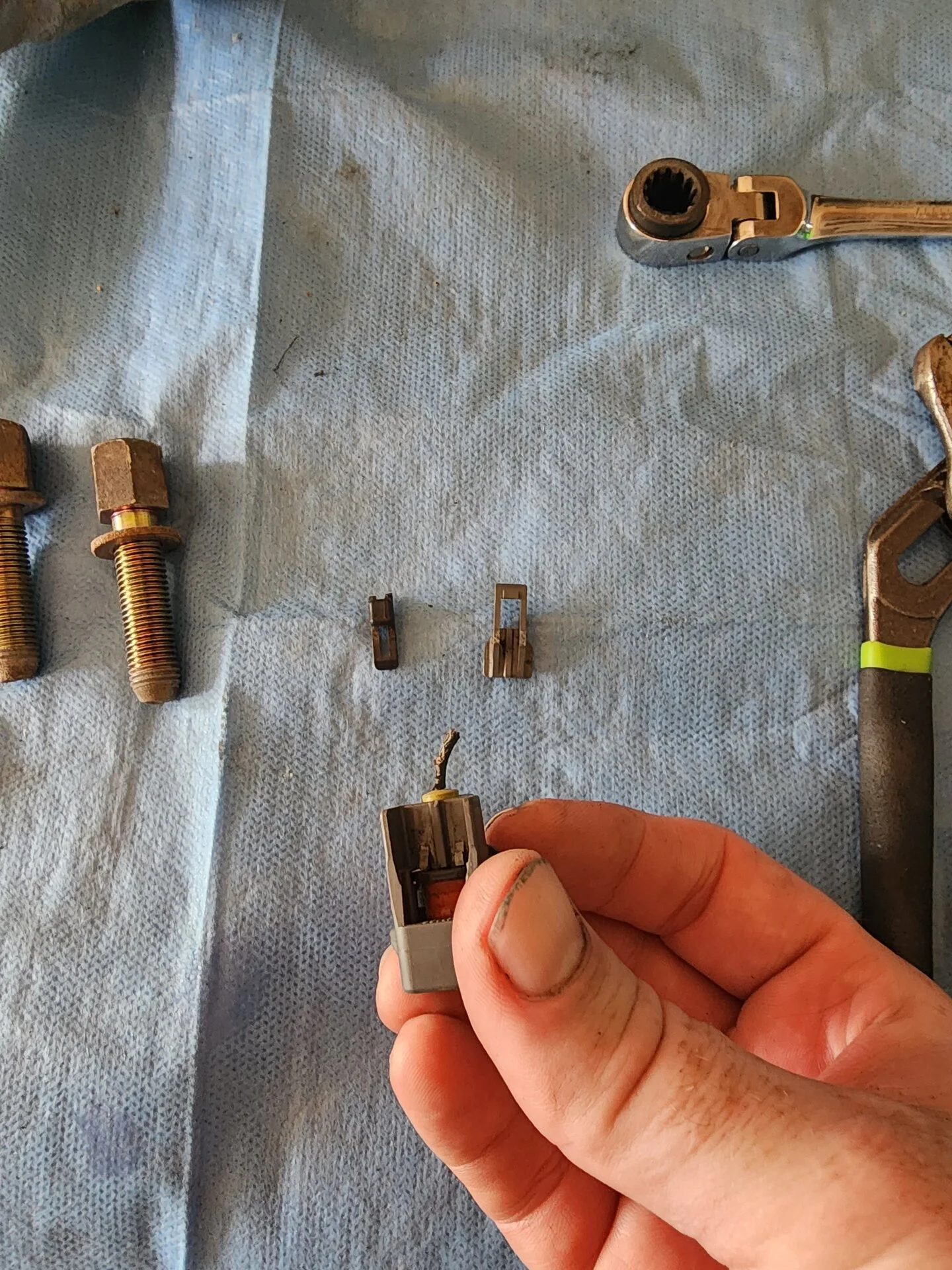

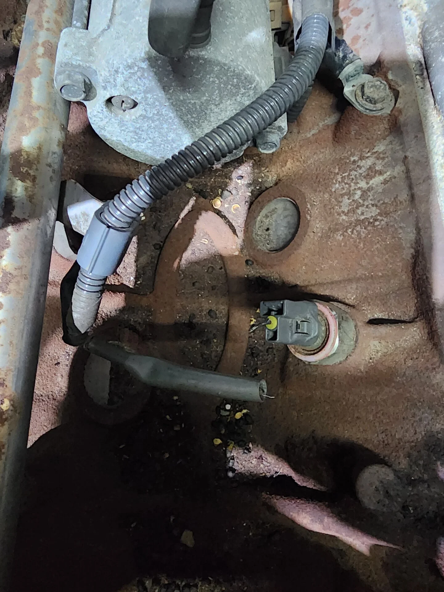

It looks like a rodent was living in here because it chewed thru the wire that goes to the knock sensore. It also left its droppings all over the place in here. Rednexus, you were not lying about the knock sensor connector being fragile, the tab that secure the connector was already broken off. The tab on the starter connector was also, already broken off as well. The good thing about both connectors is that they are still sturdy, and fit on both connections snug, so I'm hoping dropping a dab of silicone on them will keep things secure.
My only problem is, is that I need to find someone who can remove the pin from this knock sensor connector and repin it with some fresh wire, so I can splice it, and solder it back to the original wire. Now it's time to wait for all the parts, and the new starter to be delivered sometime today. In the meantime, I guess I will start the infamous cleaning process

Thanks bro for posting that pic. Unfortunately, that's not a match, but because you posted that, I was able to Google it, and low and behold, my local NAPA has it in stock. I have to swing by there today to order some brake hoses for my 2hundy, b/c Toyota discontinued them??? So I will just order it in store. If you don't mind me asking, is the knock sensor a 26mm, or 28mm deep socket? And by chance, do you have torque specs you can share for the knock sensore, and intake manifold?
I left the knock sensors in place on mine, since just the wiring was the problem. I'm pretty sure that would fix your problem as well, but certainly no harm in replacing them anyway if you have the parts in-hand and have the intake out. The pigtail you posted even comes with the heat-shrink connector! Should be a 10-minute fix.

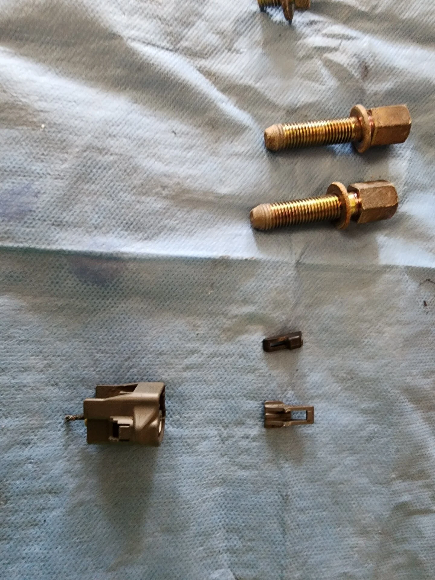

FYI it looks like the non-VVTI engines had a different knock sensor and connector connector than the VVTI motors, hence the difference. For the VVTI motor it's exactly the same as the fuel injector connector.
you can buy the knock sensor connectors from Toyota. I replaced both of mine and the starter plastic connector when I did my starter . here are the part numbers
starter contact plug 90980-11400, also 90980-09585
knock sensor plug 1 90980-11166
knock sensor plug 2 90980-11166

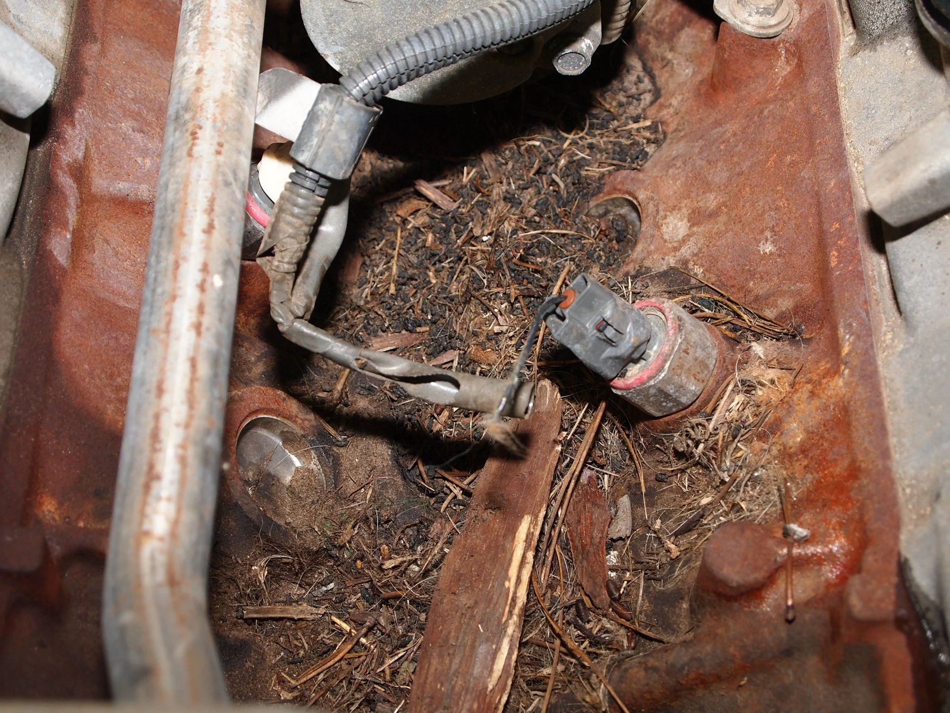

The only times I've seen knock sensor codes, is rodent damaging wire.

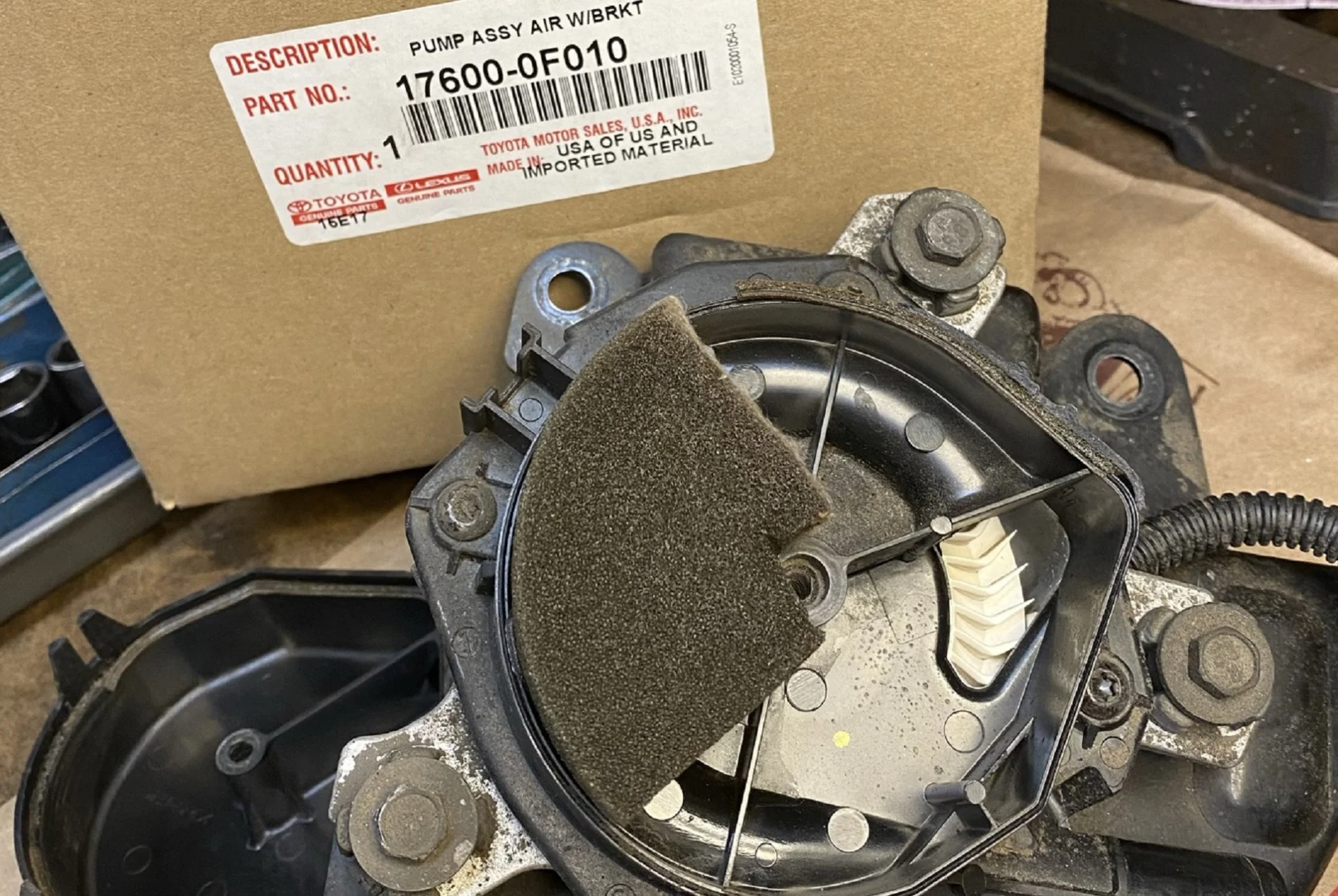

If working on a VVT engine. This is the time to mod the S.A.I. filter.

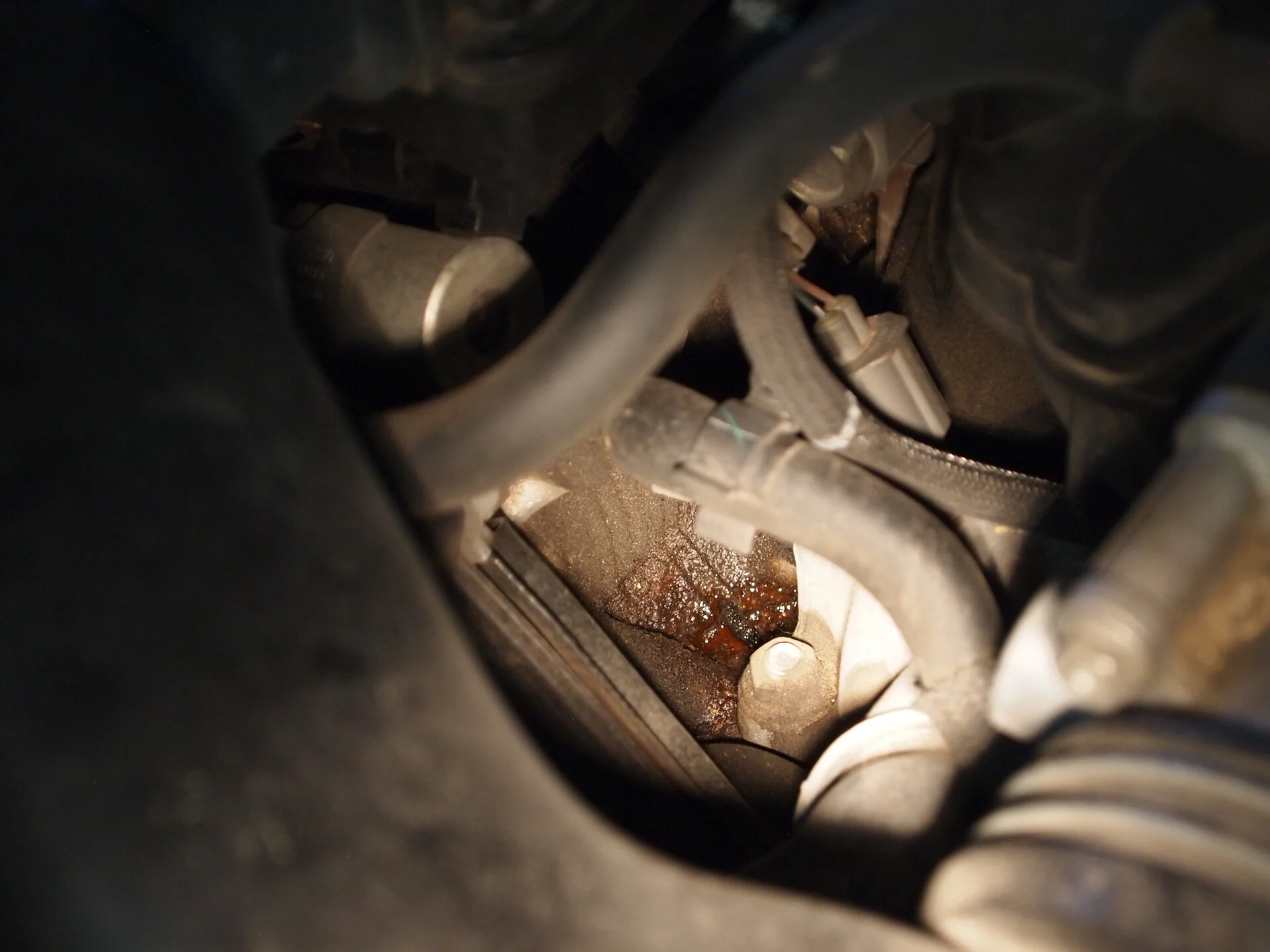

Look for any sign of seepage at front and rear water bypass joints. Any sign, replace the gasket. I've found those gasket in great condition, if no sign of coolant seepage. So I only replace (both banks) I do see signs of seepage.
