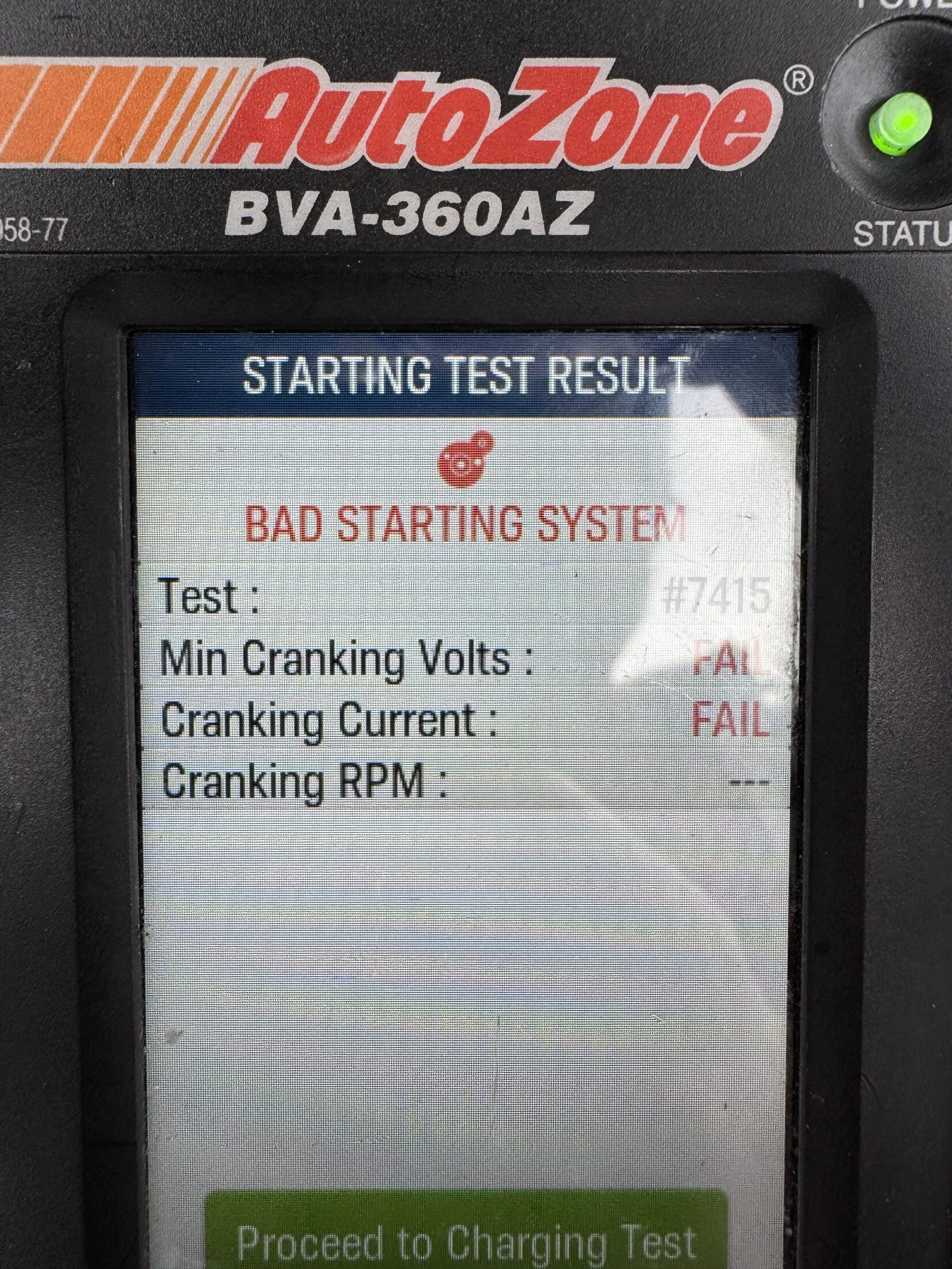

It’s mostly been fine but three times in the past 5-6 weeks it hasn’t fired up the first or even second time. You turn the key and it’ll crank but the engine doesn’t turn over. Took it to autozone to check the battery and their little system says the battery and alternator are fine but the starting system failed for voltage and current.

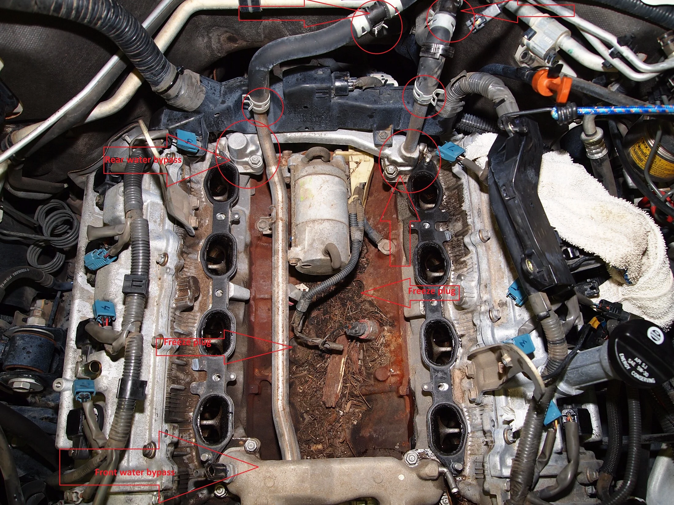

I saw it as an opportunity to refresh the fuel system from the firewall forward. It actually came out looking better than new after cleaning up the valley and replacing water lines. It runs like a new truck now. No more heater-Ts with straight OEM hoses.

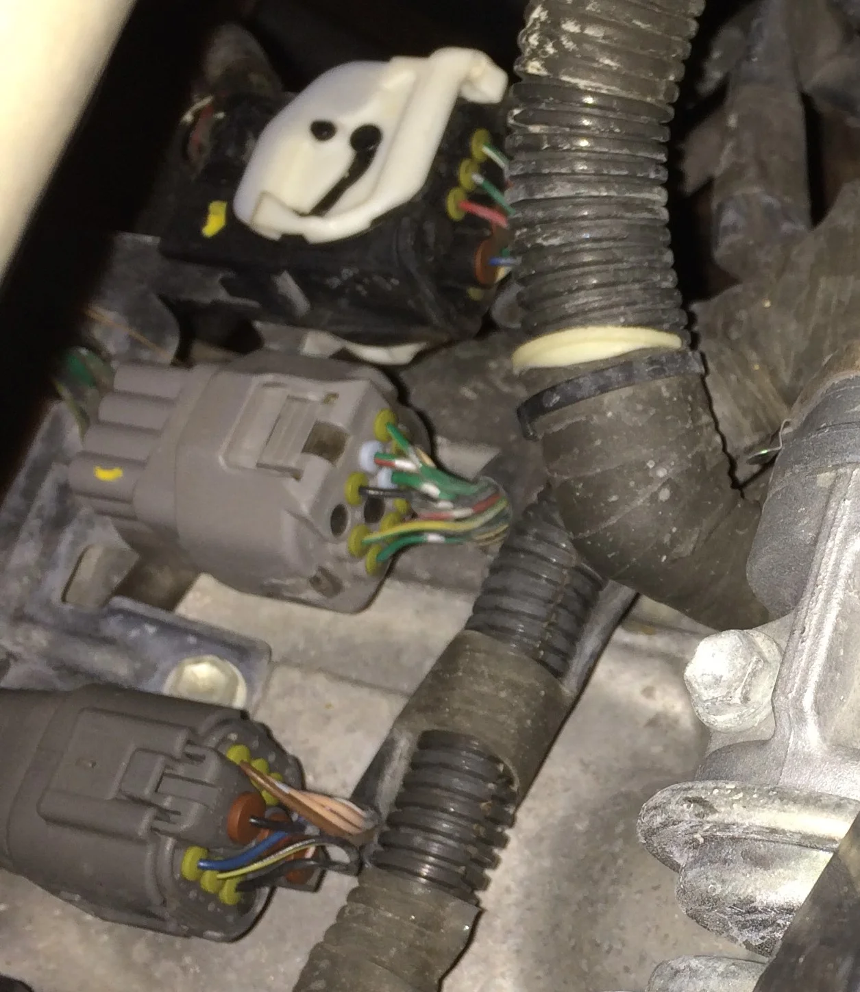

For sure replace the 2 plugs to the knock sensors. I had 6 different plugs break during my diy starter replacement project and all were available at dealer for about $6-$9 each. You’ll be able to identify the part number by looking at the number on the old plug. They depin and repin very easily - i used a dental pick looking tool.

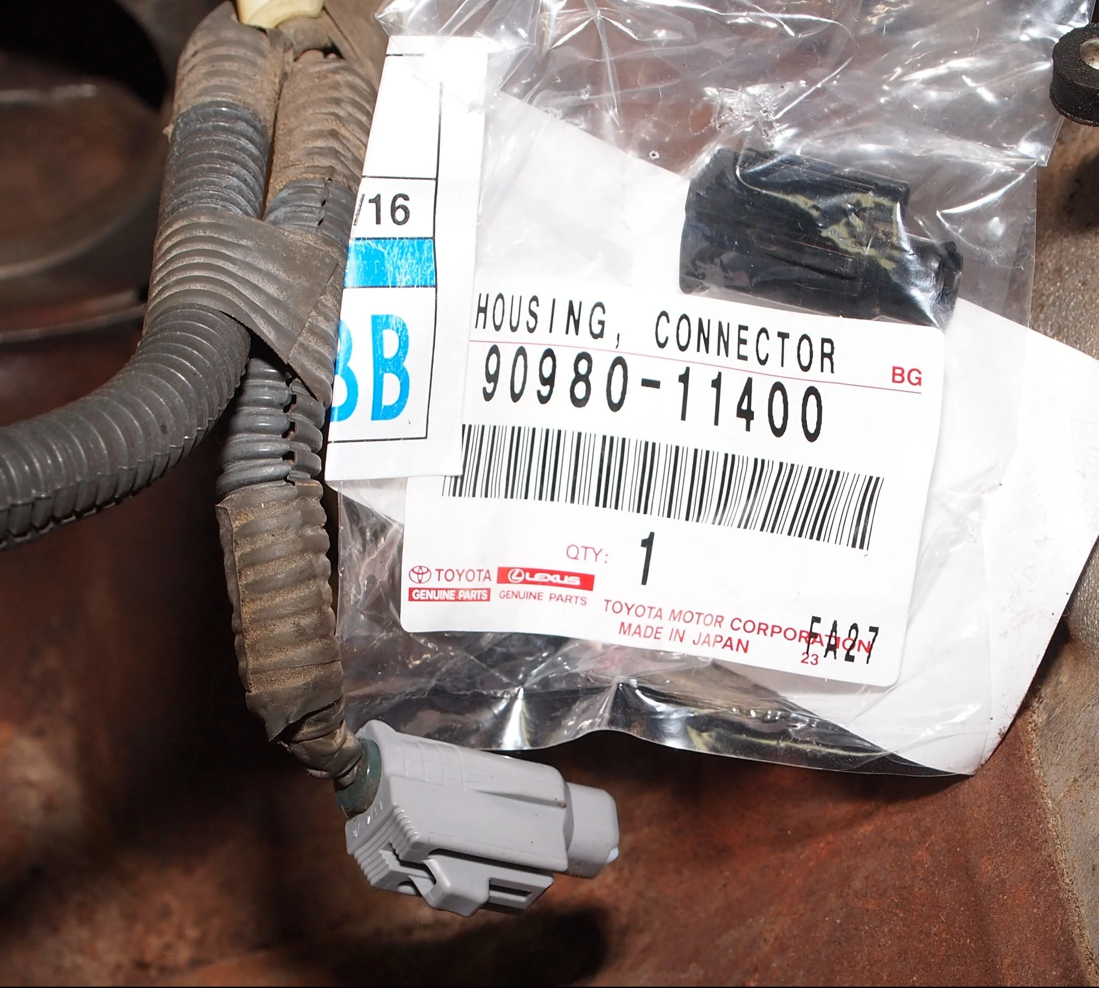

With age/heat, the single wire housing block lock will likely snap. I keep them/these standing by, since 8 out of 10 break:

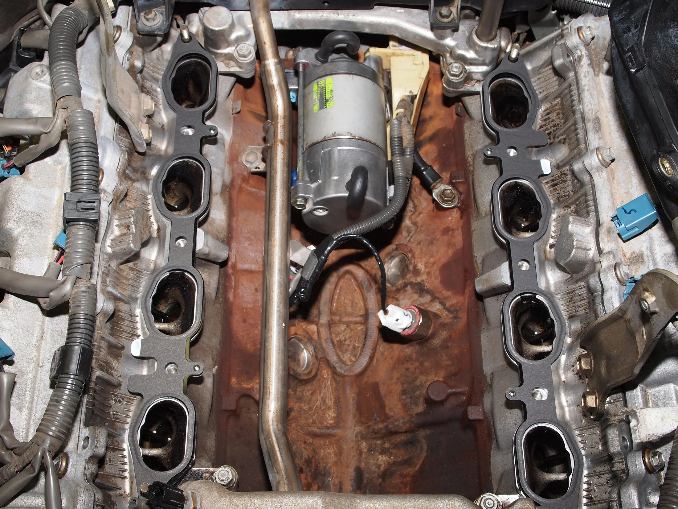

Remember, new OEM intake manifold gasket, white tabs up and use a torque wrench 13ft-lbf working to evenly torque down a little at a time..

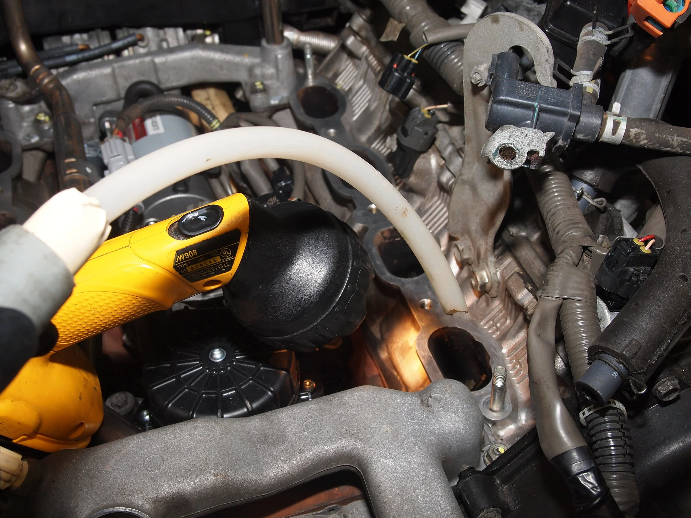

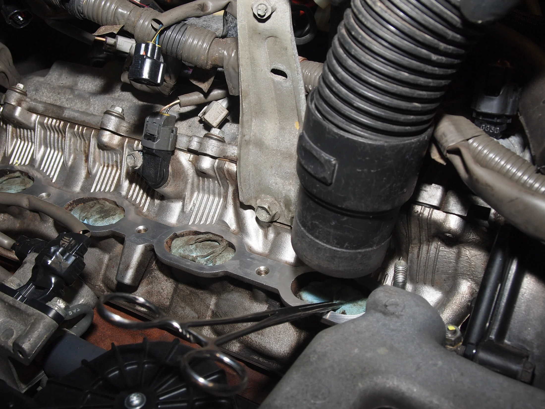

Stuff shop towels in each (8) intake port of head. After cleaning surface, vacuum out shop towels, and any sand from port/valves. Dust/sand can damage valve seals & cylinders.
Pull the one 10mm bolt holding wire harness bracket, that's on top of bell housing. Give extra wiggle room for LH rear starter 14mm bolt R&R.

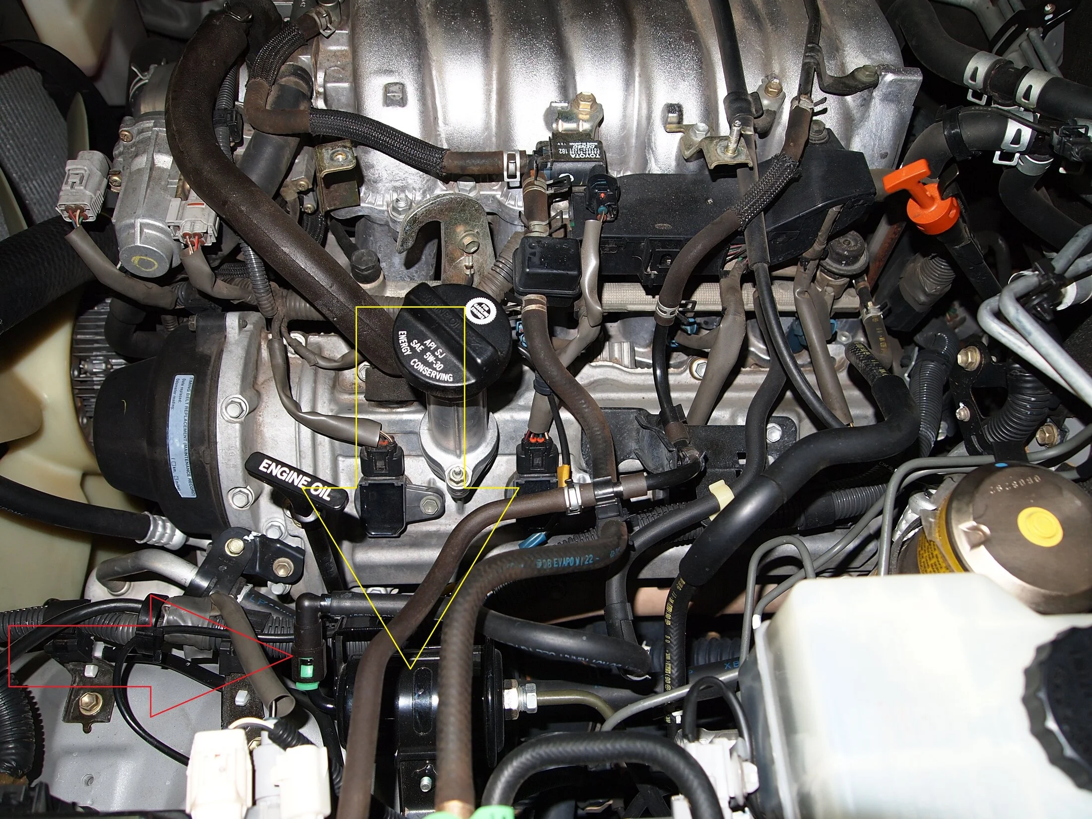

Disconnect fuel line from fuel filter. Snake it out and back in while attached to intake manifold/fuel rail. This save time, and gaskets for dampening devices and banjo on fuel rail. It's best to replace the green pinch locking clip.
Red arrow points, to green locking clip on fuel filter
OH inspect all 4 gaskets of water bypass joints front & rear and pipe (to heater Tee) seal/pressed in point on rear bypass joint. (2 gaskets on each bypass). Any leaking, now's the best time to R&R.
The starter/flywheel/engine cranks every time, but sometimes the engine doesn't fire?
That's not a starter problem.
Hrmmm, well I’m going by what the autozone tester reported but the shop will do its own diagnosis. What else could it be?
Fuel - fuel pump more likely, possibly fuel filter. The starter is either a it's working or not kind of thing. If it's turning over when you turn the key every time, it's working. If it becomes intermittent, then it's the contacts.
I wish I knew more about what this test result actually means - I’m probably putting too much faith in AutoZone
