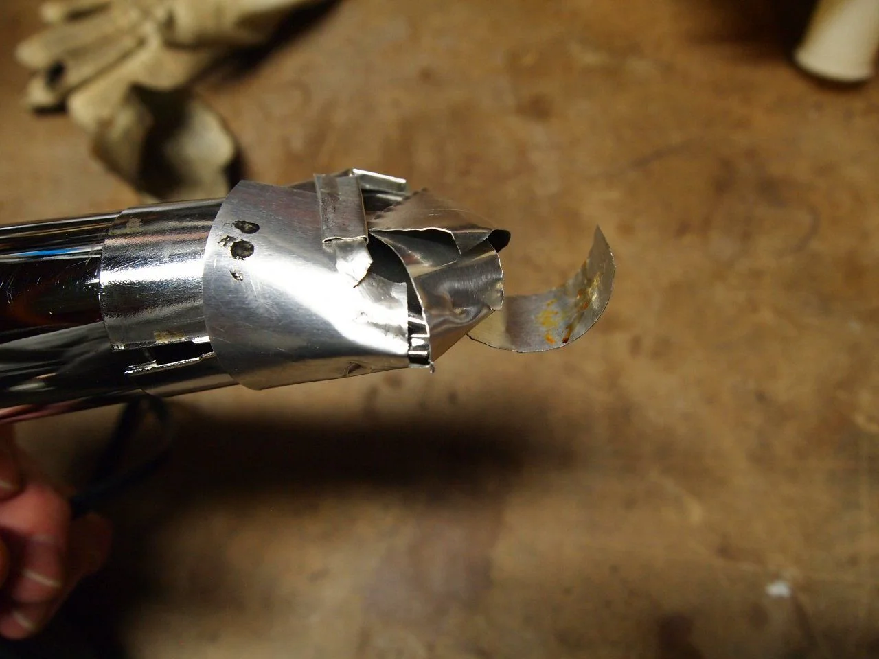

Here's the tools I found in my box, the gun is 1,000 watts. Will they work?
You need a narrow curved reflector to do Solder Sleeves. What you have now will barely have enough concentrated heat to melt and flow the solder, and solder works best with fast heating. I'd check E-Bay for Raychem heat guns, I use a CV-5300 which I think is no longer made.

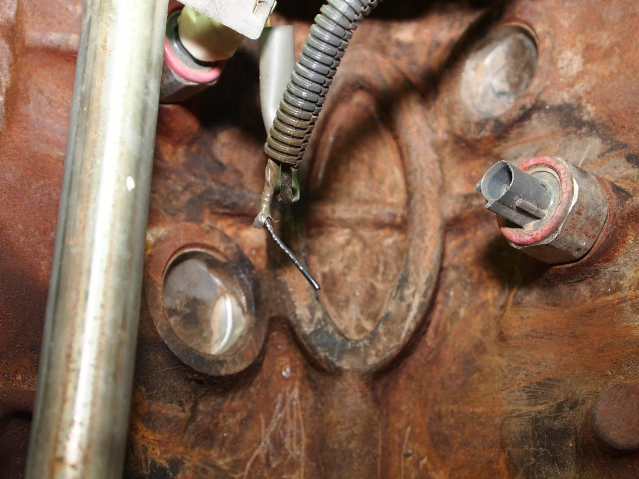

Mickey & Minnie nesting in the engine valley, snacked on the wire(s). With a P0325 (knock sensor #1 bank #1) and a visual inspection. I was able to confirm at least one wire is cut.
I was thinking I'd just splice the wire, possible adding a small section if need be. The I realized this is a very high heat area. How would I go about fixing this?

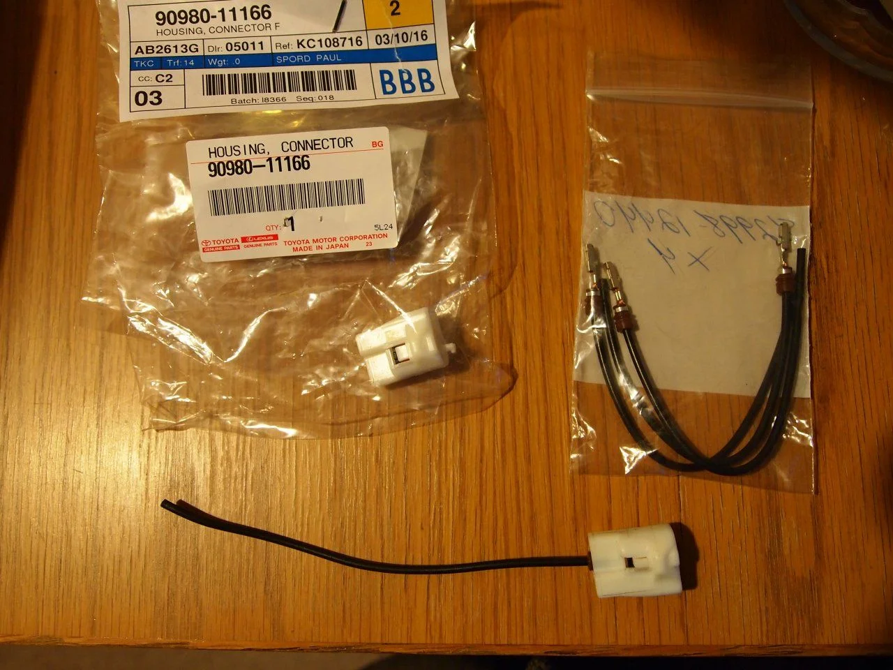

The Dealer has a Knock sensor kit with wires I'll be picking up. They're cool, and will let me take to Grainger for fitment.

I fashioned a home made reflector. Tested it with some thin flux filled solder I had lying around. Don't know this solder melting point, but it liquefied in 3 seconds. So I'll run some test splices when I get the package of Raychem cwt's, I may get lucky.

Sorry...about 3-4 seconds to melt the solder and maybe that much time finishing shrinking the ends of the splice...though your reflector might do it all at once...I like the shadetree engineering. ;)

UH OH problem. The Dealer kit (clip & wire) has a 20AWG wire, and the knock sensor wire harness is 30AWG (possible 31AWG). The Raychem cwt-9002 are for 22-18. Now what do I do?
The old knock sensor clip is very brittle and is not reusable?

Can you take pictures of the harness on the vehicle. Is it a bigger cable or just screened. I cant really picture in my head what your trying to achieve, what it looks like is you have replacement connectors, the connectors get cut of the existing harness on the truck and new get soldered in place, if im looking at it right.
The issue is the difference in wire size is so vast it exceed the butt splicers limitation. I really like the design of the Raychem Soldergrip heat-shrink Butt Splices, and would like to use. My concern is the small factory wire (30AWG OD) will not hold in the Raychem 22-18AWG.

With that large a difference in AWG size, I'd skip the connector and do a direct solder splice, using 2 layers of heat-shrink tubing (first layer small and second layer larger) with an outer shell of abrasion protection like wire loom.

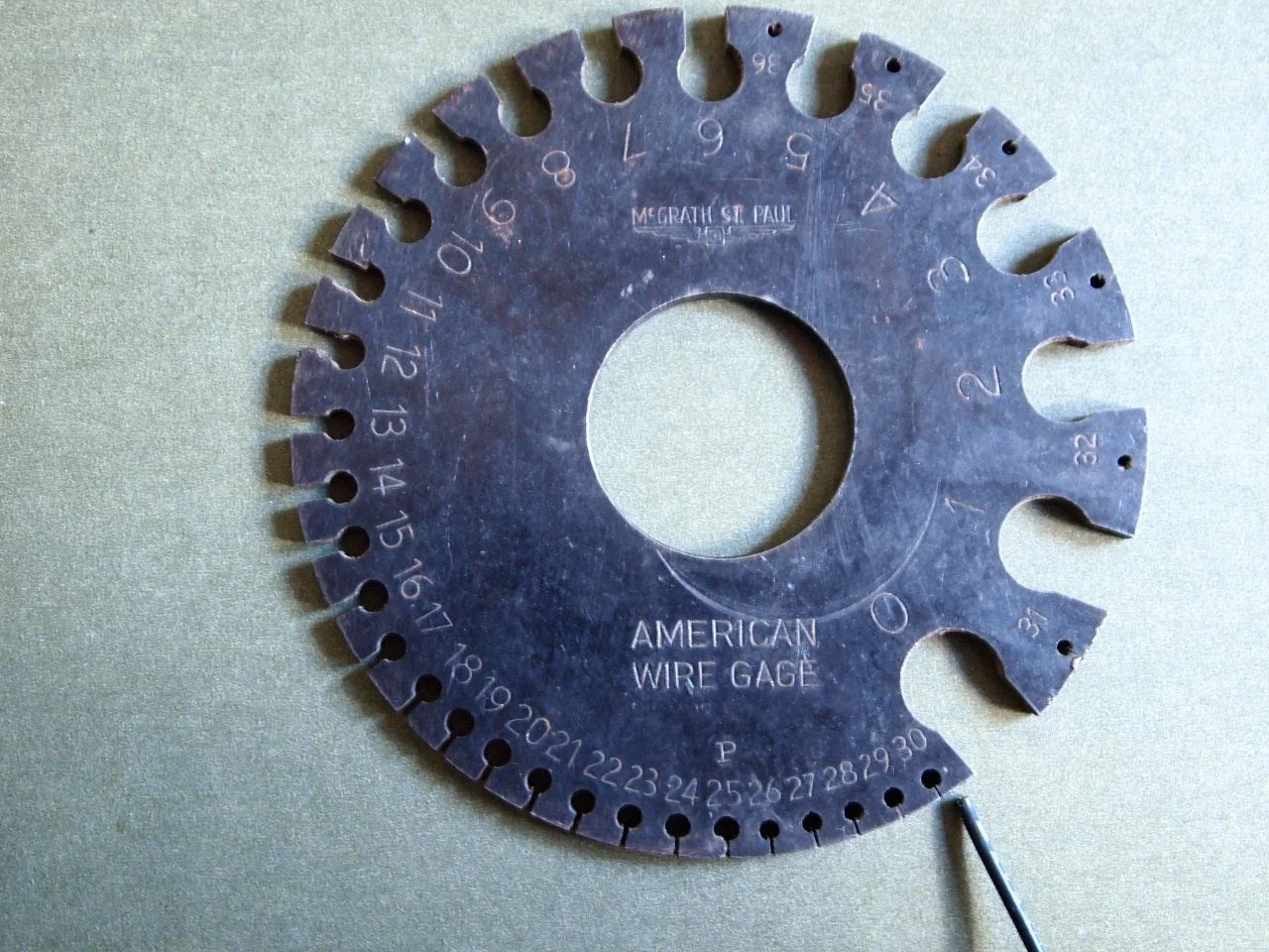

Try the raychem on the old connector cable. The solder will hold anyway, its just if the heat shrink will go small enough. So 30 awg is smaller than 20, confusing.
Yes the higher the number the smaller.
I'm amazed at some of the stuff I find in my tool box sometimes. This AWG gauge must be 50 years old.

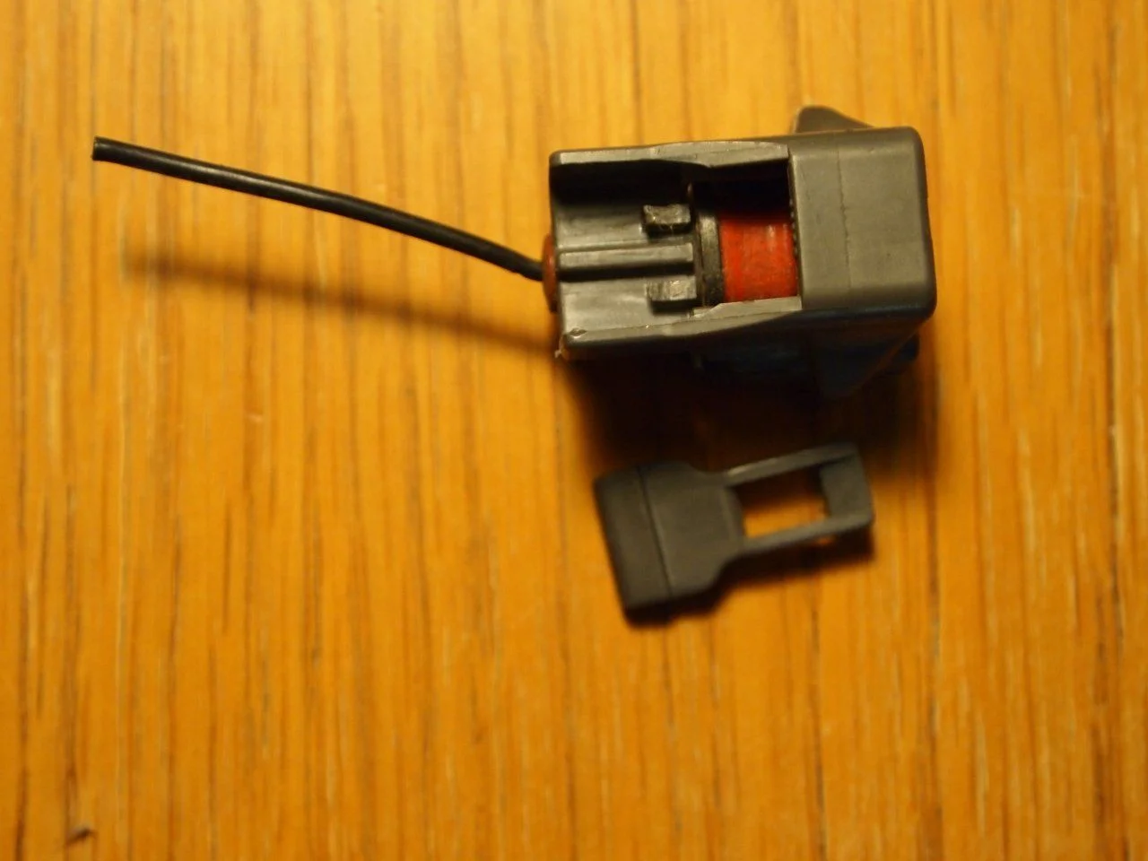

I noticed the Dealer gave me two of these white connectors. Connected to the knock sensors are white for right bank and gray for left. So I assume the ECU needs to know which is which. Wish I not put it together. I was just seeing how it worked with lead, when they clicked in....darn. This puppies are pricey, connector list at $7.33 and lead's at $7.21.
As long as it fits on the knock sensor, just put a grey dot on the connector with permanent pen or something.
Good idea. I guess it's not a big deal, as long as I do any work in this area in future. If for some reason I don't get it done today. I'll call my parts guy and see if they make a gray. Oh BTW I did just manager to separate the new wire form connector, one small victory. It will help to allow me to slide heat-shrink wrap on after splicing wires. There's not much area to work with to keep heat away from wrap while splicing, so this will be handy. I've been trying to get the other old connecter off right bank knock sensor, but the clip is frozen like left bank was. It may be packed with Mickey & Minnie leftover or just getting brittle with time & heat.
