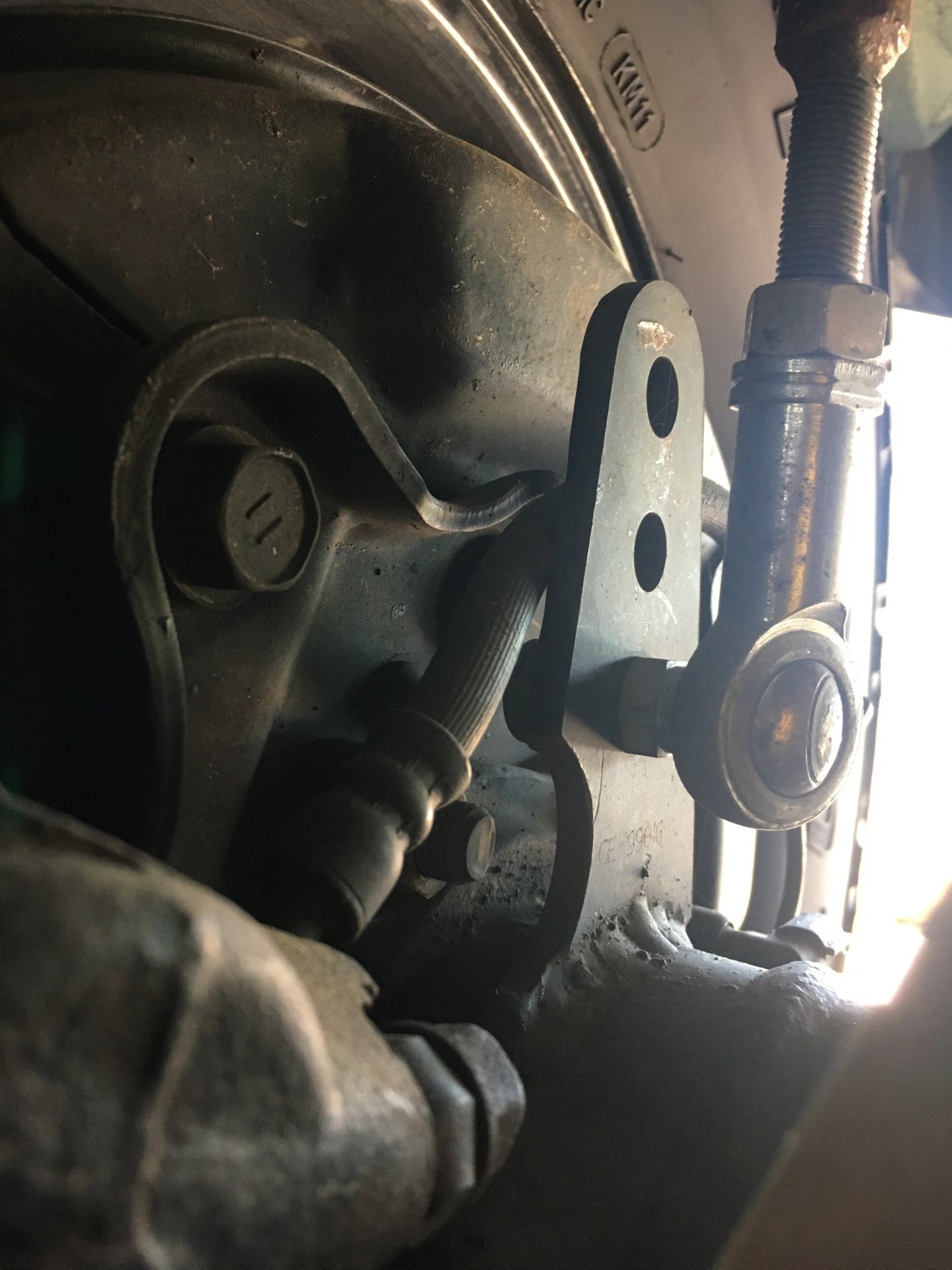

How did you arrive at the position of the axle mount tabs? I’m thinking the link is best vertical at static ride height. The angle would actually increase the amount of force required to move the arm up or down.
I also think they should be vertical at ride height, At full droop they could invert themselves.

During full articulation is that tab and bolt going to clear the Bump stop ?
I like the antirock setup! Yea, I agree with @Broski I would make sure to check it in few scenarios at full extension/stuff and extension/extension to make sure the links don't need to be adjusted longer. I've seen how the sway bar can get inverted when fully drooped on jeeps with this type of setup.
Yea I'm going to my buddies shop in the next few days to use his forklift and flex it out. Hoping it works. Worst case is I plasma it off anf reweld the tabs

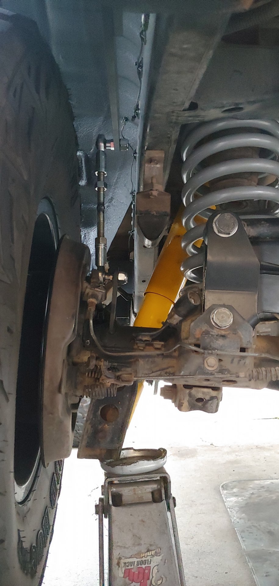

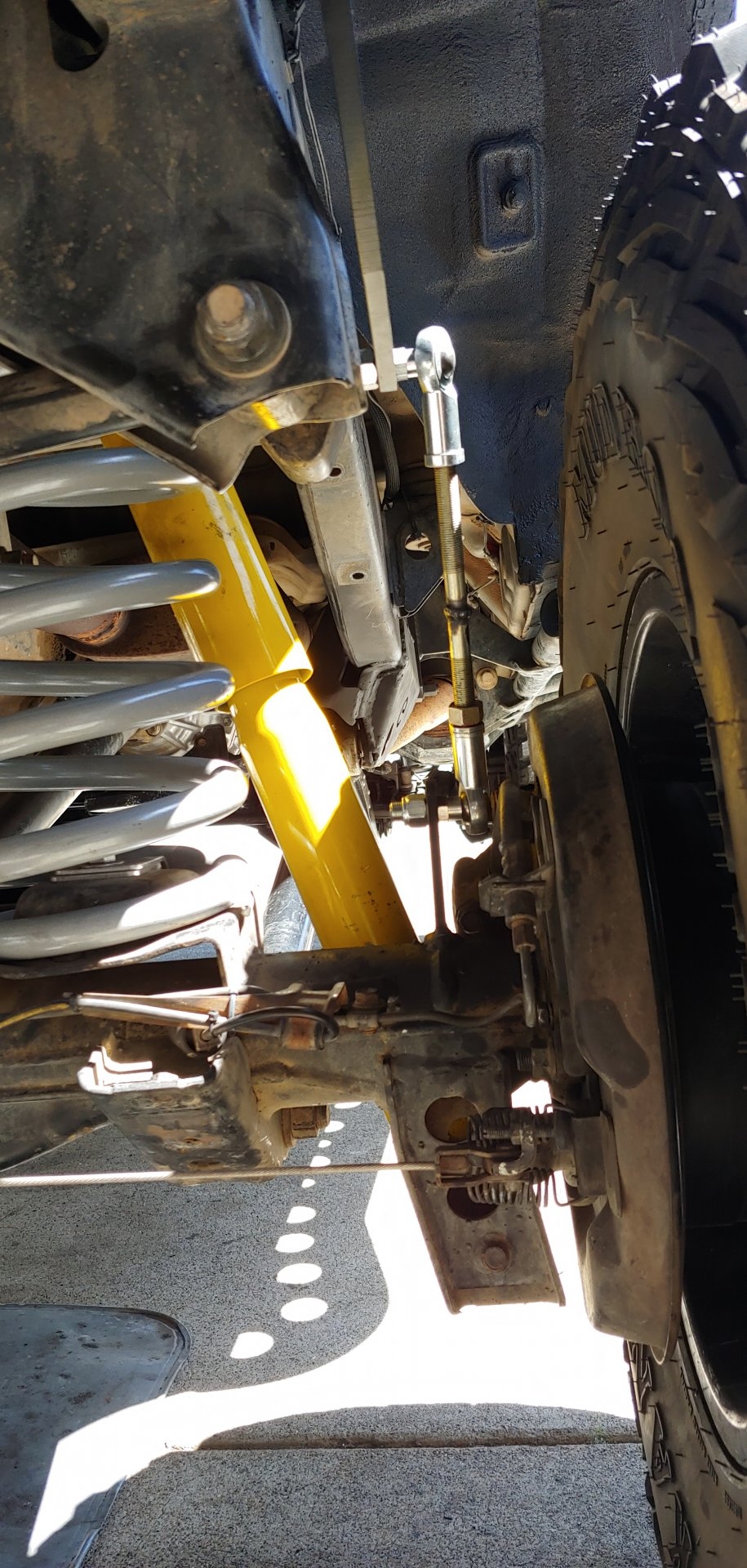

Edit. Quick hilift droop test. Still going to a fork lift test. But so far no inverted arm issues.
Edit2.... Now looking at the pics more closely. The Dobi yellow 4-5s are max droop. If I'm planning to keep the slee4+30mm I'm now thinking of buying Dobin yellow 6s. That should give me 1 more inch of down but less up travel. Hmmmmmm
That swaybar link looks tricky. Very close to flipping over backwards which could happen under rough movement.
Regarding the shocks, rather than get new ones, have you thought about simply relocating the lower mount a few inches up? Bypass the pin mount and use a standard shock bracket. Get more use out of your shock without having to go to a longer length.
I dont think the links would invert. But I'm not sure either. The axle tab was rotated forward towars the engine.Not back toward the tail
I'll fork lift flex it and drive the forklift backwards and dump it hard on the ground.
Worst case is I plasma it off the weld straight up. Will need to cut the link and shorten the threads again
I'm tired of working on this thing everyday. Sigh.
Cut off the stupid axle mounts with the plasma. That was easy. Grinding it was not and sucked.
Repositioned them at 12 oclock and burned it in.

I look at @pvhobo pictures and wondered why he welded the tab so close to the backing plates, then I removed the springs so I could cycle the axle sure enough during full articulation the lower heim joint well hit the bump stop if it not right next to the backing plate.
Hopefully the bolt on your is going to clear, It looks close 🤷‍♂️
