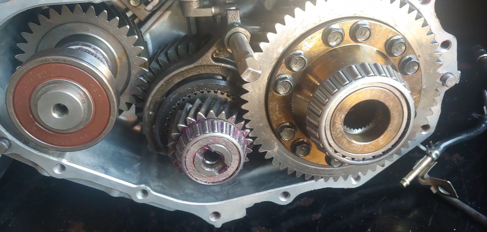

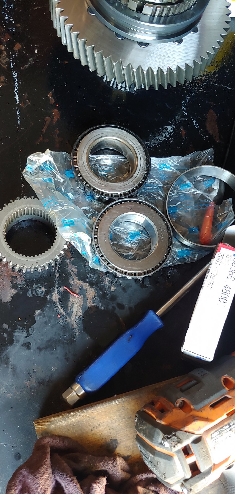

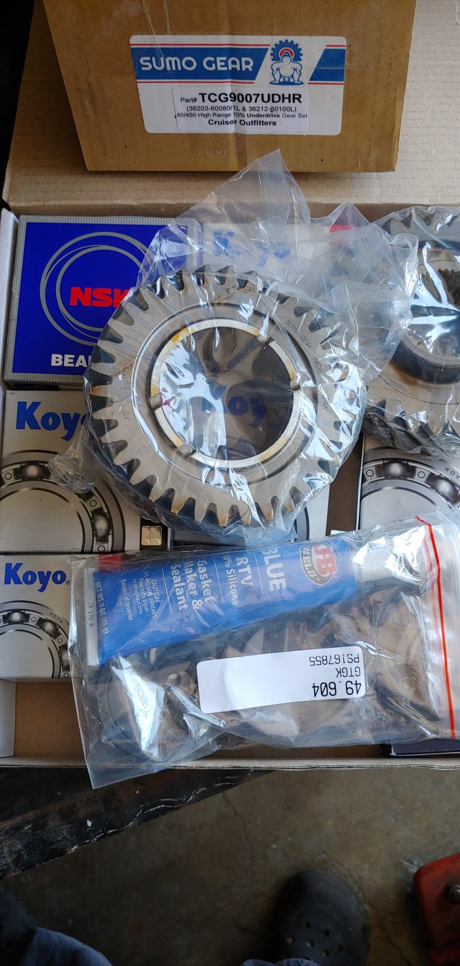

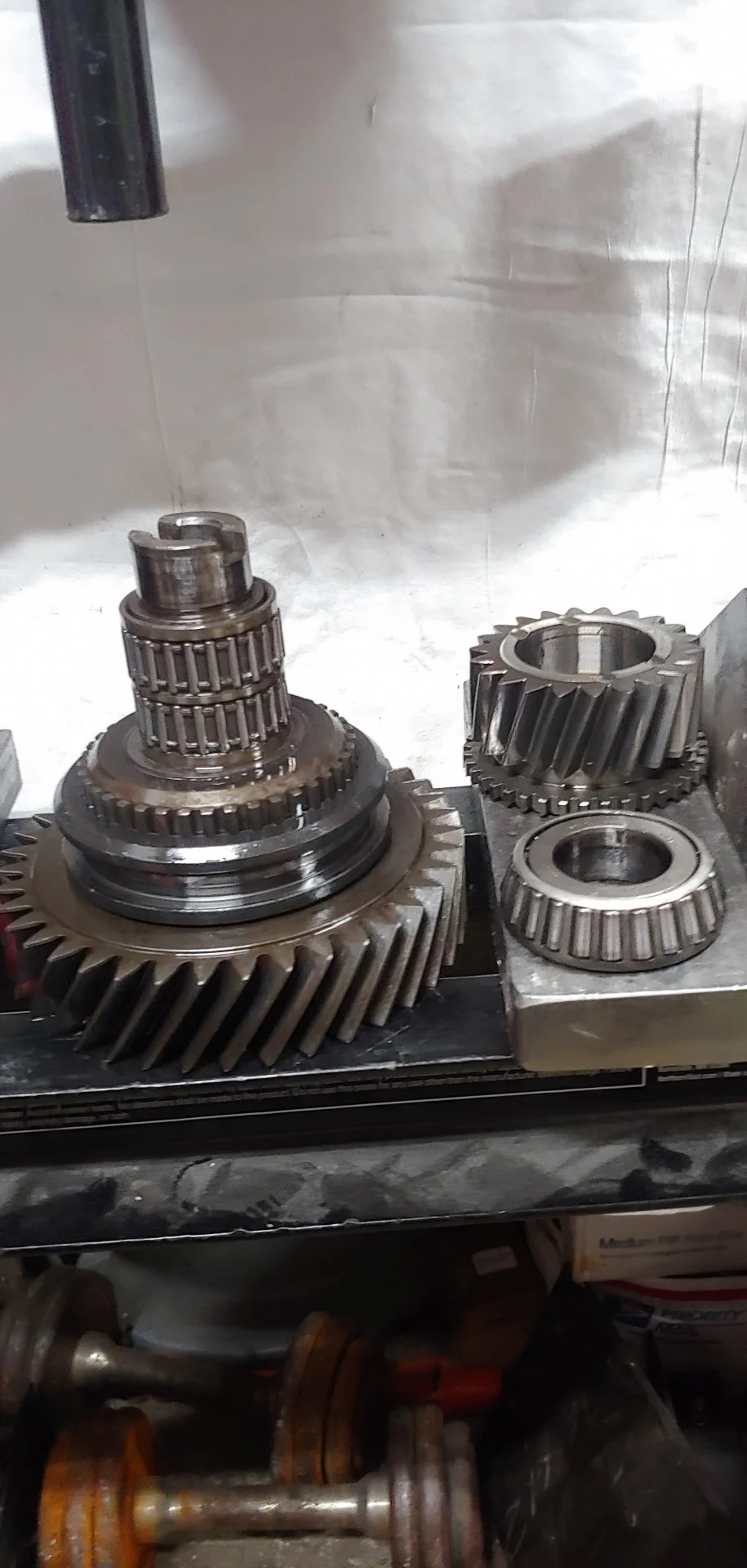

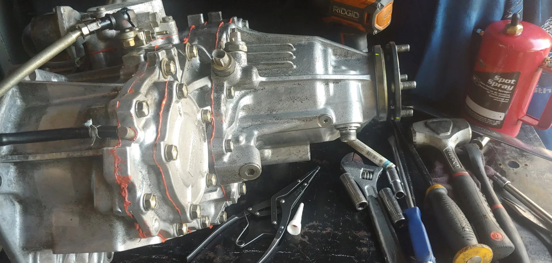

Sumo under drive and brand new tcase rebuild kit. These bearings are stupid expensive.

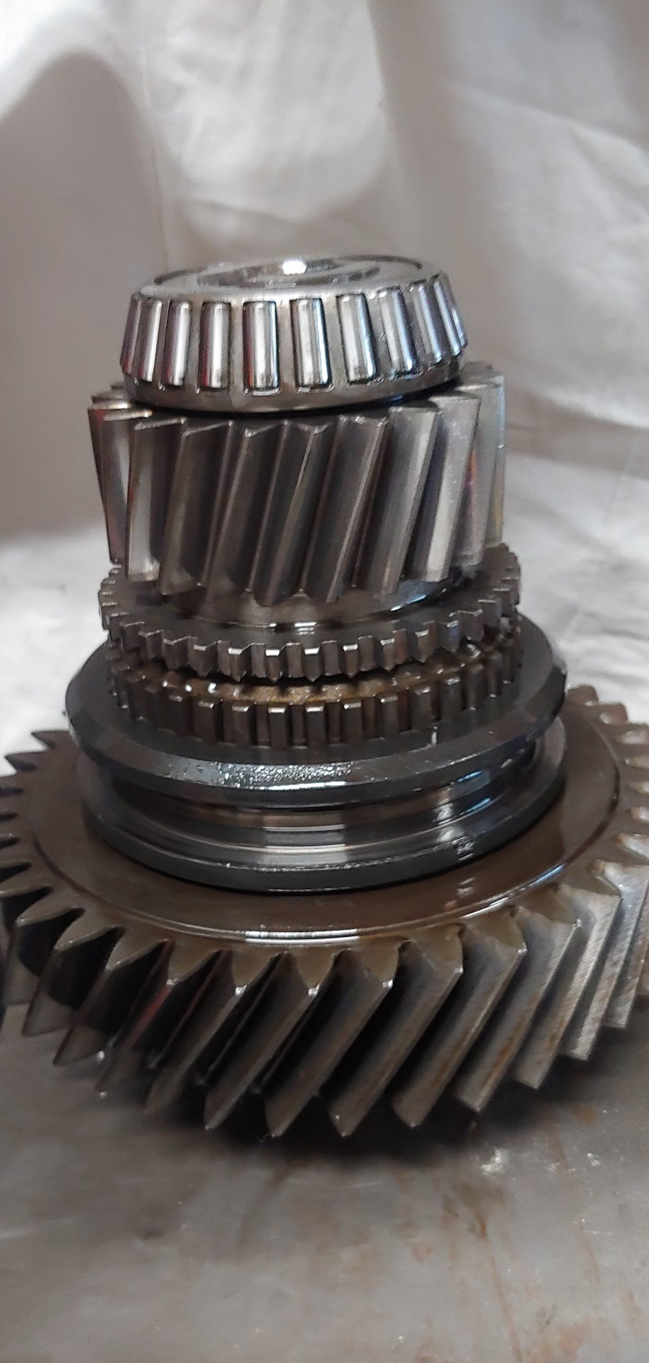

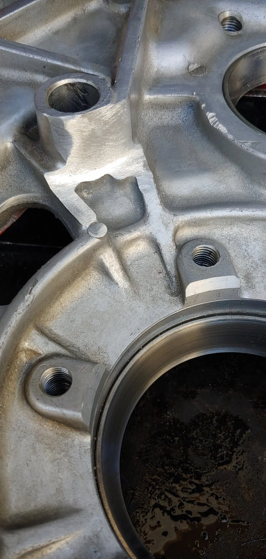

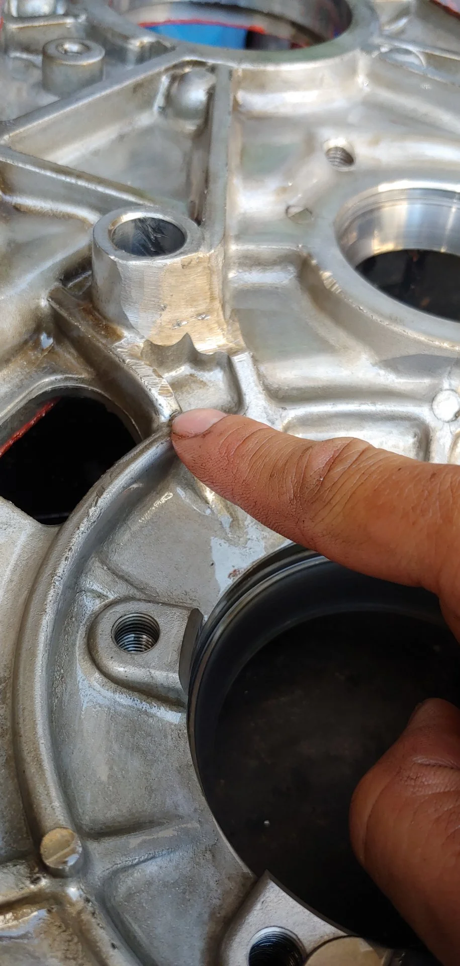

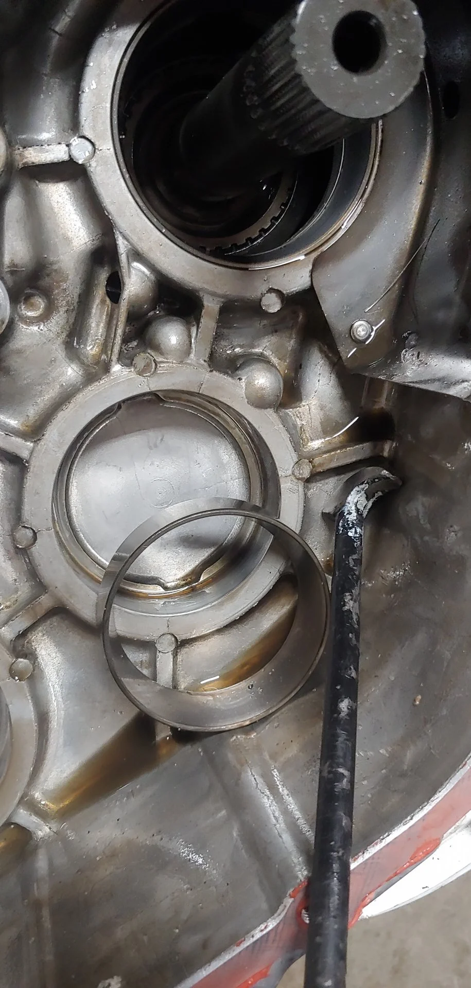

Going into my lowrange and PT tcase. Found out that whoever did the tcase grinding. Did not take nearly enough material off the housing. I took way more off and now it spins freely. I thought it was the bearings making the weird noise on release of throttle so I bought all new bearings. Turns out it was the gear contacting the case. These bearings are probably 250k+ and look and feel like crap anyway.

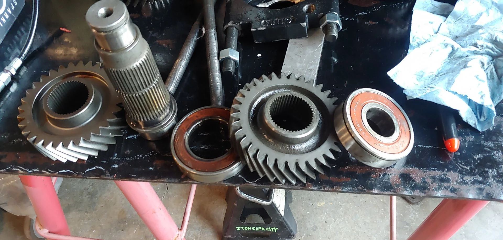

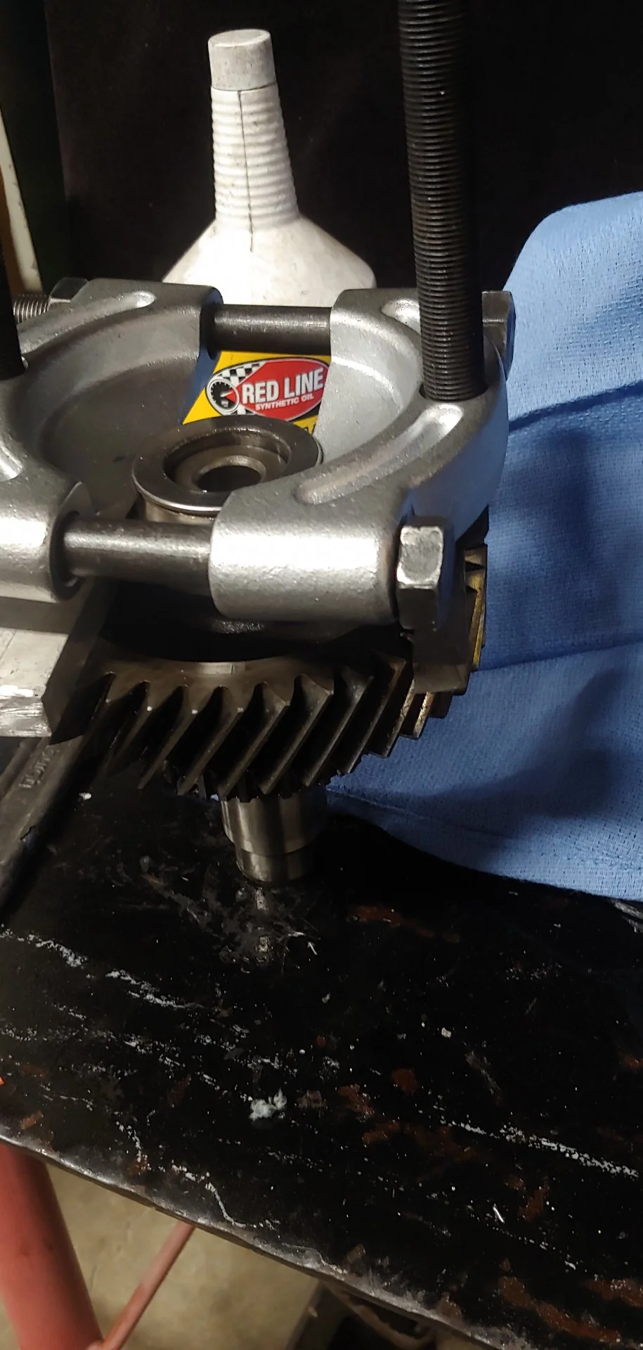

Day 2 tcase cause I needed to borrow a different puller from AutoZone. It didnt work out of the box. So I took apart my HF puller arms and used the longer arms with the skinny AutoZone body. I was able to pull the rear gear from the output shaft housing.

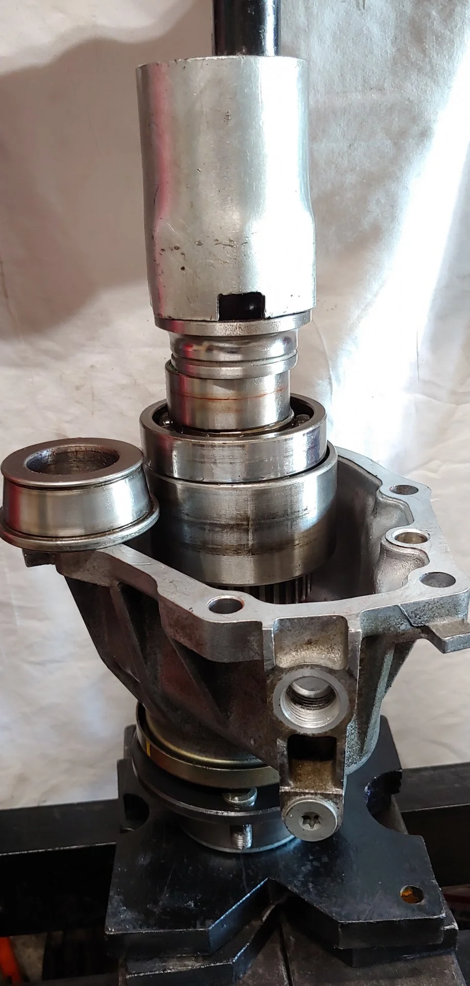

Always!!!! Keep old bearings and races. You never know when you need to stack up a crazy jenga puzzle to press s*** in!

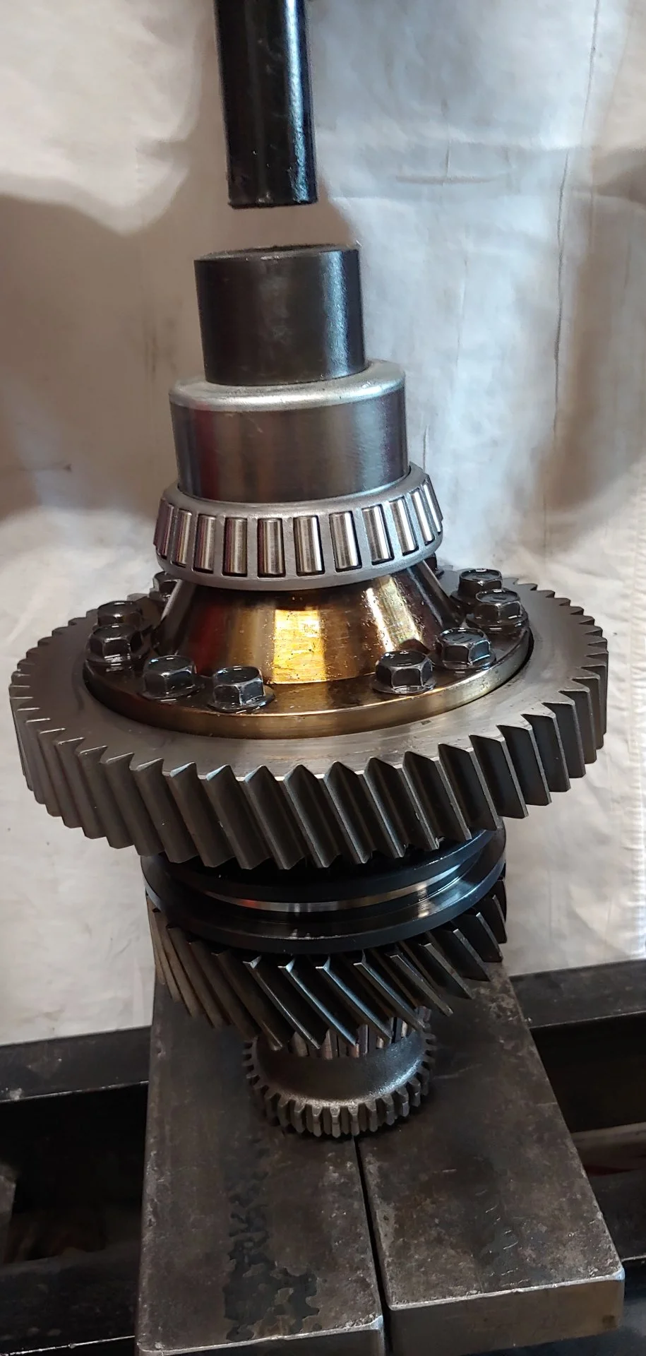

Everythings back together and waiting for the red FIPG to setup so I can stab it in tomorrow.
Now I have brand new Sumo Under Drive gears, fully rebuilt bearings and seals ($500 poorer), Marlin Low Range Gears and Marlin Part time spool.
