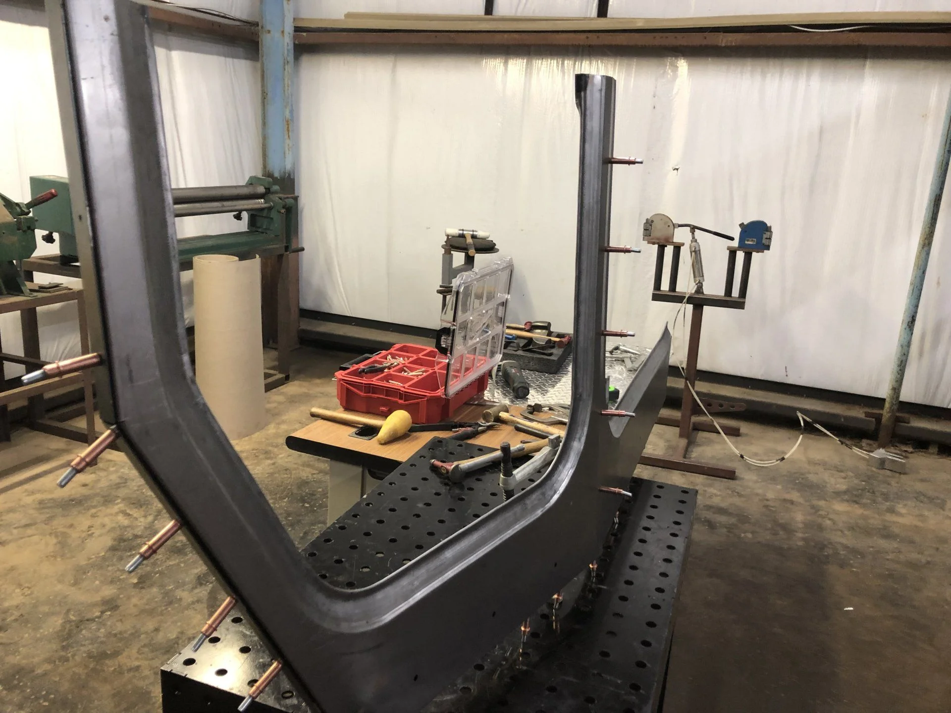

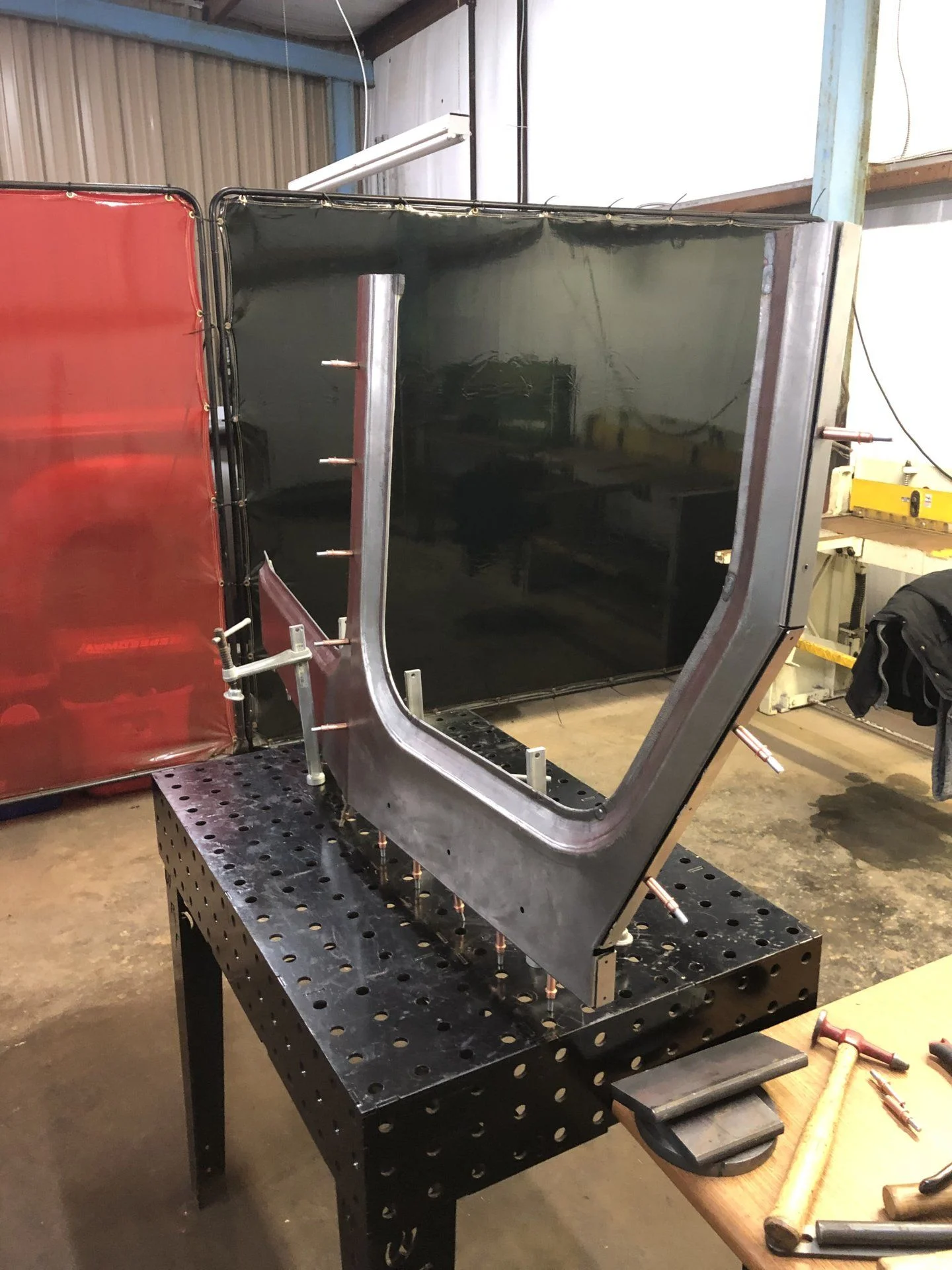

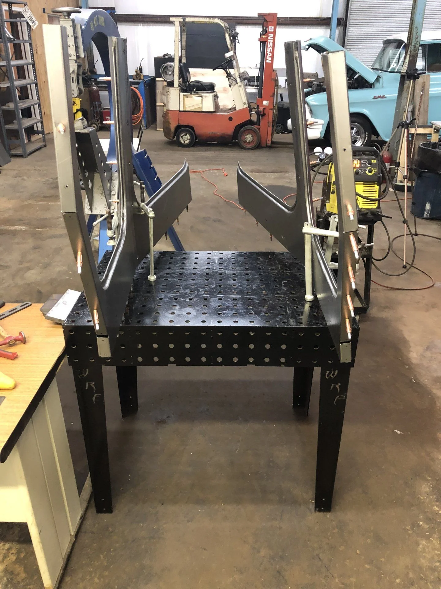

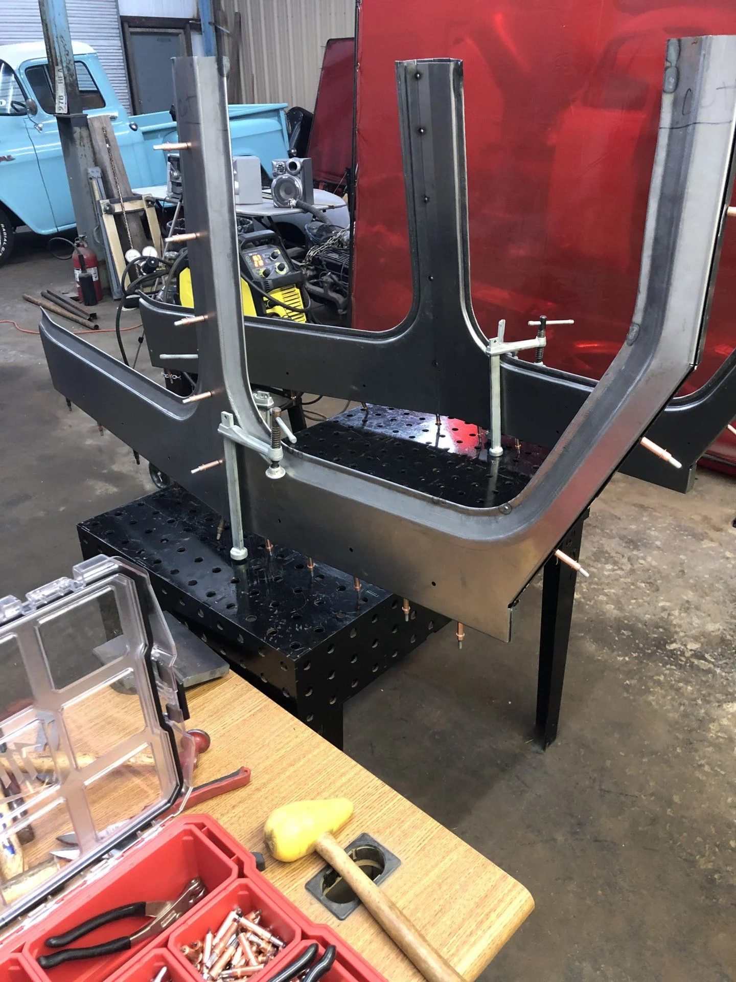

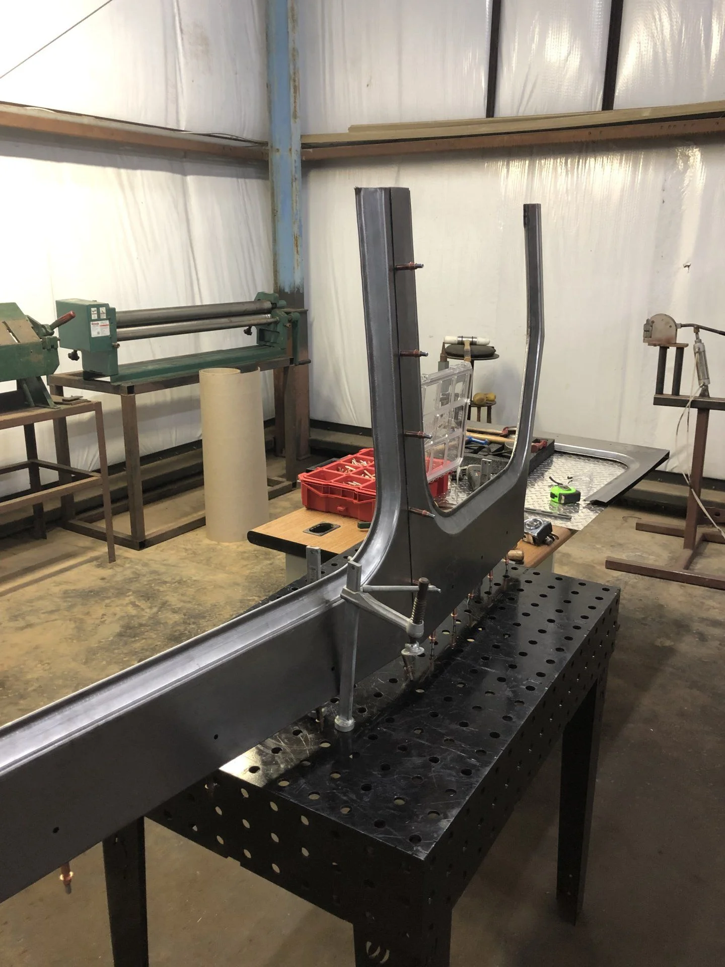

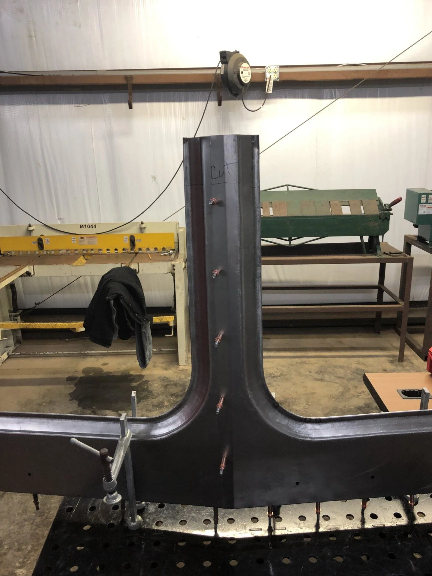

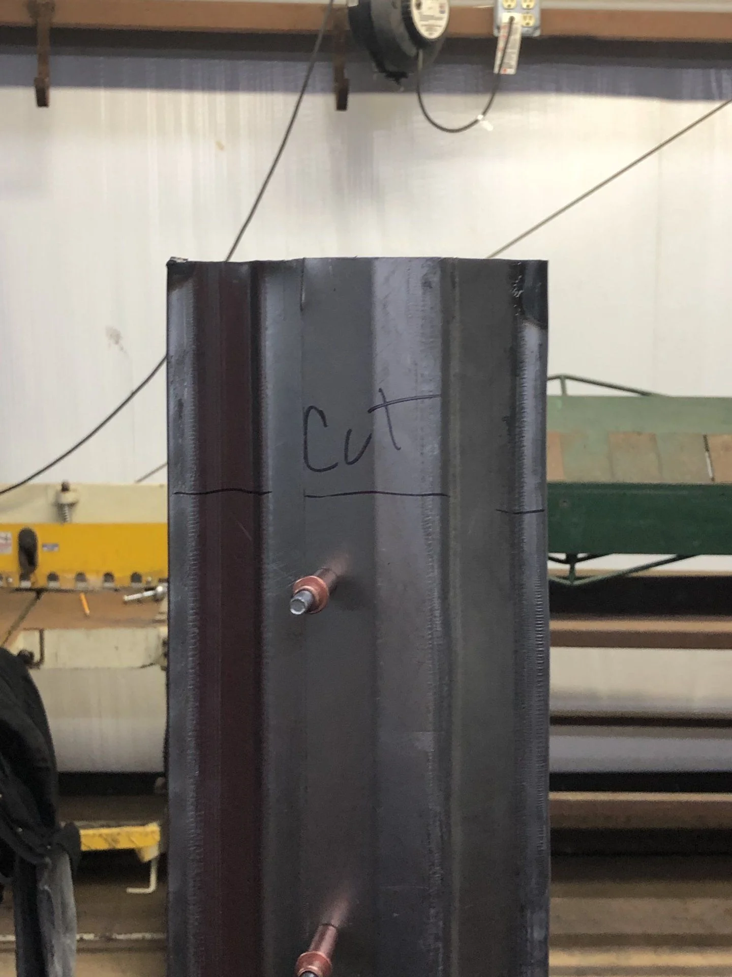

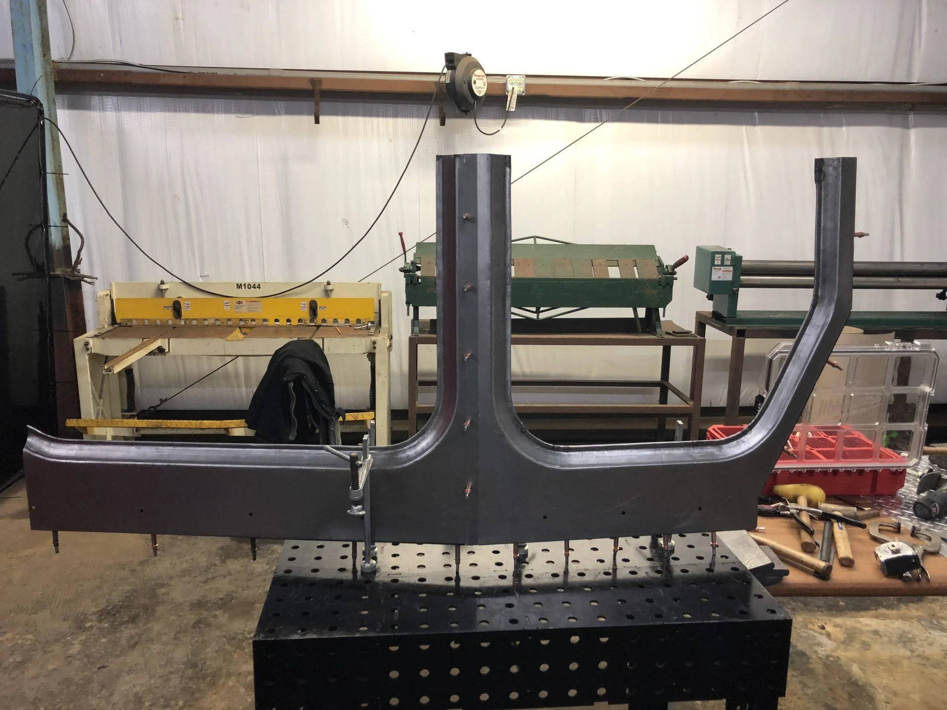

Pretty excited. After a long days work I came back to the shop after eating, I think I work to much, and finished getting the door opening finished. I finished rolling the edge over in the pinch seam then I attached the doors openings to each other and tack welded them in the back. Let me tell you, rolling 16 ga cold rolled is a mans job, Its strong as hell and hard to work after it get work hardened. Now all that’s left is to finish welding these up permanently and then I can attach these to the tub.

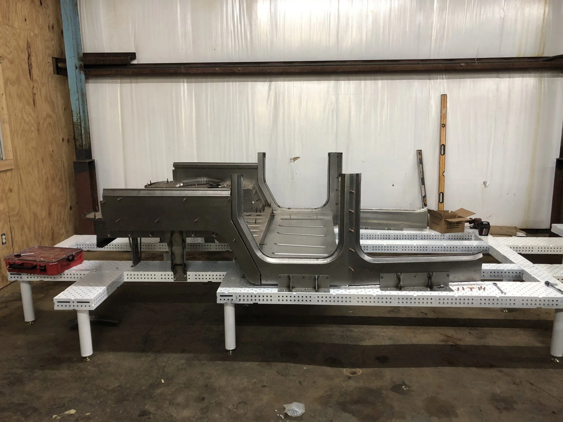

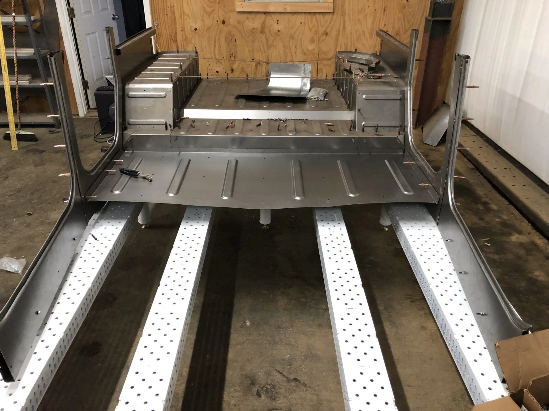

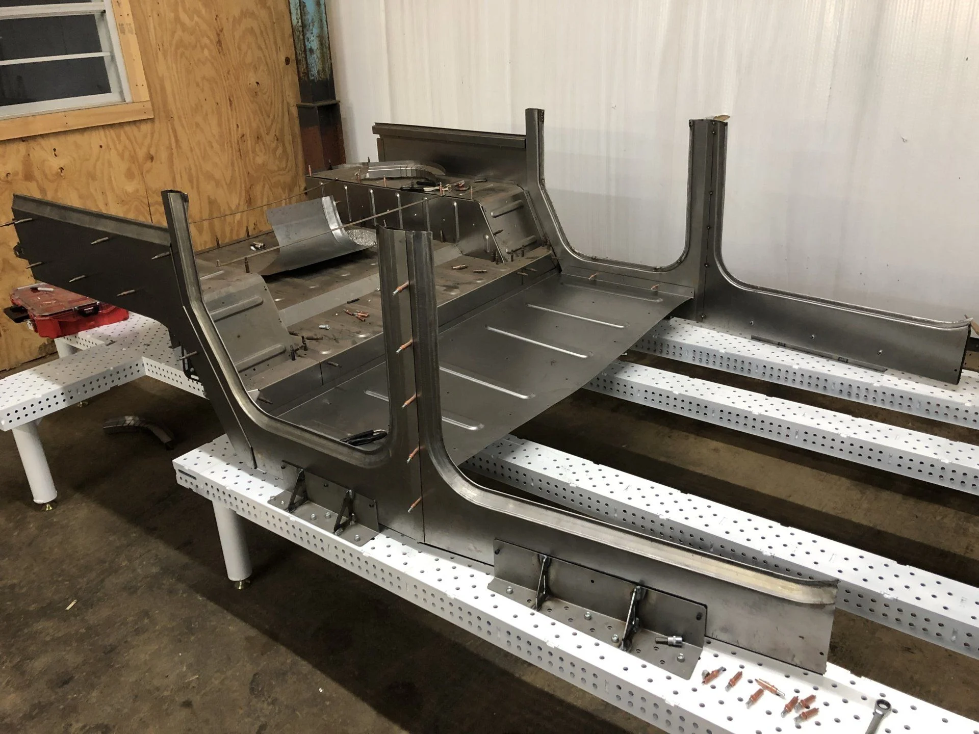

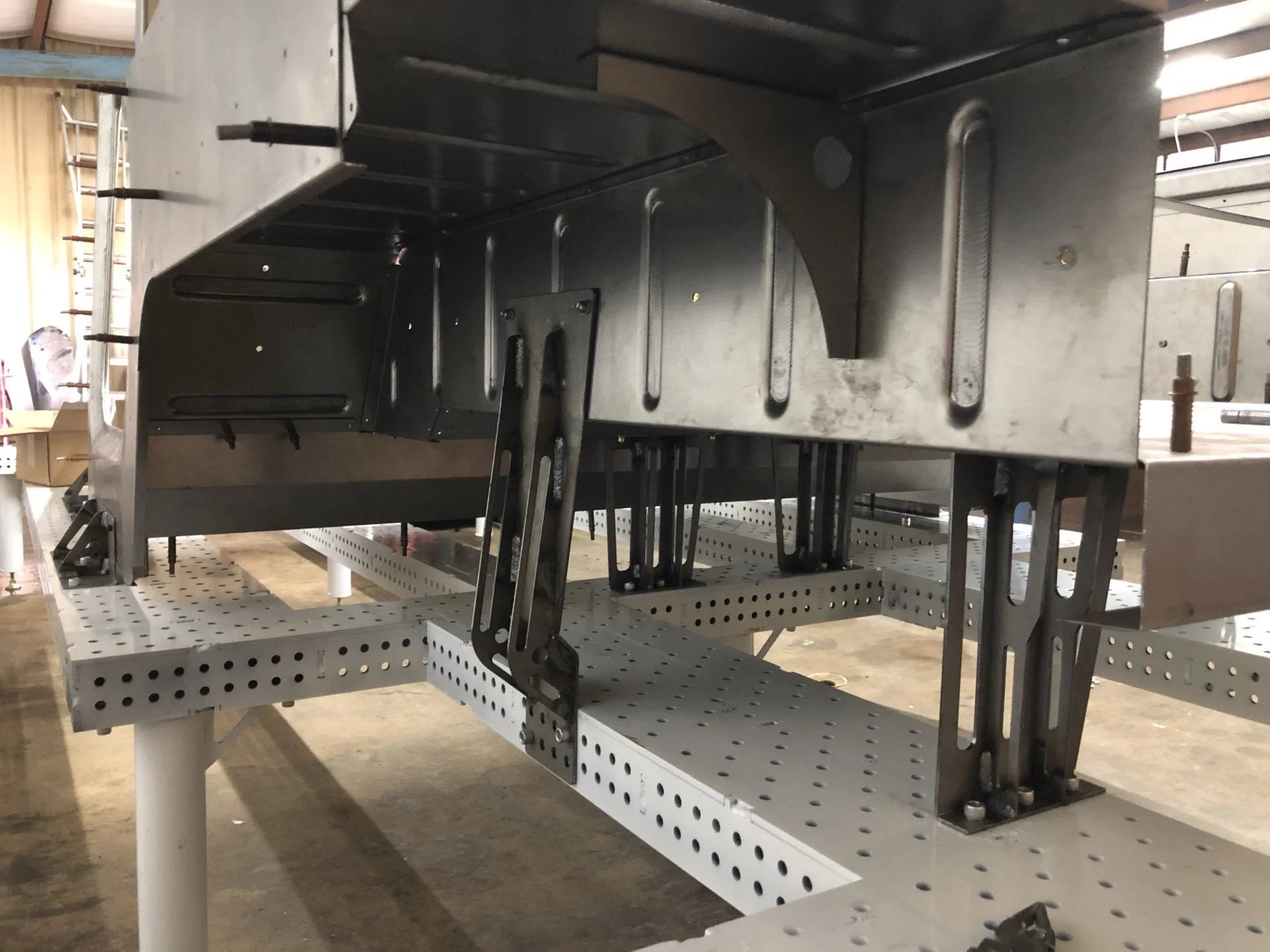

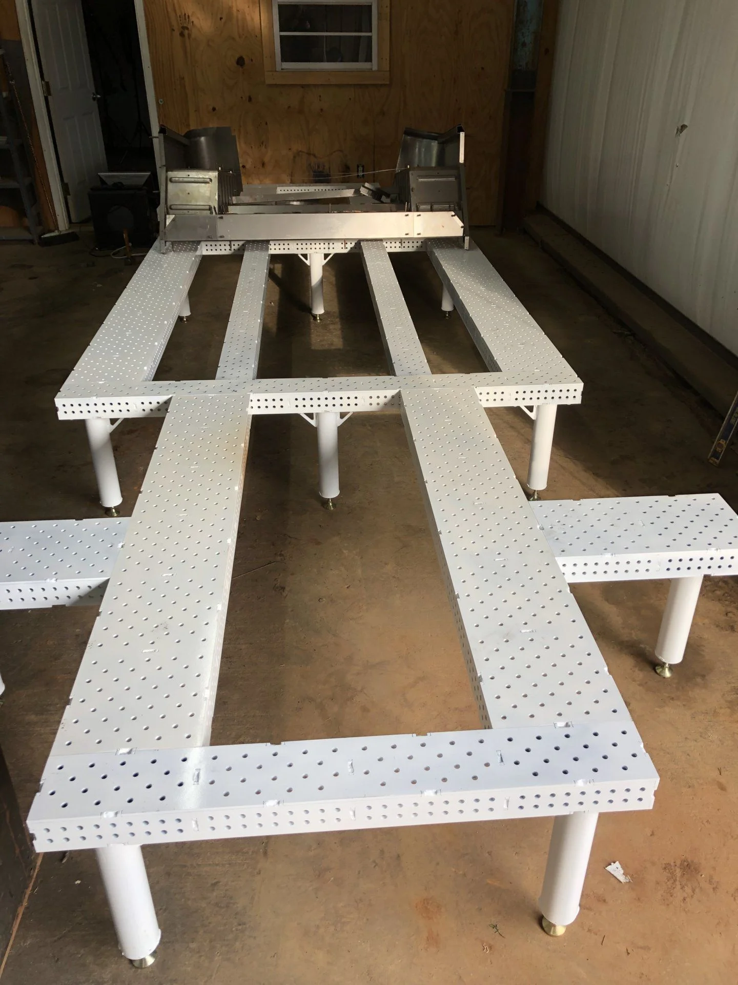

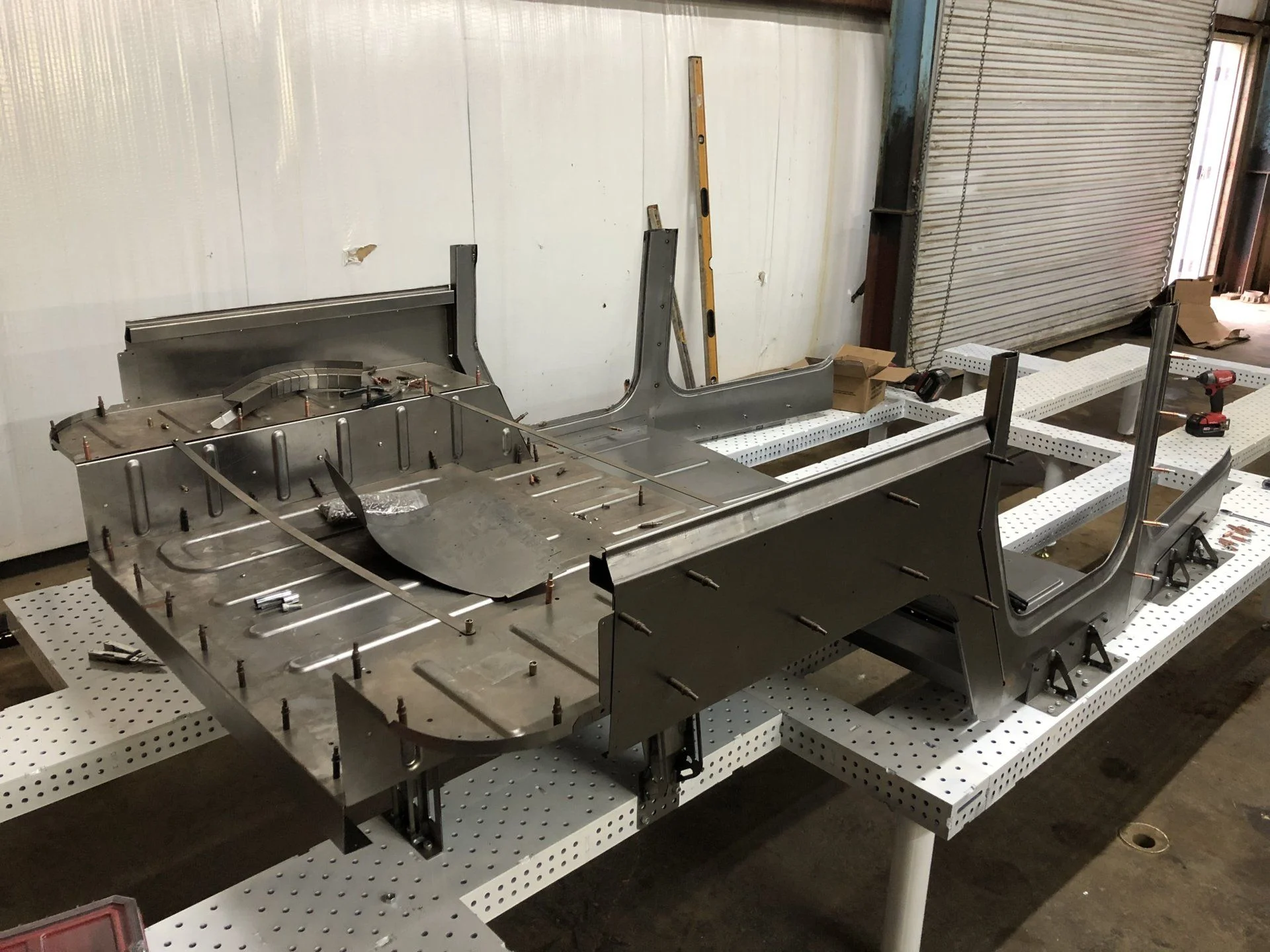

Sorry for the delay. I know sometimes it feels like I’m stopped working on this but I haven’t!! I decided I needed a modular table to help me build the body as I finish each piece. So a friend and I designed this fixture table specifically for building these tubs. Also, while I was at it, I built a new English wheel.
We have already. I have 4 to build after this one. I am having a professional artist do a rendering so the “vision” is fully realized.
Cost for a ‘79 stock body with larger rear wheel openings.
