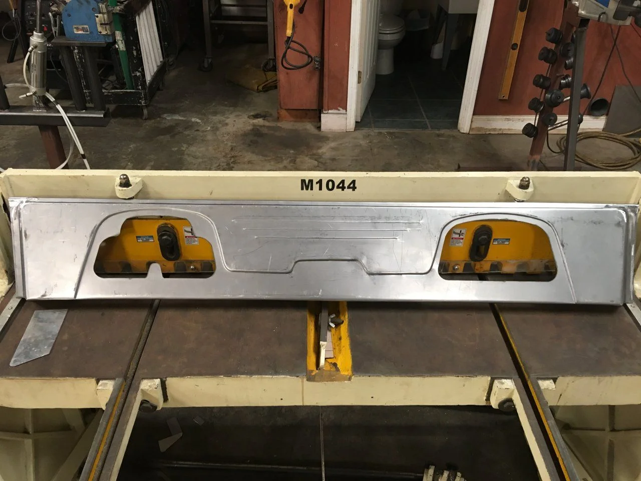

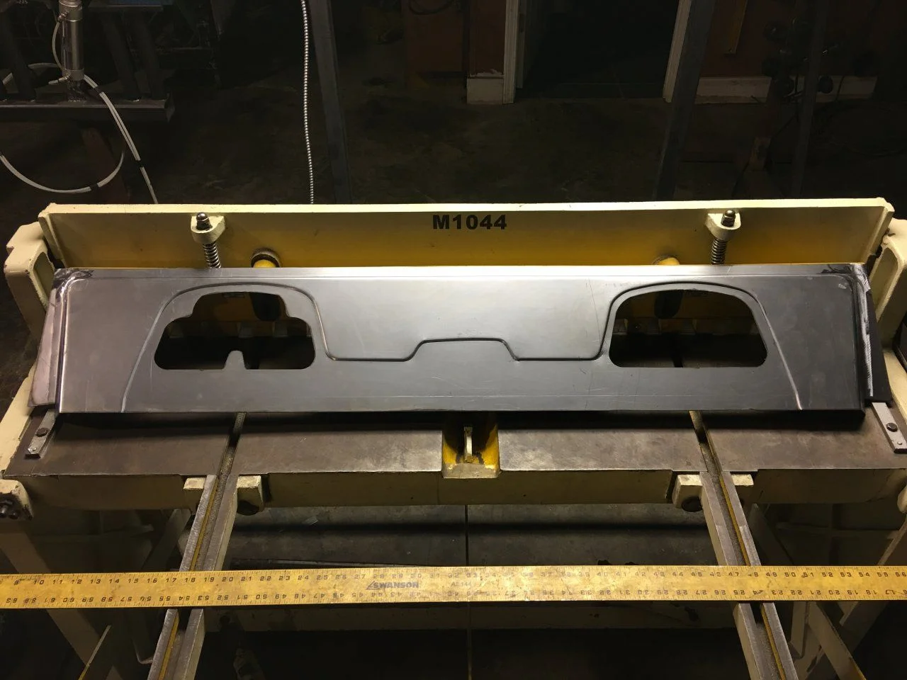

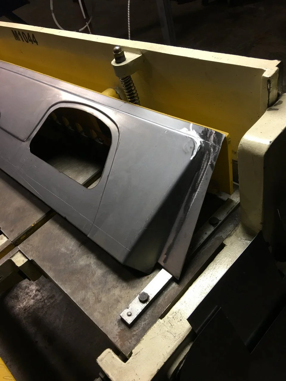

So I had some time today, a few hours, to work on the FJ 40. I figured I needed to get the dash done so I could continue forward to the cowl. So what I did was took a rough paper pattern of a 40 than I have in the shop right now and take it to my digitizer and traced that out so I could basically make a fixture so I can mark my bead lines quickly and not have to draw it out manually. I know this is bad but I really have been dreading making this dash because of the shape it was. I knew that it would take some time and a lot of layout. However I was incorrect and it only took me about three hours to make this dash from scratch never have done this particular dash before.
Yes, I am admitting that I delayed this project just a bit because of this dash. Now that this is done I will attach the a pillar's and go ahead and finish the cowl. Maybe tomorrow...

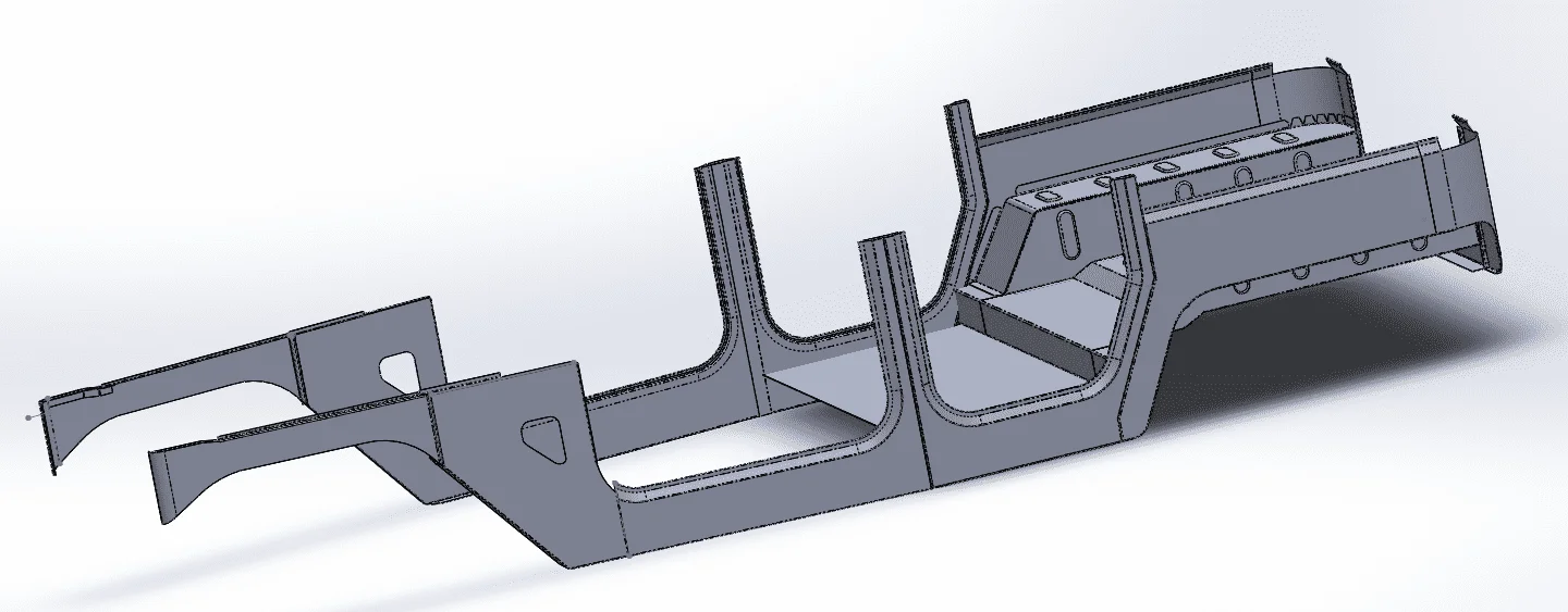

Ok, I know there has been a long delay in this project. All the training on this new equipment has been crazy. However at night I have been taking my 2D patterns and turning them into 3D patterns and assembling them. It makes it so much easier to plan everything.
autocad or solid works?
