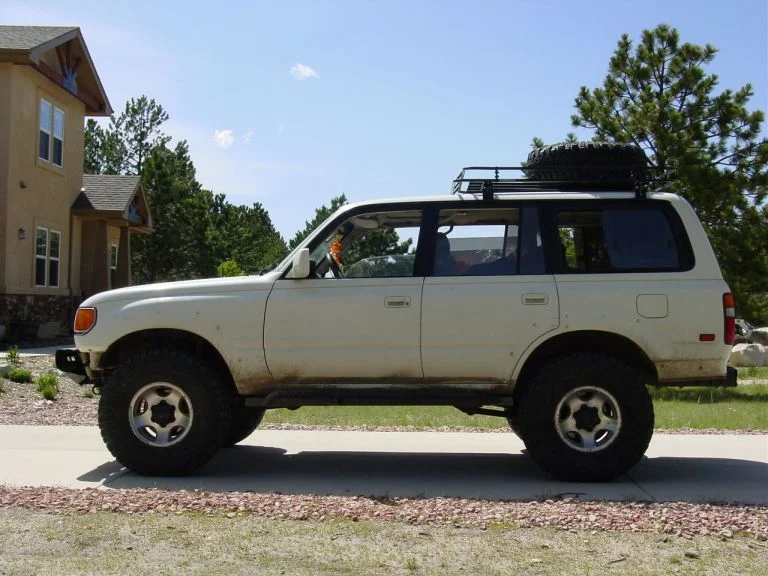

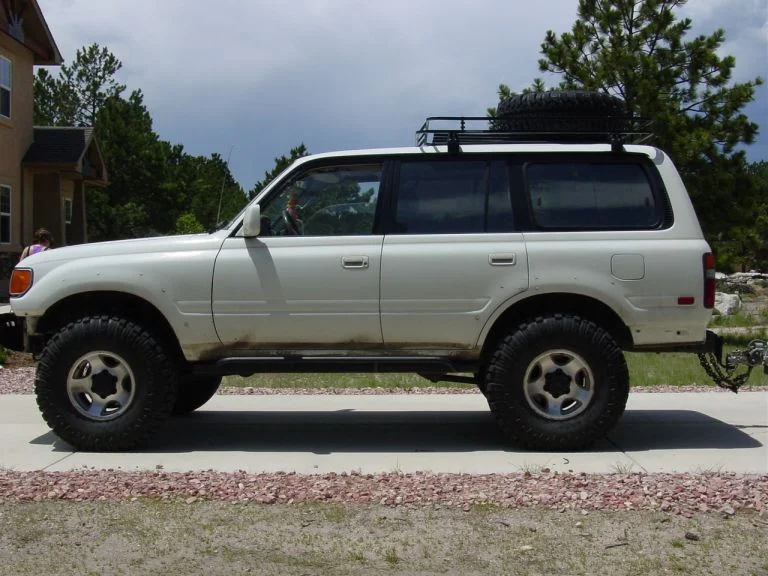

But let's look at just the springs. I took these pics just to show load bearing of F.O.R. coils because of the years of posts about "what OME springs should I get to ride level" and the responses of "just add 500 lbs to the rear so it rides nice".
In the first pic, I am completely unloaded. Just the 3 rows of seats. No tools, spares, or anything else. The vehicle is completely level hub to flare on all four corners (23" hub to flare with no flares).
In the second pic (which I actually took first), I am towing a 2,000 lb 12' open U-haul trailer with six cubic yards of damp mulch. Conservatively, 3,500 lbs. I also have my high lift, tools, spares behind the 3rd row, plus about 125 lbs of 3 kids in the 3rd row. The trailer was evenly loaded, so 10% tongue weight hanging off the hitch (350 lbs) plus 250 lbs more of kids and gear either over or behind the rear suspension. In other words, a 600 lb difference leveraged on average well behind the 3rd row.
I jounced the suspension between loaded and unloaded to ensure the measurements were good.
The loaded to unloaded rear measurement is 3/4" of compression for 600 lbs. The OME J spring under this kind of load is doubling that compression with the same stated spring rate to get to a 3.5" loaded state. This means the effective load bearing across a 600 lb load range for the F.O.R. coils is dramatically more consistent and higher than the OME coil.
I know his was 1st gen, but I have not seen anyone talking about the weight carrying capacities of the new springs.
Actually Sam's springs weren't even gen 1s, they were prototypes that he begged for.
As for carrying weight, I did a detailed post when I switched from your springs to the FOR gen IIs. the rear height was unchanged and the front was 3/8" lower.
Same truck with the same gear, only hours apart. That should give you an idea of how both springs rate compare.
