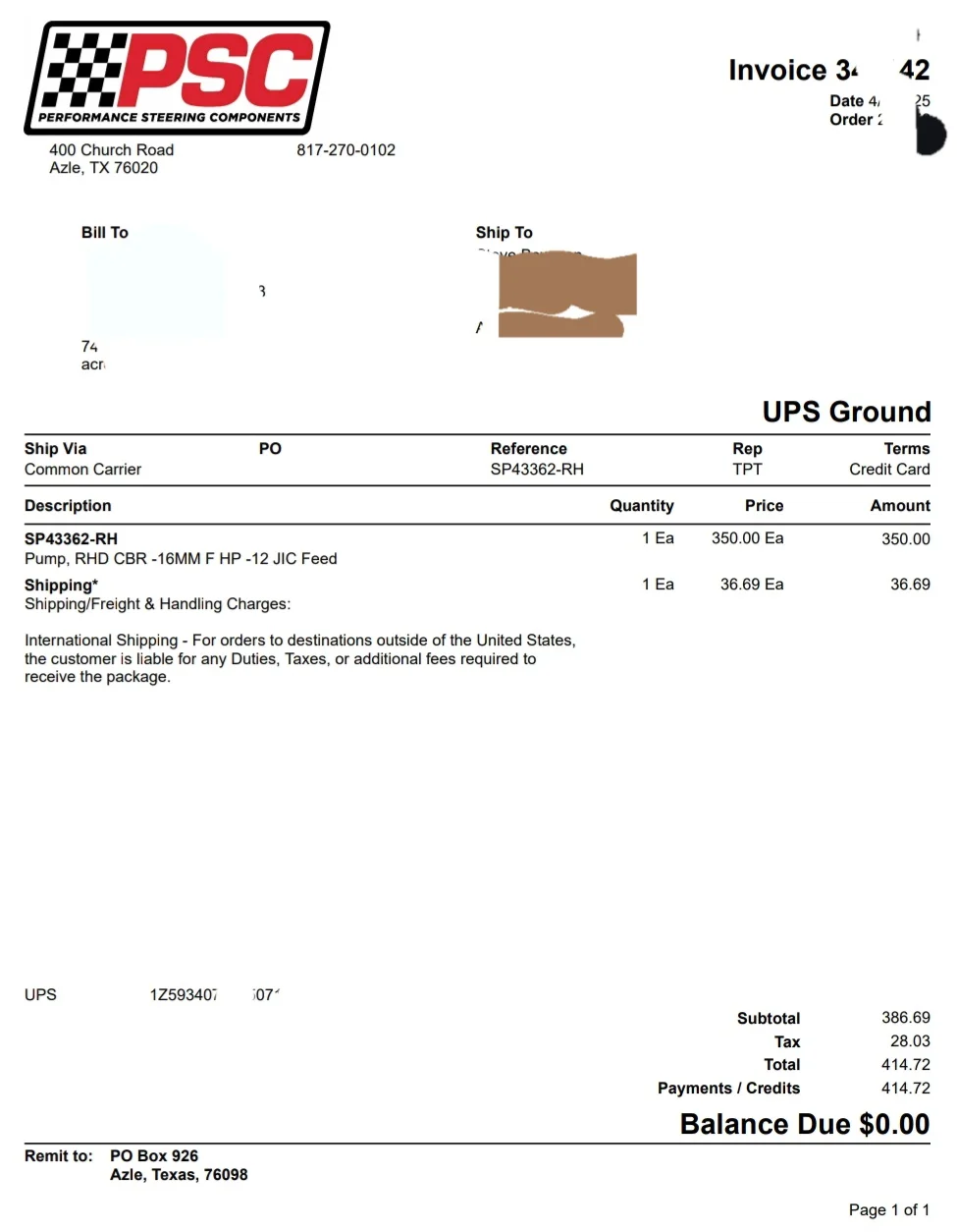

I ain't got time to dilly dally. Better get a known quantity...
All the info has been gone over countless times, the pump should have been ordered with the ram that way you you have a working set 🤷‍♂️
