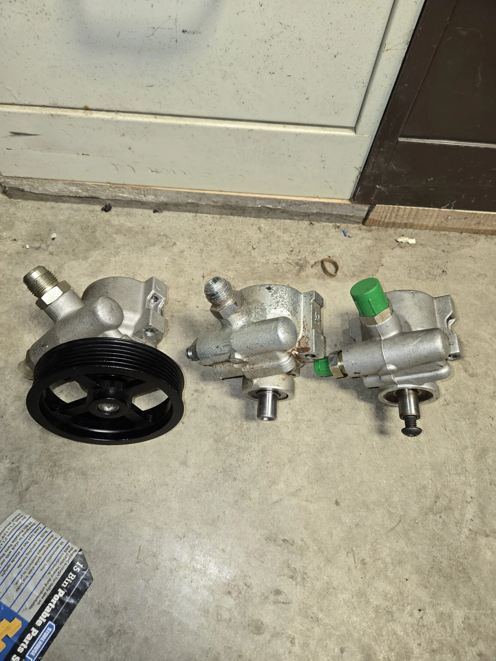

Trivia question, for the future while I await the arrival of my new pump...
Anyone had a look inside of these pumps?
Would it be possible to simply drill and tap the opposite side for the output, and then plug the original hole?

I have no idea

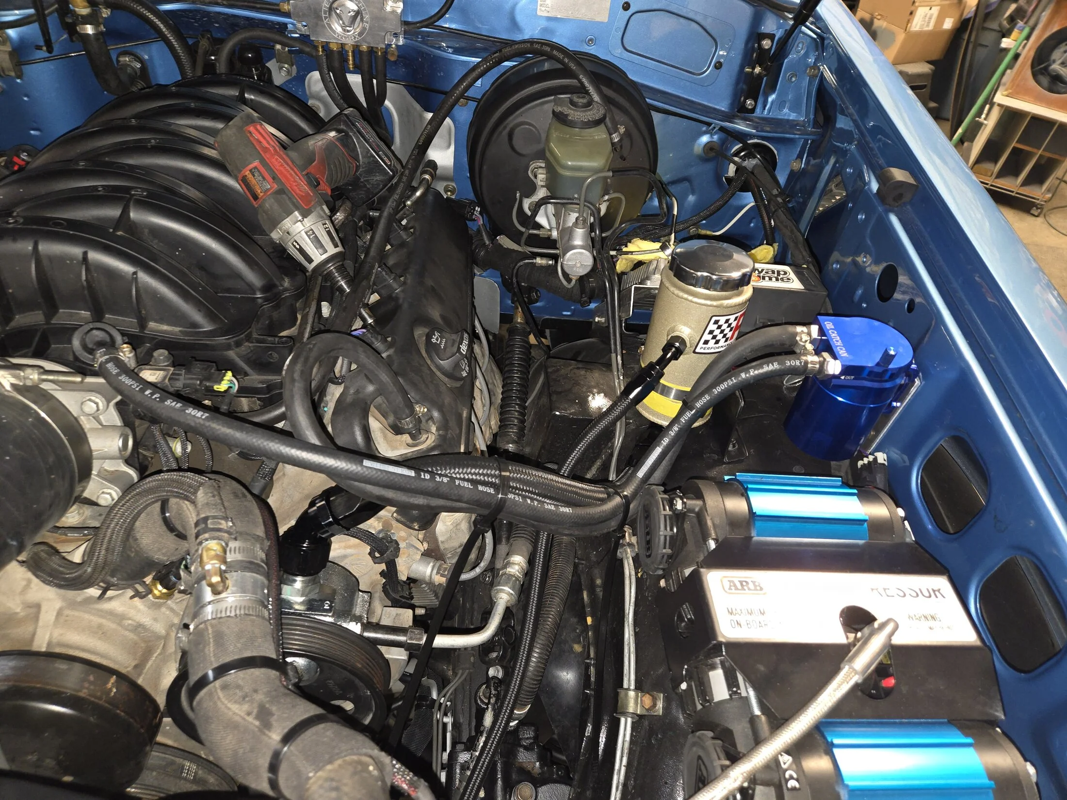

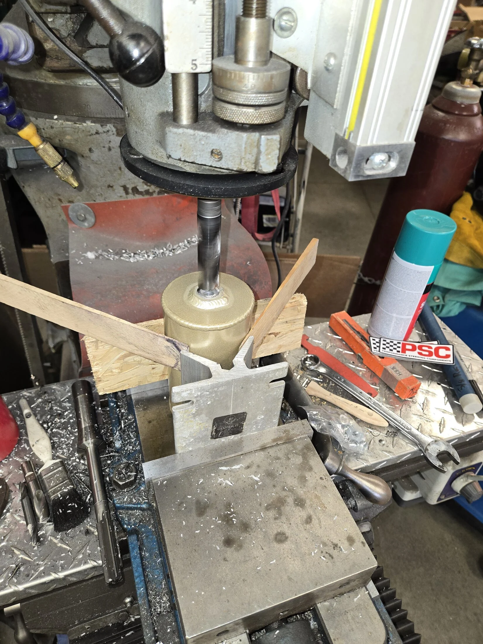

Thanks for the motivation. But I couldn't see $300 more for the reservoir. You can check it out week after next😉

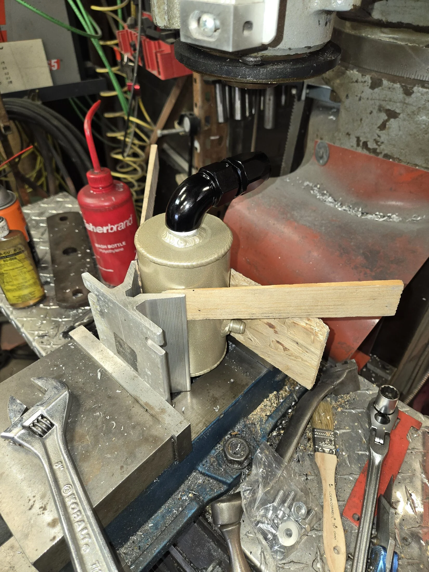

I think this will do. We'll, mostly. I'm gonna change the 45 at the pump to a 90 as soon as it gets here😃
Had to change the original -10 to a -12 90. The original welded in fitting had enough material to tap some threads into afyer cutting it off and drilling it out.

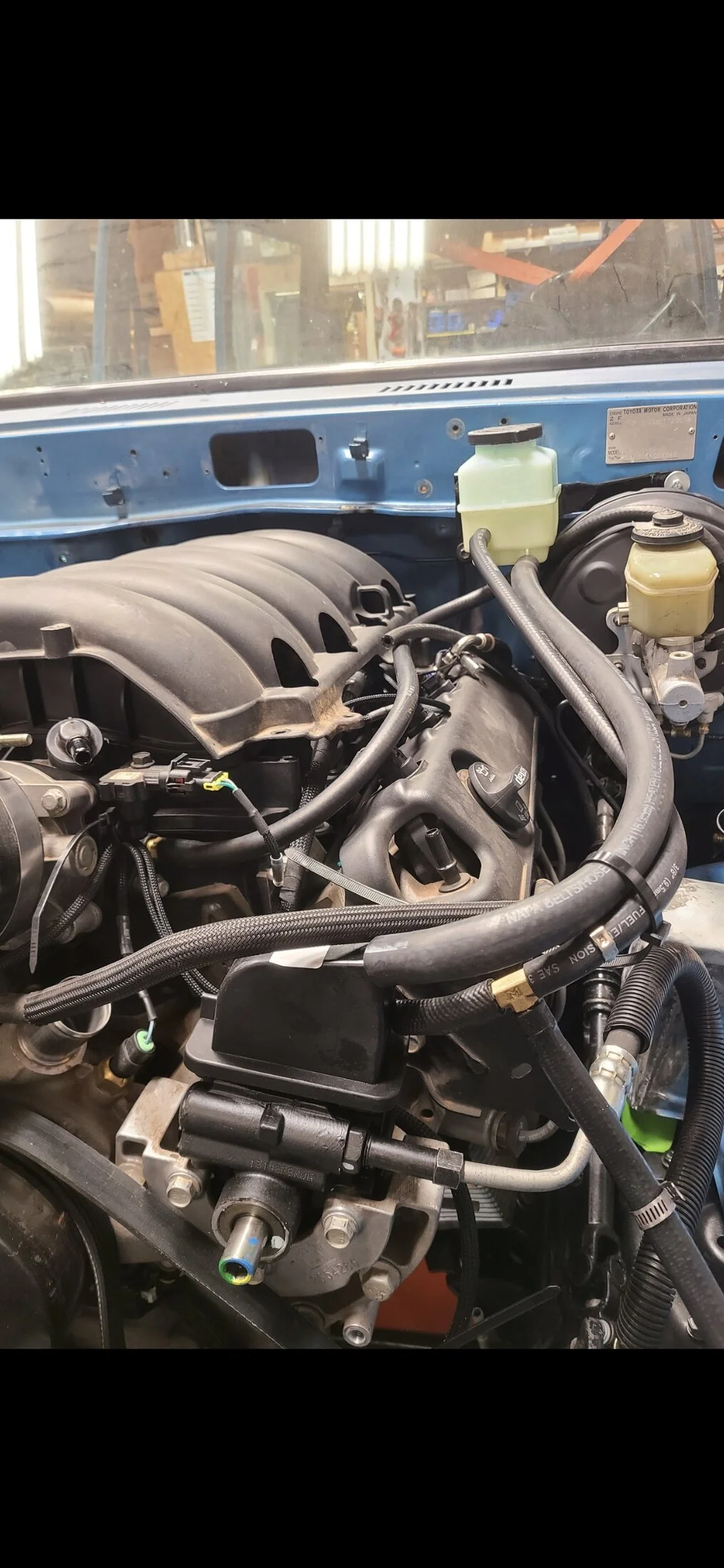

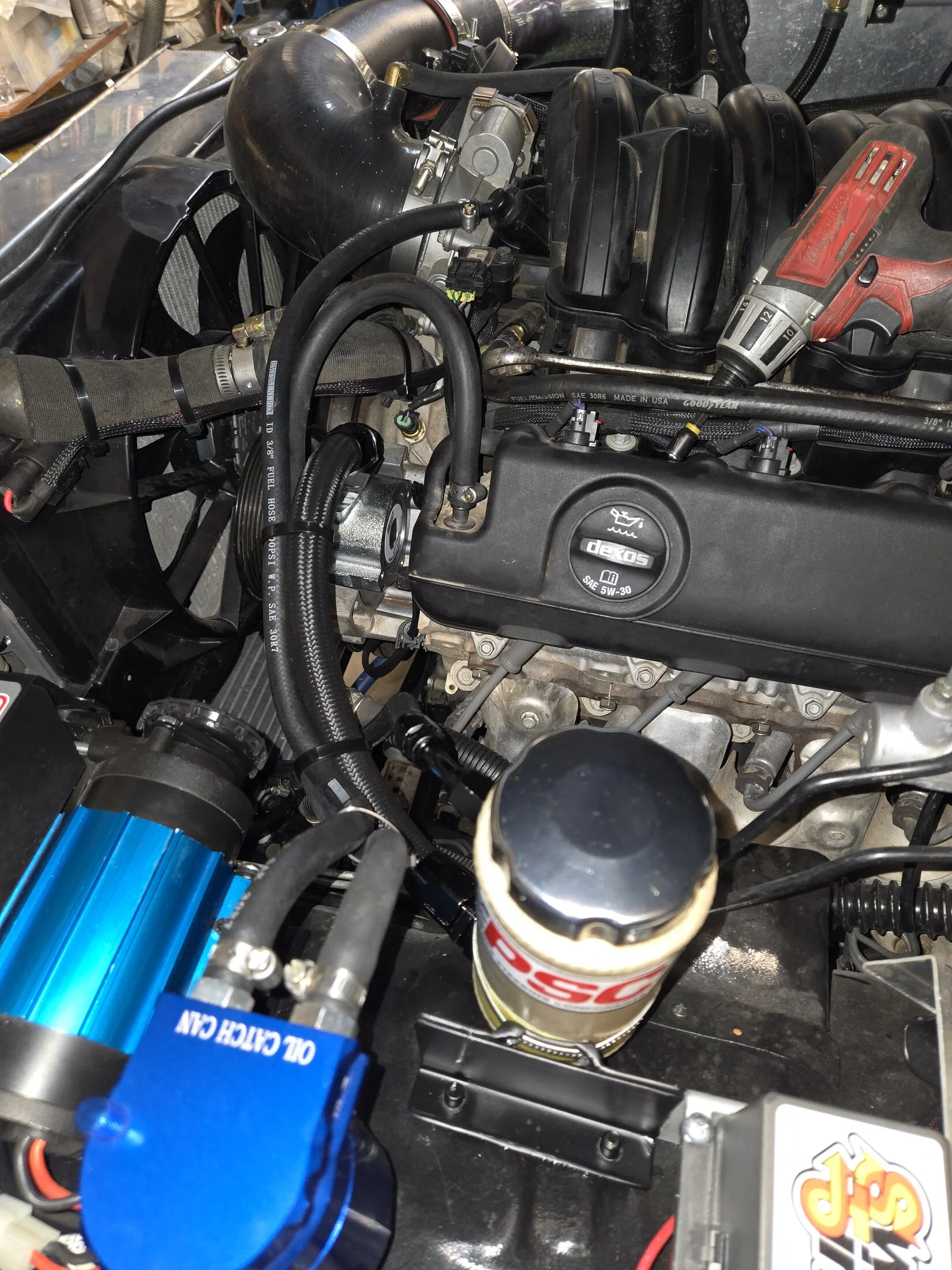

No. I had this.
That's a 5/8 hose along with the 3/8. If I'm being honest, I did have thoughts of running it since some of those psc pumps have -10 feeds. But when I was ordering the pump, they said it would have the -12.
