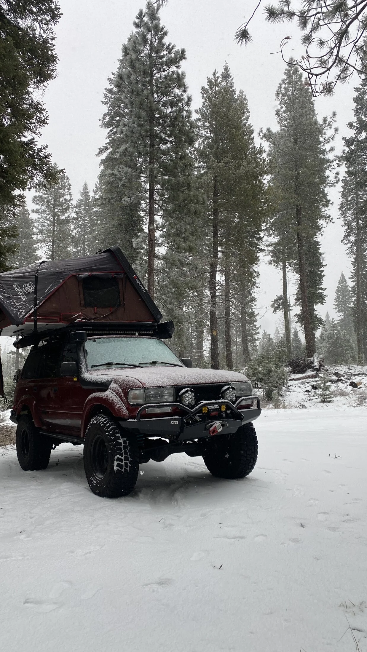

I’m running full Bajas on my Shortbus. It’s nice to know I am done with my lighting setup, and it will last for a long time with minimal to no issues. If I do have any issue, they have real customer service and can either be serviced or fixed under warranty. Made in USA. Have great lighting specs. Hold their value.
I’m running full Bajas on my Shortbus. It’s nice to know I am done with my lighting setup, and it will last for a long time with minimal to no issues. If I do have any issue, they have real customer service and can either be serviced or fixed under warranty. Made in USA. Have great lighting specs. Hold their value. View attachment 3842153
Yep, those are nice lights and a nice rig. I get the buy once, cry once perspective. That makes sense, too.
