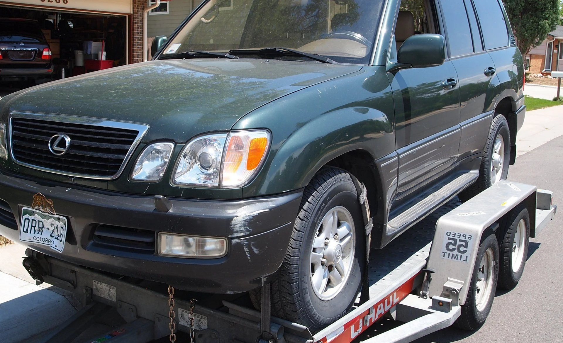

In the end I asked the seller if he just wanted to get rid of the LX and out of their. I really wasn't to interested so I made a haul offer or walk away offer. He said yes, not a PP price I'll be posting, it would devalue all series 100 HAHA. So we cut a deal and closed. I came back with trail a few weeks later, using my 2011 Land Cruiser to tow it home legally with U-haul trailer (U-haul will not allow a 100 to tow a 100).
Darn, all front lights/lenses busted!
1963074
Lucky the topography allowed us to set trailer in a low spot and ramps on high spot in PO driveway. We just hand pushed it onto the trailer. Took 10 minute and I was back on the road. To get it off the trailer, I just pull it with another 100 series and rolled it off.

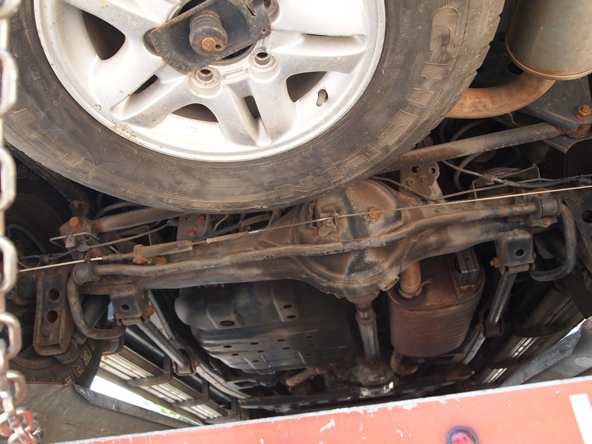

Bit more rust than I like to see, but not to bad. See gas tank skid shield, not bad at all.
1963076

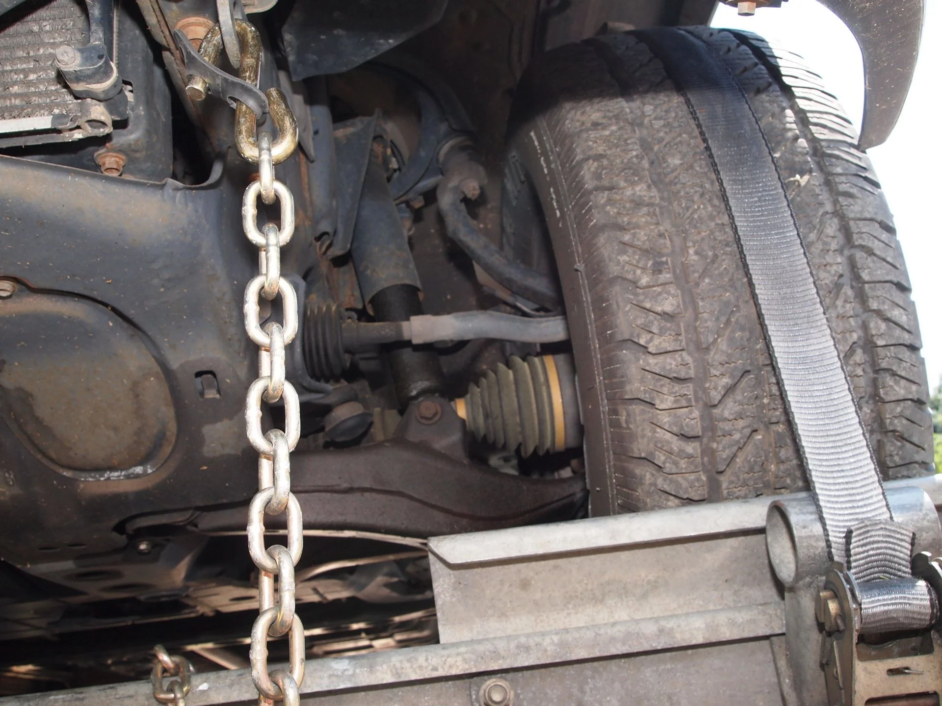

Sweet replacement OEM front drive shafts or an OEM reboot kit. See the yellow clamps:) Shock looks leaky:(

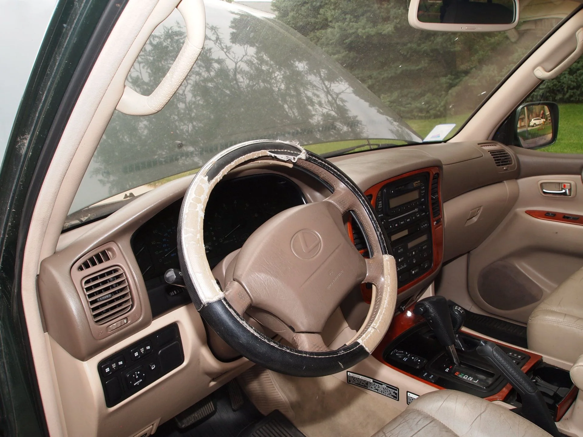

Interior is not bad. Needs a very good cleaning. Both seat bottoms have small tear, not to bad. Steering wheel a horse chewed. really.

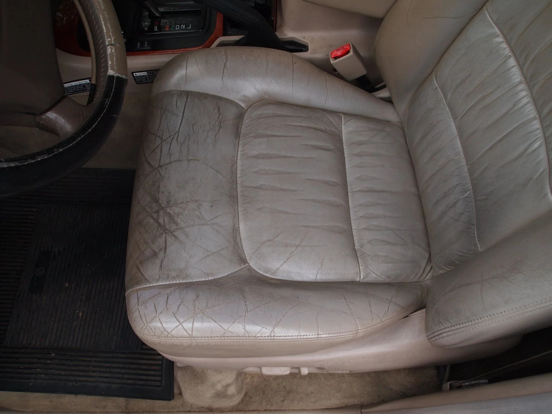

Seat have small tear. Hard to see center up front

Stitching bad up front out corner

Cover on steering is cover where horse stuck his head in and chewed it. As reported by PO!

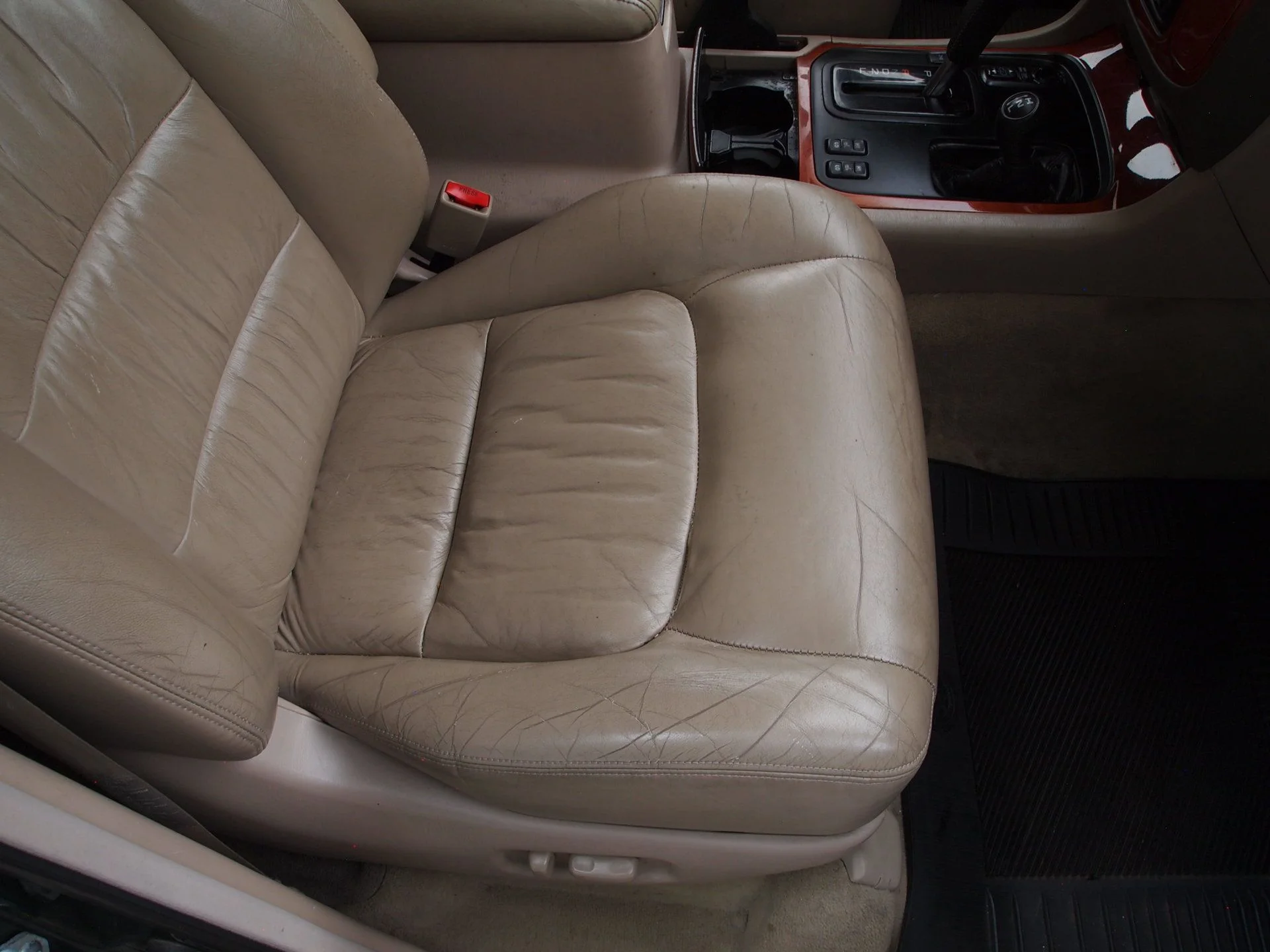

Over all leather not to bad.

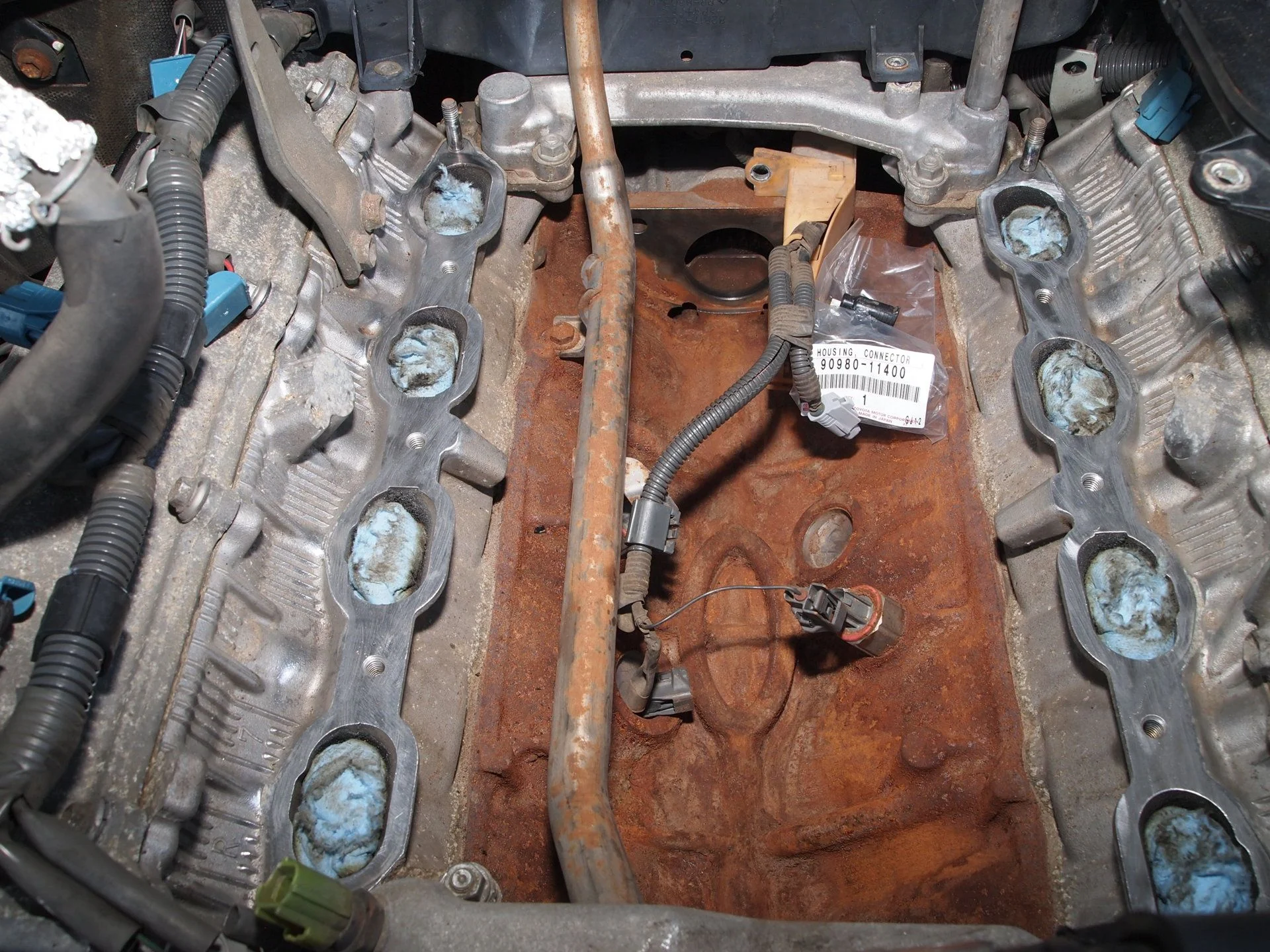

First up getting started. Wanting to pull starter I need to clean engine. This is so when I pull the intake manifold, I don't drop grim/sand/ crud into intake ports of head.
Non running engines presents a problem when power washing. I like engine angled with front end higher than rear of engine. This is so water will flow front to back out of engine valley rear drain holes, passed the starter. Of even more importance, is area between intake manifold and heads. If water sit between intake & heads, it can enter intake ports of head. When this happens it's important to run engine. Running engine drys it and blows out any water that may have entered ports/and cylinders. If allowed to sit with in engine for more than two weeks, it will likely rust leading to a smoker.
So to over come this I use as little water as possible and compressed air normally. In this case vehicle was at the curb out of reach of my air hose. So HP water was all I had at the time! So key was to water soak up as I pulled intake and get running ASAP after washing engine.

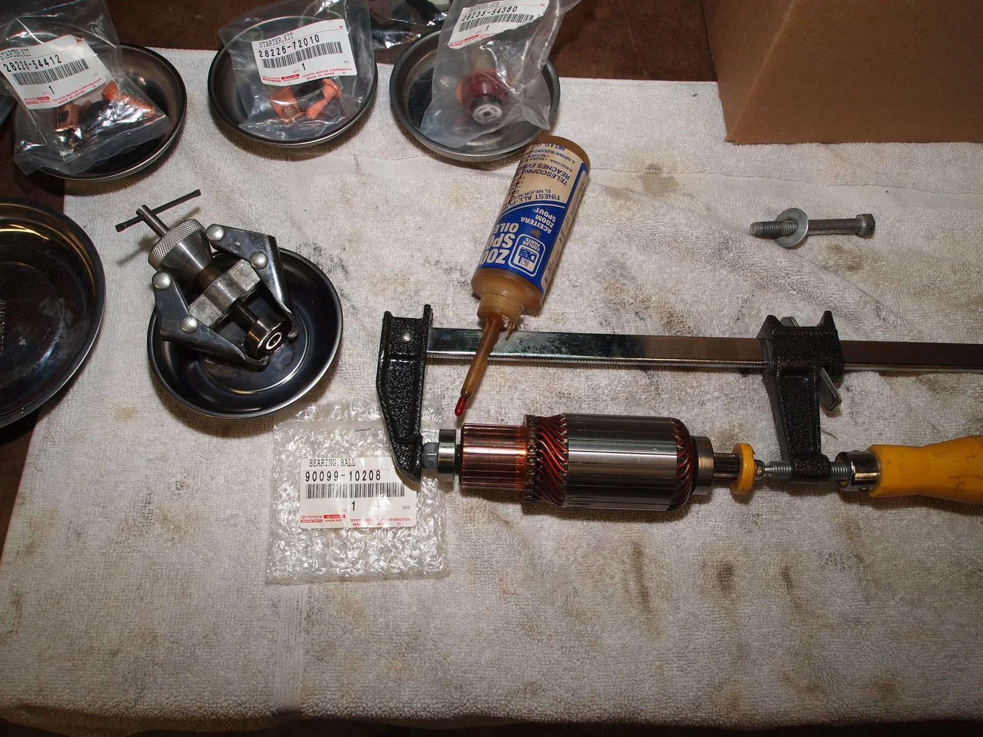

I dug right in, ordered starter parts to rebuild it.
This is first time I replace the front bearing.
It was a rebuild Denso in the engine, so it second in 560K KM (~350K miles)

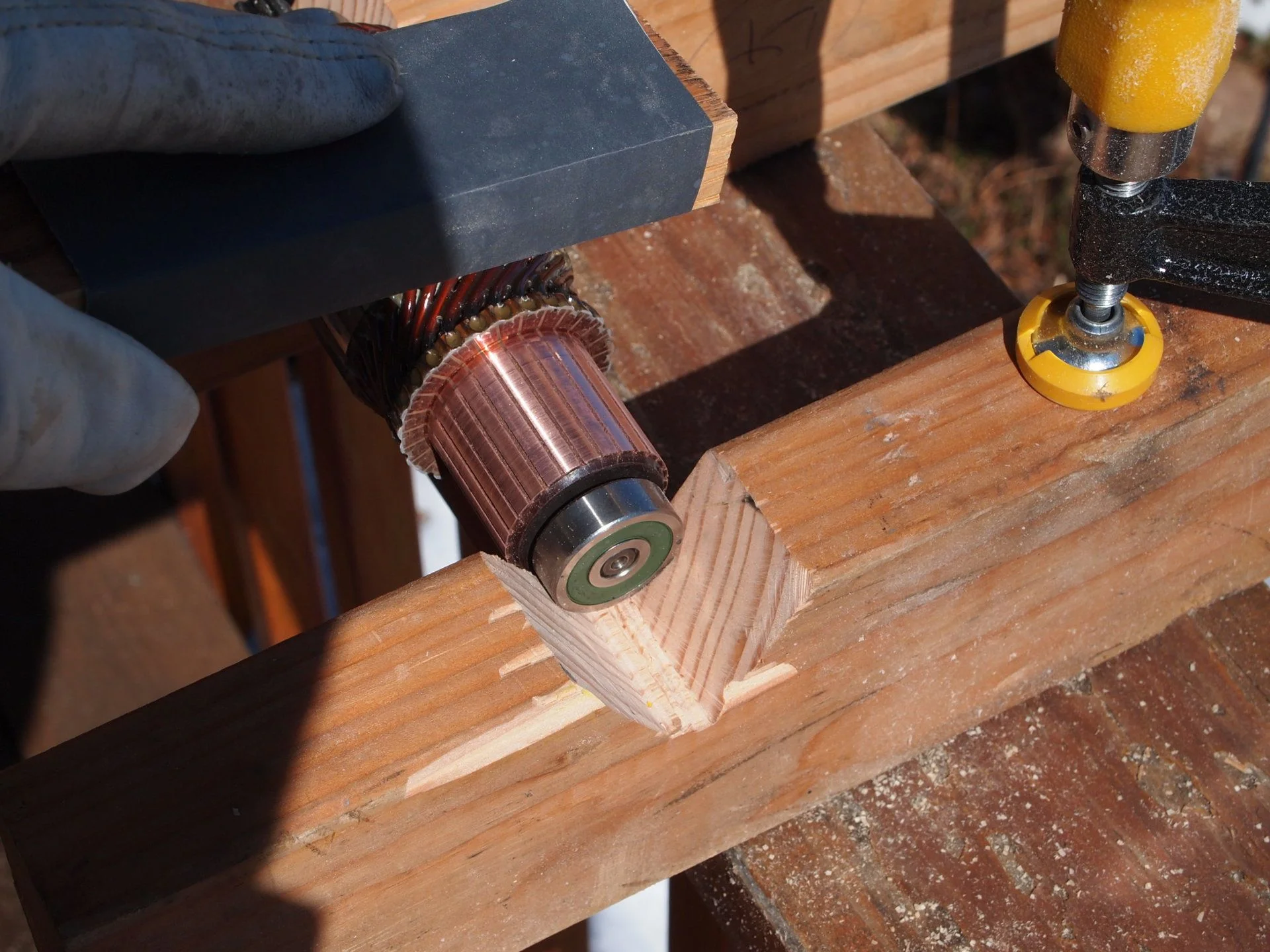

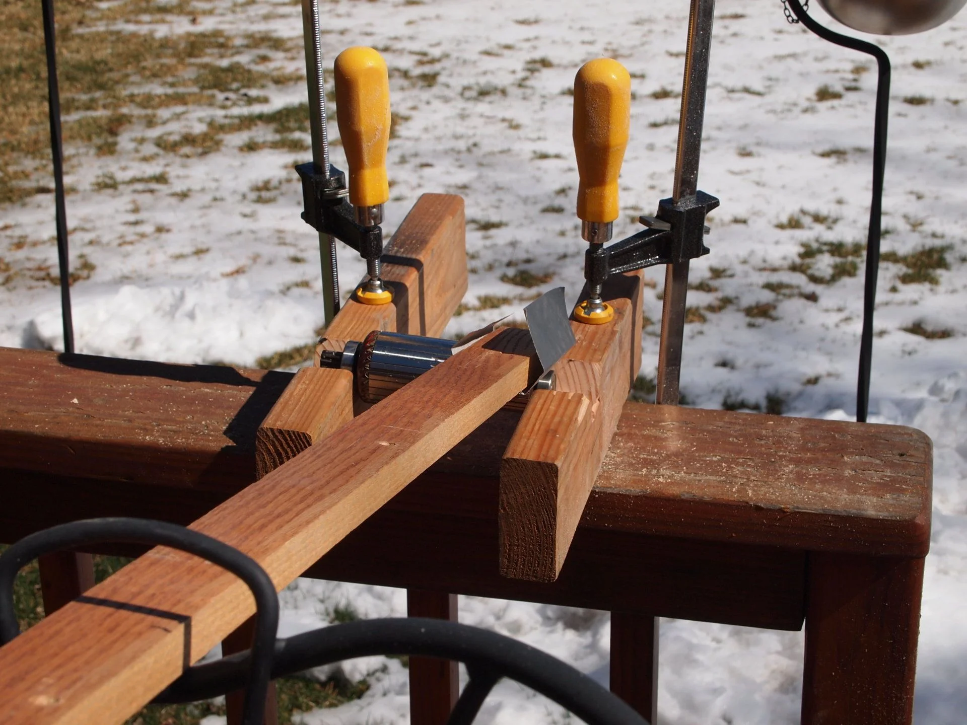

Broke out my home made commutator lath, to true it up and polish.

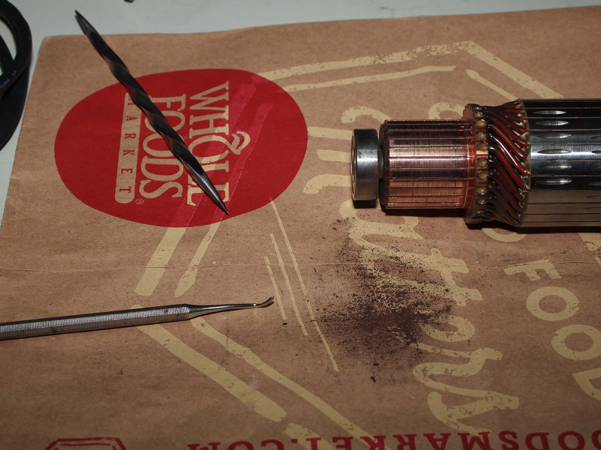

First cleaning out carbon from commutators under cut
