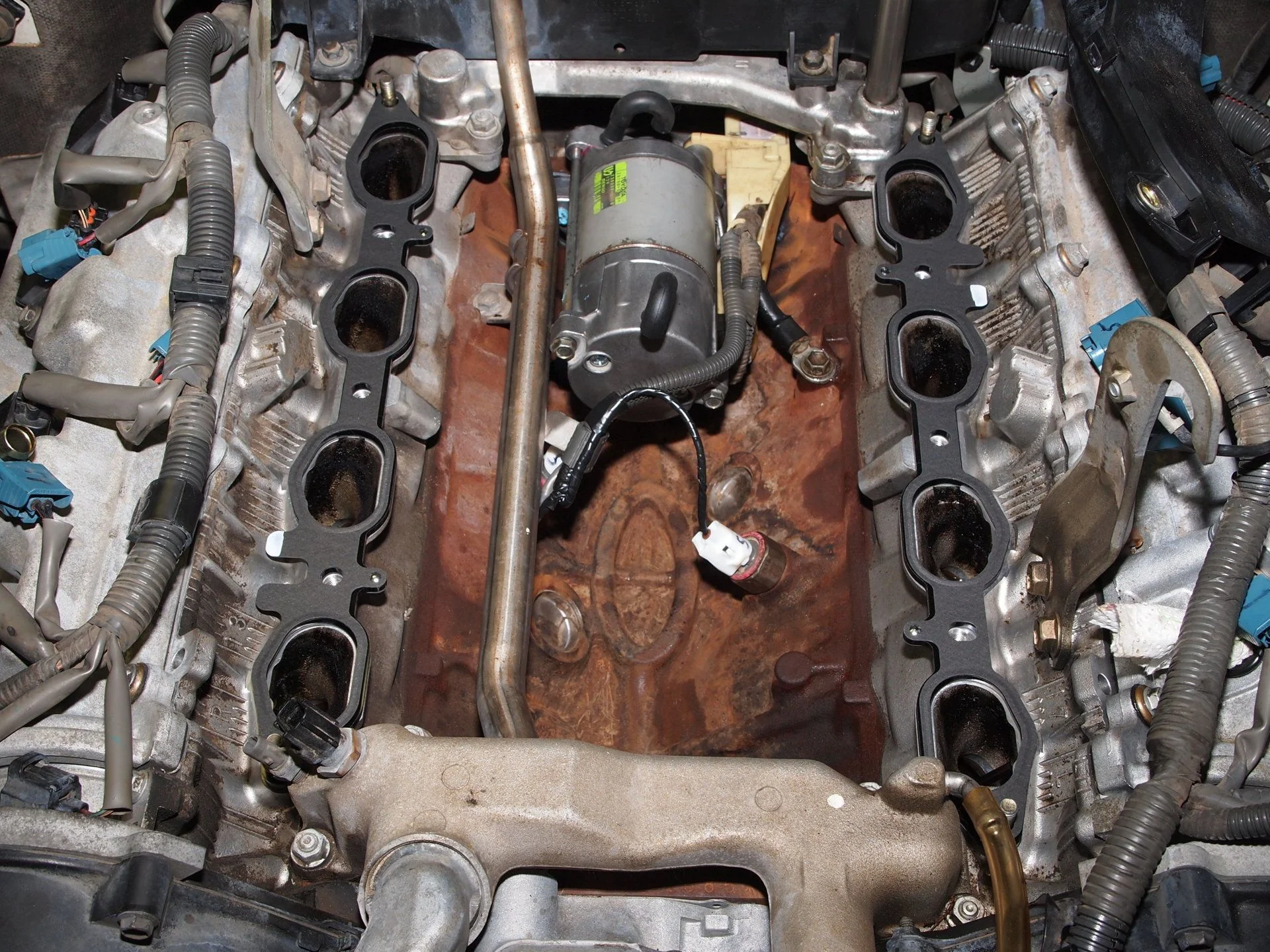

I've had a few ask me if intake manifold can go on anyway. No, it must be installed as shown here.White tabs out and up.
1969545

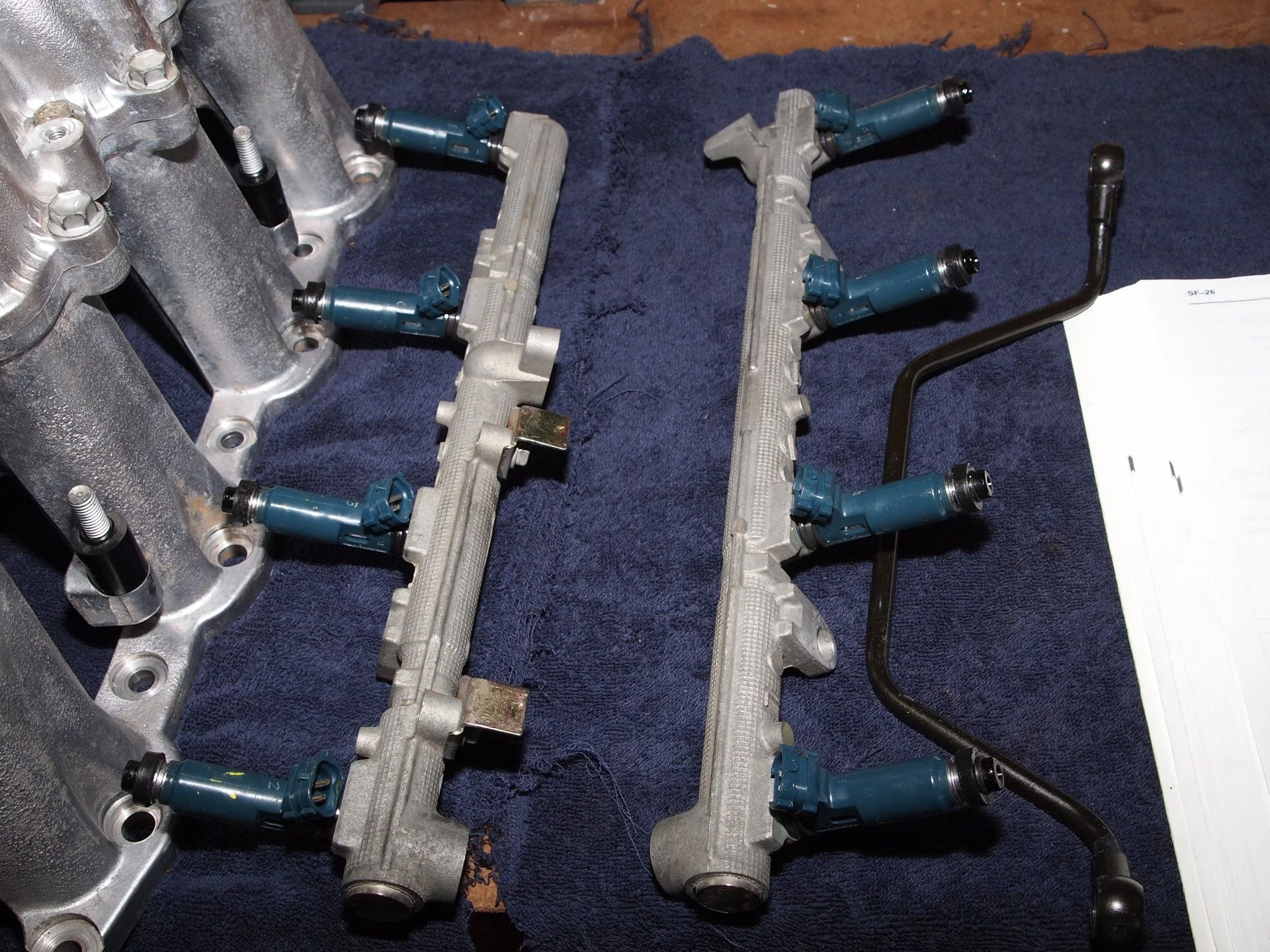

I decided to clean up Fuel Injector and put in new seas. Later I'll pull FI and have them tested and rebuilt. Have area clean and new seas in should make job cleaner when I can get to it.
1969547
Torquing down intake manifold to 13ft-lbf is important.

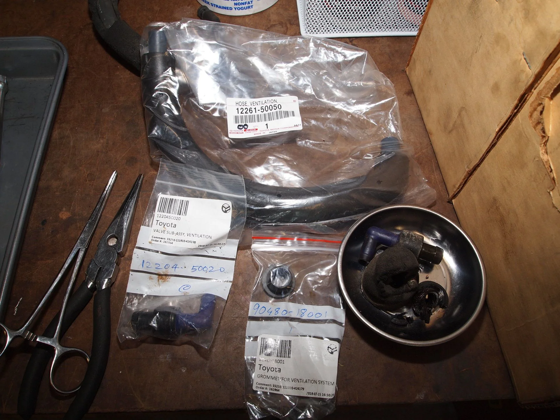

At this age hoses are hard and cracking.Making sure no vacuum leaks is key to a good running engine. It starts with PCV hoses and in the 98-02 the PCV valve grommet.
New OEM PS PCV hose:
1969566
1969568
These two can also be a vacuum leak source.

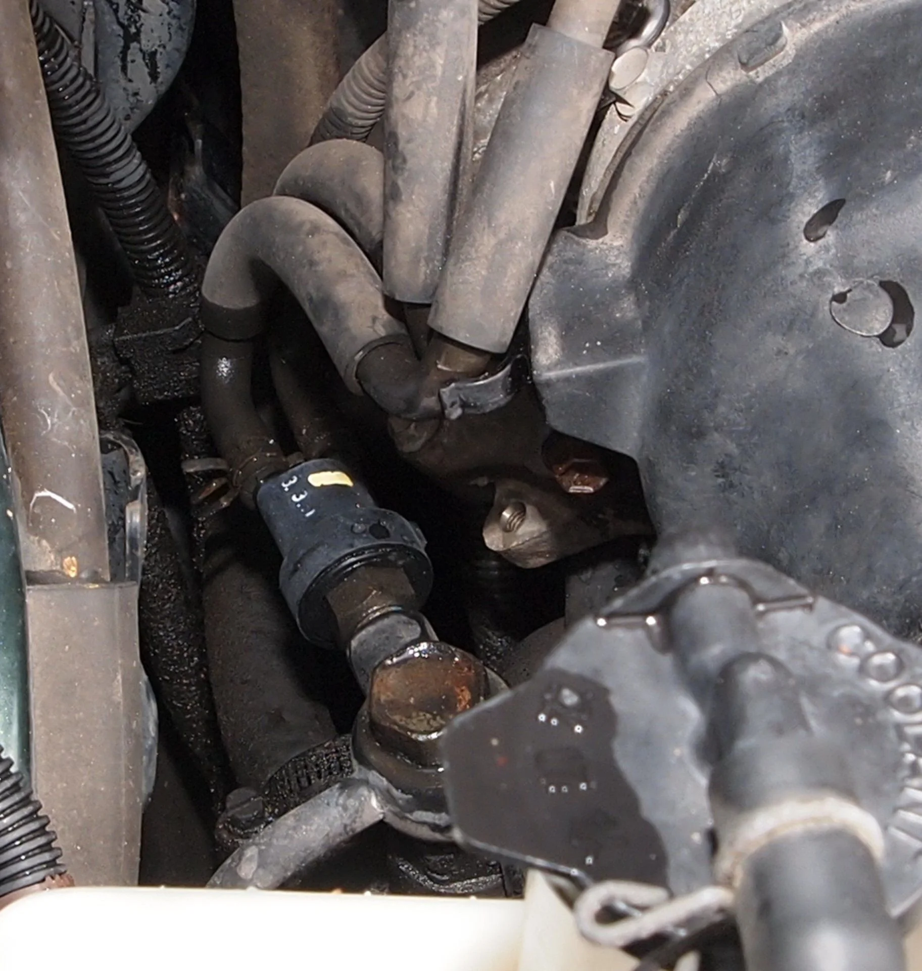

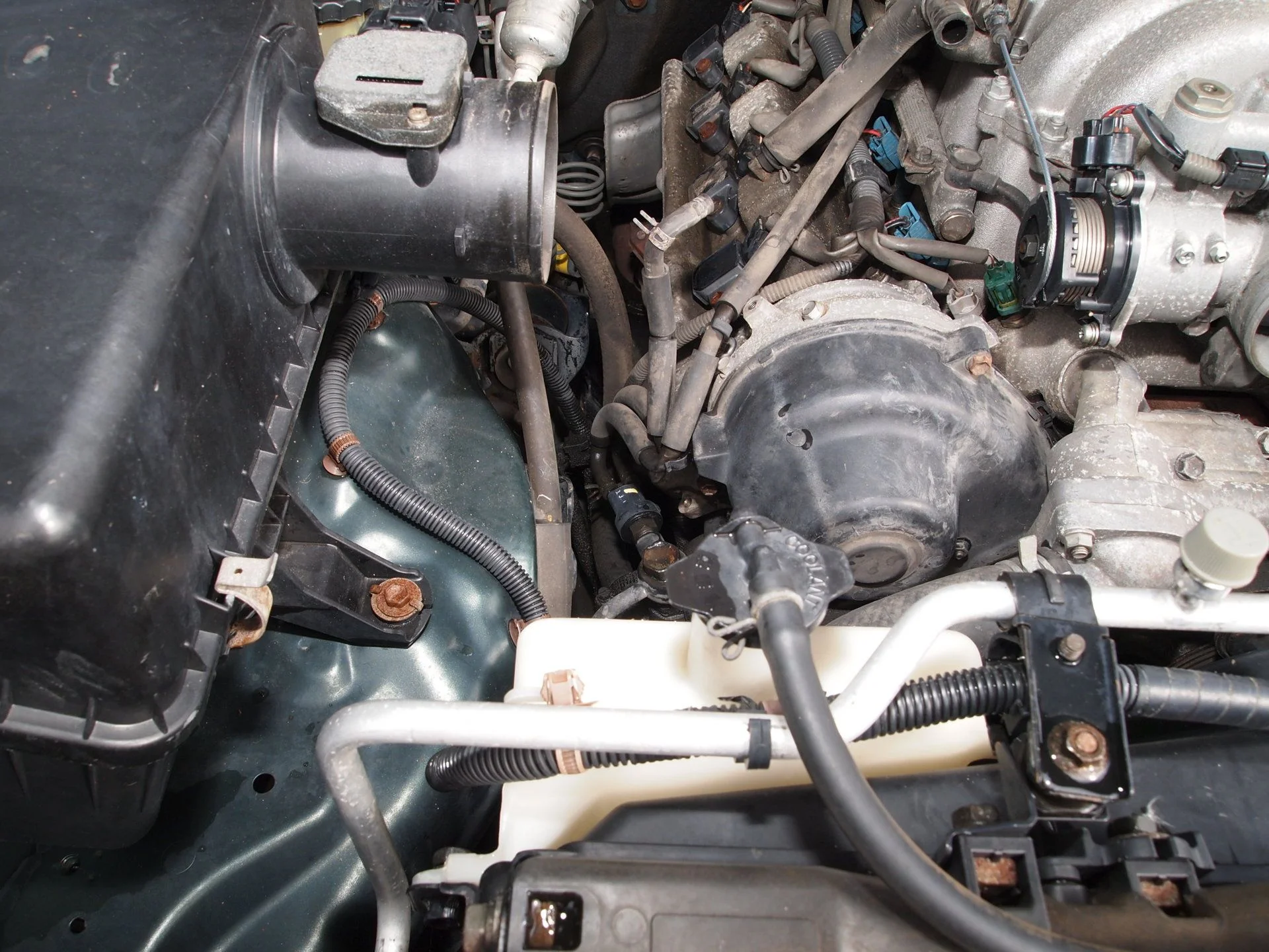

On close inspection these idle up control vacuum lines show cracking at the point they connect to idle up control.
1969581
In with the new idle up control vacuum lines.
1969573

Can you remove the intake, fuel injectors, fuel rails and cross metal pipe all as a one unit?
Yes, It gets cough on stuff that needs removing, but do able. I actually did it that way. The picture I posted is from my files, seems I didn't get picture of actual R&R. BTW: PN # 2329141010 INSULATOR, INJECTOR VIBRATION (bottom of FI in intake manifold)

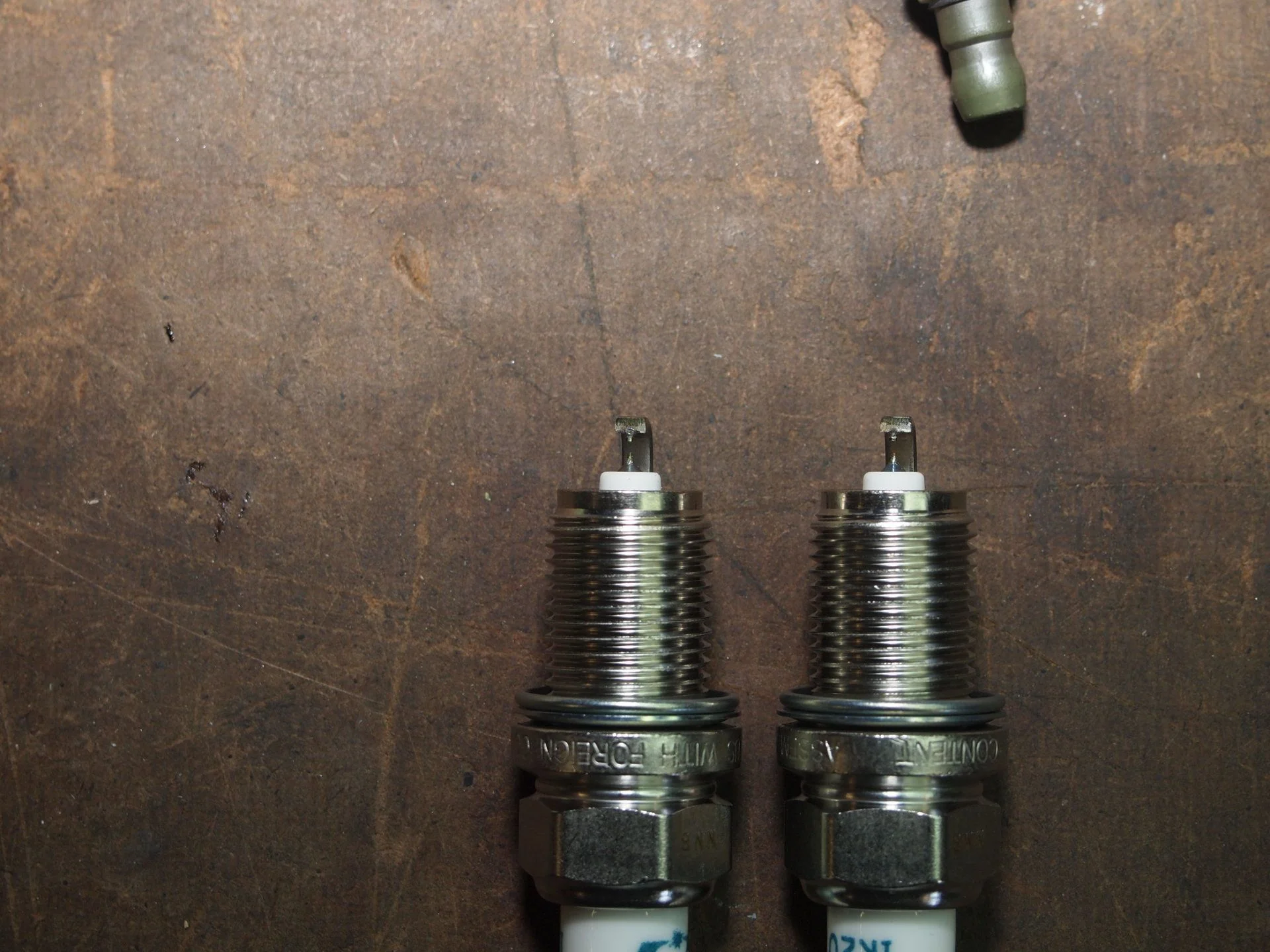

Old, Spark plugs didn't look bad. Certainly not 350K miles on them.
1969761

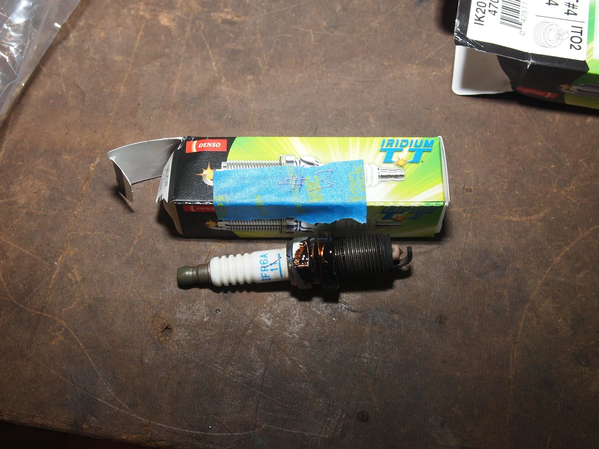

But I tossed in some new Denso TT's I picked up. It's my first time using the TT plugs. Seems I get a little less cranking on start-up (faster start). But any new plugs would do about the same. Denso claims they use less power. That means less current draw from coils (COPs) which in-turn means coils run cooler. Heat is the enemy of coils. So in theory, it means longer and better performance in life of coils. But I was a little concerned with the manufacture quality of the USA made Denso TT spark plugs. I noticed the top electrode a little off center where it attaches in about 25% of them. But they are still inline with inner/lower electrode, so their okay to use.
See the one (top electrode) on the RH is off center where it attaches/wielded.

I re-toque spark plugs as a PM these days .As I found they walk-out in about 30K miles Spark plugs Alert Alert Alert!. When re-torquing I use 18ft-lbf as the crush washer is fatten already. With new I'm torquing to 16ft-lbf to see if they'll walk-out less. Note: Toyota factory recommends 13ft-lbf.

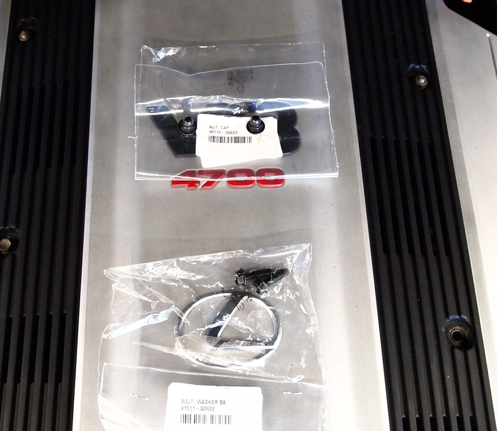

My engine valley cover bolts were missing, so picked up some.
1969770

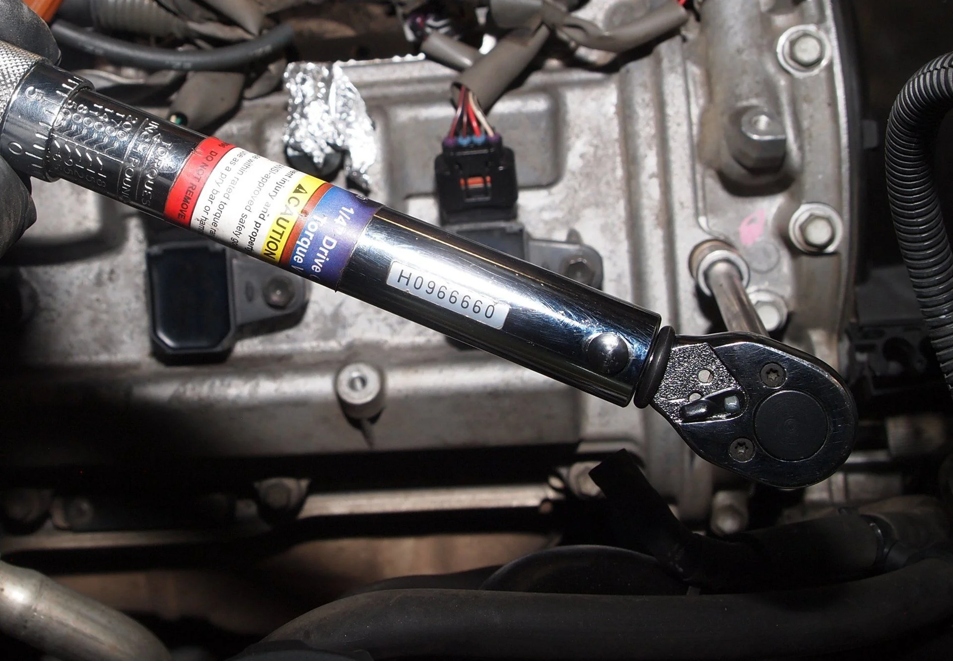

Head cover bolts re-torquing is easiest done while working with spark plugs & coils. Lexus Dealership replaced head cover gasket and spark plug tube seals at 247K miles in 2012. So a re-torque 100K miles and 7 years later is a good interval. They took about 1/4 turn to get a torque of 53IN-lbf. (Inch, not pound foot of torque)
Stock photo of head cover bolt re-torque to 53IN-lbf wit a small 1/4 torque wrench.
