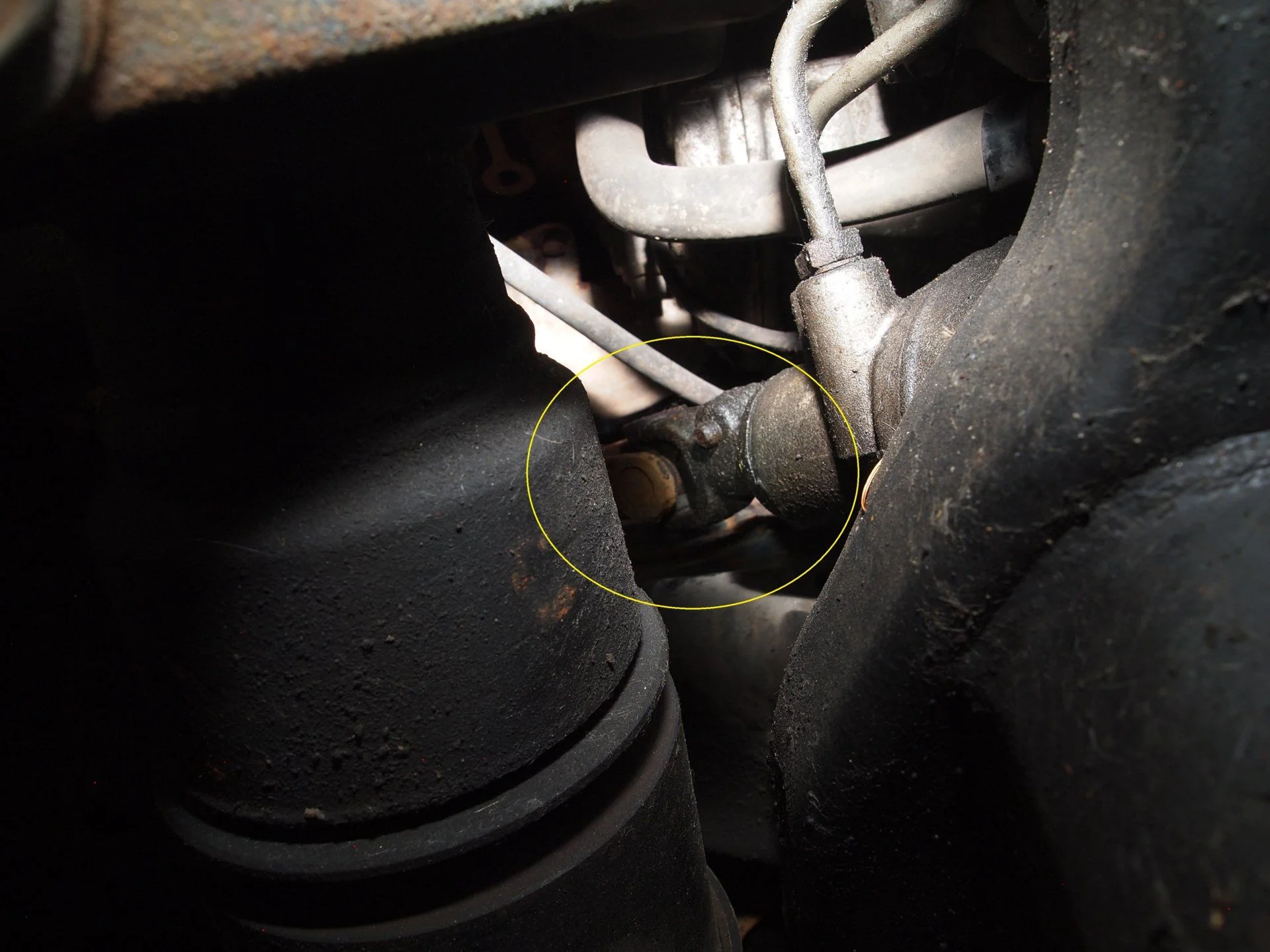

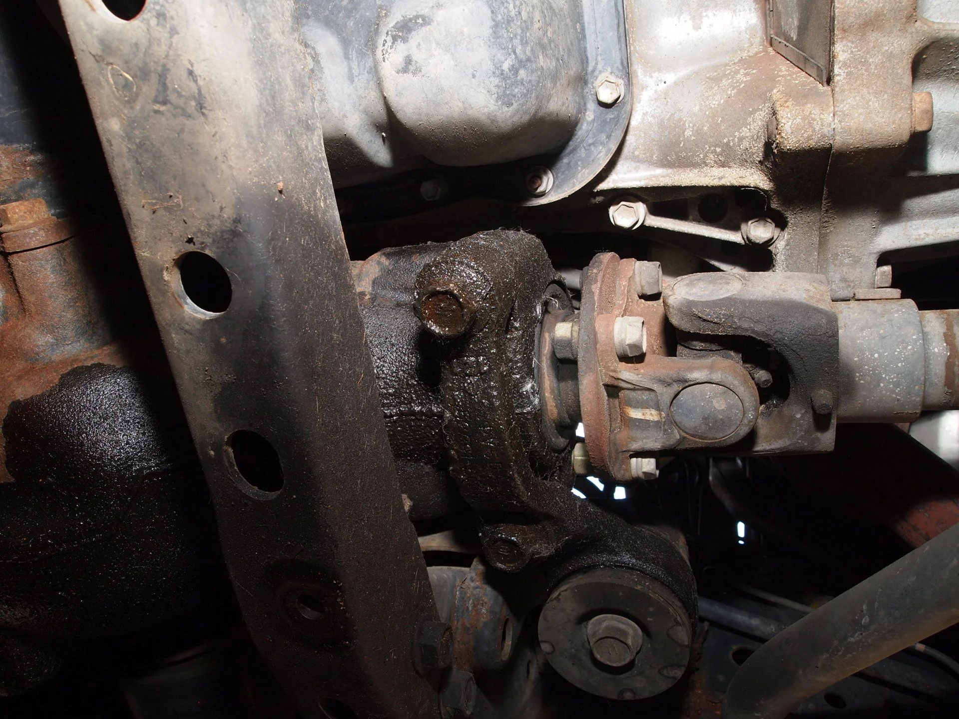

Found frond diff rear seal leak and steering rack input shaft leak. AT-205 re-seal is first set. The seals get old and AT-205 restores what time has leached out. AT-205 is not a stop leak or seal modifier, I don't use those.
Addition a measured amount of AT-205 and drive for minimum of 5 hours, clean and reinspect for leak by watching closely as I drive. Seems to have done the job. Both minor leaks stopped.
Front diff

This leaks seem to be from above just. After cleaning I've yet to see it return.

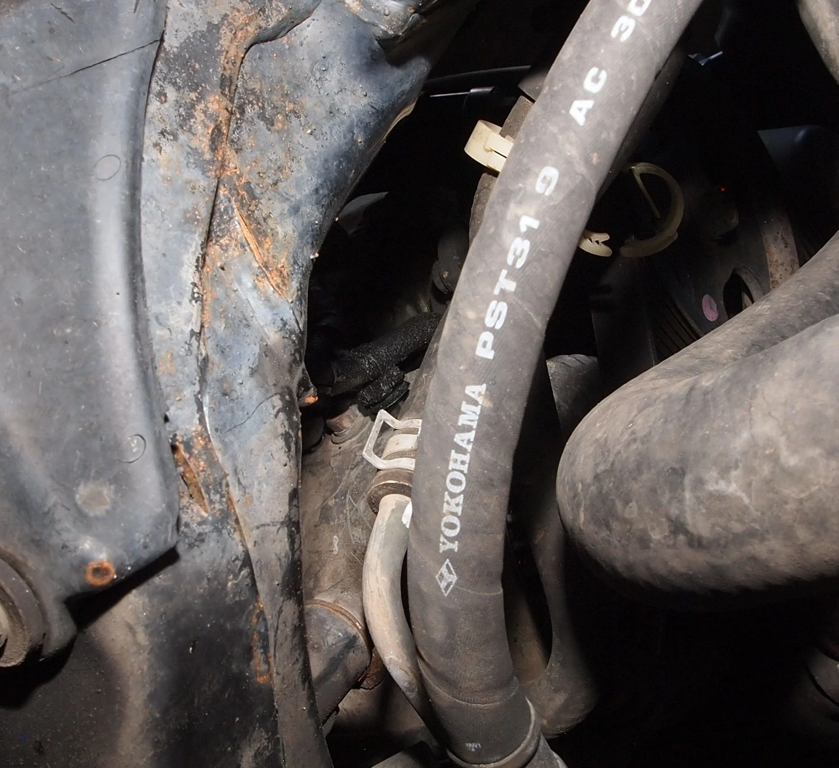

Power Steering hoses leaks and weeps.
I got lucky and the high pressure & lower pressure line were replace by Lexus.
In the 98-02, return hose to reservoir is only sold by Toyota as part of HP & Lower pressure line assembly. So again, sweet this was replaced.

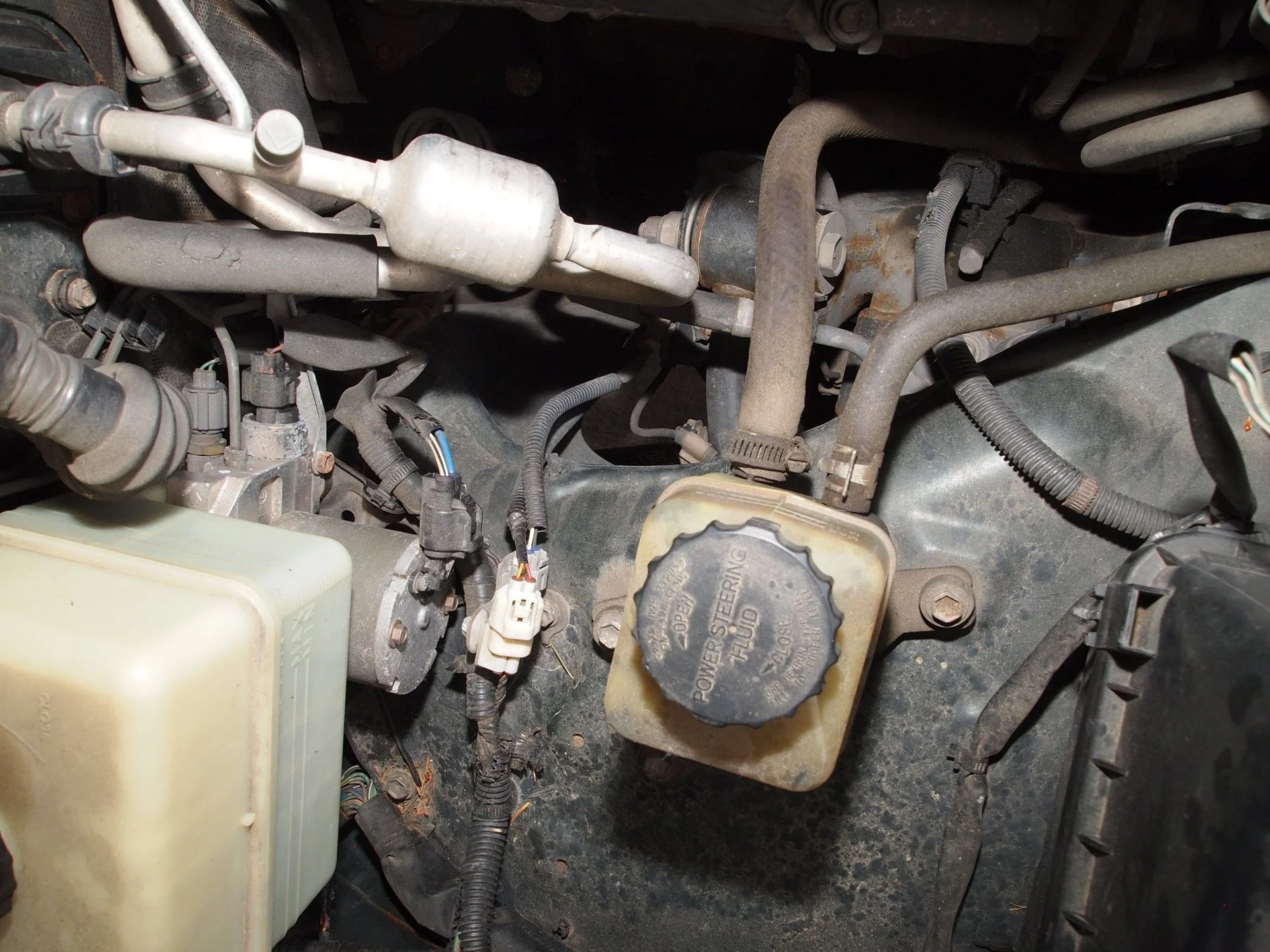

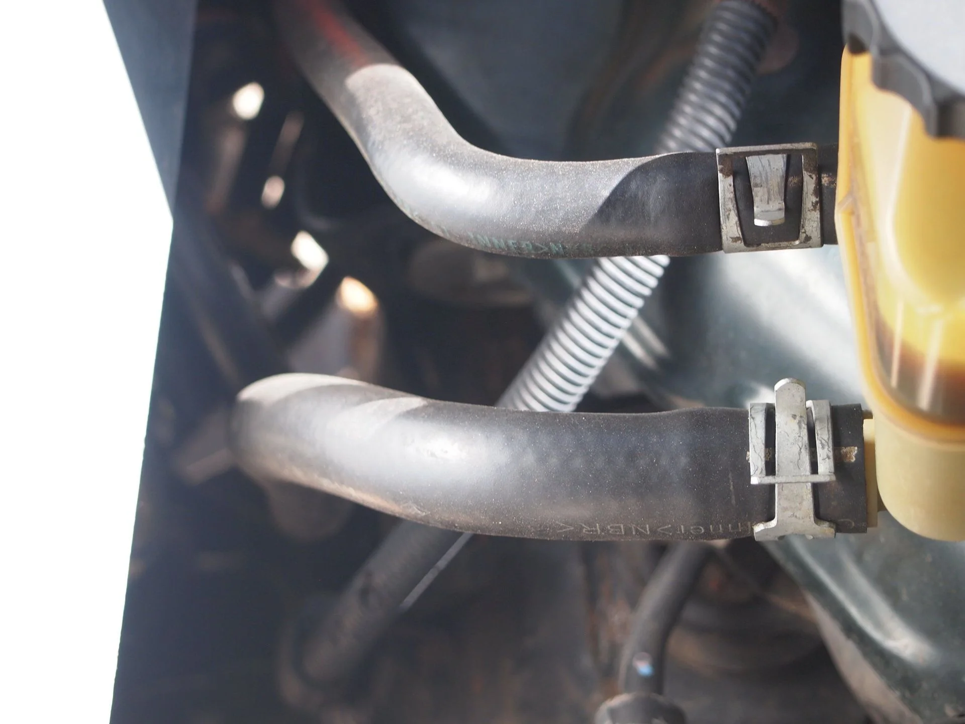

The suction hose which runs between reservoir and vane pump was apparently weeping a bit at one point. As Lexus Dealership put on screw clamps and just some cut to fit hose. This works okay, temporarily. But longer term it's best practice to replace the suction hose and spring clamps with Toyota OEM, so I did!

  4. Steering rack input shaft began leaking again after flush, just a bit. So I added some more AT-205 and it stopped.
  5. Front differential rear seal held after first adding AT-205.

New OEM suction hose and clamp.
Old aftermarket with screw clamp.

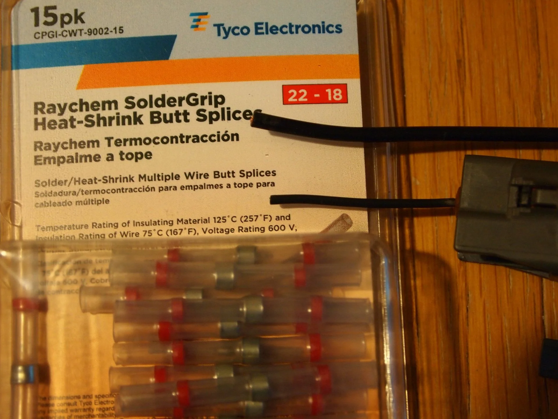

Found a wire cut on ABS unit on side of master. Remember this rig sat in a flied for extended period of time.
Fix it in just minutes actually.
