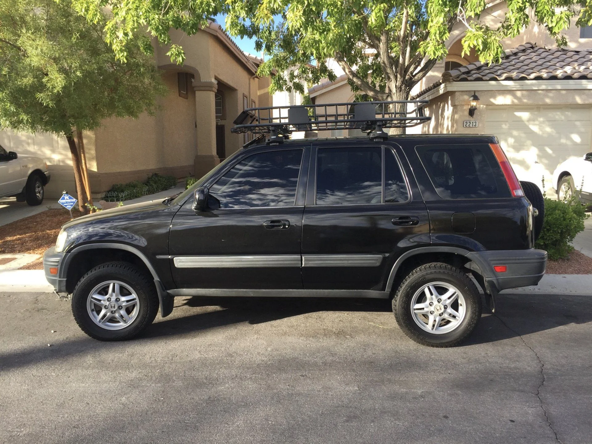

We’ve enjoyed the CR-V as it’s handled some light off road action and has been a good car, currently has a 1.5” OME lift and rear spacers to level out the ride.
While we haven’t yet parted ways with the Honda it is time to get started on the next project.
After some research and time spent on Mud we determined the LC to be a good option for the next tow car. (I know some will say flat towing a LC behind a motor home isn’t worth the risks, but there didn’t seem to be lots of other options available).
After some research I figured out they make tow bars for model years 99 - 03, but figured Toyota didn’t change the frame for model years 04 - 07 so pretty much any year would work. I wanted something newer than 03 to get the 5spd transmission and wasn’t worried as much about the mileage as this would be a 3rd car. I wanted something with a decent service history and was hoping to spend less than $10k if possible.
So here goes.
First the baseline of where the Honda got us.

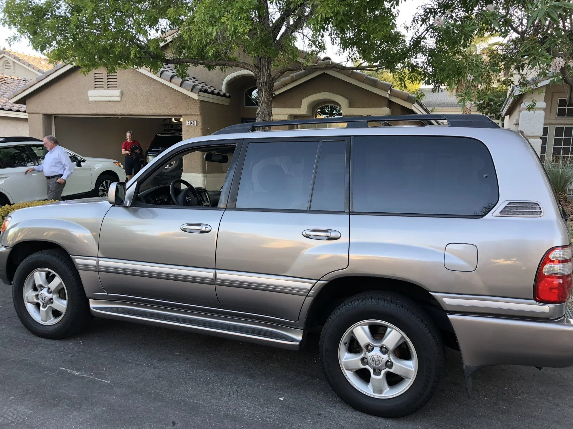

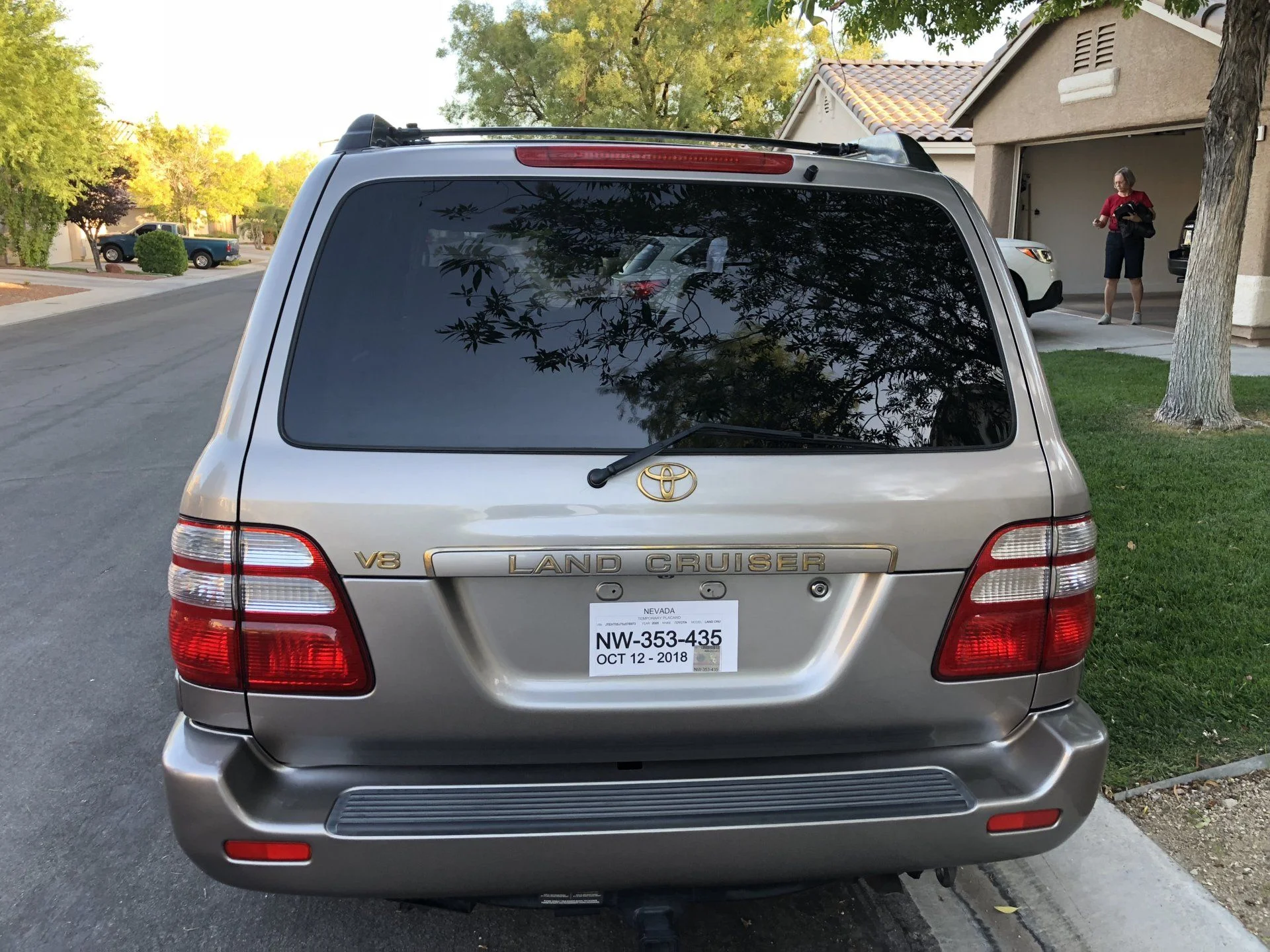

Enter the LC tow car, another 05 with 255k on the clock, acquired in Las Vegas. Service records show probably 3 PO’s the last two living in Las Vegas. For some reason the Toyota service records show the dealer services for the first 5 years, but don’t list the servicing dealership, so it’s hard to know where it started it’s life.

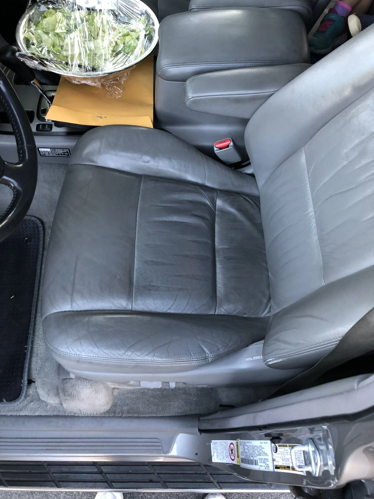

The interior was in good shape, granted it didn’t drive or feel like the 05 with 42k, but i guess that’s what 210k miles will do to a car. TB service was done at 211k, so that was a plus.

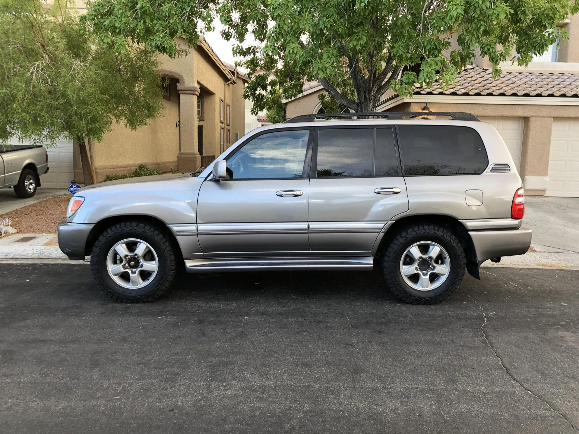

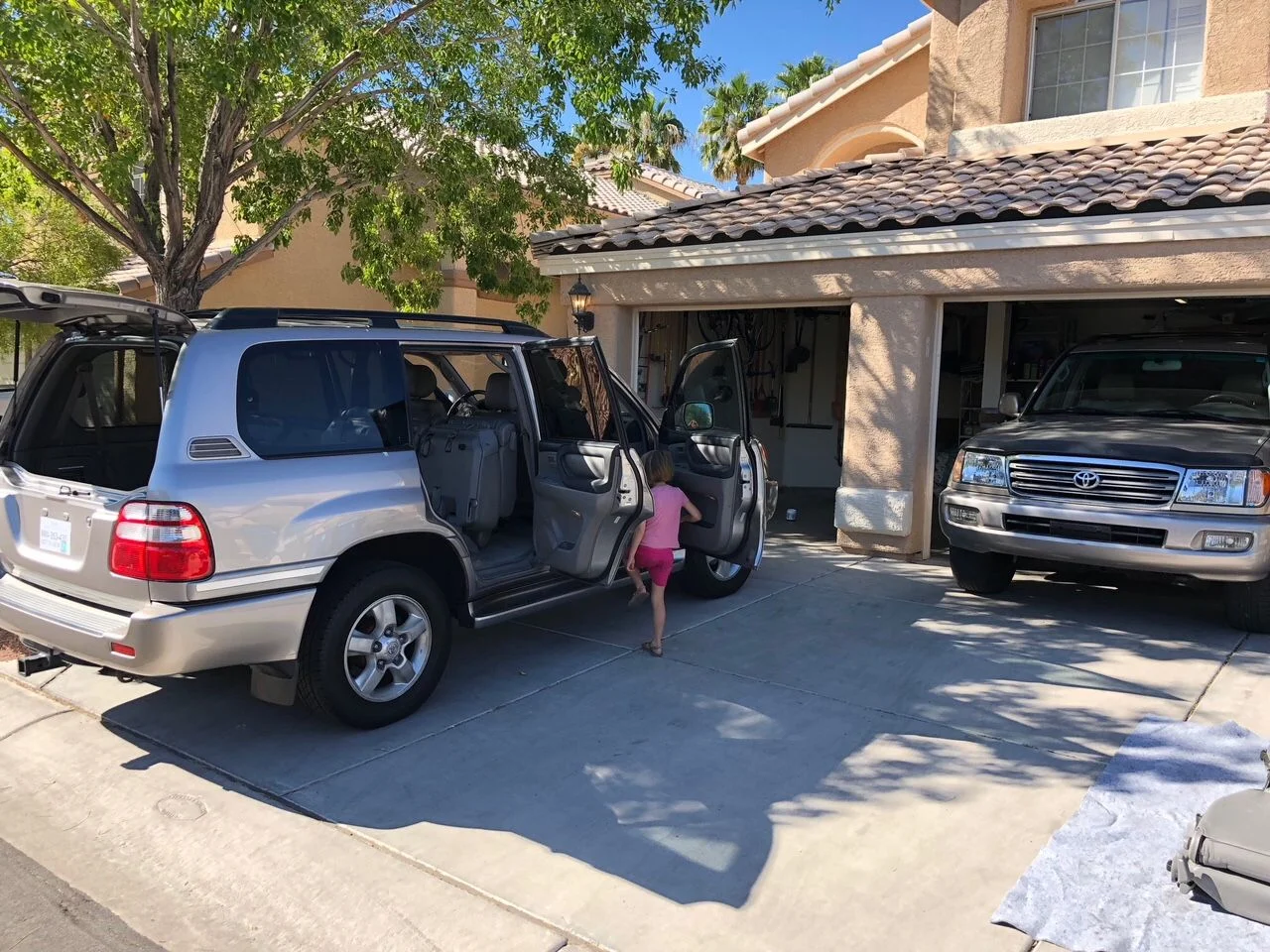

Here is a shot of the two cars for the limited time we had both.
Here are a couple more photos

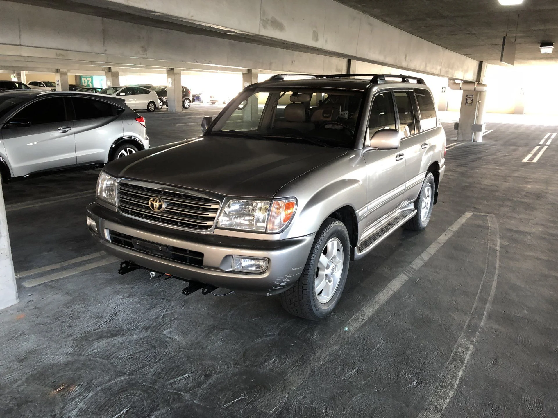

Also got around to installing the Blue Ox tow bar on Saturday. Install went well, still waiting for tail light wiring kit to arrive before wrapping everything up.
Doesn’t look to bad, might even be able to get an aftermarket bumper on there in the future.

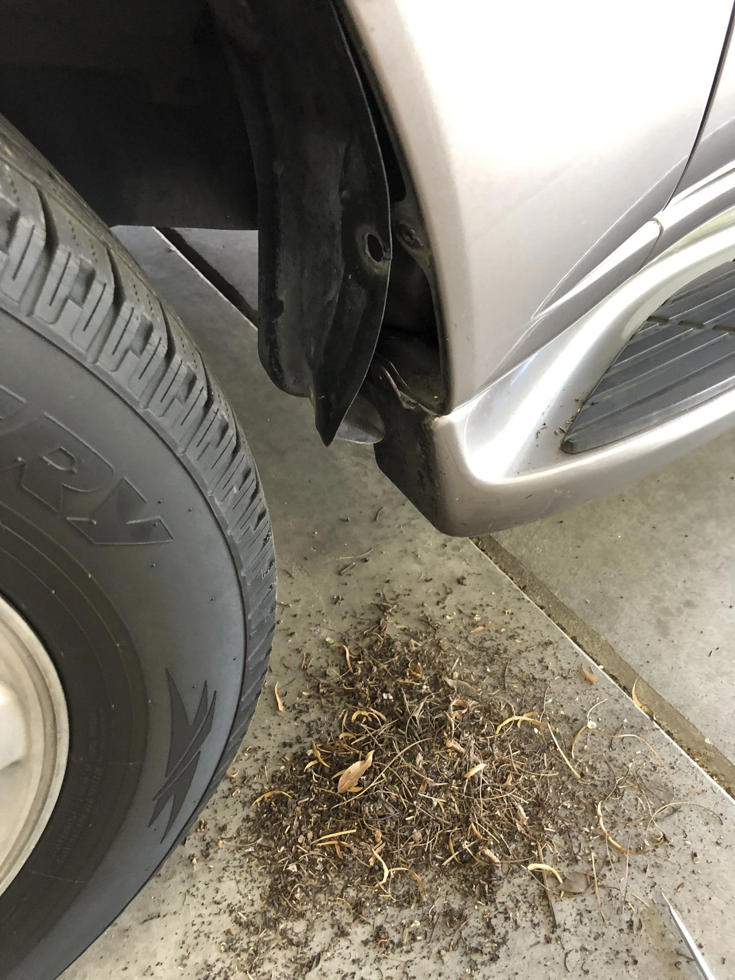

Also while I was cleaning things on Saturday, thought it would be a good idea to clean out the front fender wells. I could see little pine needles sticking out. Man was there a ton of leave in there.

Also added cabin air filters. The LC didn’t have the door, so had to replace that as well. Took about an hour following the directions on Mud.
Not as dirty as I expected give how much debris came out of the fender wells.

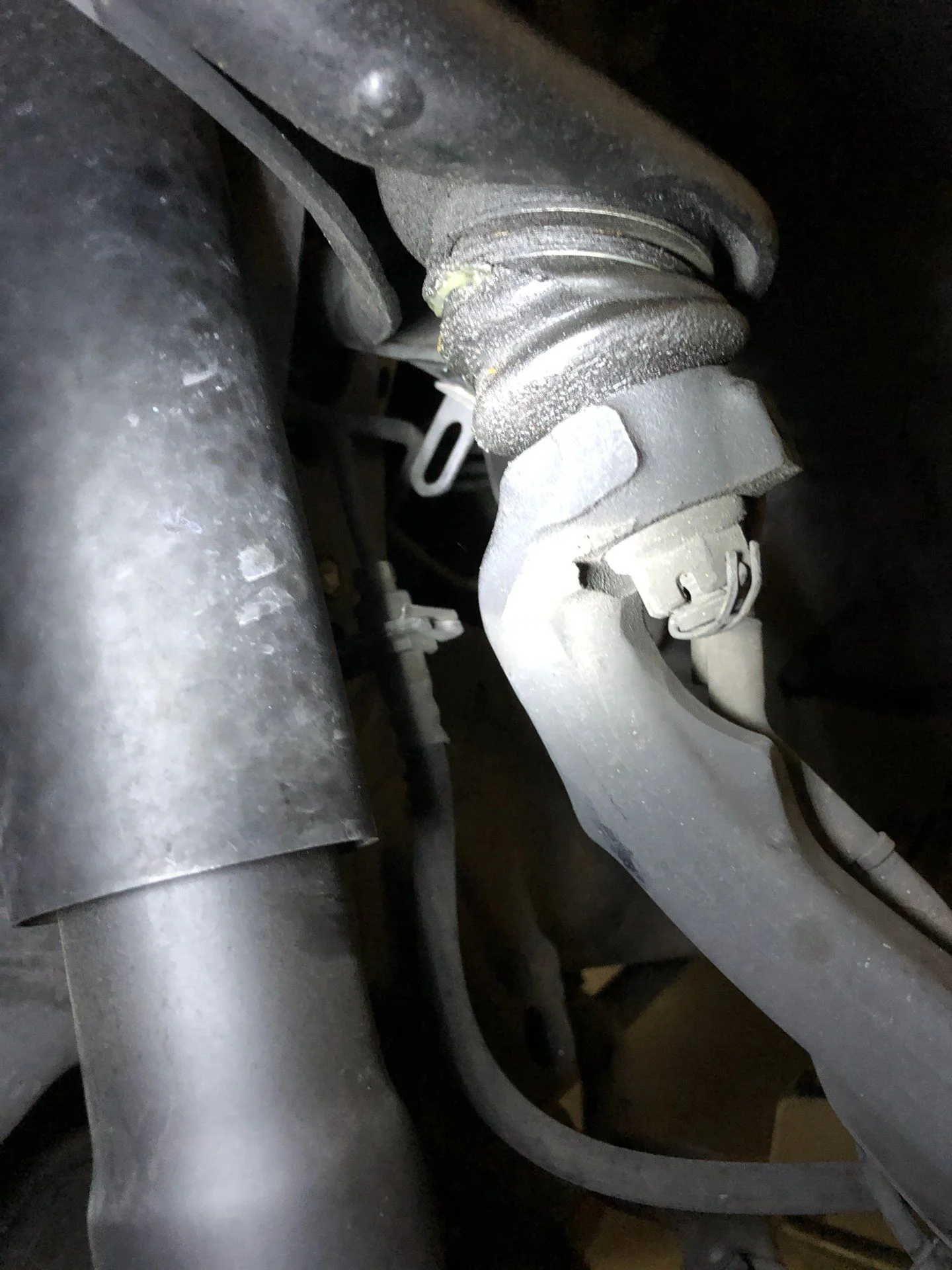

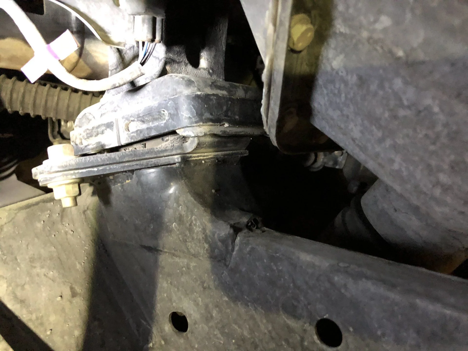

Used the opportunity to spend some more time underneath. This of course just adds items to the to do list.
Both motor mounts are definitely shot.
Transmission mount looks pretty good, but my guess is I’ll do this one as well just for peace of mind.
